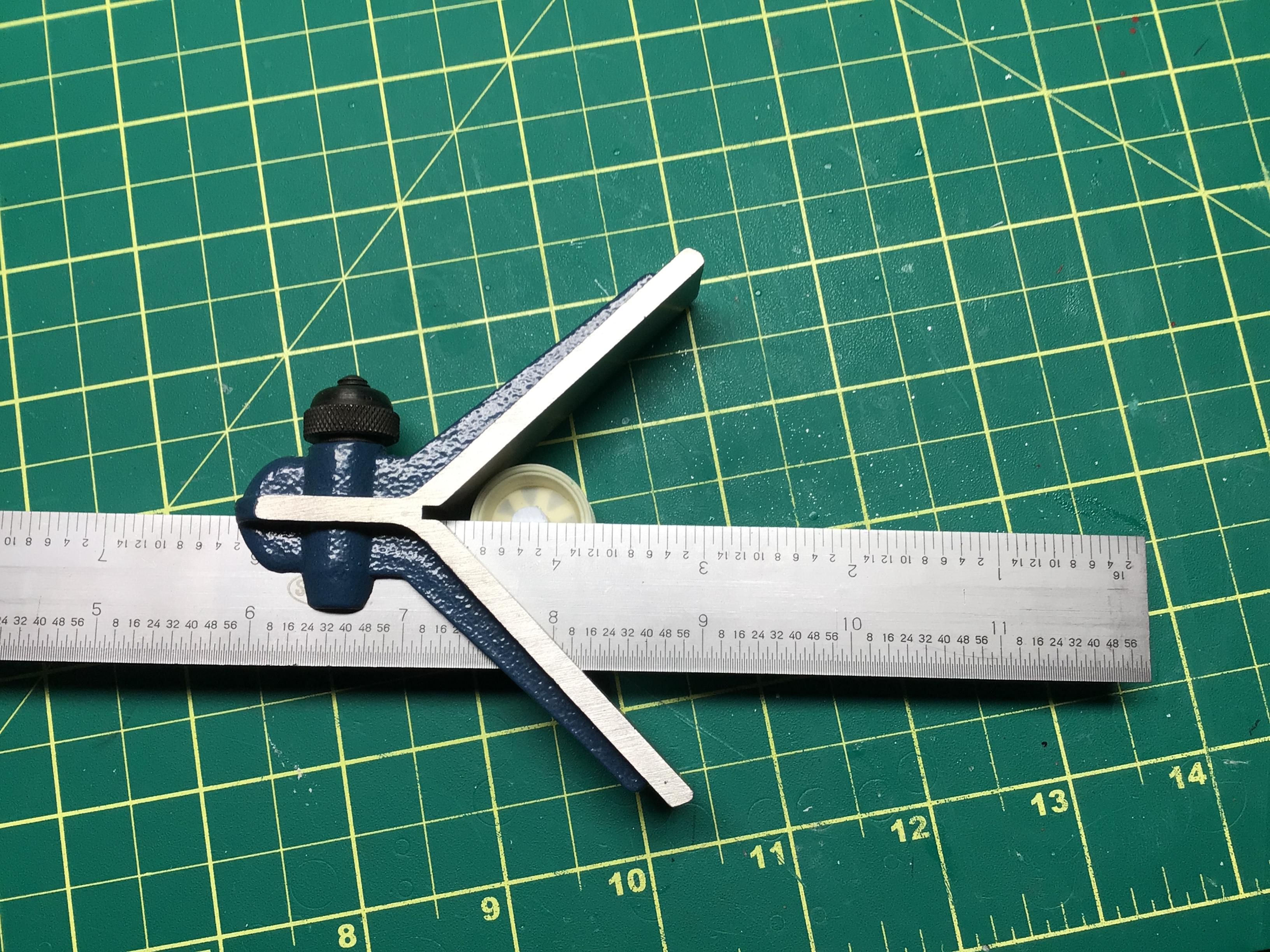

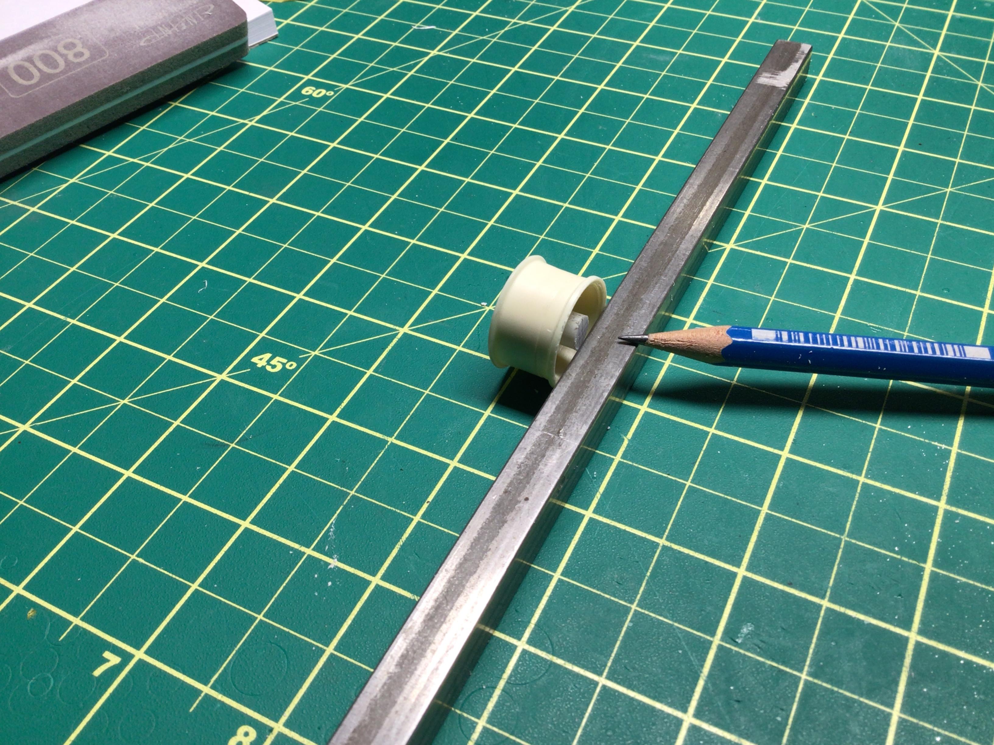

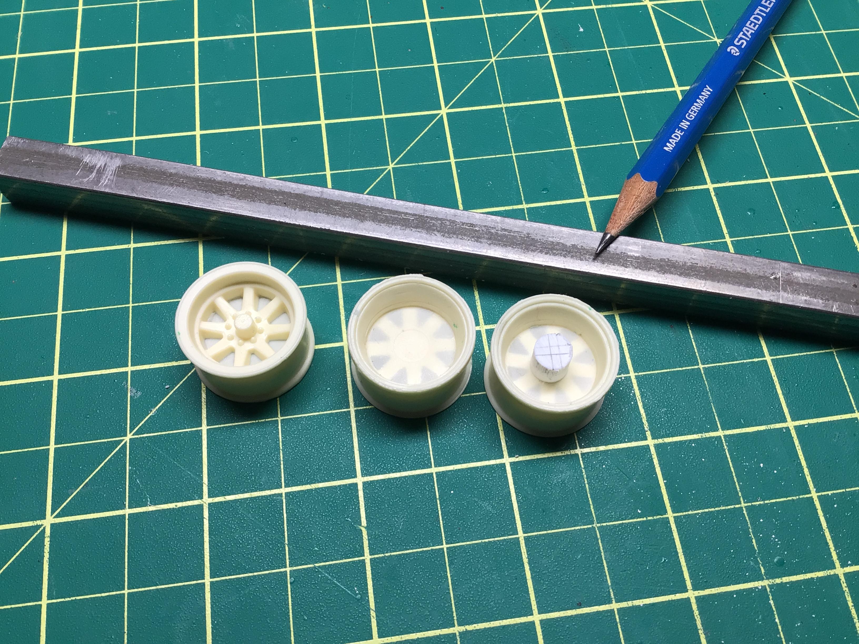

NOBLNG Posted August 17, 2024 Posted August 17, 2024 (edited) 23 hours ago, stinkybritches said: If Jeremy doesn't mind, I would like to piggyback on this topic. How do you make sure that your attachment method is centered on the wheel? Here’s a couple of ways to find the center of a wheel. 1) A center finder attachment for a combination square. 2) Find something close to half the diameter and mark the wheel four times to get double crosshairs straddling the exact center. Both can be done with or without the tire mounted. Edited August 17, 2024 by NOBLNG 1 1

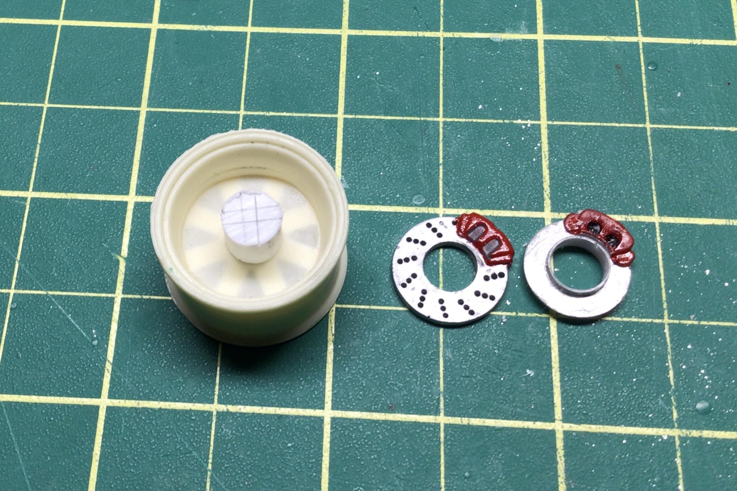

NOBLNG Posted August 17, 2024 Posted August 17, 2024 I also cast a couple sizes of disc brake rotors that I can drill to slide over the evergreen stub that I mount to the wheels. 1

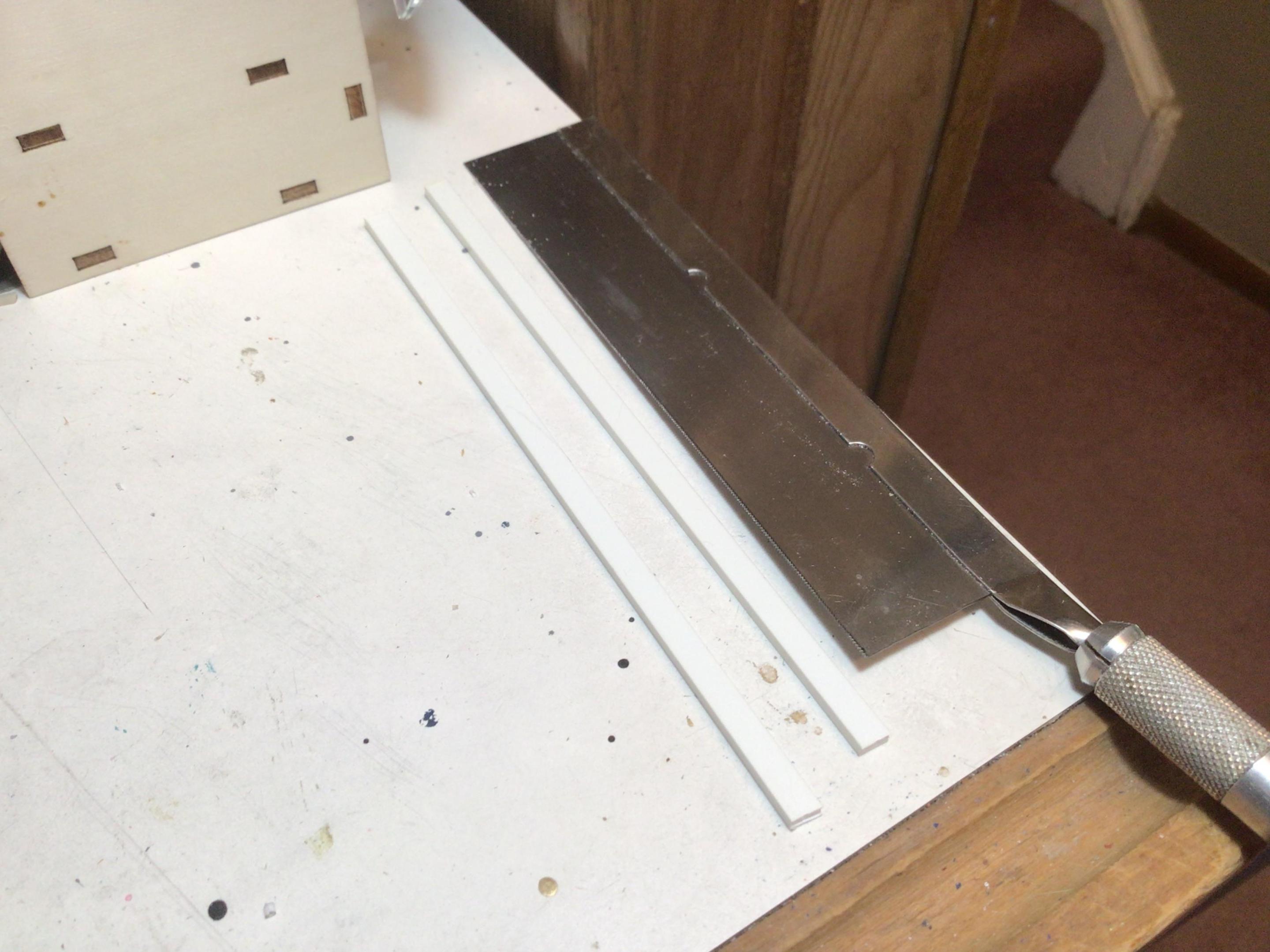

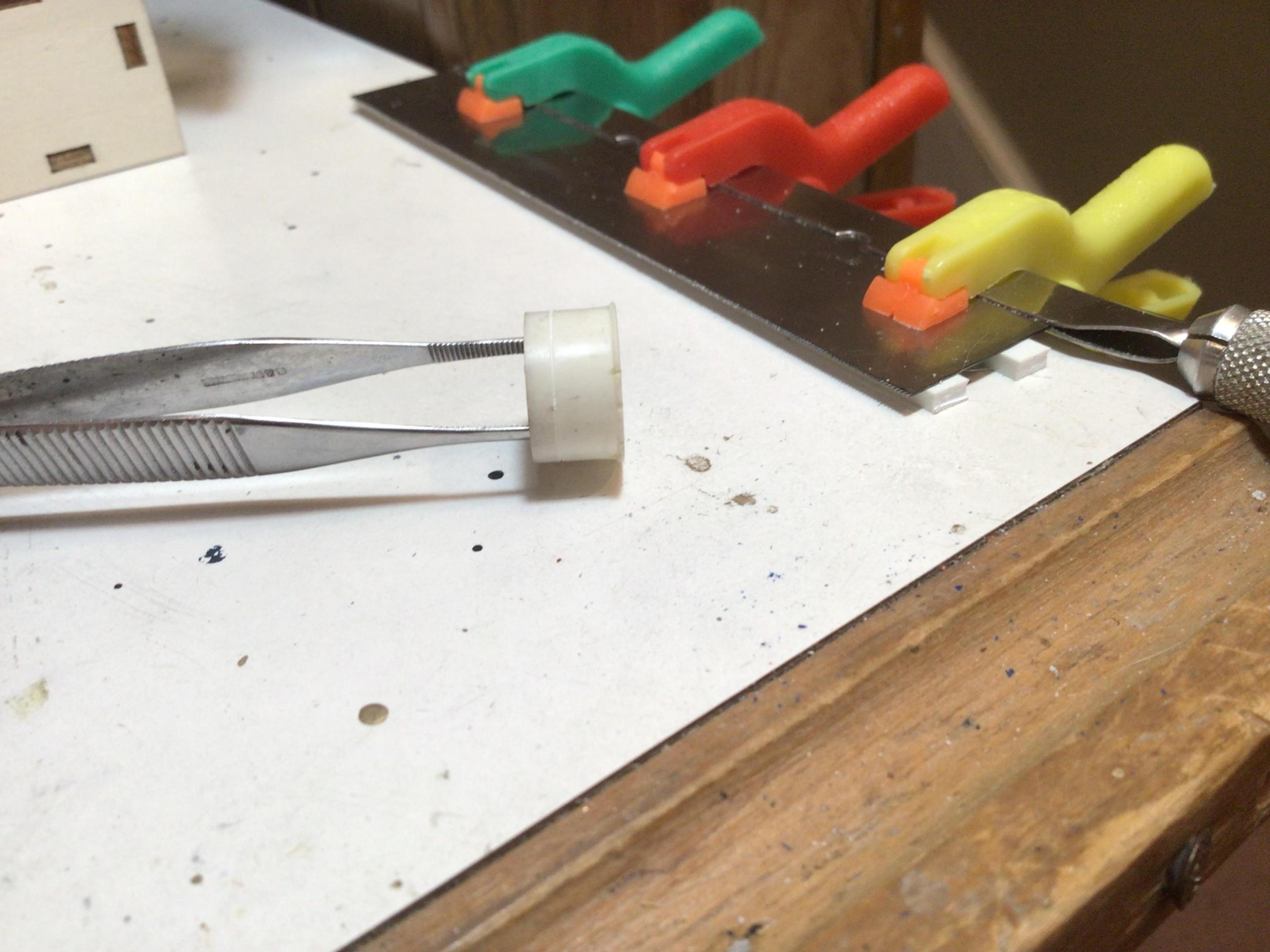

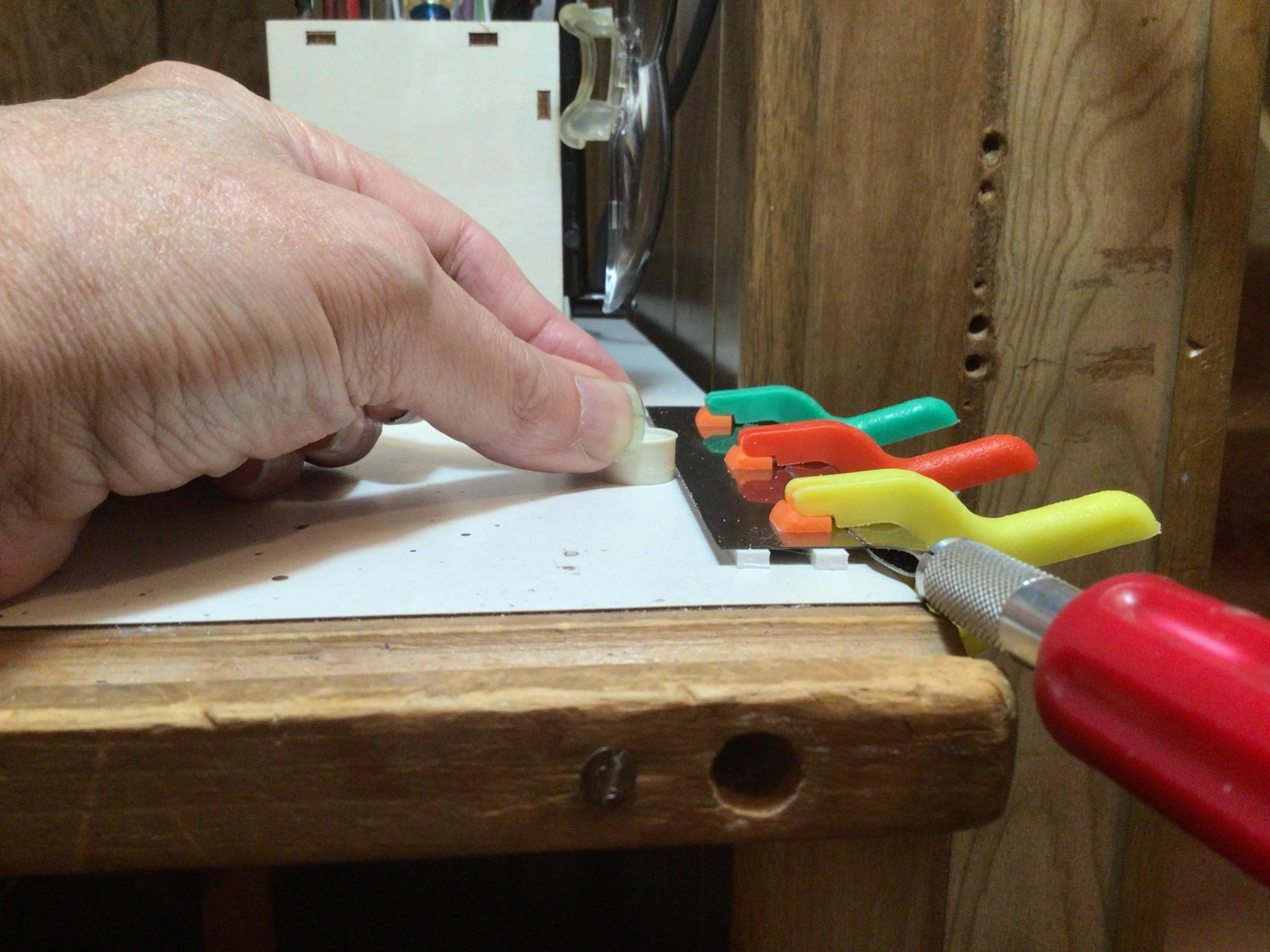

Radretireddad Posted August 20, 2024 Posted August 20, 2024 (edited) Tip number 2. When narrowing a set of wheels or fabricating widening rings, I've found it difficult to get a precise cut using my drill as a lathe. It’s also difficult trying to find ways to securely chuck various types of wheels into my drill so I came up with this method instead. I place various thicknesses of evergreen square or rectangular rod under my razor saw and clamp them to the edge of my workbench. I then drag the wheel along the edge of the blade while rotating it. This gives me a precise cut that always ends where it started and cuts exactly the same width on all 4 wheels. You can cut chrome plated wheels if you cover the face with masking tape to protect the finish. You can also use strip stock under the saw for very narrow cuts. You can also cut various diameter’s and wall thicknesses of PVC tubing if you like. The only caveat is that it’s hard on the old fingertips. Edited August 20, 2024 by Radretireddad 3

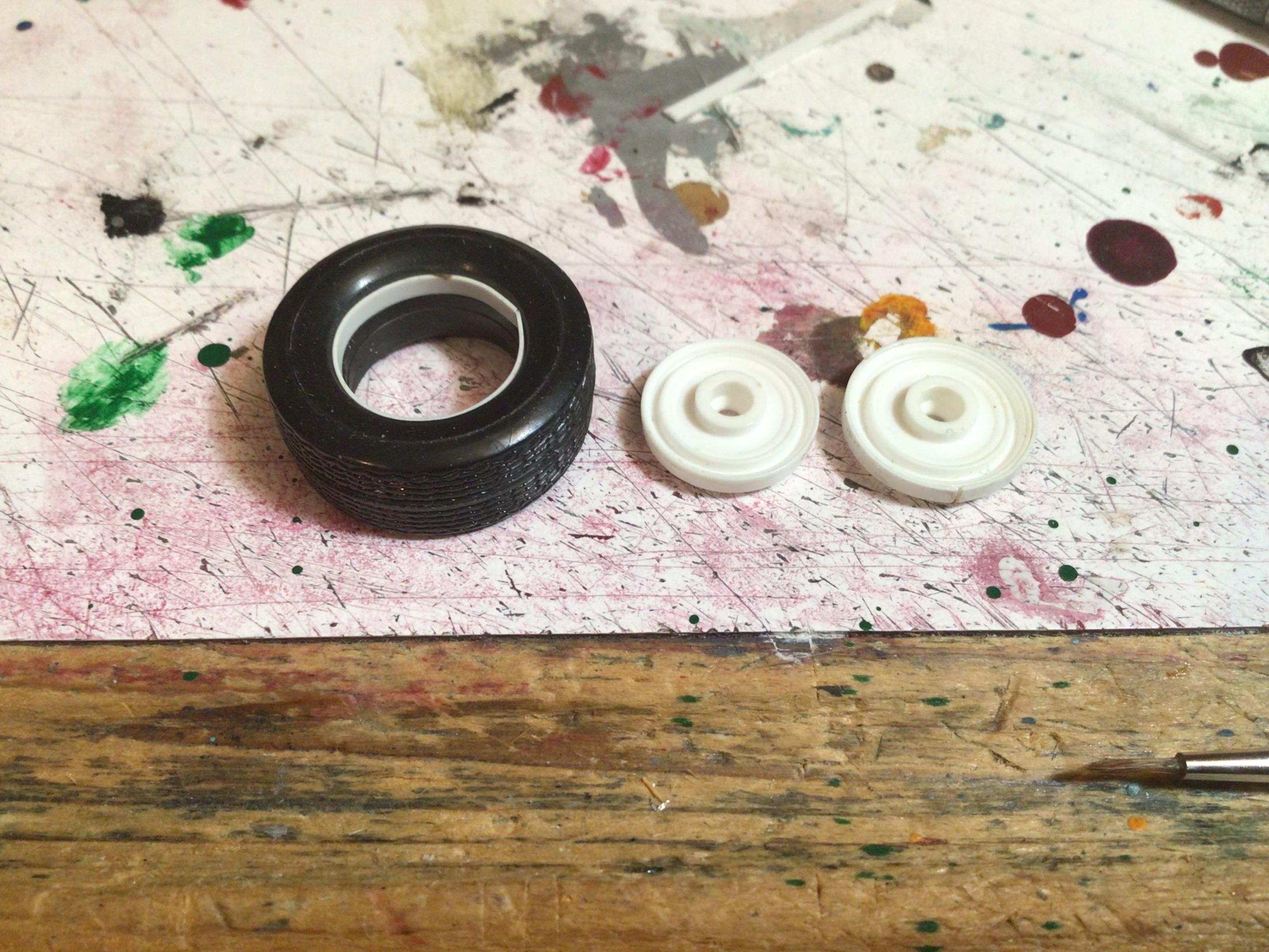

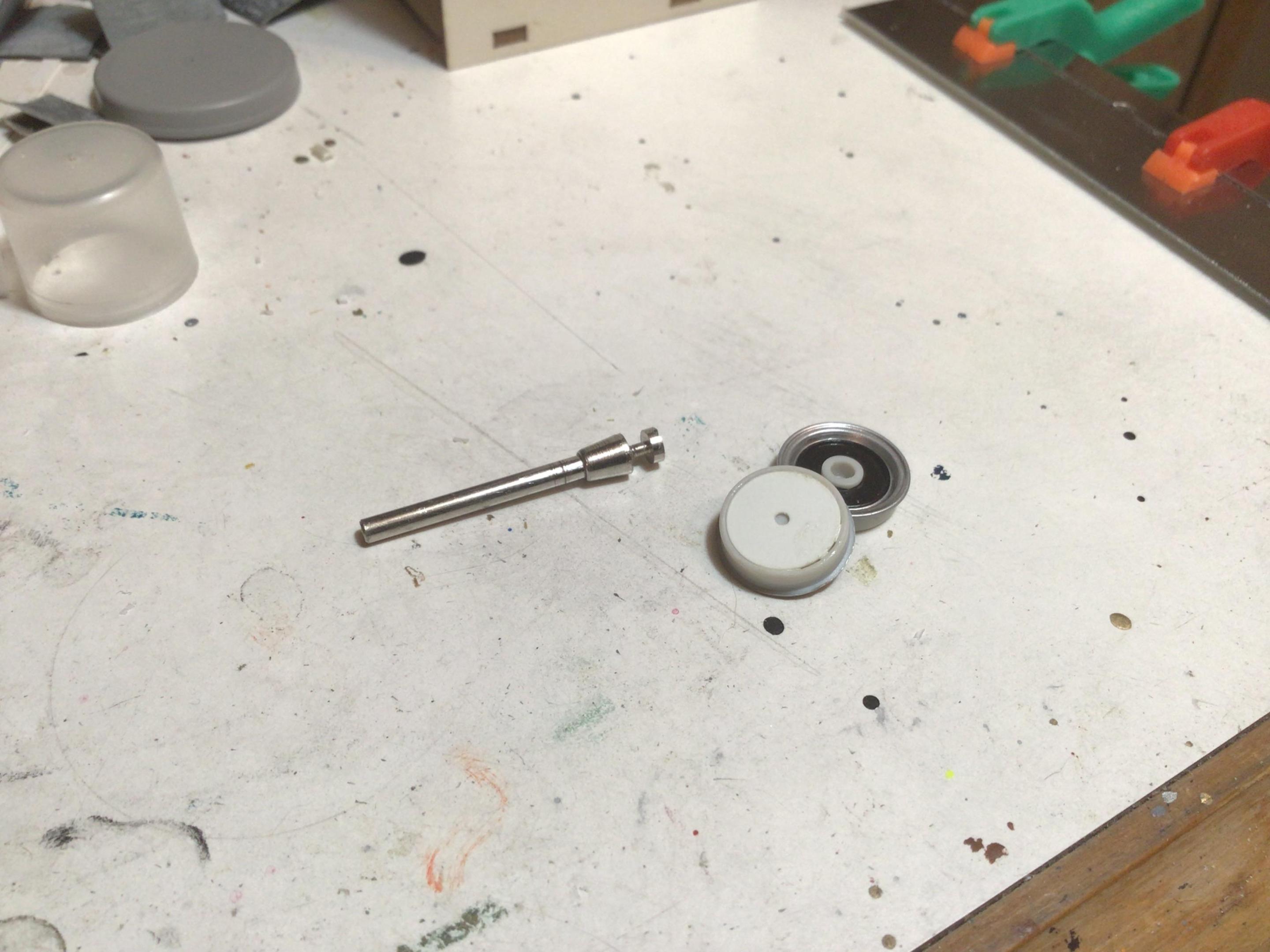

Radretireddad Posted August 20, 2024 Posted August 20, 2024 (edited) Tip number 3. Many of the current round 2 offerings use an inner retainer cap that fits into the wheel back which requires the use of only the wheels and tires that came in the kit to capture the inner retainer with no excess slop between the inner and outer wheel. Since I’d like to use other wheels and tires that may not maintain the proper fit, I came up with this. I first file the head of the inner retainer cap down so it’s thinner than the cavity in the wheel back. I then rough cut 4 pieces of evergreen sheet stock into discs, clamp them in a stack and drill a small hole through the center of all four at once. I then screw the stack of all four into my Dremel arbor, spin ‘em up and file all four down to just fit inside the inner wheel back. Place the retaining cap into the wheel back and carefully glue each disc you’ve just made into the wheel back around the outer edge. Now the inner retaining cap is captured with no side to side slop and your free to use any wheel and tire you want. These are off of The AMT 1970 Monte Carlo. I hope you’ll find these useful. Edited August 20, 2024 by Radretireddad 1
