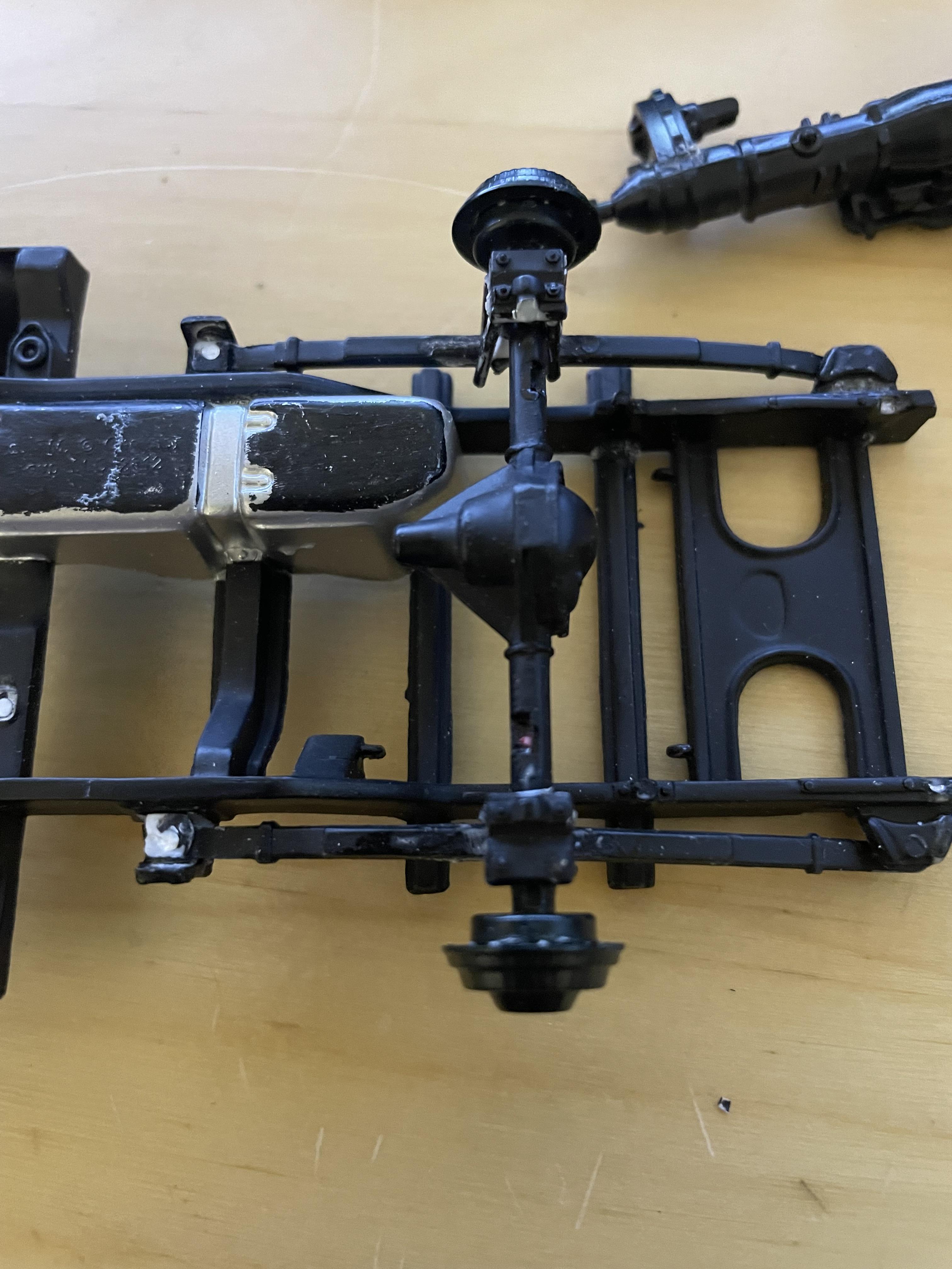

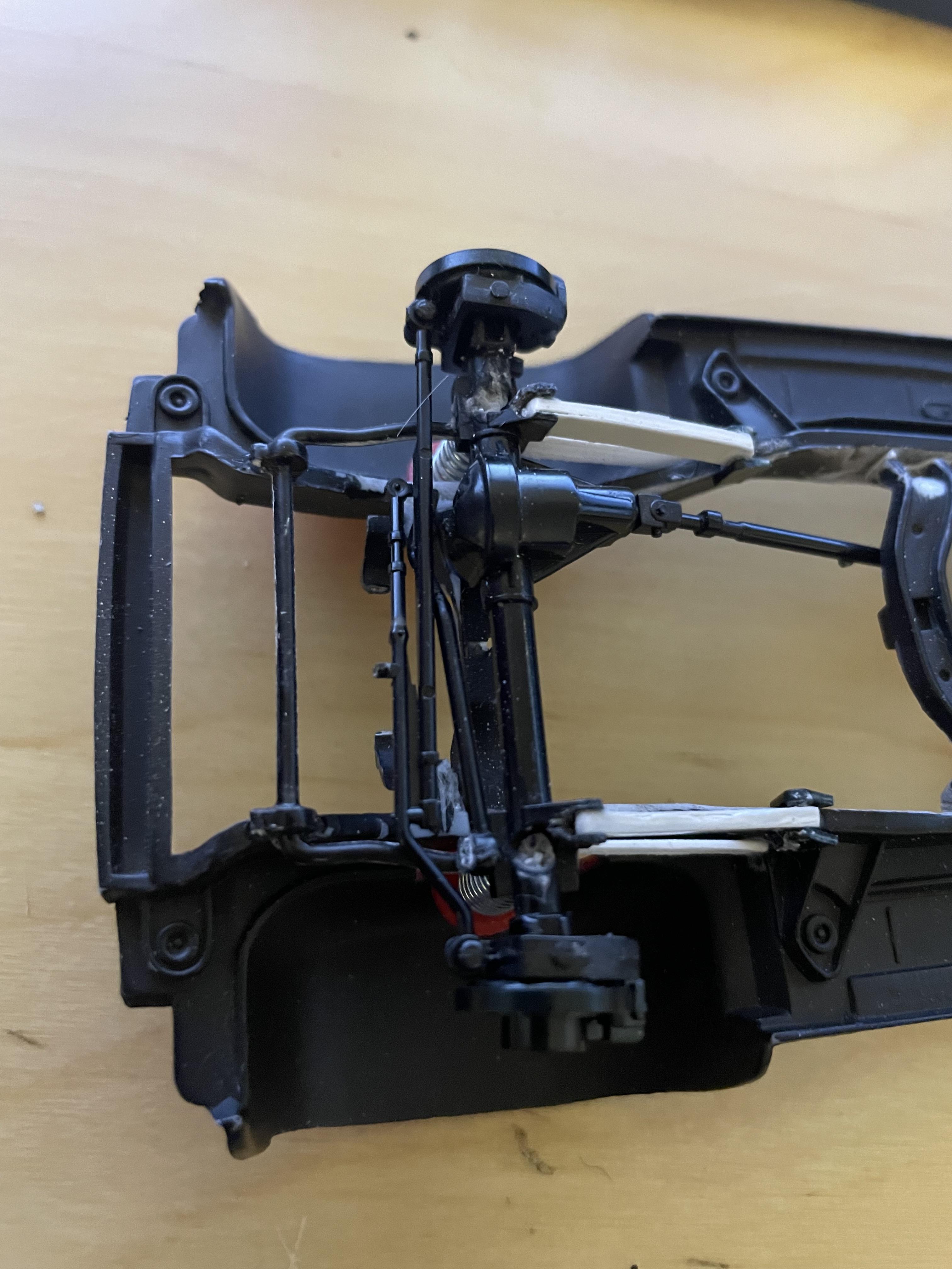

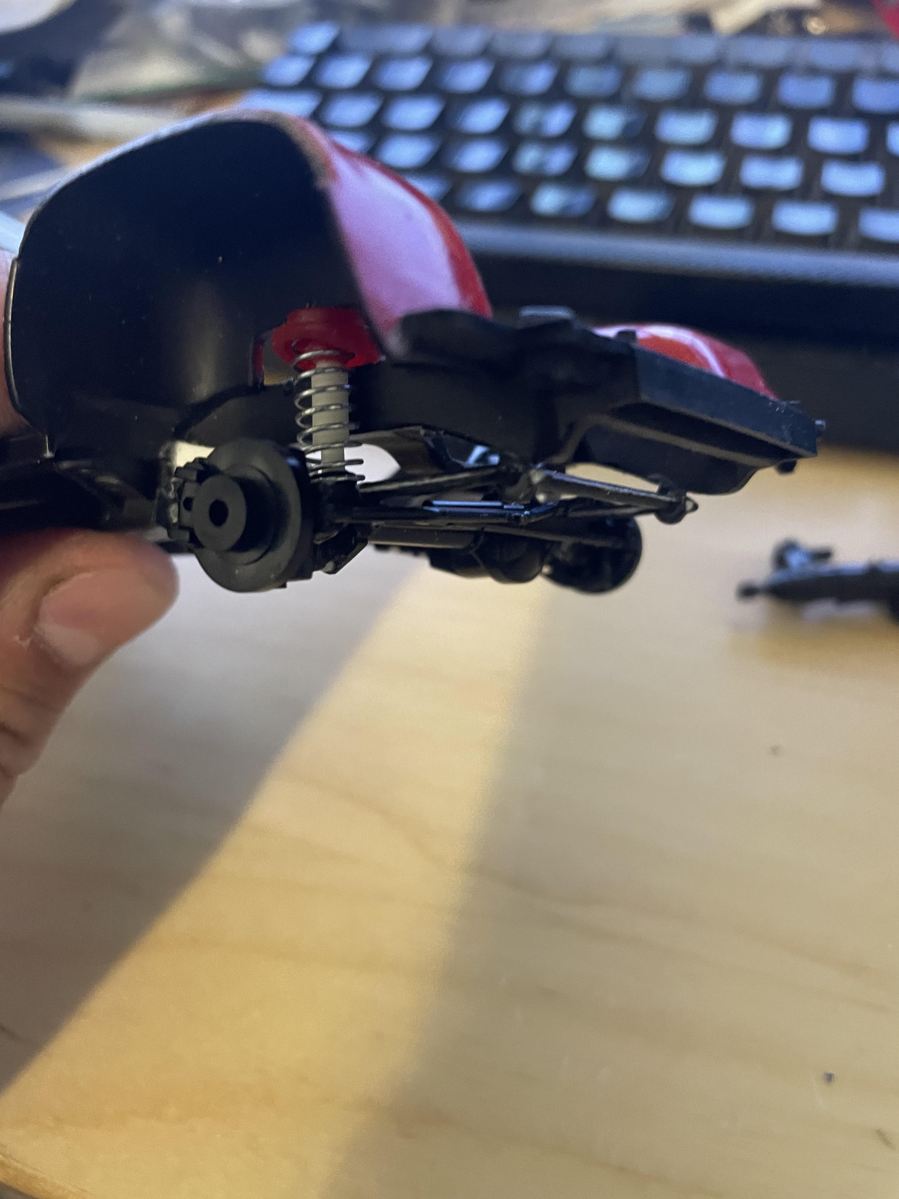

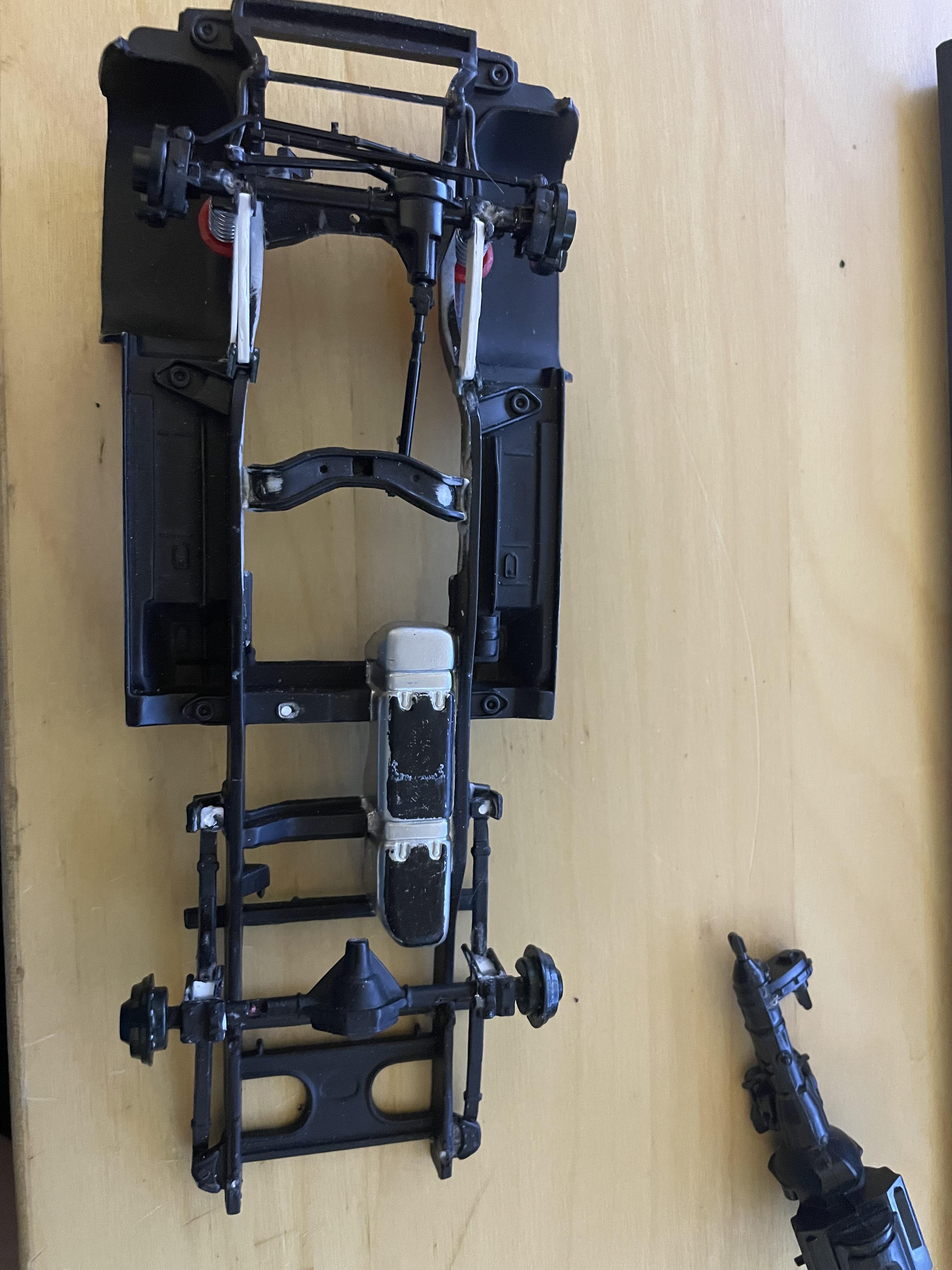

I was trying to figure out how to make a more common Ram 1500 out of a stalled Ram VTS project, and I realized that the Tamiya Grand Cherokee had just what I needed! I know they are different scales but the size difference was very minimal. I grabbed the drivetrain (minus rear axle), relocated a couple of the crossmembers, removed the 2wd suspension mounts, flipped the forward leaf spring mount, added lift blocks, and scratchbuilt a front suspension. The brakes also fit the kit rear axle perfectly!  Here’s the finished chassis work, off to paint the interior!

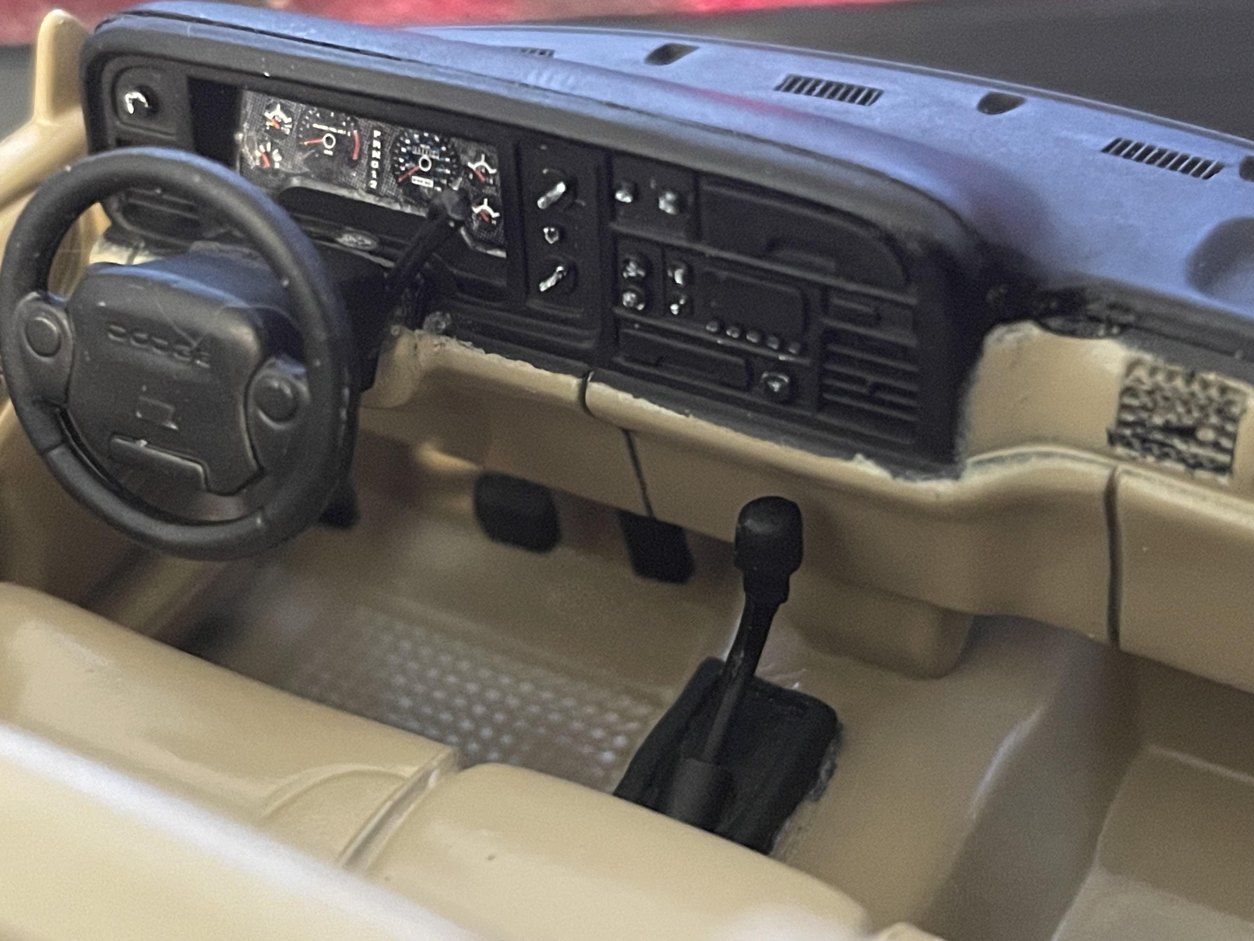

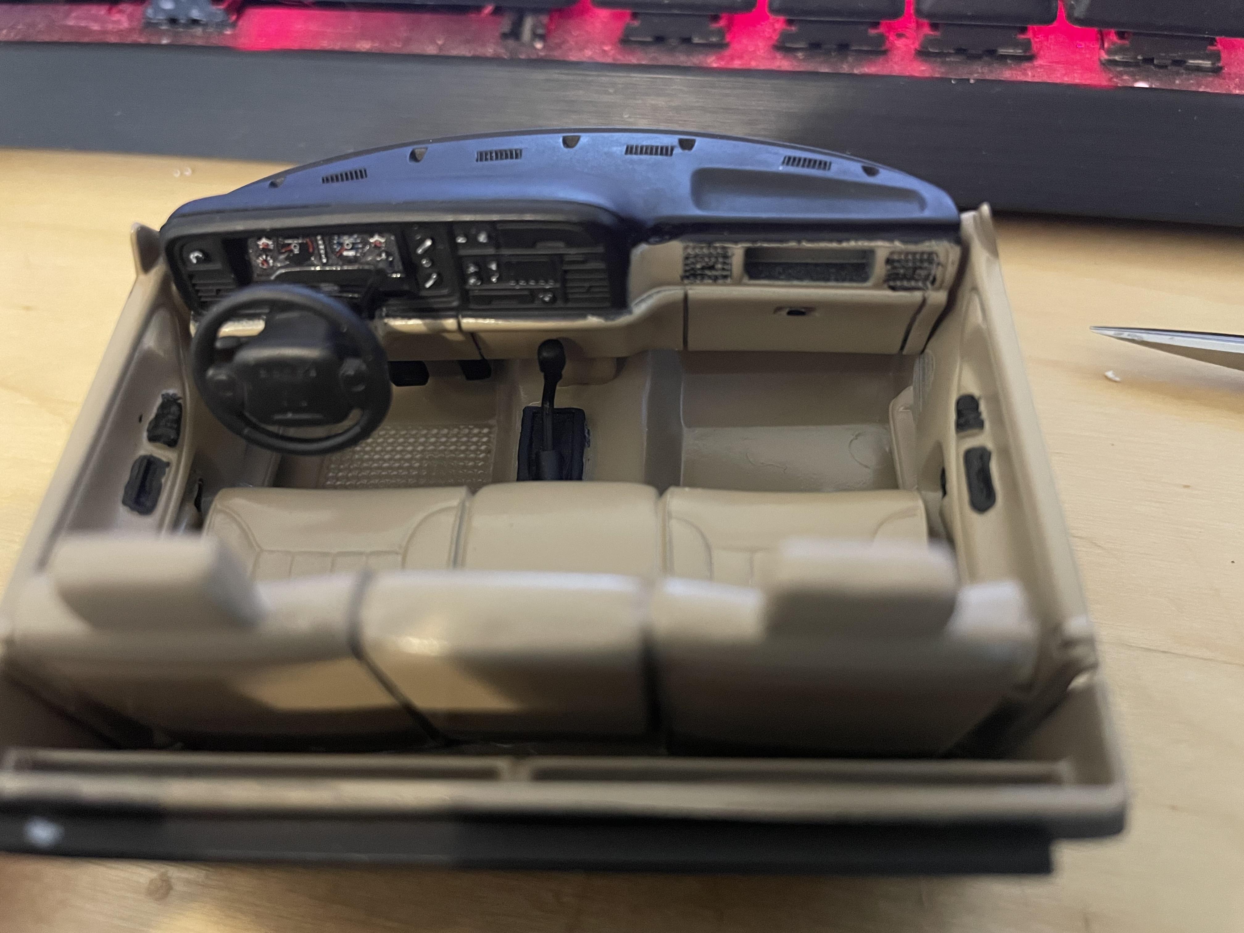

Got the interior finished up last night! Basically the kit interior with the addition of a column shifter and transfer case shifter. Its meant to replicate the Laramie SLT leather interior, but i think the fake wood trim they had is ugly so i didnt replicate it.
  • Like 1
Chassis and interior look really nice.

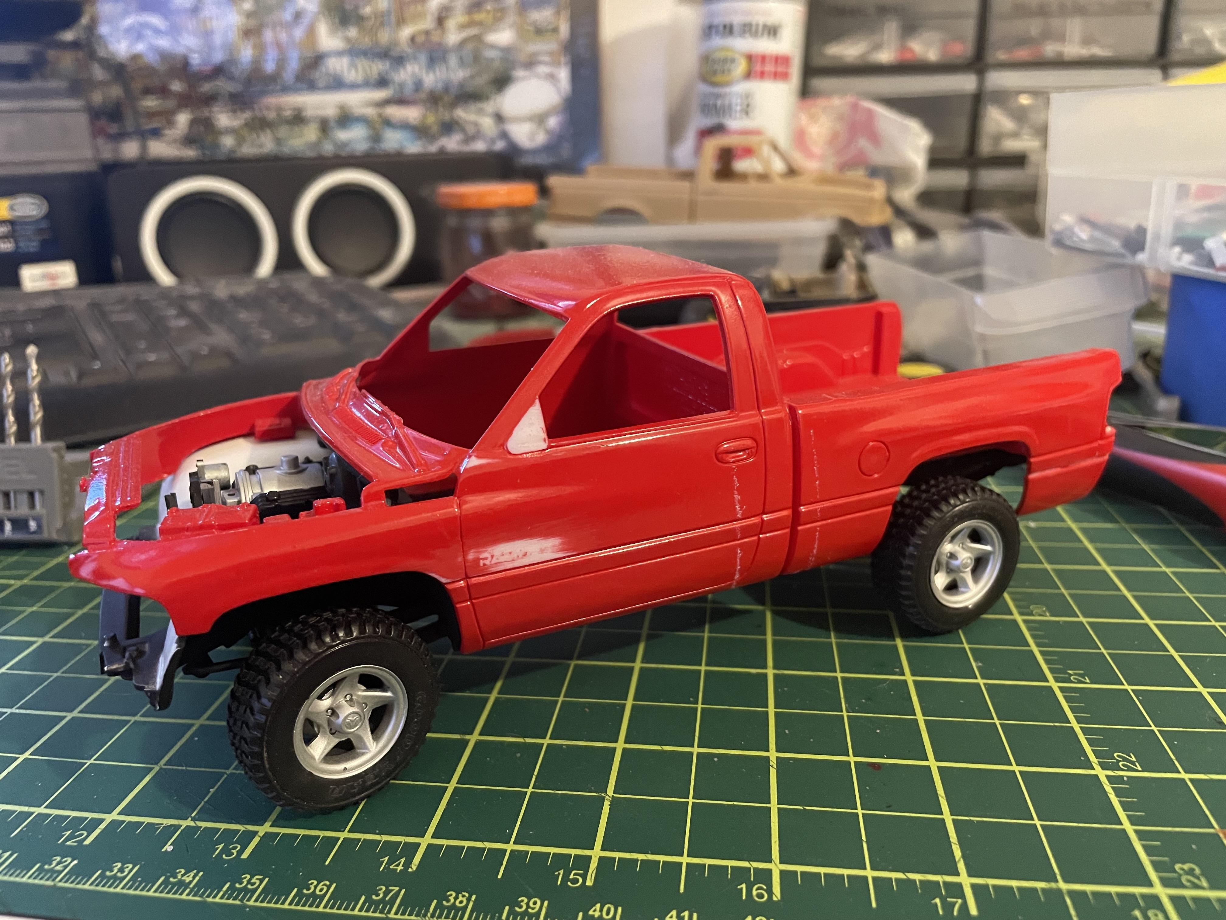

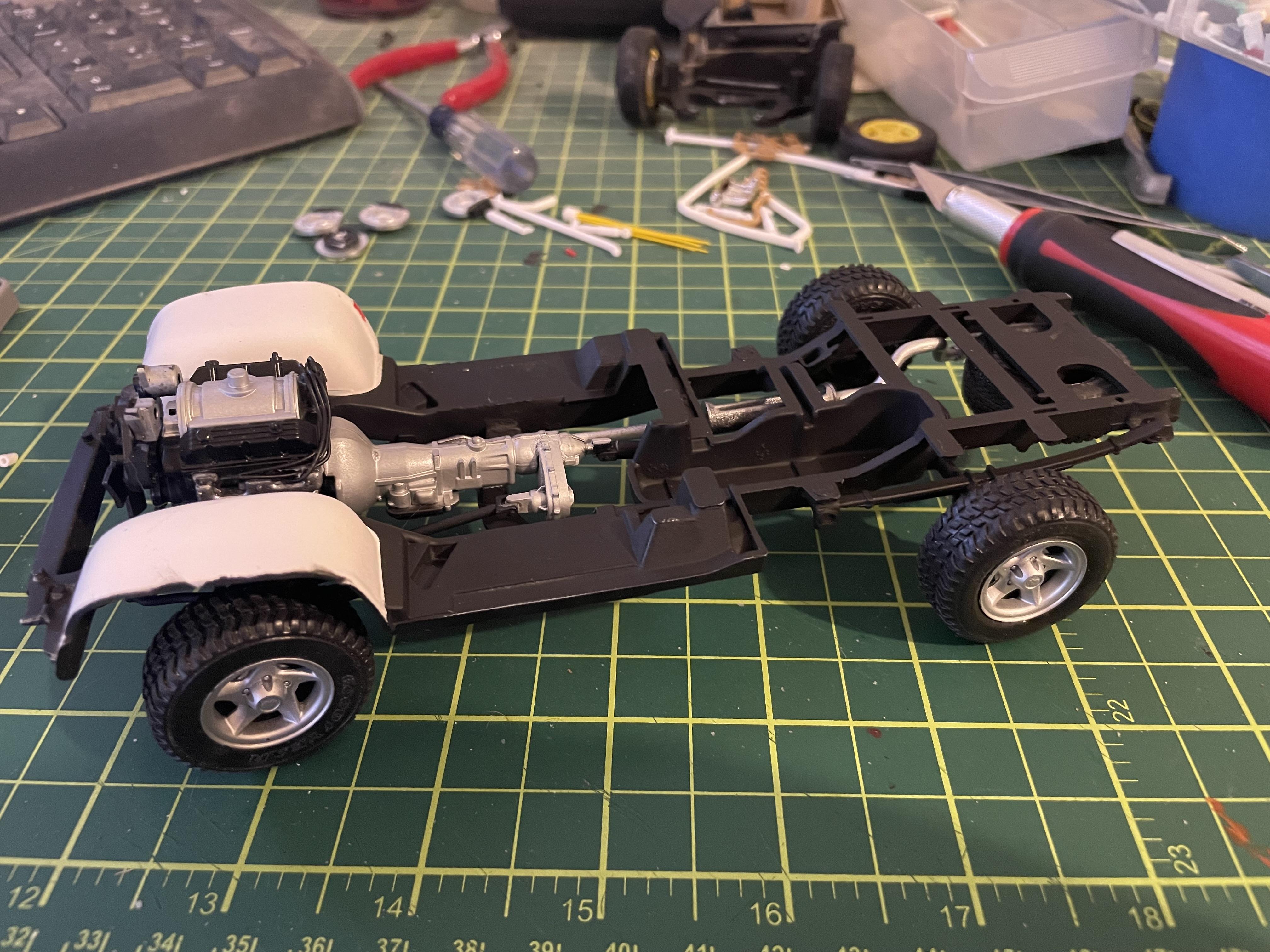

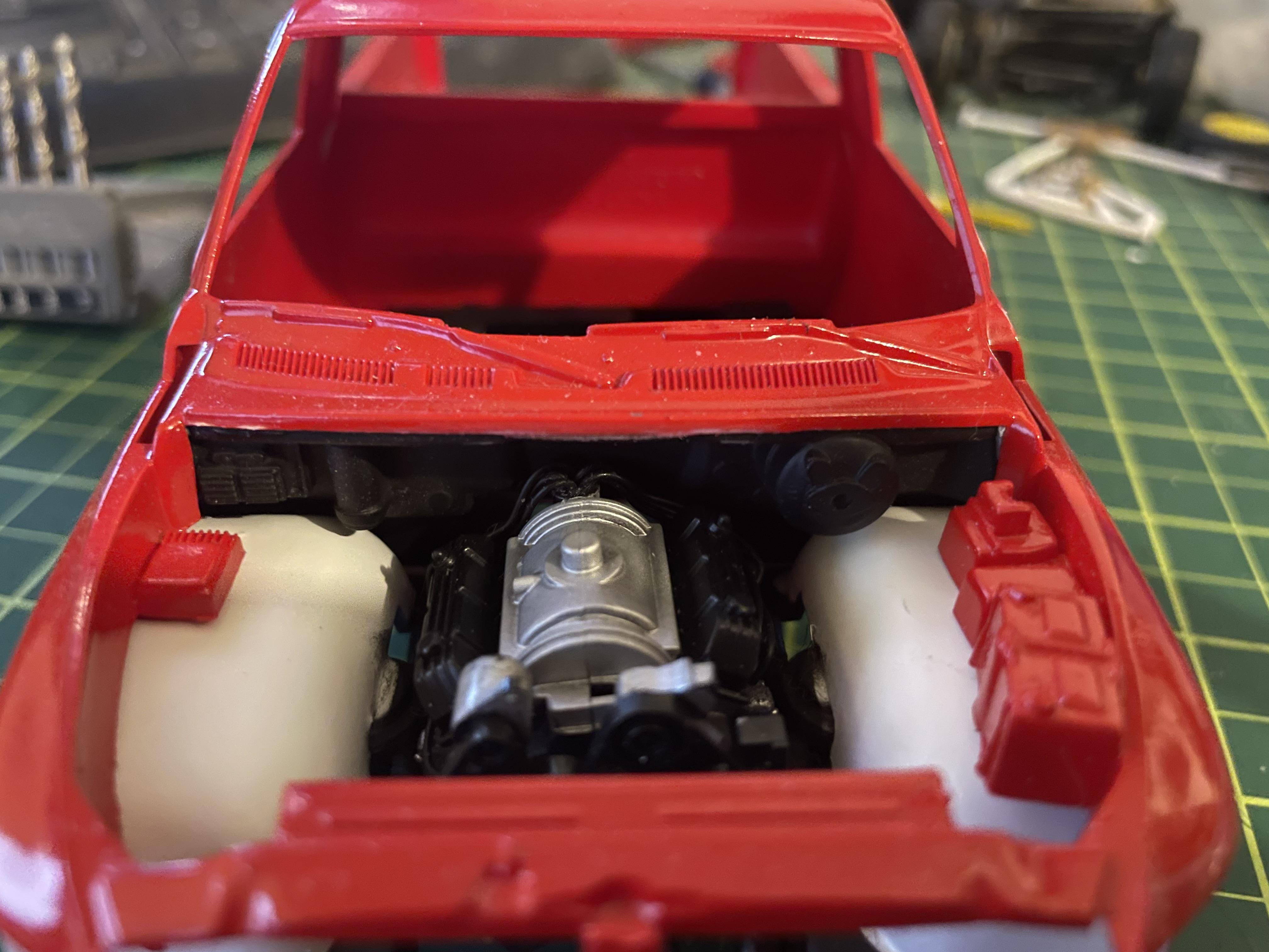

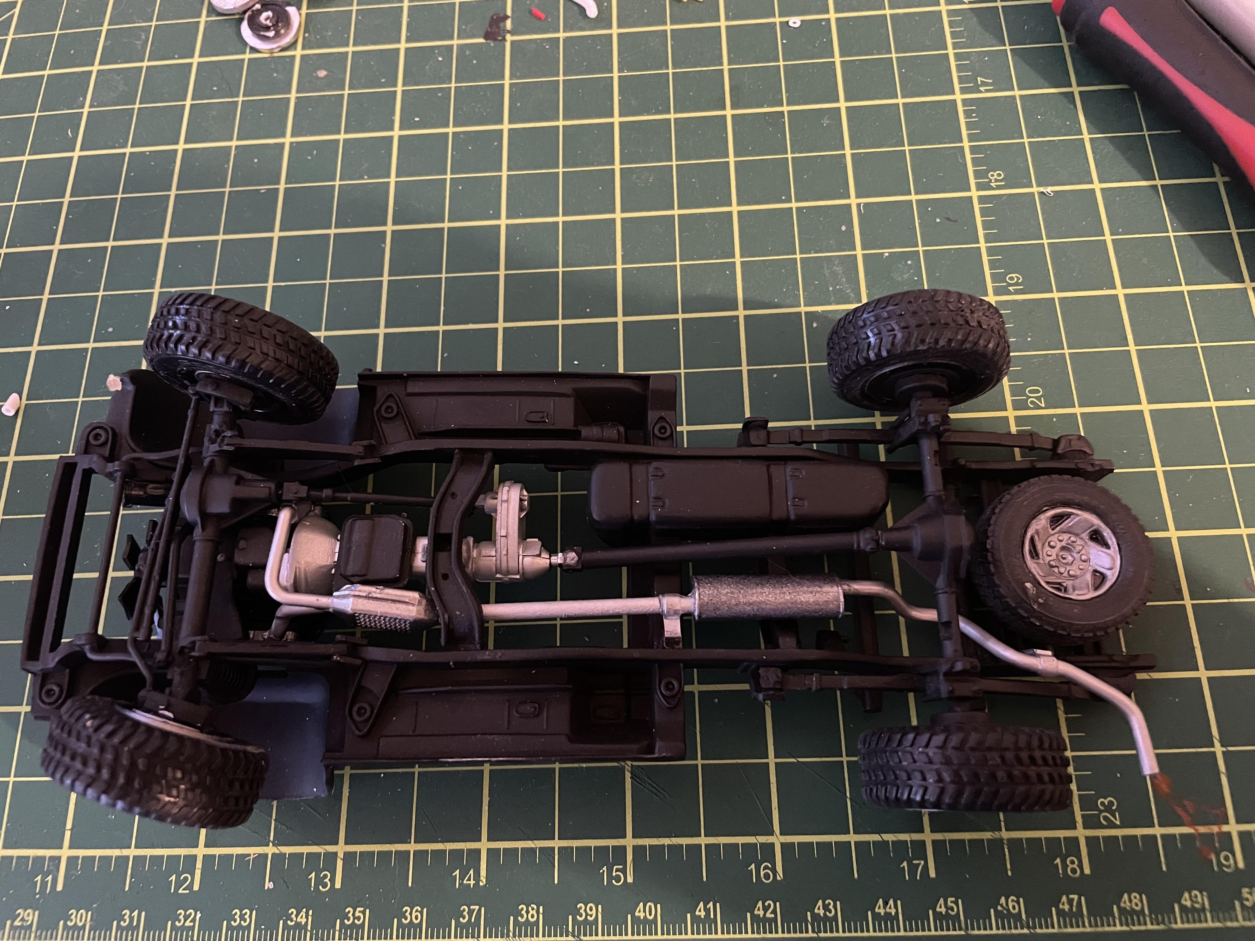

Here is the completed chassis assembly as well as the stance with the body in place. As for color, as you can see on the inner fenders i plan to go with a white body (the red is from my first iteration of the kit). The wheels and tires are from a diecast version of the Ram Sport that I have. In the last pic, you can see how well the engine fits in the engine bay!
