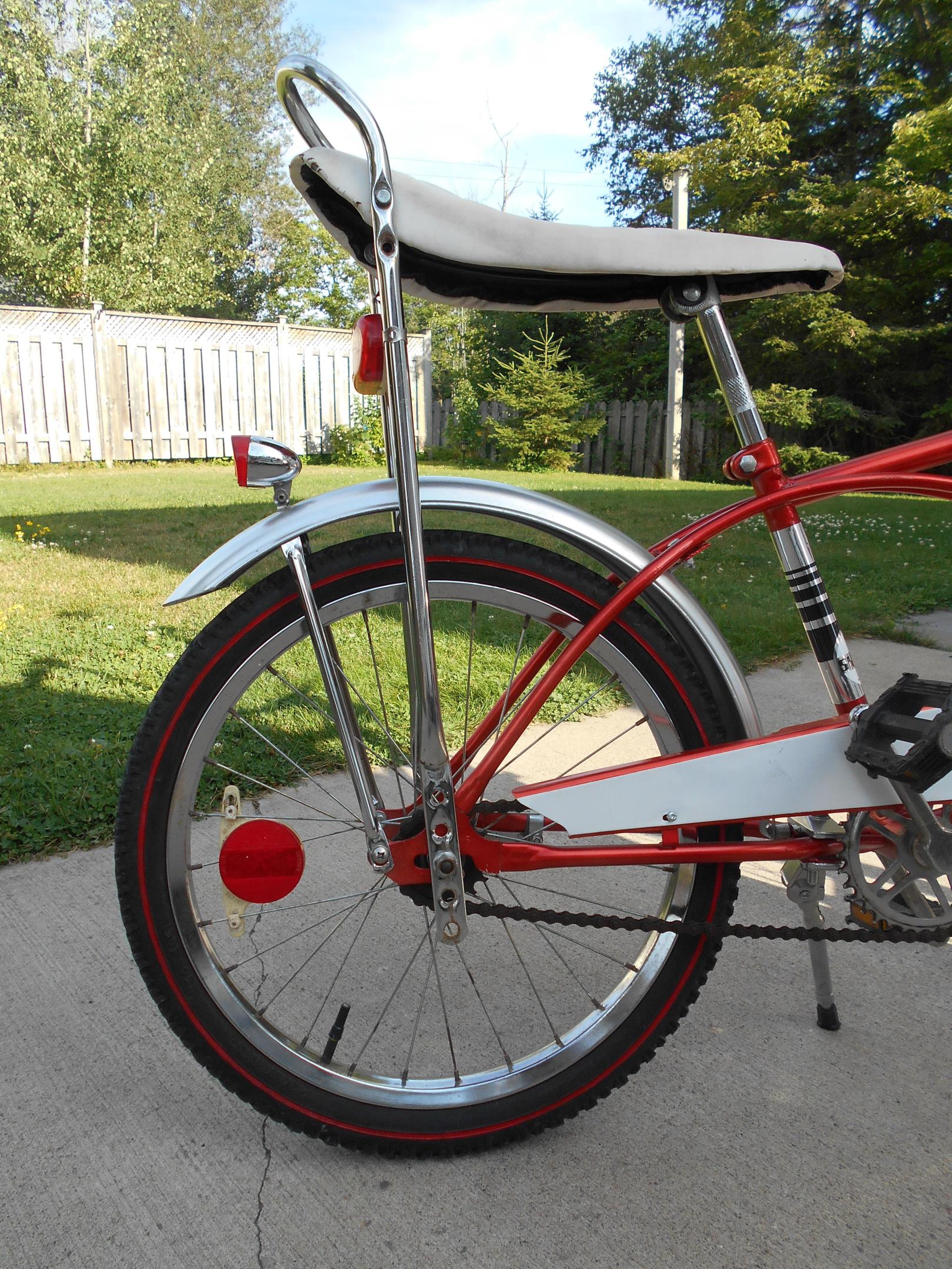

Falcon Ranchero Posted August 16, 2024 Posted August 16, 2024 I am never sure if painting tires is a good idea or not. Yesterday I painted a redline on the back tire of my circa 1971 Skyline bicycle, and it seems to be holding up nicely; there was a stamped moulding on the tire so I was able to do it neatly. It is mildly tacky and drying good. But I attempted white walls on another bike once, and after a day the paint turned pink and then peeled. In terms of car tires, I wouldn't have ever thought of it, but at a recent car show there was a '49 or '50 Meteor that had painted-on white walls, and I didn't know if that was a good idea or not. What do you guys think? 3

Falcon Ranchero Posted August 17, 2024 Author Posted August 17, 2024 17 hours ago, JollySipper said: What paint did you use for the white wall on your bike? The reason I ask is DupliColor makes a vinyl and fabric 'coating' for just such things........ They also make an adhesion promoter that goes on clear, it's kinda like primer for the vinyl paint. You would also need to make sure the tire is CLEAN before you paint it......... It was at least 3 years ago I did the whitewall bike tire, but it may have been tremclad; not the best choice for rubber, I realized that after I spent an hour painting both sides. But for the redline I used some other paint; don’t have the can with me but I know the factory that makes the paint blew up or something so you can’t get it anymore, but it seems to be working so far. 1
