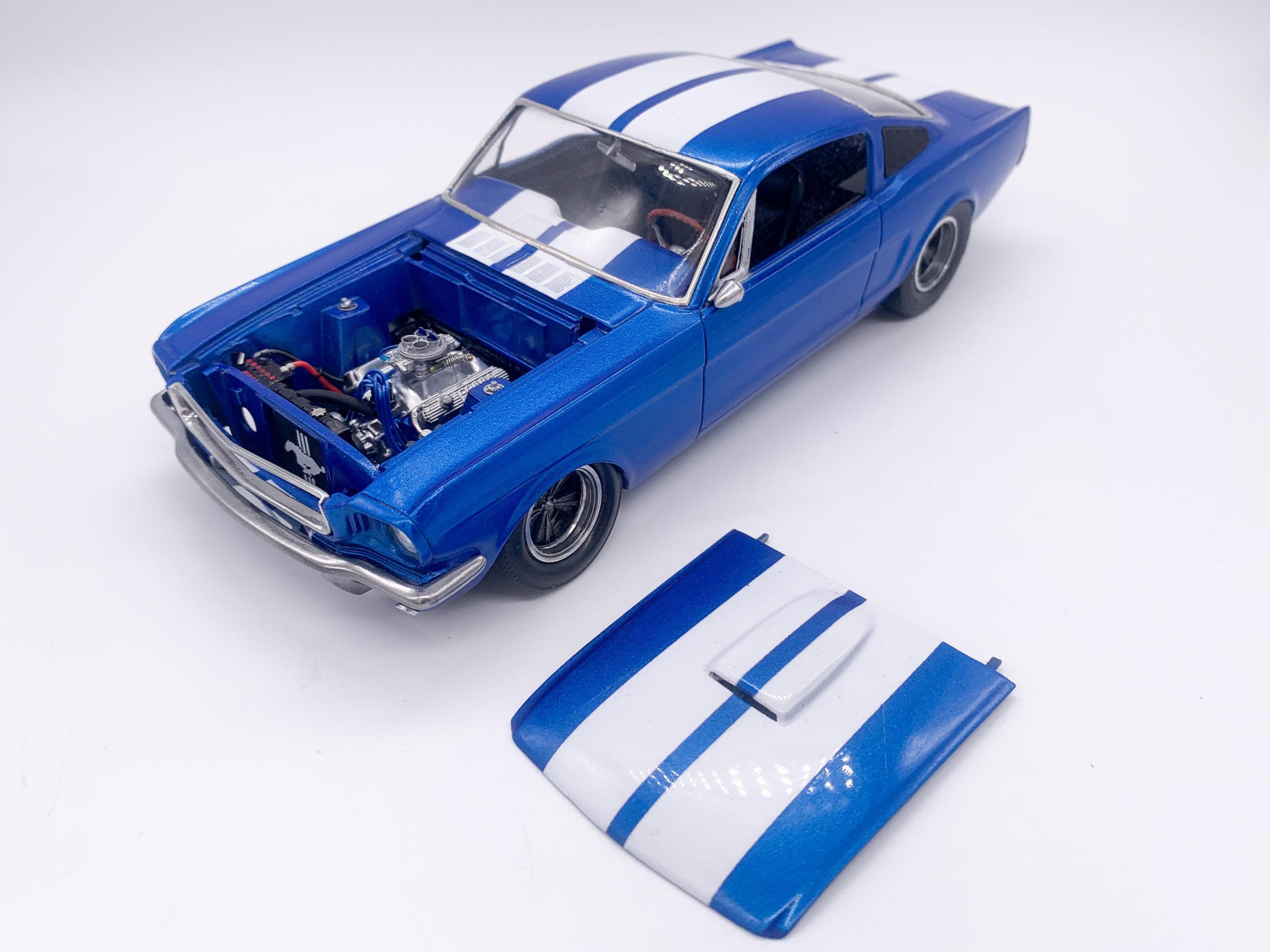

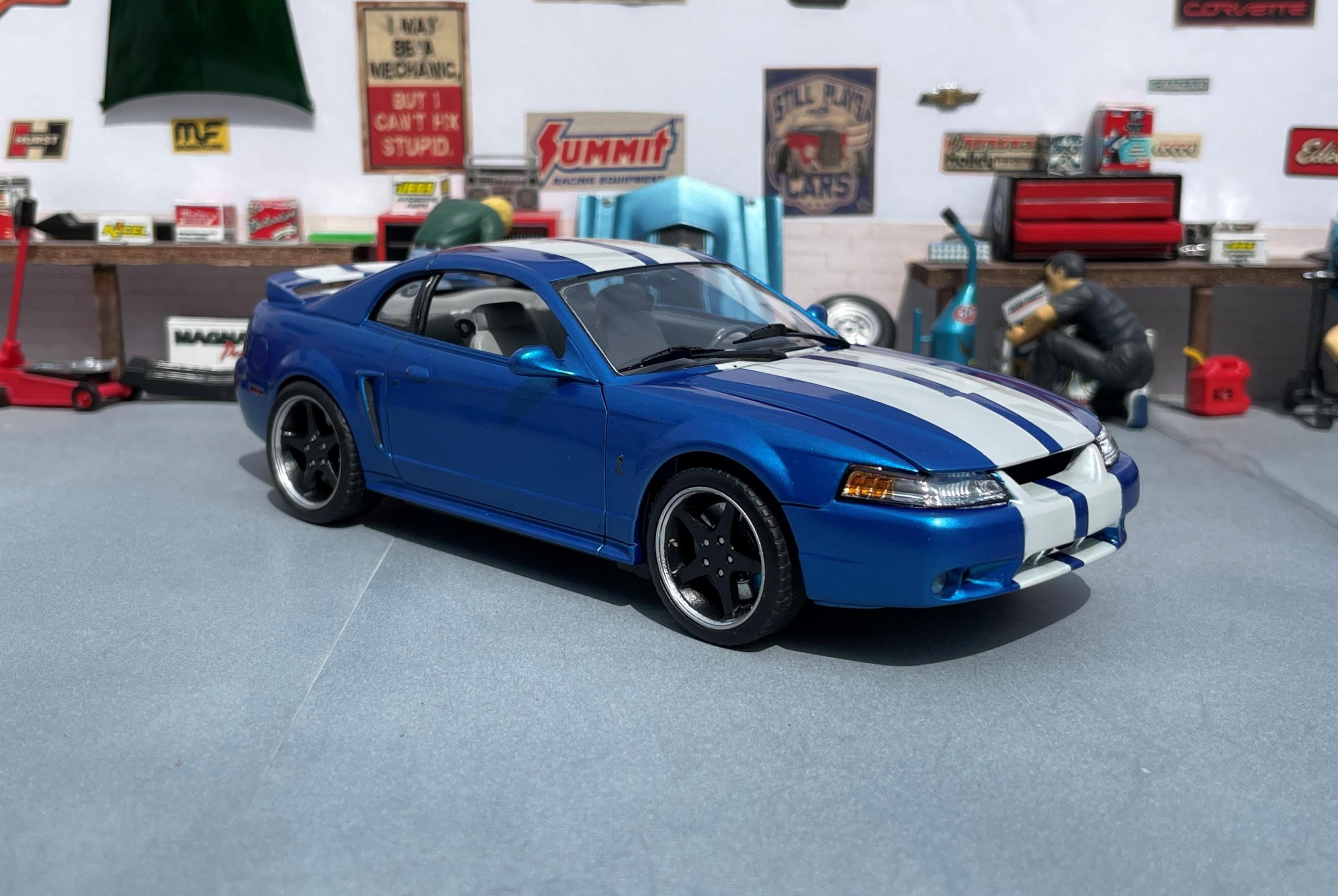

OldNYJim Posted August 20, 2024 Posted August 20, 2024 I’ve always found Createx easy to spray, infinitely mixable and almost foolproof to spray. Make sure to use primer, and thin with their thinner if you need to. Once you get the feel for them, they’re pretty easy to work with… Some projects painted with Createx, and cleared with either enamel or Rustoleum clear: 3 2

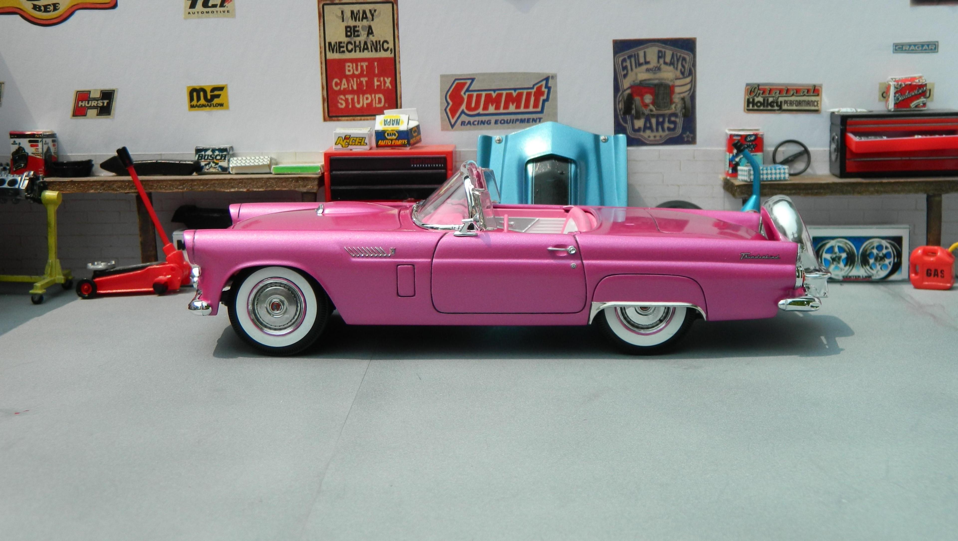

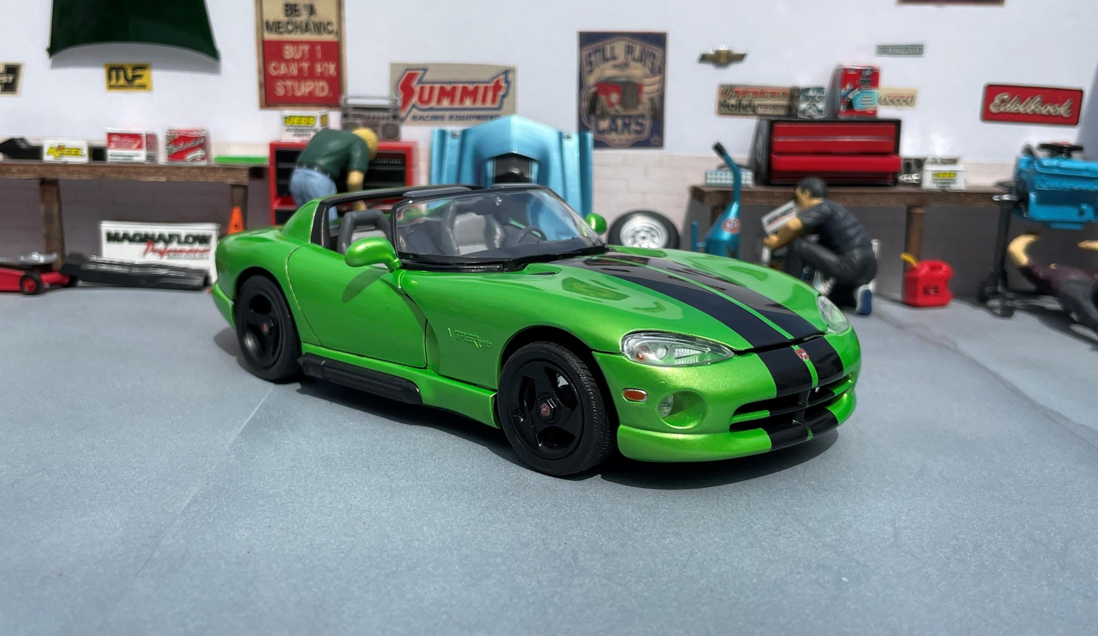

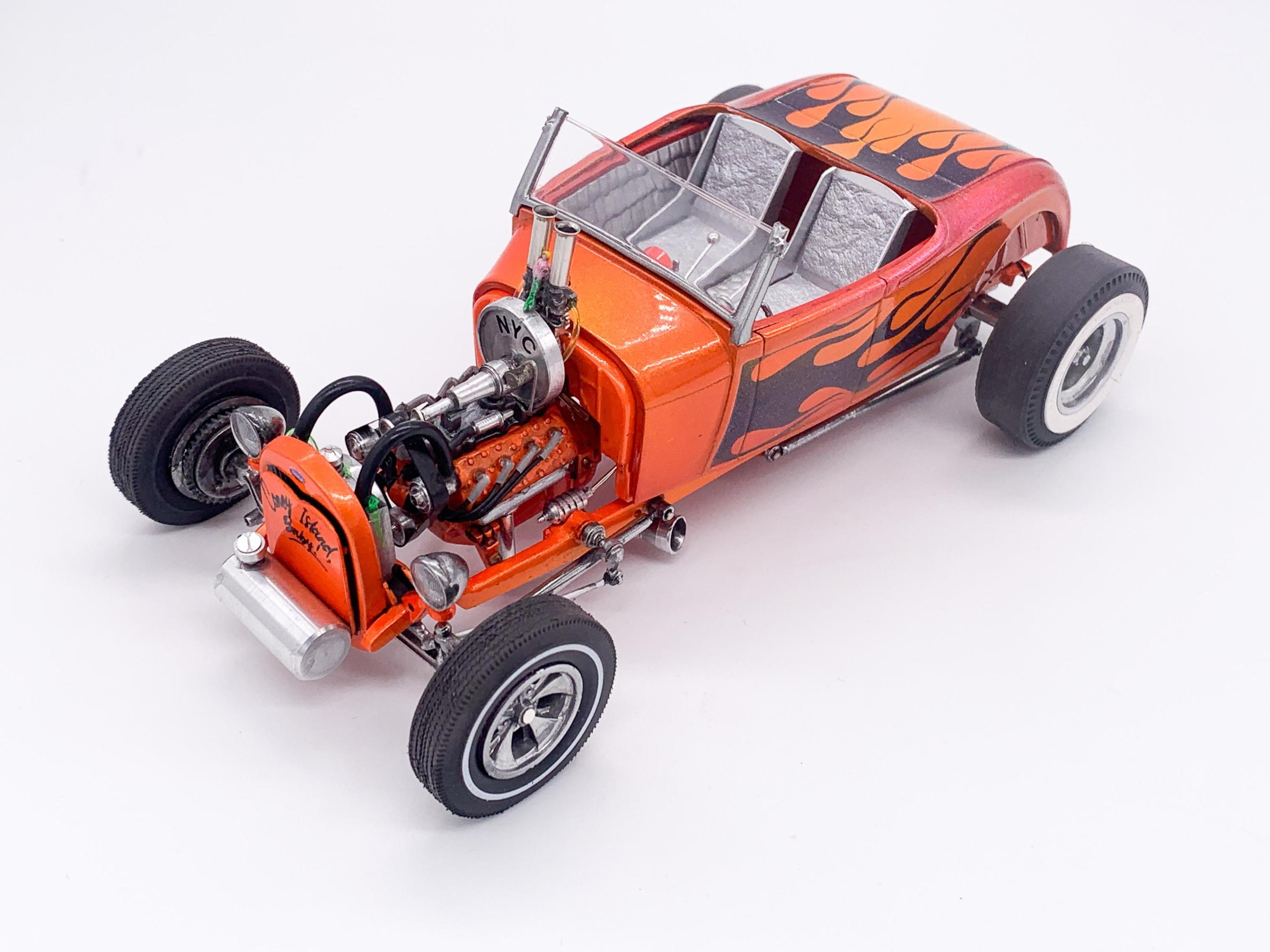

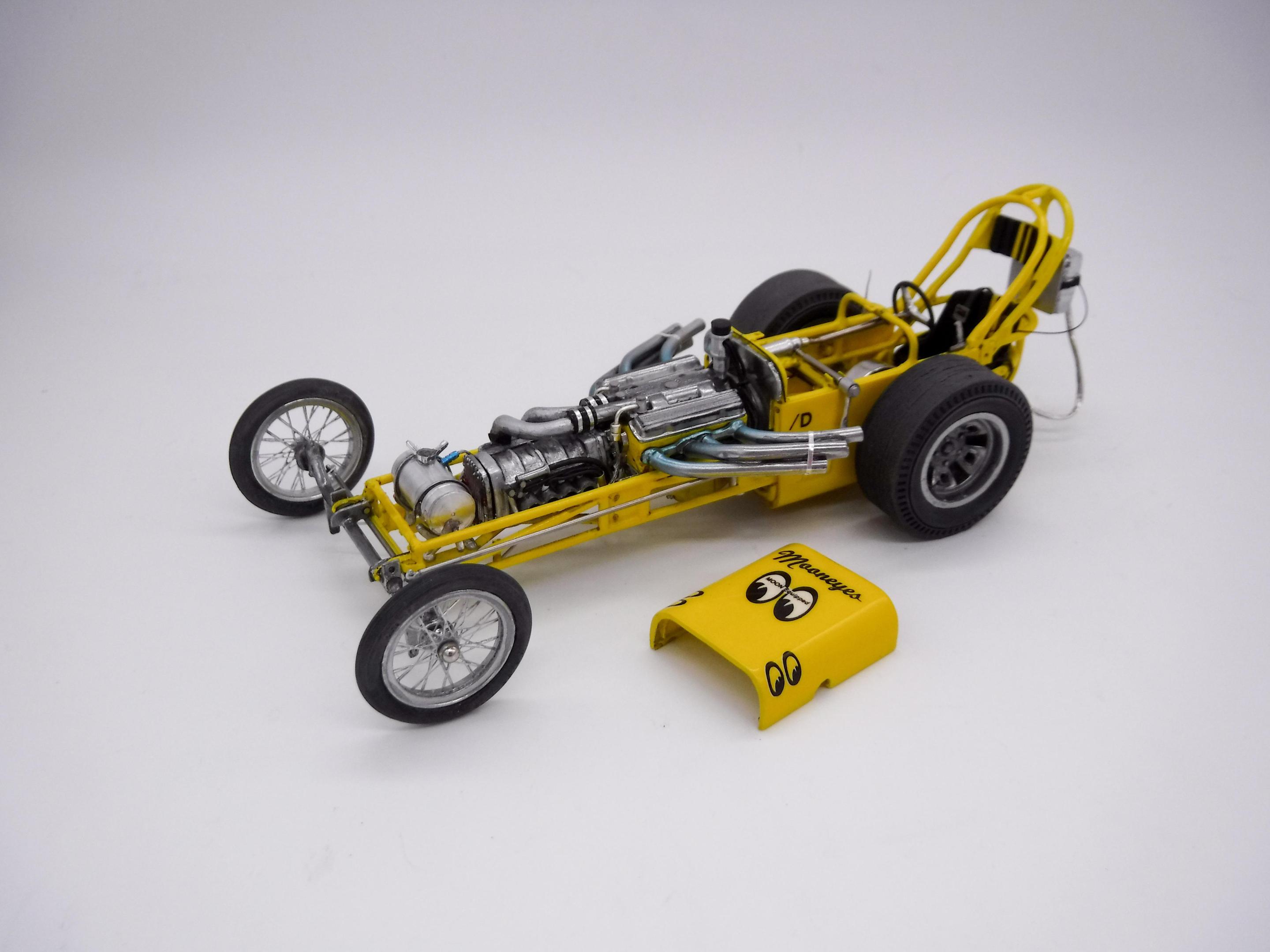

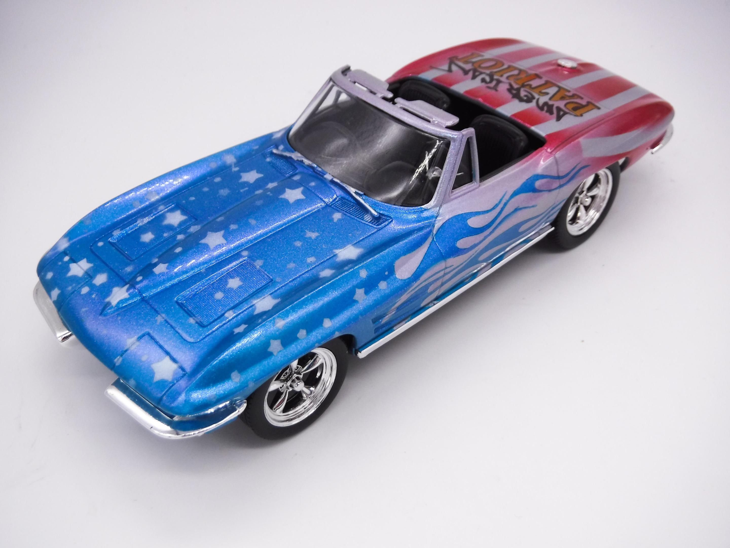

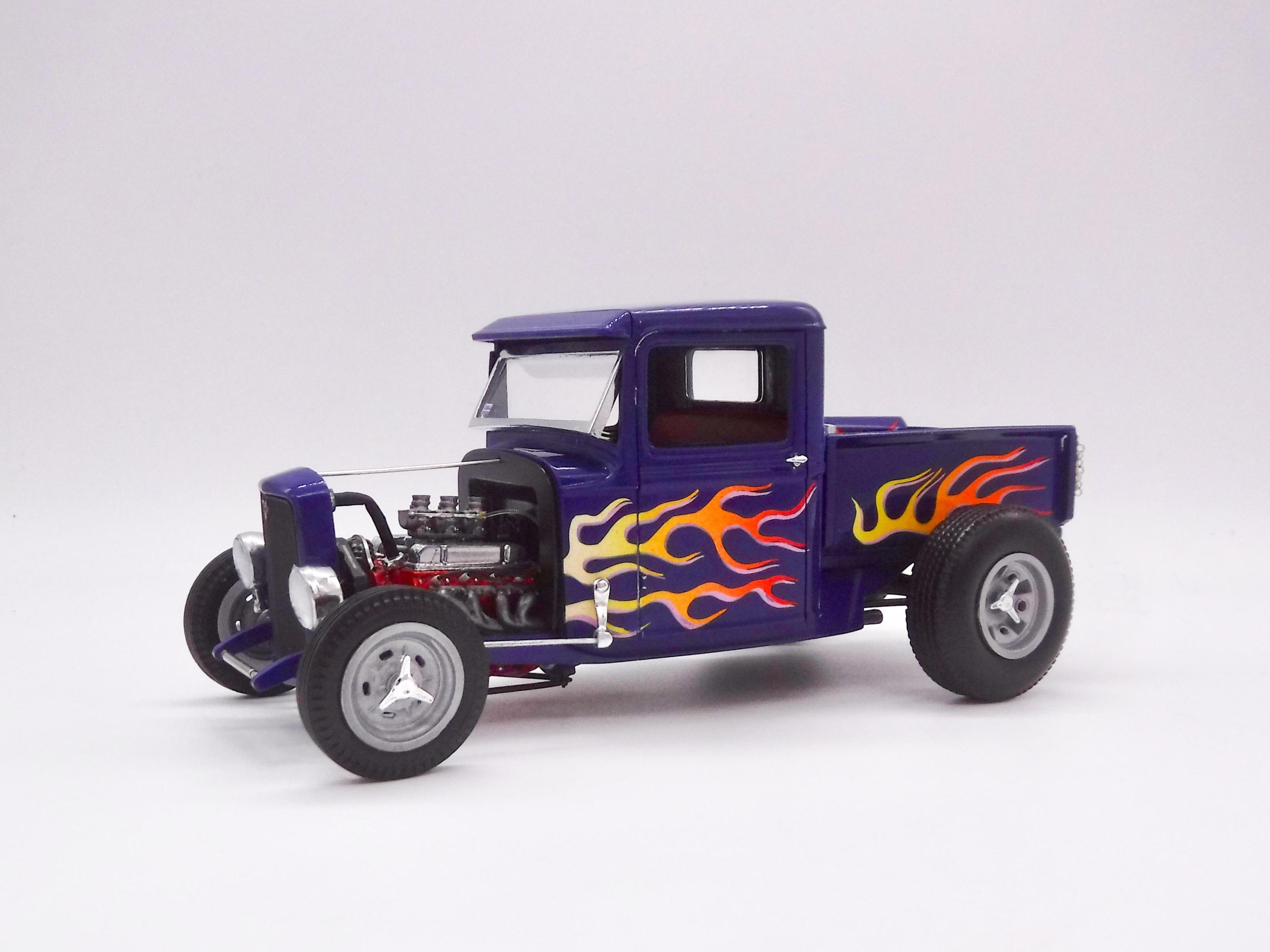

Dragonhawk1066 Posted August 20, 2024 Posted August 20, 2024 I love using Createx paints. There is a bit of a learning curve to get the right consistency for your particular airbrush, but once you're there it flows and dries very nicely. I do recommend using their products for mixing and thinning for better results, at least at first. Lots of great info on their website. As the others have said, definitely use a primer underneath. Using different base colors (metallic silver, metallic gray, and metallic black) will also slightly change the hue of the pearls and metallics. The Viper is a mix of Pearl Lime and Pearl Green, the others are straight colors. 4 1
TransAmMike Posted August 21, 2024 Posted August 21, 2024 1 hour ago, Dragonhawk1066 said: I love using Createx paints. There is a bit of a learning curve to get the right consistency for your particular airbrush, but once you're there it flows and dries very nicely. I do recommend using their products for mixing and thinning for better results, at least at first. Lots of great info on their website. As the others have said, definitely use a primer underneath. Using different base colors (metallic silver, metallic gray, and metallic black) will also slightly change the hue of the pearls and metallics. The Viper is a mix of Pearl Lime and Pearl Green, the others are straight colors. Oh yeah Craig, those are awesome paint jobs. Which paint (i'm assuming the pearl) and color is the T-bird??
Dave G. Posted August 21, 2024 Posted August 21, 2024 13 hours ago, fiatboy said: Hi Dave G. Are you talking about heating the paint before you airbrush, or the surface of the plastic after you paint? Thanks. I flash dry each coat with the hair dryer. I learned this using Createx on T shirts but with a heat press. Then I saw a fishing lure maker who used the heat gun on his lure painting with Createx paints, at each coat, to fully flash dry. His results were awesome, so I incorporated that into model building. Also, the first two coats are very fine mist coats. You can barely see them on the primer. But it's the foundation for later wetter coats. No runs. So, I put down a faint mist coat of color, then flash dry with the hair dryer on medium. Then a second. The second coat you begin to see color, heat set it. Subsequent coats are wetter and wetter, each one heat set. The paint flashes off very quickly so it's not a big deal to perform.
Dragonhawk1066 Posted August 21, 2024 Posted August 21, 2024 21 hours ago, TransAmMike said: Oh yeah Craig, those are awesome paint jobs. Which paint (i'm assuming the pearl) and color is the T-bird?? Thanks Mike! The T-bird is their Pearl Magenta.
TransAmMike Posted August 22, 2024 Posted August 22, 2024 Well its sure is a pretty and unusual color. 1
Dave G. Posted August 22, 2024 Posted August 22, 2024 8 hours ago, TransAmMike said: Well its sure is a pretty and unusual color. You can make pink pearl by using pearl white with a little of that magenta in it. I'm planning that on a T Bird build. Supposedly my wife wants to build it, it's her kit. We shall see. She already built a yellow 1960 Bird, so ya. I sprayed two 60 T Birds with Createx, one yellow, one blue. They were the little 1/32 AMT curb side kits.

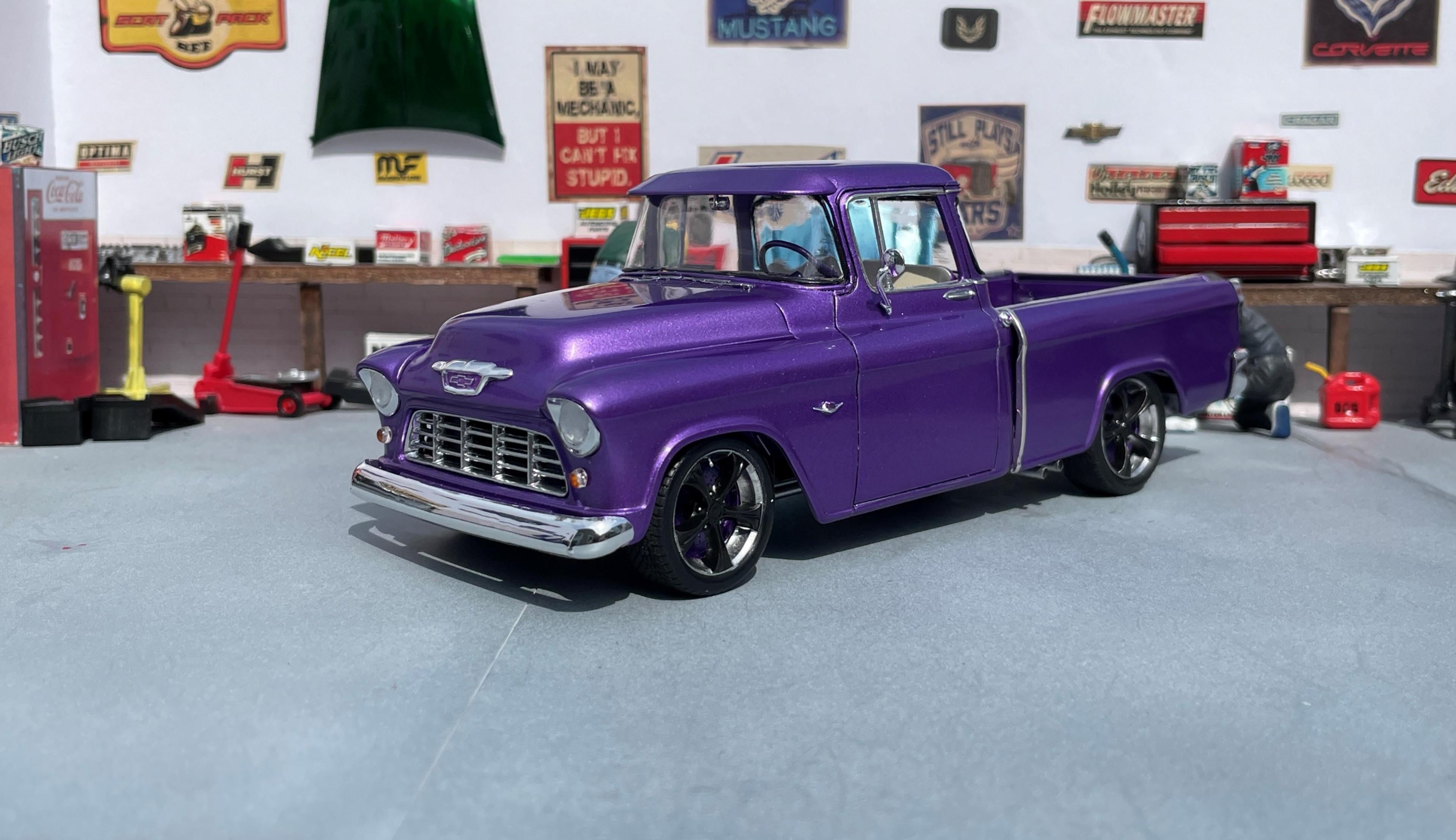

DJMar Posted August 26, 2024 Posted August 26, 2024 (edited) On 8/20/2024 at 4:16 PM, Dragonhawk1066 said: Not to hijack the thread, but that purple is mighty tasty! ? Edited August 26, 2024 by DJMar

Dragonhawk1066 Posted August 28, 2024 Posted August 28, 2024 On 8/26/2024 at 4:29 PM, DJMar said: Not to hijack the thread, but that purple is mighty tasty! ? Pearl Plum. It is a great color! 1
