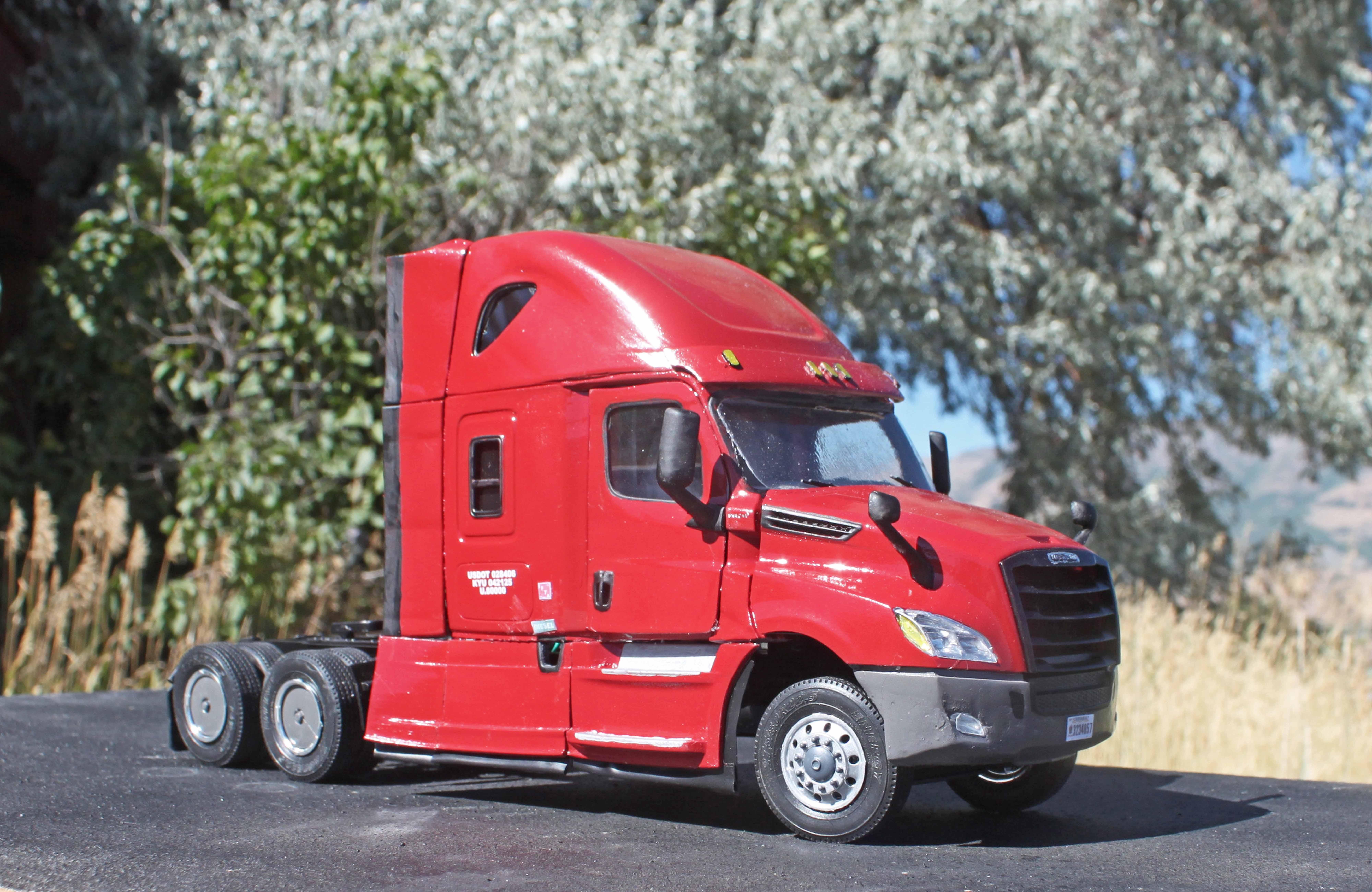

RoninUtah Posted August 21, 2024 Posted August 21, 2024 Well, in my last post about the International Highbinder, I hinted that my next build would be completely different… and this is it! Like many model truck builders, I lamented the fact that although Freighliner Cascadias represent at least 40% of the Class 8 trucks on the road (at least around here), none were available in 1/25 scale to build. In fact, except for the Moebius International Lone Star and Pro Star and the Italeri Volvo VN, there were no modern highway tractors for us at all. The rest of “Big Plastic” didn’t seem interested at all in coming out with anything new, content with regurgitating the same 70’s models they’ve been doing for years. I guess the cost of engineering, tooling, obtaining the proper licenses and gearing up for production are too scary for them to speculate on. Into the gap stepped 3D printing. In particular, the Cults 3D website, which has thousands of 3D designs by hundreds of members. It has just about every modern truck there is available for downloading and printing, of varying degrees of accuracy and quality. This build is from a 3D model by Cults 3D member “Alfa Centauri,” who has several accurately detailed and well-designed 3D models for a nominal price to download. I don't do my own printing, but I had been corresponding with Bren, a member here who does his own 3D printing, and Bren very generously offered to print the Cascadia for me. Maybe to make me shut up with my whining, I don’t know. But I deeply appreciate it! By the way, Bren has some very interesting and informative observations about 3D printing truck models on the “Truck Aftermarket/Resin/3D Printed” section of this site. It’s worth checking out. I decided to put this on an extra Moebius Lone Star Chassis I had lying around (doesn’t everybody?). I shortened the chassis to look correct with the Cascadia body, and reinforced it by epoxying brass rods to the frame rails. Resin is very heavy, the finished model weighs a little over a pound! The resin parts have thick sidewalls, due to being scaled to 1/25, so they required some grinding to fit. The edges of the doors in particular had to be ground down to a feather edge. The printing process resulted in some diagonal “streaks,” particularly on the upper cab and the bumper, which had to be ground and filled to the extent possible. The interior is minimal, consisting of a floor pan, seats and a (well detailed) dash and steering wheel combo. I supplemented those with cabinets from the Lone Star and a sleeper bunk from the parts box. The rest of the build was pretty straightforward, the parts fit together well and I added some parts box bits and improvised details. It’s a curbside model for now, but maybe I’ll get around to figuring out how to disguise the International Maxx Force engine (a POS in real life) as a Detroit DD-15. Or maybe I’ll just put a Cummins X-15 in it, which is actually a factory option for the Cascadia. There was no shortage of reference photos for this build! I designed it to be a typical present-day fleet truck, just like the hundreds of Cascadias you see every day on the highway. I based it on a C.R England tractor, but I don’t have the right decals and this truck isn’t to England’s specs anyway. But I wanted this to be typical for its type, so it’s kinda boring and plain-jane; definitely nothing you’d see entered into the Mid-America truck show. So, here it is, the elusive current Freighliner Cascadia in 1/25 scale. It was a challenging build, but I’m generally pleased with the results. And now I can stop whining! 4
