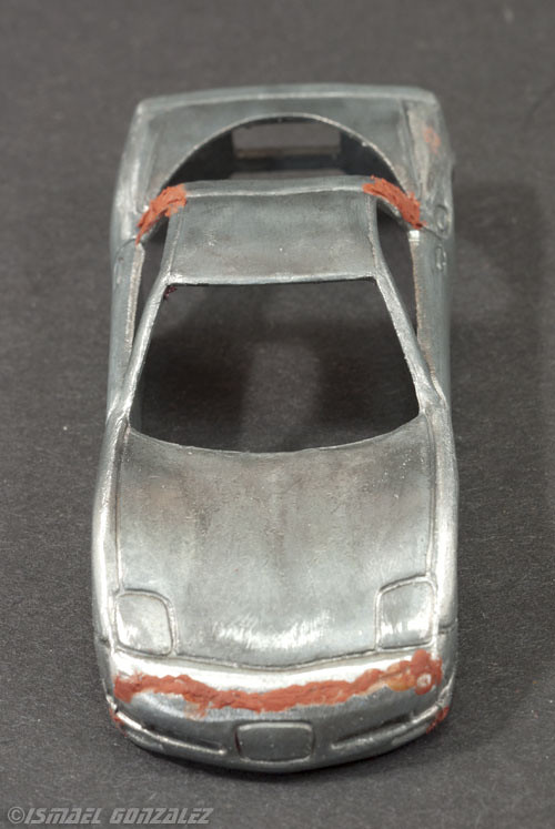

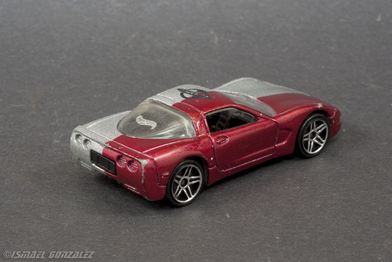

This is a 1/64 scale car which started life as a beaten up $1 Hot Wheels toy.

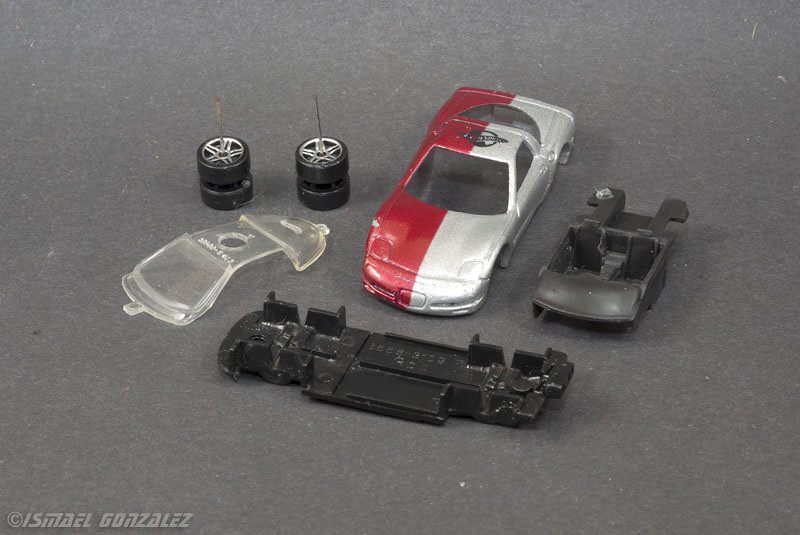

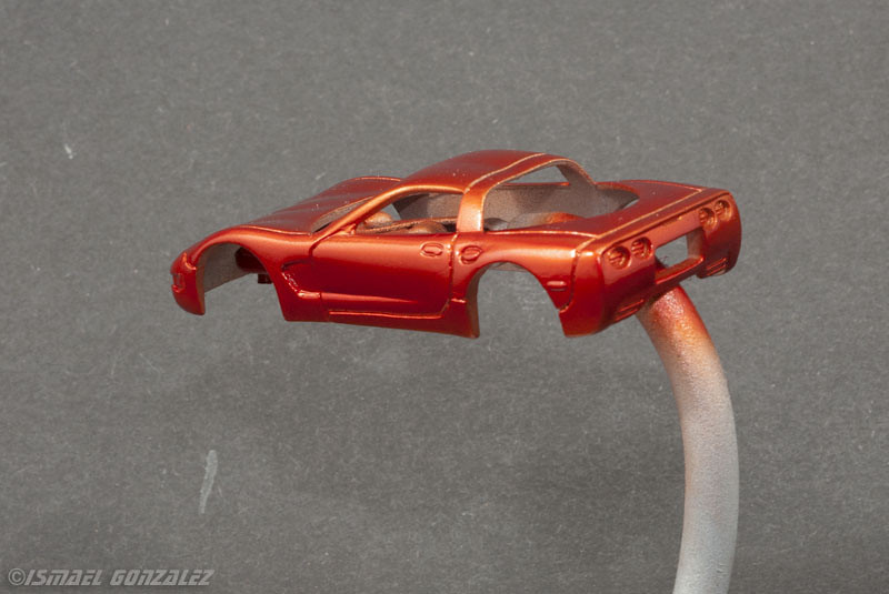

The body was stripped and bodywork was done with automotive filler.

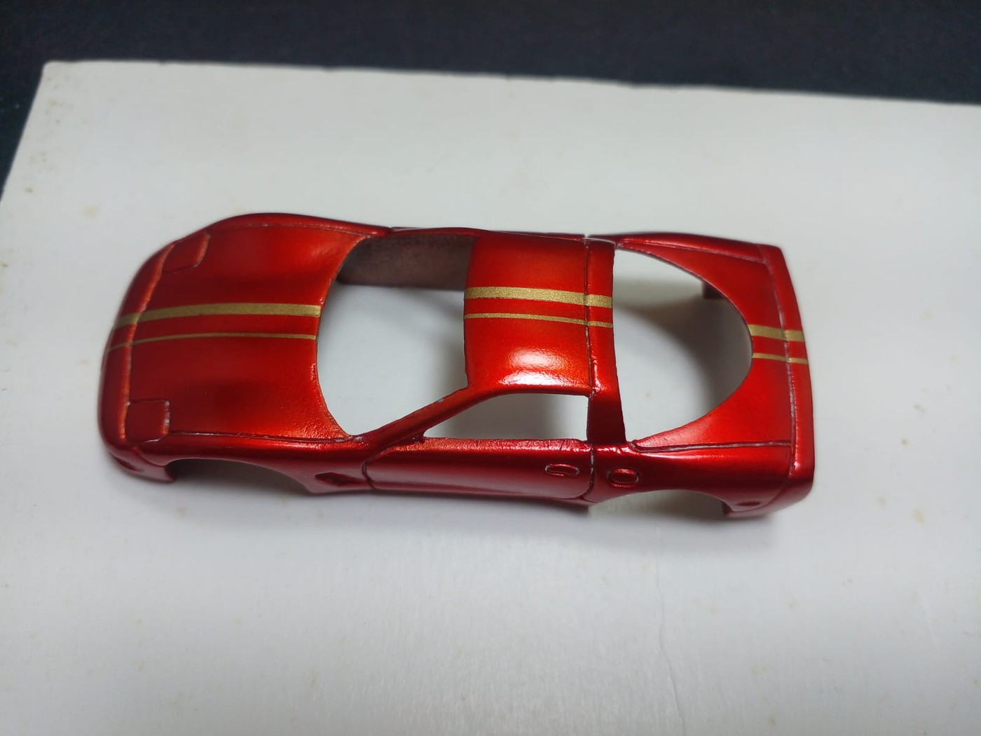

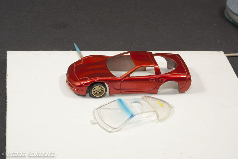

After bodywork was completed, a coat of primer was applied. Then it was painted aluminum enamel. The aluminum was sanded and recoated for a smooth finish. Hard to get in such a small scale. After it cured for a few weeks, I airbrushed about 3 million 2 hundred thousands coats of Tamiya Clear Red reduced about 20% with Tamiya X20A reducer. Seriously, I think there may be a dozen or more coats over many days (nights actually).
Tamiya Clear blue reduced about 10% with X20A was used on the Velocity airbrush again, this time to tint the windshield. The resin wheels were prepped and painted. The separate tires were also prepped and painted and eventually assembled.
At the last minute I cut some decal strips. After dry everything was sealed with Honey Gloss clear.
Let it dry for a few days before polishing the heck out of it.

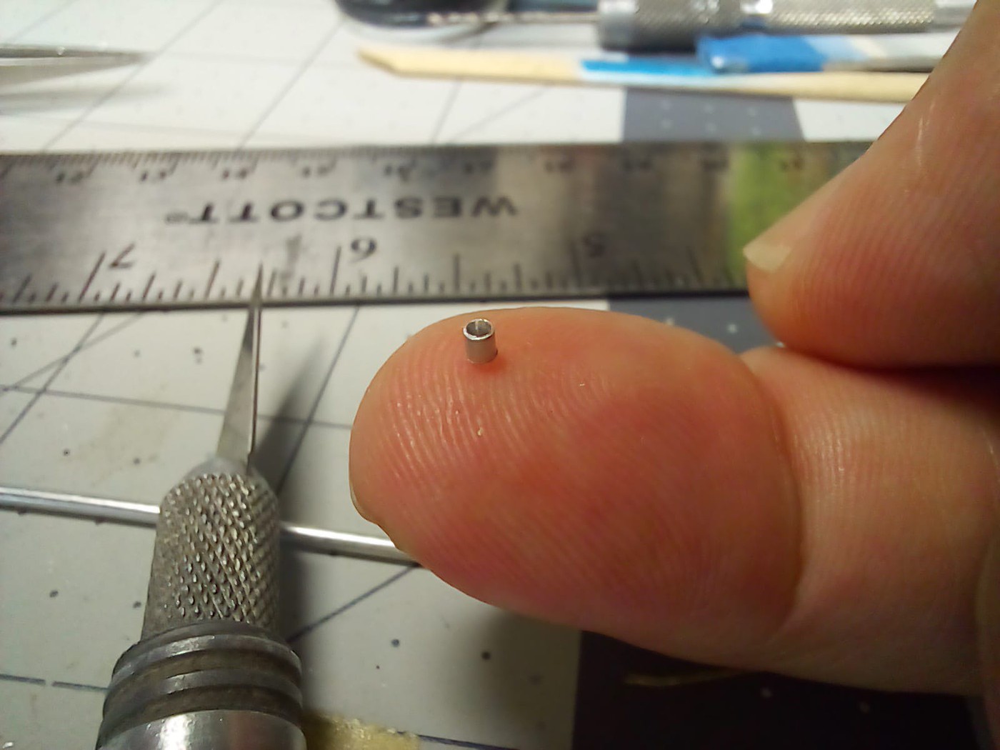

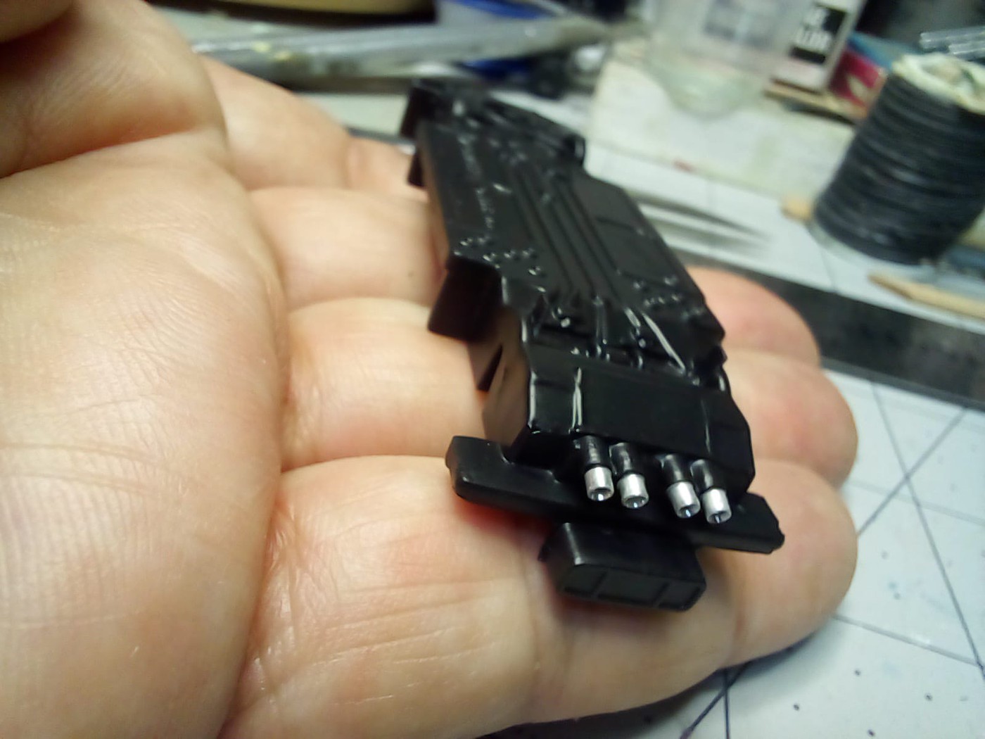

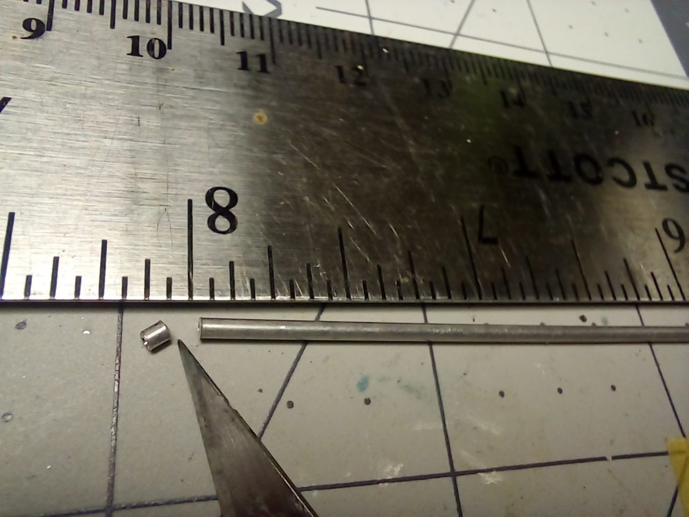

Exhaust tips were done with aluminum tubing cut to size and reamed. Had to make 6 as these have the tendency to fly away and disappear...

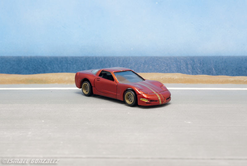

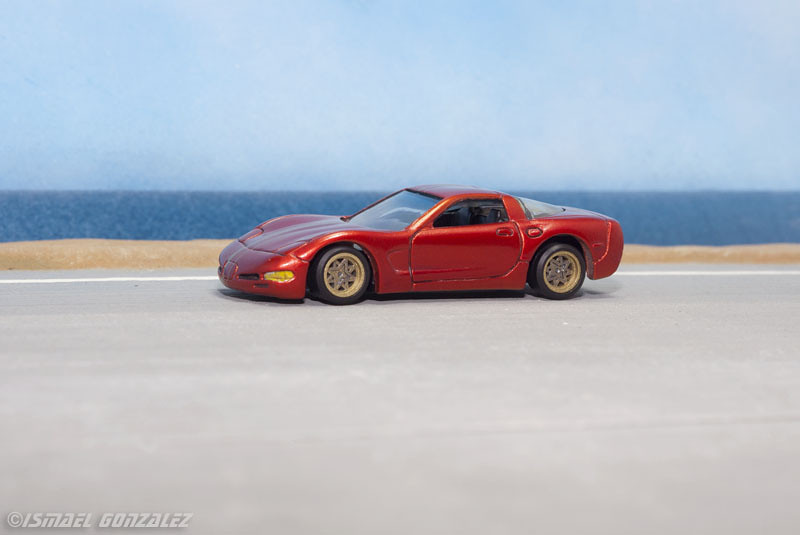

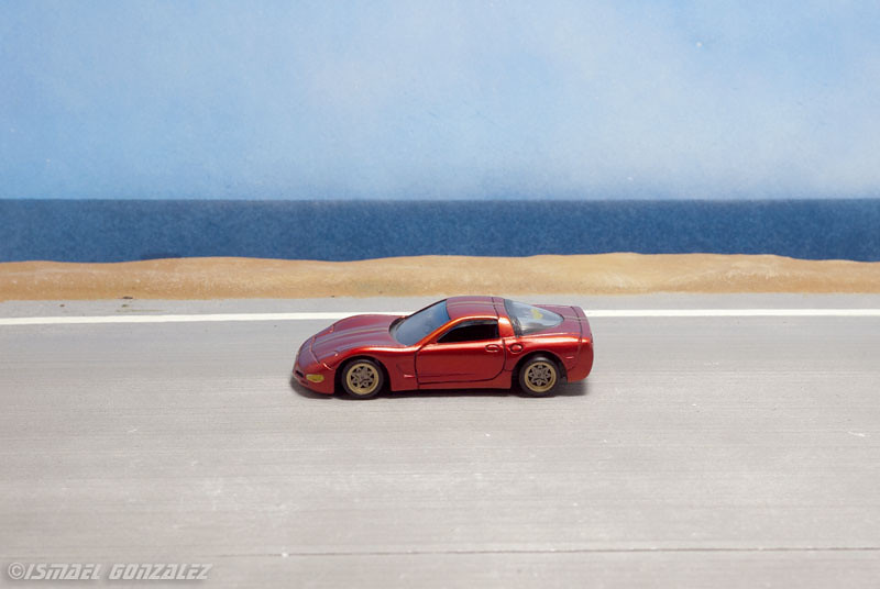

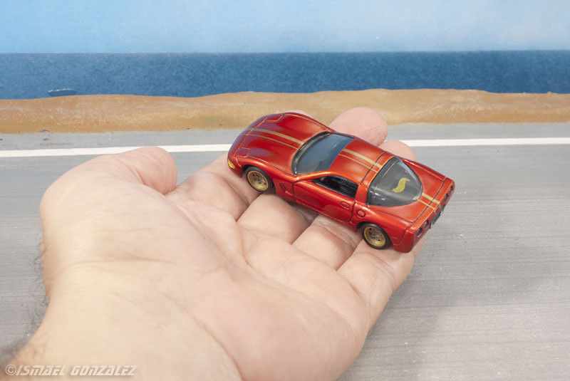

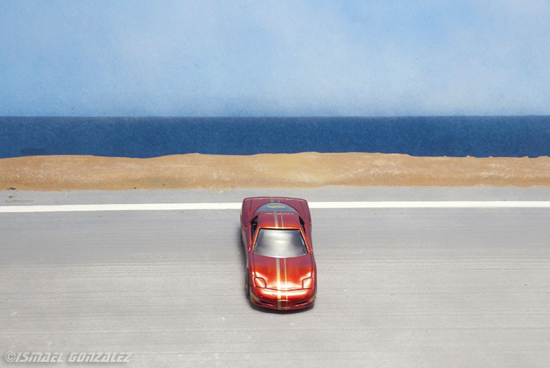

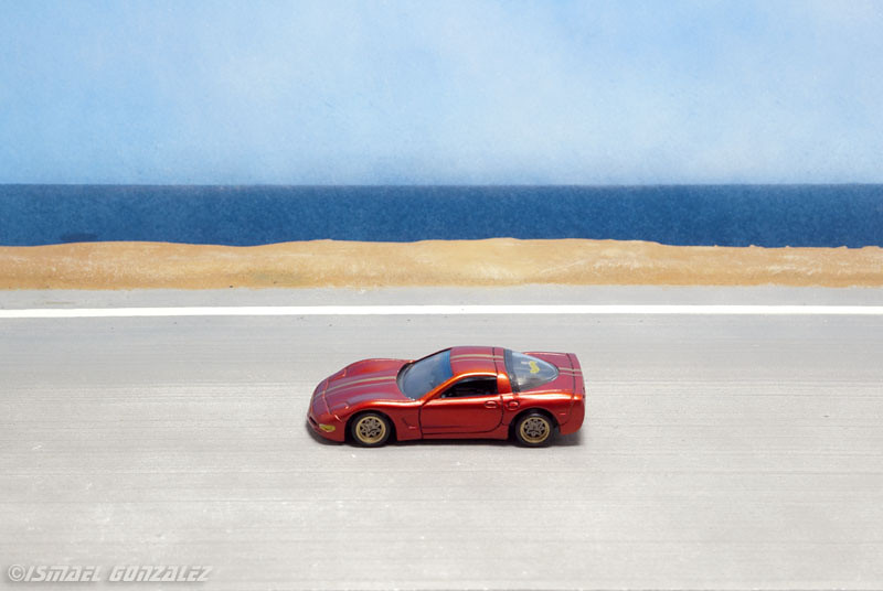

The end result:
This was just a fun experiment. Not an overly serious project.  But I am very happy with it.
