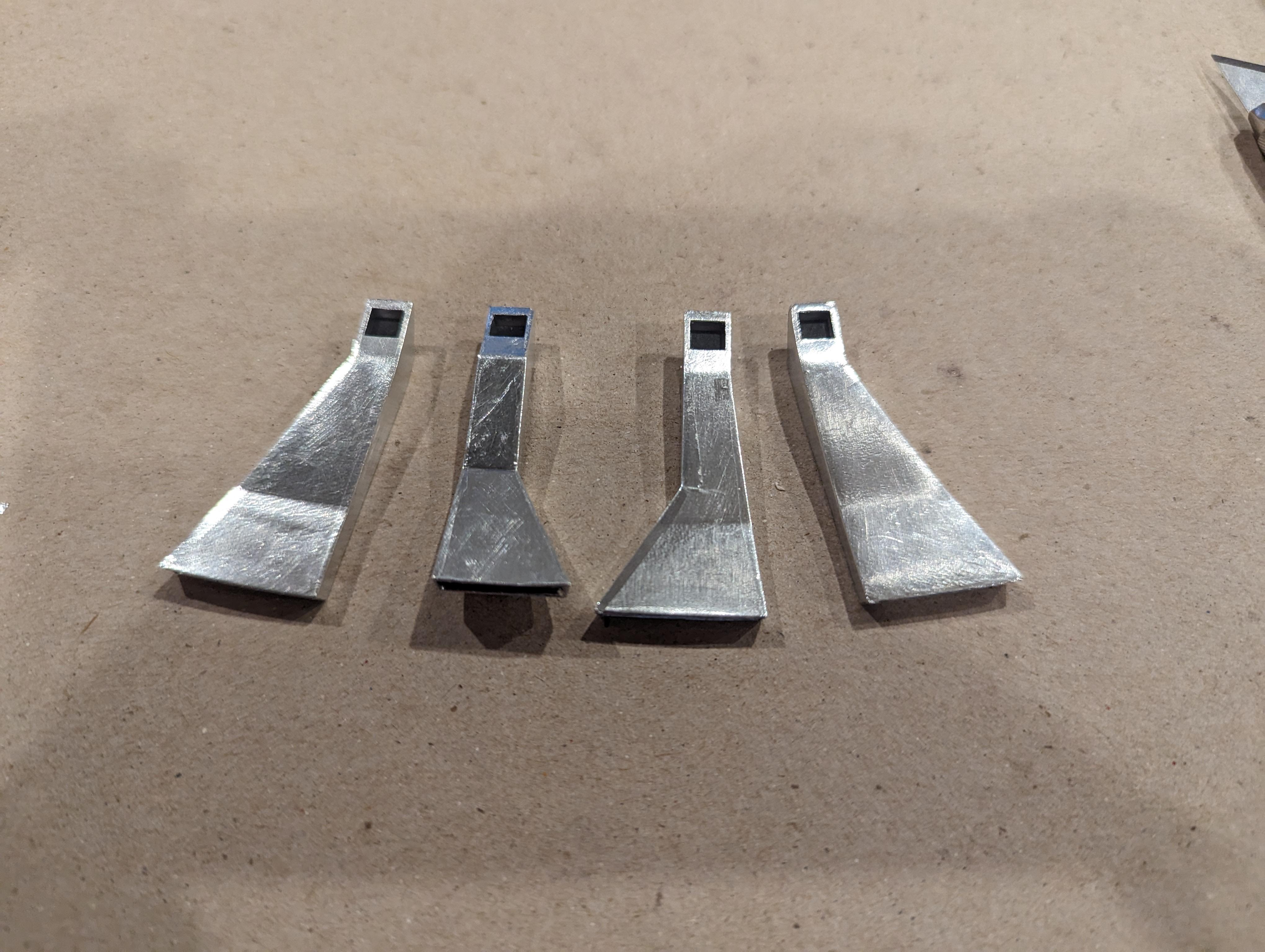

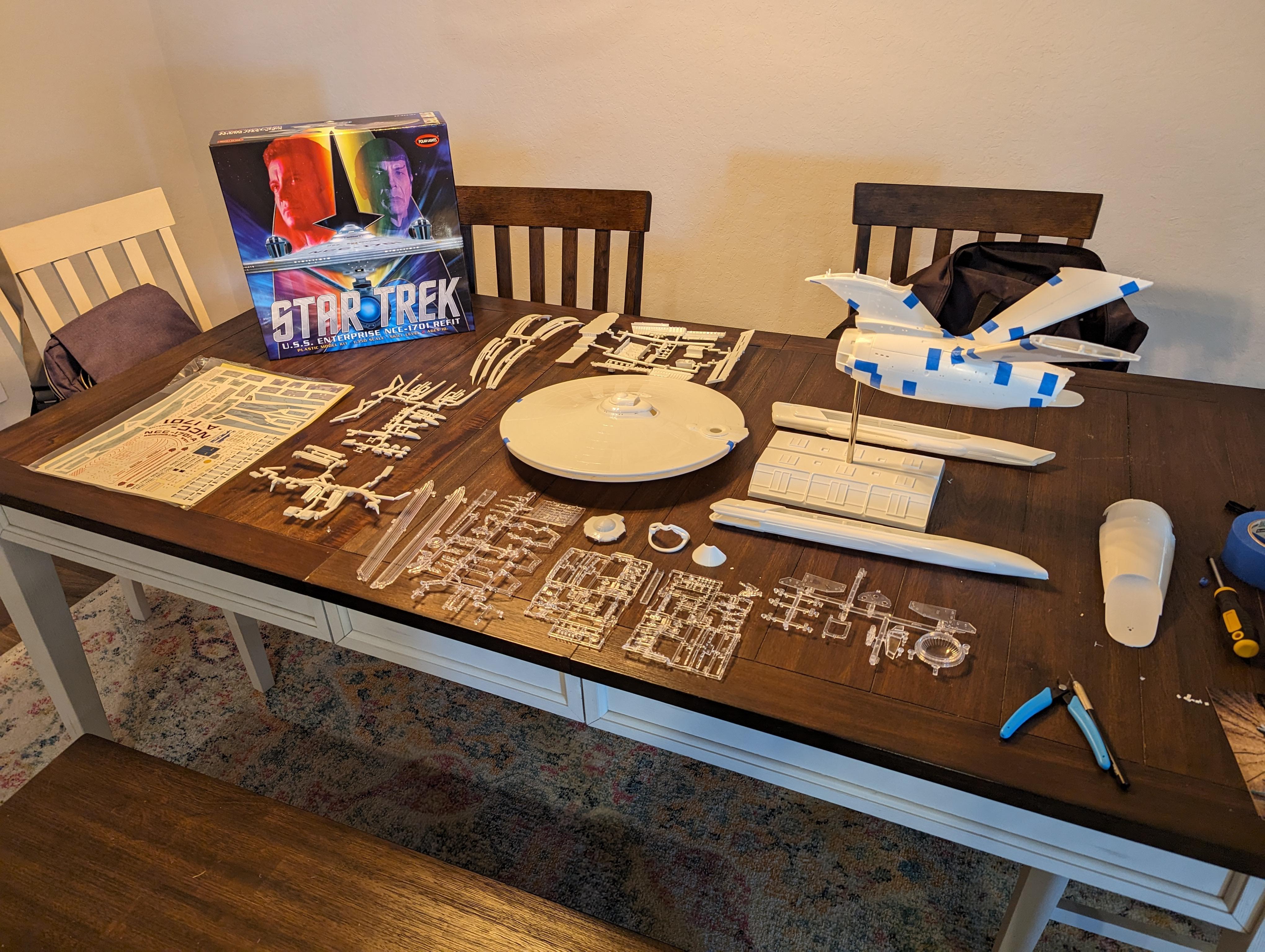

All of the parts arrayed and the primary and secondary hulls test fit before beginning the project in earnest. There is apparently a lot of variation in fit depending on when exactly individual kits were produced. Thankfully, I got a really good copy and there are very few fit issues.

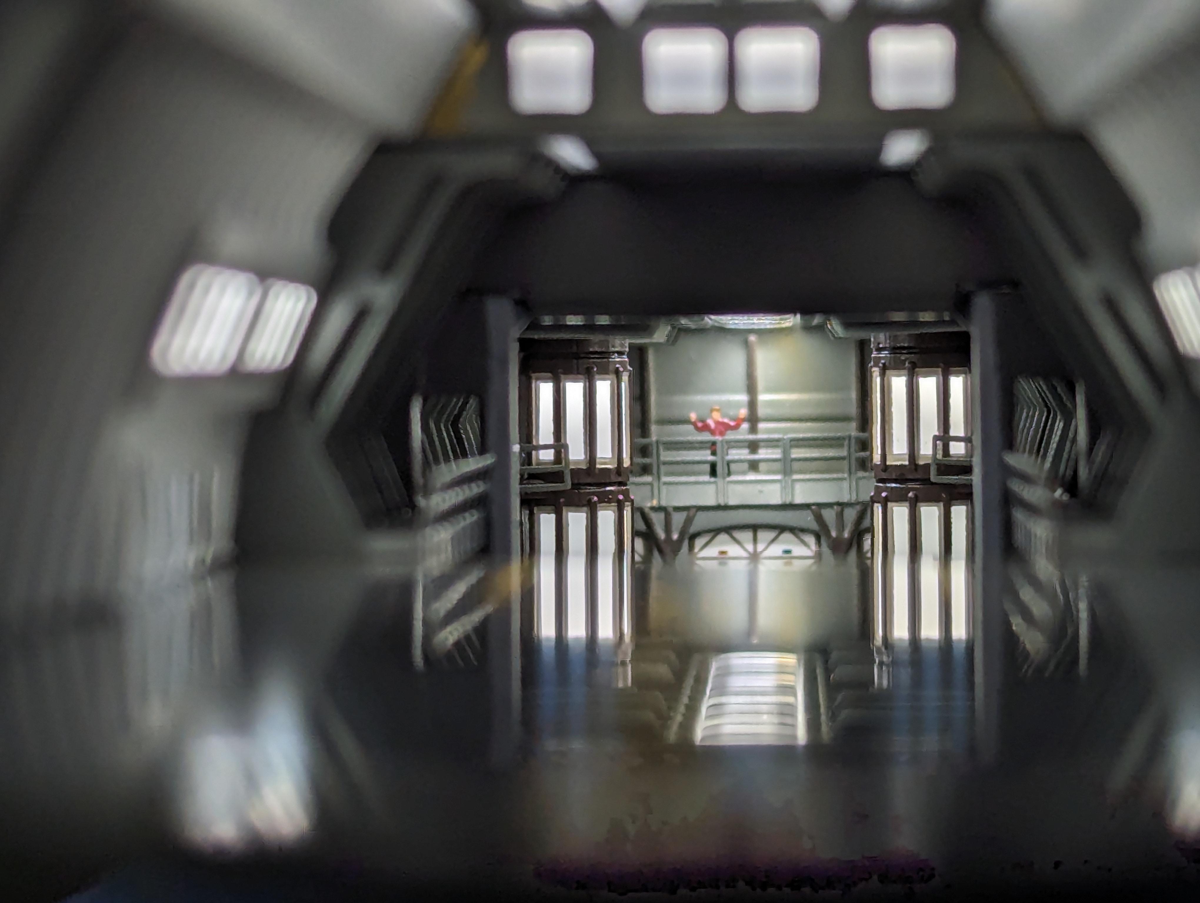

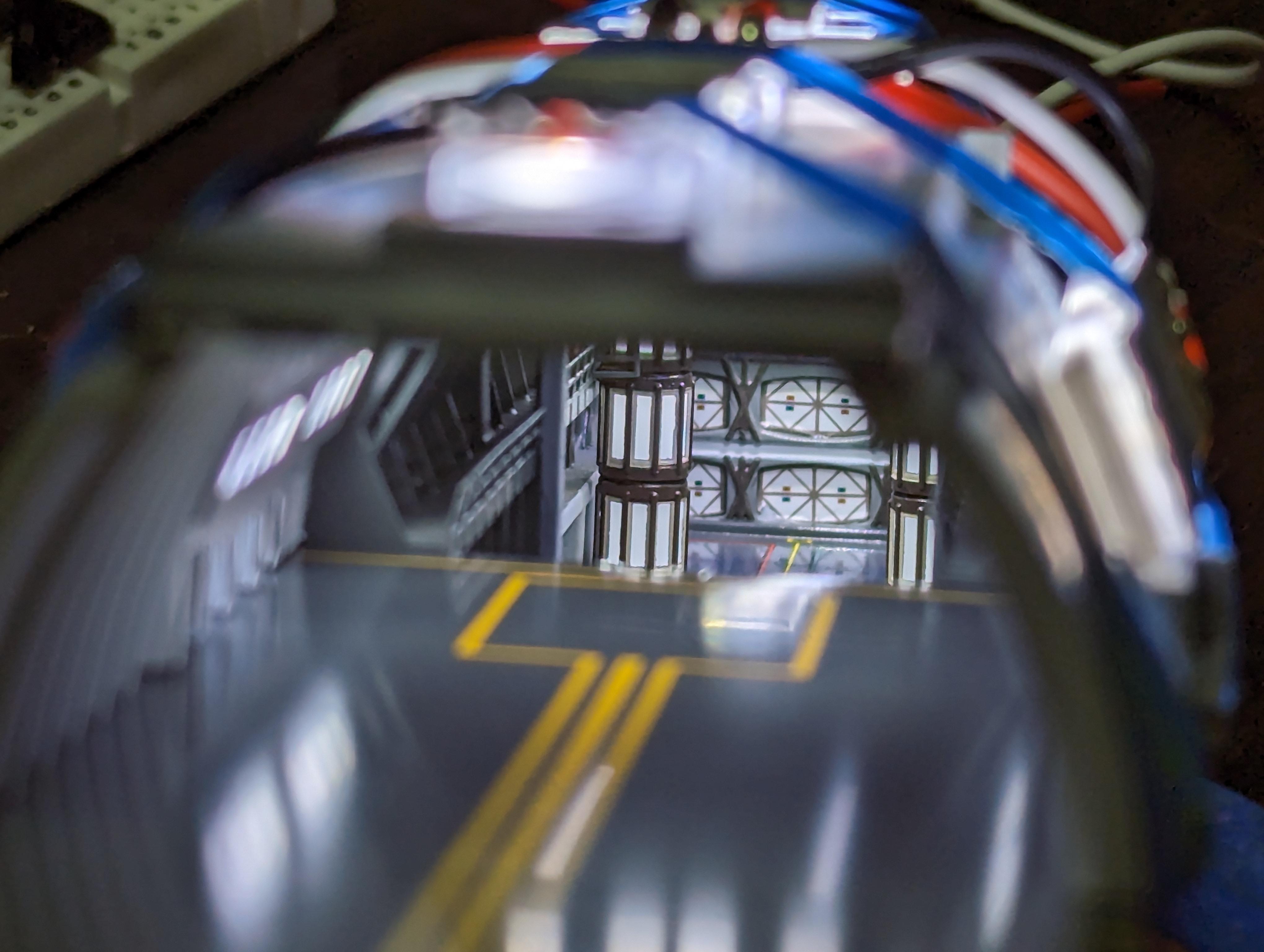

Shuttle bay assembly and lighting test.

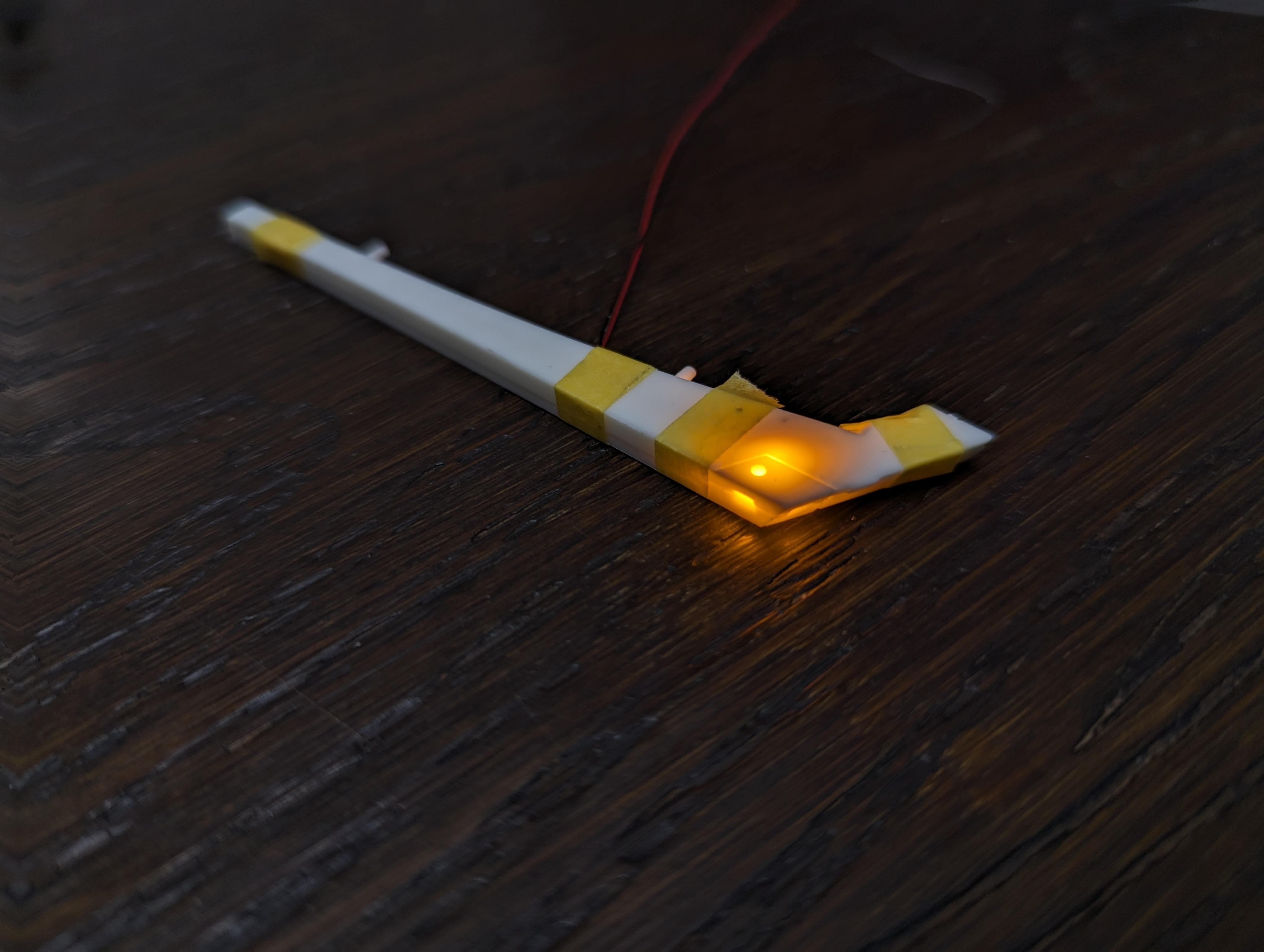

Light test of the 3D printed turbolift tubes for the shuttle bay.

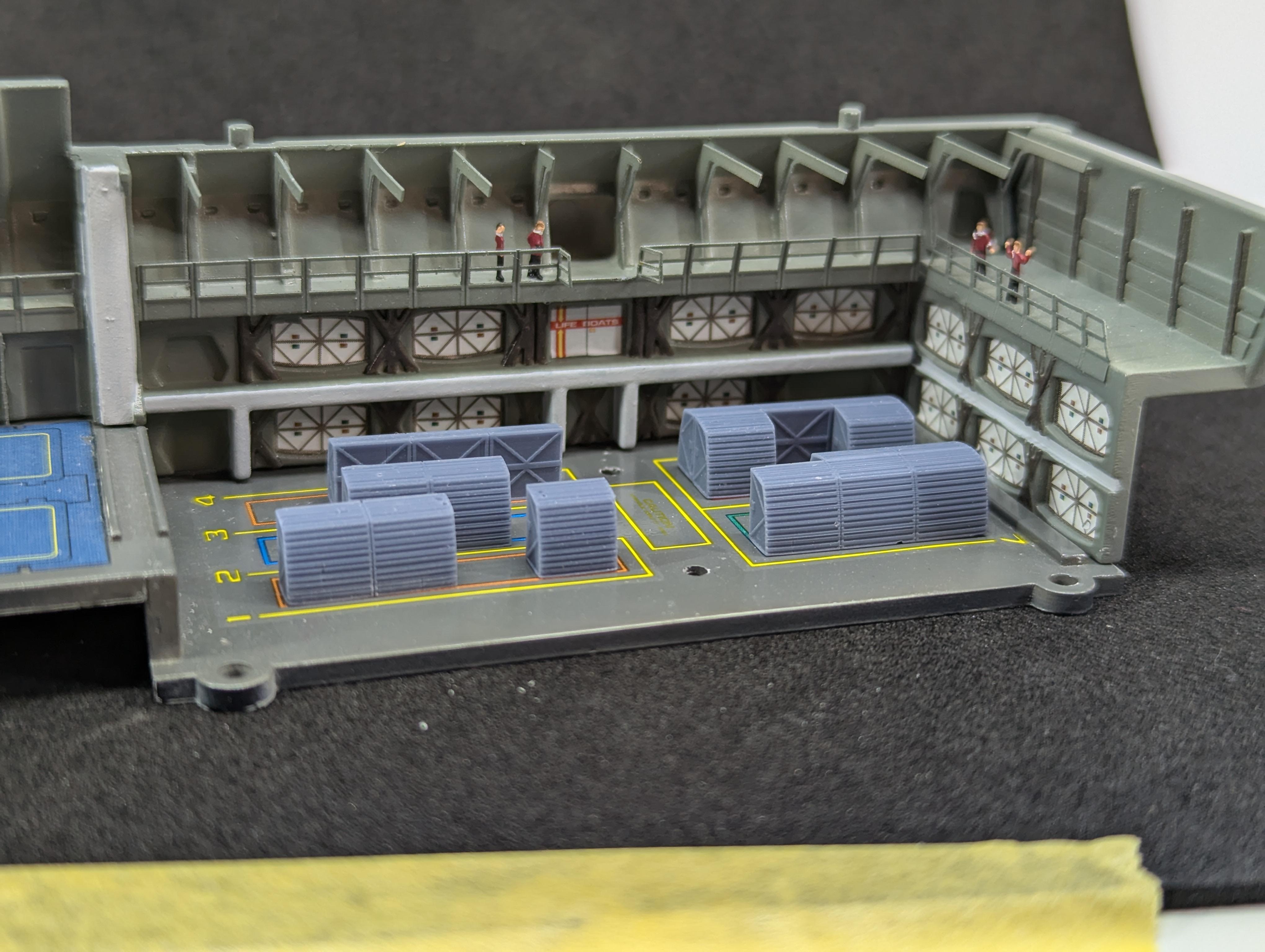

I also designed and printed some cargo containers. They still need to be cleaned up and painted, but they add some interest to the cargo bay floor. They'll be difficult to see, but I'll know they're there.

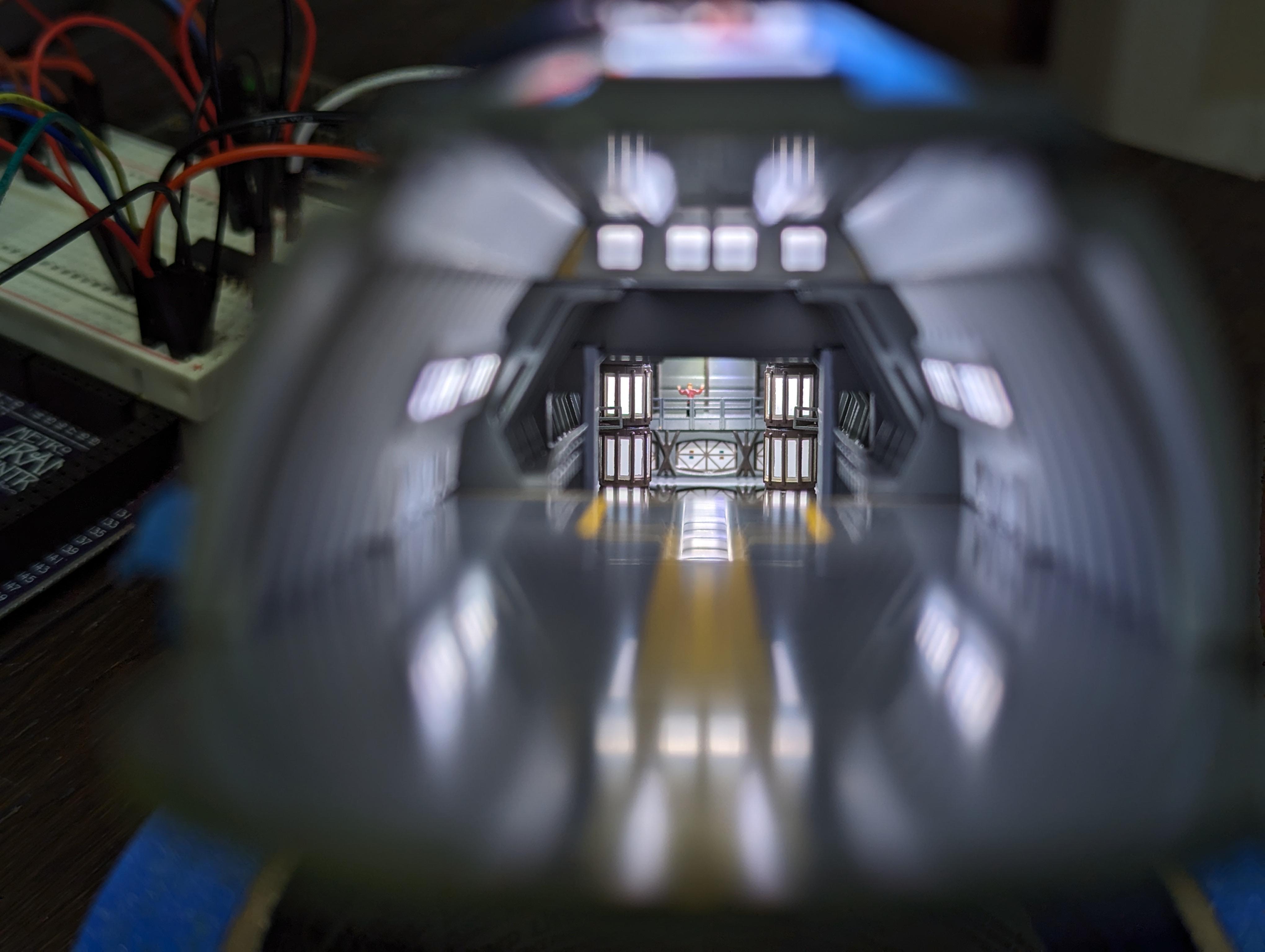

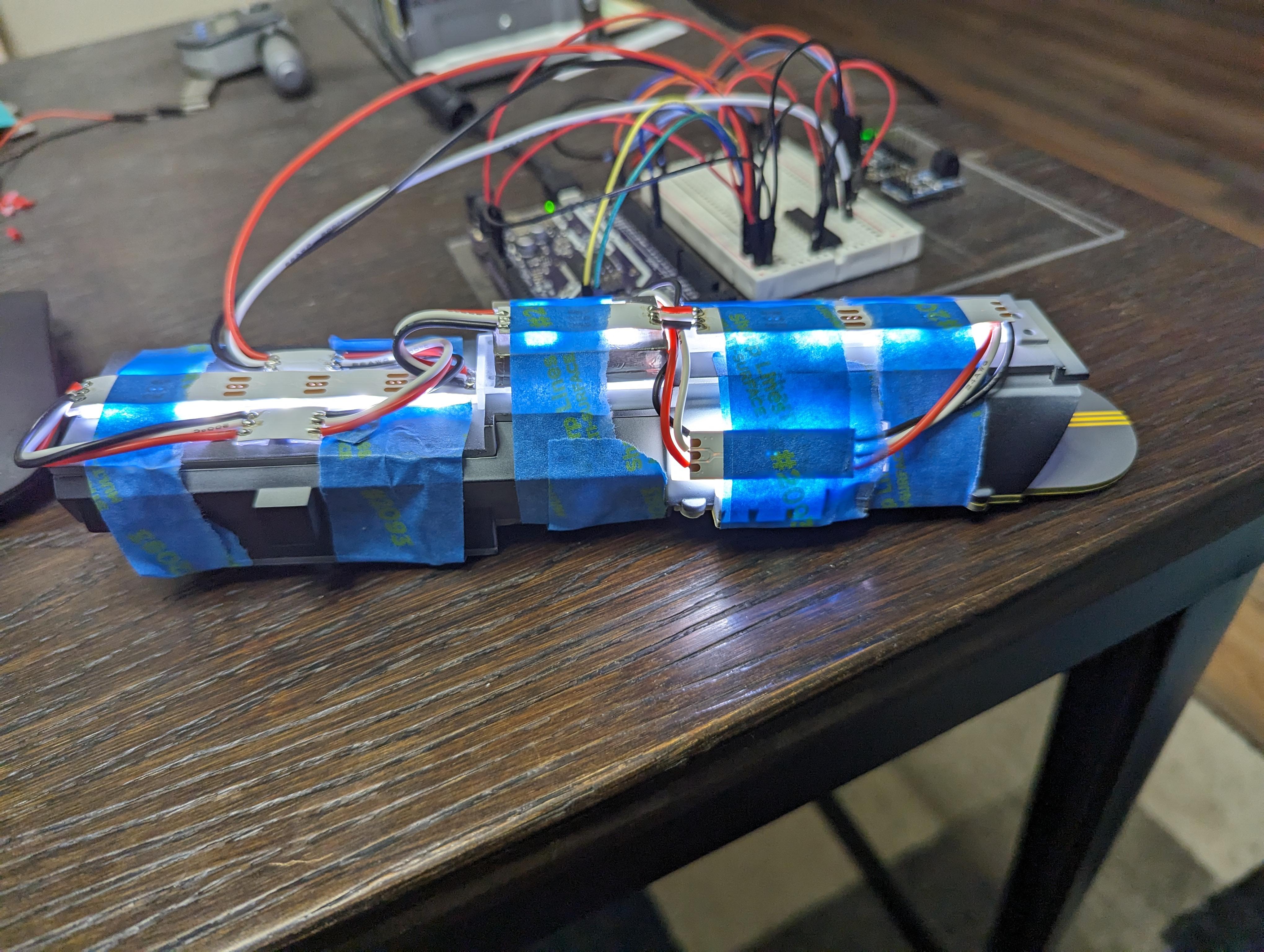

Shuttle bay cocooned in painters tape and LEDs. There are 17 Neopixel RGBW LEDs just for this part.

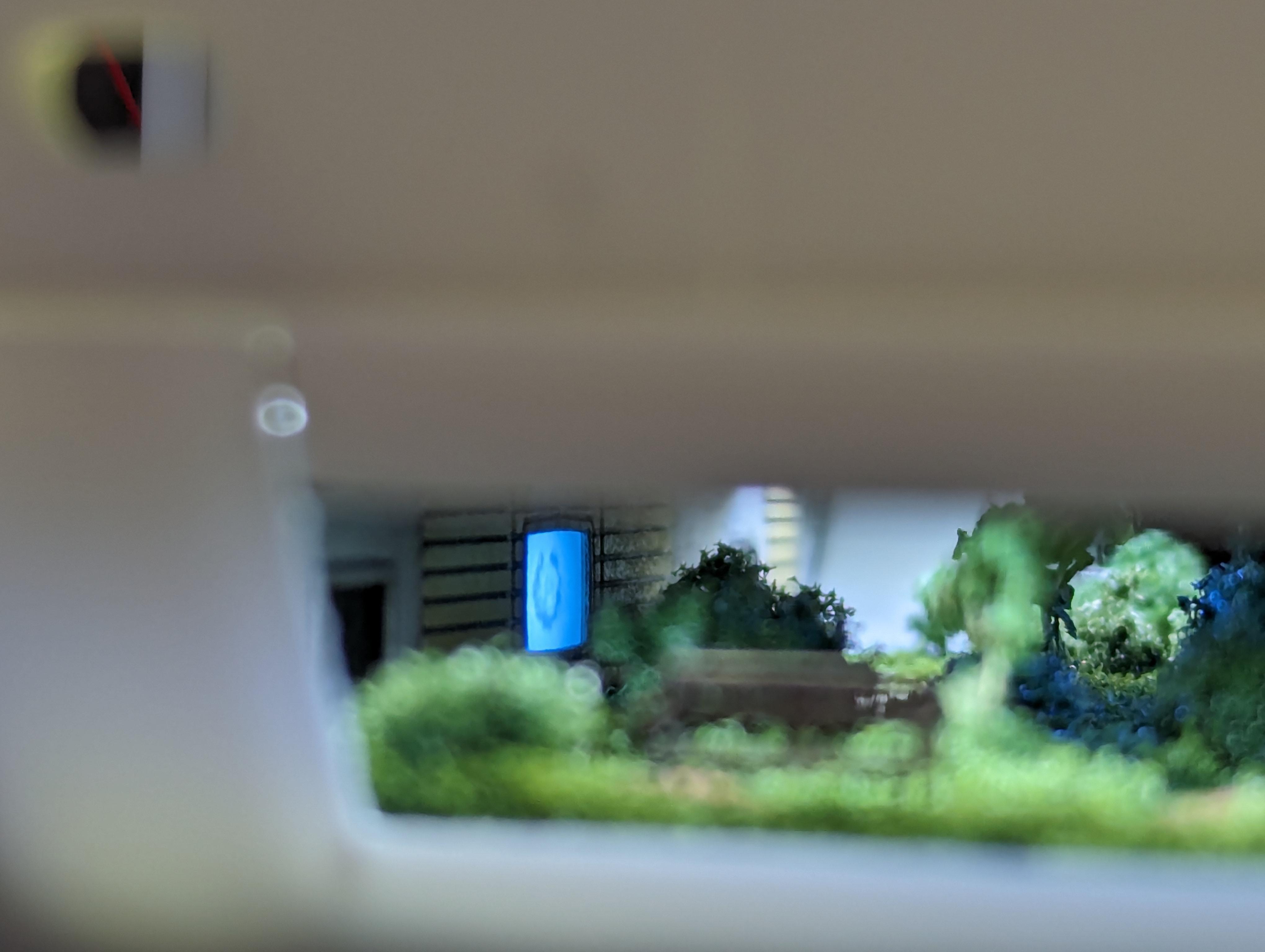

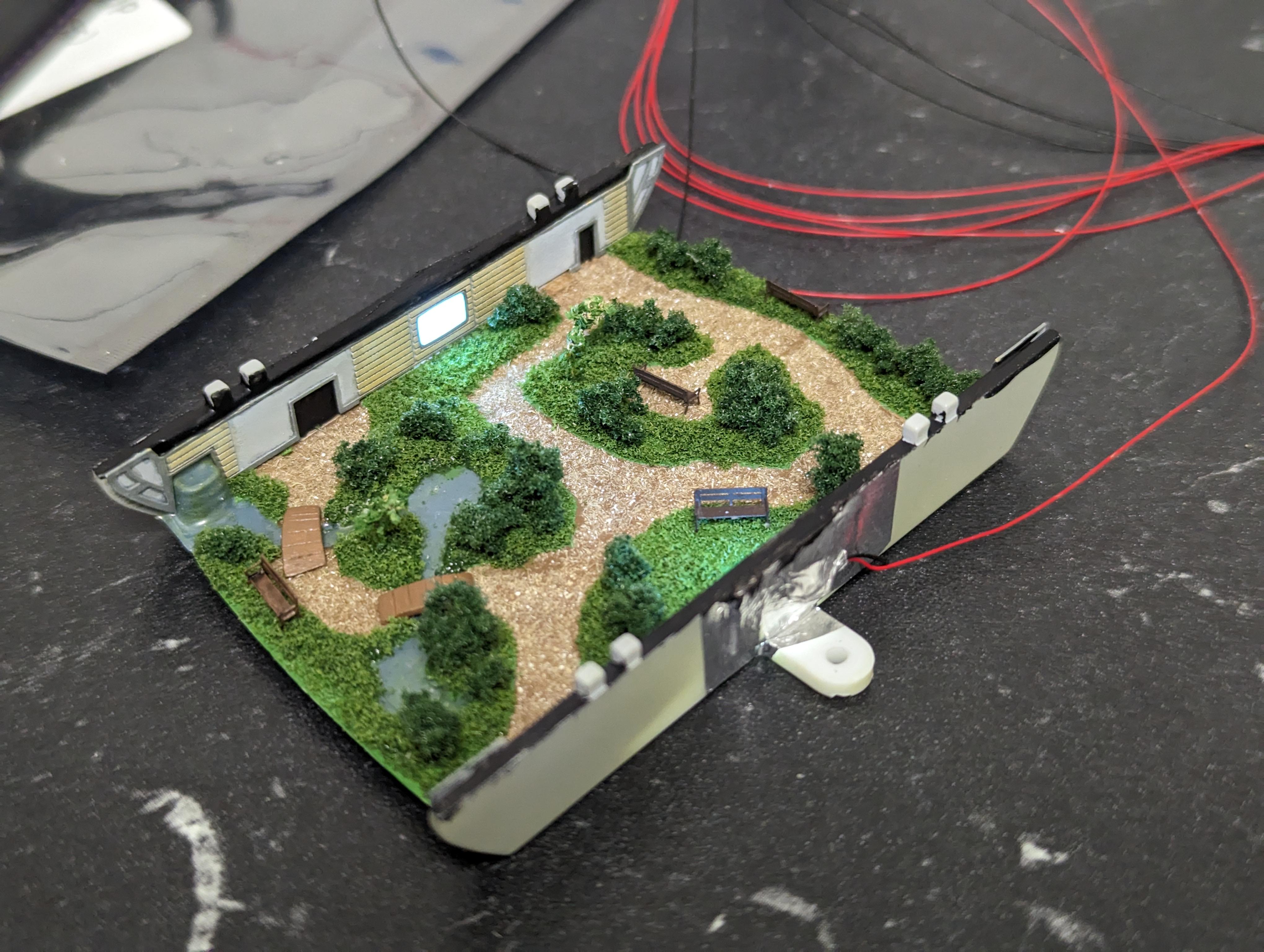

Arboretum. I extensively modified this part, grinding off the cartoonish tree, bench, and bridge details, as well as grinding down the stream bed. I built up the grass areas with putty, used some various Woodland Scenics diorama foliage, filled in the stream with clear resin and added photo etched details (benches and bulkhead walls). I also cut out the bulkheads and added backlights to the view screens.

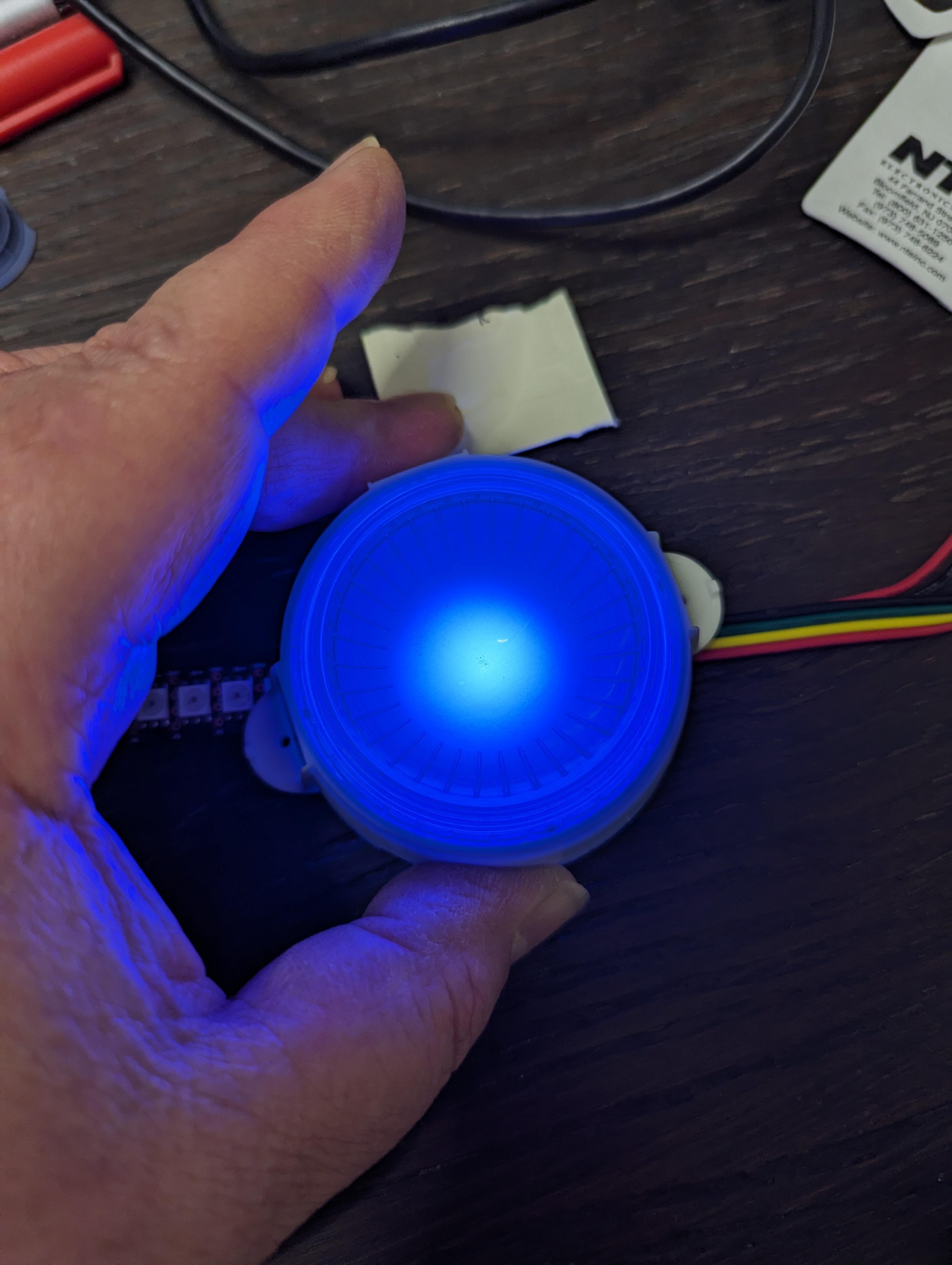

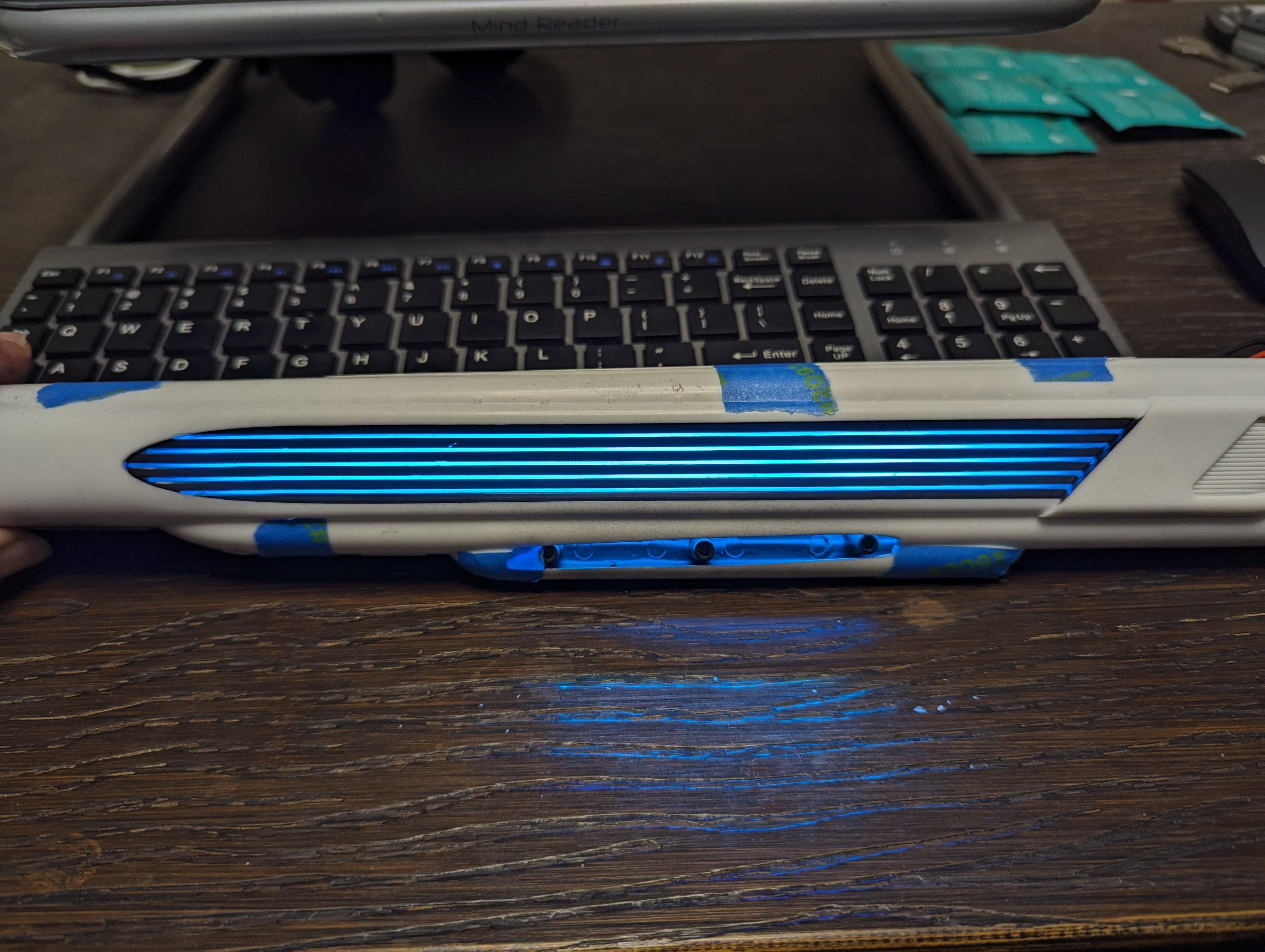

Warp nacelle lighting test. I used some diffusion material from a dead LED TV to make sure the lighting is nice and even.  It looks a little mottled here because it's running an random idle animation I'm testing that varies the brightness in a random water like pattern.

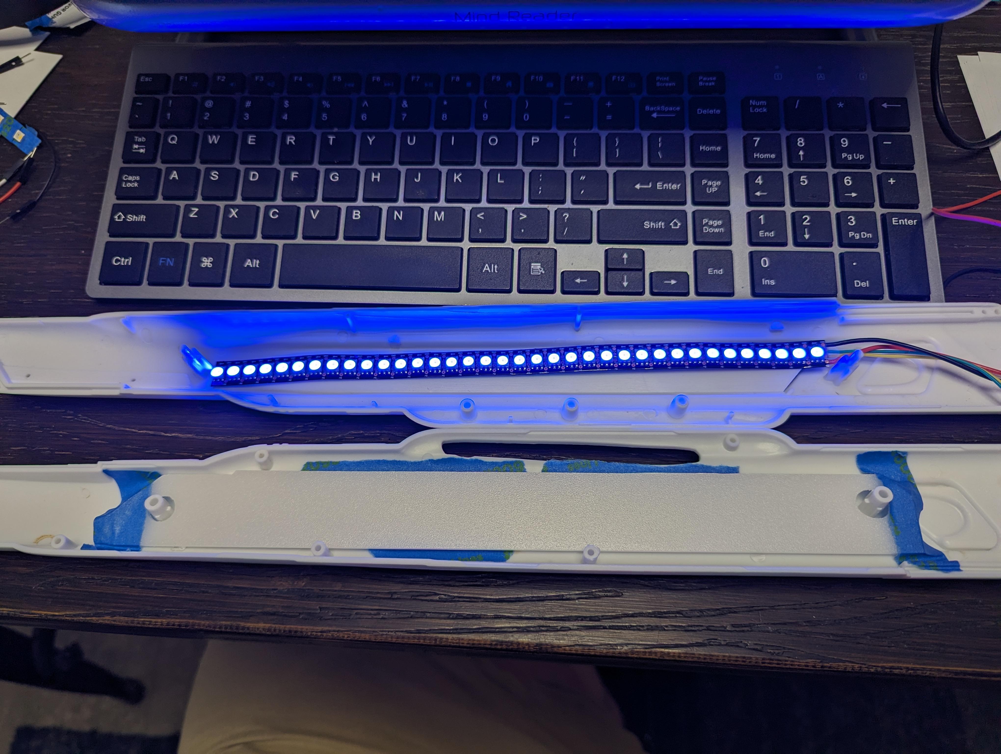

The LED strip and diffuser inside the nacelle.

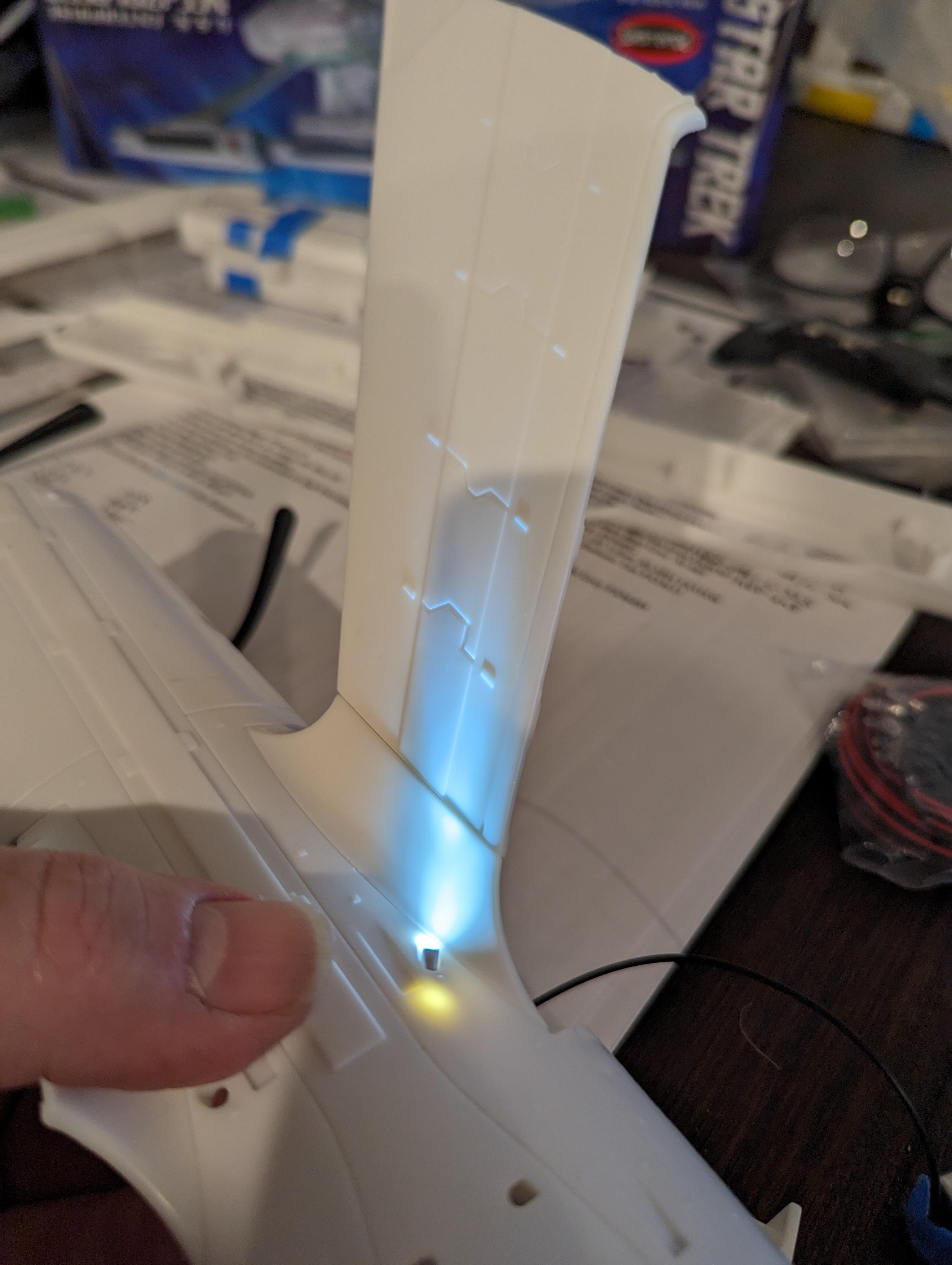

Test of the warp nacelle reaction control thrusters. I carved out a tiny sliver of the TV diffuser to provide even lighting to all 4 emitters from a single SMD LED.

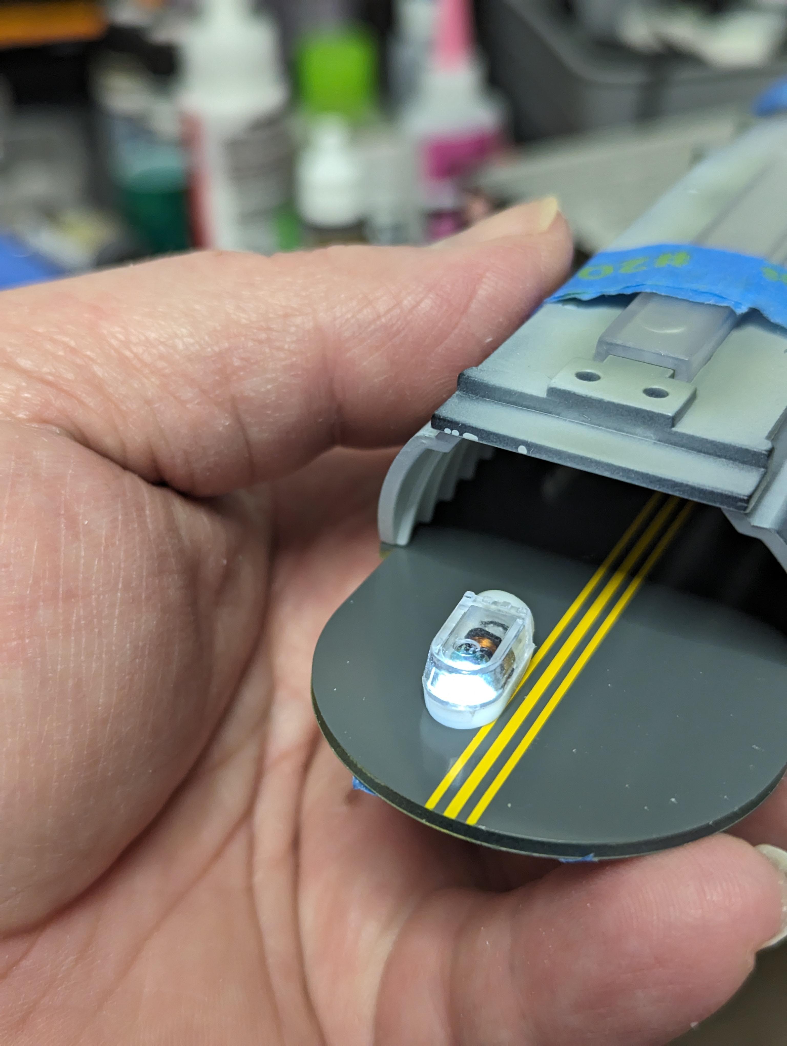

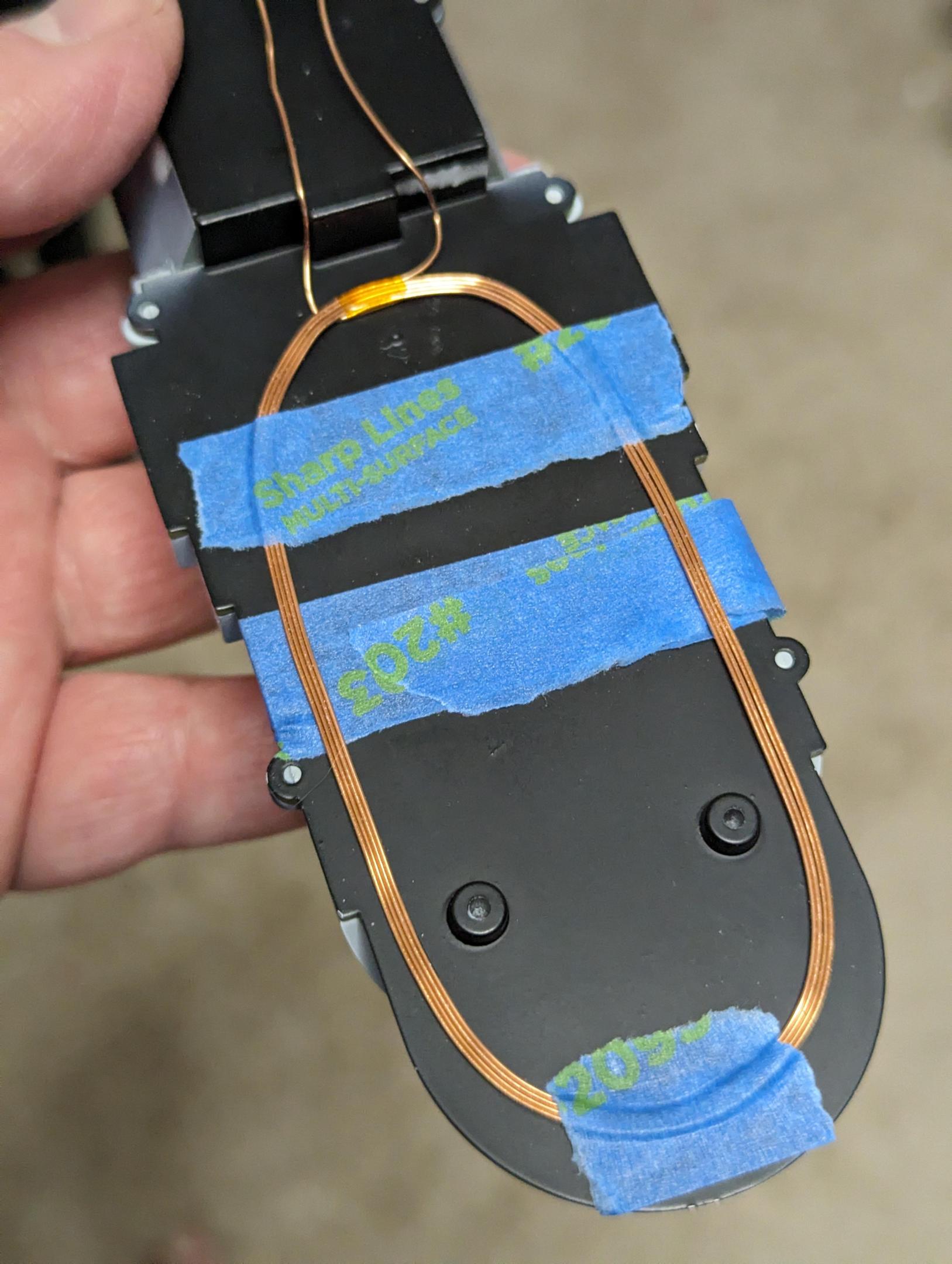

Test of a concept to provide lighting to the shuttles in the bay without having to hard wire them. I carefully bent an induction coil to fit the underside of the deck and placed a tiny inductive LED in the shuttle. The final shuttle will be light blocked and painted and just the areas that need to be lit will shine through.

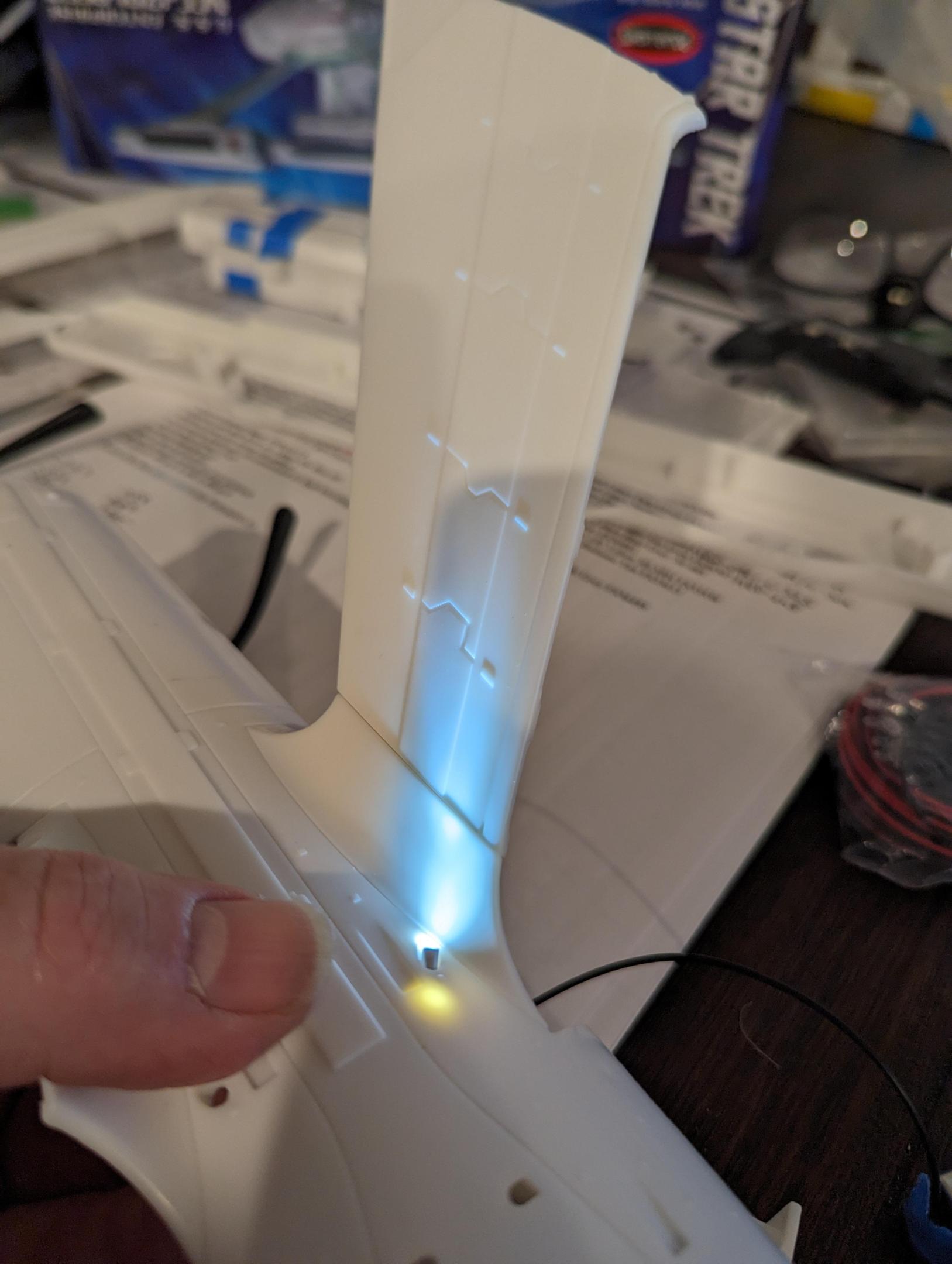

Test of the main navigational deflector lighting. It's using another RGBW LED and can shift between the amber low power mode and the blue high power mode.

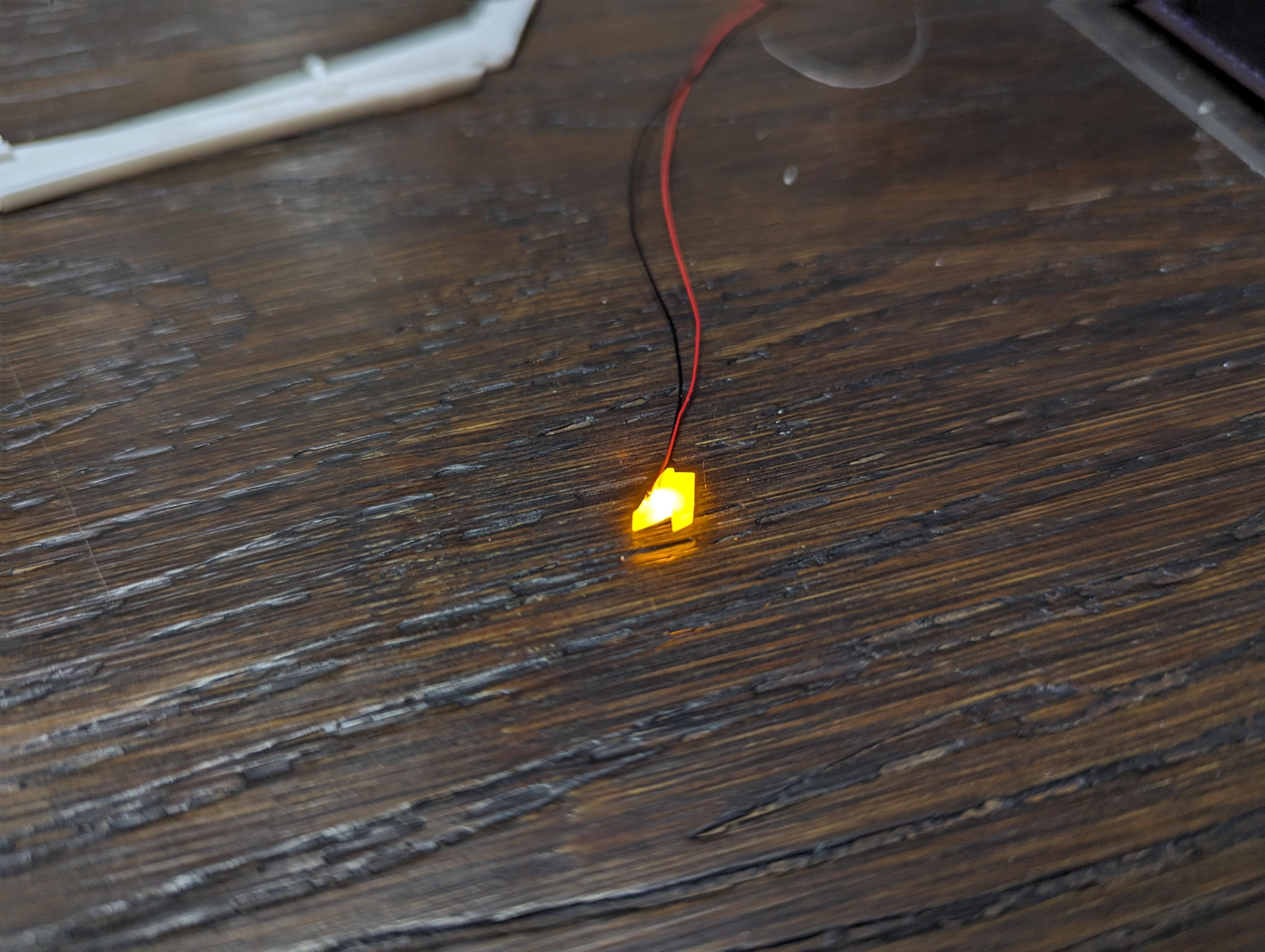

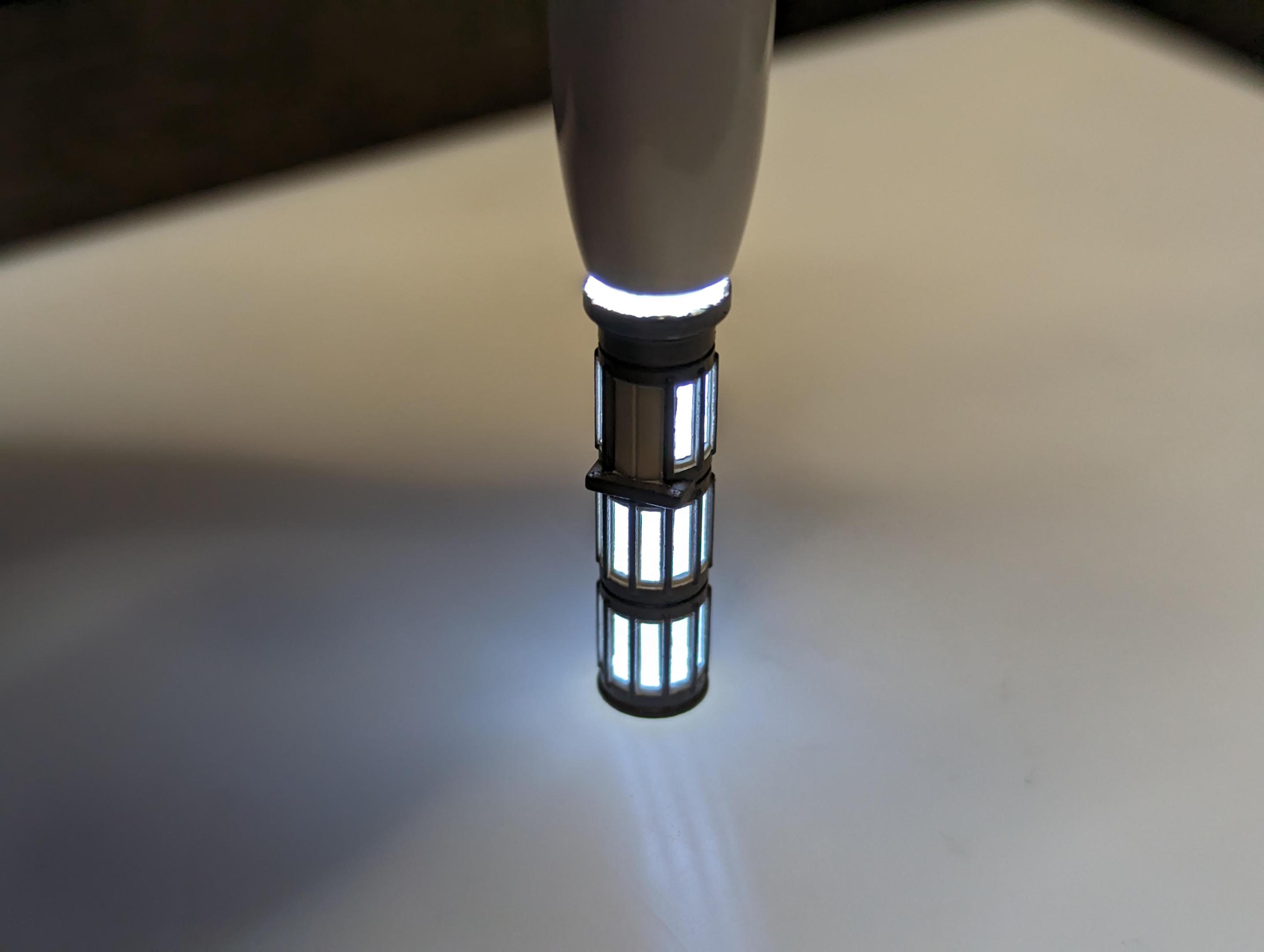

Self illumination spotlight testing. I used a 2mm tower LED and put a small piece of aluminum tube over it to control the shape and throw of the light. I'll sand the tube down flush on the exterior on the final version.

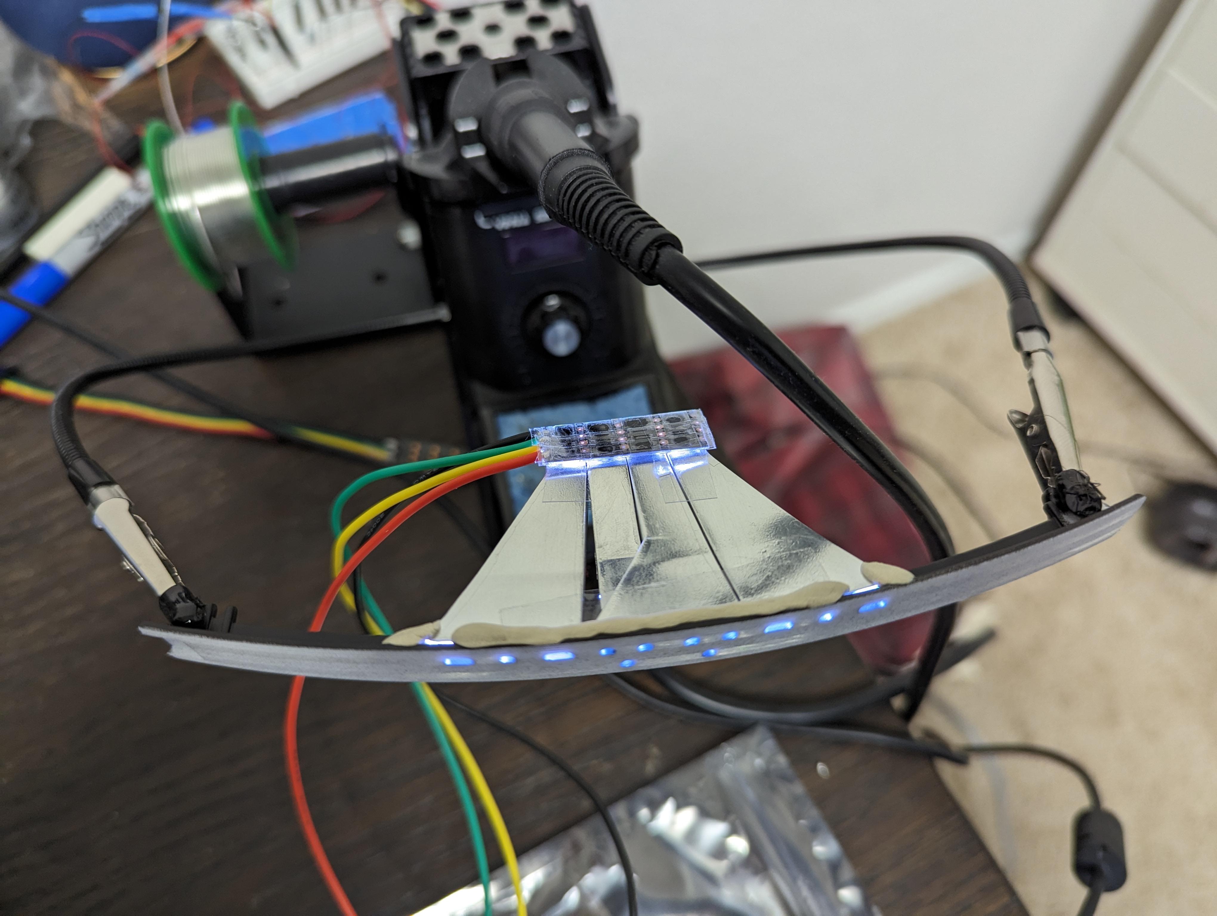

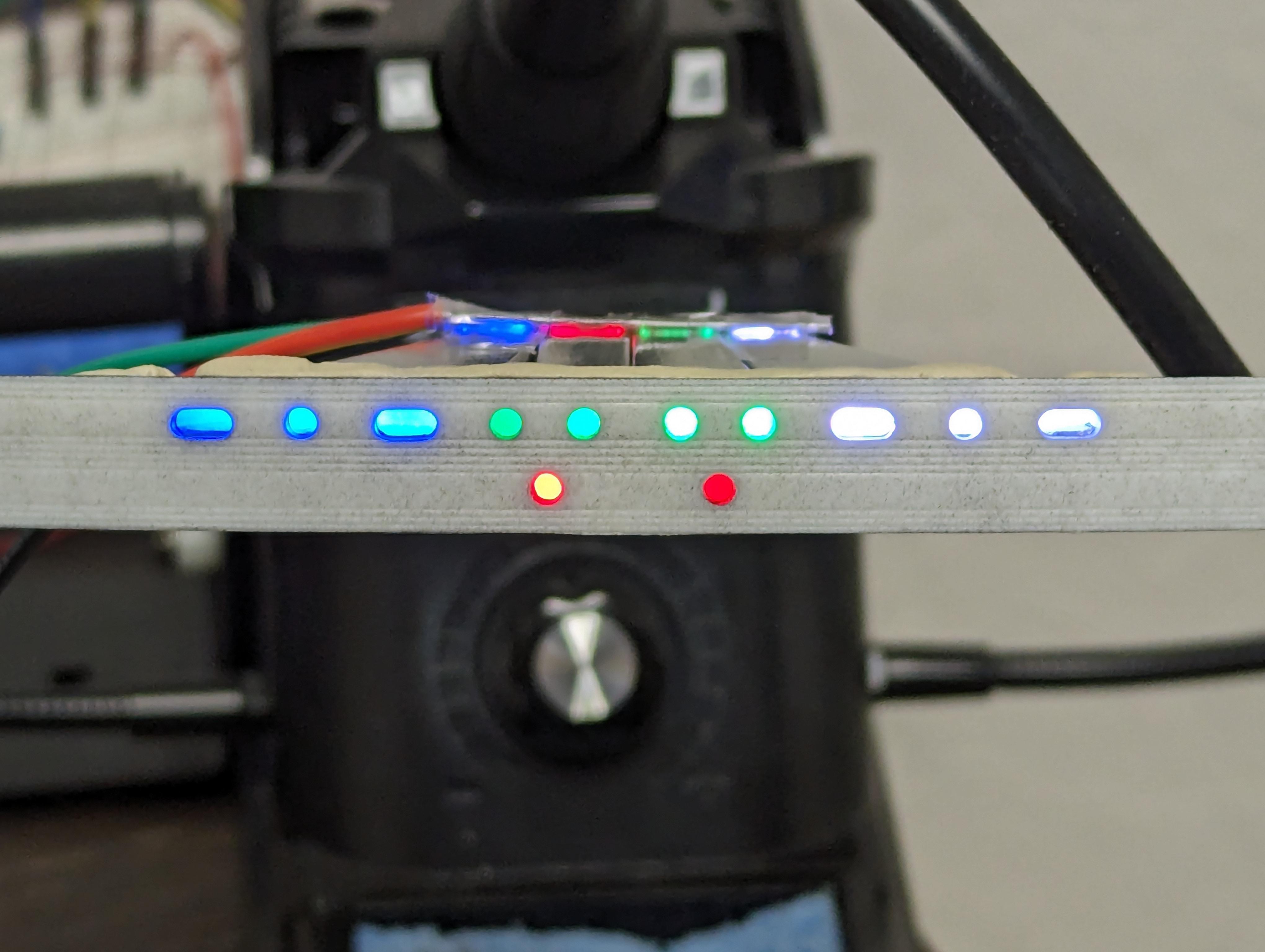

Test of the porthole lighting and light pipes. The 3D printed light pipes are sanded smooth and polished on the exterior to get rid of any print lines and then covered with bare metal foil for light blocking and to increase internal reflections. This allows me to keep the light were it needs to be as well as control each group of portholes individually.
Close up of the arboretum testing out the view screen lighting.
