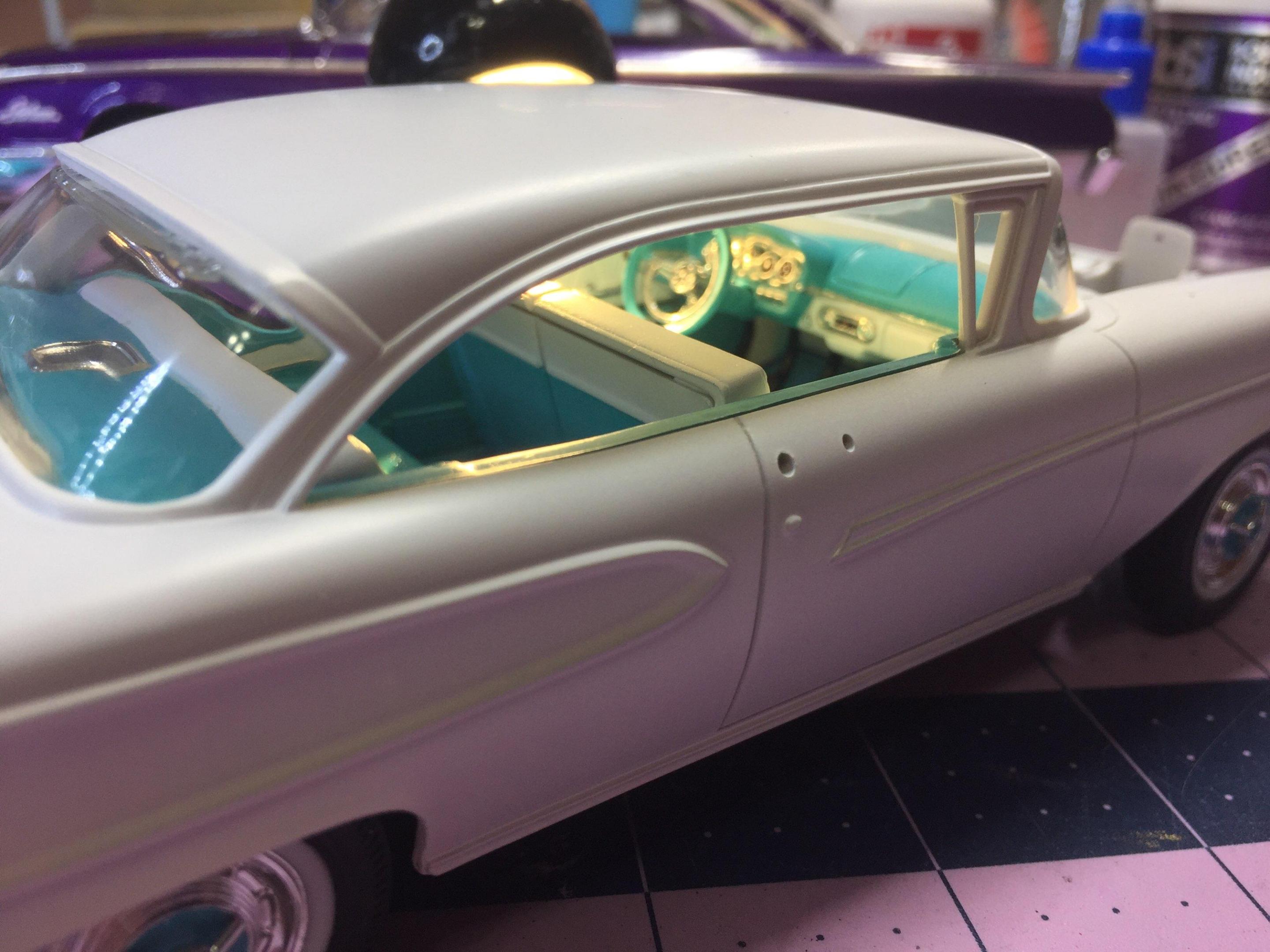

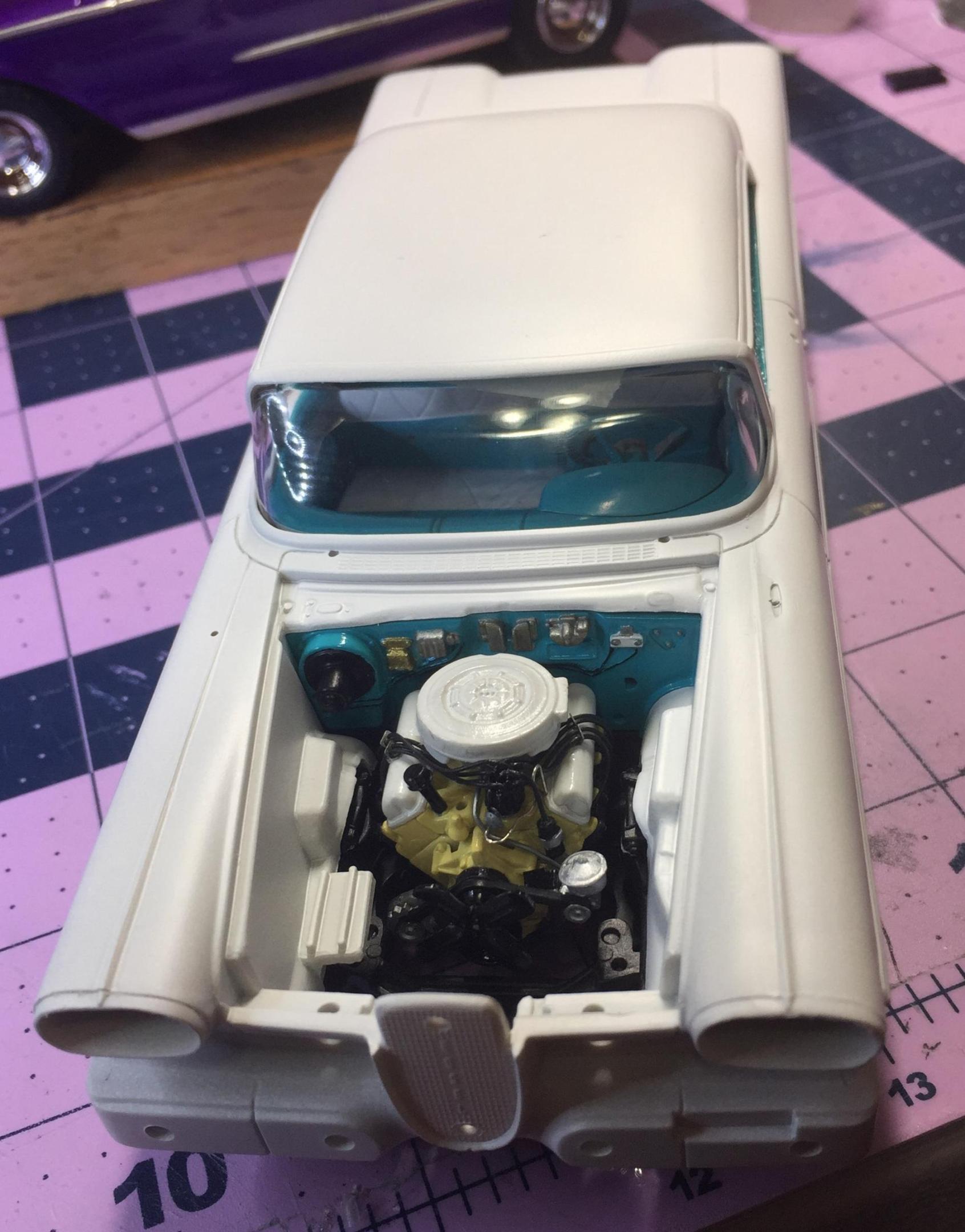

customline Posted October 13, 2024 Author Share Posted October 13, 2024 As promised, I have a glass-in mock-up for your inspection. I gotta tell ya, this thing builds up nice and tight. I attached the rear "sheet metal" to see if I could assemble it with the panel in place. I was able to do it but it's a bit risky; I was anticipating something breaking but it didn't. Taking it apart now may be how I accomplish said breakage. Wish me luck ? I'm encouraged by the fit-up of the interior to the body. Everything seems good at this point. Thanks for coming by! Your over-the-top praise and ill-considered comments are always welcome.? BTW, look at the close-up of the windshield. It looks odd....maybe convex top to bottom?(bubble-like). The fit is quite good though, the glass is precisely located with tight-fitting pins. 2 Quote Link to comment Share on other sites More sharing options...

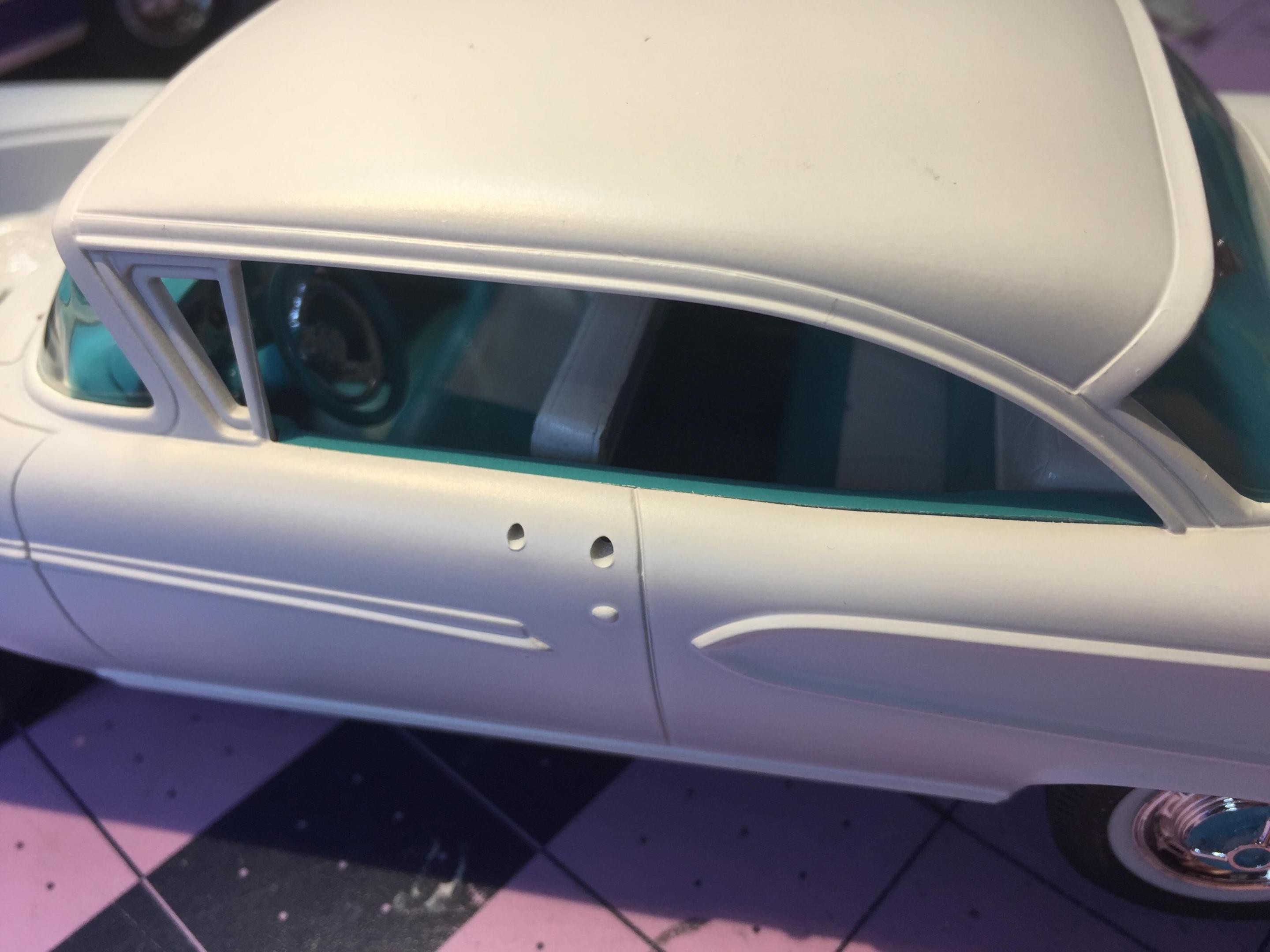

David G. Posted October 13, 2024 Share Posted October 13, 2024 The Edsel is looking good Jim! The paint issue on the hood looks like some light crazing. I just had that happen when I put the first color coat on the London Black Cab I'm currently working on. I've had it happen a few times before and the texture always seems to follow casting flaws; those areas in which you can see where the plastic meets in the mold when its injected. When I get this result, I usually let the paint rest for a day then I hit it again with what I call a "drench coat" of paint. That usually fills in enough of the texture that it will sand out easily. It sounds like we both used the same technique but in a different sequence. David G. Quote Link to comment Share on other sites More sharing options...
customline Posted October 13, 2024 Author Share Posted October 13, 2024 57 minutes ago, David G. said: The Edsel is looking good Jim! The paint issue on the hood looks like some light crazing. I just had that happen when I put the first color coat on the London Black Cab I'm currently working on. I've had it happen a few times before and the texture always seems to follow casting flaws; those areas in which you can see where the plastic meets in the mold when its injected. When I get this result, I usually let the paint rest for a day then I hit it again with what I call a "drench coat" of paint. That usually fills in enough of the texture that it will sand out easily. It sounds like we both used the same technique but in a different sequence. David G. I did put more paint on it after a wet-sand and most of the crazing is gone but there is still a bit to deal with. I hope I don't run into it when I paint the rest. I worry about the roof because of the molded pattern inside. The crazing follows the pattern on the flip side of the hood. I primed with Tamiya light white primer. Too thin? I dunno. The crazing isn't the really bad crazing you get with hot lacquer on bare styrene. It's more like "frost" but it seemed to go deep when I was trying to smooth it out. 1 Quote Link to comment Share on other sites More sharing options...

espo Posted October 13, 2024 Share Posted October 13, 2024 The interior looks like it fits perfectly looking at the tops of the interior door panels and how they meet the tops of the doors. Windshield, maybe not seated completely at the top? Quote Link to comment Share on other sites More sharing options...

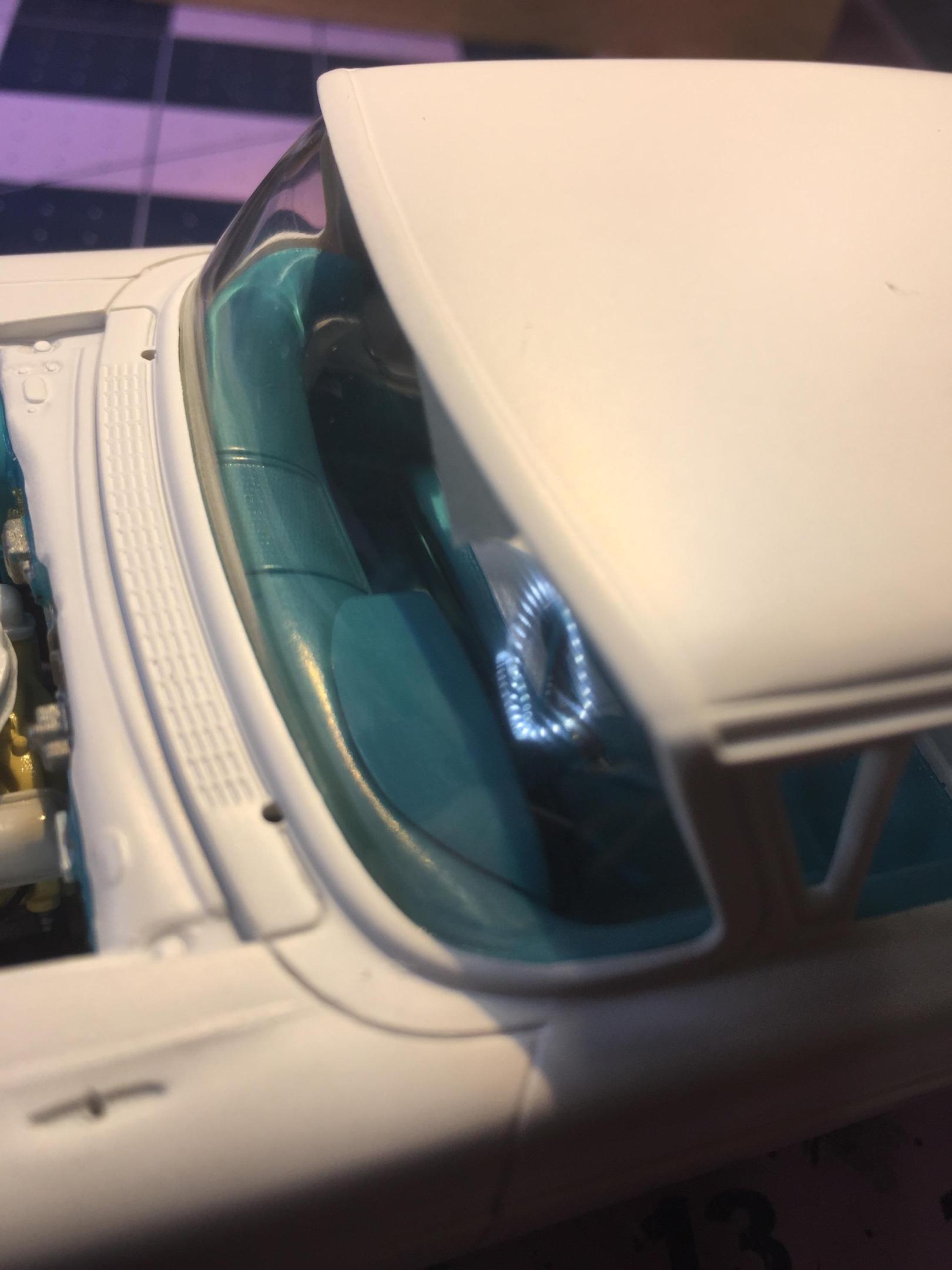

customline Posted October 13, 2024 Author Share Posted October 13, 2024 41 minutes ago, espo said: The interior looks like it fits perfectly looking at the tops of the interior door panels and how they meet the tops of the doors. Windshield, maybe not seated completely at the top? That's why I took those shots, Dave. It's important that it ends up flush with the door tops. Box checked. The glass is taped top and bottom and the windshield dropped a bit but the fit is as good as it gets. Does that windshield look a bit off though? Look at the way the far end looks in the close-up. I see a slight outward curve. The glass should be flat, top to bottom. I don't have any idea what the designer of the "horse collar" had in mind but the '58, to me, looks like it was emulating a jet aircraft intake of some sort. It's a bit unclear. But those wings on the back sure do make a case for that idea. The Pontiac version of the vertical element may have been totally different thinking because of the styling of the other Pontiacs around that time. But it could be the same guy, I suppose. All that info should be out there. 1 Quote Link to comment Share on other sites More sharing options...
espo Posted October 13, 2024 Share Posted October 13, 2024 27 minutes ago, customline said: That's why I took those shots, Dave. It's important that it ends up flush with the door tops. Box checked. The glass is taped top and bottom and the windshield dropped a bit but the fit is as good as it gets. Does that windshield look a bit off though? Look at the way the far end looks in the close-up. I see a slight outward curve. The glass should be flat, top to bottom. I don't have any idea what the designer of the "horse collar" had in mind but the '58, to me, looks like it was emulating a jet aircraft intake of some sort. It's a bit unclear. But those wings on the back sure do make a case for that idea. The Pontiac version of the vertical element may have been totally different thinking because of the styling of the other Pontiacs around that time. But it could be the same guy, I suppose. All that info should be out there. I also noticed what you had pointed out about the appearance of the windshield. The reason I mentioned the positioning issue is that is something I have run into in the past on some builds. The top edge of the windshield might not have the same exact shape as the roof maybe. As for the "horse collar" grill, the story I heard years ago was the Edsel was designed by Henry Sr.'s son Edsel Ford who also was also involved in the design of the original Lincoln Continental. How true this is I really don't know. Edsel was sort of an automotive design type more than anything else from what I understand. Poor health has been blamed for his short life. Quote Link to comment Share on other sites More sharing options...

customline Posted October 14, 2024 Author Share Posted October 14, 2024 5 hours ago, espo said: I also noticed what you had pointed out about the appearance of the windshield. The reason I mentioned the positioning issue is that is something I have run into in the past on some builds. The top edge of the windshield might not have the same exact shape as the roof maybe. As for the "horse collar" grill, the story I heard years ago was the Edsel was designed by Henry Sr.'s son Edsel Ford who also was also involved in the design of the original Lincoln Continental. How true this is I really don't know. Edsel was sort of an automotive design type more than anything else from what I understand. Poor health has been blamed for his short life. Yeah, David, that's always something that can cause all sorts of trouble. I don't think that's the case here but I will see if maybe it is. Thanks for the heads-up. Edsel must have wanted to push the envelope with his design but the timing wasn't good. The Edsel should probably be allowed to rest in peace. On my shelf ?. 2 Quote Link to comment Share on other sites More sharing options...
