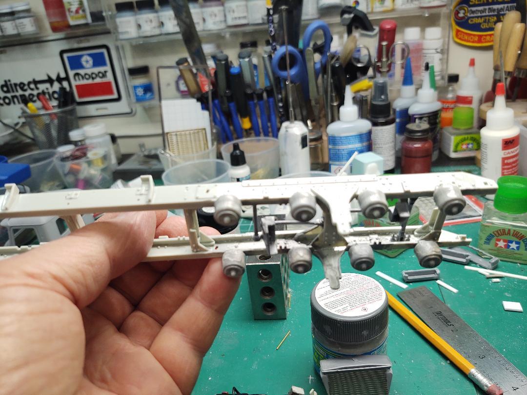

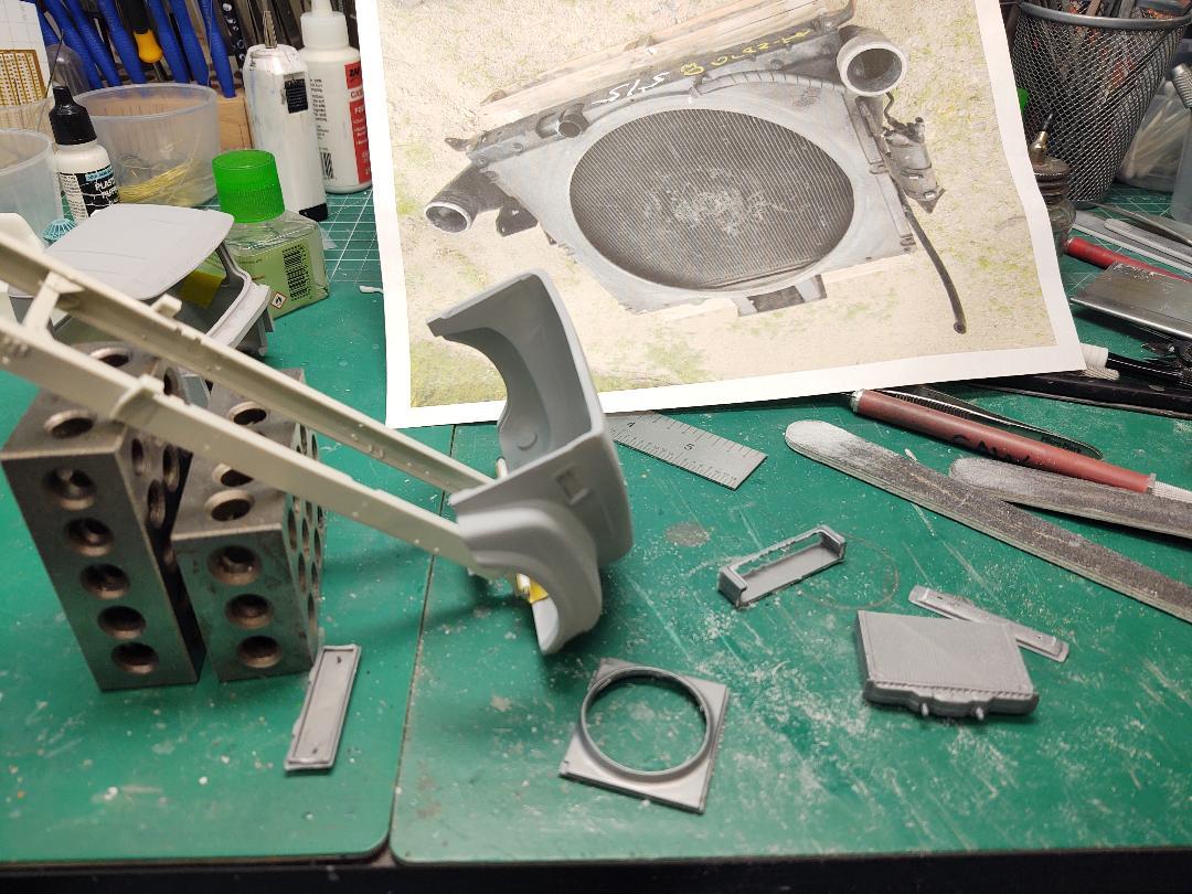

Scott Eriksen Posted December 18, 2024 Author Posted December 18, 2024 No work today so I had some bench time this morning,,cobbled up some hood hinges.(I'll add more detail,reinforcement angles later) and started modifying the KW radiator into something close to the Mack along with the CAC ,built up some more putty on the hollow air bags,,,should be enough now to contour to shape. 3

Scott Eriksen Posted December 20, 2024 Author Posted December 20, 2024 Had to work a few hours today ..now back at the bench...had to revise the rad assy some in order to have room for the CAC and still have hood clearance ,,sanding and contouring the hollow air bags....added pulley and fan drive to the MP8 which also required modifying some plumbing that was casted into the front of the engine,,no biggy ..I think that engine might have been set up for a Volvo cabover,,,just a guess,,,,intake air inlet will also have to change for hood clearance which I figured would have to be done anyway ...pics later or tomorrow 3

Scott Eriksen Posted December 21, 2024 Author Posted December 21, 2024 Charge Air Cooler/radiator cobbled up ,used some CTM rad mesh,K&S aluminum tube and styrene for the CAC,used some styrene and a Parts by Parks aluminum pulley for the fan drive,,just had to nip a bit off each blade of the Kenworth fan .... front engine mount support bar in place .Sanding and filling of hollow air bags continues-almost there . Hood-rad-engine-cab-interior tub-wrecker body test fit -I think it will fly,,may have to hog out some of the thick interior tub to clear the back of the engine and gain just a bit of room behind the cab ,it still has to come closer to the hood anyway ,it's gonna be close ,,,worse case I stretch the frame a bit .Changed the outlet orientation of the turbo and altered the inlet of the intake manifold .Shot the Allison aluminum and attached to the engine,,,still needs the pto and hyd pump ,,,should have room 2
