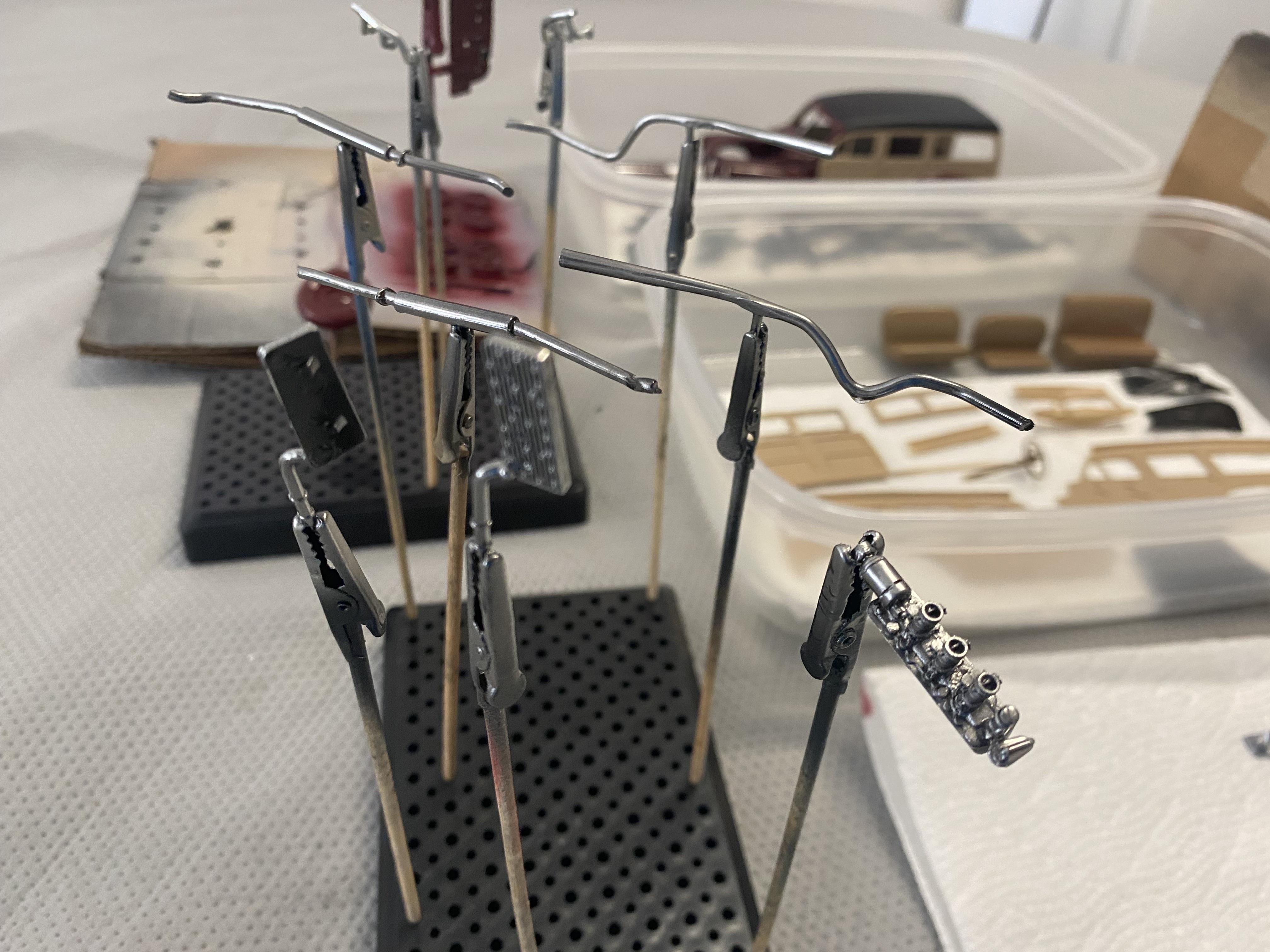

IMG_5512.thumb.jpeg.56cd22ffbdedd2da1e508a851b2282c7.jpegIMG_5513.thumb.jpeg.fe0749538e57663616f38d0f6a56a6ec.jpeg

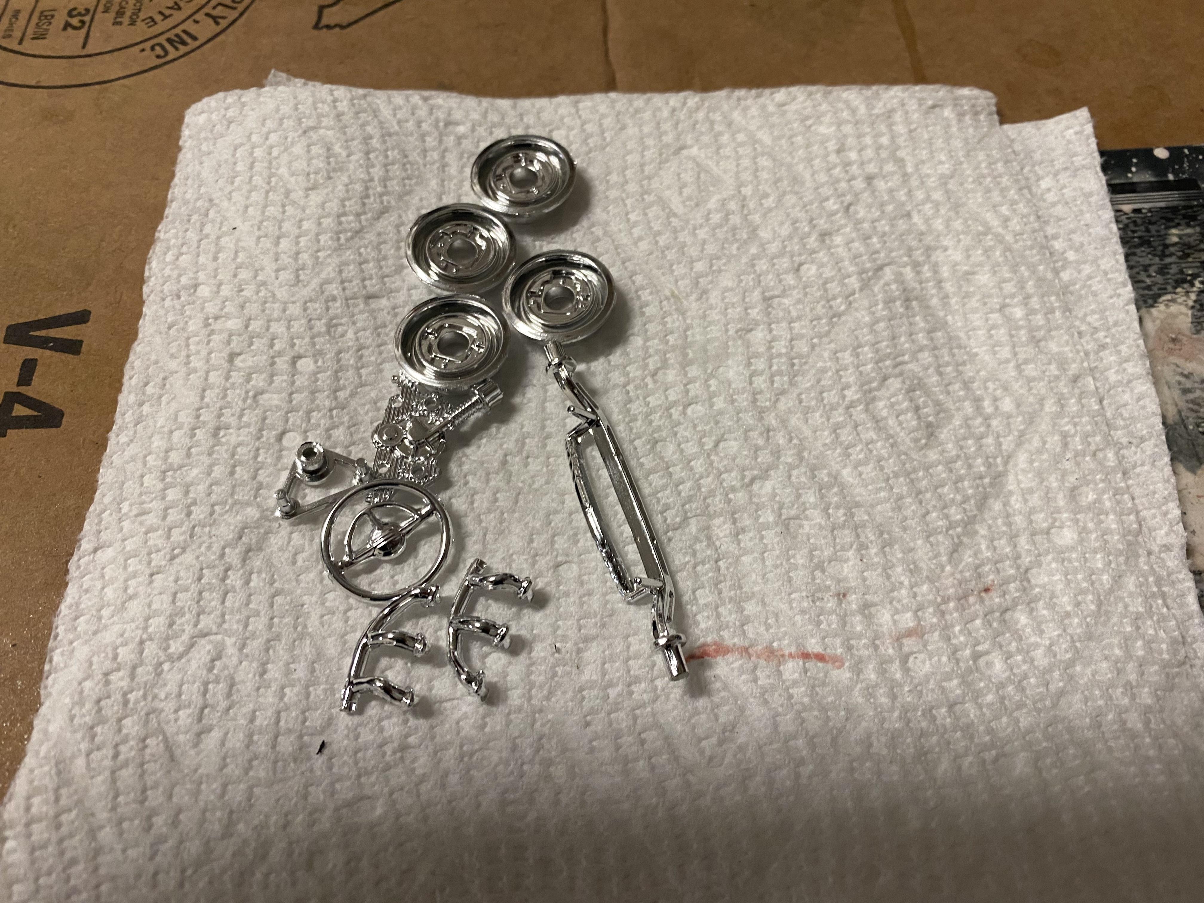

stripped chrome parts, why… just why.

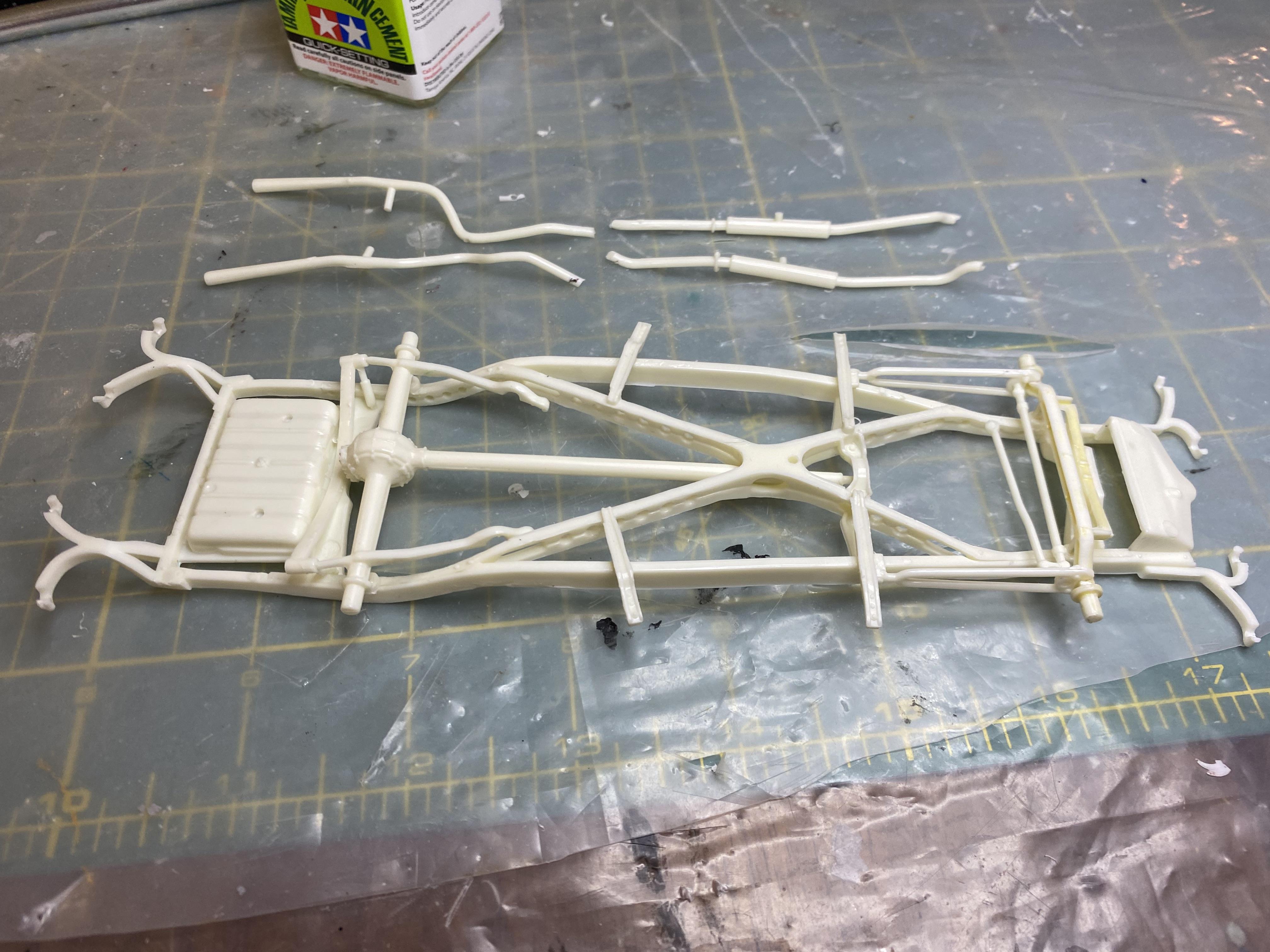

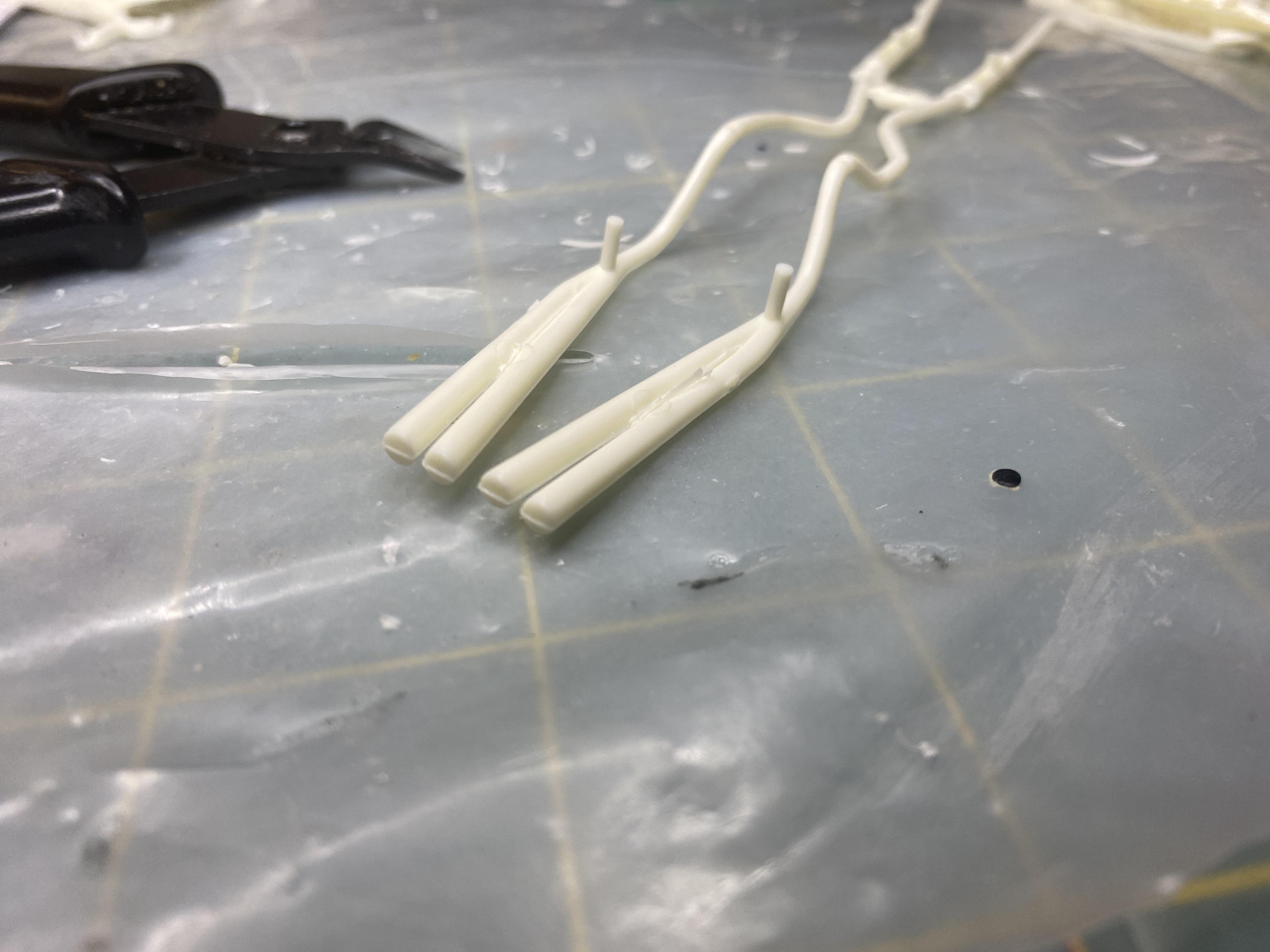

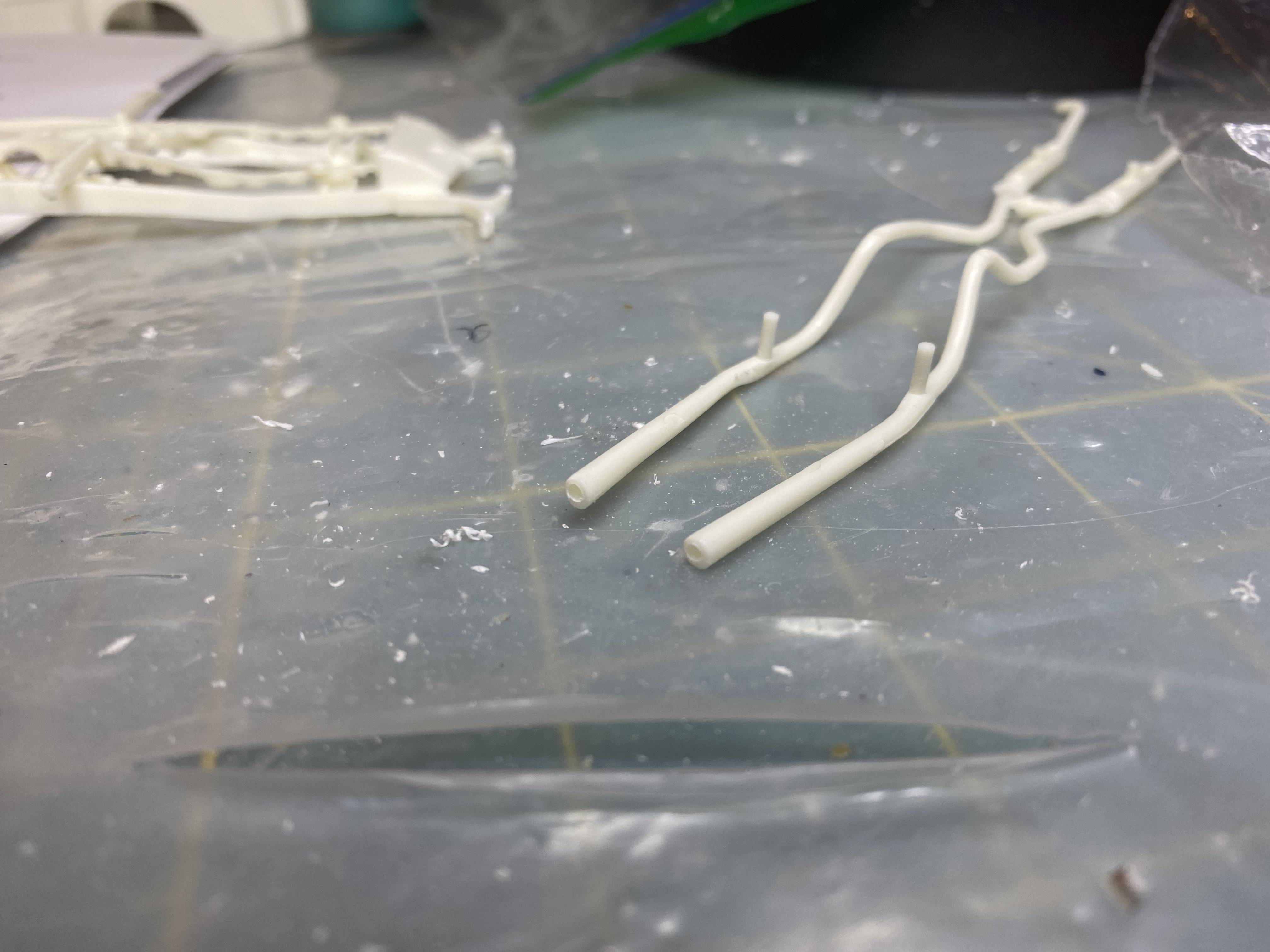

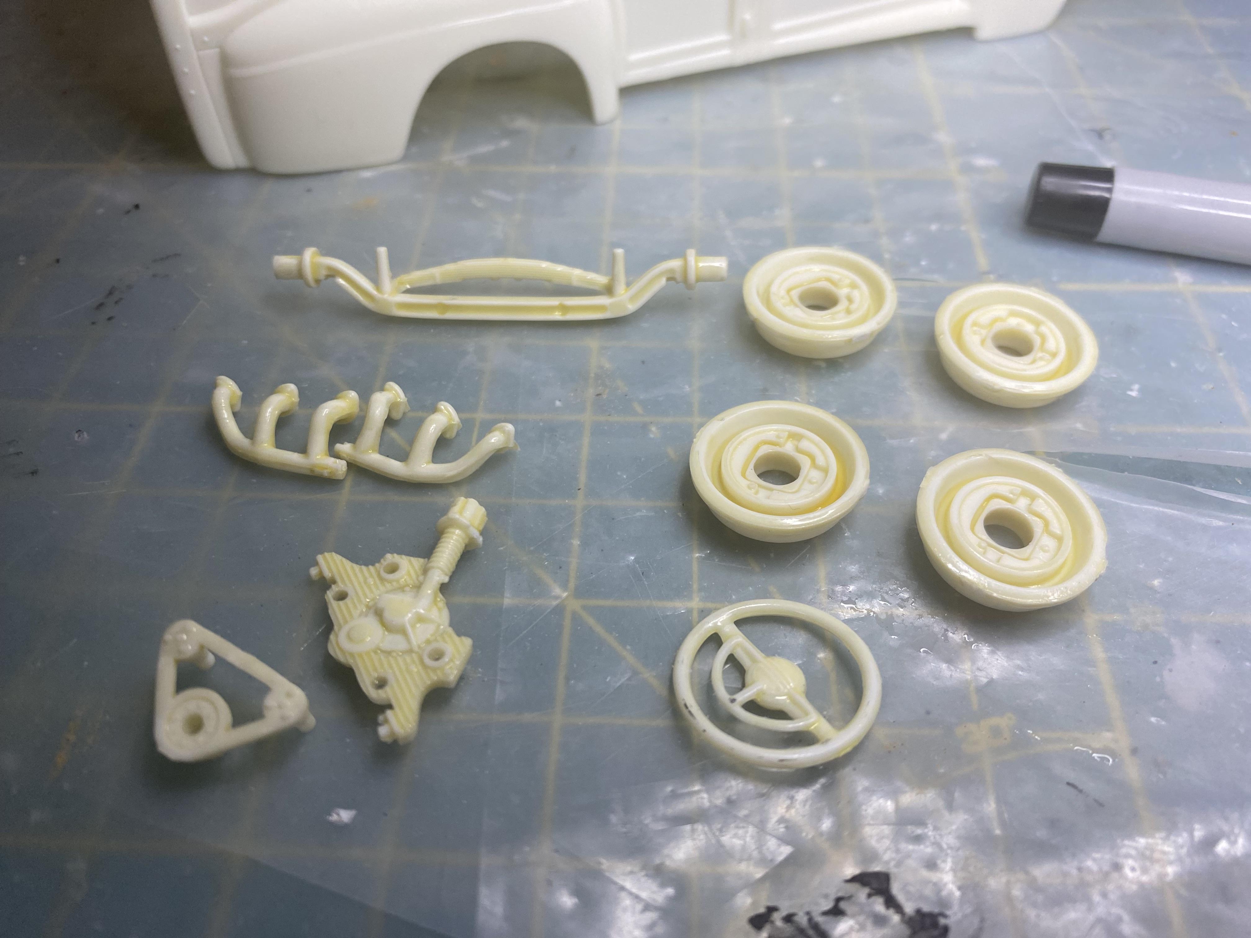

I didn’t like the quad ends for the dual exhaust som cut down to one and drilled ends.

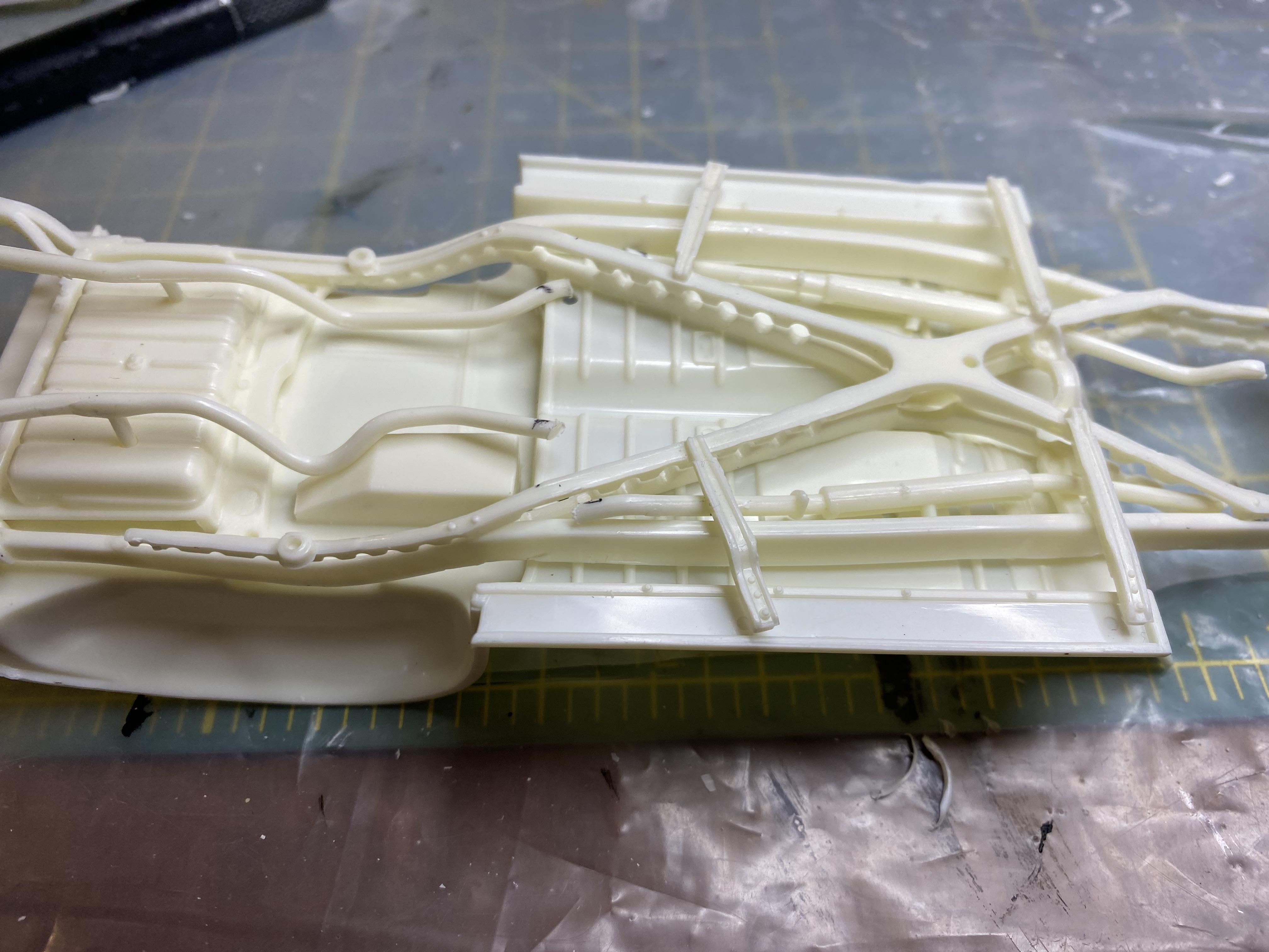

IMG_5515.thumb.jpeg.59567d5608951c435e12cf8667cdc70d.jpegIMG_5516.thumb.jpeg.d0a8107cd1435fc3580829d7a73d19fa.jpeg

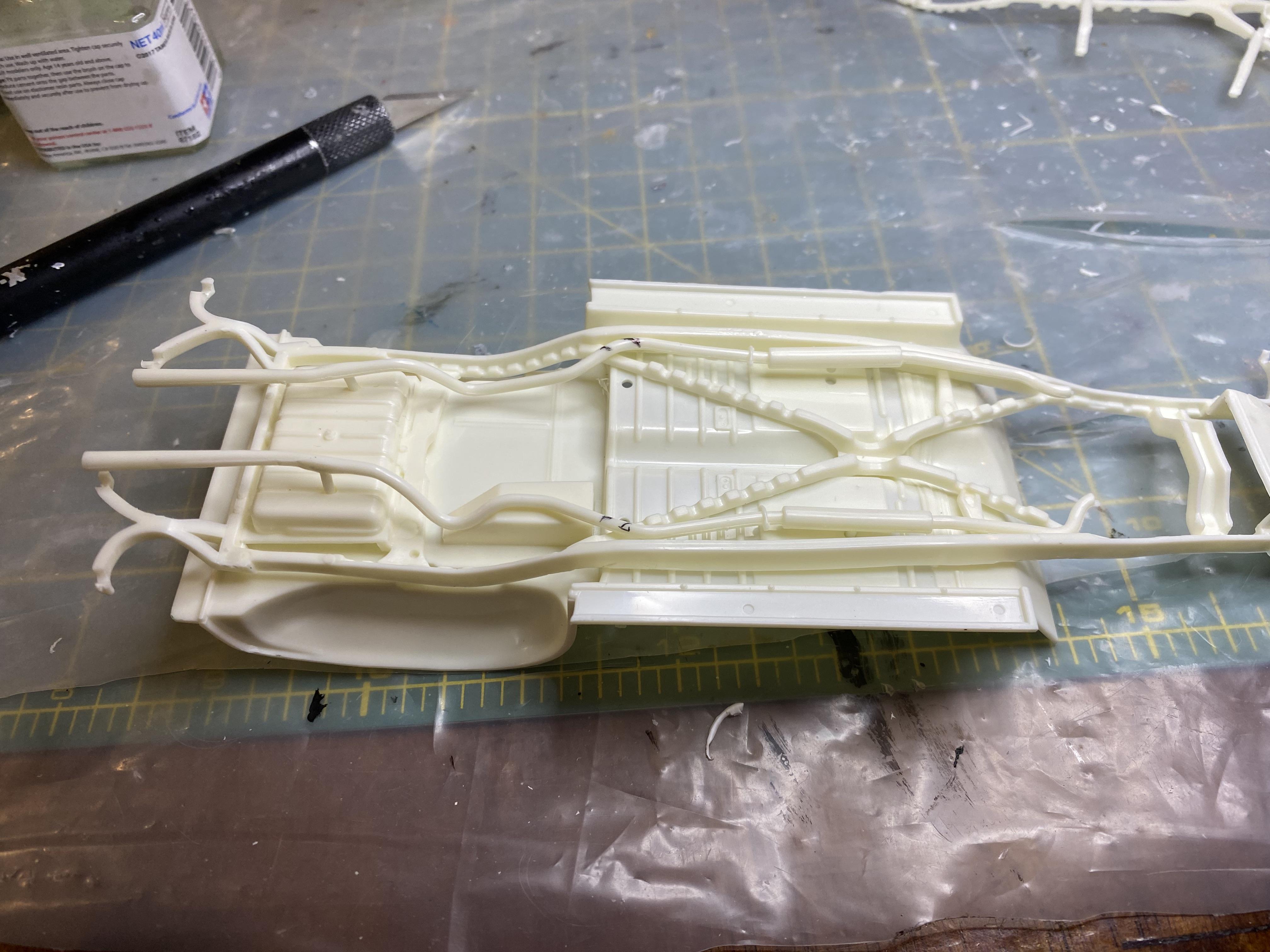

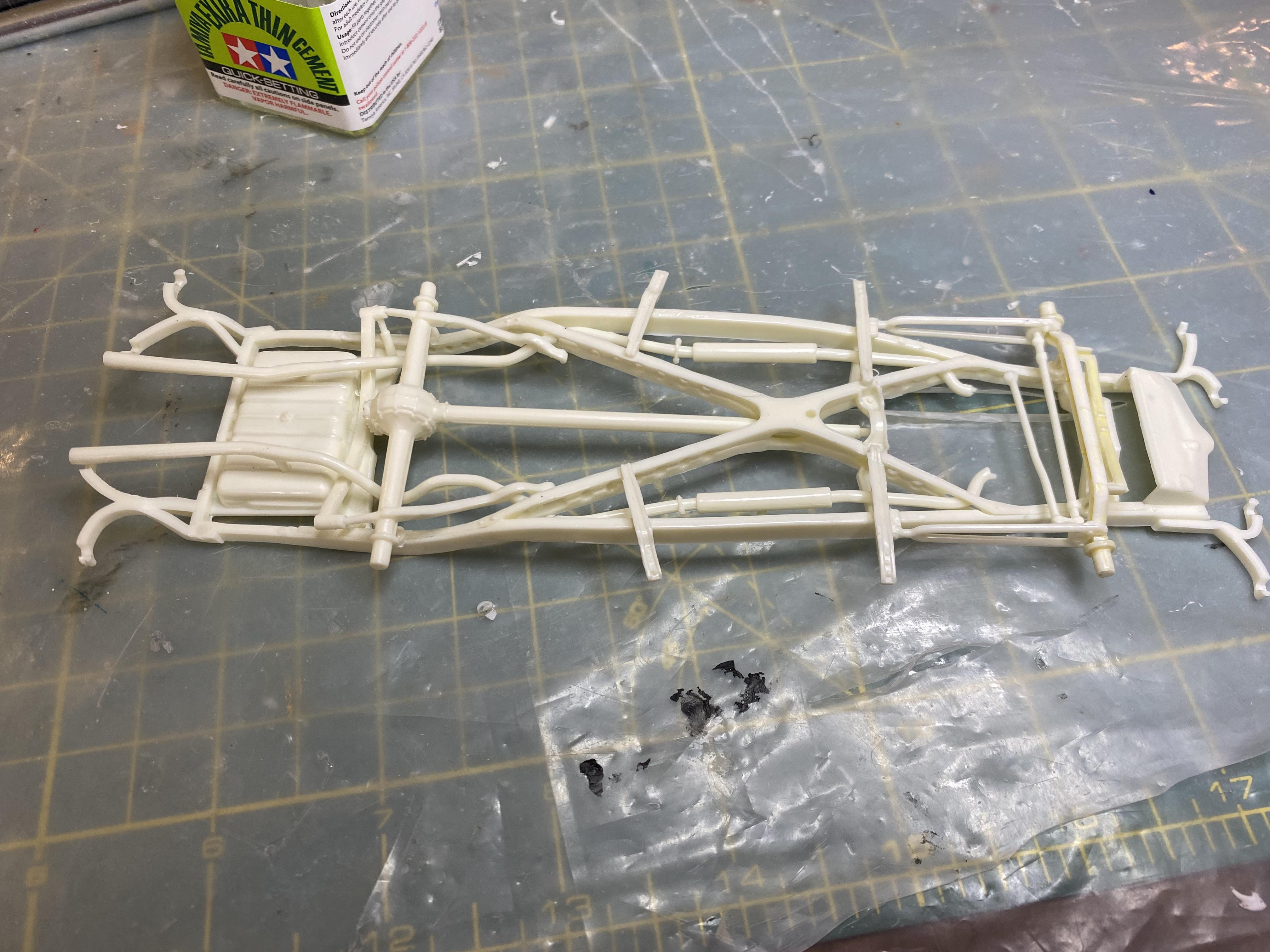

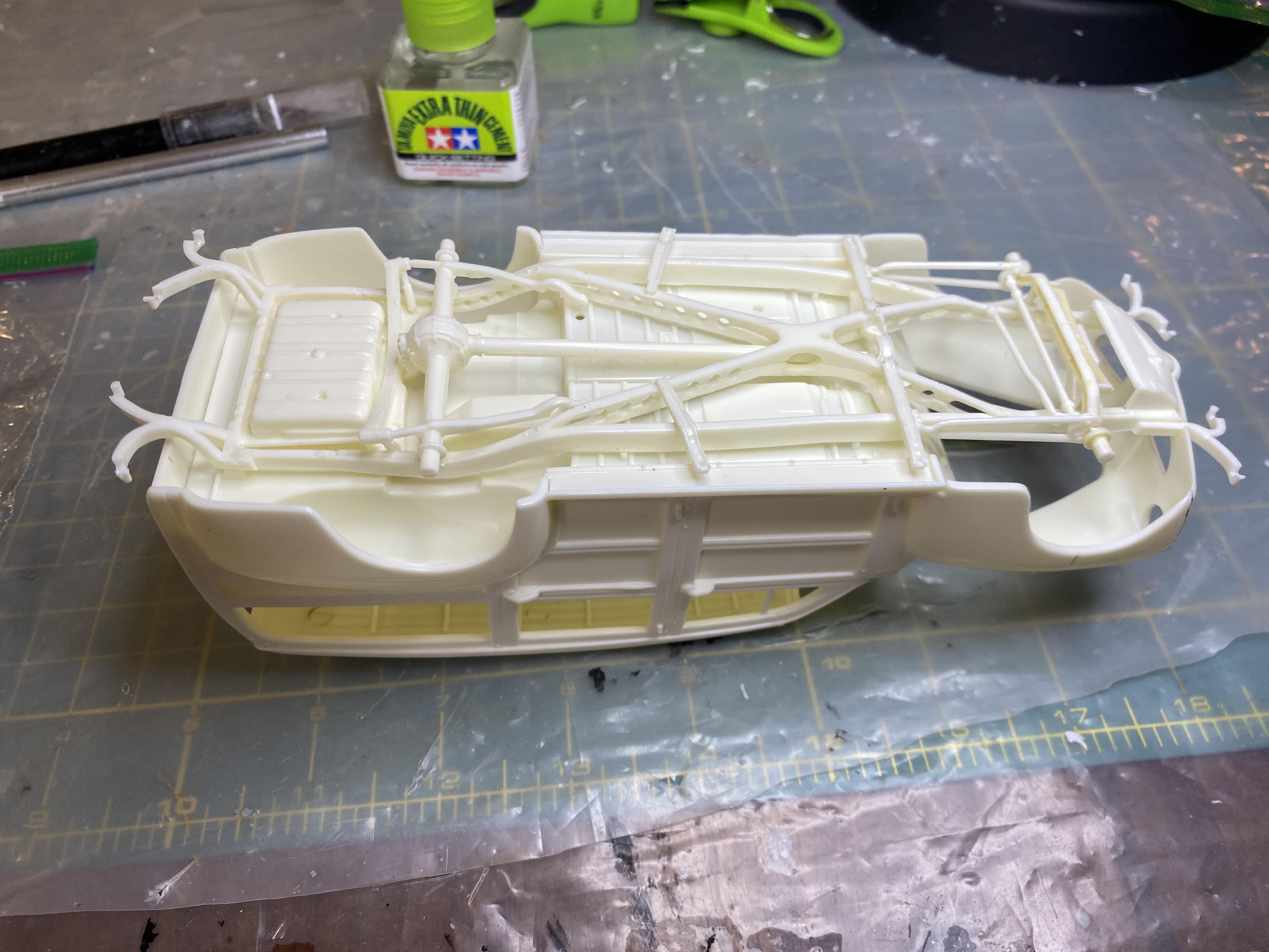

assembled the frame and suspension. I cut the exhaust where it fits into the frame to make it easier to install later so I could assemble the frame that would have been a paint assemble one painted.
IMG_5517.thumb.jpeg.405c26edd6c8be0504bf71500ed184cd.jpegIMG_5518.thumb.jpeg.1662662ea7d8b99bc809c5aa32eaeb7d.jpegIMG_5519.thumb.jpeg.96b25a5e23e363d576b3e32bebe1826b.jpegIMG_5521.thumb.jpeg.cf3e8281add8c87d7b1e7e92dca65bcd.jpegIMG_5522.thumb.jpeg.a85fb22a1bc53d43f5fb67fb19c37eb3.jpegIMG_5523.thumb.jpeg.cac1d5e62aa456c09fc9c47e9f56edcd.jpeg

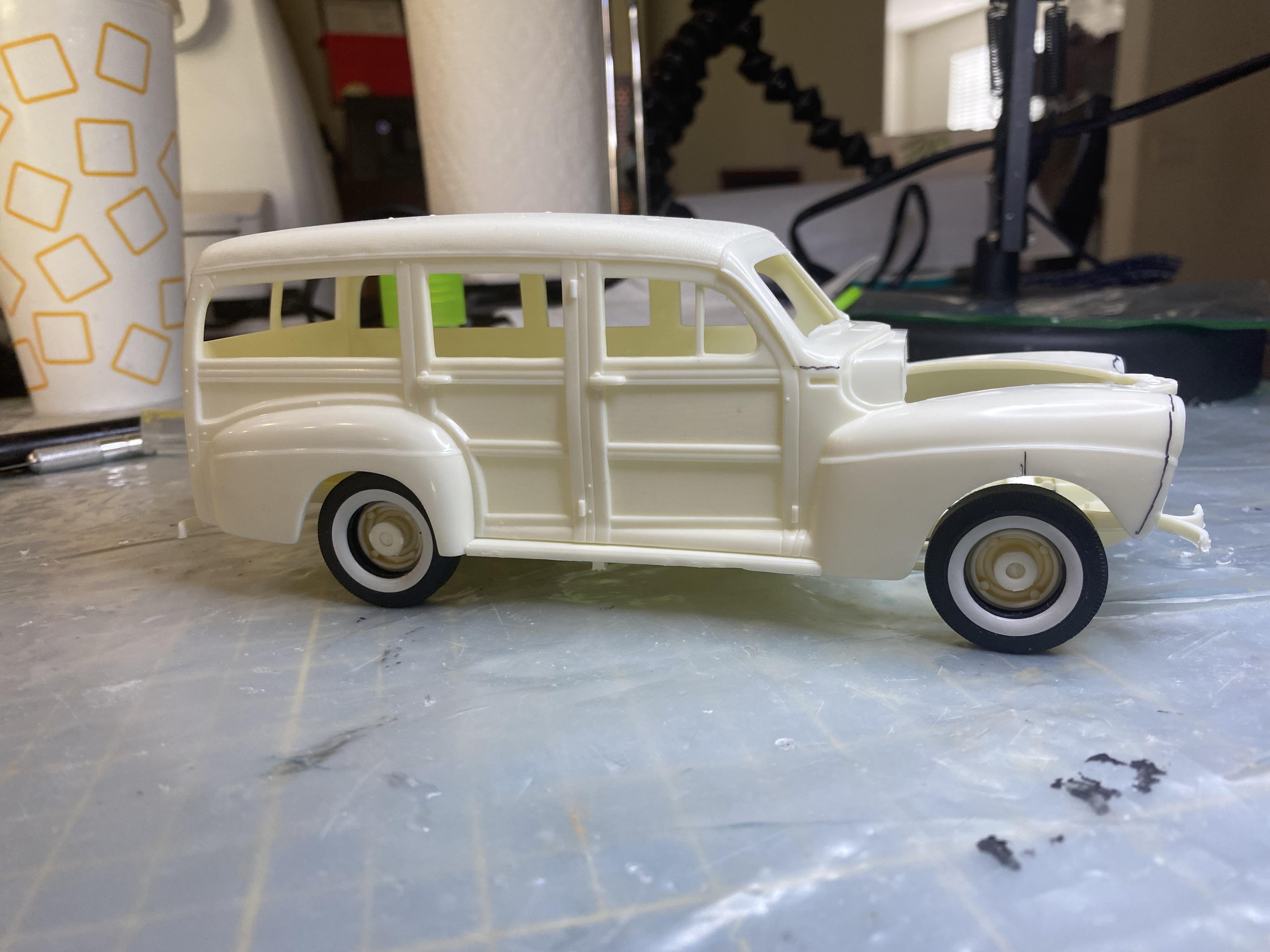

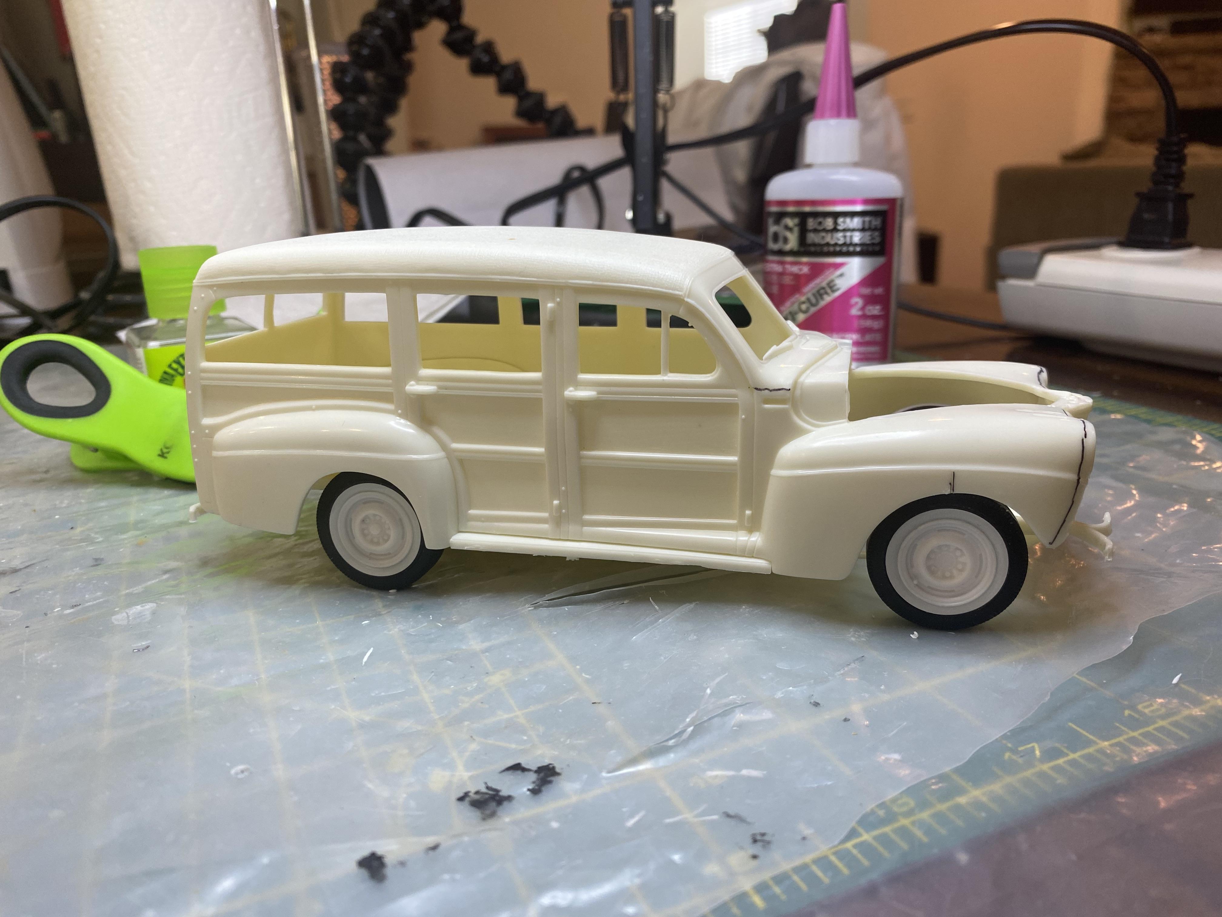

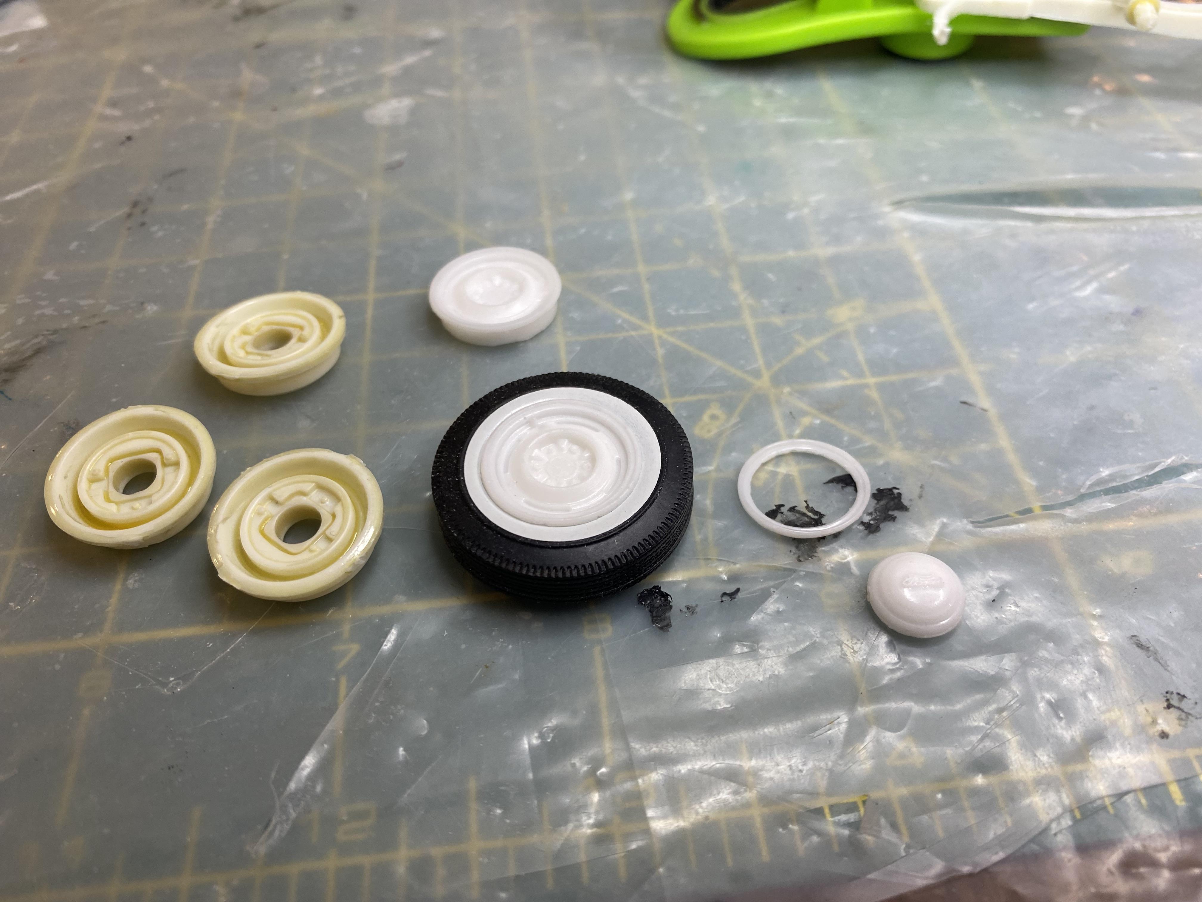

I cast some steelies and trim rings from the 1950 Chevy pickup and hub caps from the spare. Pad printed wide whites to round off the period look.
OMG the stance out of the box is terrible! Corrected with a bit of a “California Rake” look to give it the period correct stance.

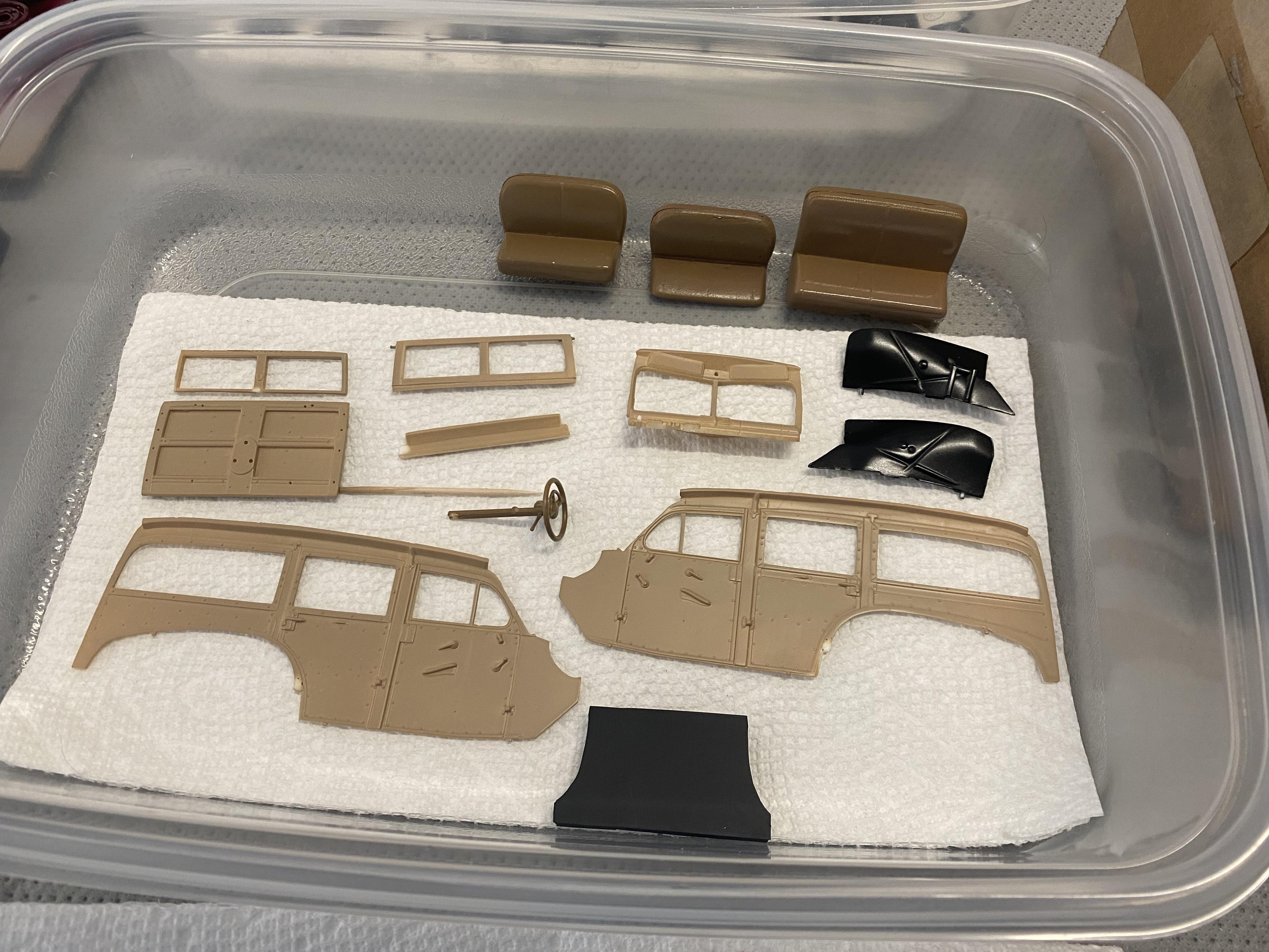

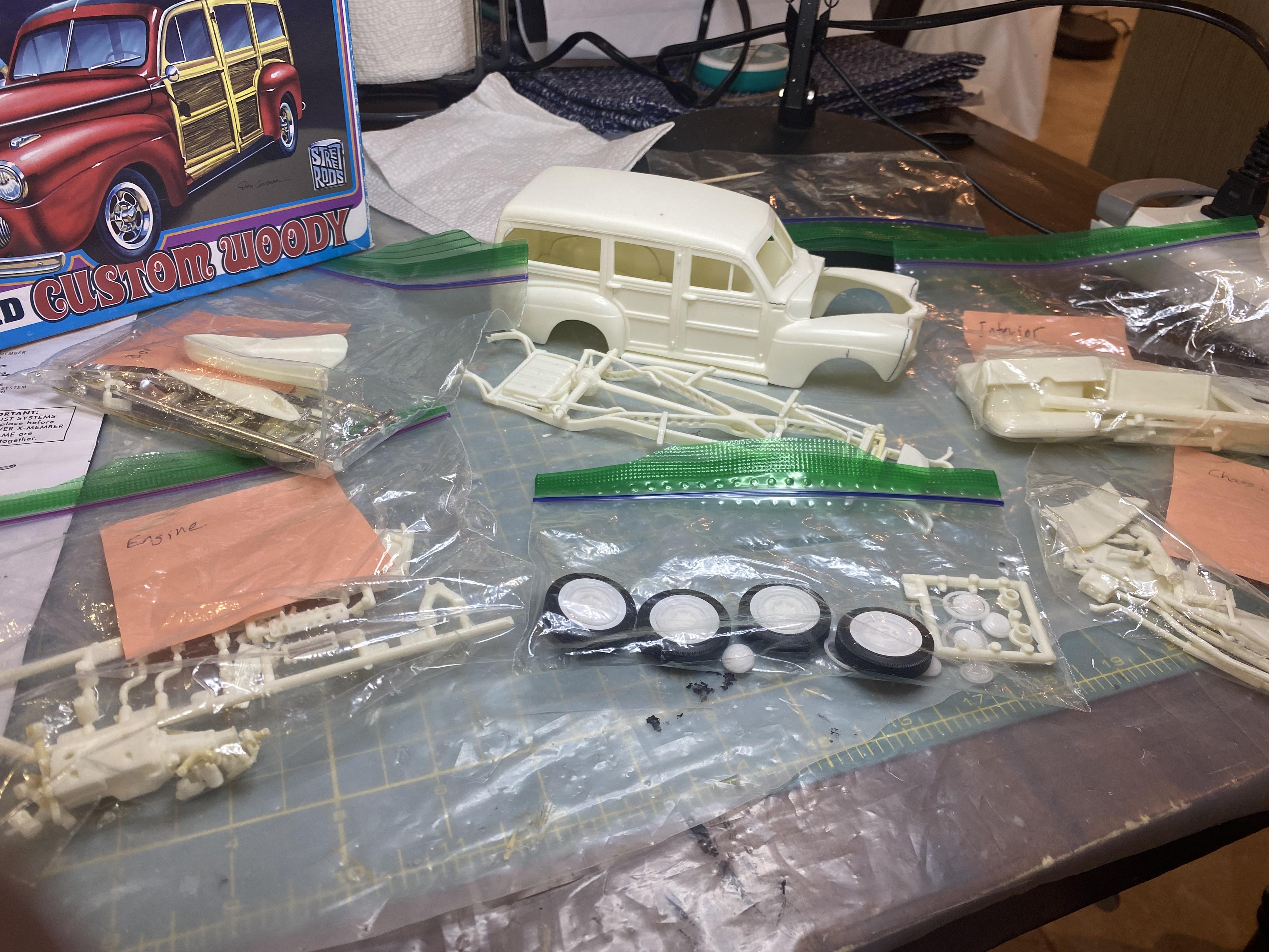

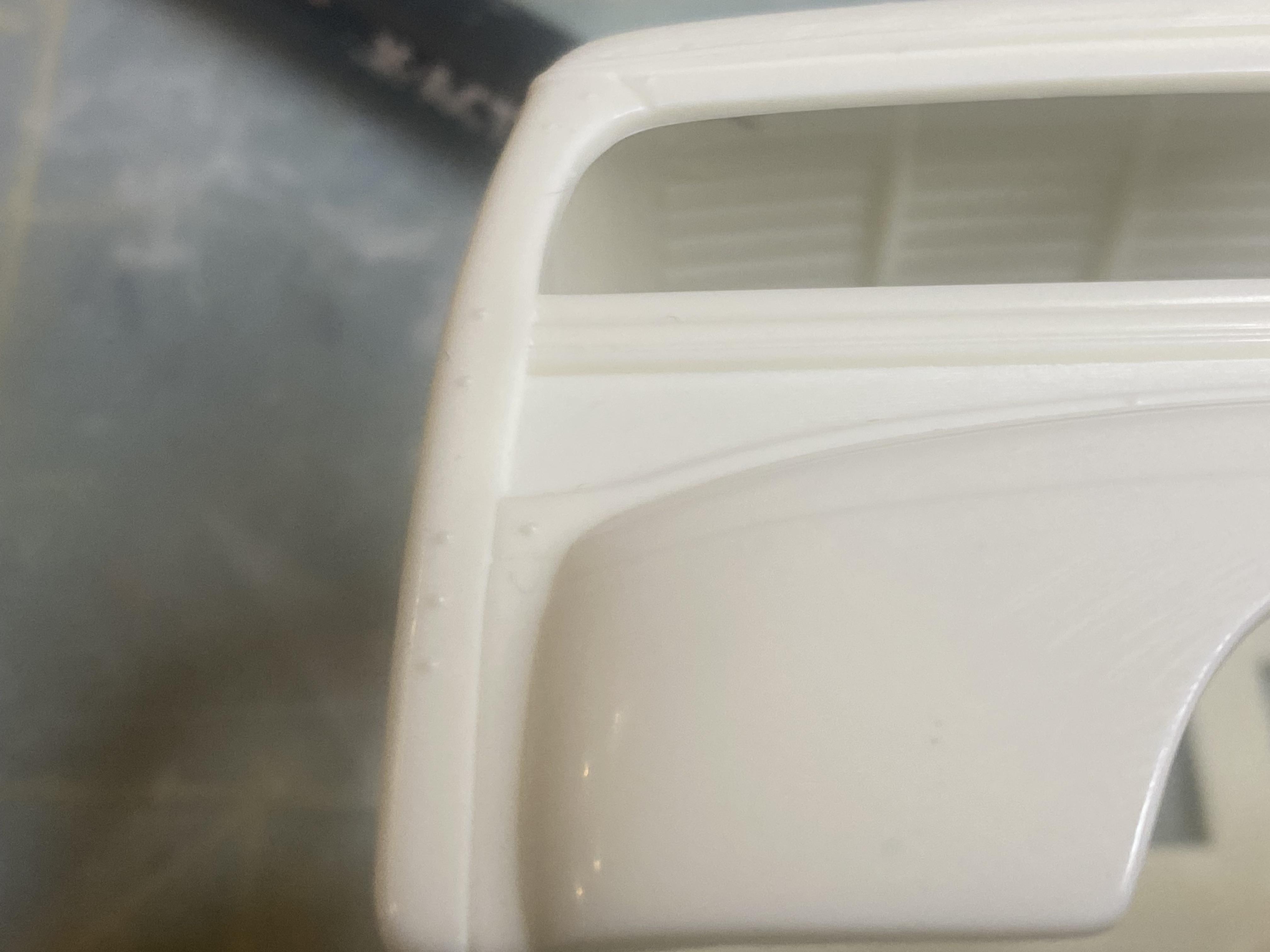

assembled components and bagged per section. This kit had so much flash and heavy spruce connections.

Thanks. I have the Revell 48 Ford woody kit but I haven’t built it yet to compare myself. So far this kit seems pretty decent. You can tell the mold was getting old by this time, there is a lot of fairly thick flash on every sprue tree.
I’m surprised there is so much flash.  The original came out in 1999, which by my standards is not that old ?. This version is 2015.  I have the original versions stashed away, I’ll have to see how that one looks.
  • Like 1
Interesting. I haven't had it any worst on rereleases before. They must have used it a lot in a short time. Nothing hard to cleanup so not a biggy.

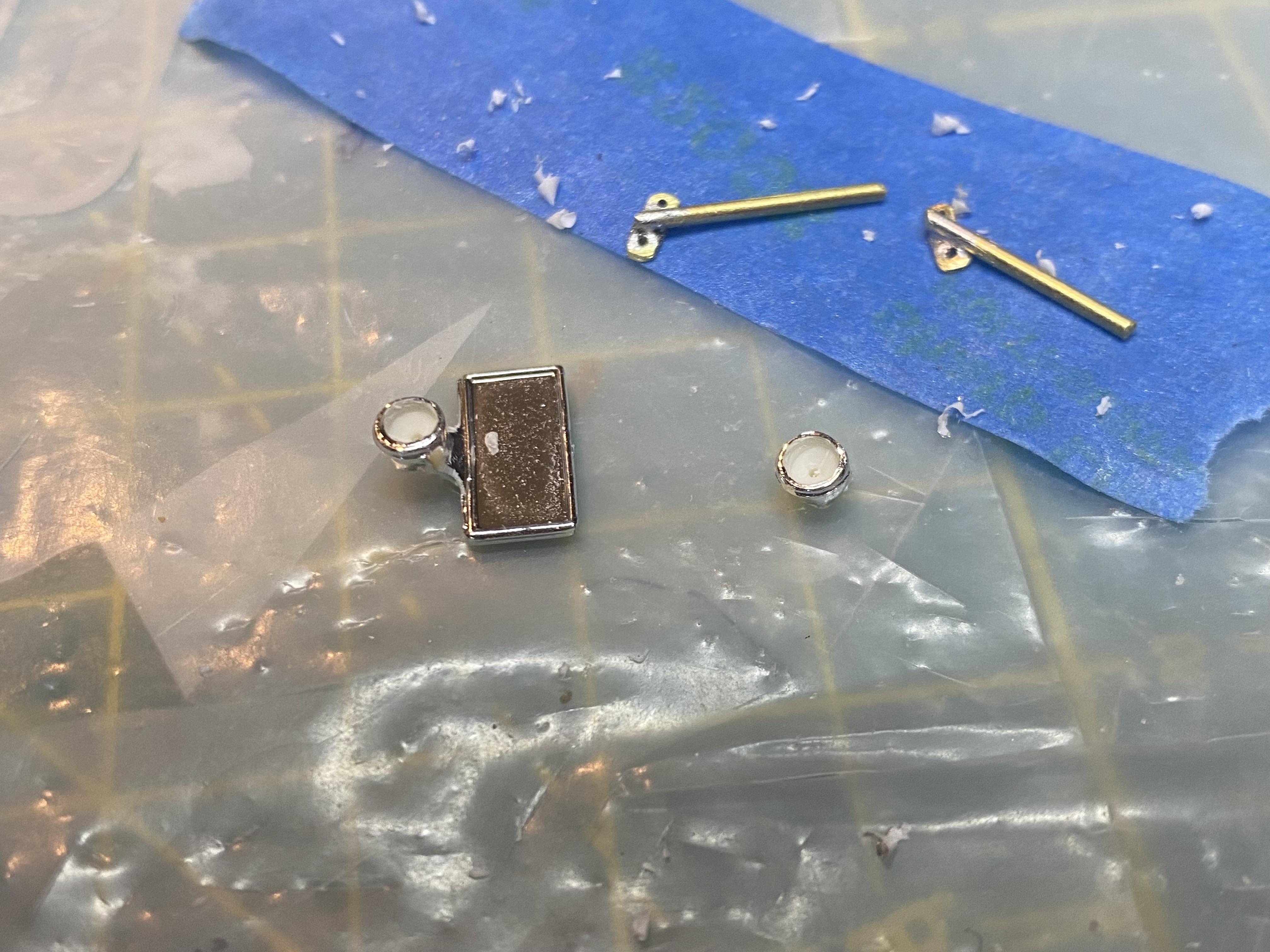

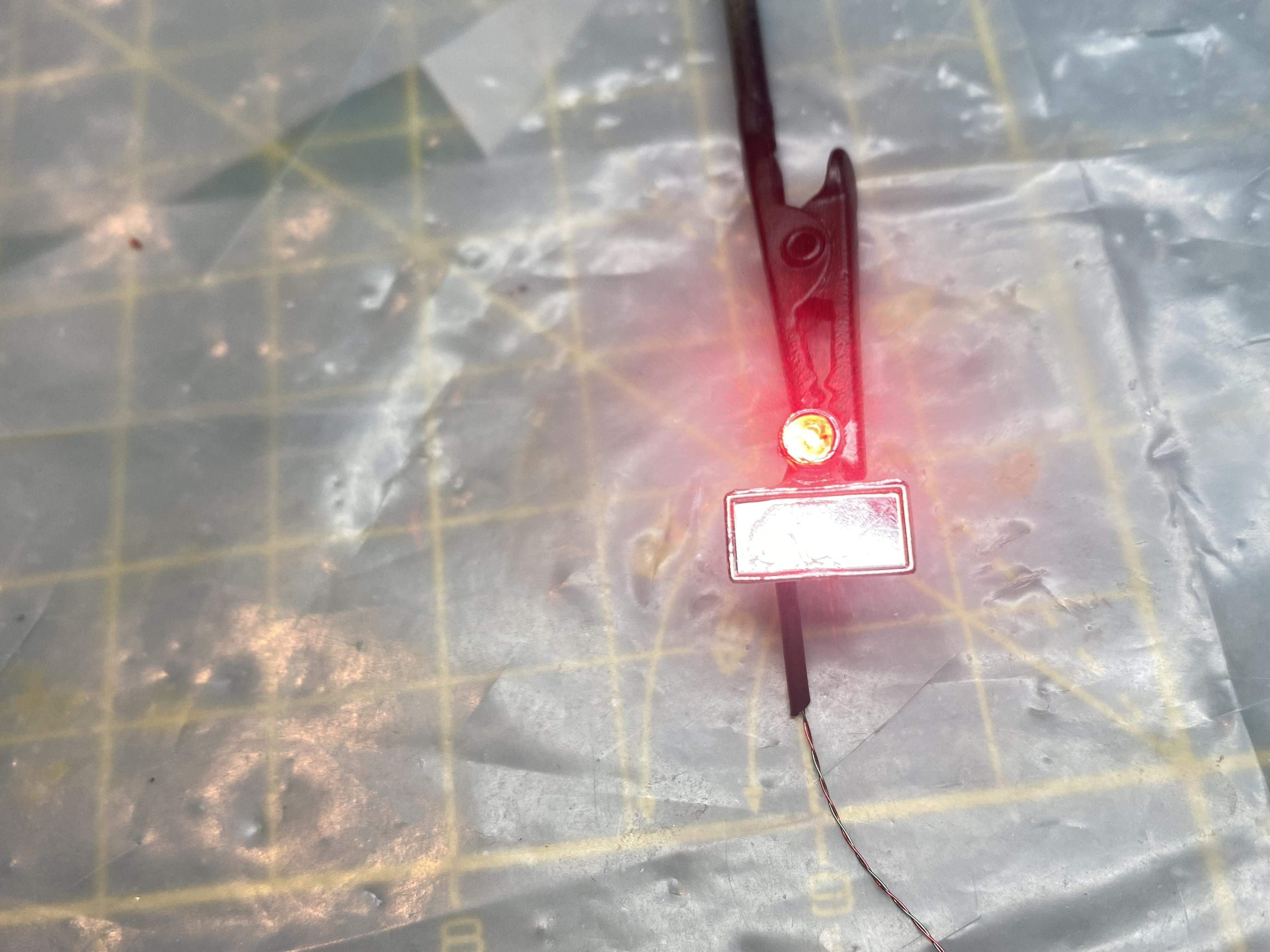

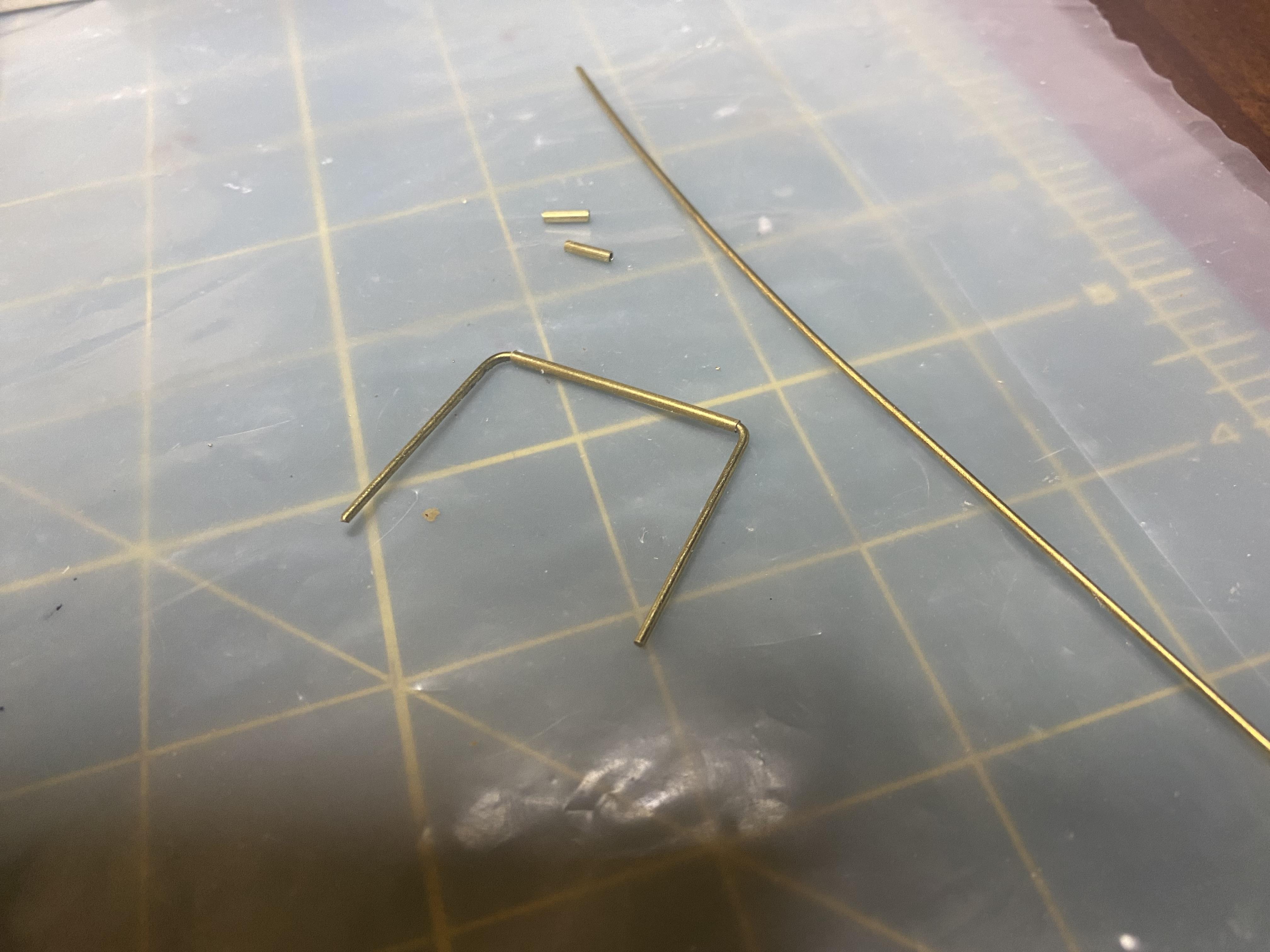

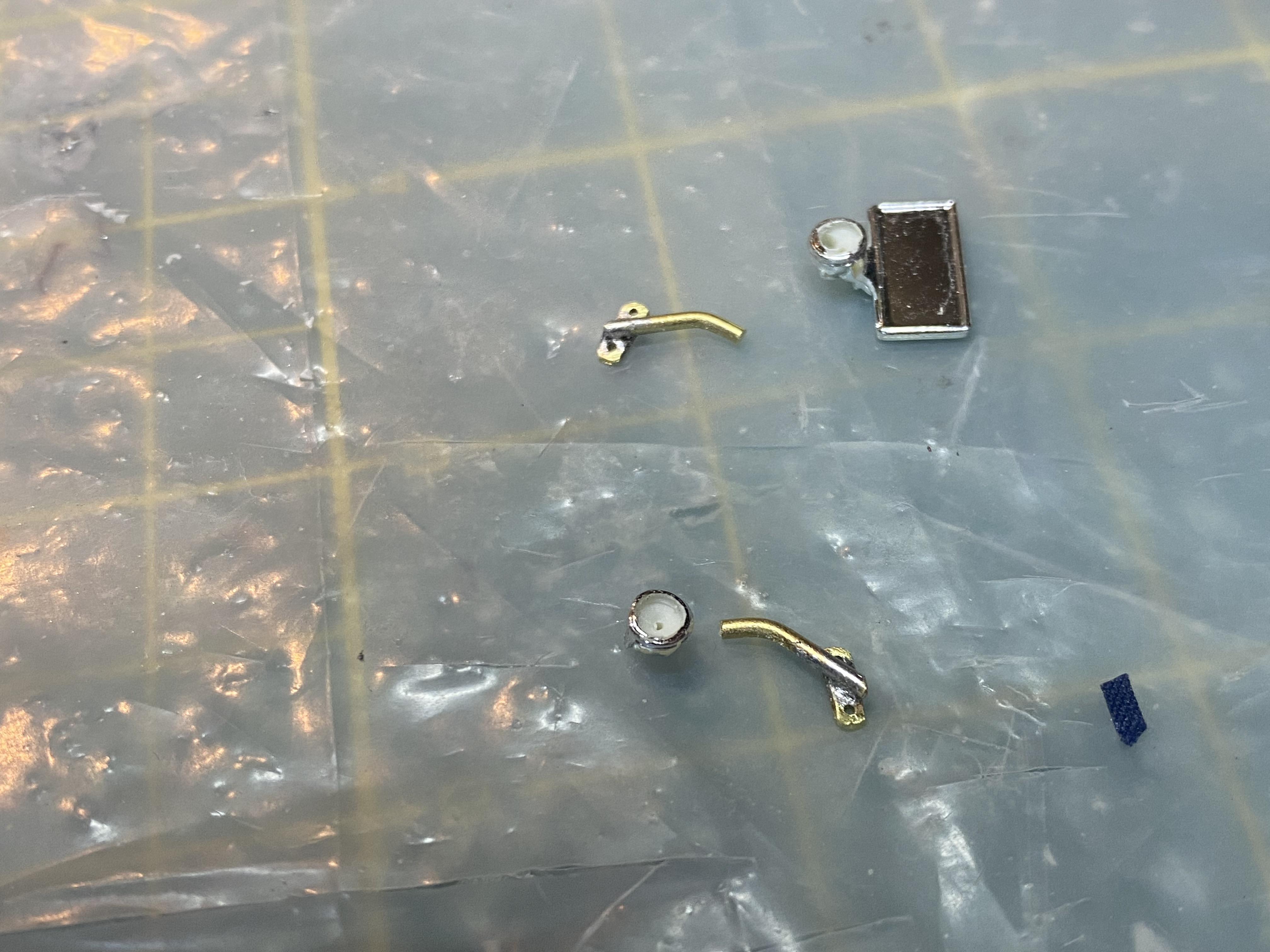

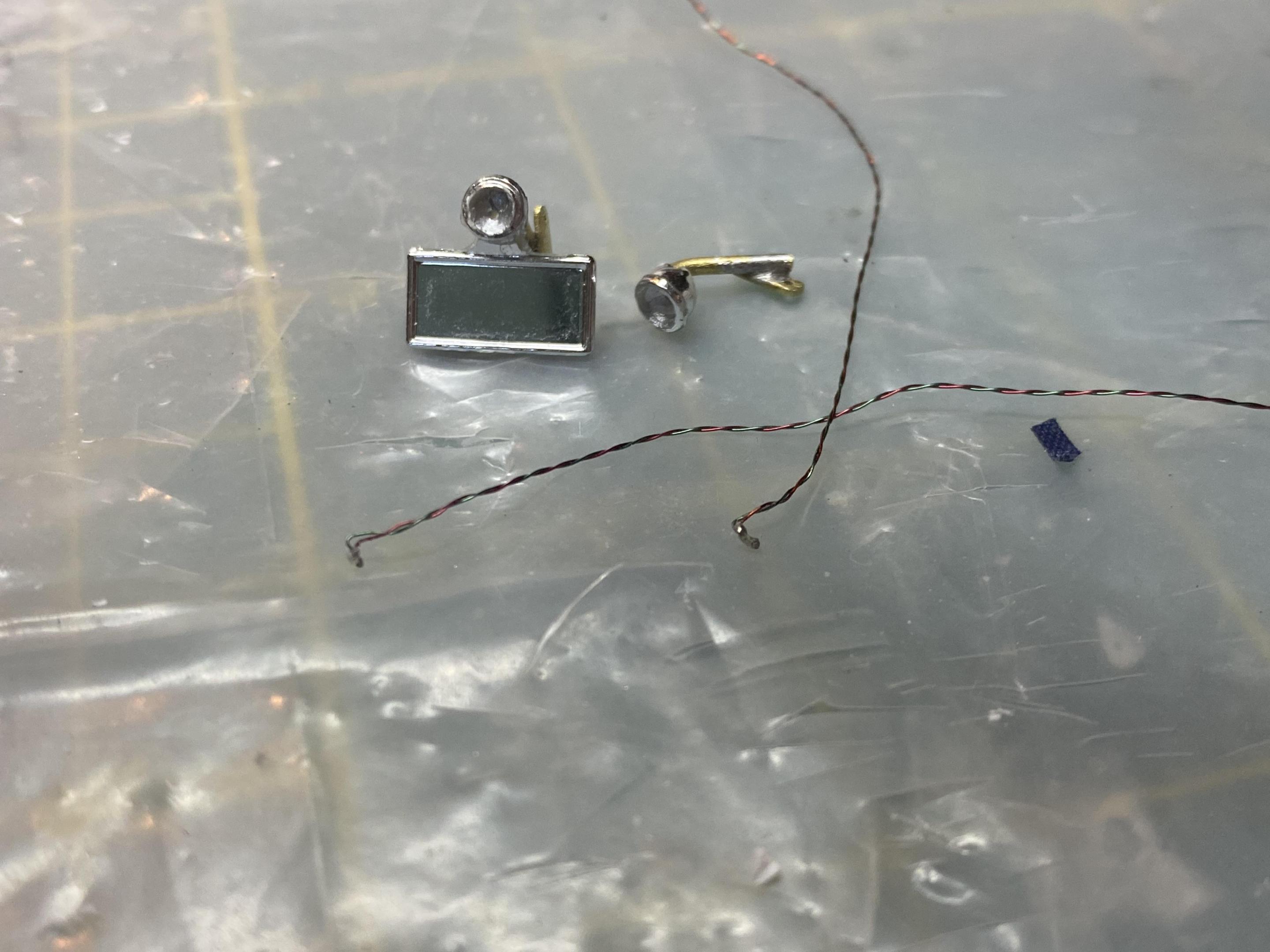

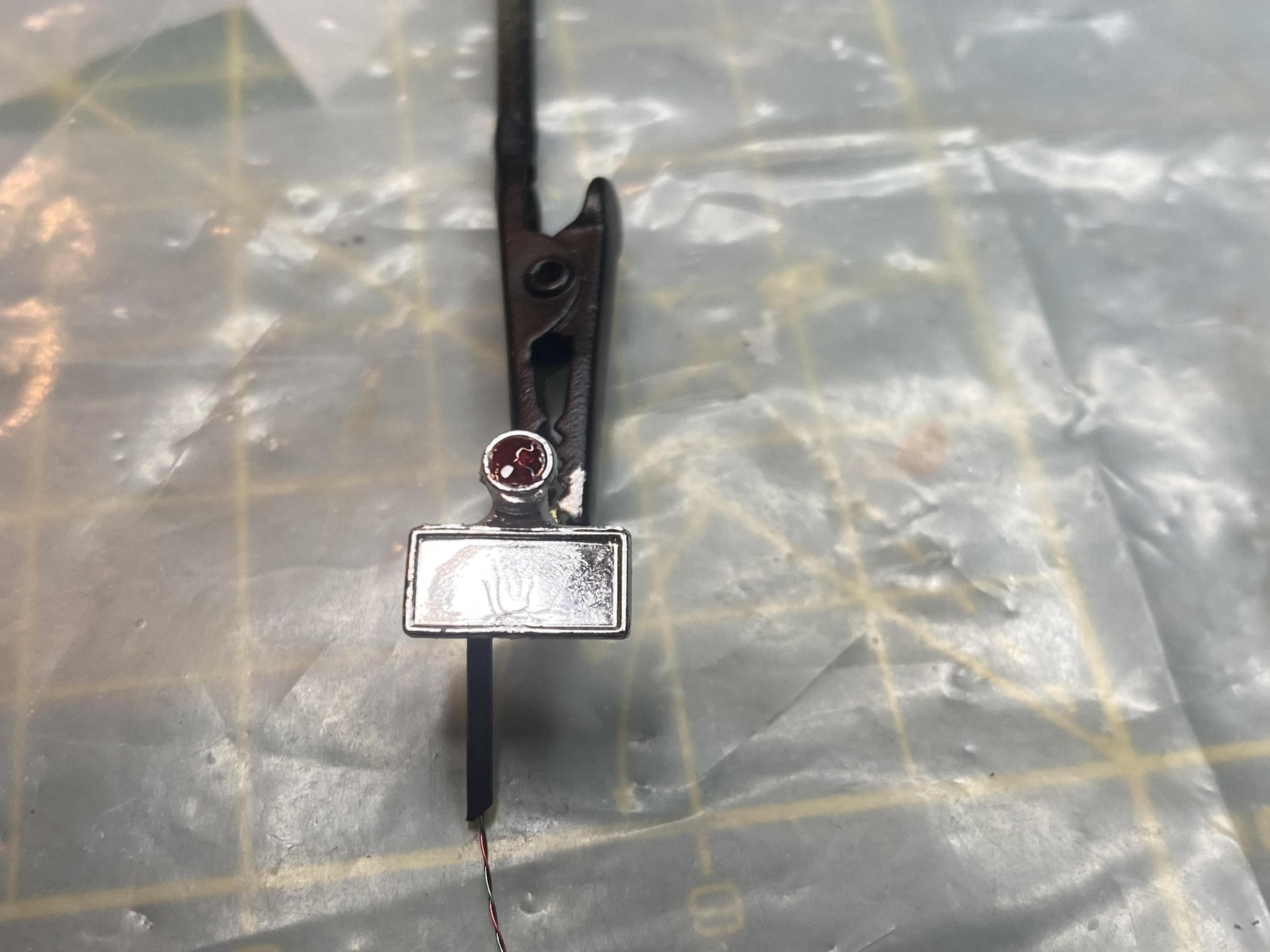

My thumb is starting to get better but still have to take it easy. I did get the taillights created. I smashed some brass rod and drilled for the mounting and soldered rod to It. I drilled out the kit taillights for pico LEDs and wiring. I also drilled for the brackets. Then installed the pico LEDs and added clear UV resin lenses and painted Tamiya clear red. Added the wire covering and tested.
IMG_5552.thumb.jpeg.c9f709a7b05f7fdbceb09ad003a3d71e.jpegIMG_5553.thumb.jpeg.b3b5f23413e8e67f90fdd6f5a6bfc89e.jpegIMG_5554.thumb.jpeg.e3414863bf2354199b15d0e4e70f677b.jpegIMG_5555.thumb.jpeg.601e55a6149e9f87d09ad077e6449cbd.jpegIMG_5557.thumb.jpeg.fcd8f4010351aab9af17db8ddfb09855.jpeg
this is the look I am going for.

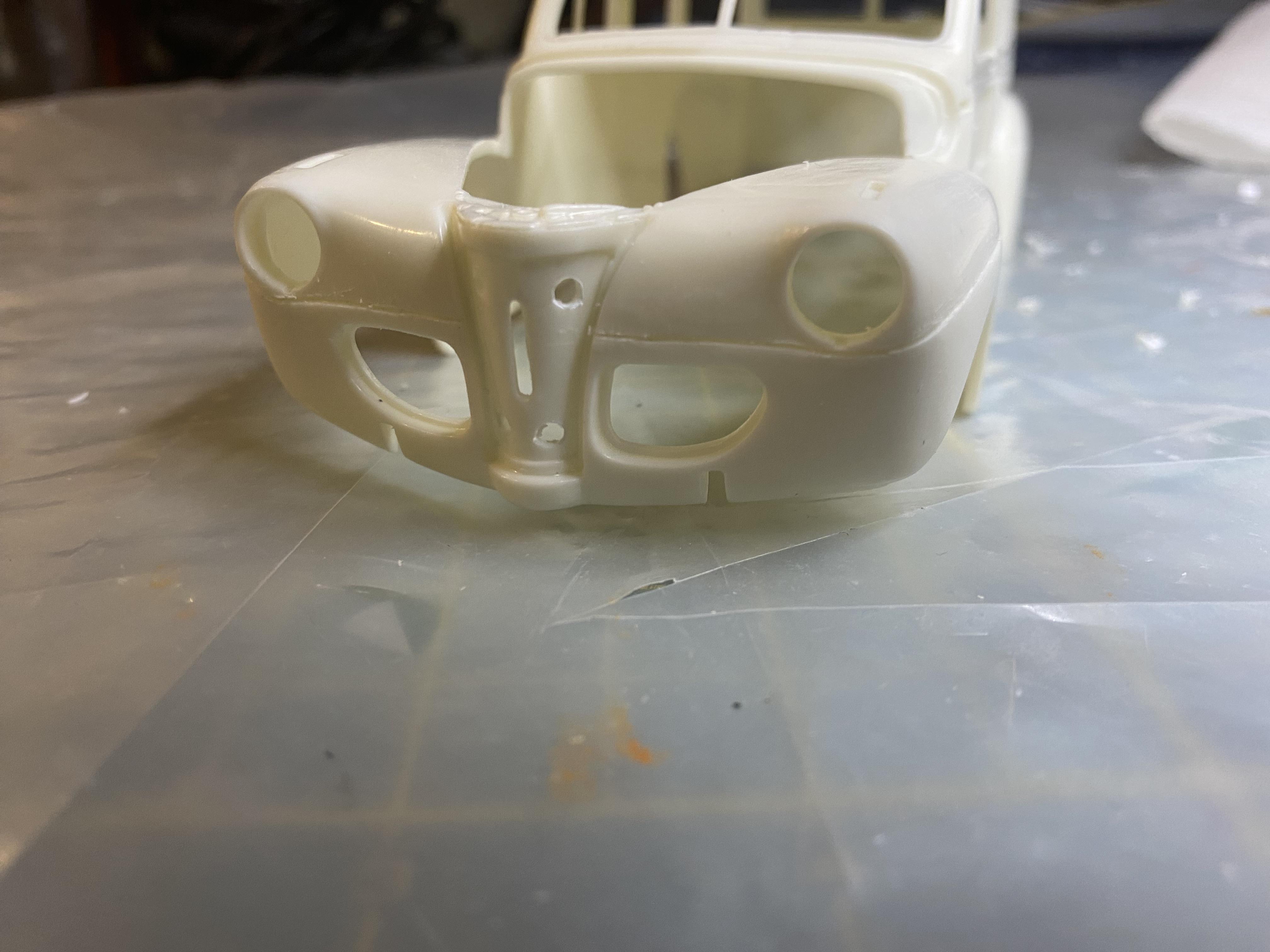

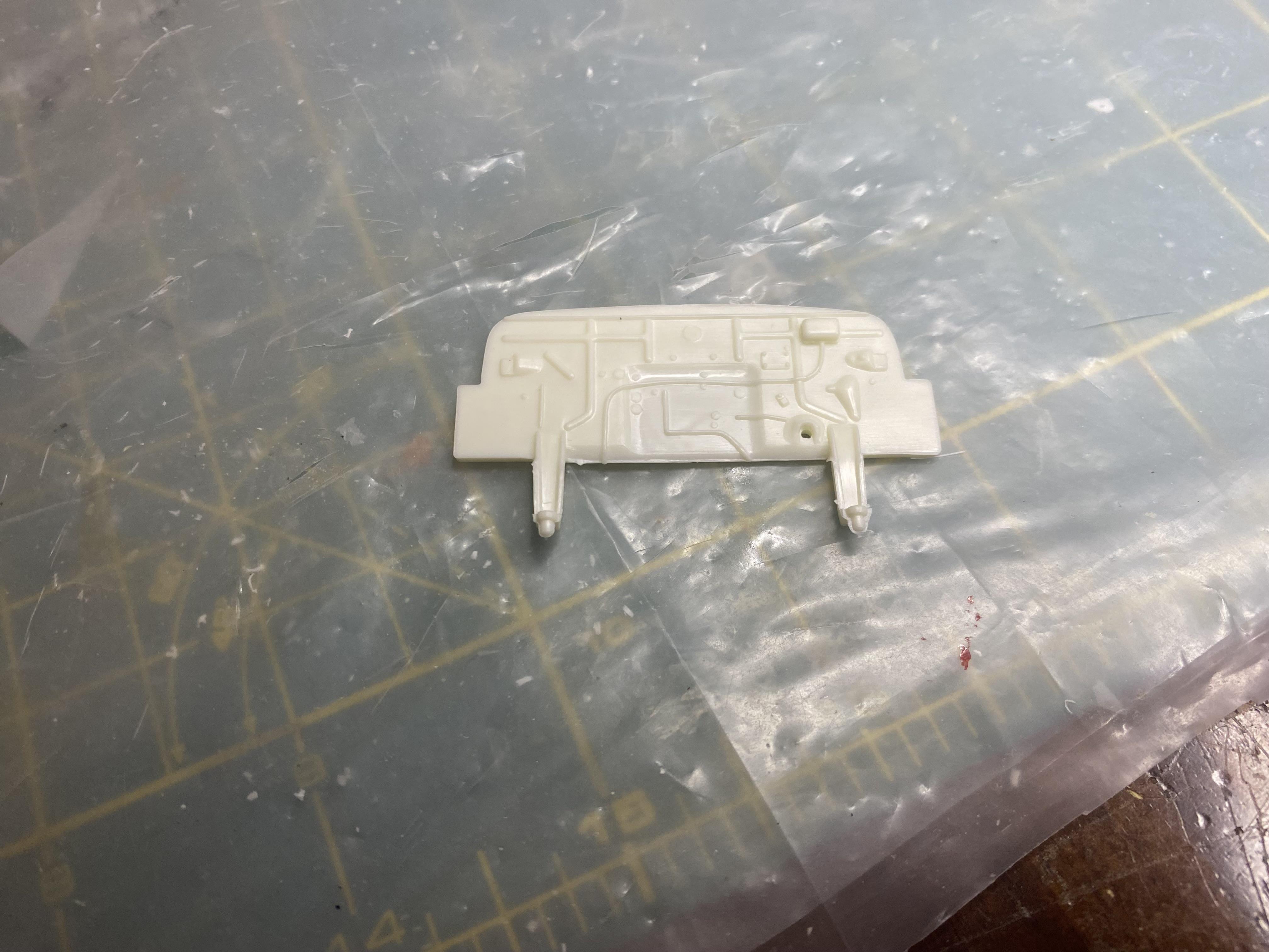

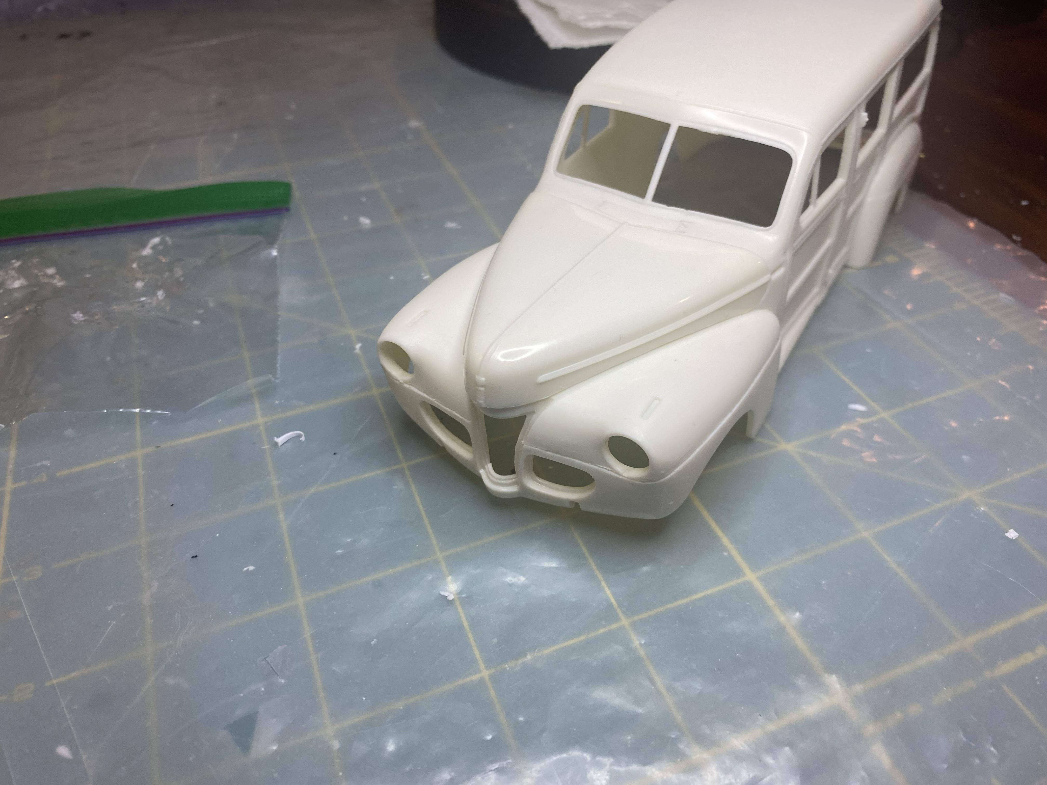

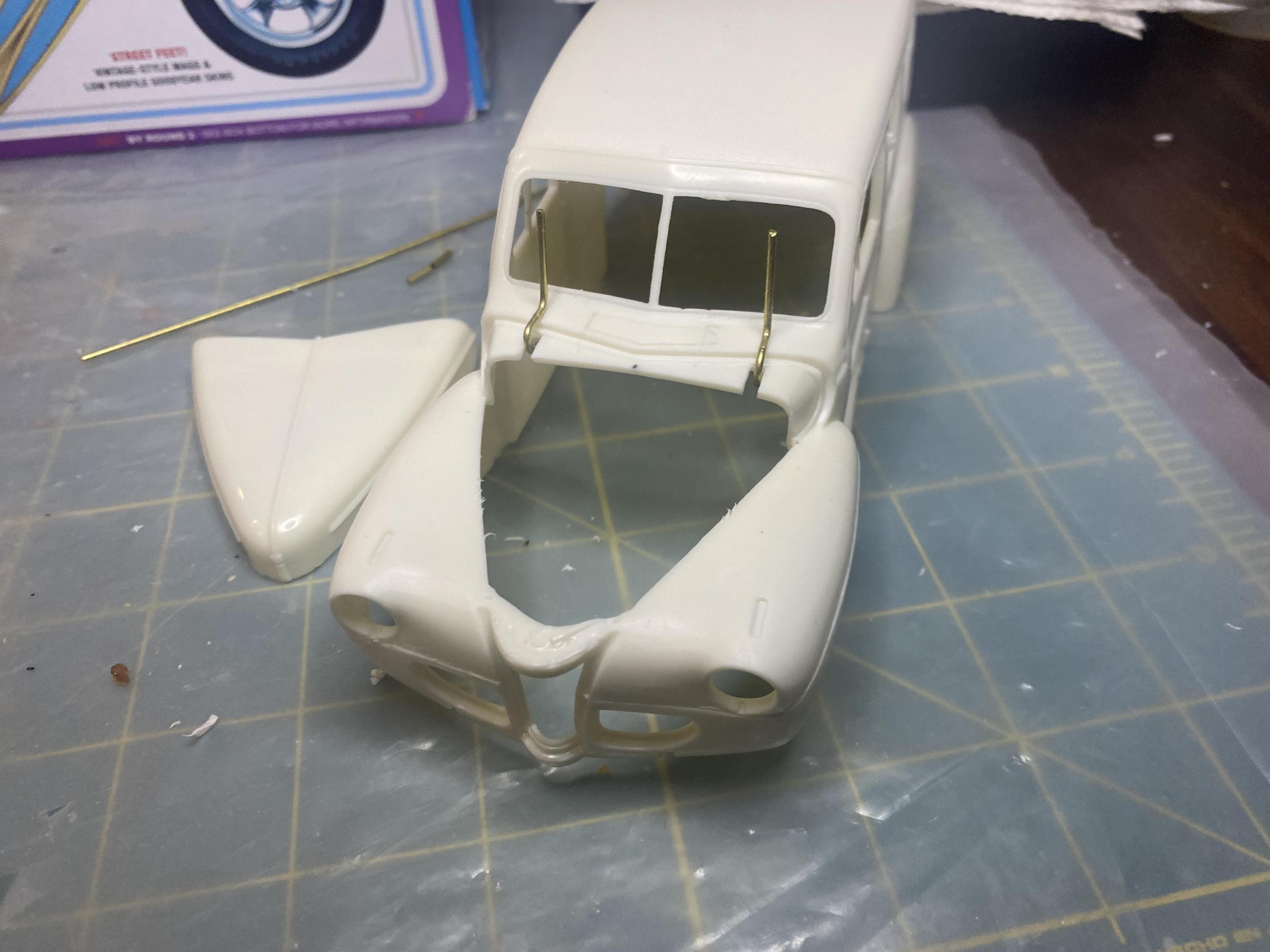

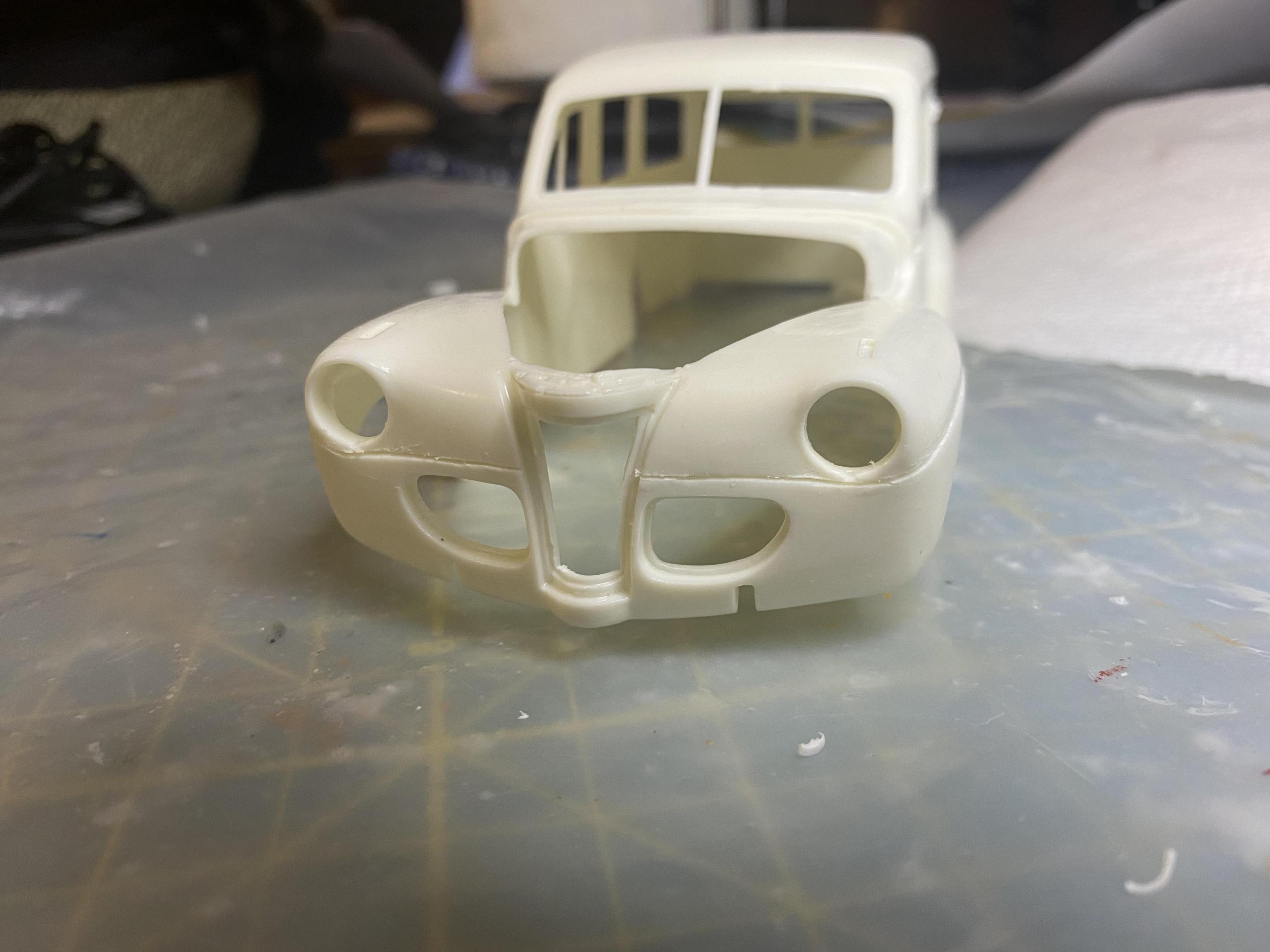

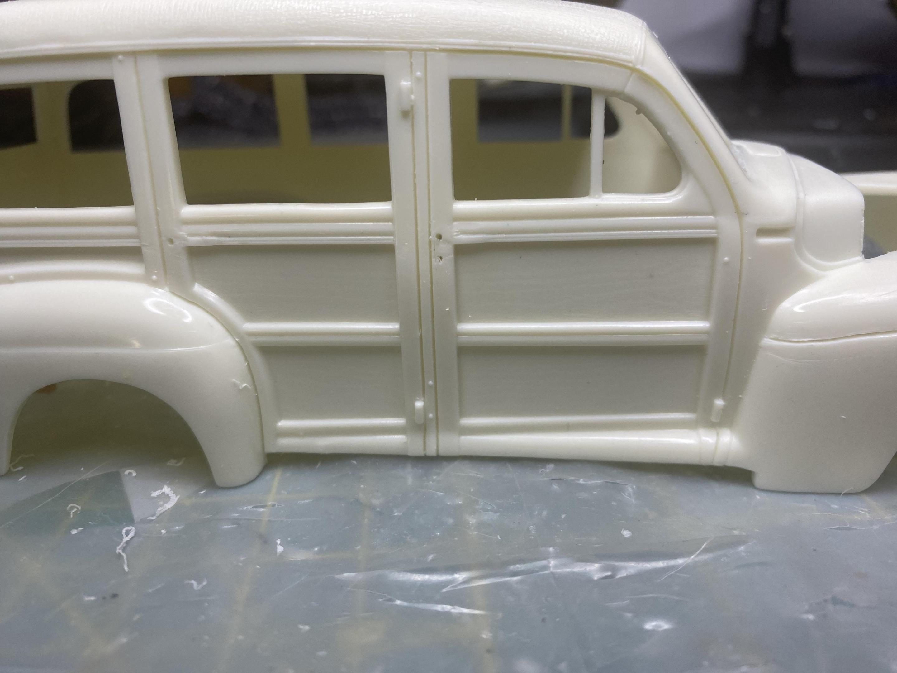

I have gotten a little more work done mostly on the body.

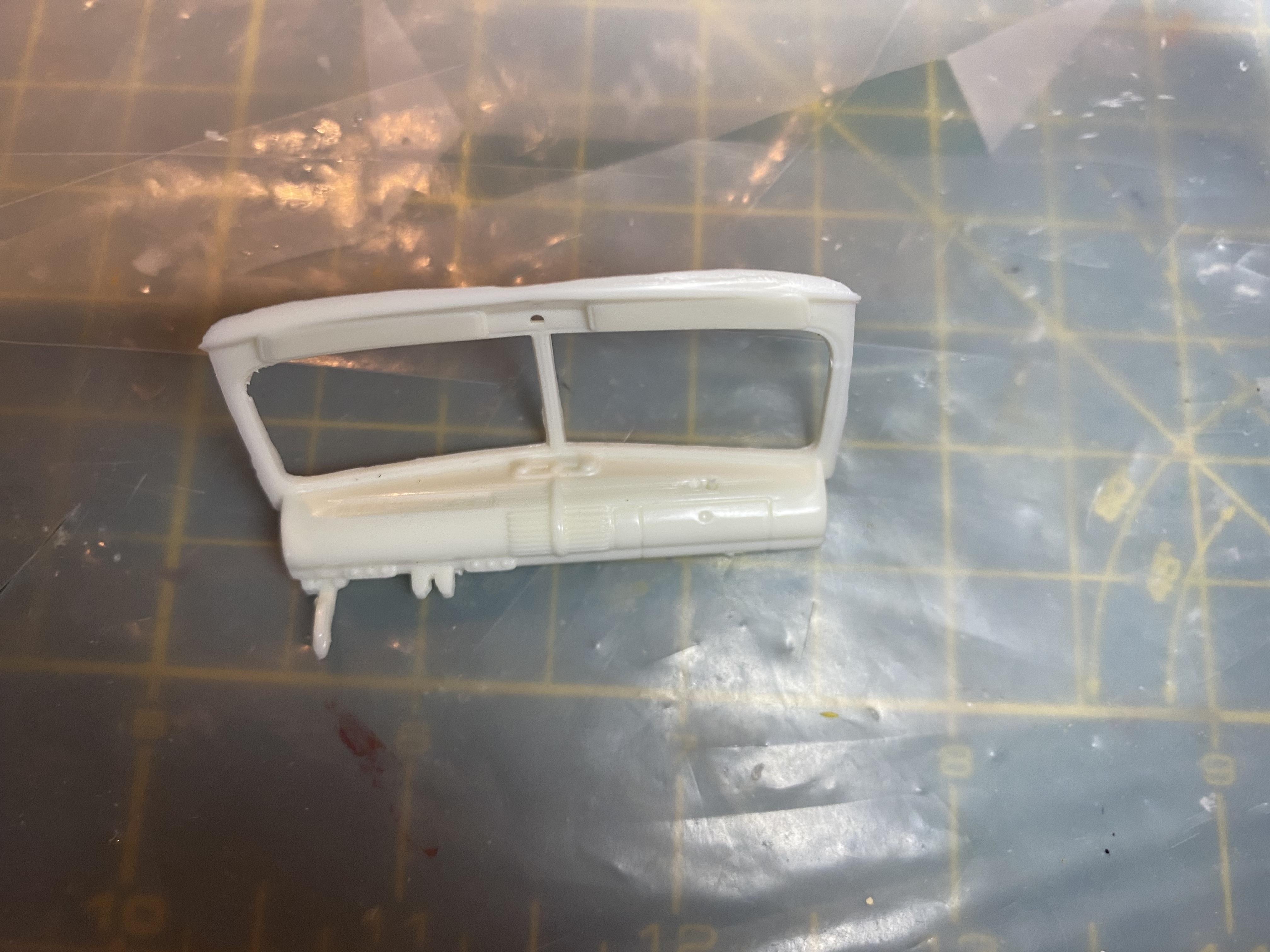

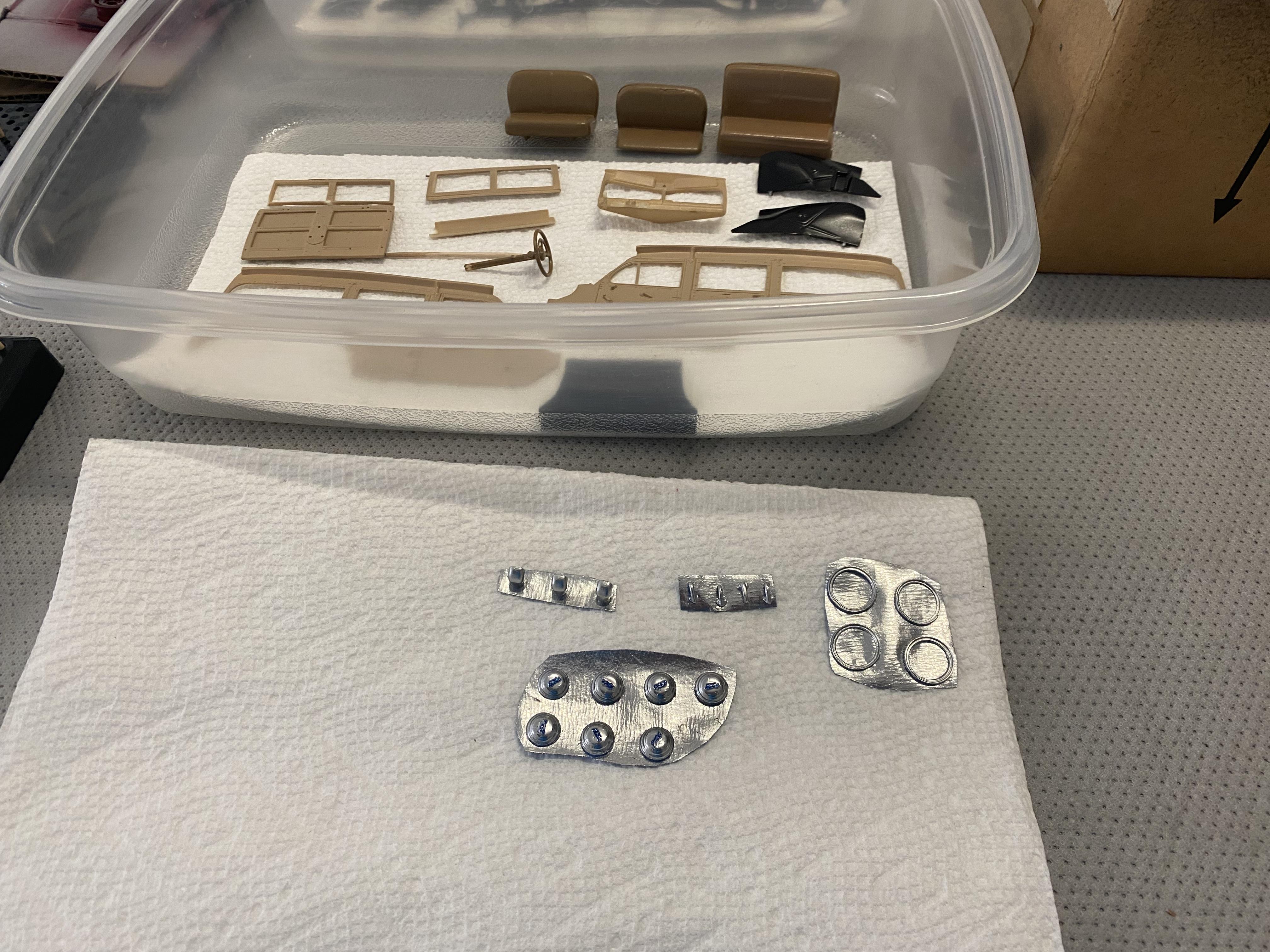

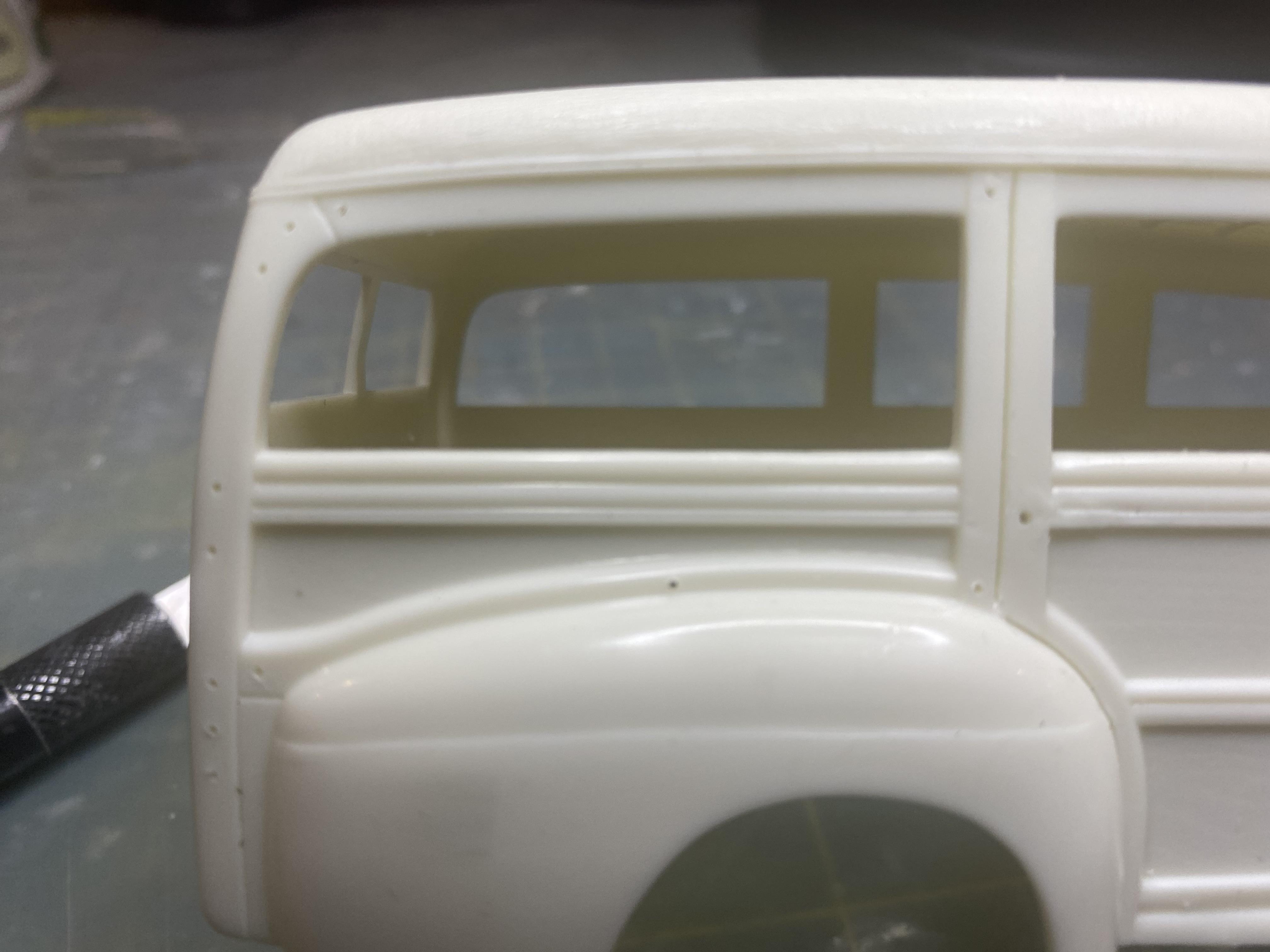

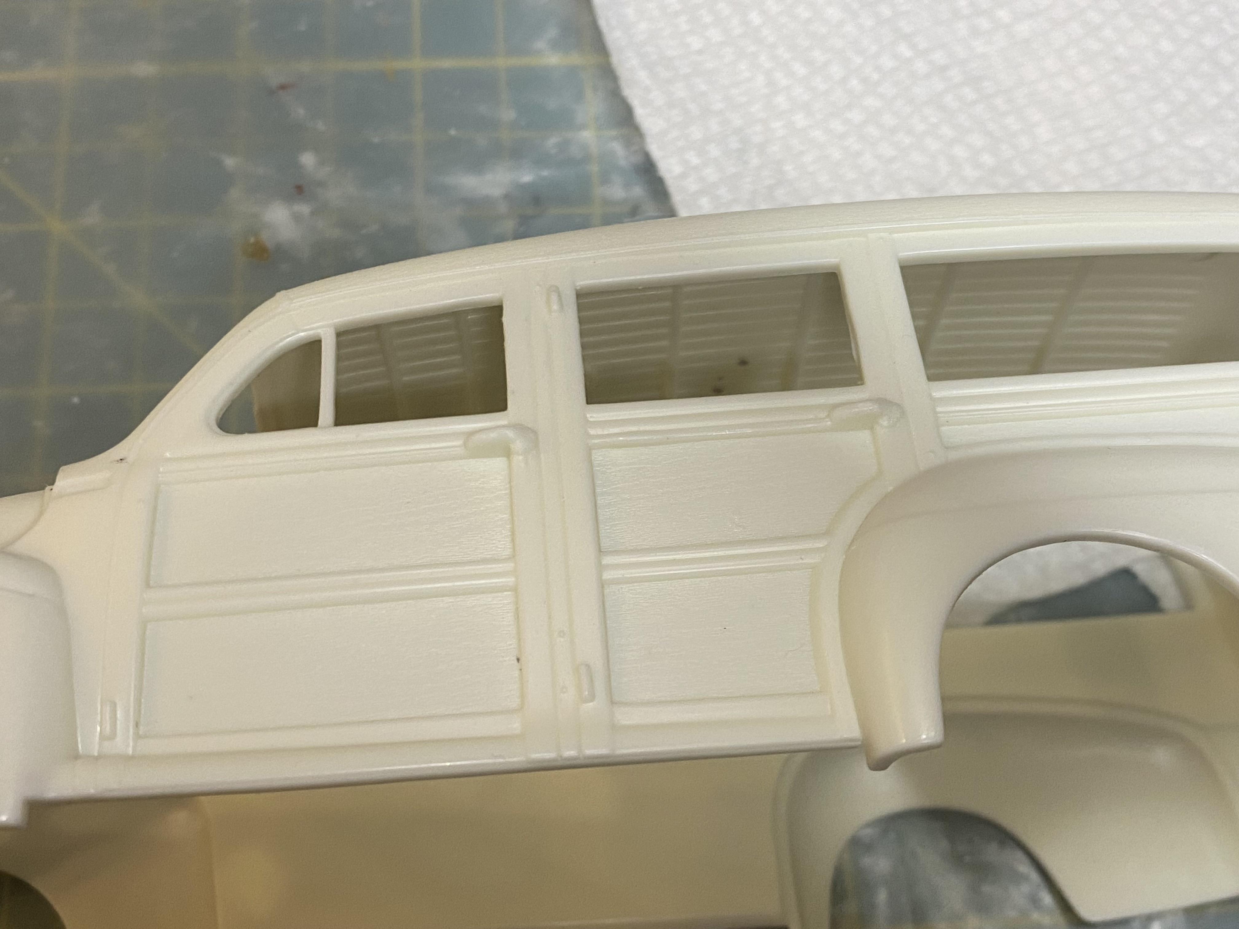

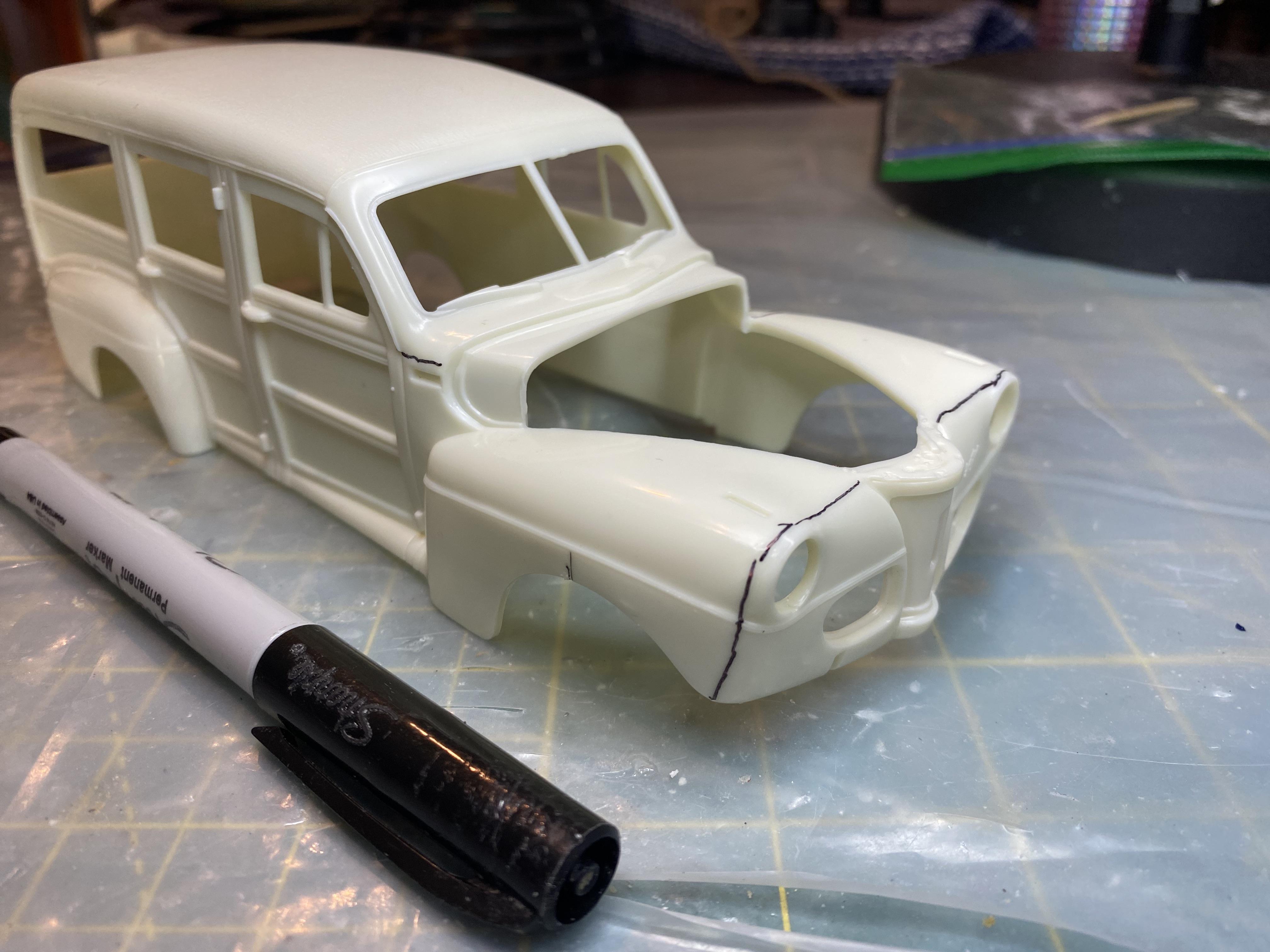

i removed the molded wiper and door handles and etched the vent deeper. I removed the molded in firewall wiring that will get actual wiring during detailing.
 IMG_5573.thumb.jpeg.266f077263d6bc2f50682209aa83919d.jpegIMG_5574.thumb.jpeg.33ecfa1879ba45f729914853f4a7ab85.jpegIMG_5575.thumb.jpeg.d37e36e4c94e10f5895e91b1707fad92.jpegIMG_5576.thumb.jpeg.4472a67046540ae585f200c1e8d14063.jpegIMG_5577.thumb.jpeg.145437c15cbbe82d15a51dba53f742b2.jpegIMG_5578.thumb.jpeg.5f9017595ffe235639a3fcfcd972444e.jpeg
I created the gauge decals and a few additional surfer decals for the rear windows.

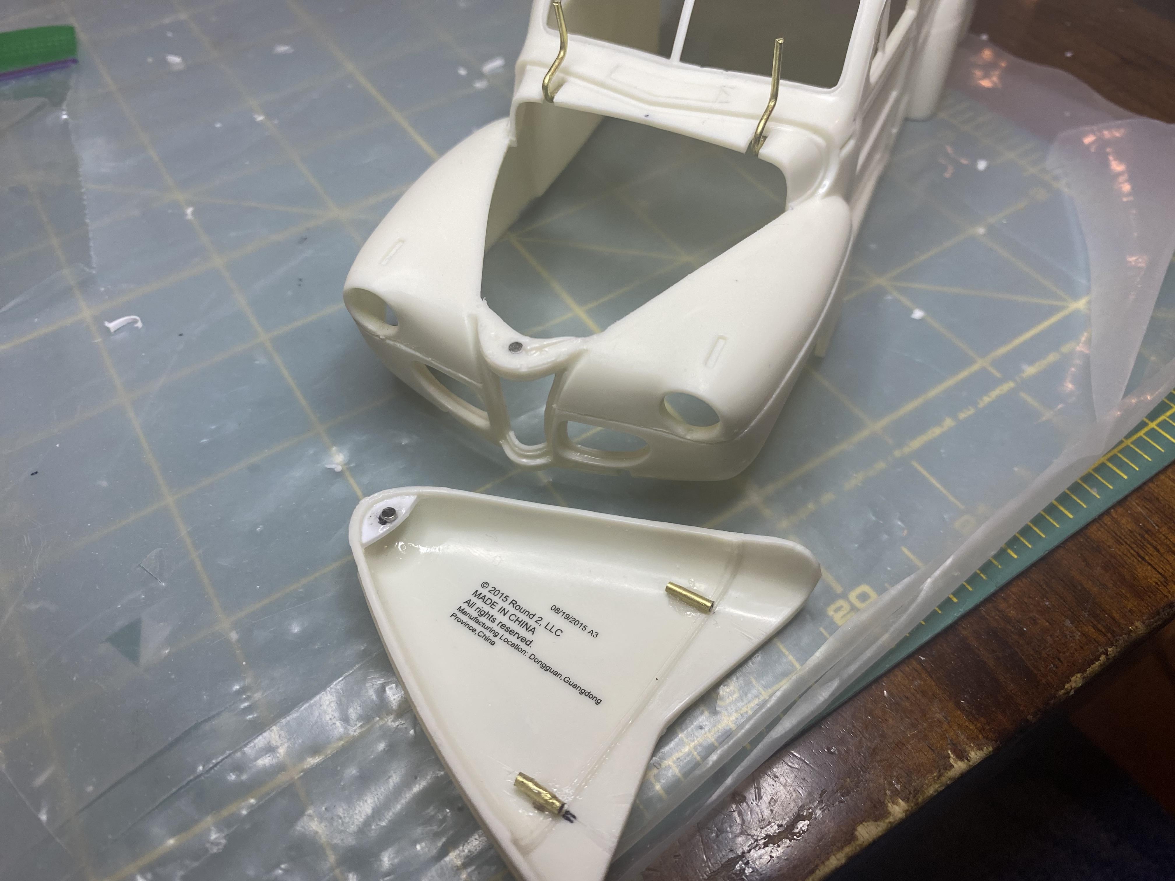

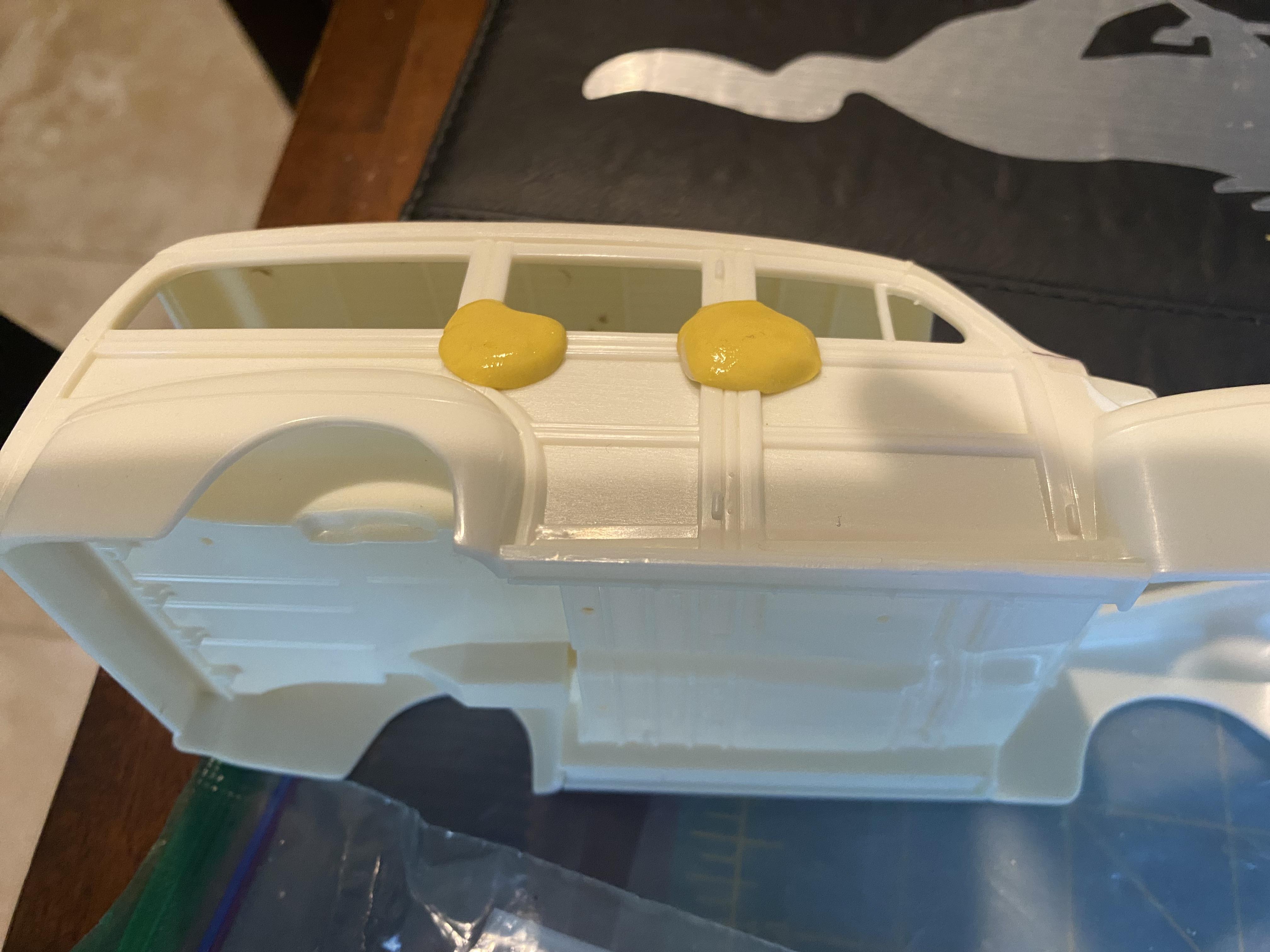

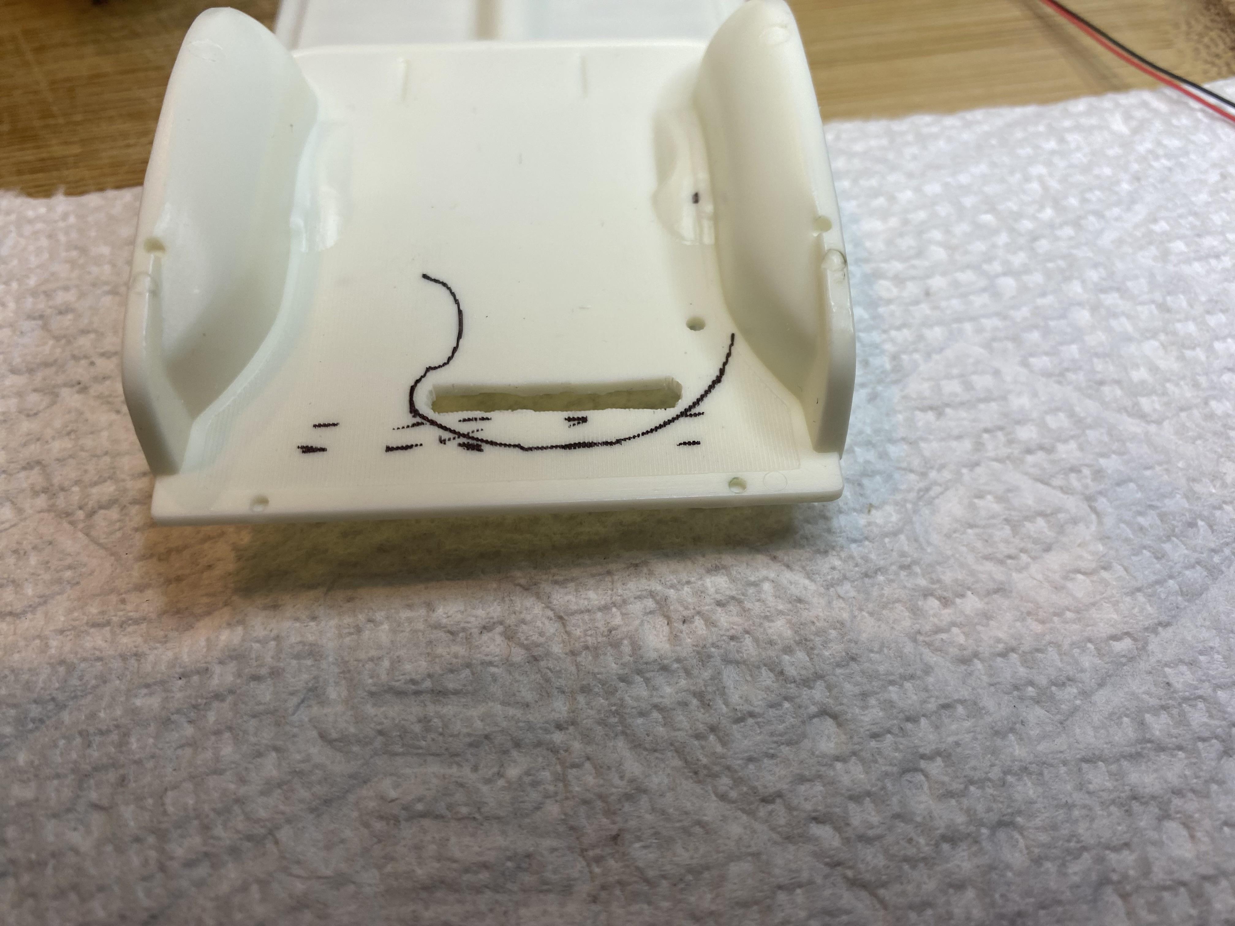

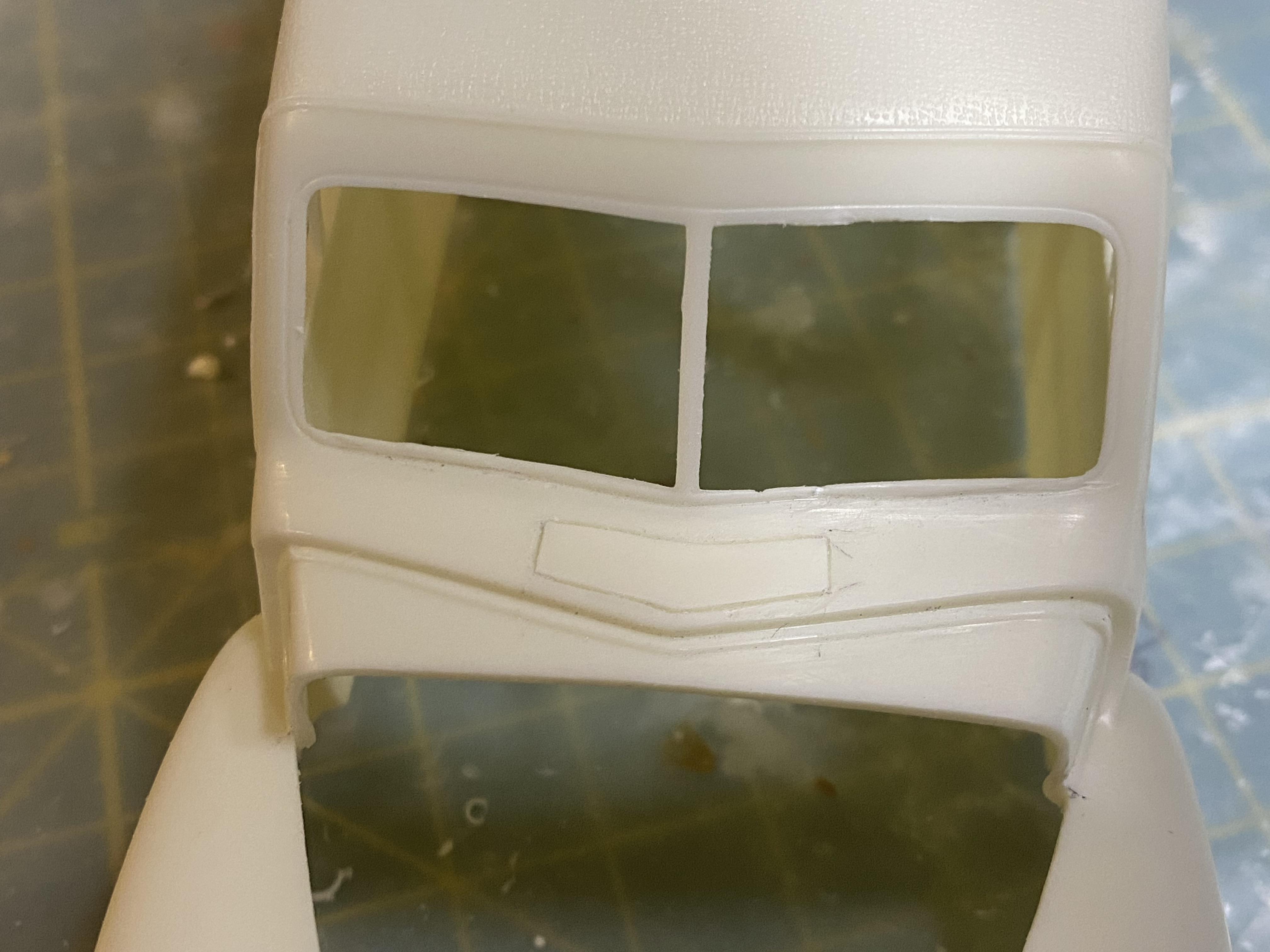

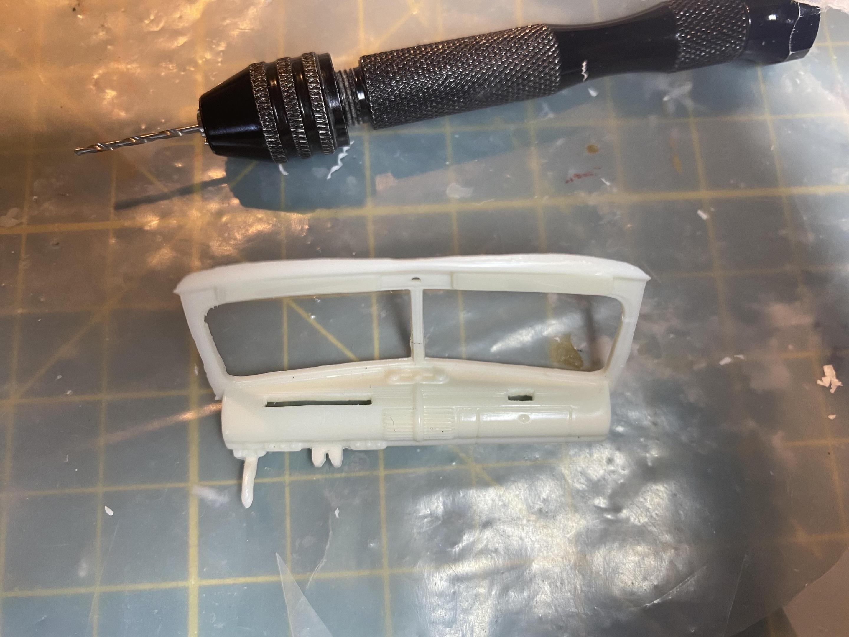

I cut open the grill in prep for being able to see through for depth later. I also etched the door jambs and drilled the wood bolts that will get some top studio rivets to imitate the carriage bolt heads later.
IMG_5579.thumb.jpeg.6d99e8955da72a9e1bac47566b391ed7.jpegIMG_5580.thumb.jpeg.46cbea6845ee397c13e1d992b6c9ff76.jpegIMG_5583.thumb.jpeg.7822526f5d73840aadfee6e0e6467b13.jpegIMG_5584.thumb.jpeg.a151abdc2c9dd97f2baf89268bb22ad5.jpegIMG_5585.thumb.jpeg.f1948d0b487f300d884626dd3fb2be4c.jpegIMG_5586.thumb.jpeg.55f78e9bbb2fe65a5bcbaa9b31e2f033.jpeg

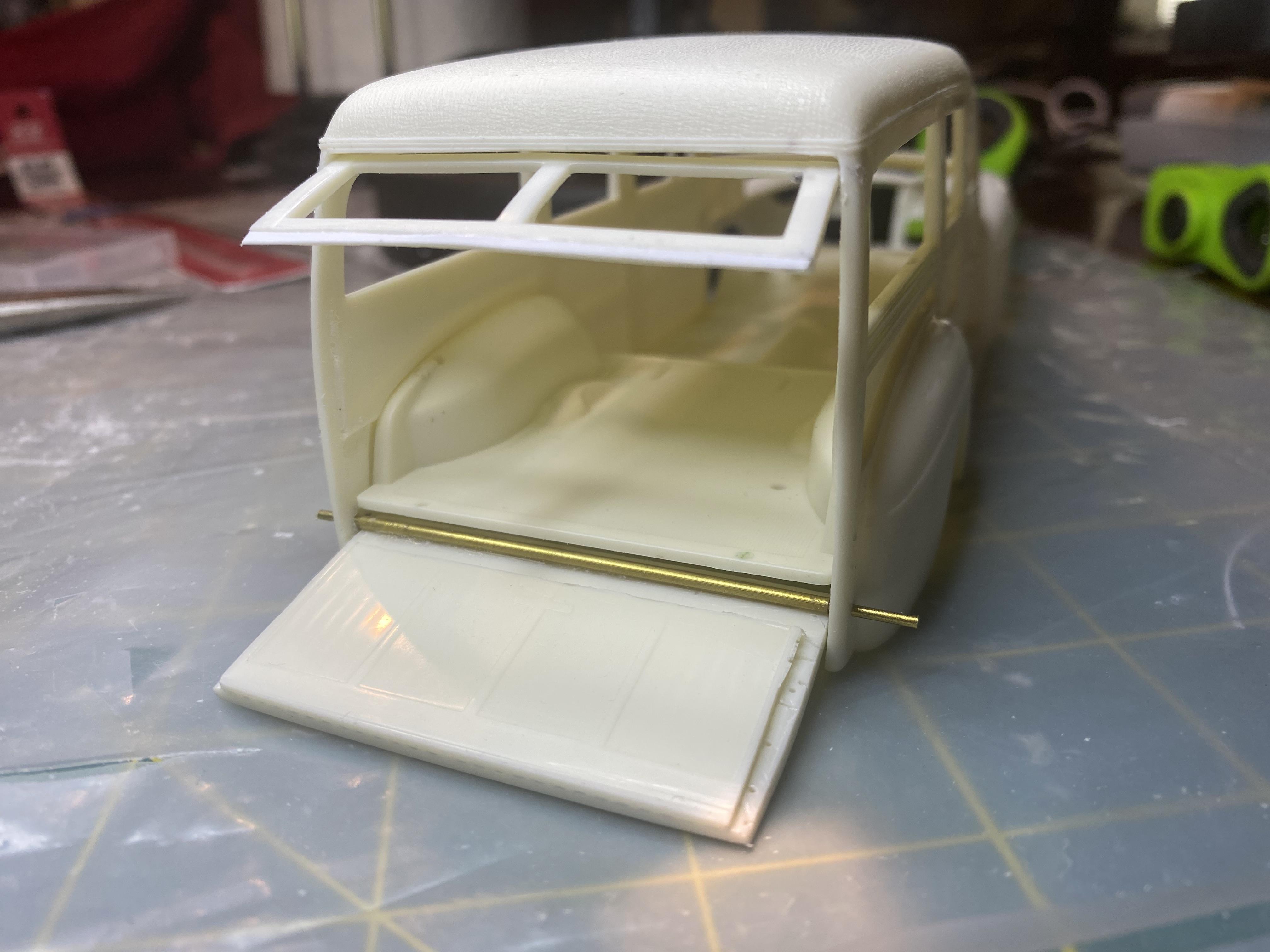

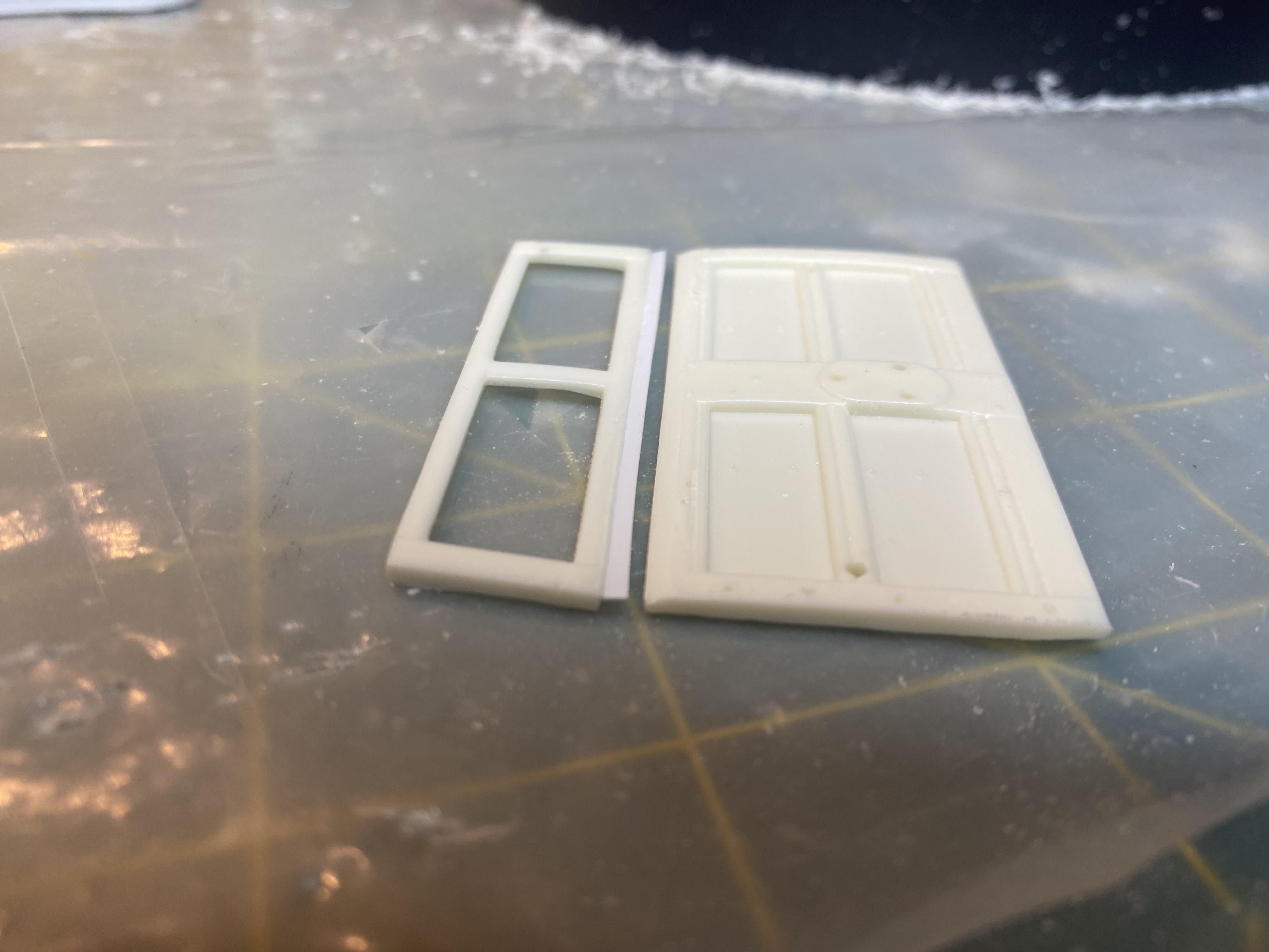

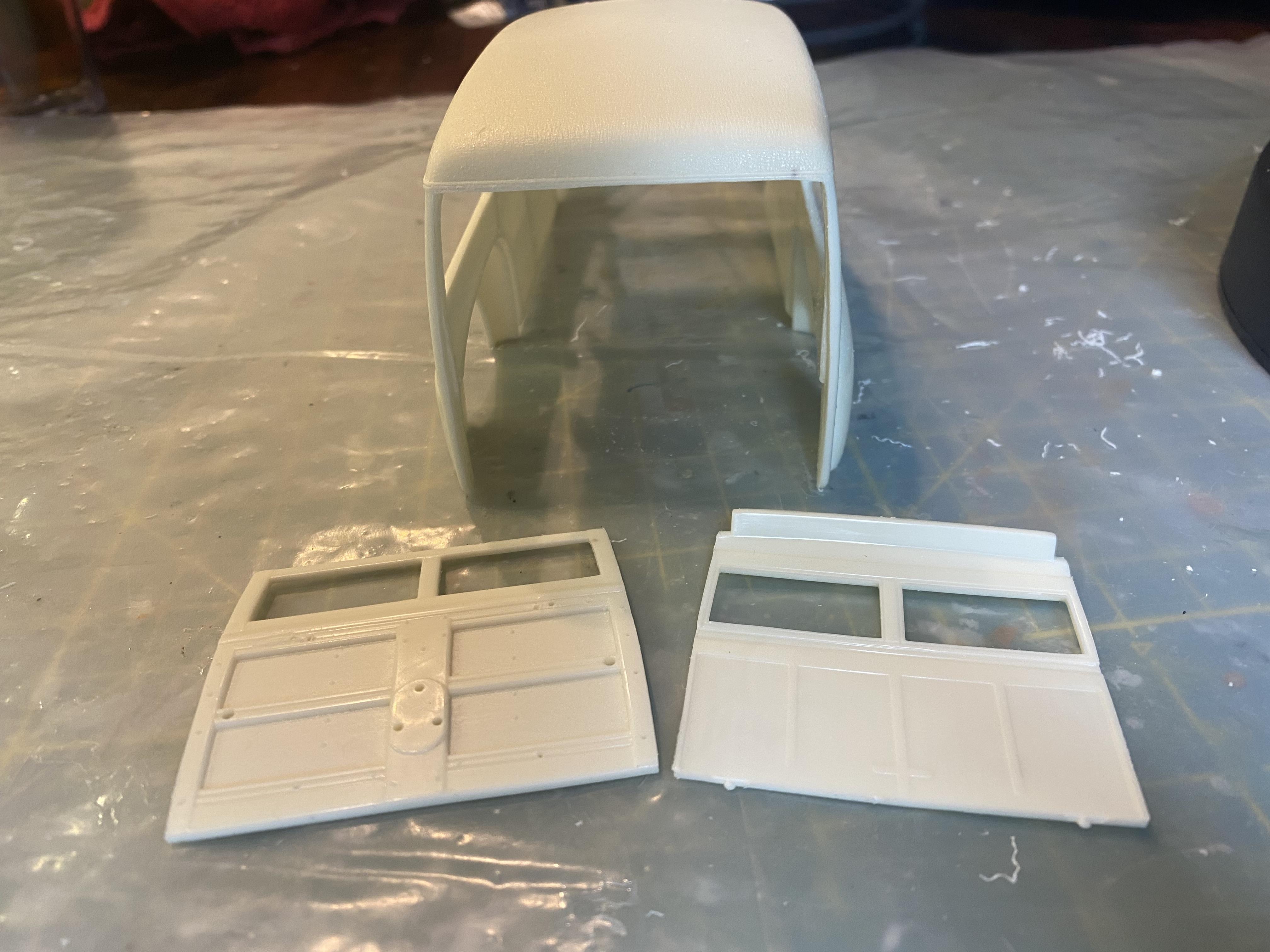

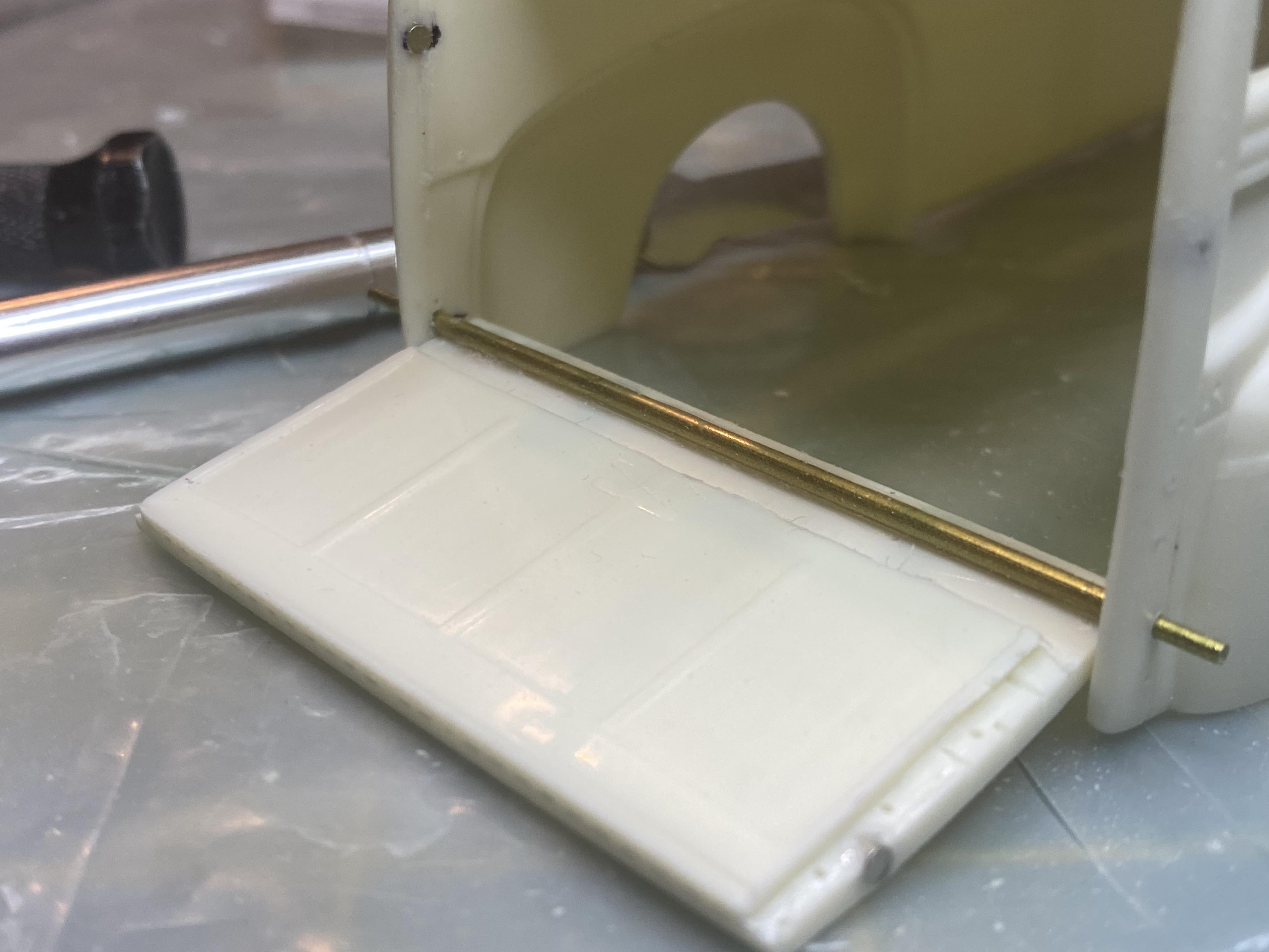

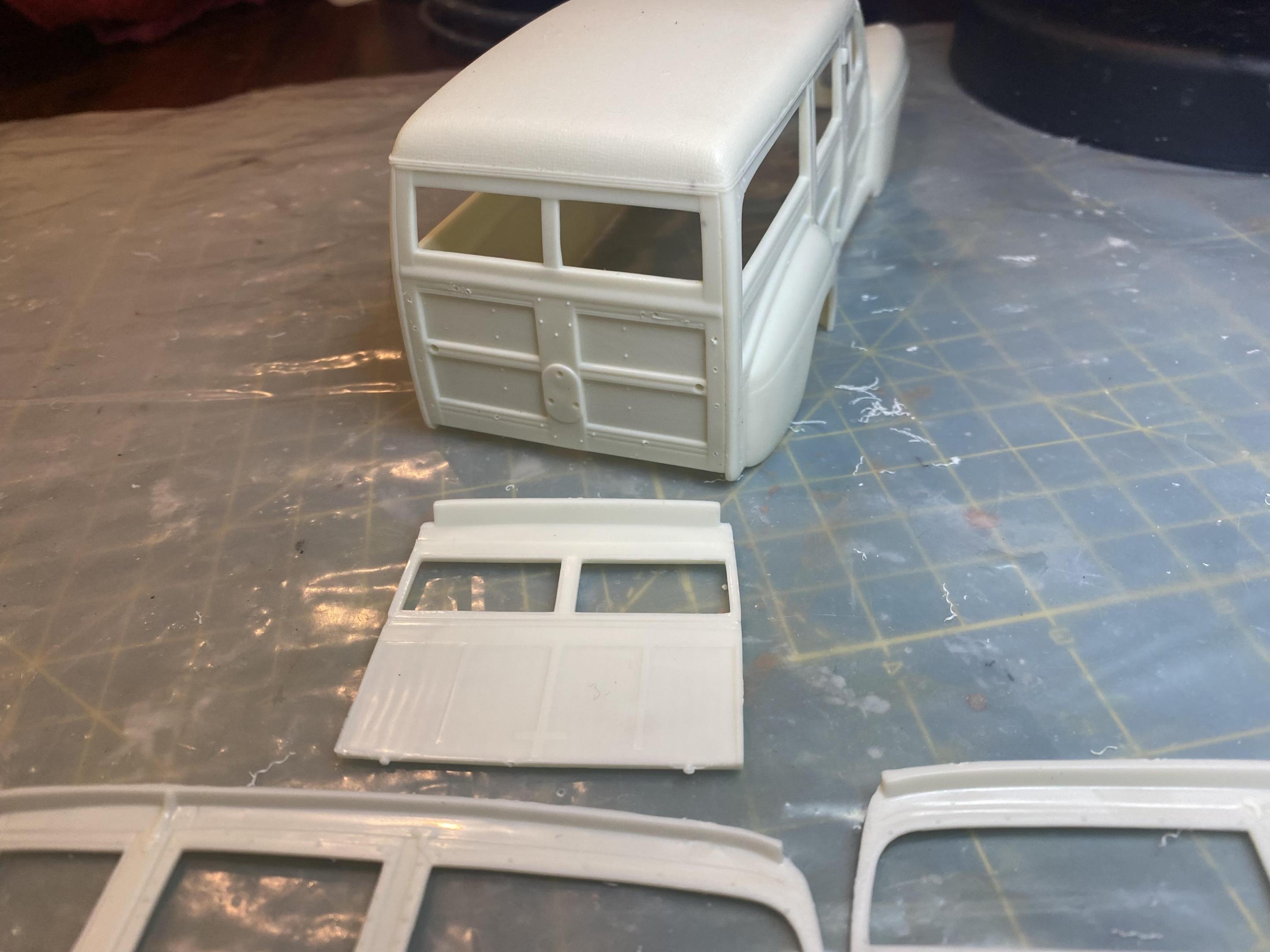

I removed the back doors and created the rubber flap to overlap from styrene sheet. I then created the hinges and used magnets to get the lower door to stay closed.
IMG_5587.thumb.jpeg.b14ae26bff8b1a7040ed00e3efe12318.jpegIMG_5588.thumb.jpeg.e48df1cd0932124d329883cd25d01a17.jpegIMG_5589.thumb.jpeg.2140941d1125b6daedac1be4c51bfa90.jpegIMG_5590.thumb.jpeg.7ae85b251aff25ffa15c9f005889bca2.jpegIMG_5596.thumb.jpeg.7ff587accf62c8e9905487957ceda208.jpegIMG_5597.thumb.jpeg.d4a156ec1c64ee9d5b7cfd0dc0f337d5.jpegIMG_5598.thumb.jpeg.9561b5d1b8155e86d29031e0c2b74c25.jpeg

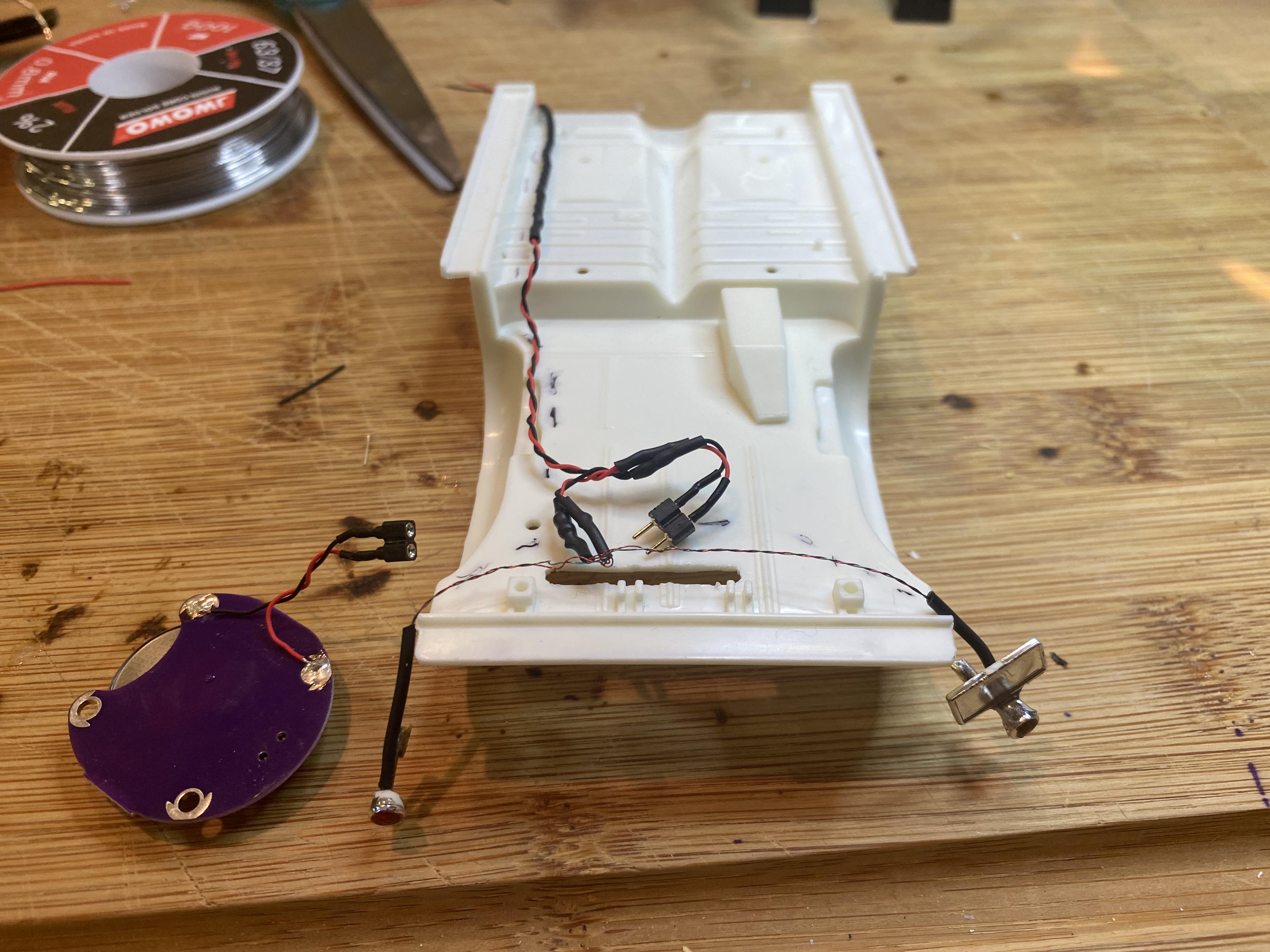

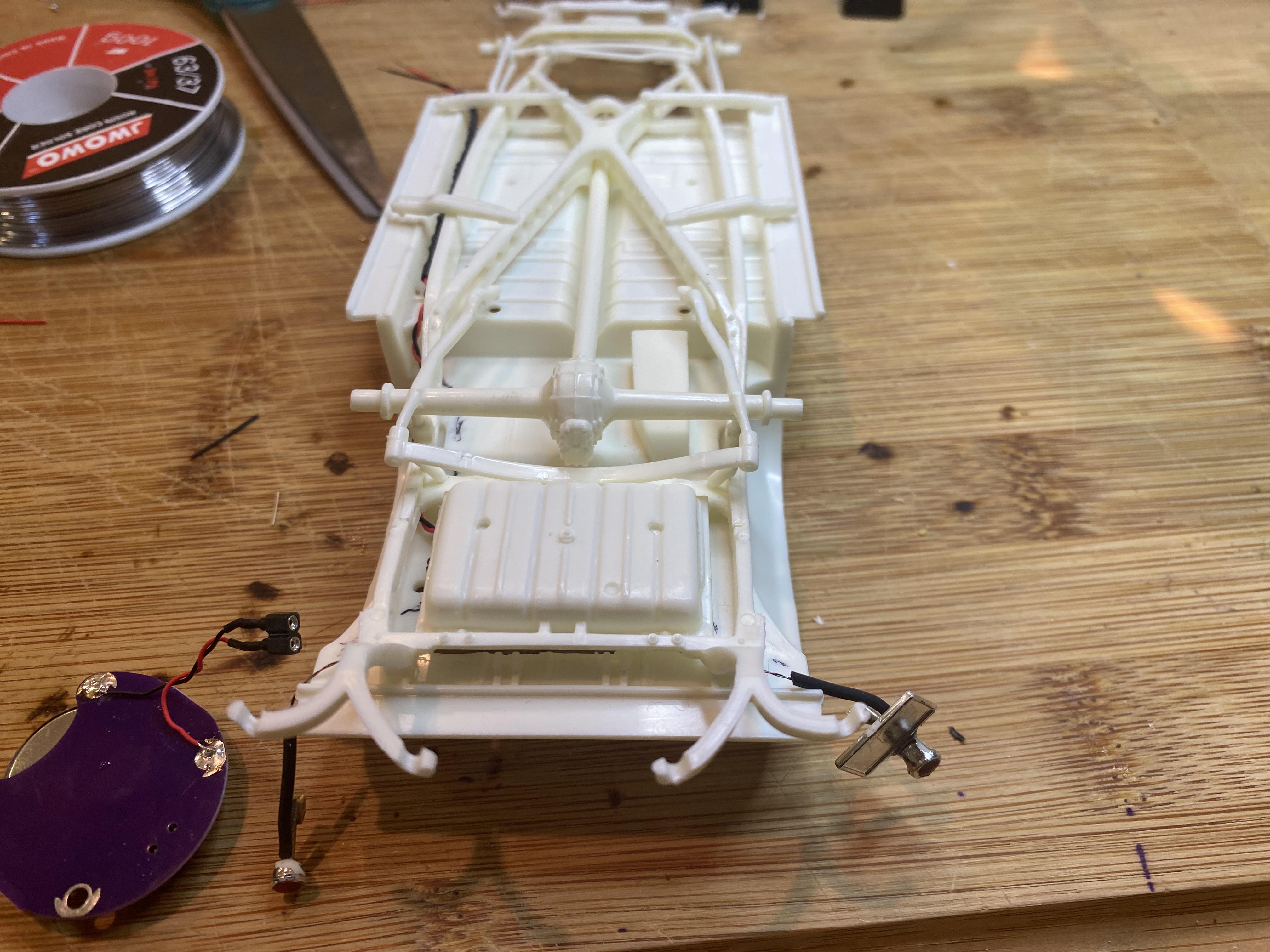

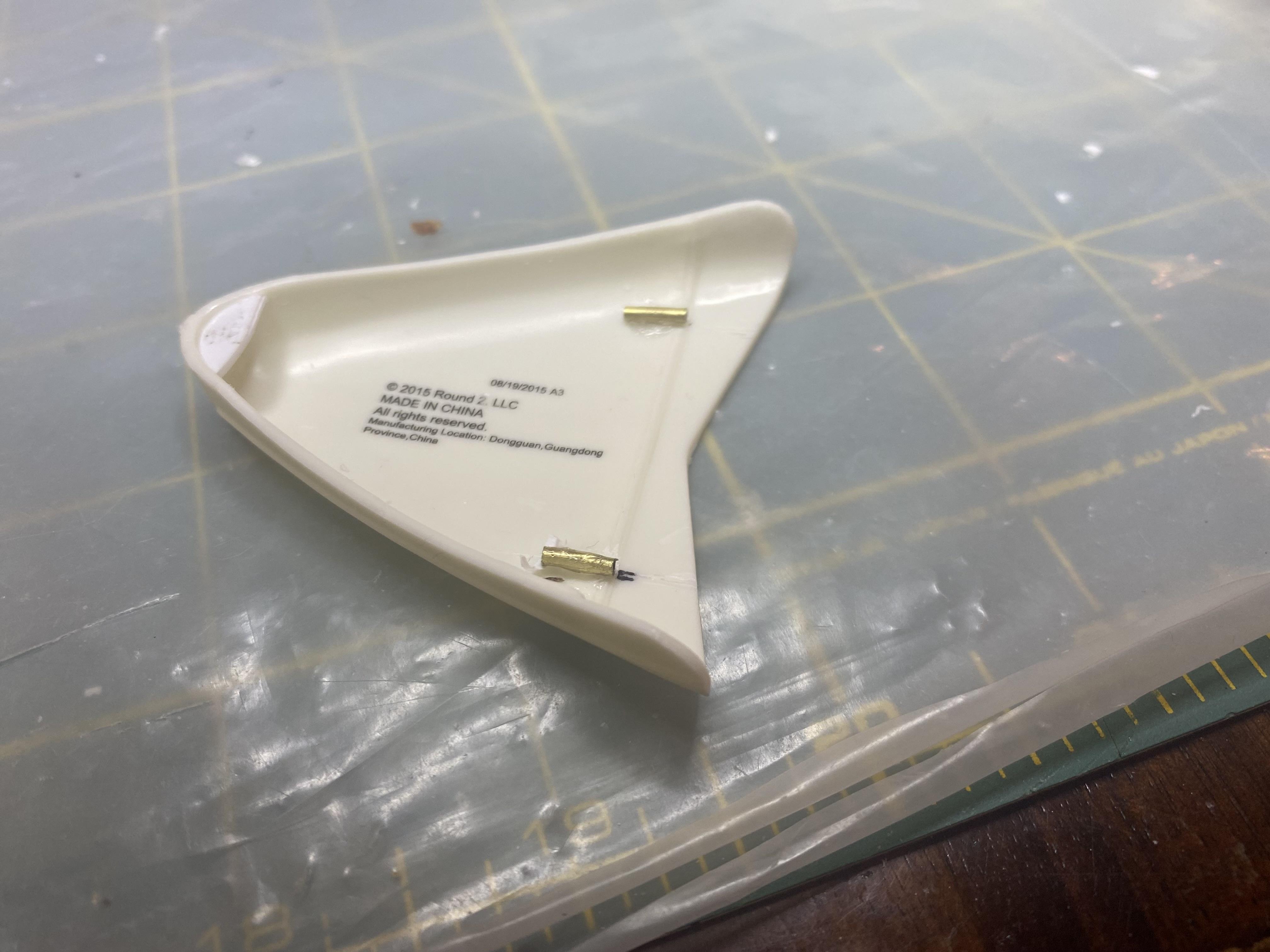

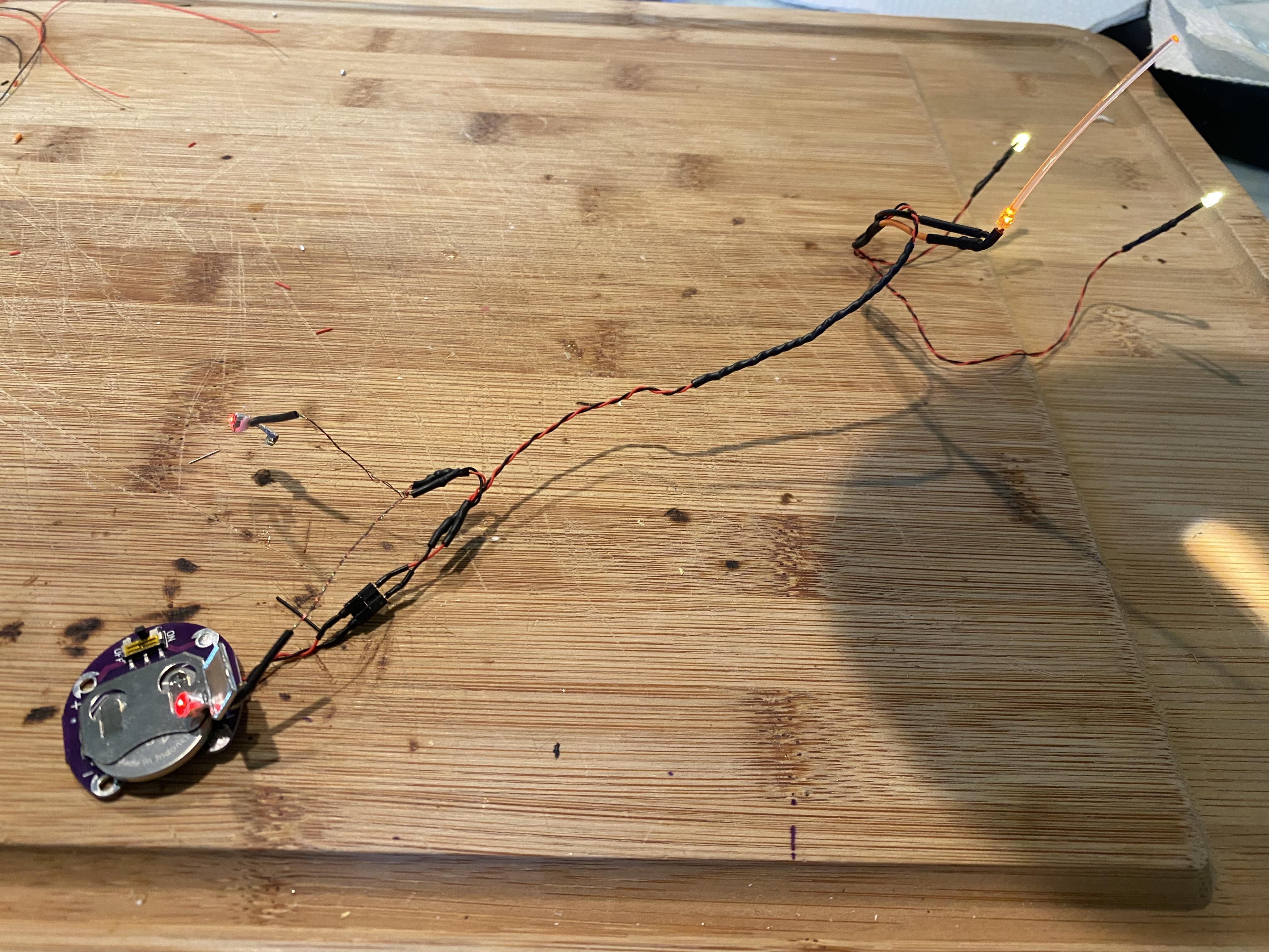

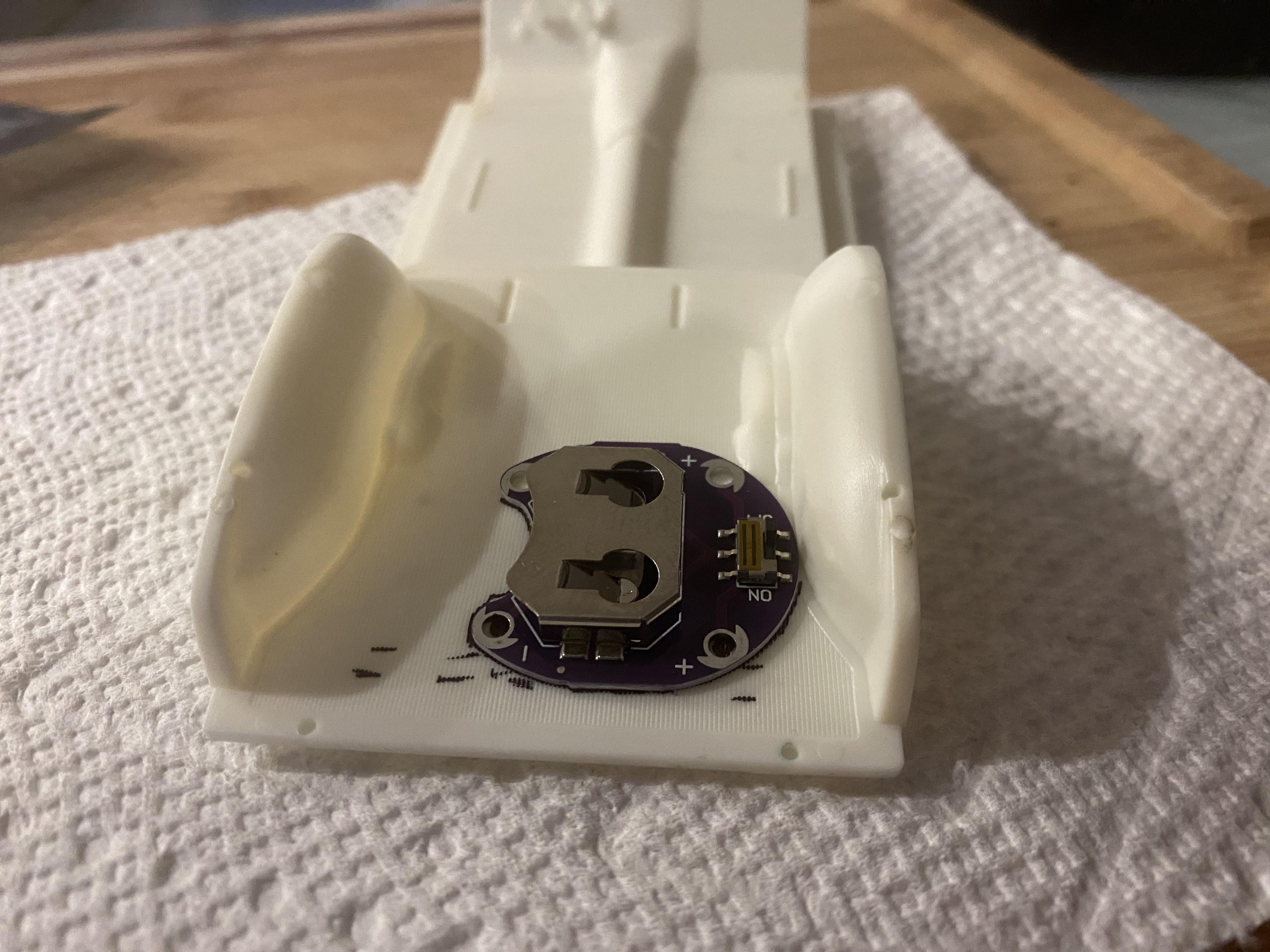

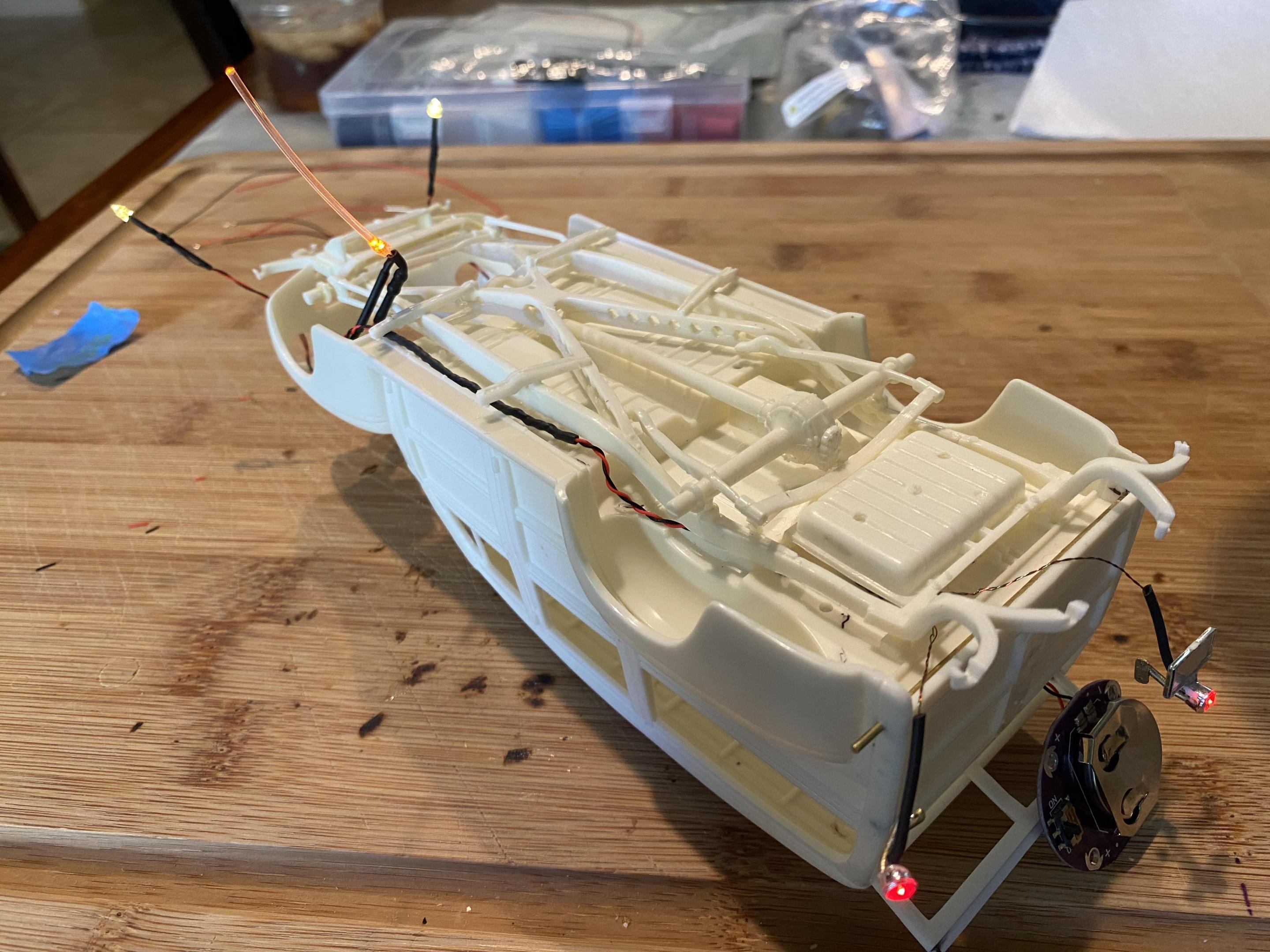

Today I created the LED wiring harness and a cover for the battery. I am using a lily pad style battery holder with a switch built on the  circuit board. I will eventually try to camouflage the cover with items like a picnic basket, ice chest and beach towels.
IMG_5599.thumb.jpeg.080630e2e88f2661f9792fdd50b68b3f.jpegIMG_5601.thumb.jpeg.2deb8f3a8f764f8bc856f73ec9cddc10.jpegIMG_5602.thumb.jpeg.648d16d17562d072e224949b945d1b42.jpegIMG_5604.thumb.jpeg.0ee2f563a7921115b37e31b1e6d2a060.jpegIMG_5605.thumb.jpeg.34e6f8cfbba9763ee75cdff484ce00bb.jpegIMG_5606.thumb.jpeg.902a81f44548b3e94024350b1c5dcb30.jpegIMG_5607.thumb.jpeg.9ff2e821c3f7ab6c792b3ce6492f7b4e.jpeg

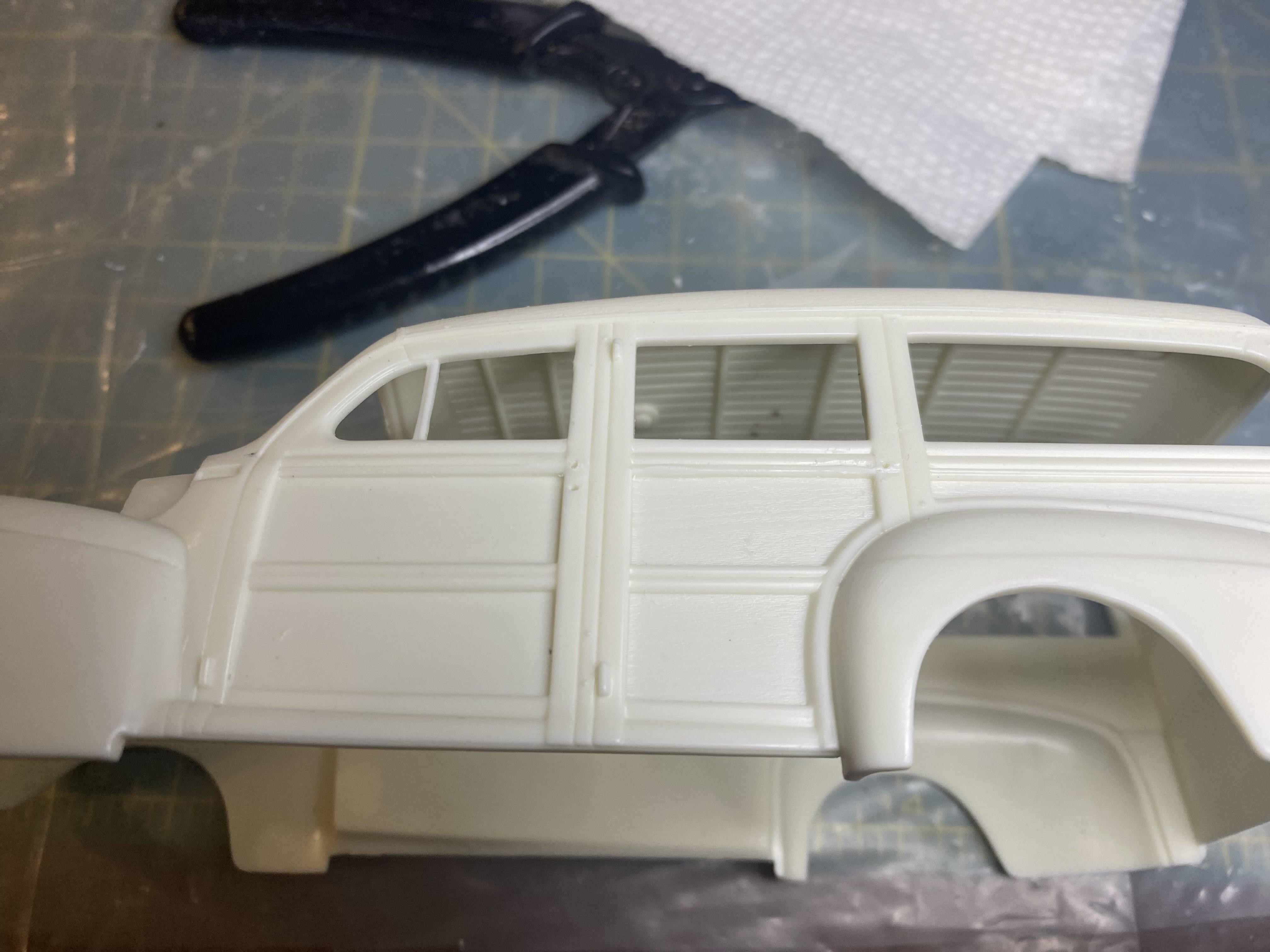

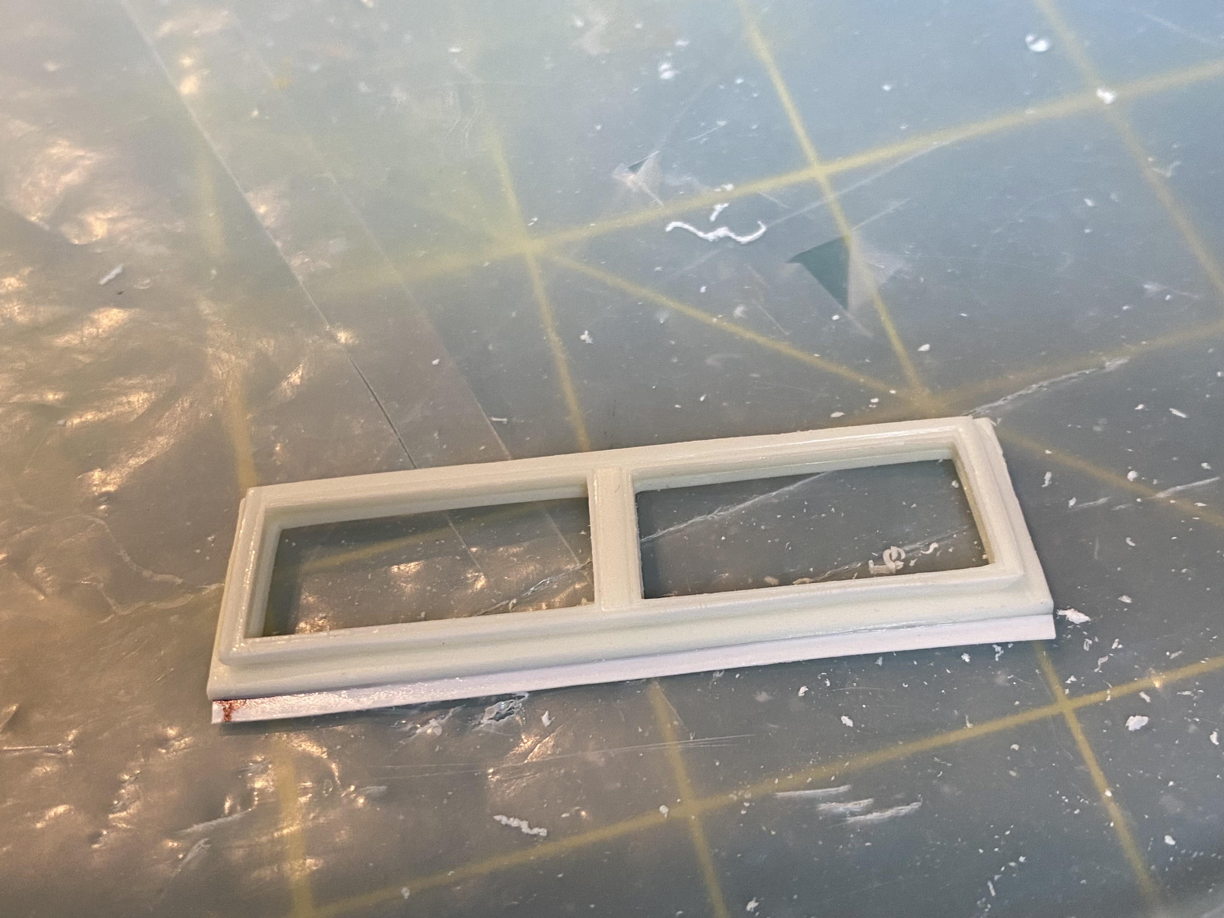

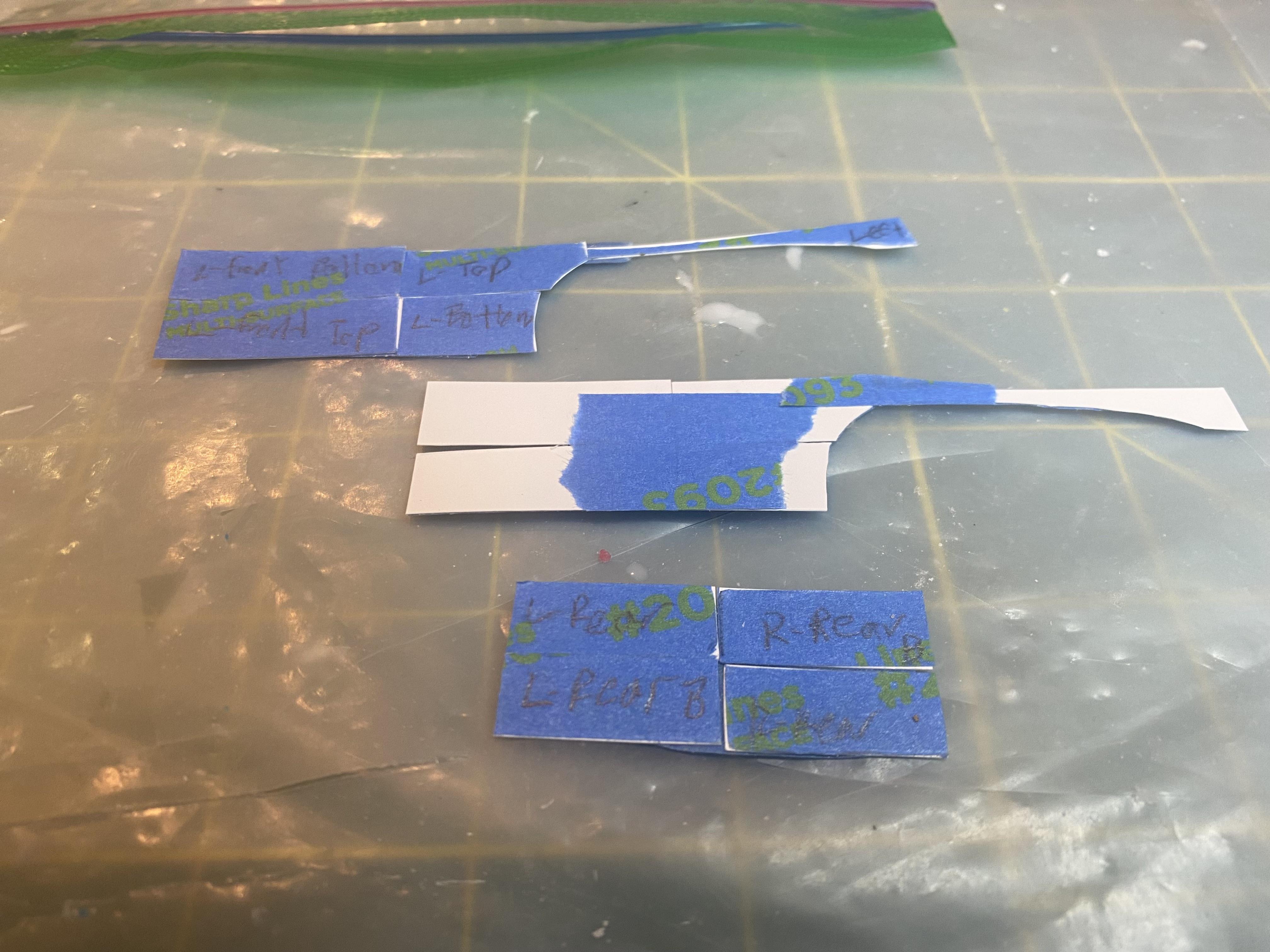

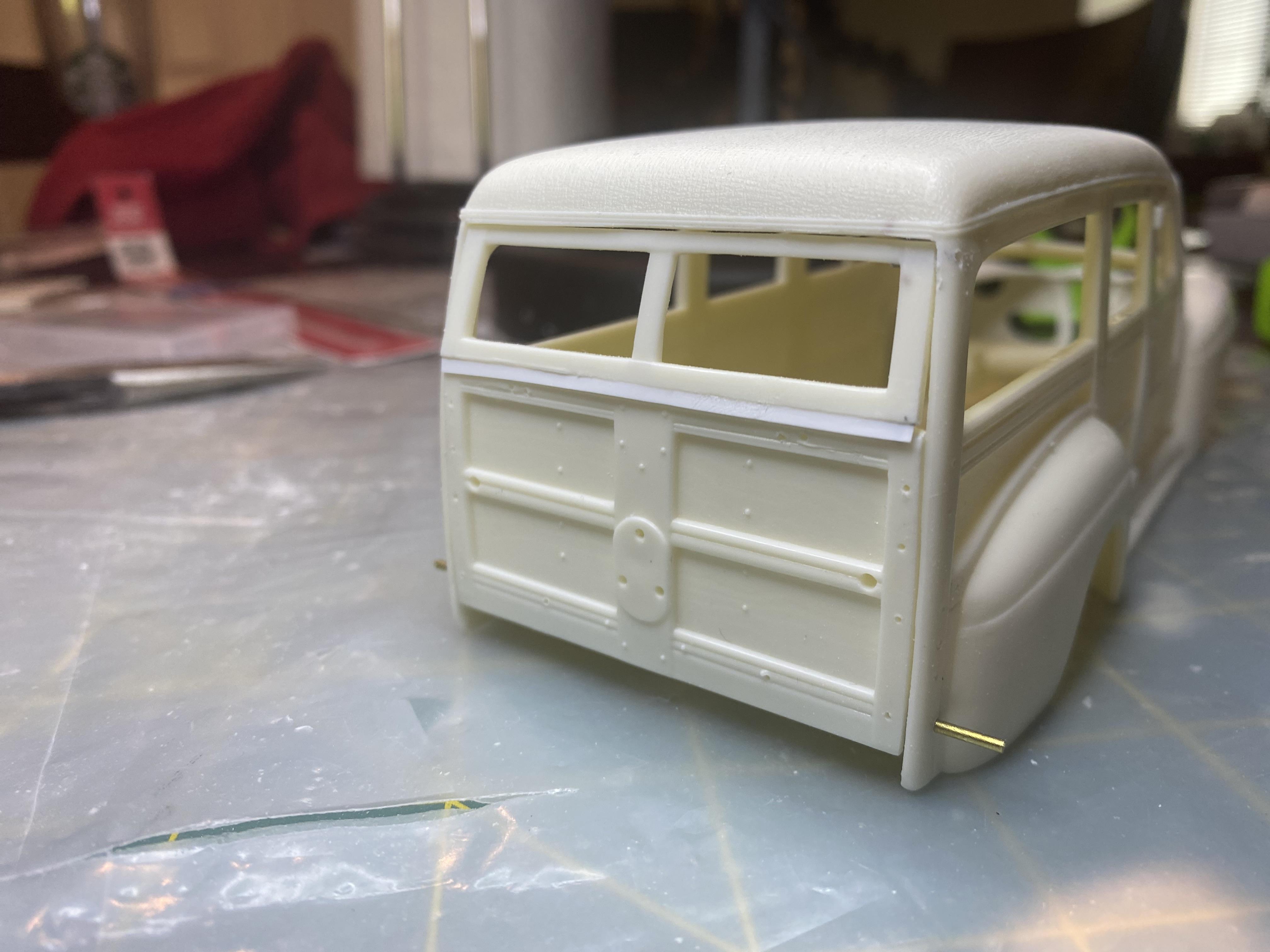

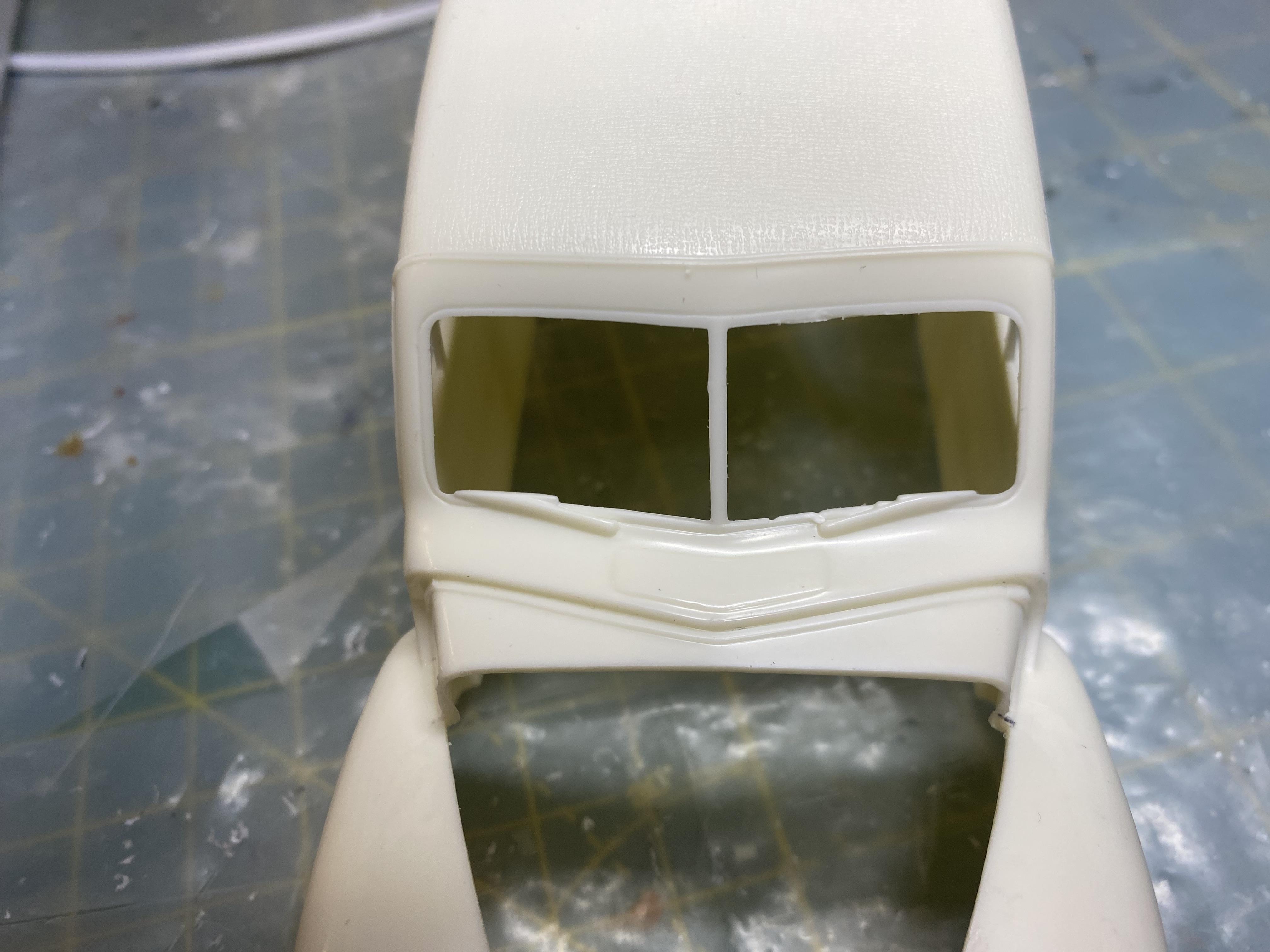

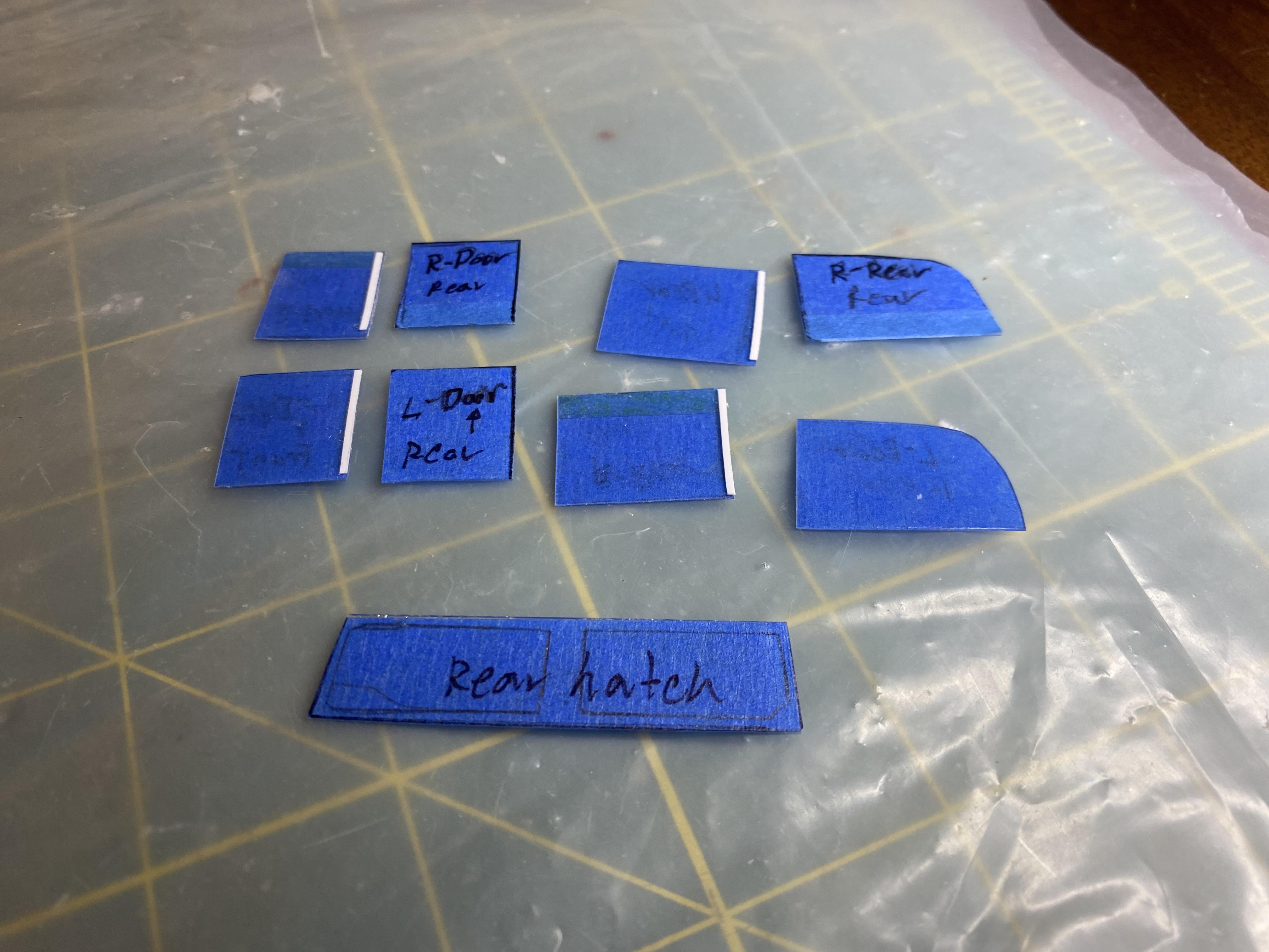

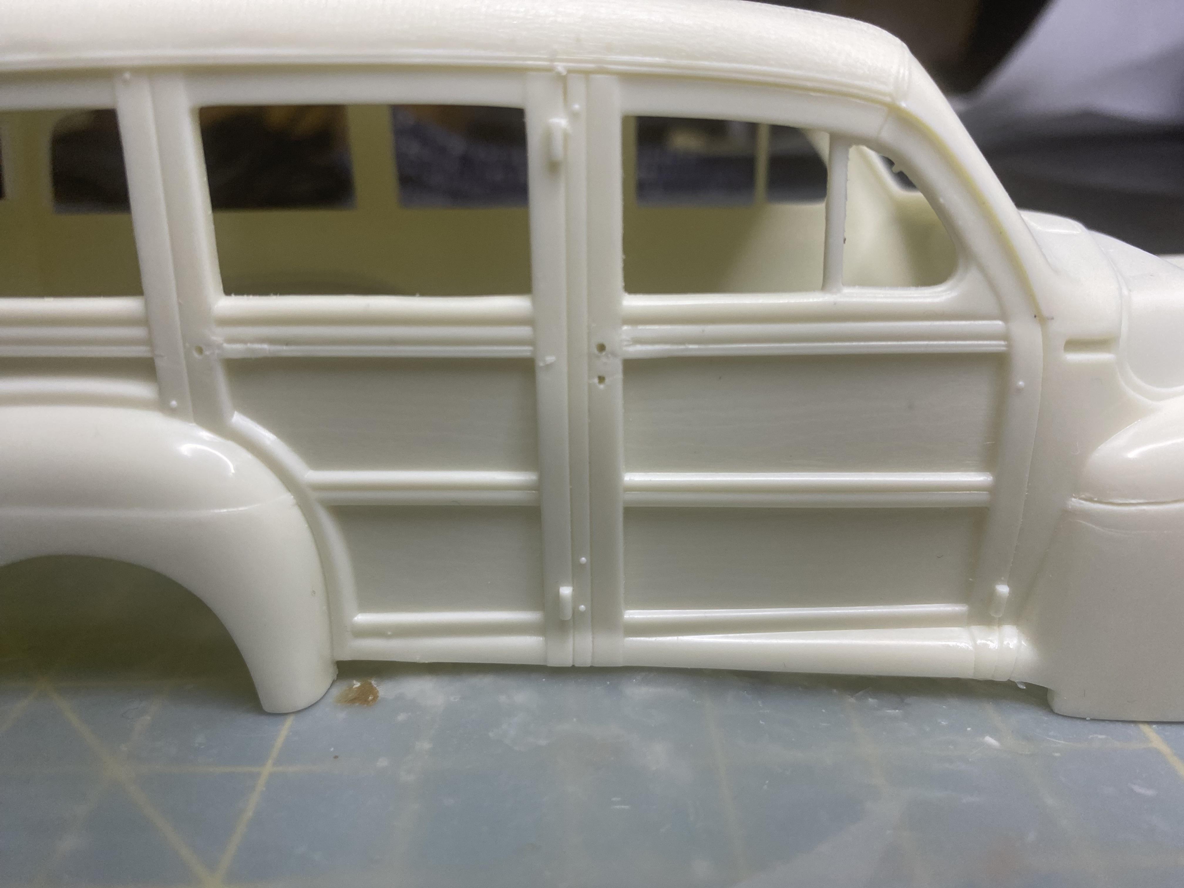

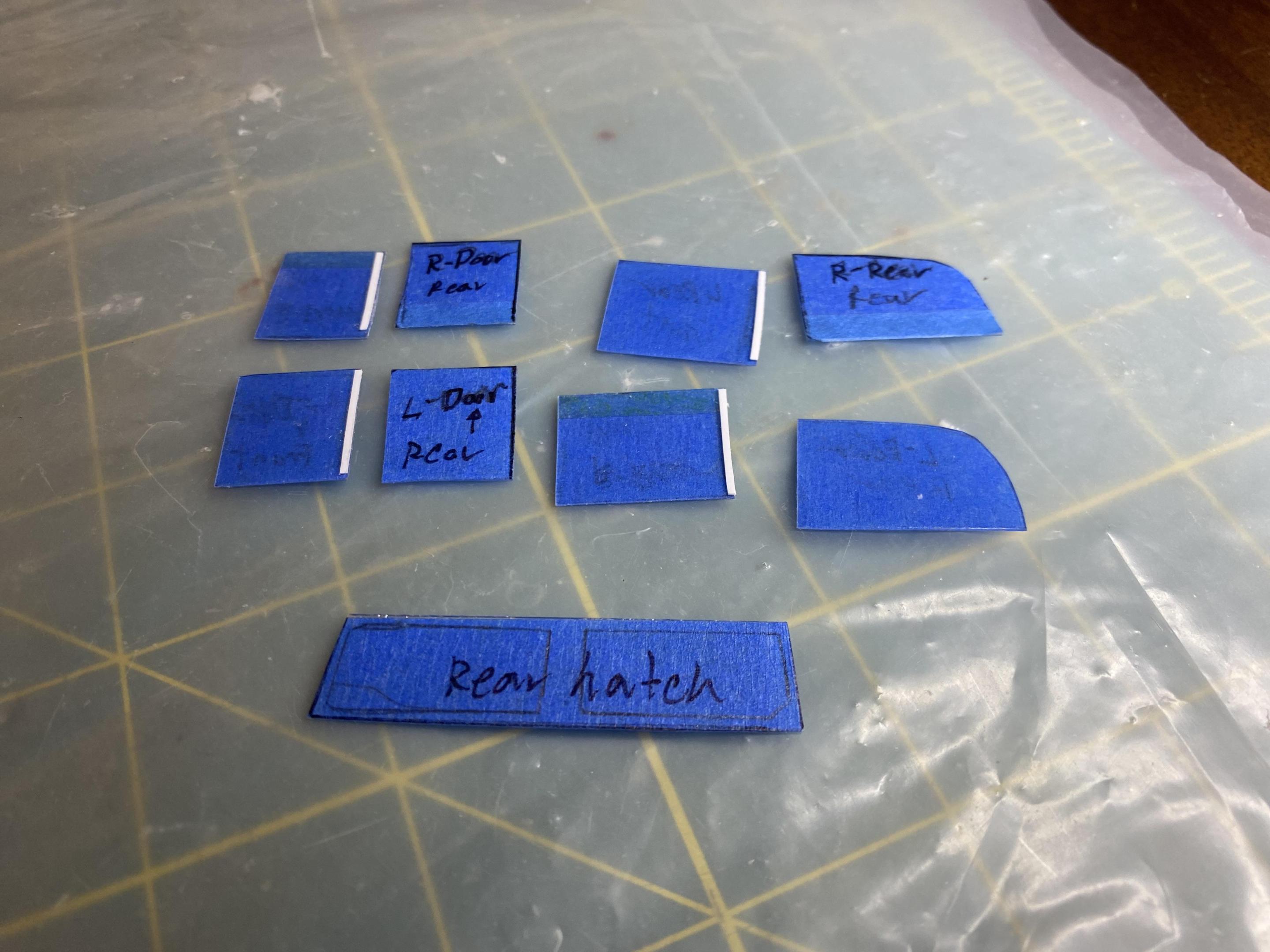

I got just a little bit more done. The template to cut out the side windows had it where you cut out solid glass for the rear doors and rear area. That is not how they are supposed to be. I made them in halves like they should be and added trim for the felt wipers. I also cut out the rear hatch so they would look the same.

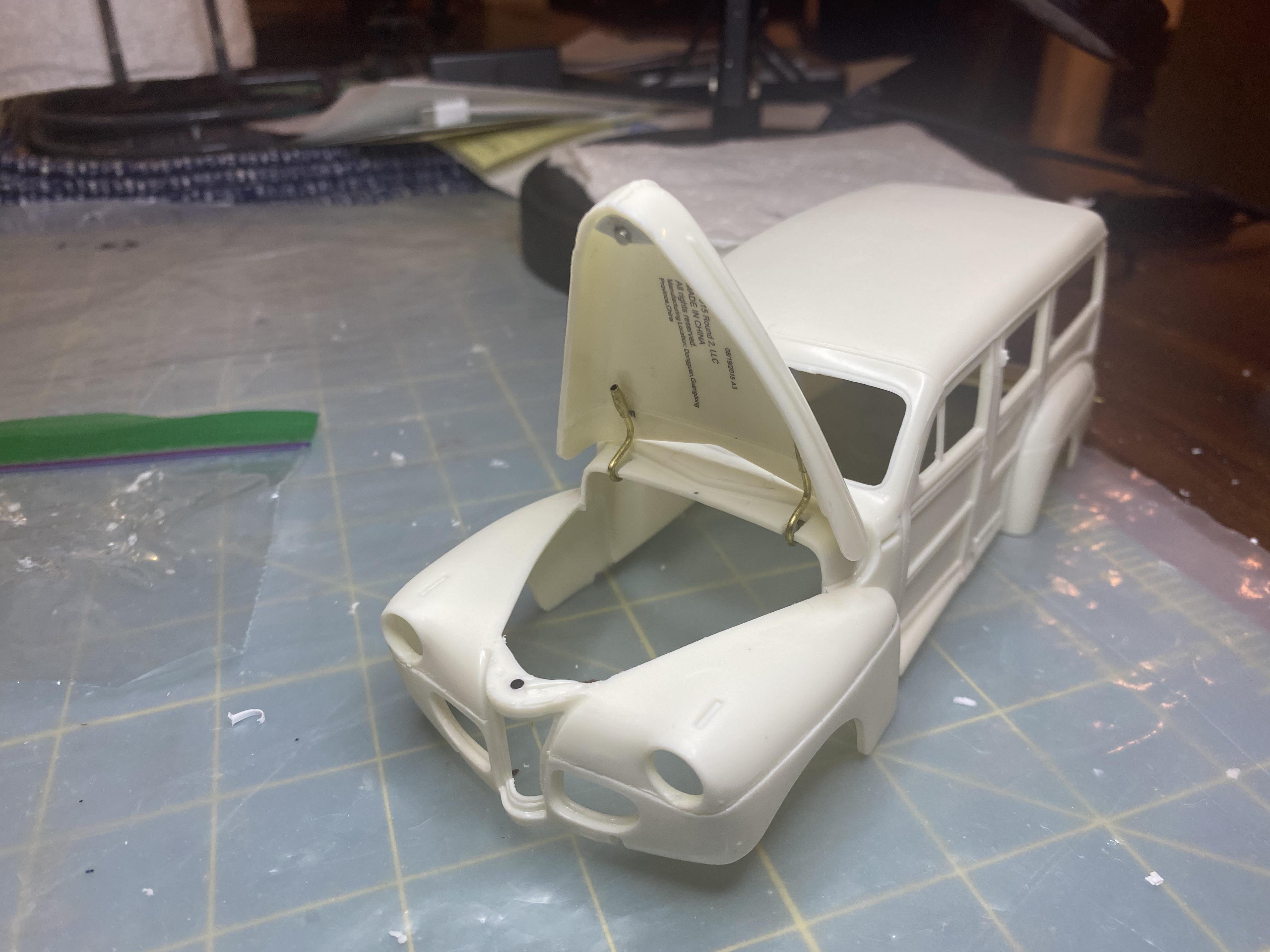

i also created the hood hinge and a bracket in the hood for magnets to hold the hood closed.

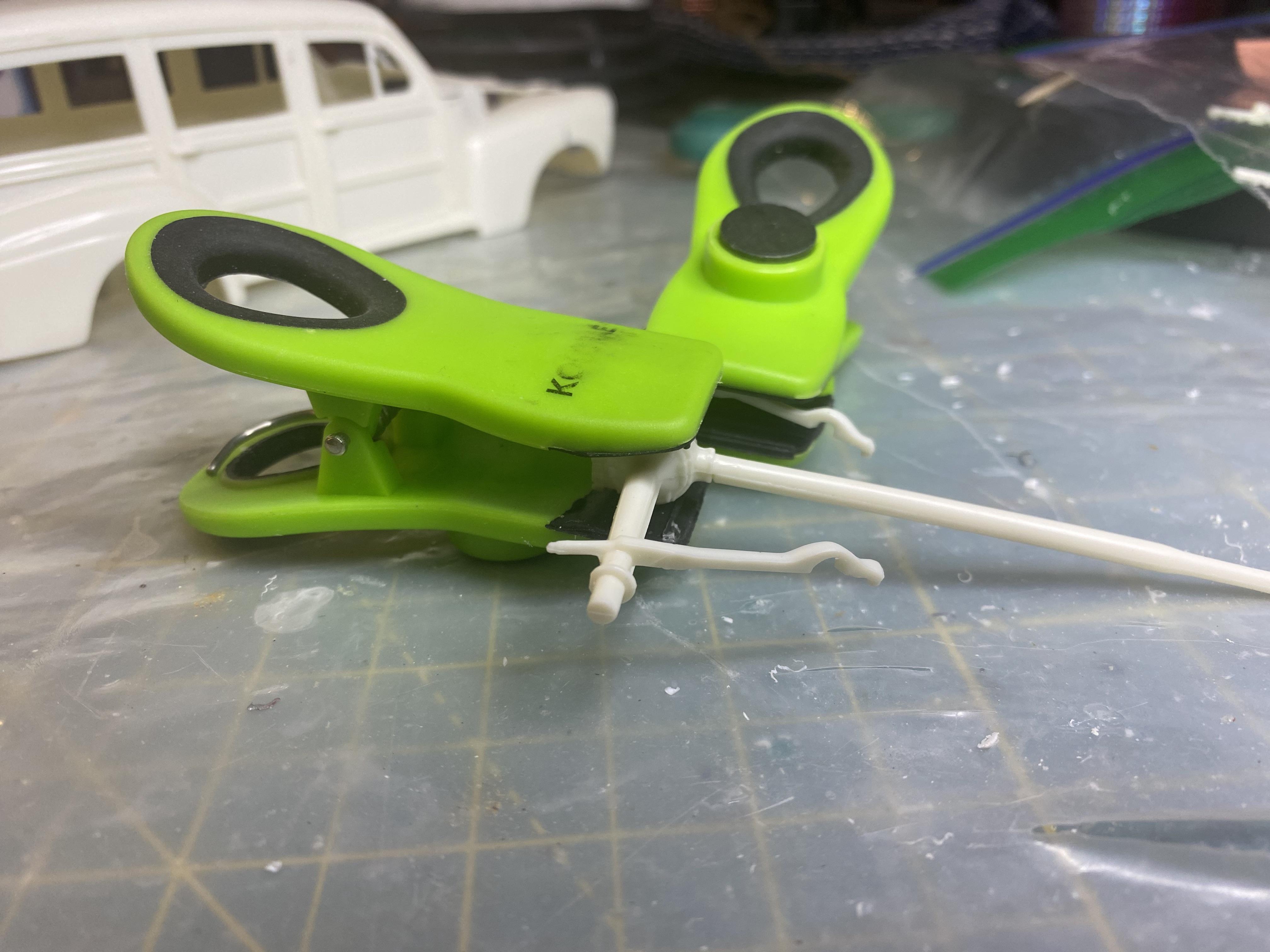

This is what I use. I really like to be able to pose the hood and doors when I make them open. I also have small pieces of tube on the hood so I have the option to take them off. I also use tiny magnets to hold them closed.

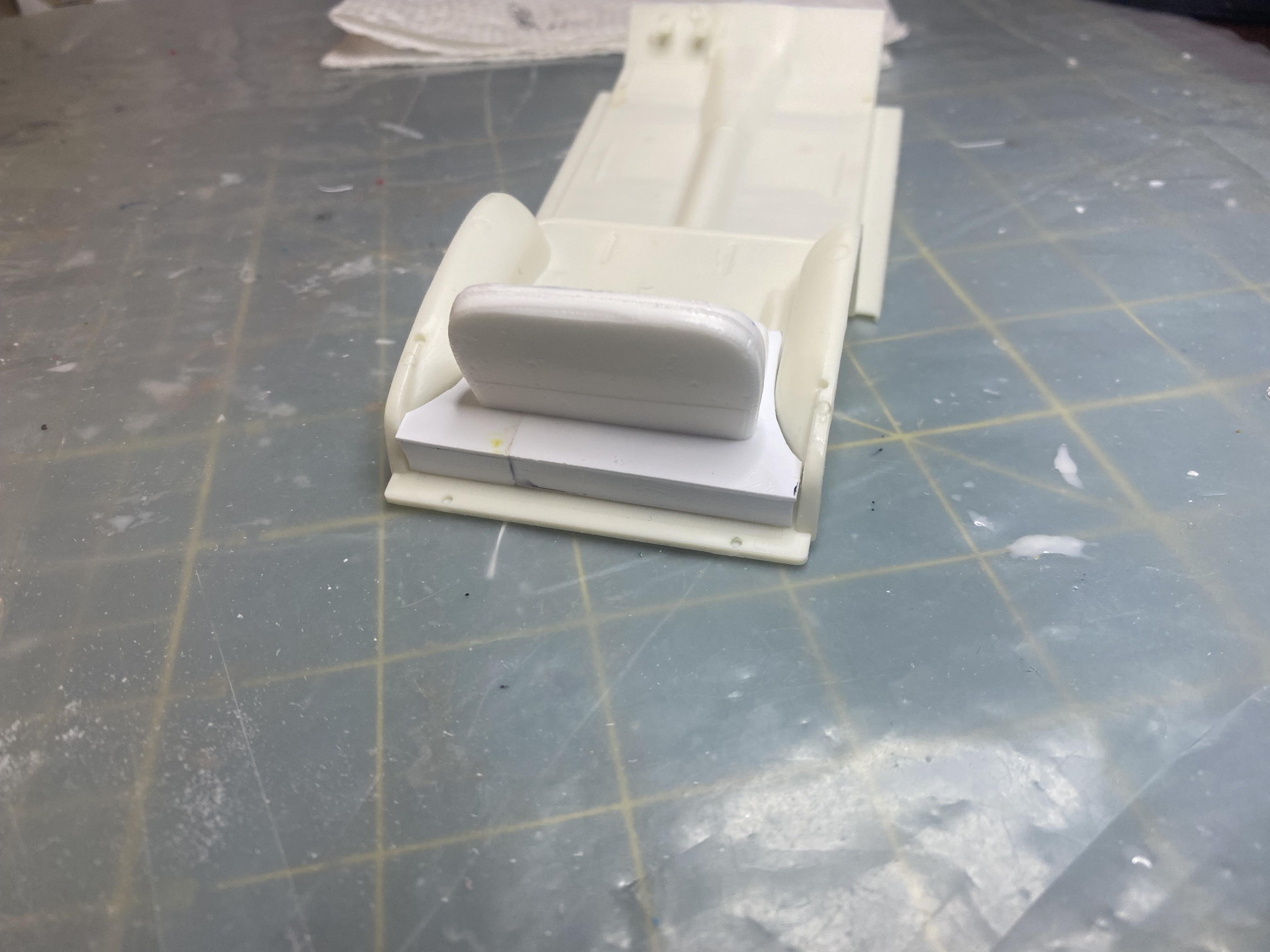

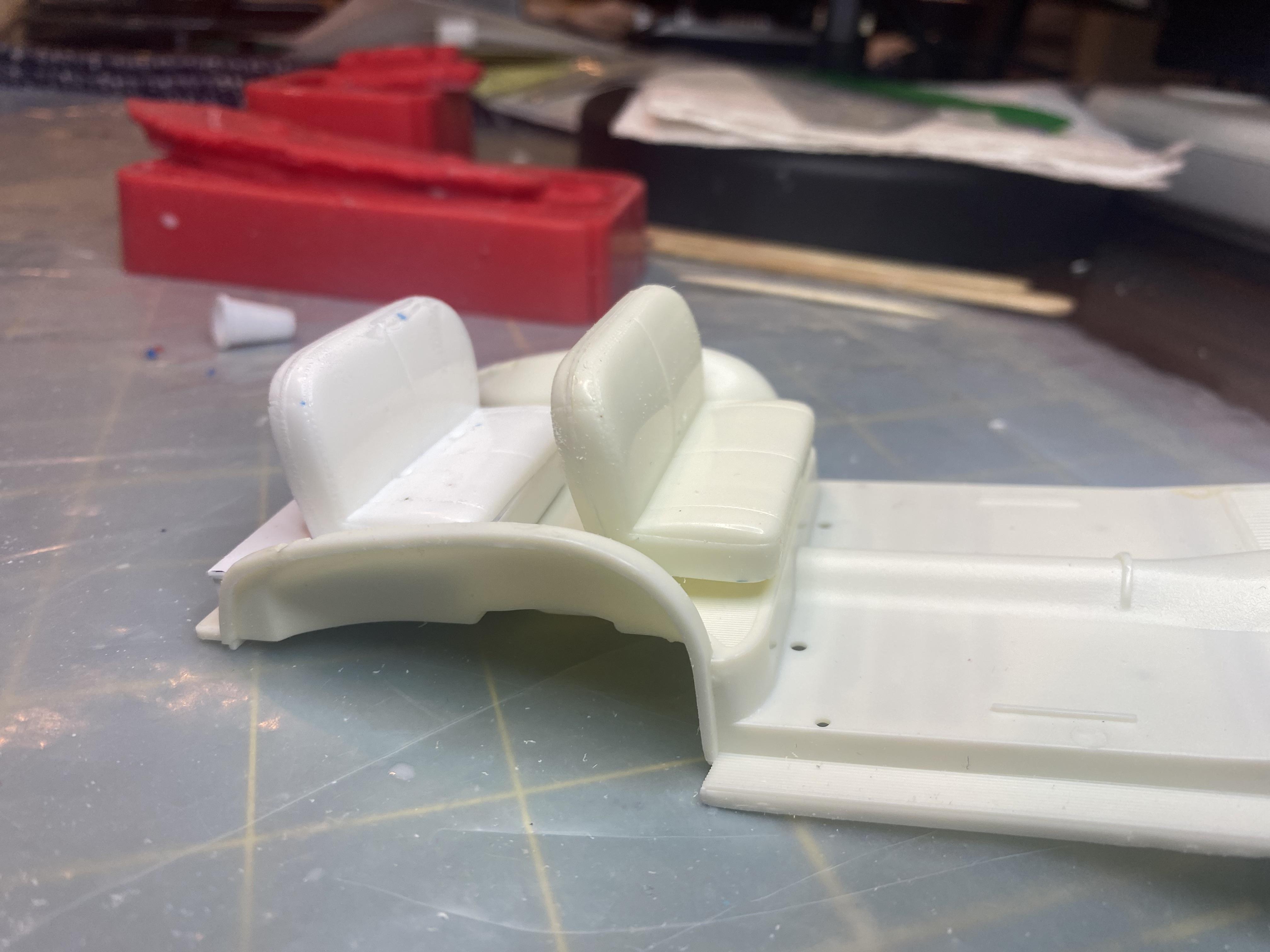

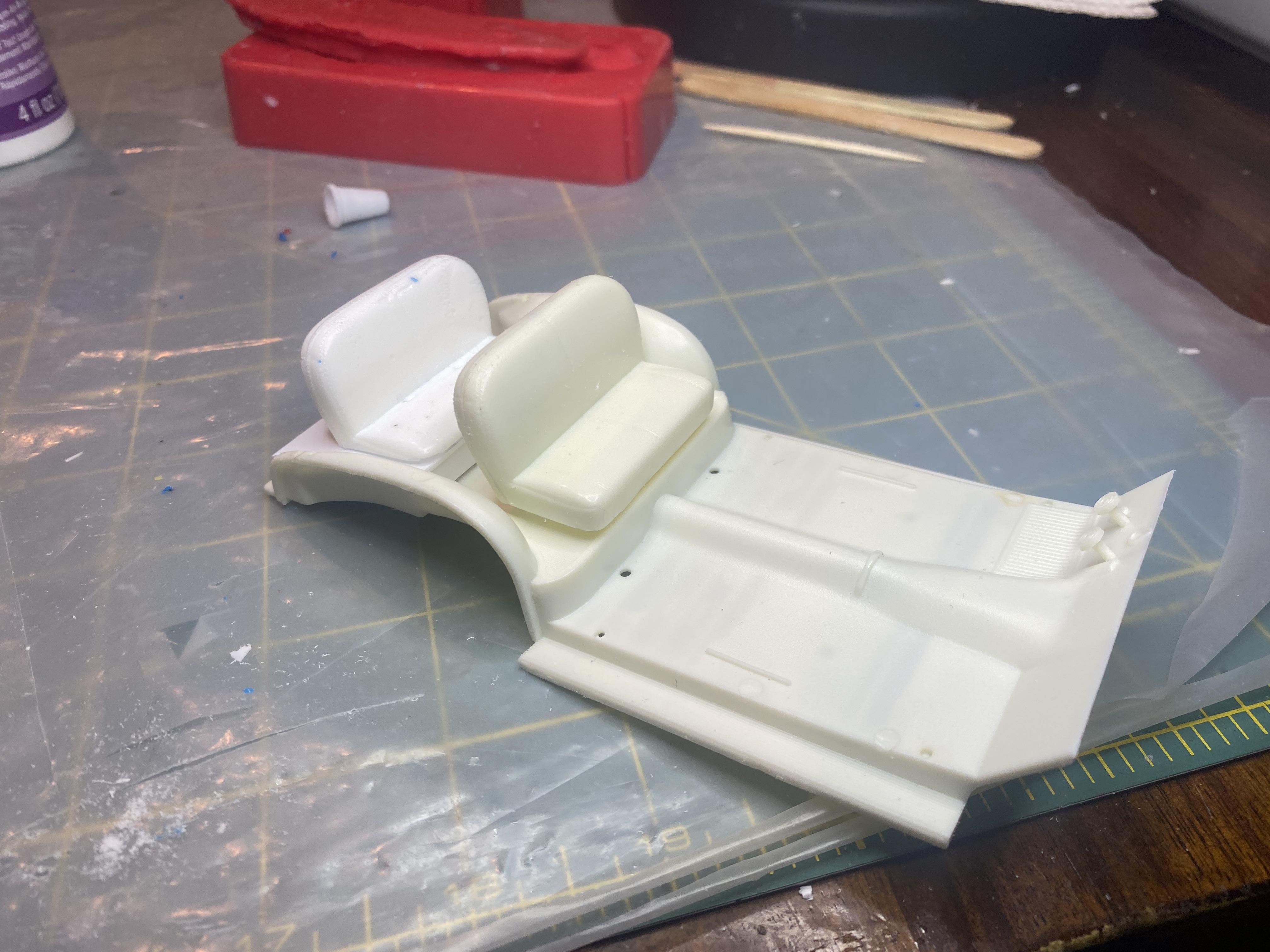

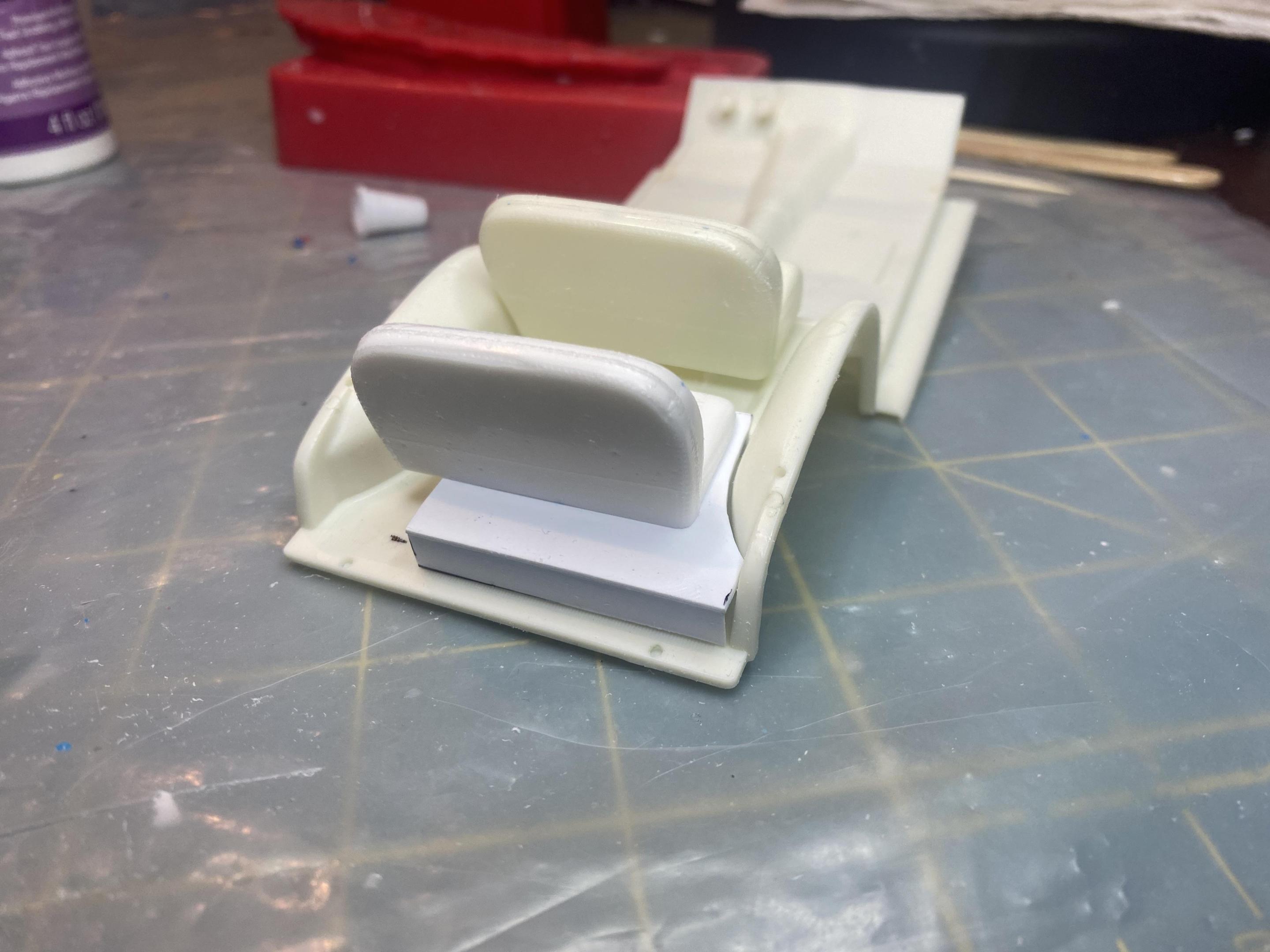

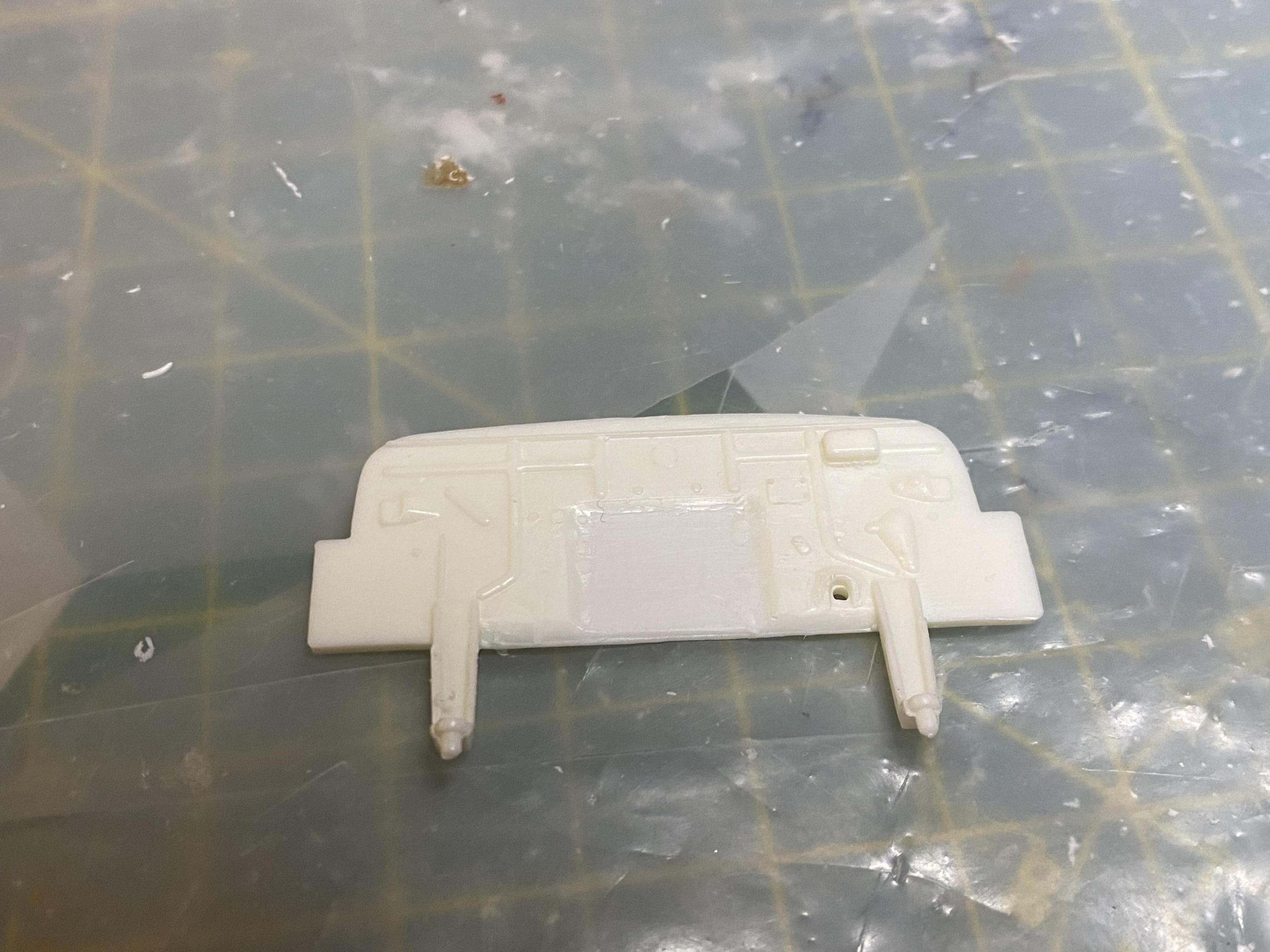

Every reference image I found of a 1941 Ford Woody had a third row rear seat but for some reason the kit didn’t include the very back seat. I resin cast a rear seat and trimmed it to fit on the LED battery cover camouflaging it more.
IMG_5624.thumb.jpeg.fb7487c8aa6e364821efb5ab29f0e8b6.jpegIMG_5625.thumb.jpeg.d673b310f84f0cc79856d7b6f1b197cf.jpegIMG_5626.thumb.jpeg.8ab7ea08c5a3d8e47a5ff9fa84229aa0.jpeg

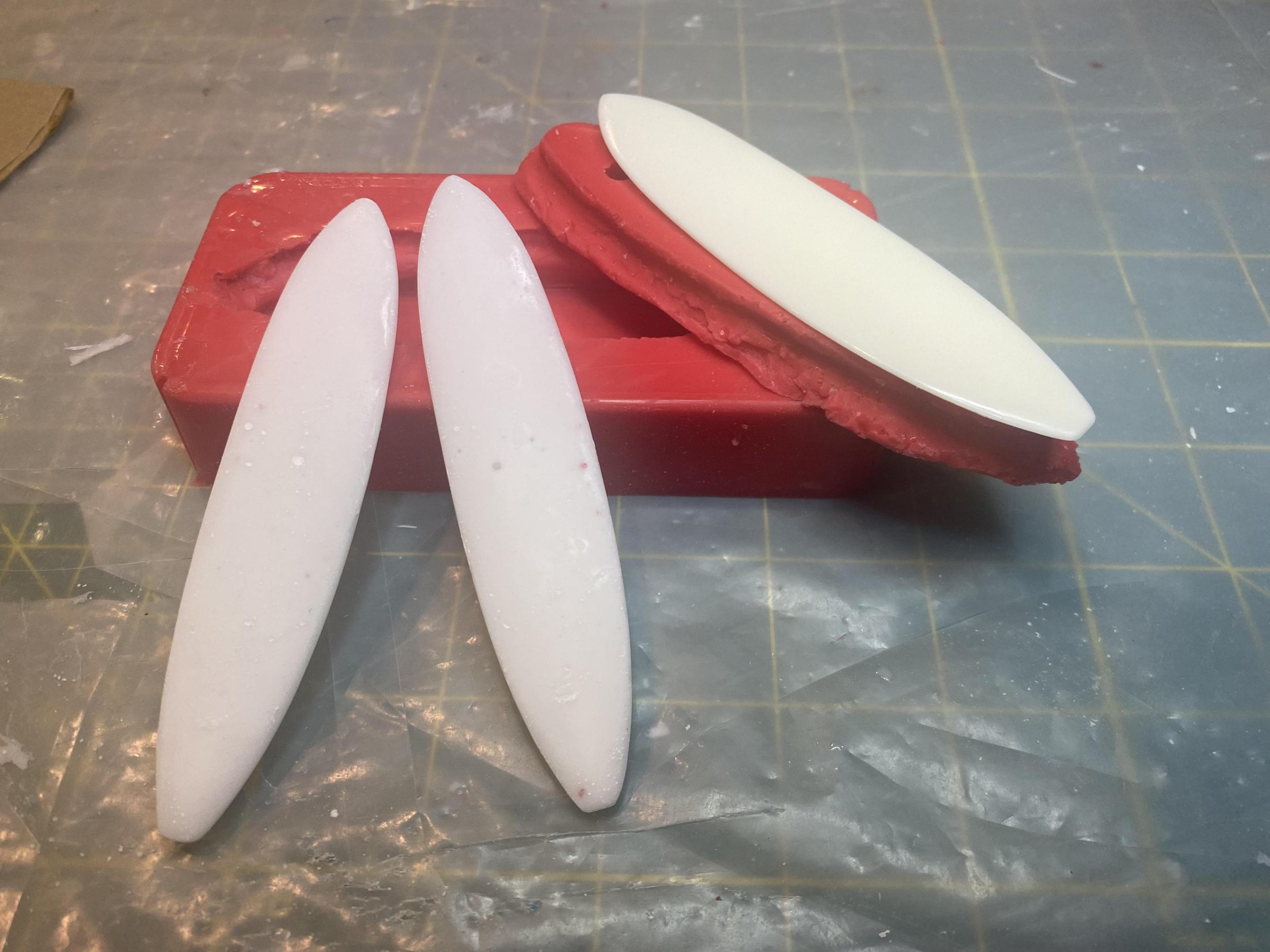

I also resin cast the surfboard and created additional boards. I will be creating a roof rack for two boards at some point.

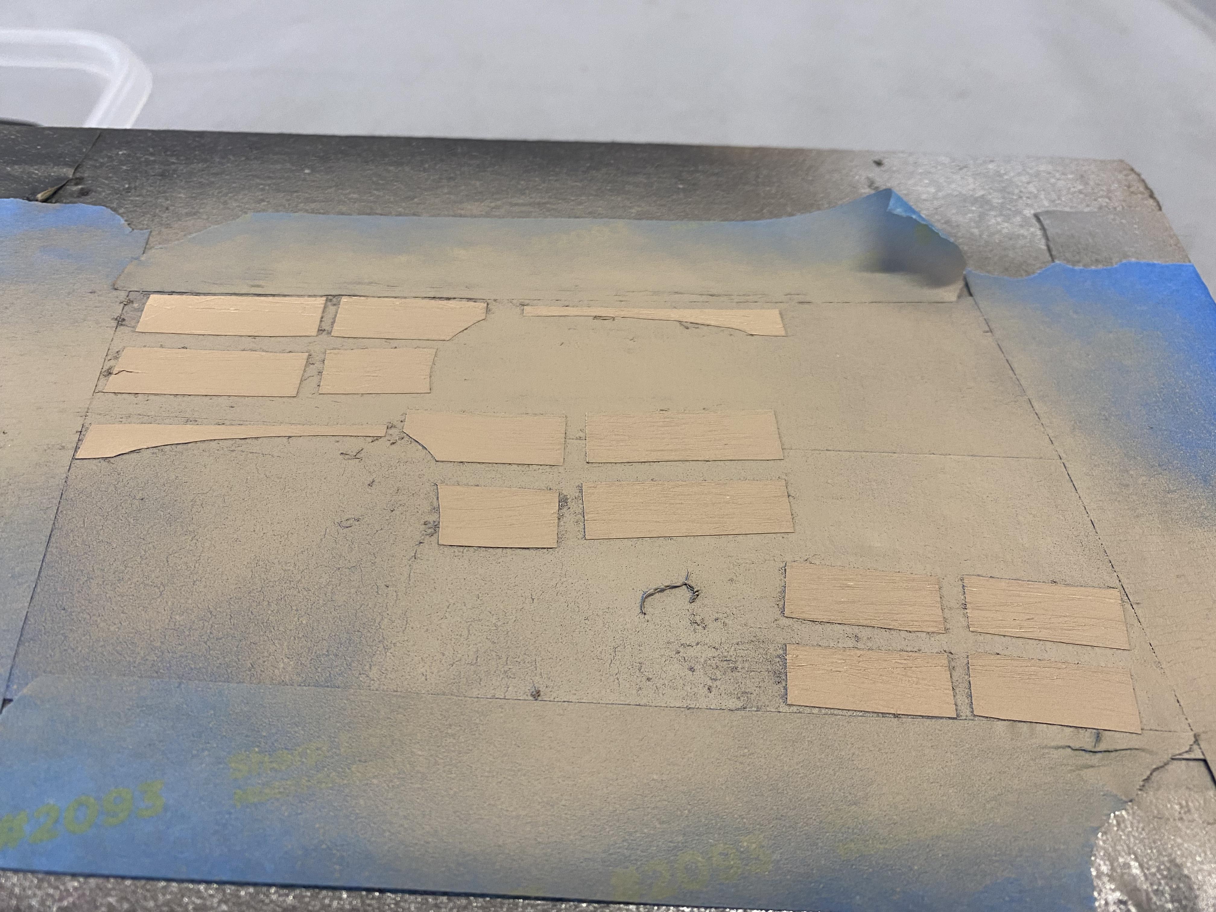

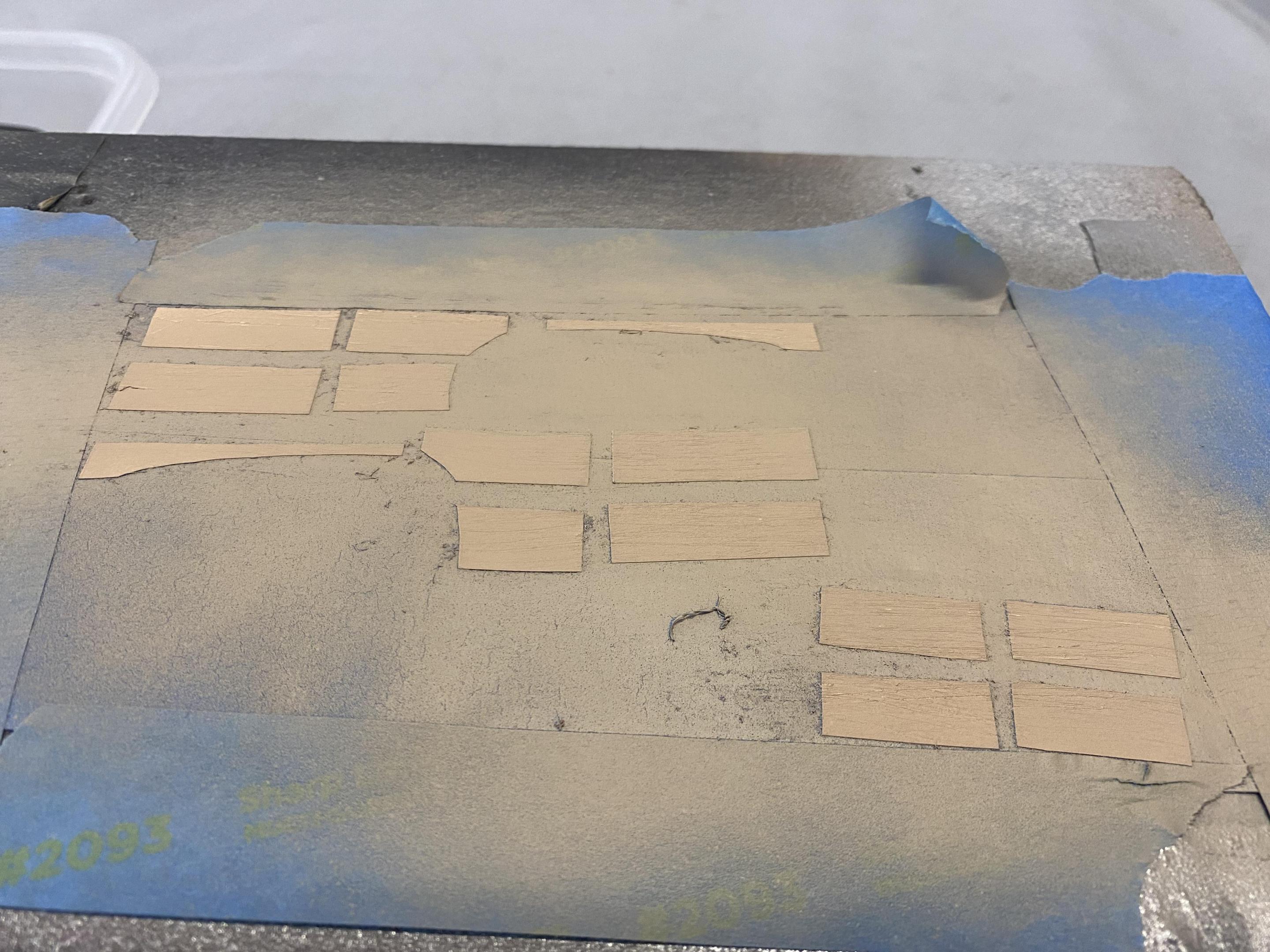

I picked up so. .005 styrene sheet and cut for woodgrain inserts. The decals are far too pixelated and one was damaged. I had purchased this kit opened. Getting a good woodgrain look inside the opening wood be difficult and likely too much buildup on the edges. I am pretty much ready to move on to paint and assembly with fabrication and modification is about done. I have some supplies on order so probably next weekend.

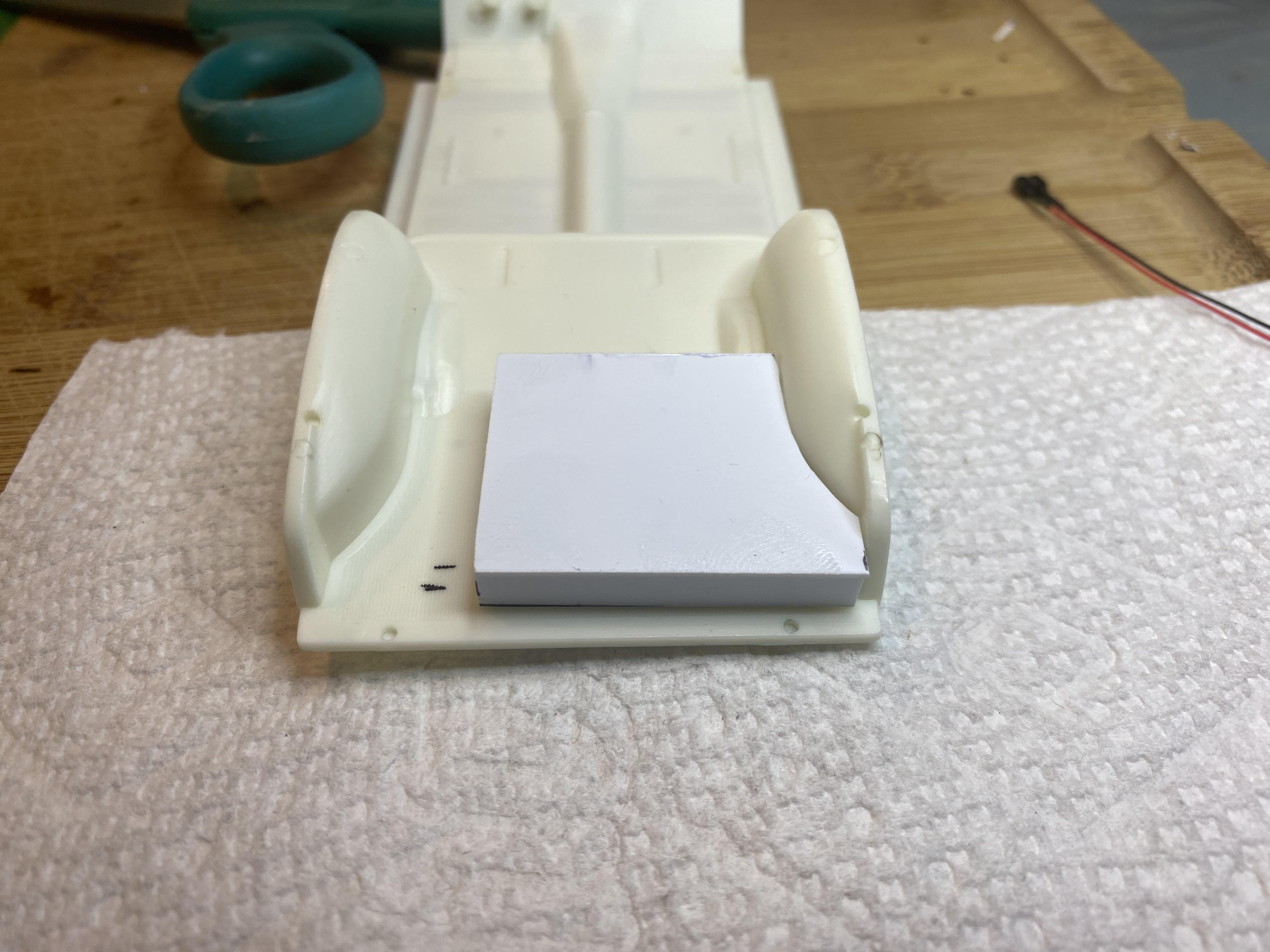

I was looking at the images above and decided it would look. Look a lot better if the battery cover was the full length of the back.

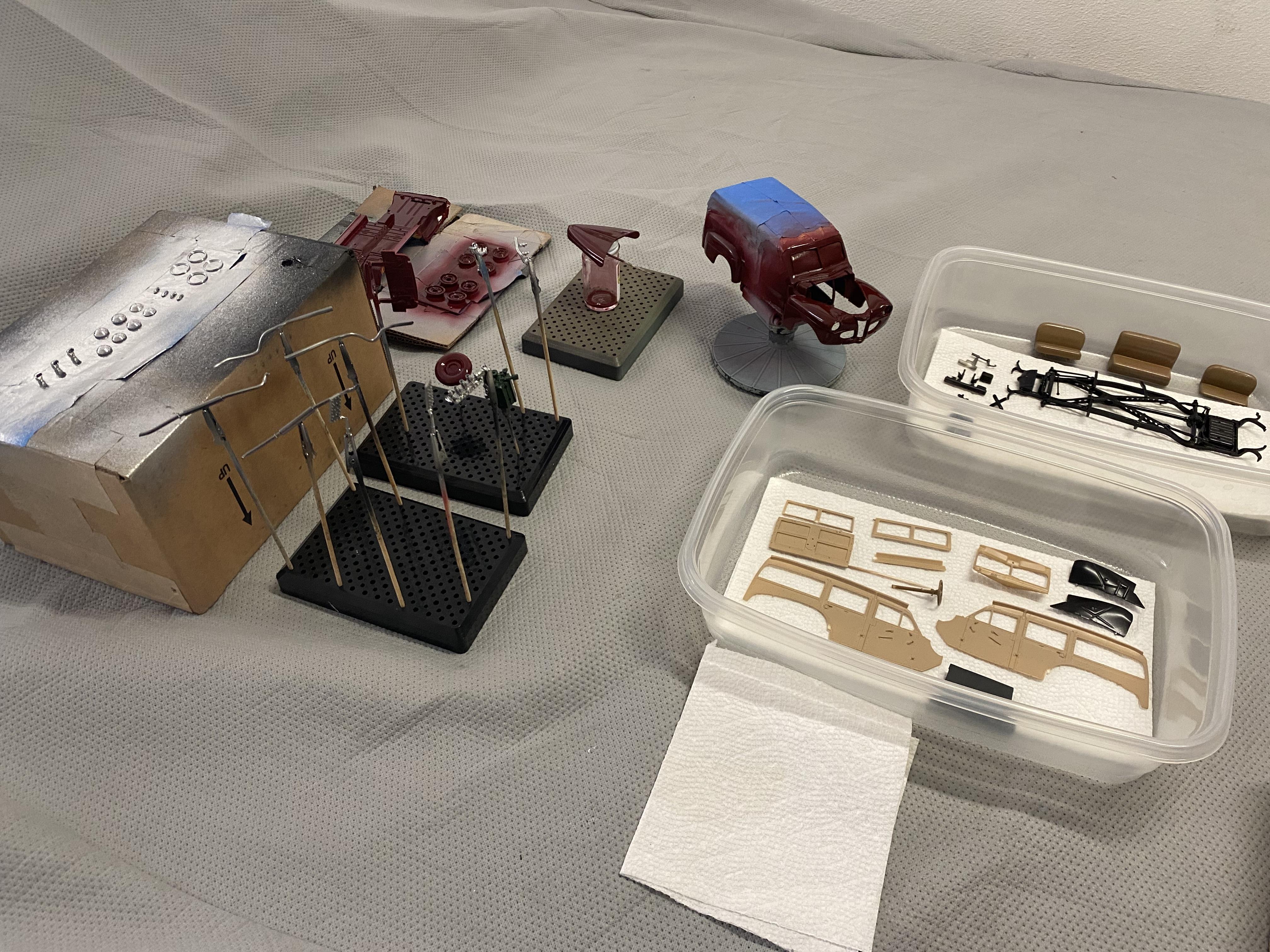

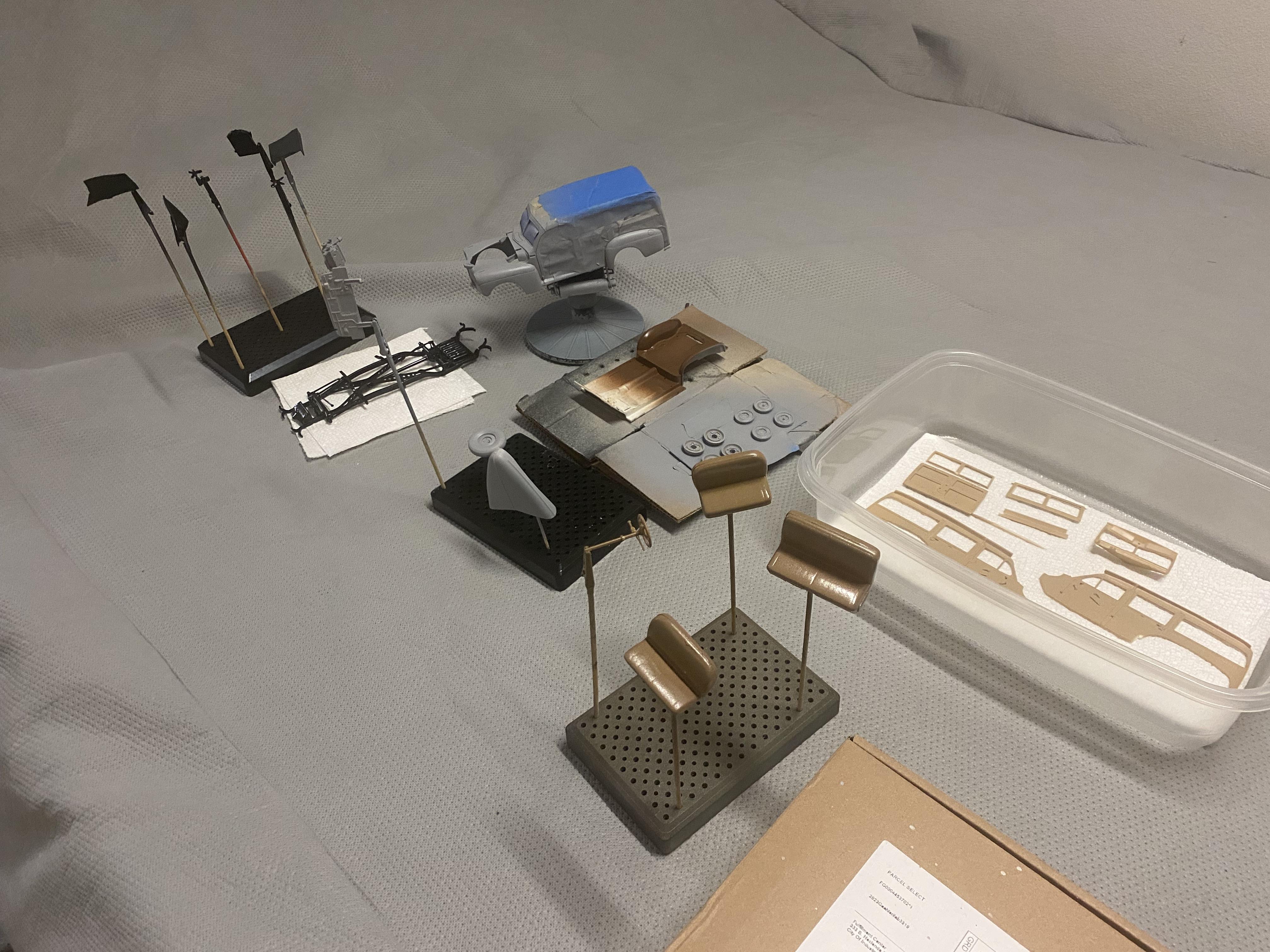

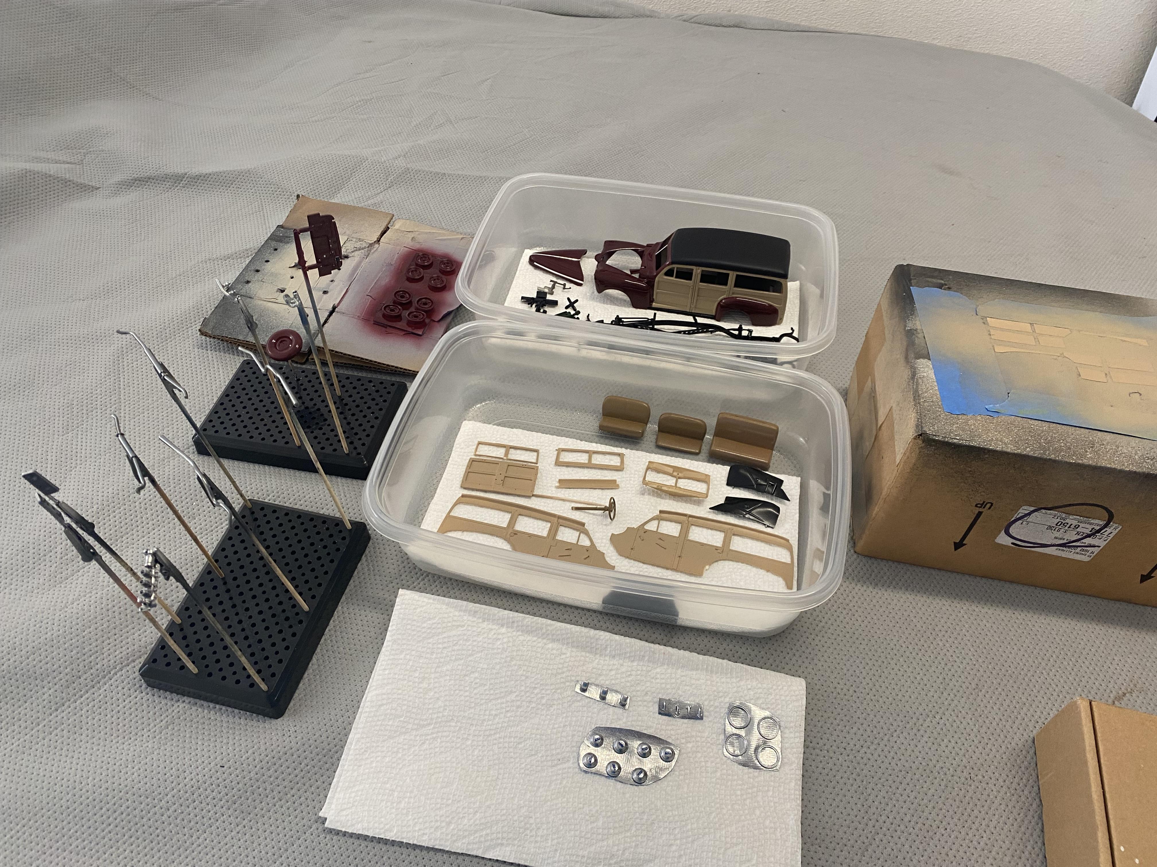

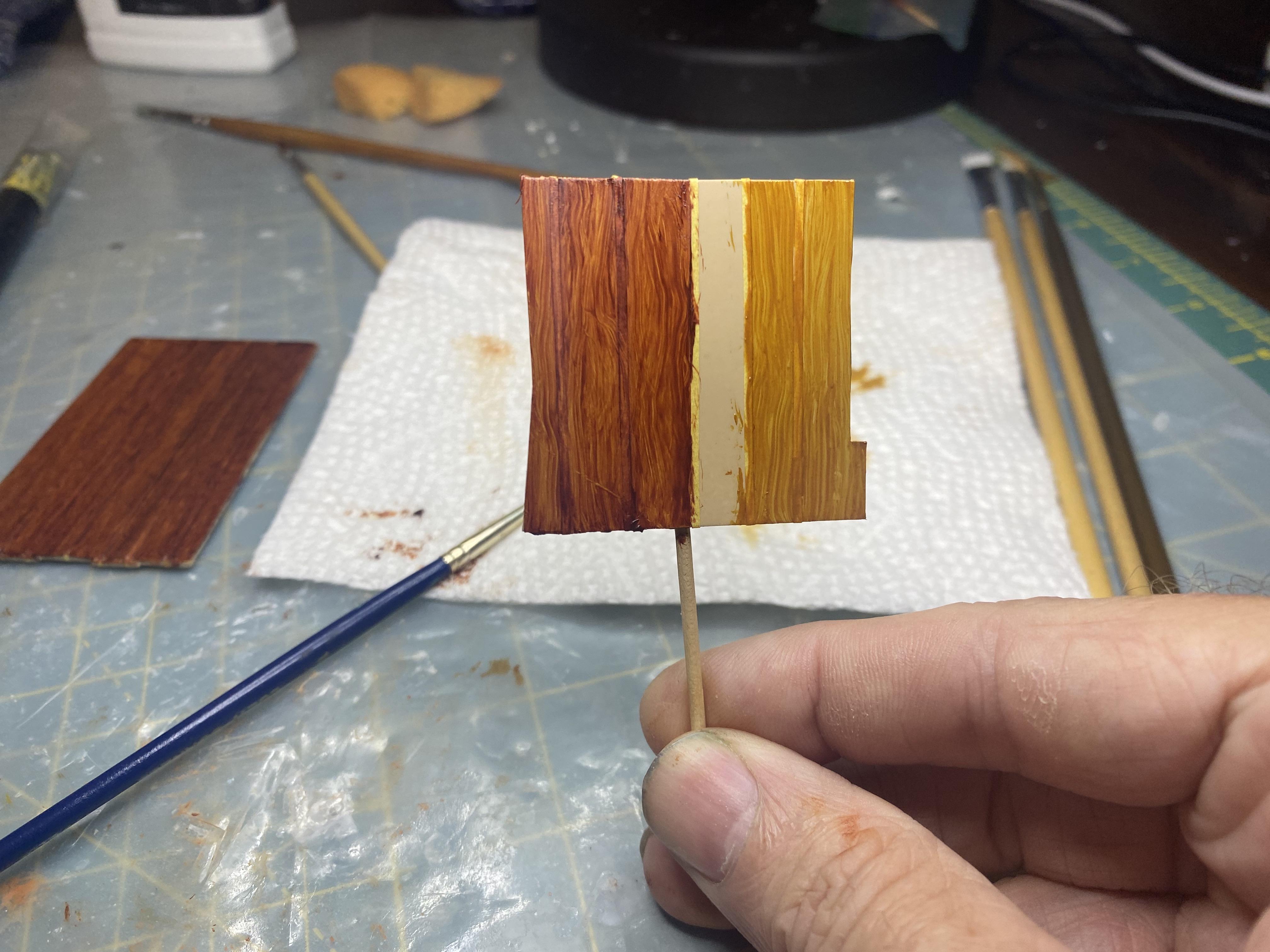

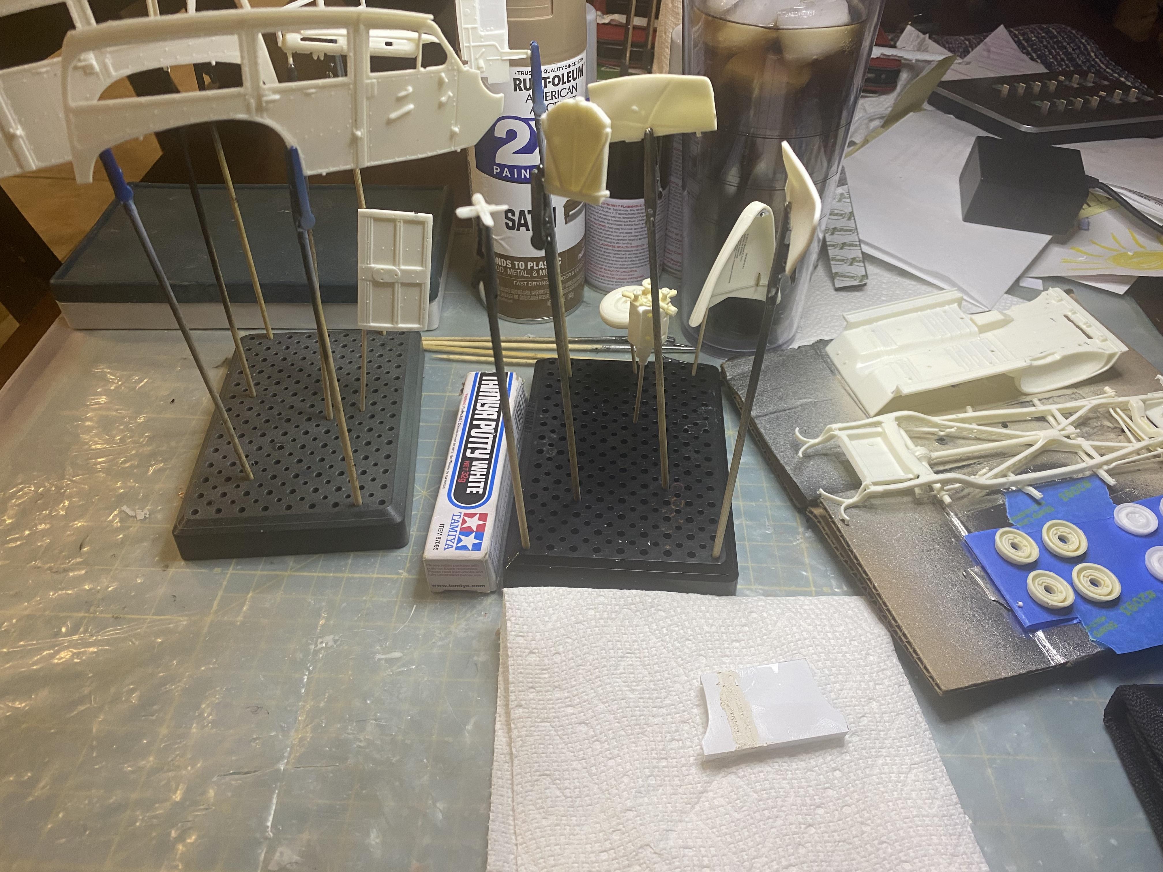

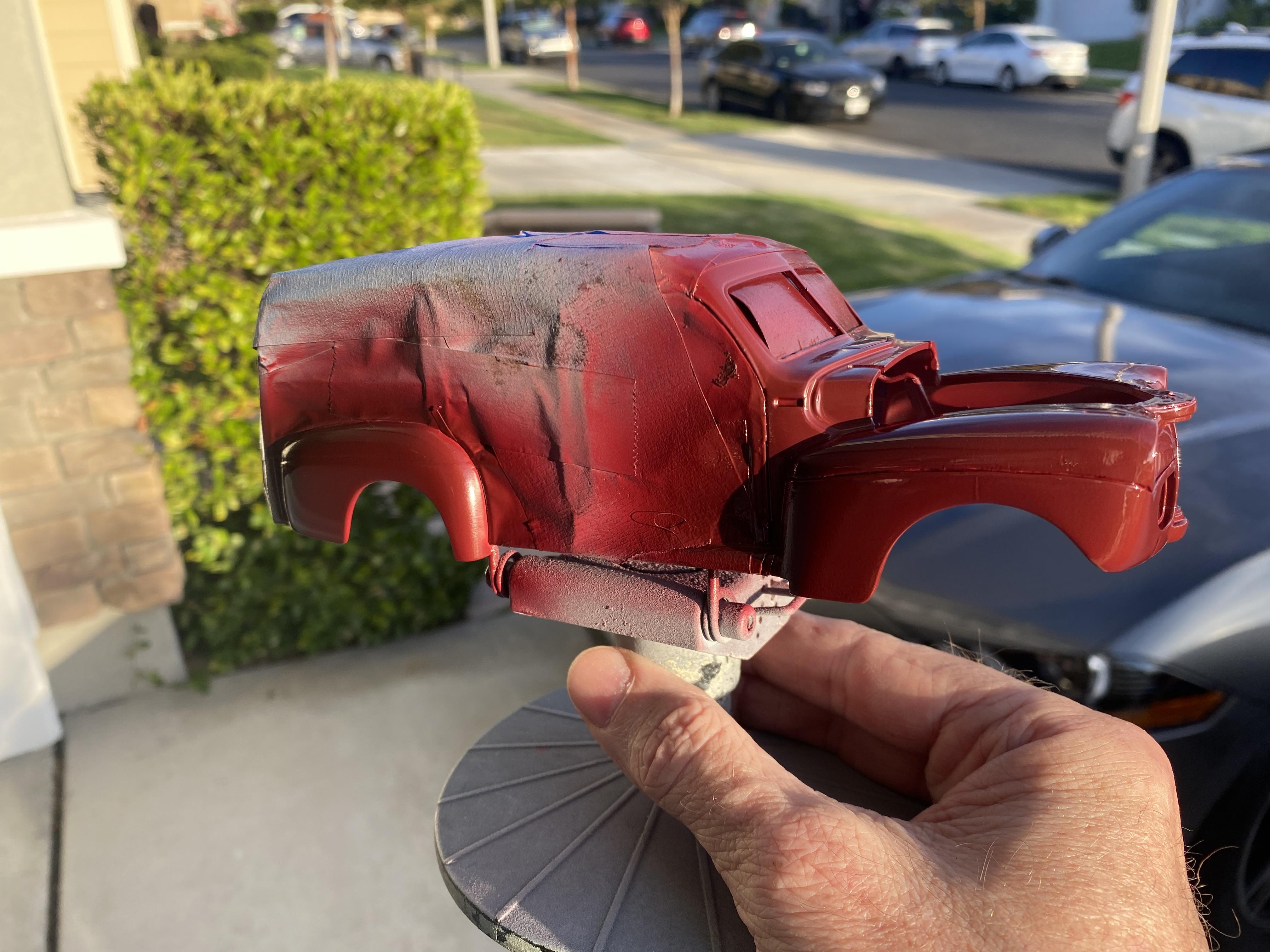

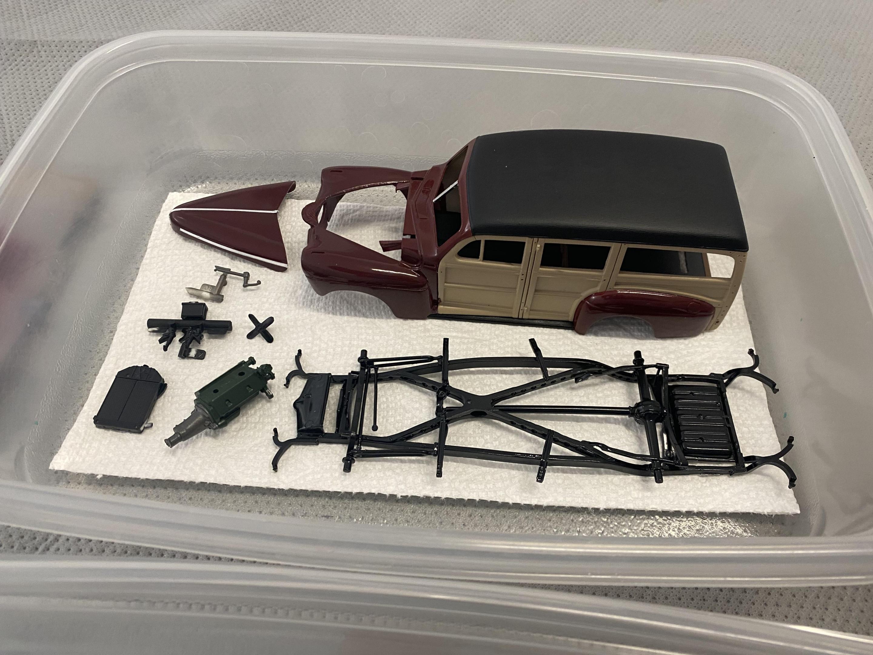

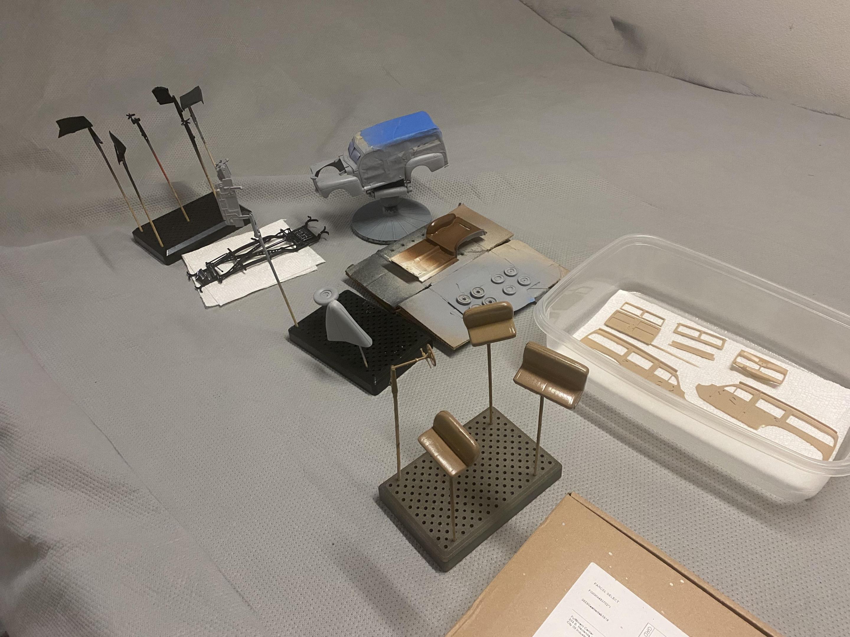

Finally started getting some paint on the Woody. Base coat on most components. Next step will be to create the woodgrain effect much like I did 1950 Chevy 3100 bed.
IMG_5632.thumb.jpeg.c5802baa547b8ae12d5c30542f4ea3ee.jpegIMG_5636.thumb.jpeg.5480d4fd577b525bc35a6cd592992503.jpegIMG_5638.thumb.jpeg.2d75da6a3f3b330e4e188956e3548220.jpegIMG_5639.thumb.jpeg.01ef9a87090a399c2dcc80797398057c.jpegIMG_5642.thumb.jpeg.8f840f652fc7295e2e9cc6f60b4243c4.jpegIMG_5643.thumb.jpeg.38f3375d931fd0f1bb6459f9242a0ad7.jpegIMG_5644.thumb.jpeg.e551ba2d783bd7cb43cb8c162b32b32c.jpegIMG_5645.thumb.jpeg.9ad266f8dc9338ba7992e5398d5af7a9.jpegIMG_5646.thumb.jpeg.8a6390c891ec2fa8f92d05a6af54b6f1.jpegIMG_5647.thumb.jpeg.8e93a88244a201c0aeb12b22242518e5.jpeg2024-07-2810_07_07.thumb.jpeg.552485e4a2223fa5d4bde8e64052e254.jpeg
