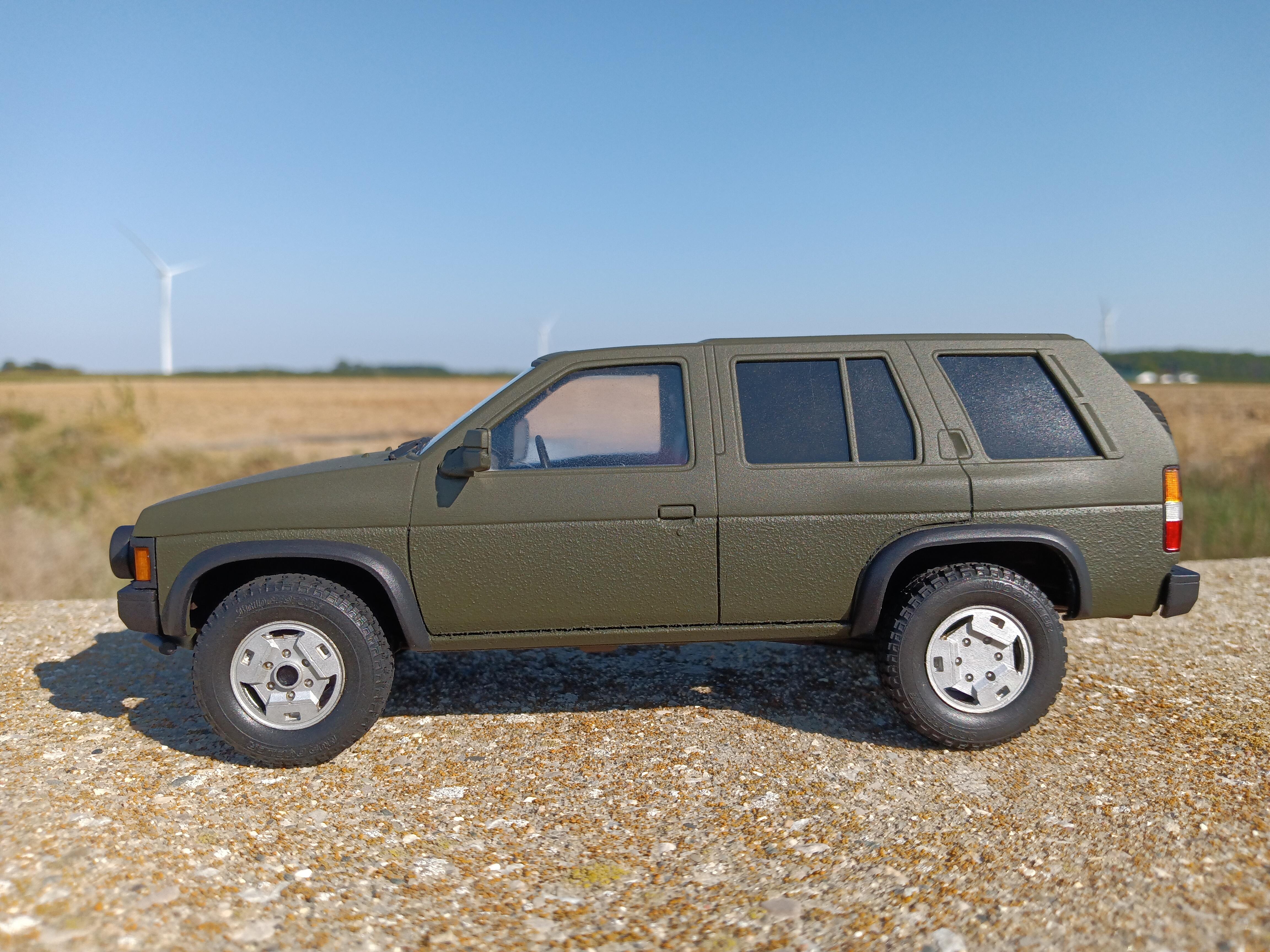

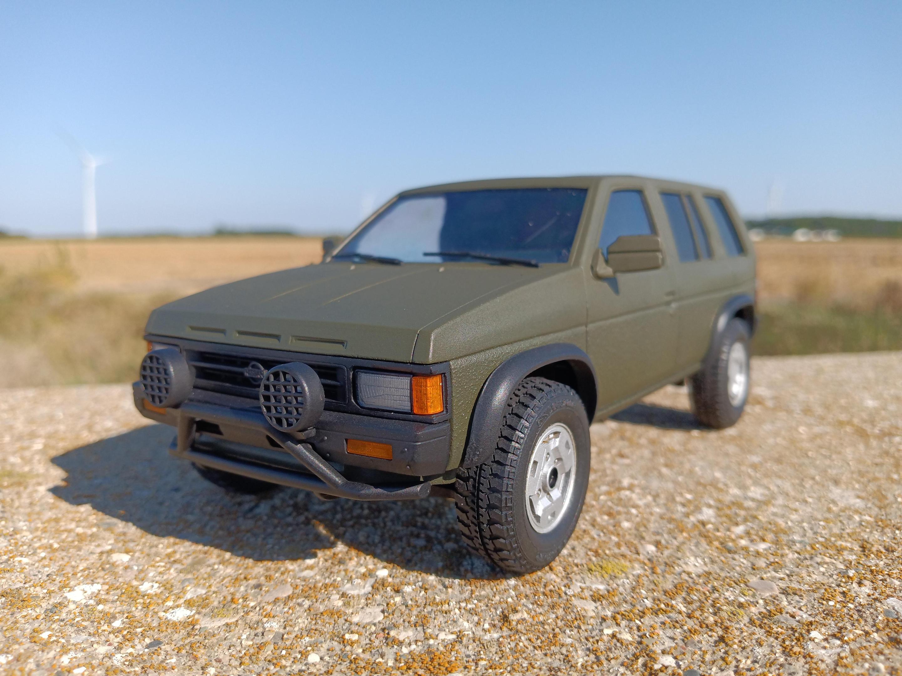

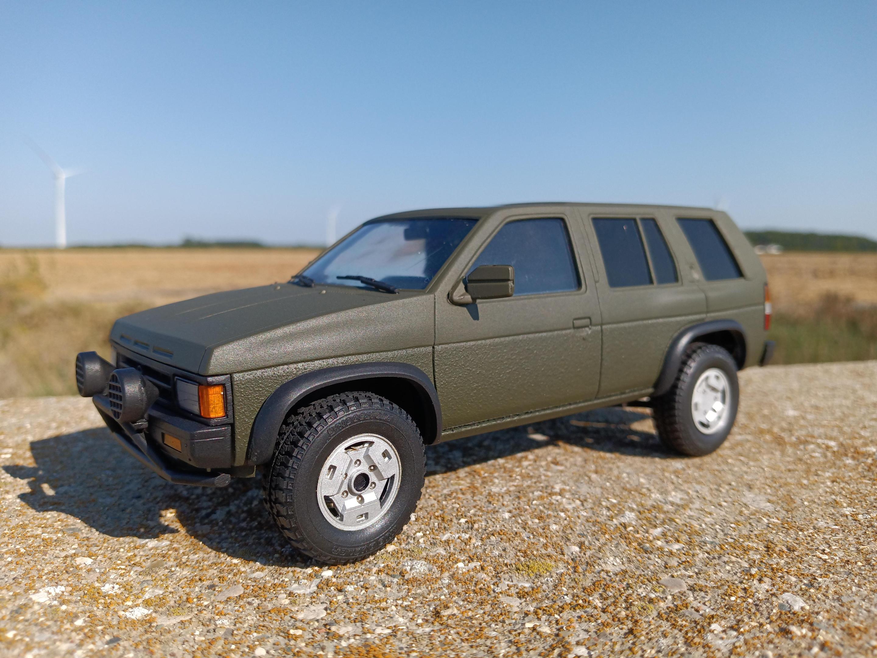

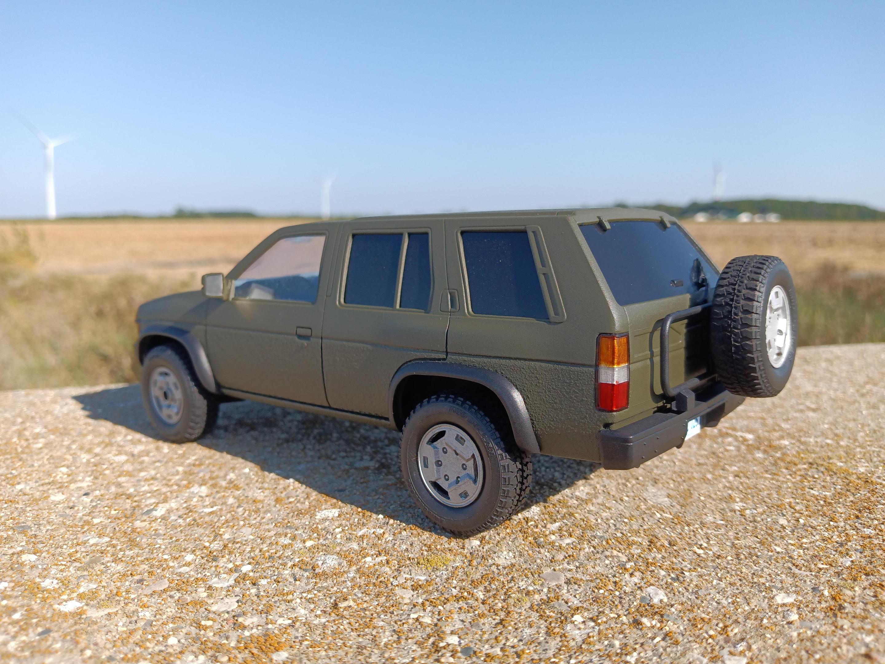

The model is the American Satco boxing of the Aoshima kit. Basically this was an LHD version with US market graphics. Satco offered a set of stock alloy wheels cast by Modelhaus, which this particular kit had. Satco offered a few different wheel and tire combos as extra cost options, and the kit was also available with a 1992 Pathfinder dealership brochure. The kit this was built from had the wheels and brochure, but not all of them did. The kit is 100% out of the box in that regard, then.
Textured Krylon was used to simulate the Line X look. I scribed the door lines deeper so they wouldn't be lost under the textured coating. Then the entire body was hit with black primer, then Tamiya Olive Drab.

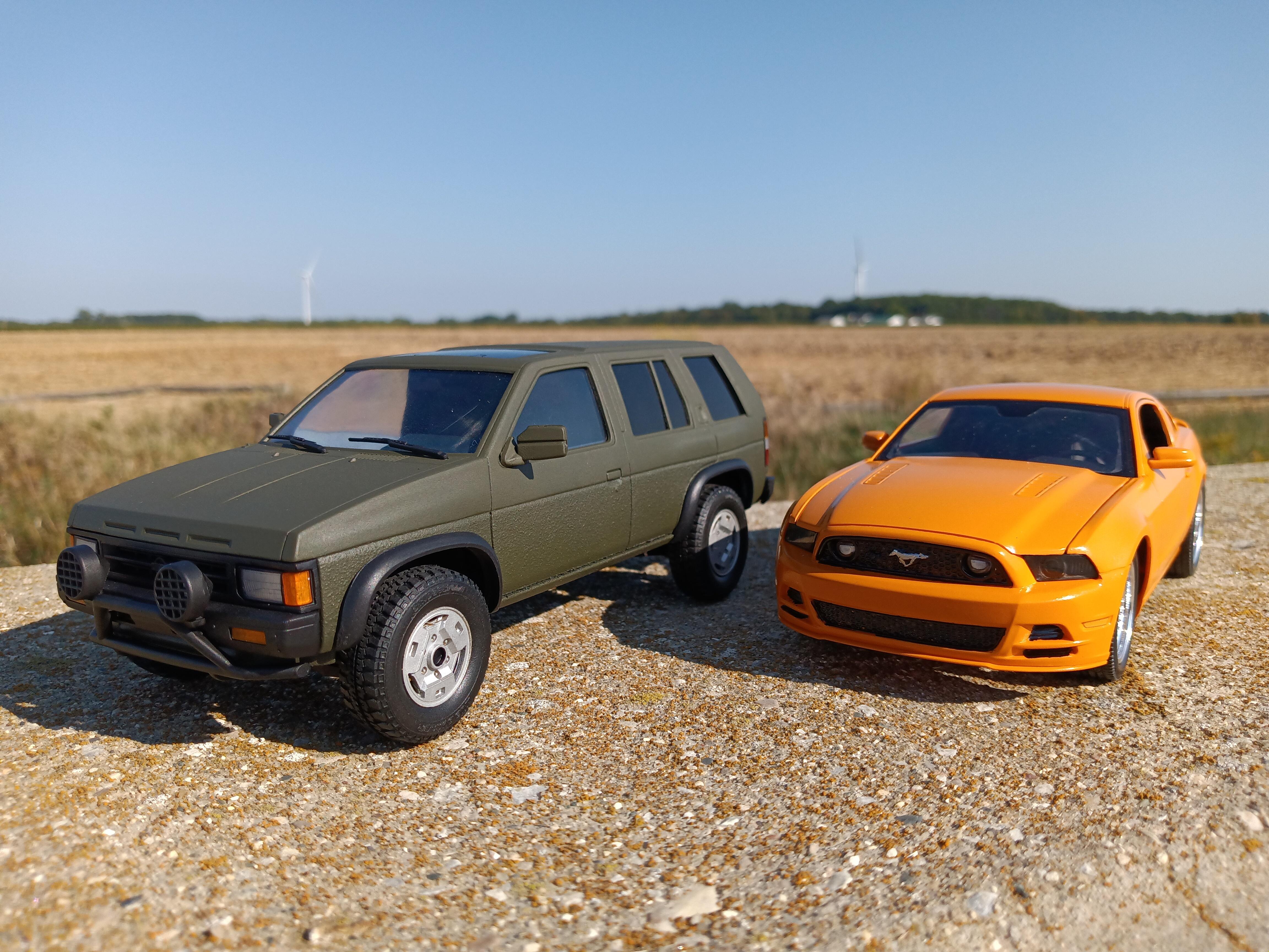

IMG_20240916_163315.thumb.jpg.132dd5433afc3bf2665ac99d24b9c433.jpgIMG_20240916_163324.thumb.jpg.e83308ef912390cb2d1836876fe6e3ef.jpgIMG_20240916_163334.thumb.jpg.1ba8333c1c6f8defc139979093c30834.jpgIMG_20240916_163344.thumb.jpg.081d2902bb6814a998997a5fe90ccf49.jpg

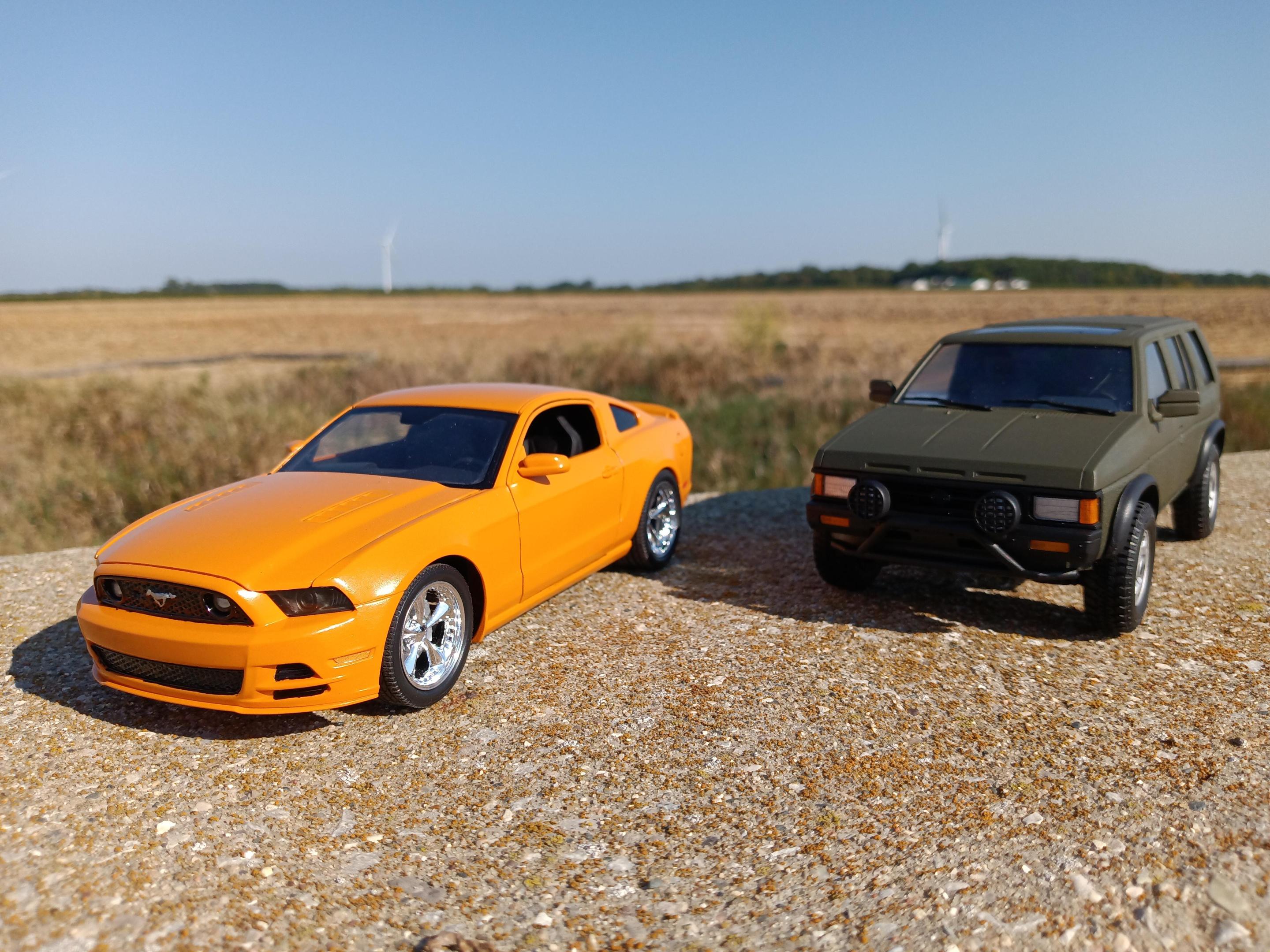

Pretty soon Mike's Mustang will be locked away in the winter paddock, and the Pathfinder will be on full time duty.
IMG_20240916_163418.thumb.jpg.74ebc695103721bd257f2b94385d957c.jpgIMG_20240916_163427.thumb.jpg.7d0ae281bfd281a6c4ad6de9b9d27d78.jpg

Like the Off-Road look of this. I have seen guys do the Line-X paint job on a few 1:1 Wranglers that see a lot of tight trails and they don't worry about the scraps from the brush. The brush guard looks good along with the lights.
