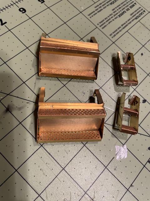

RoninUtah Posted September 22, 2024 Author Posted September 22, 2024 More progress: The interior is done: The seatbelt strap is a bit of cloth ribbon, threaded through little brass eyelets and then threaded through slots in the resin piece... So, I put the cab aside for the time being while I'm working on the chassis accessories- Battery/tool boxes and steps are PE brass, folded in to shape and cemented together. For some reason, the PE sheet with the fuel tanks seems to have vanished. To be honest, I wasn't too crazy about trying to bend sheets of flat brass into cylinders for the tanks- I tried that with the Argosy build and it didn't turn out very well. I have plenty of older style KW tanks of the right size in the parts box, but that left me with a dilemma- the straps on the W990 tanks are much wider and flatter than the old style tanks, and I was wondering how to deal with that. A light-bulb moment happened when I was about to toss an old prescription bottle and I realized that it was just the right diameter- so I sliced it into strips (after cleaning off the label goo). I ground down the straps on the kit tanks, cut the medicine-bottle strips to size and they slipped right on! We'll see how they look when they are chromed. BTW, the fuel tanks and the wheels will be to only styrene parts on this build. Next is chrome- the bumper, grille, headlight assemblies and hood vents all need to be chromed, as well as the exhaust stacks and shields and of course, all these chassis accessories. I hope I have enough Motlow left in the bottle to do it all; if not I have another bottle on order. Fingers crossed! 5

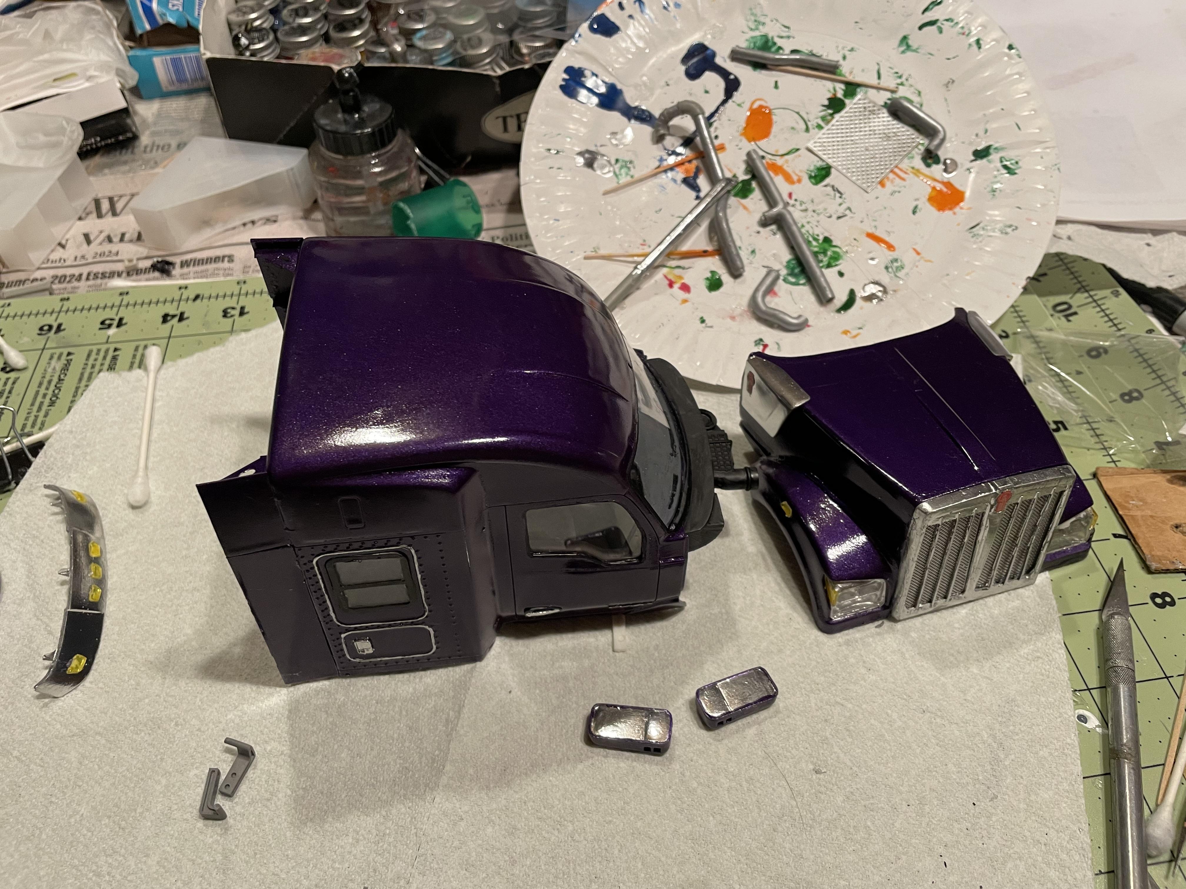

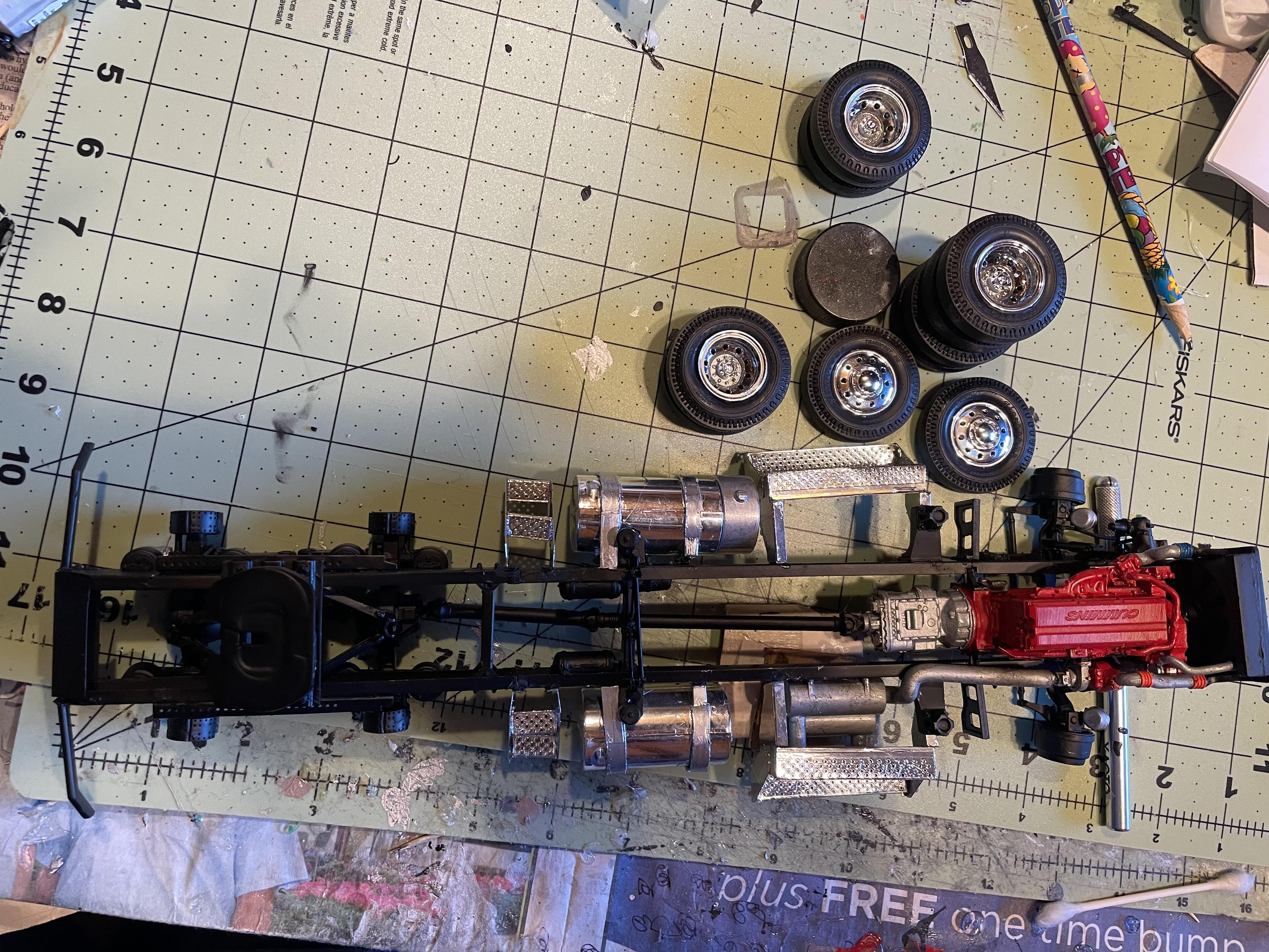

RoninUtah Posted September 25, 2024 Author Posted September 25, 2024 When I get into a build, I don’t eat or sleep and the cat goes hungry… but I get a lot done! Just kidding, but I’ve been putting some time into this one. The chassis is ready to go on wheels and the cab and hood are almost ready for installation. With a little luck I should be wrapping this up in a couple days! 5
