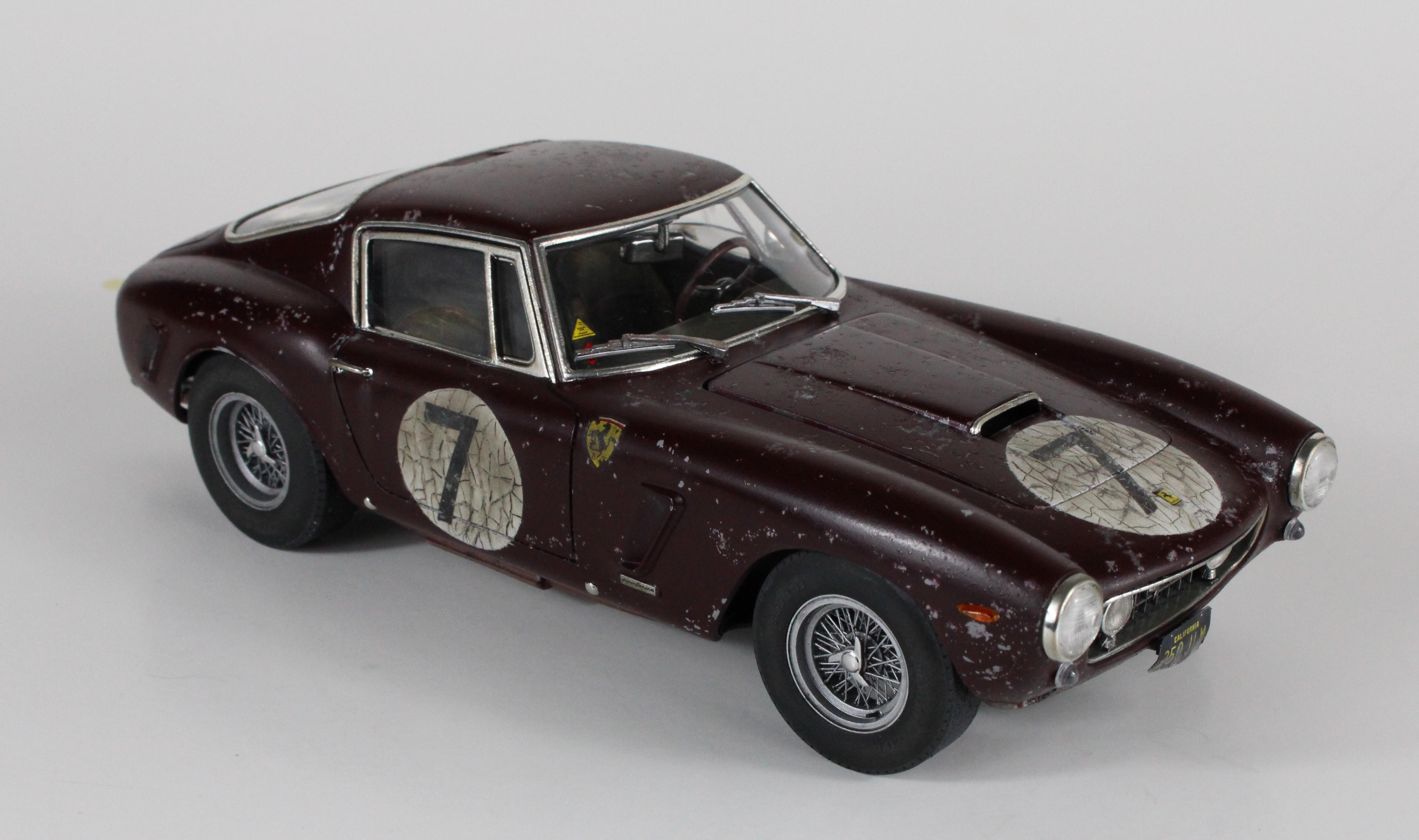

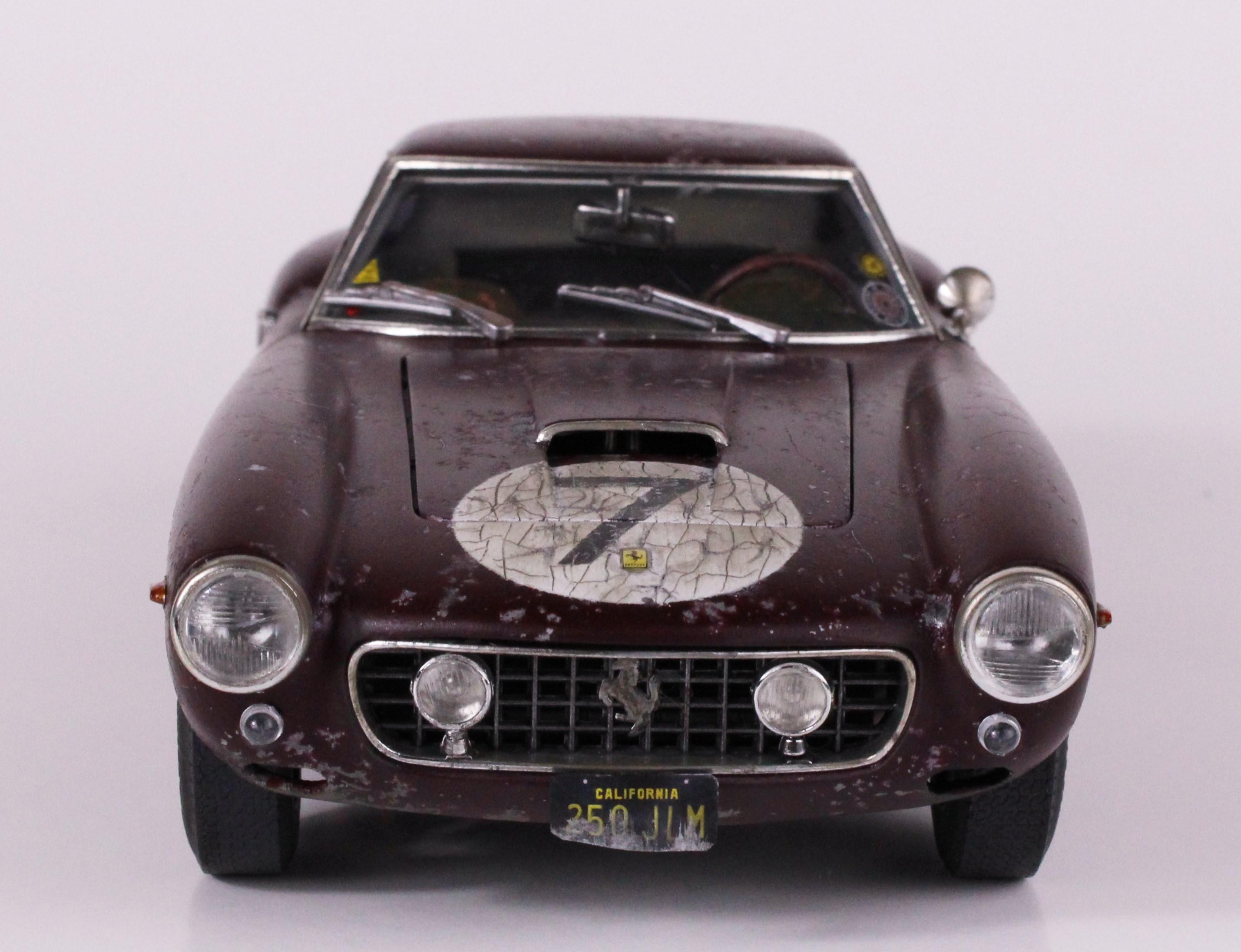

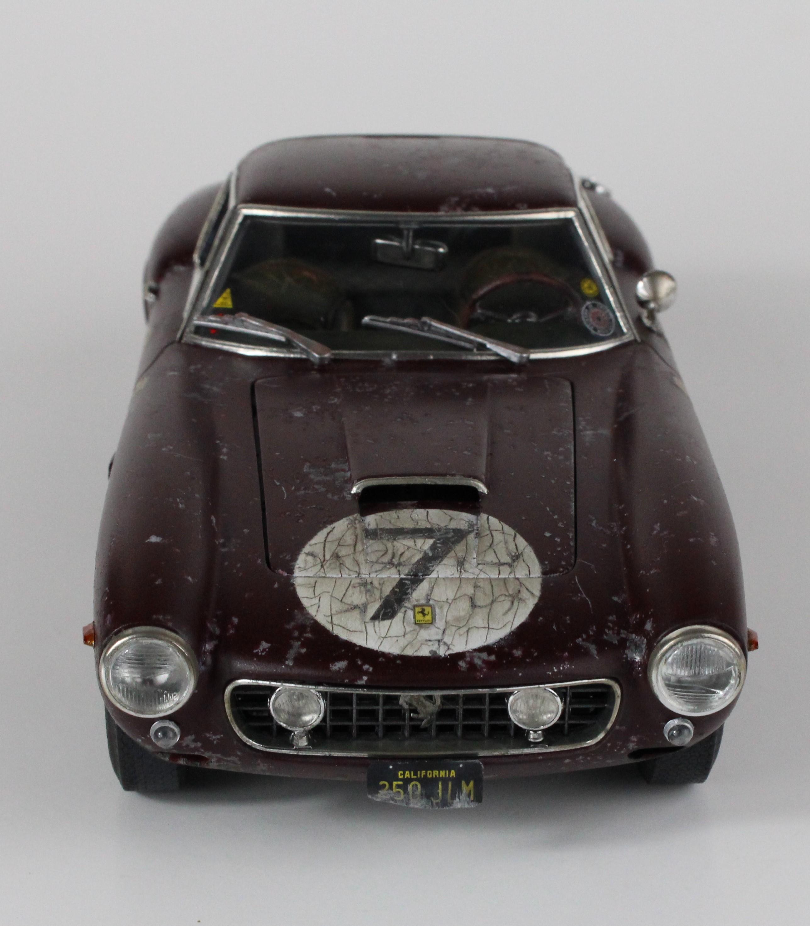

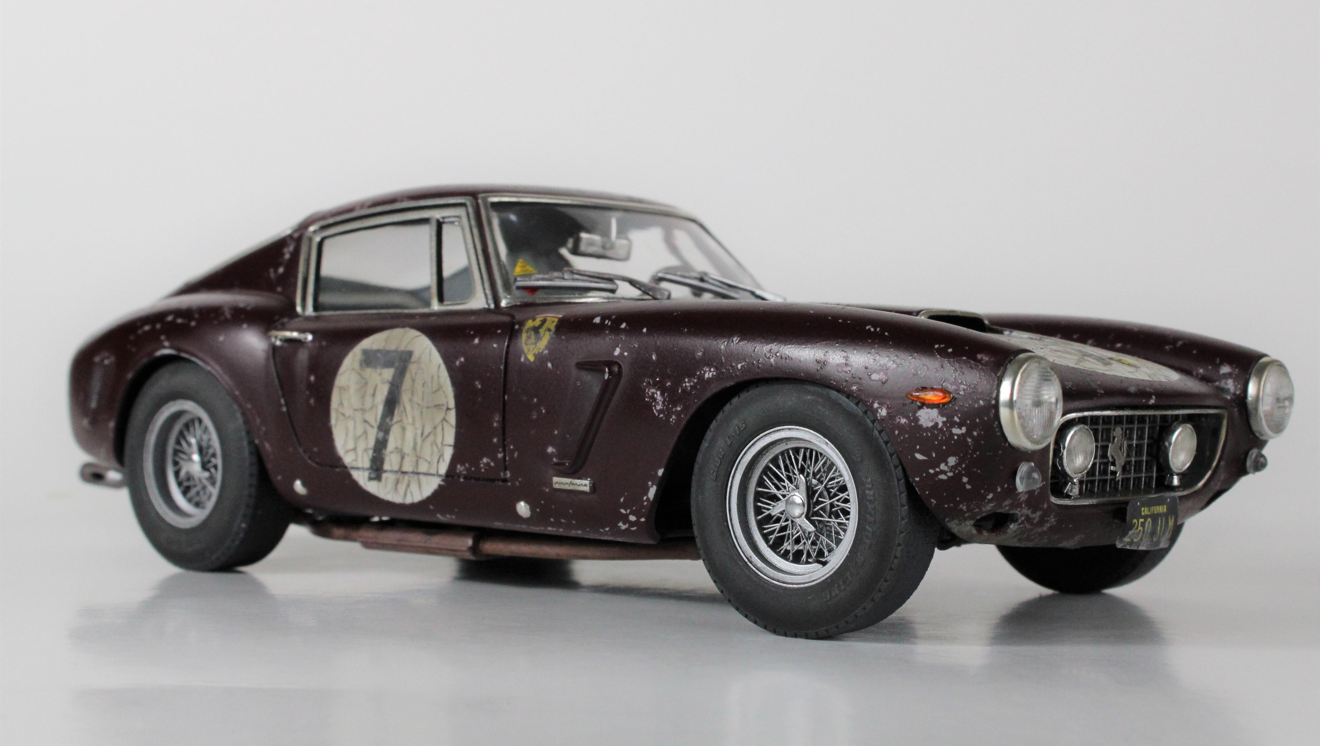

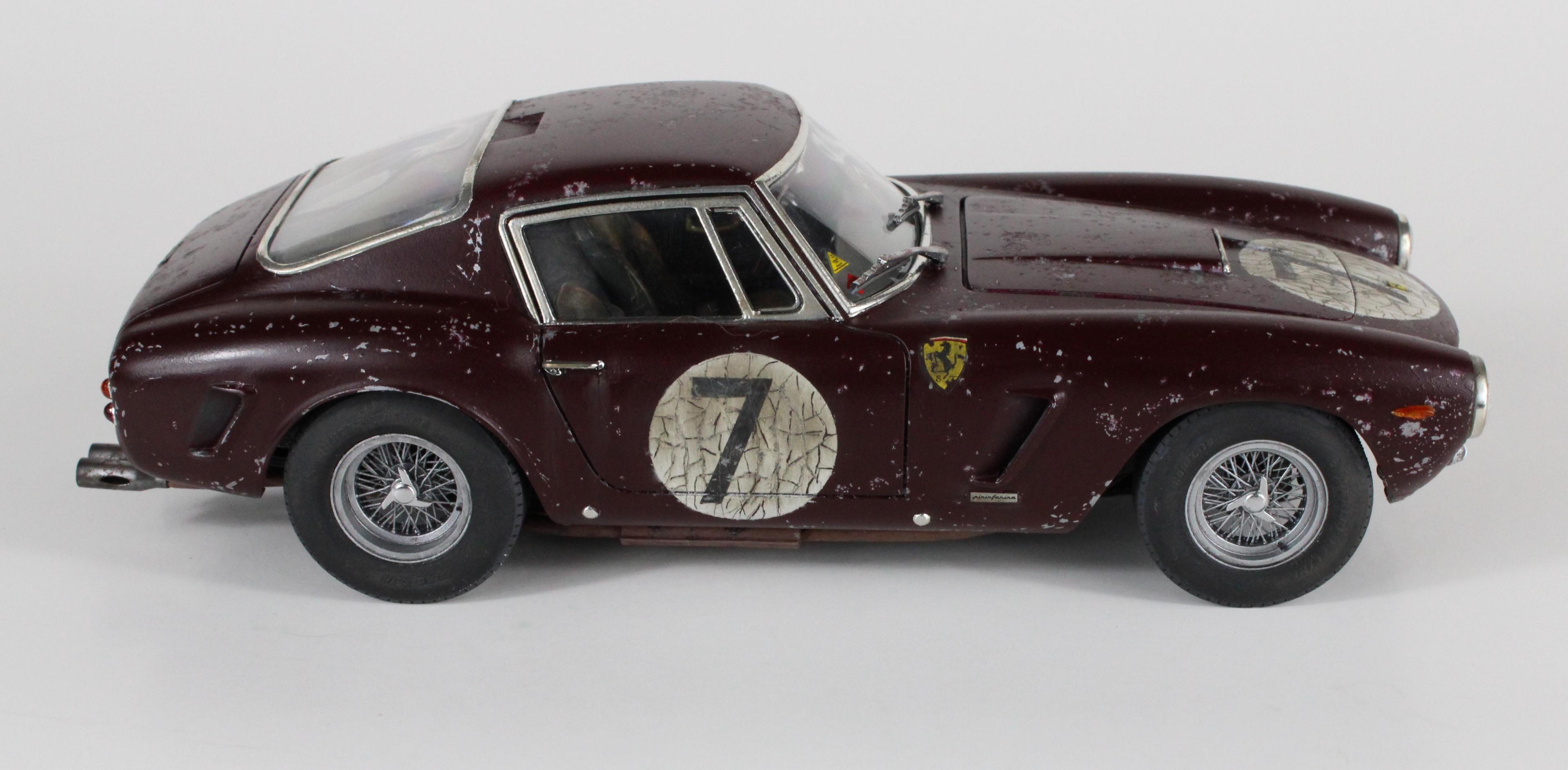

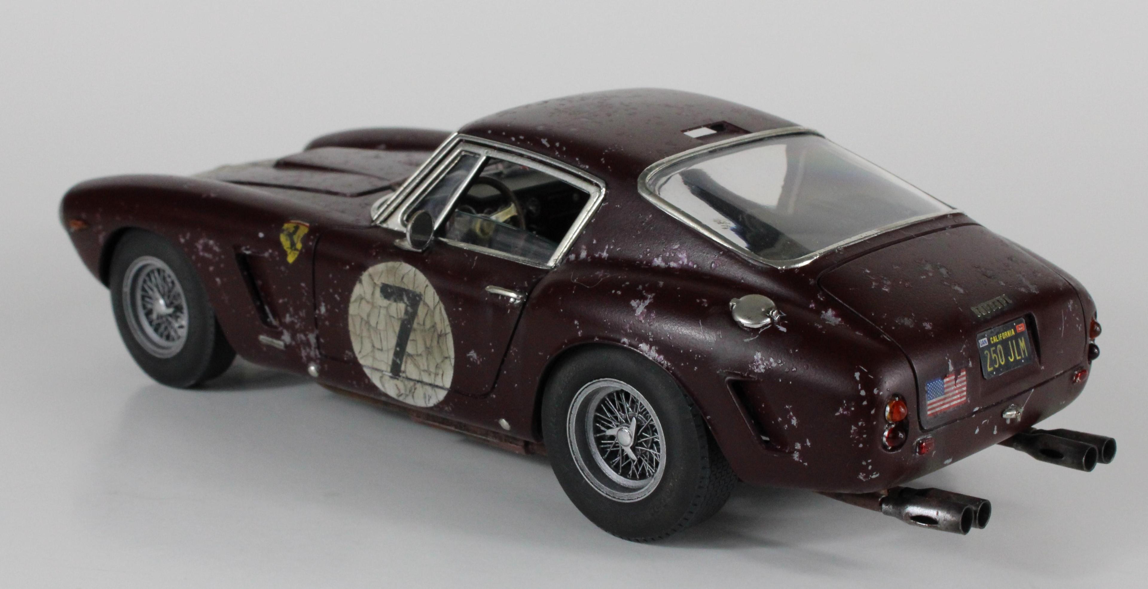

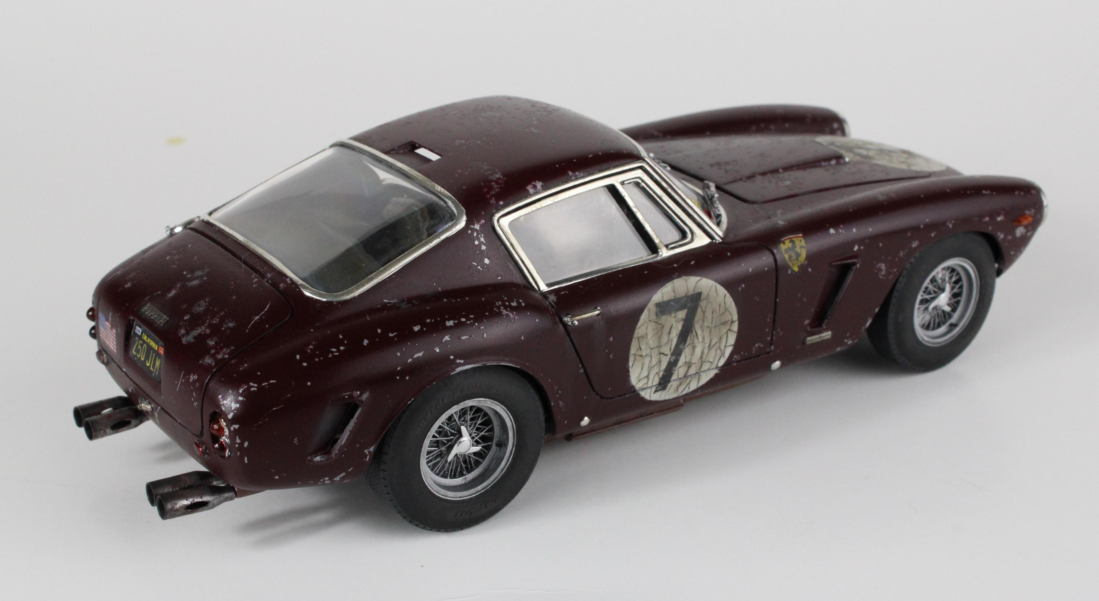

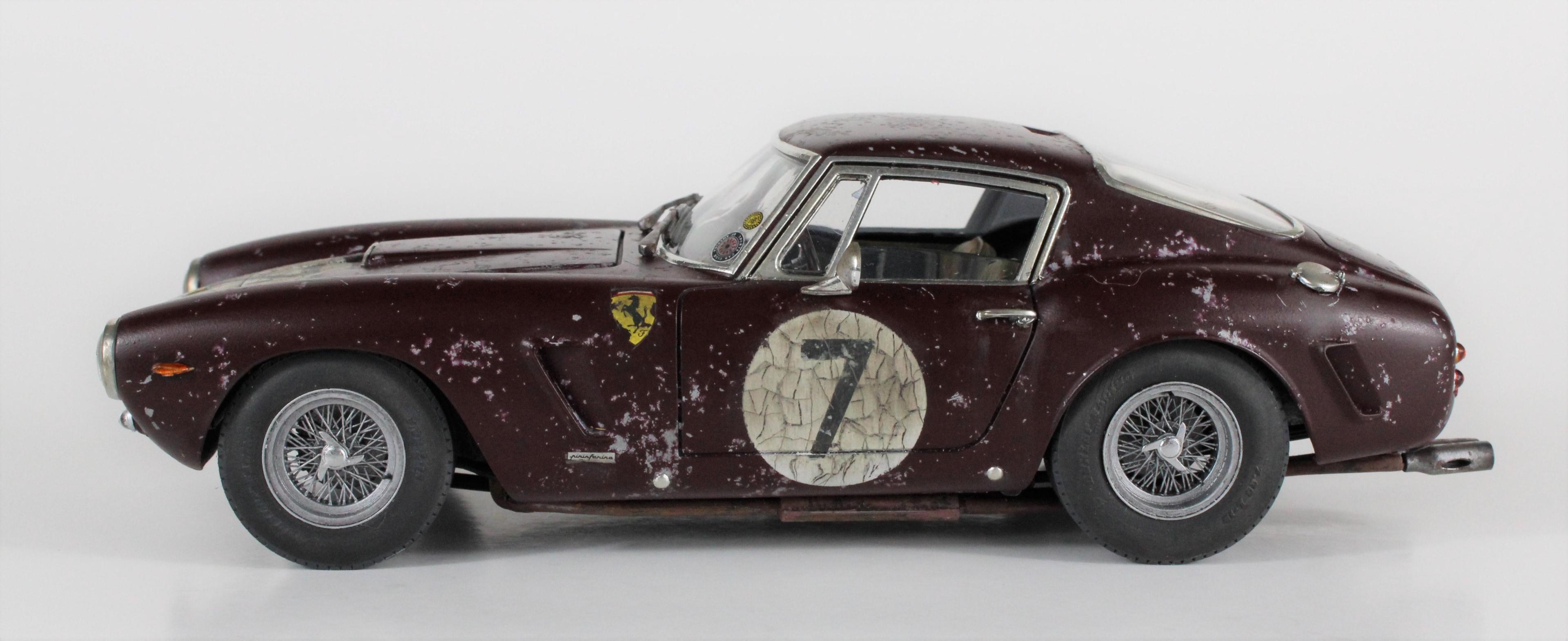

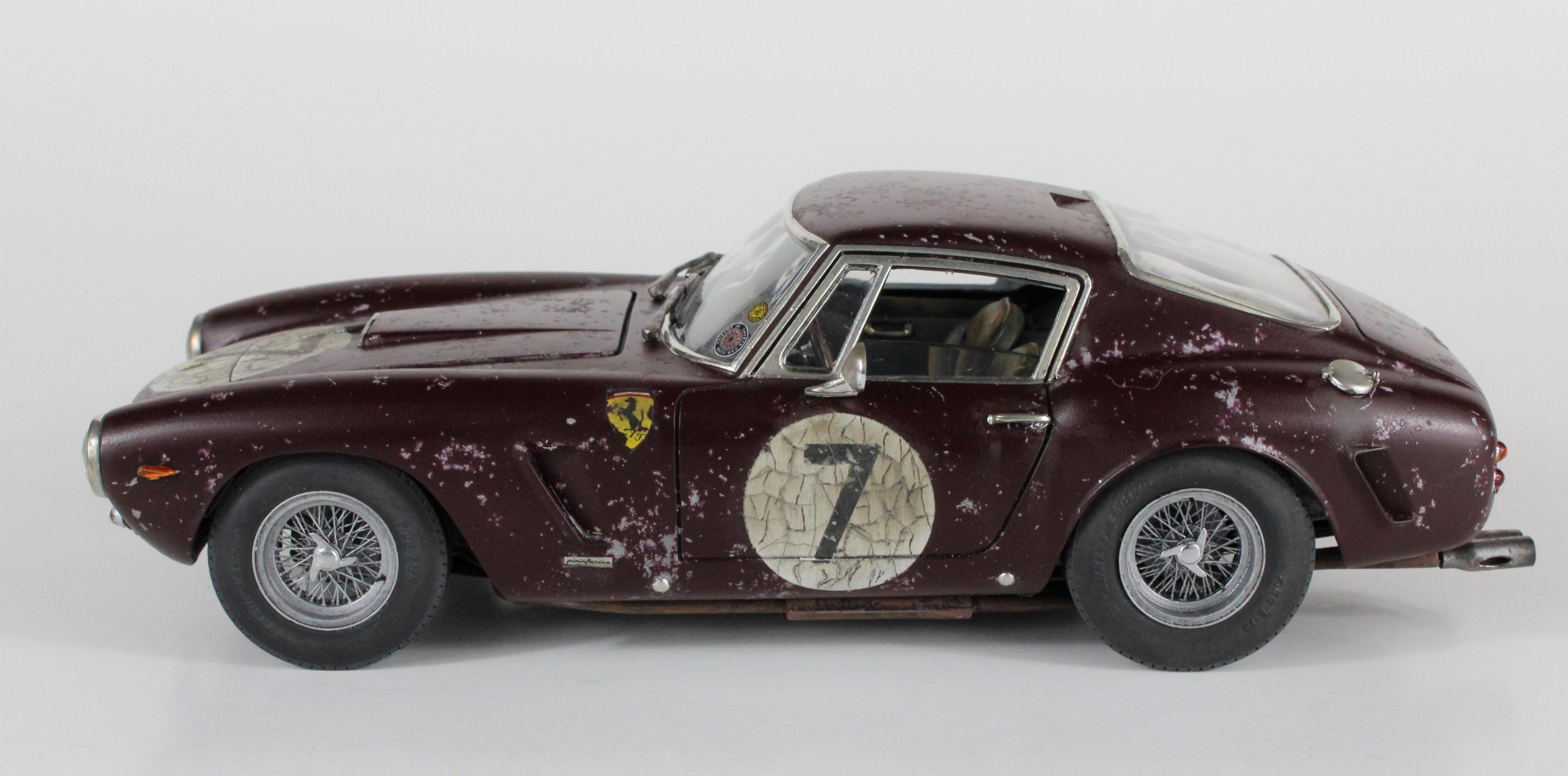

I've recently gotten interested in the idea of preserved, as opposed to restored, vintage sports and racing cars. It's a fascinating topic discussed at length in Miles Collier's book "The Archaeological Automobile" and is probably most succinctly summed up by the phrase "It's only original once". I've become more interested in modeling this aspect of the collector car hobby lately. I still enjoy building shiny things but it's fun to shake things up once in a while!
This is the rare Italeri Ferrari 250GT SWB kit. It's a later development of their 250 series kits (the 250GTO and SWB California kits came first and have been rereleased several times) and is a pretty decent representation of the shape of a later SWB. There are glaring inaccuracies in other areas of the kit, though. The seats are atrocious, being incorrect in shape and detail as well as being closer to 1/32 scale in size. The engine bay is okay, but short of detail. The chassis is good and the stance out of the box is excellent, however. It's not modern Tamiya, but it's not bad at all.

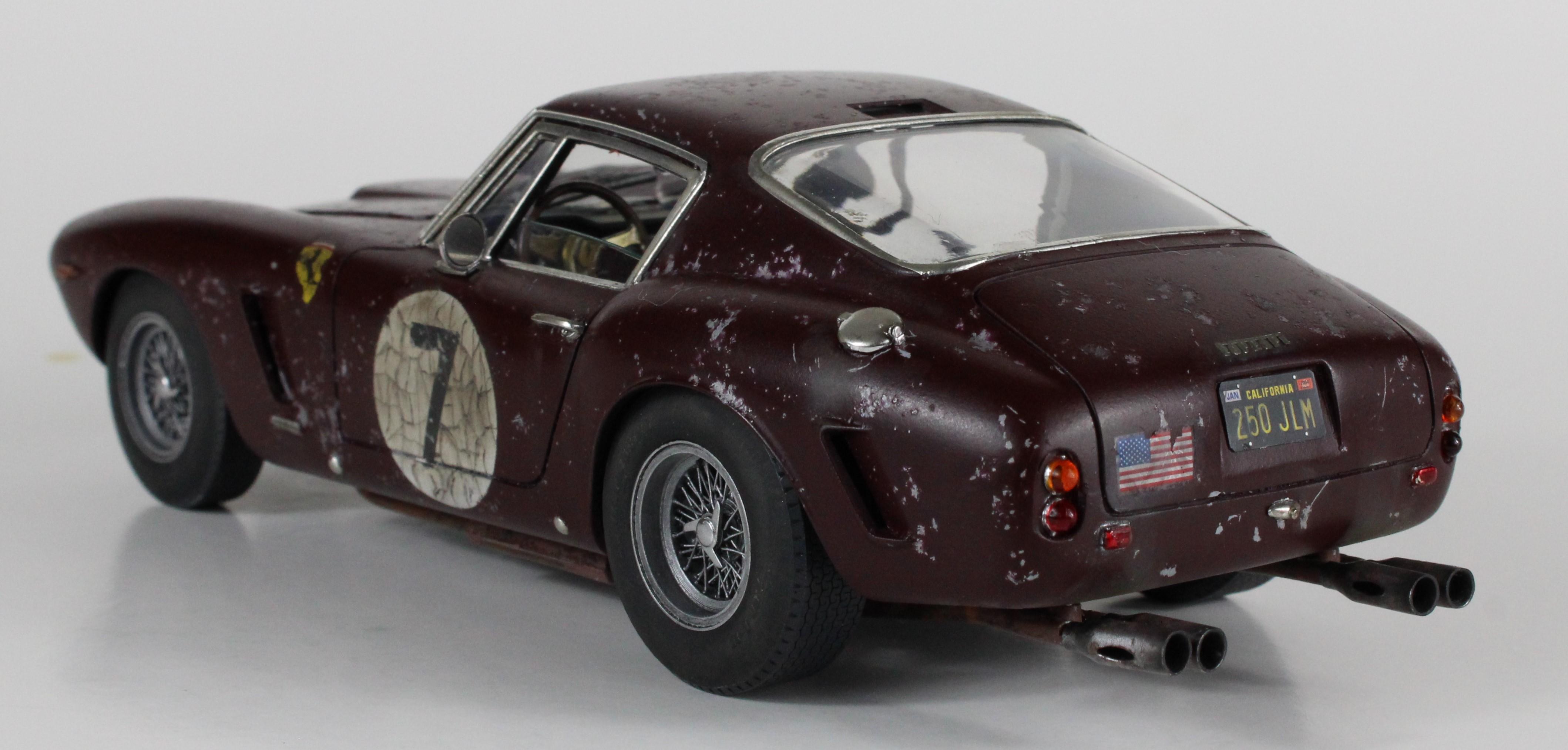

Certain elements will always make or break a build. The kit wire wheels are acceptable but there are better alternatives out there. PE wires are an improvement but the latest generation of 3d-printed wire wheels are a game-changer. The units here are big & little Borranis with Dunlop racing tires by Jack Modelling. They fit the kit's spindles perfectly with just some spacers needed between the brake disc and wheel back to push the wheels out a bit. The seats are Revell Shelby Cobra units modified to represent stock racing buckets with Tamiya 2-part putty and wire.
I've said it before but the thing when you take a build like this on is that you can't have a weathered body and a pristine interior and chassis. When you start down that path prepare to walk it until the end. So you're not just painting every part... you're painting, then applying a wash, then dry-brushing and maybe even applying pastels to basically every single part. Lots of work, but it's a lot of fun.
The weathering technique on the body work is a combination of many things. Salt weathering was used to expose the aluminum under the paint. Basically you apply your base color (Vallejo Model Air Aluminum) and then moisten the surface and sprinkle with kosher salt. Once that is dry it forms a fragile mask. Apply your top color (Tamiya Maroon) and once that's dry, brush the body to reveal the bare aluminum underneath. I then masked and painted the roundels and numbers, and scratched cracks into the white paint using a dull X-acto blade.  I then applied Vallejo washes to the panel lines and to tone down some of the too-shiny exposed aluminum.

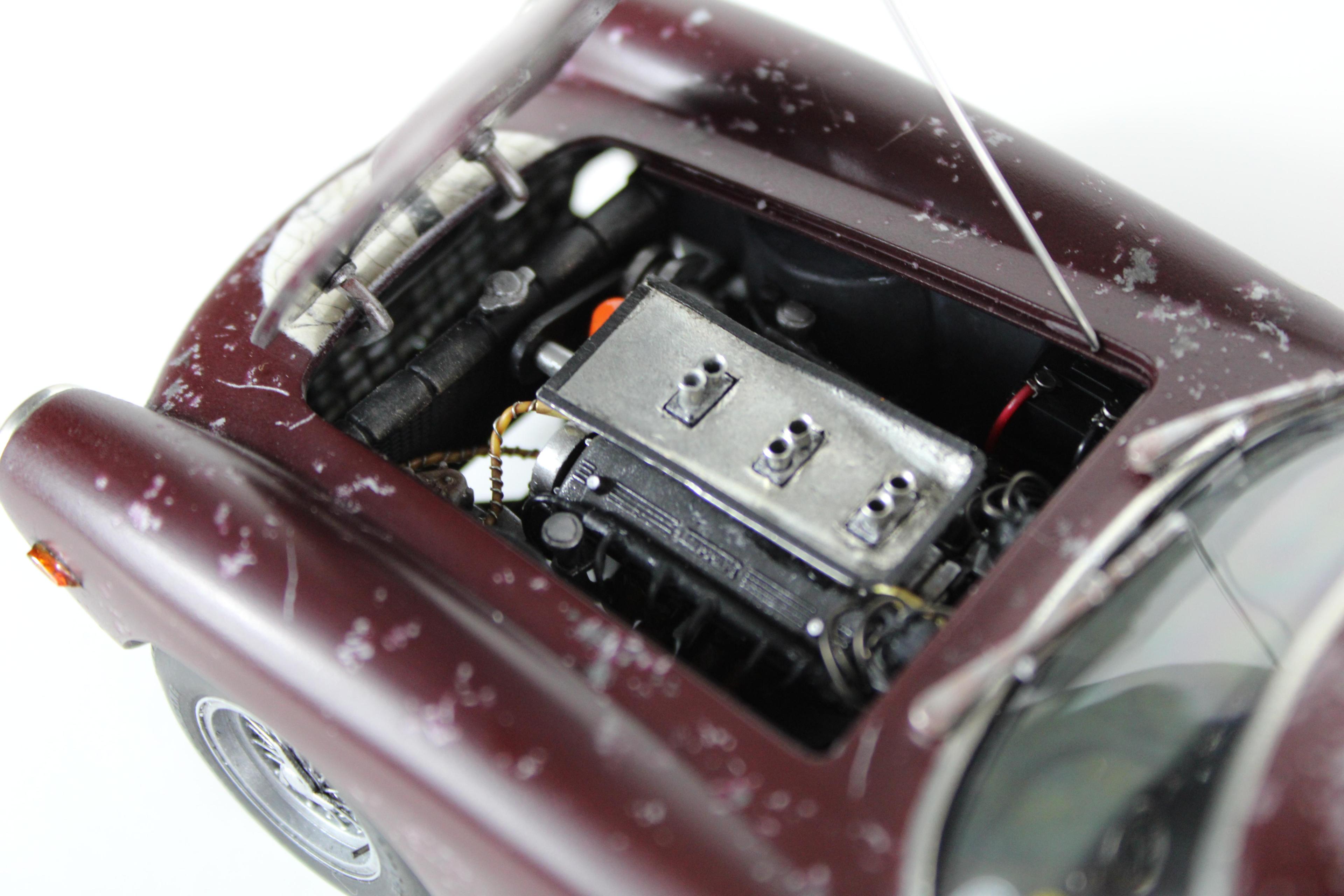

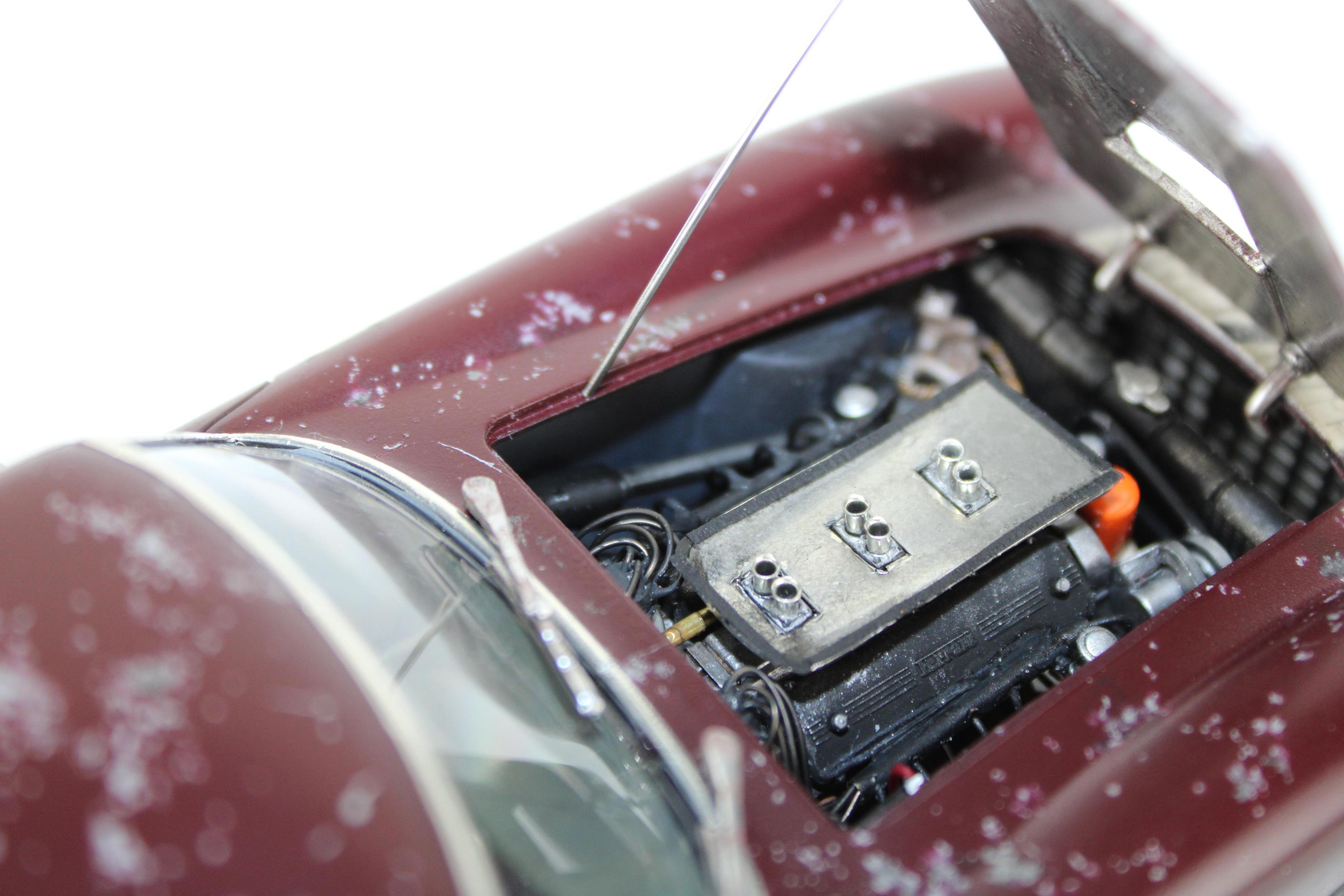

I added a fair amount of detail to the engine bay but ran out of room to add the radiator hoses Italeri forgot. THe most annoying fit issue I had was that the radiator fouled the hood hinges and needed to be moved back quite a bit, leaving no room for the radiator hose unit I was going to adapt from the Fujimi 250GTO kit. It looks pretty good though...

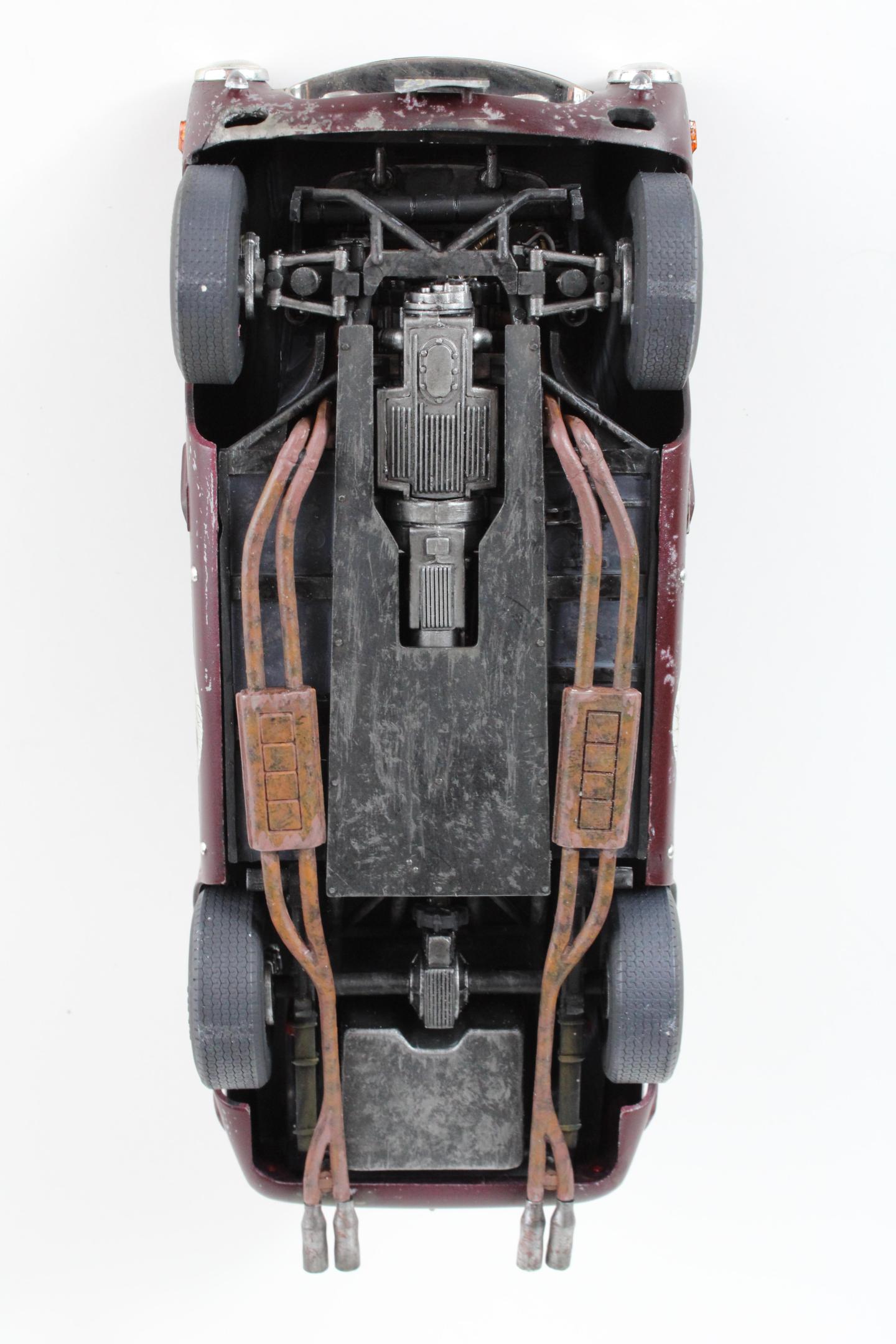

The chassis is appropriately rough and ready as well.

The final details: License plates are decals from Warbird from their California license plate set. I mounted them to aluminum printer's plate so I could bend up the front plate. Pastel weathering on the body is Tamiya soot and oil stain Weathering Master pastels. The exhausts are "SNAP" exhausts from the Fujimi 250GTO kit. They were a popular period aftermarket exhaust for racing Ferraris. The windshield decals are from VRM's "Number Circles and Things" sheet and tell the fictitious story of the early life of this car. It was raced in the Targa Florio in 1962, imported into the US and ran the 12 hours of Sebring in 1964 and 1965.
