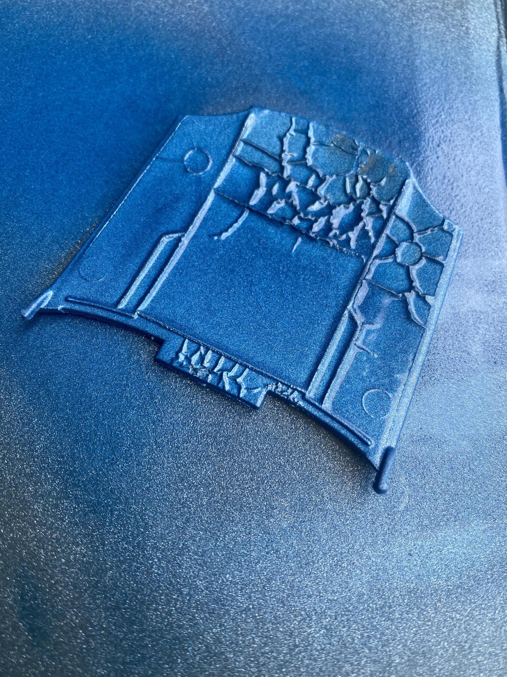

Kaput 705 Posted October 1, 2024 Posted October 1, 2024 Hello All - I just painted the underside of a hood of a stock car model I received and this happened: (see attached photo). Dupli-color perfect match over rustoleum primer. The car body is actually fine its just the hood part. Any thoughts before i run it over with the lawnmower? Lol
StevenGuthmiller Posted October 1, 2024 Posted October 1, 2024 Just a guess, but I’m gonna say “Rustoleum” is your problem. Strange how that name comes up with about 90% of paint issues. Steve

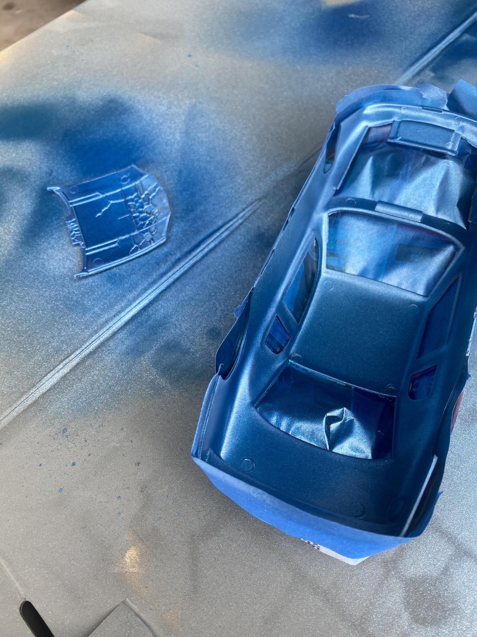

Bainford Posted October 1, 2024 Posted October 1, 2024 It looks like the classic reaction when painting lacquer over enamel. I am guessing the Rustoleum primer is enamel. Curious it didn't happen to the rest of the body.
Fat Brian Posted October 1, 2024 Posted October 1, 2024 I agree with the other posters, this is pretty classic paint incompatibility. Use Duplicolor primer under Duplicolor paint and it will greatly reduce the chances of this happening. 1

peteski Posted October 2, 2024 Posted October 2, 2024 (edited) If the top surface of the hood and the entire car body were painted with the same exact primer and color paints I find what happened very weird. Unless maybe you sprayed the underside of the hood with a very heavy wet coat of the top color paint, but used lighter coats on the other (undamaged) surfaces?? Edited October 2, 2024 by peteski 2

slusher Posted October 2, 2024 Posted October 2, 2024 Duplicolor paint need Duplicolor primer. It’s a hot paint. Strip your hood and repaint it body looks good!
StevenGuthmiller Posted October 2, 2024 Posted October 2, 2024 This is why you throw everything else in the trash and use a good automotive lacquer primer for EVERYTHING! There's absolutely no need to have a half dozen different primer brands laying around for this, that, and the other thing. One good primer can be used under any type of paint, and you won't have to ever deal with this sort of nonsense again. My go-to is Duplicolor sandable primer, in several colors, and Duplicolor primer sealer. Of course there are others, but find one that's intended to withstand automotive lacquers and stick with that, and that only. Bouncing around between a bunch of different products is almost guaranteed to create issues at some point. Steve 2
Dave G. Posted October 2, 2024 Posted October 2, 2024 I don't use enamel primers for anything. And Rustoleum primer is enamel. I bought exactly one can with stipulation if it wasn't lacquer, as the store employee said it was, I could return it. I shot one little spritz of paint and returned it. I know the smell of enamel primer from years ago, Got my money back. I'll use enamel color coats but not primer.

Bugatti Fan Posted October 3, 2024 Posted October 3, 2024 (edited) It comes back to the very basic rule of thumb. Oil based paints over Acrylic generally works OK. But not the opposite way. Why ? Acrylic paint forms the equivalent of a thin plastic coating when dry and therefore a seal. Oil based paints used underneath cannot evaporate naturally and therefore will attack the acrylic from underneath The make of paint is probably not as important as following the basic rule of acrylic under not over. Edited October 3, 2024 by Bugatti Fan

StevenGuthmiller Posted October 3, 2024 Posted October 3, 2024 2 hours ago, bobthehobbyguy said: I think this is a gtrat illustration of the issues caused by mixing paint brands. My guess is that you may have painted the hood a little wetter and got the reaction. Staying with one brand of paint and paint type when painting. Brand is much less important than the formulation of the primer. As I said, you can spray anything over a good automotive lacquer primer such as Duplicolor, whether that be an enamel from Testors or Rustoleum, a lacquer such as Duplicolor, Tamiya, MCW, etc, or a water based acrylic. Doesn't matter. If you rely on brand, it requires that you have a bunch of different primers laying around if you use various paints. It's not necessary. All you need is one. Even the "brand" theory can cause problems if you're not paying close attention. Some brands carry lacquer primers and enamel primers, as well as lacquer and enamel paints. I certainly wouldn't risk spraying a lacquer over enamel primer, even if it is the same brand. Steve 2
Bainford Posted October 3, 2024 Posted October 3, 2024 55 minutes ago, StevenGuthmiller said: Brand is much less important than the formulation of the primer. As I said, you can spray anything over a good automotive lacquer primer such as Duplicolor, whether that be an enamel from Testors or Rustoleum, a lacquer such as Duplicolor, Tamiya, MCW, etc, or a water based acrylic. Doesn't matter. If you rely on brand, it requires that you have a bunch of different primers laying around if you use various paints. It's not necessary. All you need is one. Even the "brand" theory can cause problems if you're not paying close attention. Some brands carry lacquer primers and enamel primers, as well as lacquer and enamel paints. I certainly wouldn't risk spraying a lacquer over enamel primer, even if it is the same brand. Steve Exactly. This has nothing to do with paint brands, and everything to do with incompatibility of paint types. If the primer on this model was painted over with any other brand of enamel, there would likely have been no problems. Similarly, if Rustoleum made a lacquer paint, and it was applied over Rustoleum enamel primer, this reaction would likely occur. There is absolutely nothing wrong with mixing brands. Many of us do it all the time with excellent results. It is perfectly acceptable to do as long as one has a basic understanding of the different paint types, which, for hobby purposes, is not at all complicated (this statement ignores the introduction of two-part or 2K paints, which I won't comment on except to say, best just to avoid it altogether for hobby use). For example, Duplicolor primer, covered with Tamiya lacquer thinned with Mr Color levelling thinner, and cleared with Alclad works great. The key is that they are all lacquer compatible, and the combination was tested beforehand. Once a little experience is gained, one can move forward with confidence. As Steve mentioned, a newby who finds himself confused by all this paint stuff and 'plays it safe' by selecting all Tamiya products may find he has a frustrating and discouraging mess on his hands, since Tamiya markets acrylics, enamels, and two types of lacquer paints. A potential quagmire of incompatibility. It is important to understand the basic issues (they are not difficult), and not just blindly choose products because they are the same brand. Additionally, instructing others to 'stick to one brand' stifles experimentation, which is a fun and interesting aspect of our hobby, and has led to some excellent discoveries over the years that many of us now take advantage of. The key is to test before committing to a kit. Also, screwing up the paint on a kit is not the 'end of the world' event that some people make it out to be. Just chalk it up to experience, strip it and move on. 1
