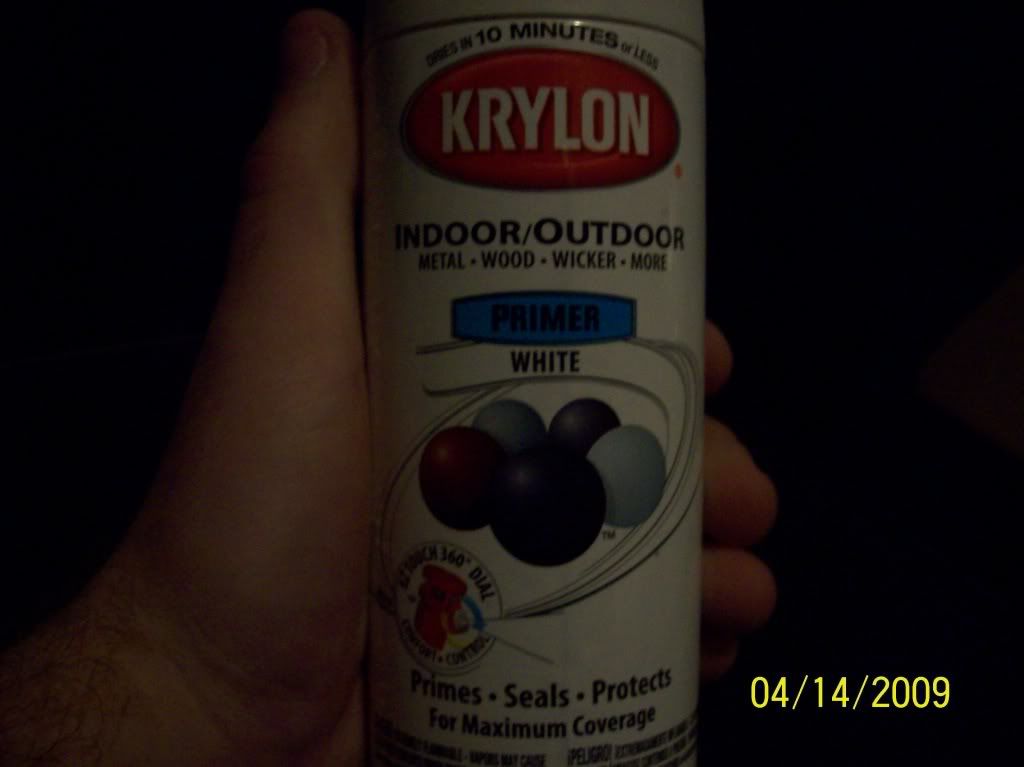

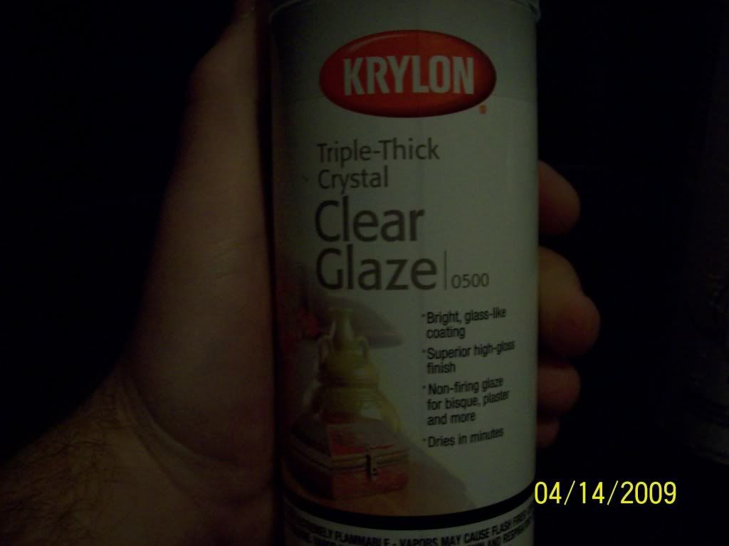

B_rad88 Posted April 14, 2009 Posted April 14, 2009 this is the white i used and the gloss i used!!!!!!!! they work great! on the cars in the pics i used the white primer, auto motive touch up paint, and the triple-glaze clear gloss! they where $3 bucks a can at wal-mart!!!!! great products!!!! P.S. I NEVER POLISHED THE CARS!!!! THE SHINE IS STRAIGHT GLOSS ITS SELF! NO POLISH!!!!!!!!! hey is my chevy with the white primer, gum metal grey silver (a.m.t.u.p.) and the and 1 coat of gloss!!! now here are the 2 cars i was talking about earlier with the white base and the silver base!!!!! ones extremly darker than the other! here is the caddy its has the white primer, royal blue (a.m.t.u.p.) and 2 coats of the gloss! here is the mini copper with the silver base, royal blue (a.m.t.u.p.) and 2 coats of the gloss! now here are the two cars side-by-side! i hope this helps you! Brandon

B_rad88 Posted April 14, 2009 Posted April 14, 2009 (edited) it would come out grey! lol! use clear coat, especialy that krylon tripl-glaze gloss!!!!!!!! hey t-dave, you had good finish from plasti-kote? every time i used it, it always bubbled on me and to me that paint sucks! i am having better finishes from krylon! plus wal-mart is cutting the plasti-kote off the shelfs, they are ot selling it any more! Edited April 14, 2009 by KUZTOMMODELS88

MrObsessive Posted April 14, 2009 Posted April 14, 2009 you had good finish from plasti-kote? every time i used it, it always bubbled on me and to me that paint sucks! i am having better finishes from krylon! plus wal-mart is cutting the plasti-kote off the shelf. Aaaahhh...........That's why I love my airbrush! I usually decant the Plastikote into a paint jar, then airbrush. Plastikote's paint does tend to be a bit "foamy" when it's sprayed in the jar. I like to let any paint I decant to sit at least ½ hour to gas out before I'll start to airbrush. I almost forgot about Krylon! Krylon makes excellent white and gray primer (sandable). In fact, one of the best gloss whites to use is probably Krylon as it will STAY white forever!
