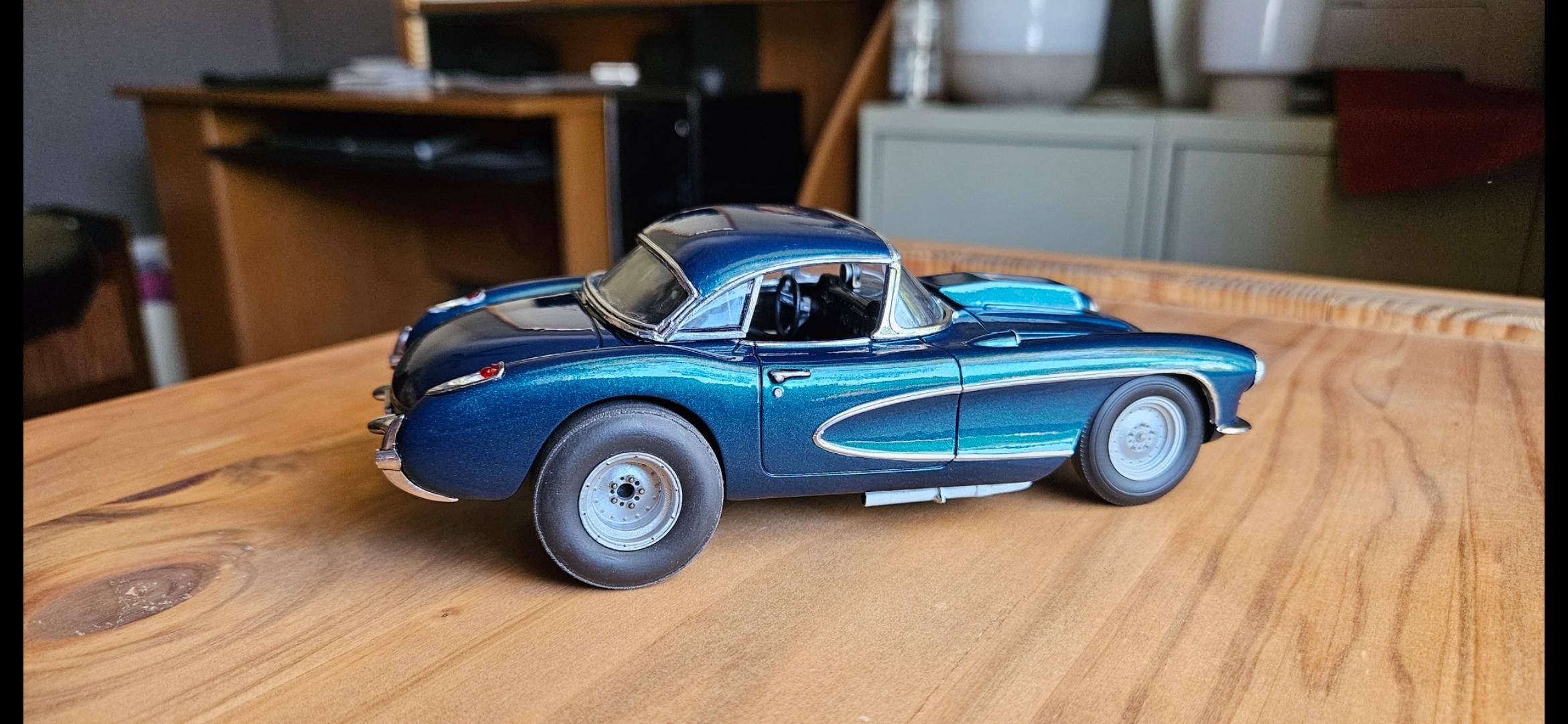

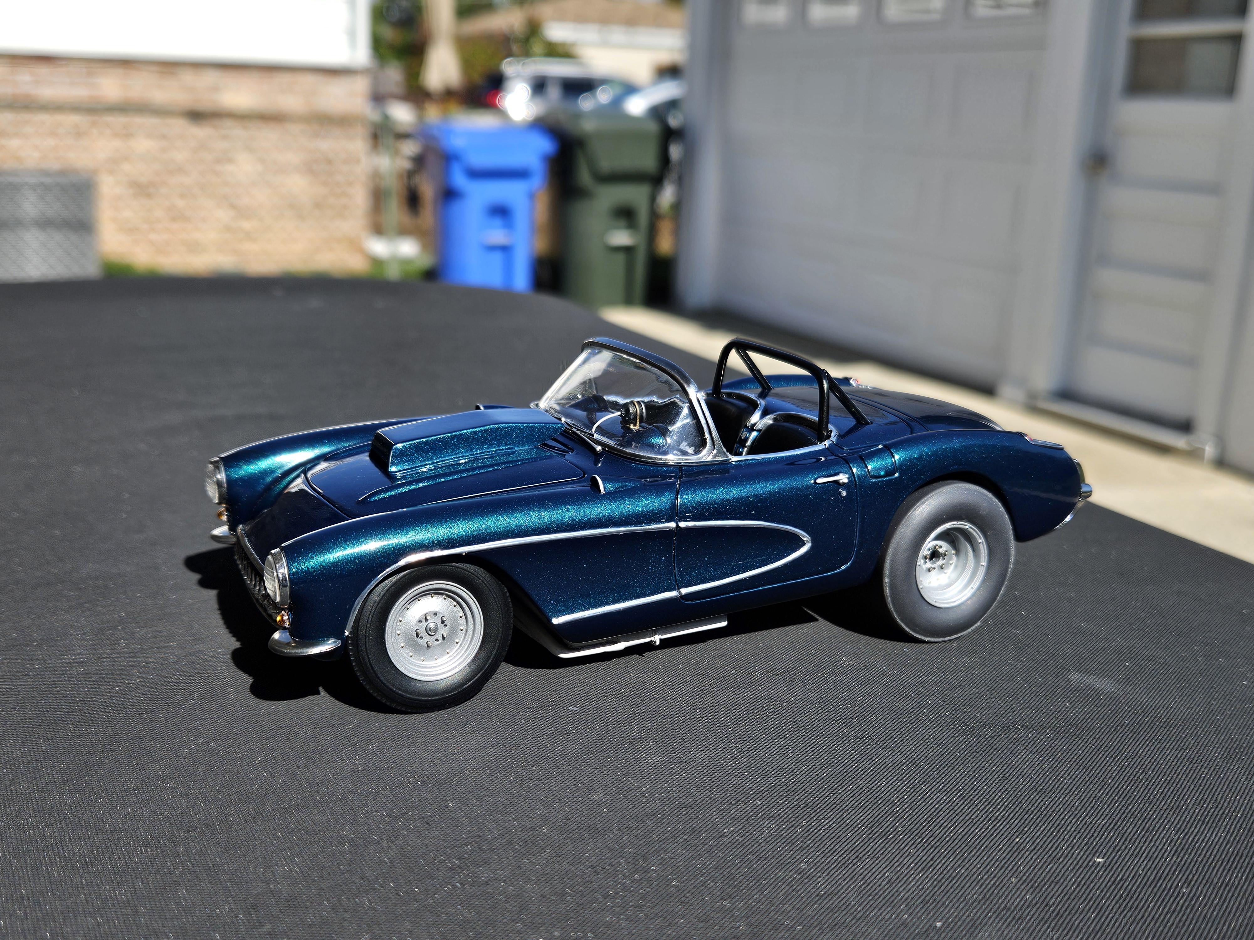

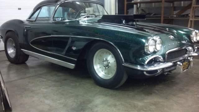

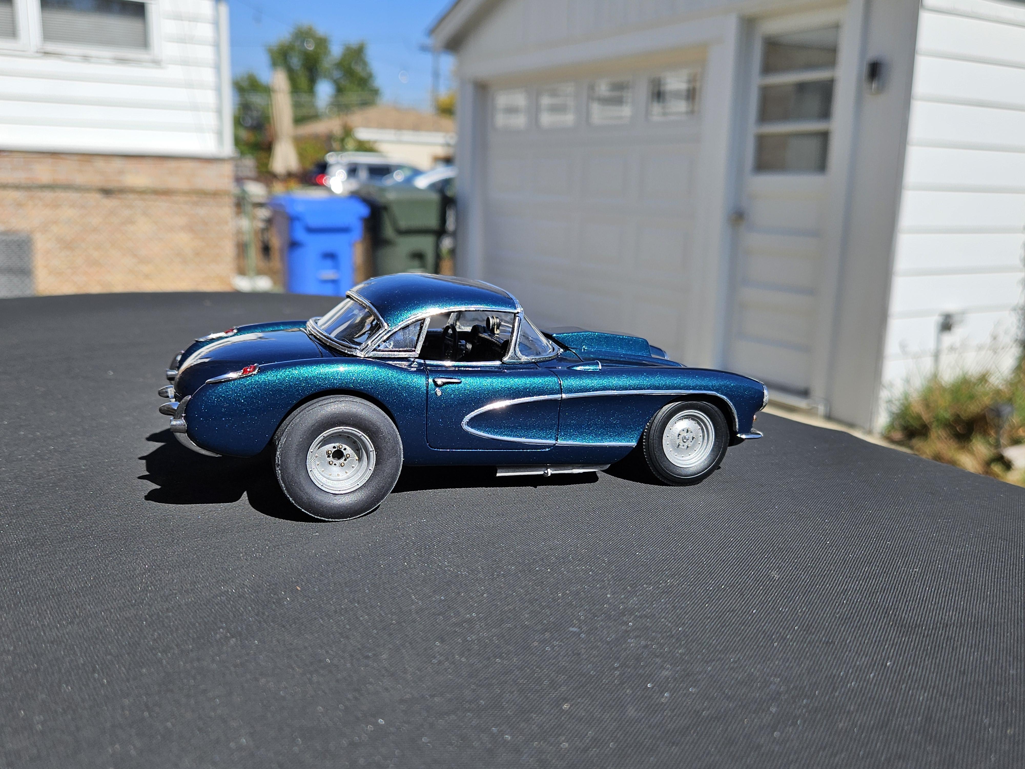

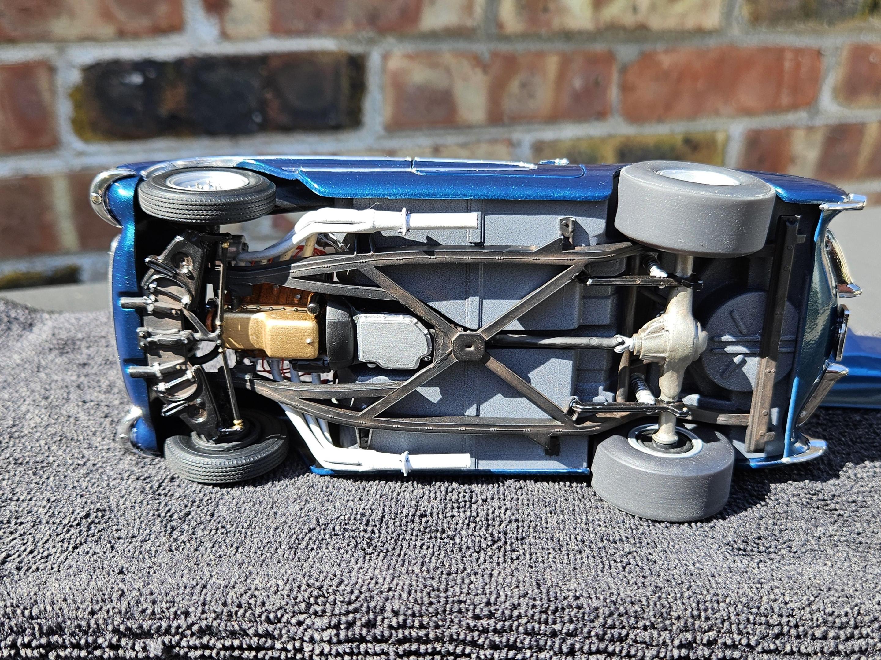

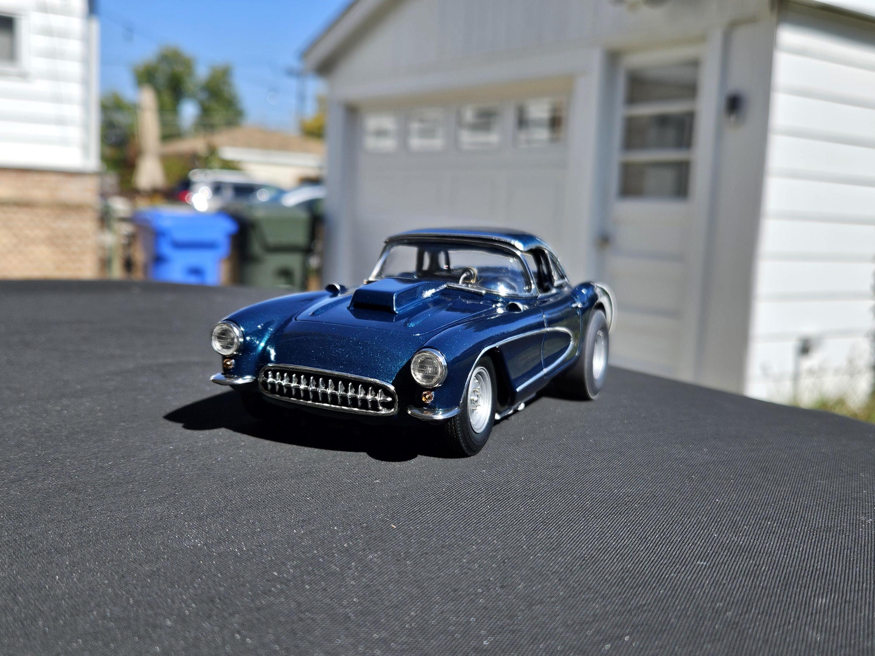

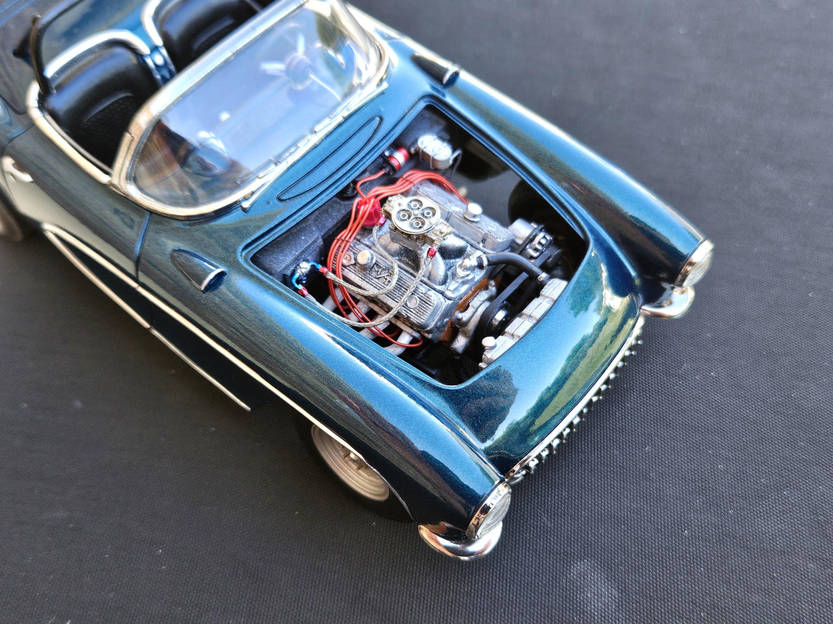

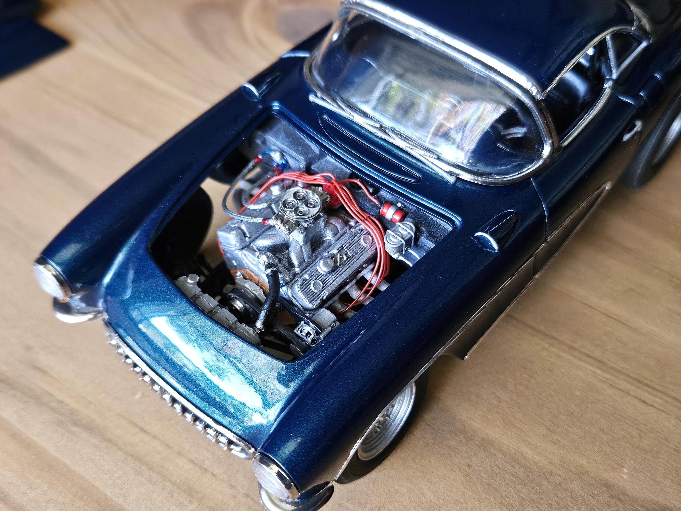

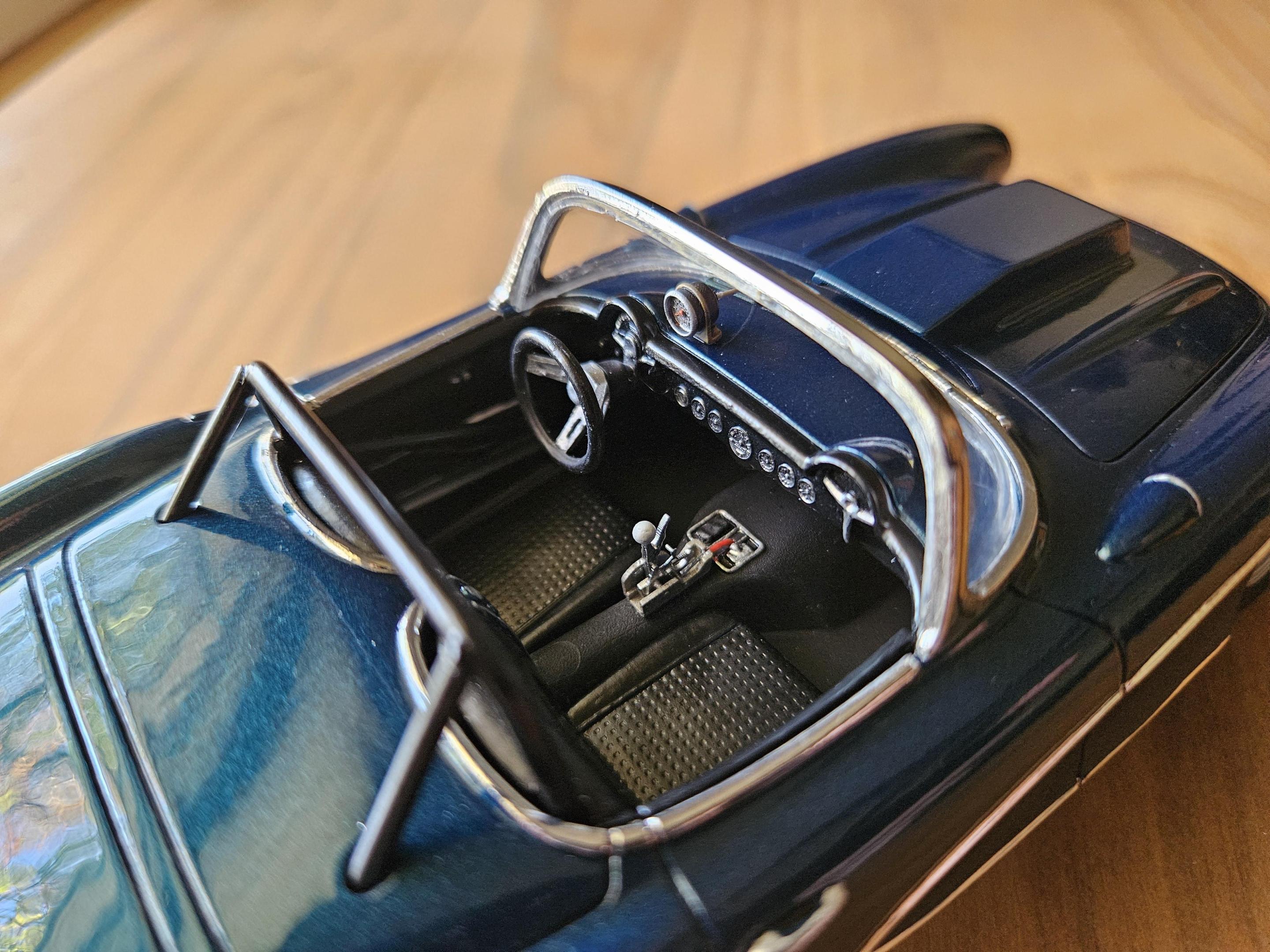

keviiin86 Posted October 6, 2024 Posted October 6, 2024 The theme of this one is a late 70s era bracket car. I tried to keep everything fairly era correct and only use parts that were available at the time. The basic chassis and engine are out of the box but I modified a bunch of stuff also. Cut the trans off and swapped to a th400 and moved the whole engine/trans further back. I added resin parts throughout from VCG, Iceman and futur attraction as well as fuel lines from detail master and wired distributor from M.A.D. Made the rollbar out of aluminum rod, narrowed the rear end and added a cross member and 2 upper control arms to make it a 4 link style suspension. The paint is GM mystic teal automotive touch up that I had mixed up in a spray can and clear coated. I threw in a picture of a 62 corvette I found on Facebook a while back which is sort of the "look" I was going for. Anyways, enjoy! 13
