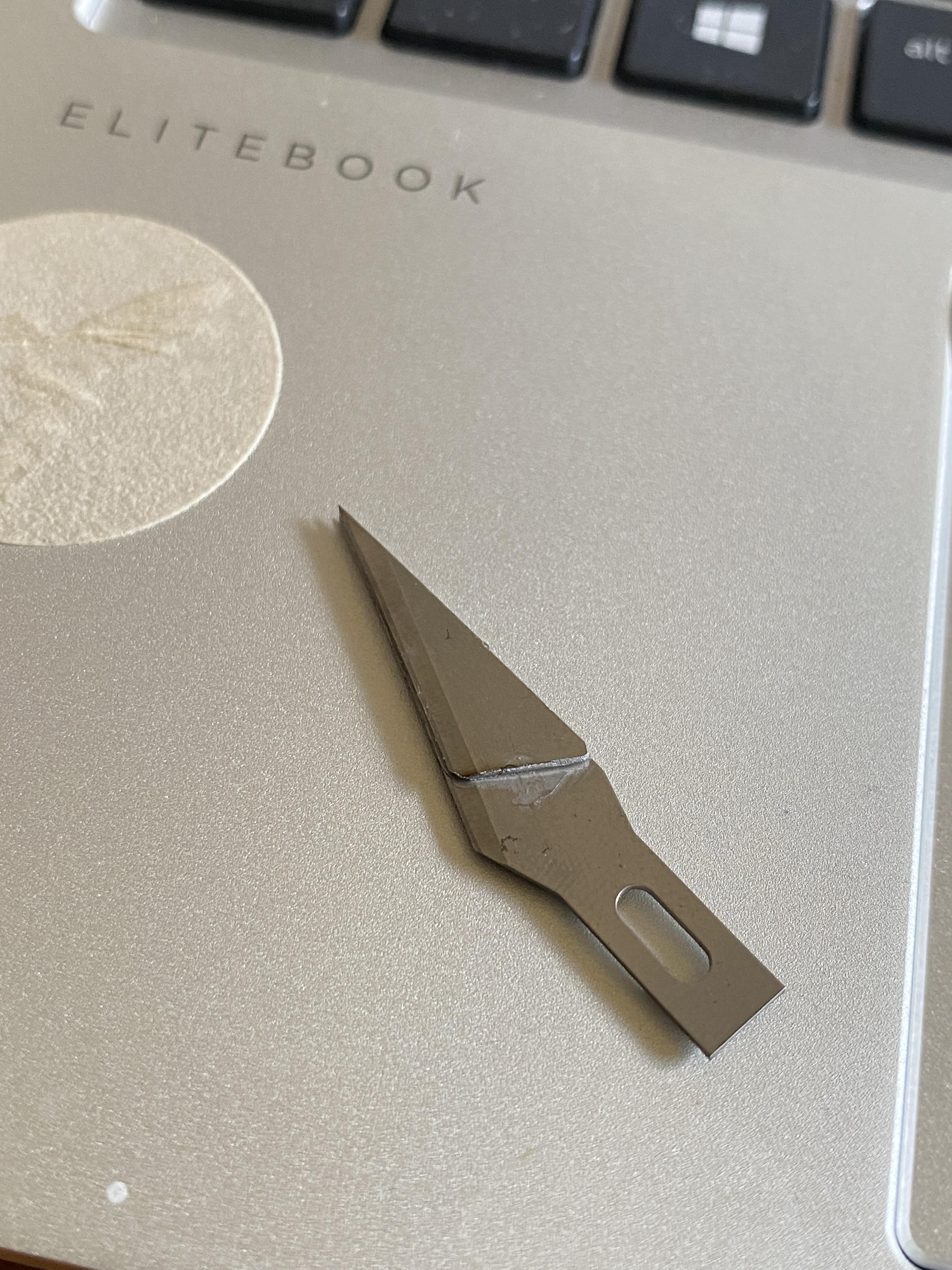

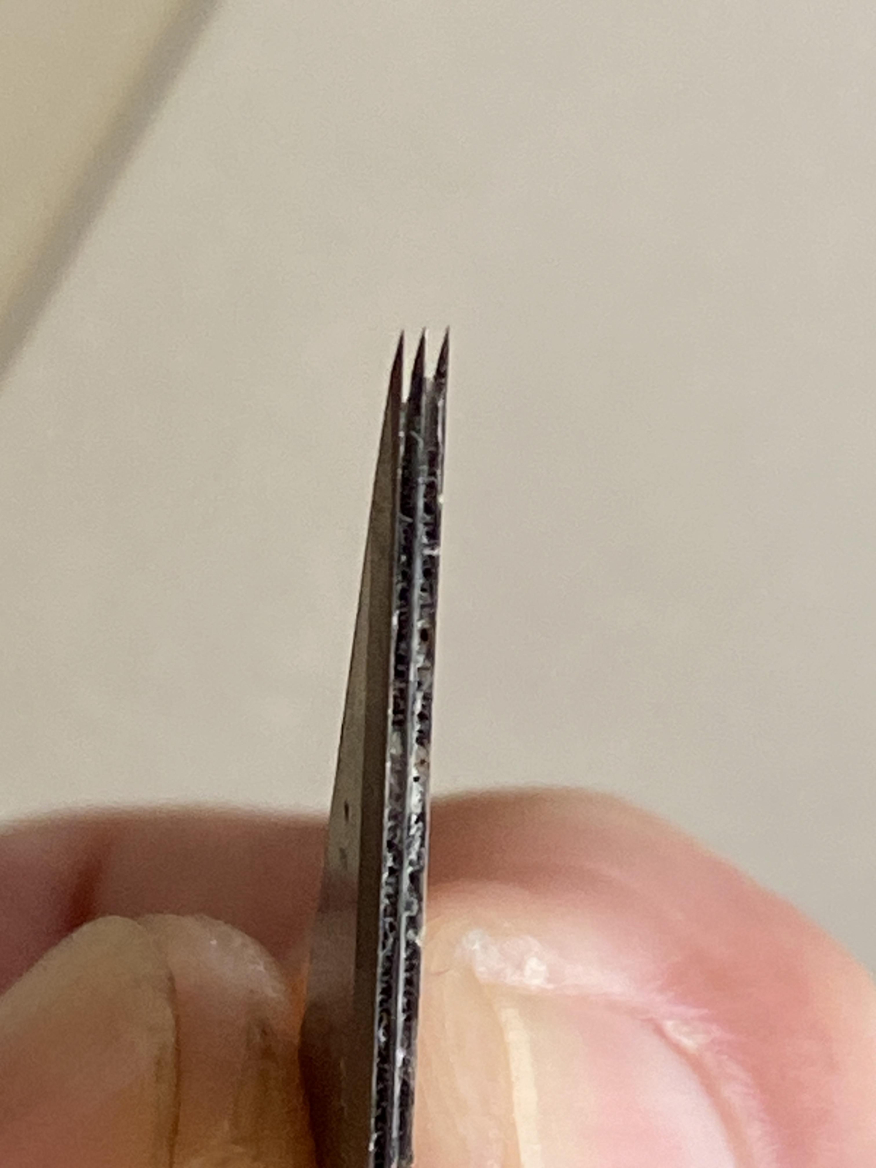

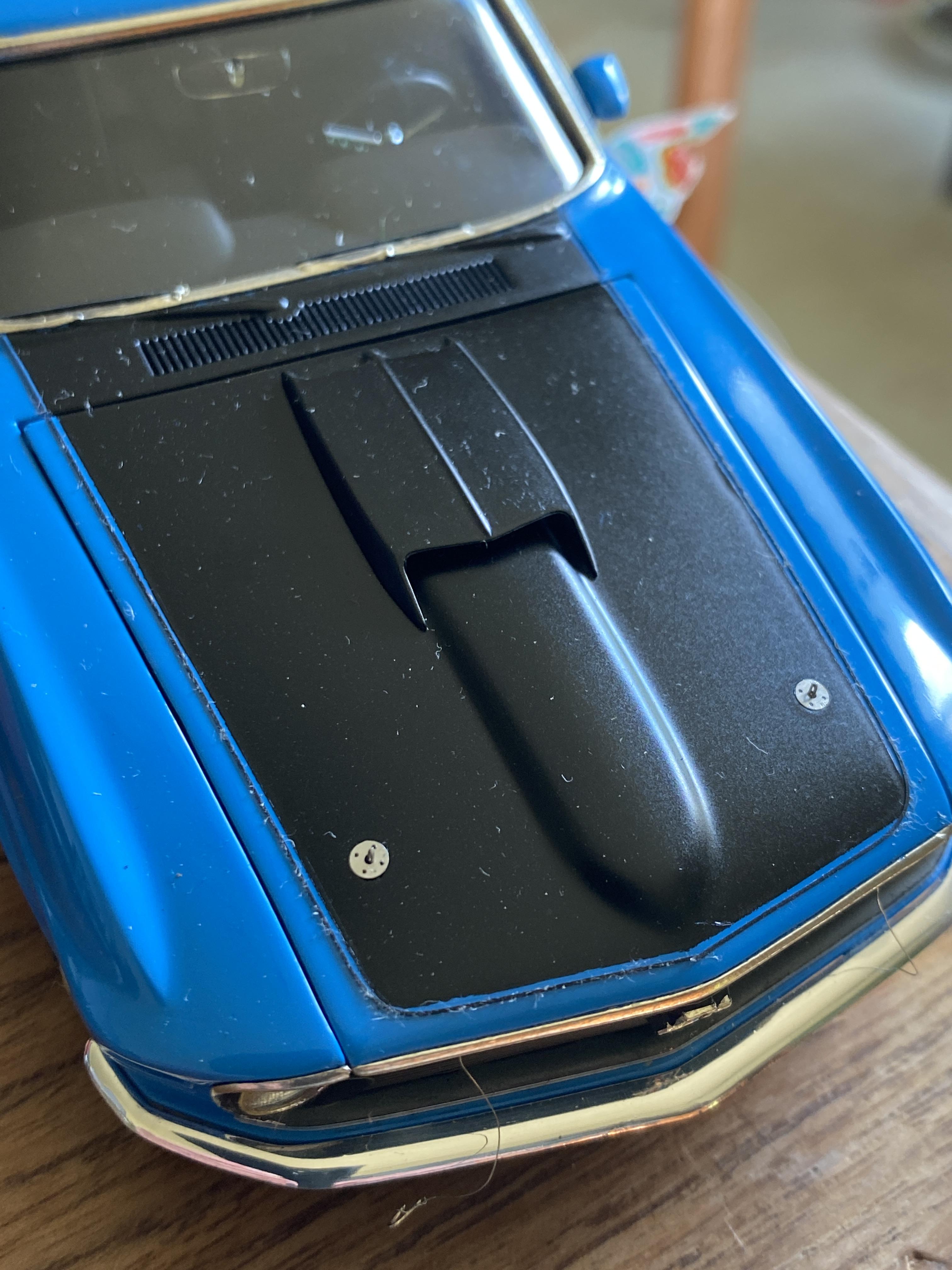

Bainford Posted October 10, 2024 Posted October 10, 2024 (edited) 2 hours ago, 64SS350 said: Right, forgot about that, and I believe one guy said he even just put two blades side by side, the area that is sharpened creates a void or narrow width to cut with. I'll be checking into the fingernail tape though! I've done the 'glueing blades together' thing a number of times. The blades are .020" (0.5 mm) thick, so with two glued together, your cut tape will be .020" (0.5 mm) wide, which is a scale 1/2 inch. That's still pretty wide for in-scale pinstripe, but it can be difficult to work with tape narrower than that. There are some hobby pinstripe tapes available that are as narrow as 1/64" (roughly .015") which scales out to 3/8 inches wide. They come in a variety of colours, but the thickness (height) of the tape can throw off the look. Line-O Tape is one brand that comes to mind, and I think Detail Master marketed some pinstripe tape as well. The mask for this hood was created using three blades glued together, to cut the pinstripe and edge of the flat black at the same time. This pinstripe was created using 1/64" pinstripe tape. I think it was the Detail Master brand. The thickness (height) of the tape is evident when viewing the model. Also, this model was built over ten years ago, and over time the tape has 'pulled in' at the corners. The stickum at the tape edges is also a dust magnet. Edited October 10, 2024 by Bainford

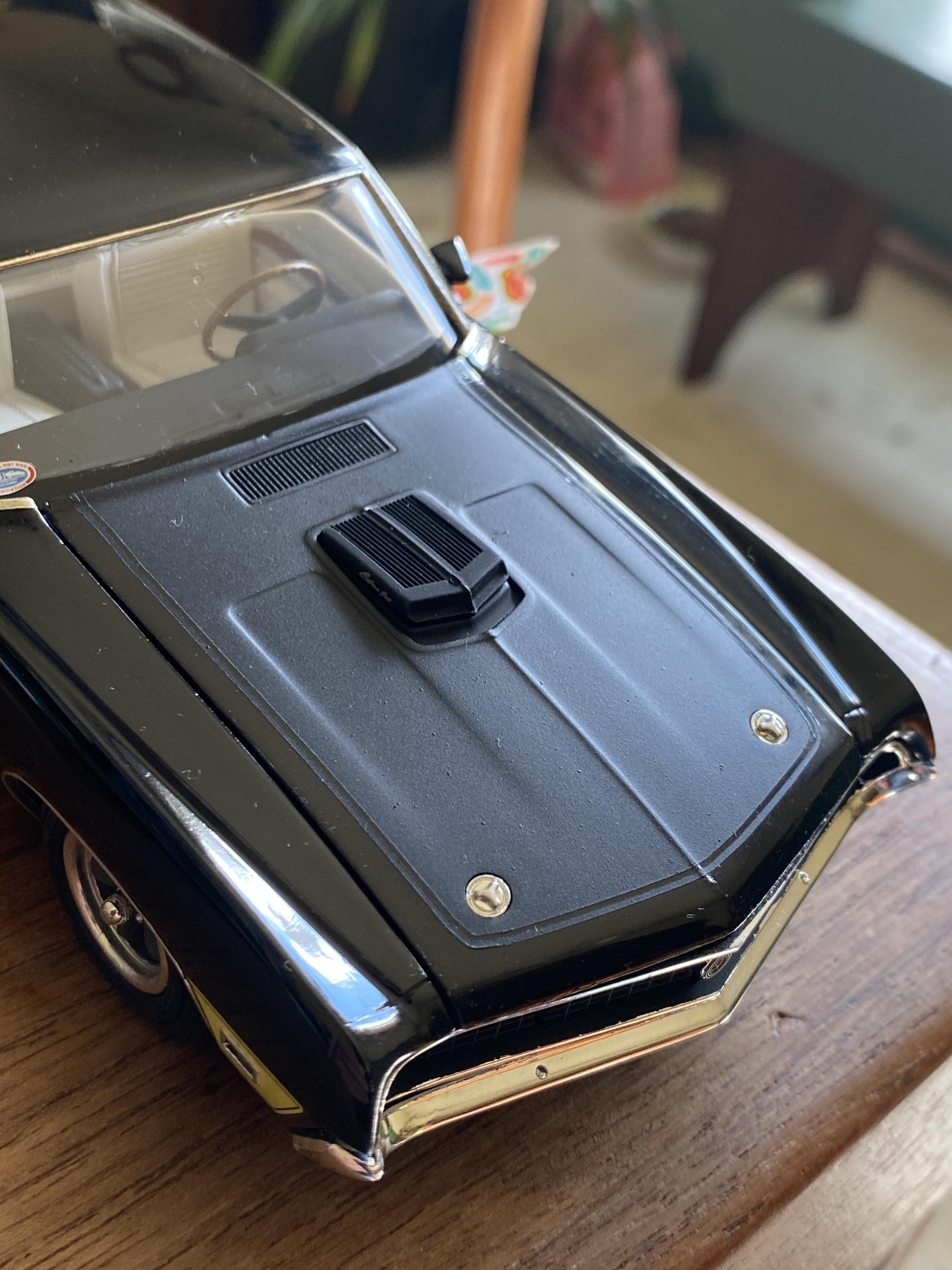

Rich Chernosky Posted October 10, 2024 Posted October 10, 2024 You can cut all kinds of tape down to the size you want. My "go to" is 3M vinyl tape. Lay a piece of tape on a piece of glass. I use a 6" metal straight edge. Lay the ruler on the tape to the width you want and hold down very firmly with one hand and use a sharp X-acto in one smooth cut. You can cut the vinyl tape hair thin and it will still stick. When you lay it on the model be careful not to stretch it. It can be moved slightly into position with a toothpick. It also holds very tight curves. Afterwards lay a thin wash of varnish on the tape to keep it in position. Its thicker than the paint but you barely notice it. I have been using this trick for many years. See below. The gold pinstripe on the side and hood are 1:1 gold pinstripe tape cut down to size. These stripes come to a point and this was done while still on the glass using a razor blade at a sharp angle. I will often use this technique when I have two large stripes and the space between them is very thin. This is difficult to mask without bleed under. The vinyl tape can be sprayed body color. Some might call this cheating but what works is what matters. 1
