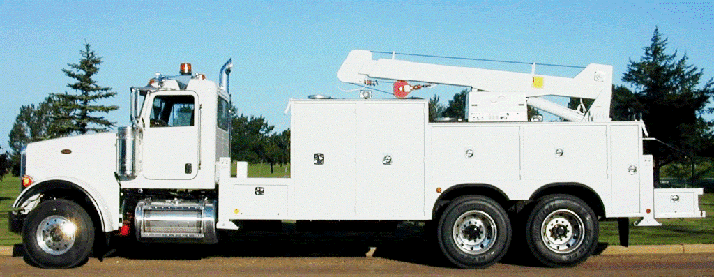

PHPaul Posted October 11, 2024 Posted October 11, 2024 In this post, I asked some questions about building a service truck. I ordered the AMT Paystar 5000 Dump Truck kit and in my usual impatient fashion, I have started on what was supposed to be a Winter project. . In order to design the service body, I had to build the basic frame and mock up the cab to see what I have to work with. I'm a very visually-oriented person. Fairly often, I have a mental picture of what I think I want, but when I actually build it, I find several things I'd do differently. That's particularly true in this case as the entire focus of the project is the service body. Build, re-think, rebuild is the path to satisfactory results, but that gets expensive in styrene, so I did a couple of mockups out of poster board. As is often the case, Plan A was unsatisfactory. Plan B is much closer to what I want, and with a little tweaking will likely be the way I go. I dropped it down over the frame, and made it longer. The extra length will require a frame extension and the drop will require removing the second fuel tank or moving it to the other side. I'm thinking it's too tall as a 6 foot man standing on the ground wouldn't be able to reach anything in the top of the side boxes. I'll probably shorten it to at least the top of the cab. The next step will be to fab up the inside partitions and wheel well (also out of poster board) and make some final decisions on design before hacking up some styrene. Comments/suggestions/criticisms welcome. 5
yh70 Posted October 11, 2024 Posted October 11, 2024 1 hour ago, PHPaul said: In this post, I asked some questions about building a service truck. I ordered the AMT Paystar 5000 Dump Truck kit and in my usual impatient fashion, I have started on what was supposed to be a Winter project. . In order to design the service body, I had to build the basic frame and mock up the cab to see what I have to work with. I'm a very visually-oriented person. Fairly often, I have a mental picture of what I think I want, but when I actually build it, I find several things I'd do differently. That's particularly true in this case as the entire focus of the project is the service body. Build, re-think, rebuild is the path to satisfactory results, but that gets expensive in styrene, so I did a couple of mockups out of poster board. As is often the case, Plan A was unsatisfactory. Plan B is much closer to what I want, and with a little tweaking will likely be the way I go. I dropped it down over the frame, and made it longer. The extra length will require a frame extension and the drop will require removing the second fuel tank or moving it to the other side. I'm thinking it's too tall as a 6 foot man standing on the ground wouldn't be able to reach anything in the top of the side boxes. I'll probably shorten it to at least the top of the cab. The next step will be to fab up the inside partitions and wheel well (also out of poster board) and make some final decisions on design before hacking up some styrene. Comments/suggestions/criticisms welcome. off to a good start, but i do agree its way to tall..here is a couple pictures for height. 1

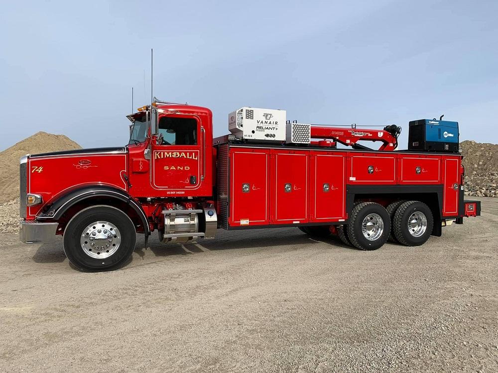

PHPaul Posted October 11, 2024 Author Posted October 11, 2024 @yh70 I agree, that's much better. Thanks for the picture, I haven't had much luck finding 10 wheel service trucks. I'm even planning on painting it red! 2

yh70 Posted October 11, 2024 Posted October 11, 2024 (edited) 4 hours ago, PHPaul said: @yh70 I agree, that's much better. Thanks for the picture, I haven't had much luck finding 10 wheel service trucks. I'm even planning on painting it red! You Welcome Paul....yes it is resin. i can order you one but it will be next month before i make my order. the crane even telescopes. here is a picture. i have not un bagged it all yet but i can and send you pictures of the parts if you like. also i can send you the pictures on the file. just send me a message.. also the bed looks way better now since you cut it down.. Edited October 11, 2024 by yh70 2
