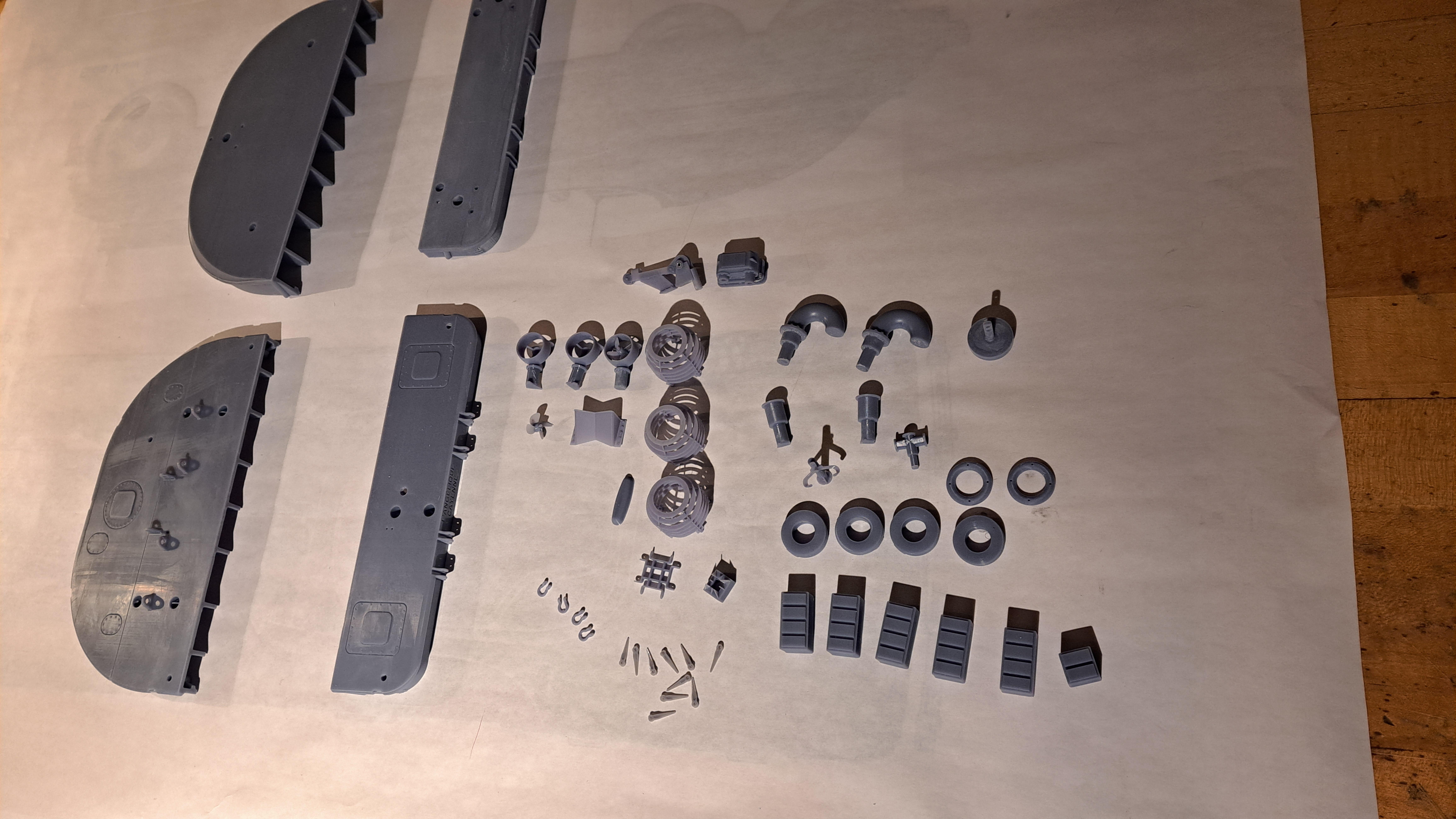

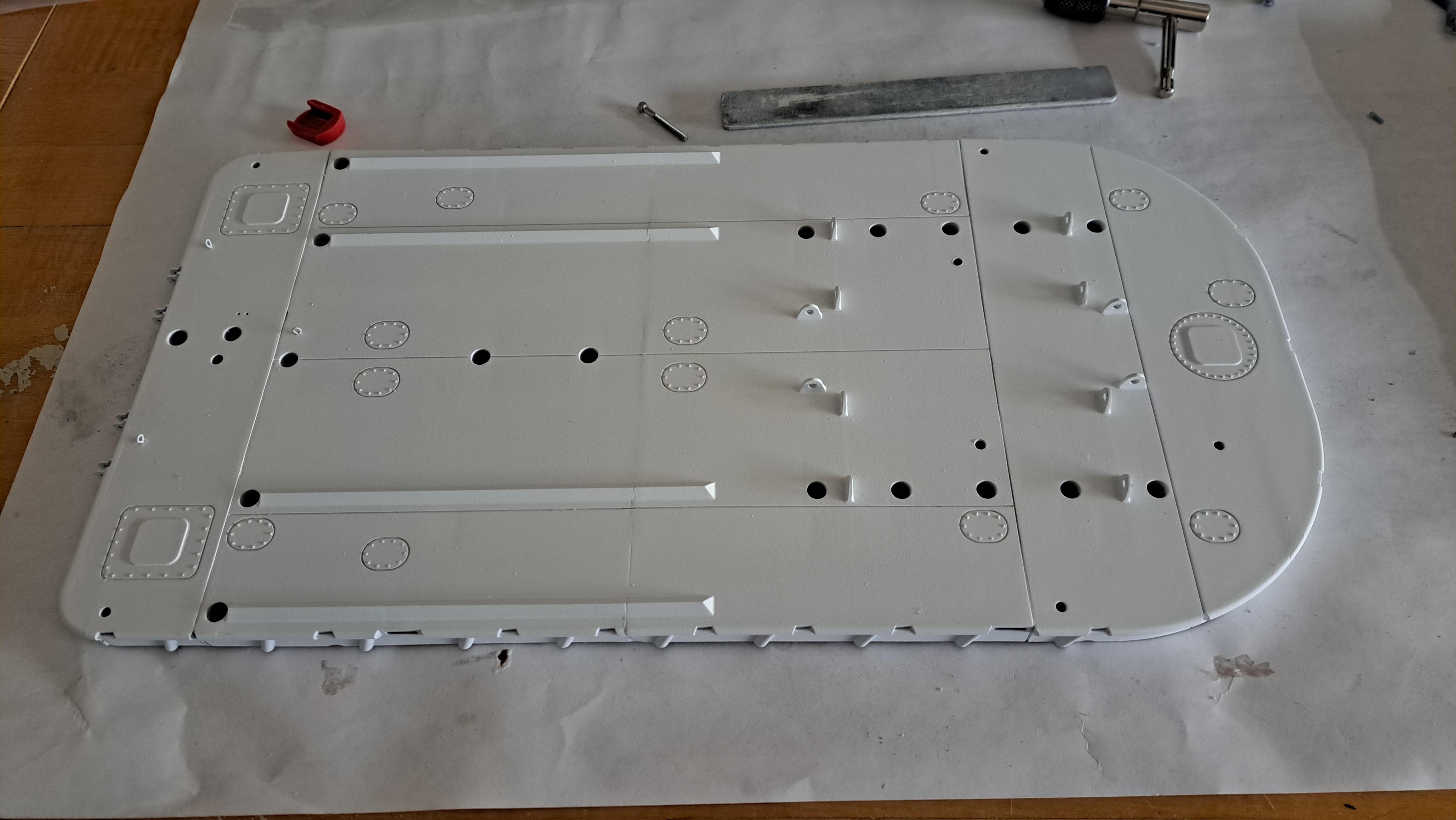

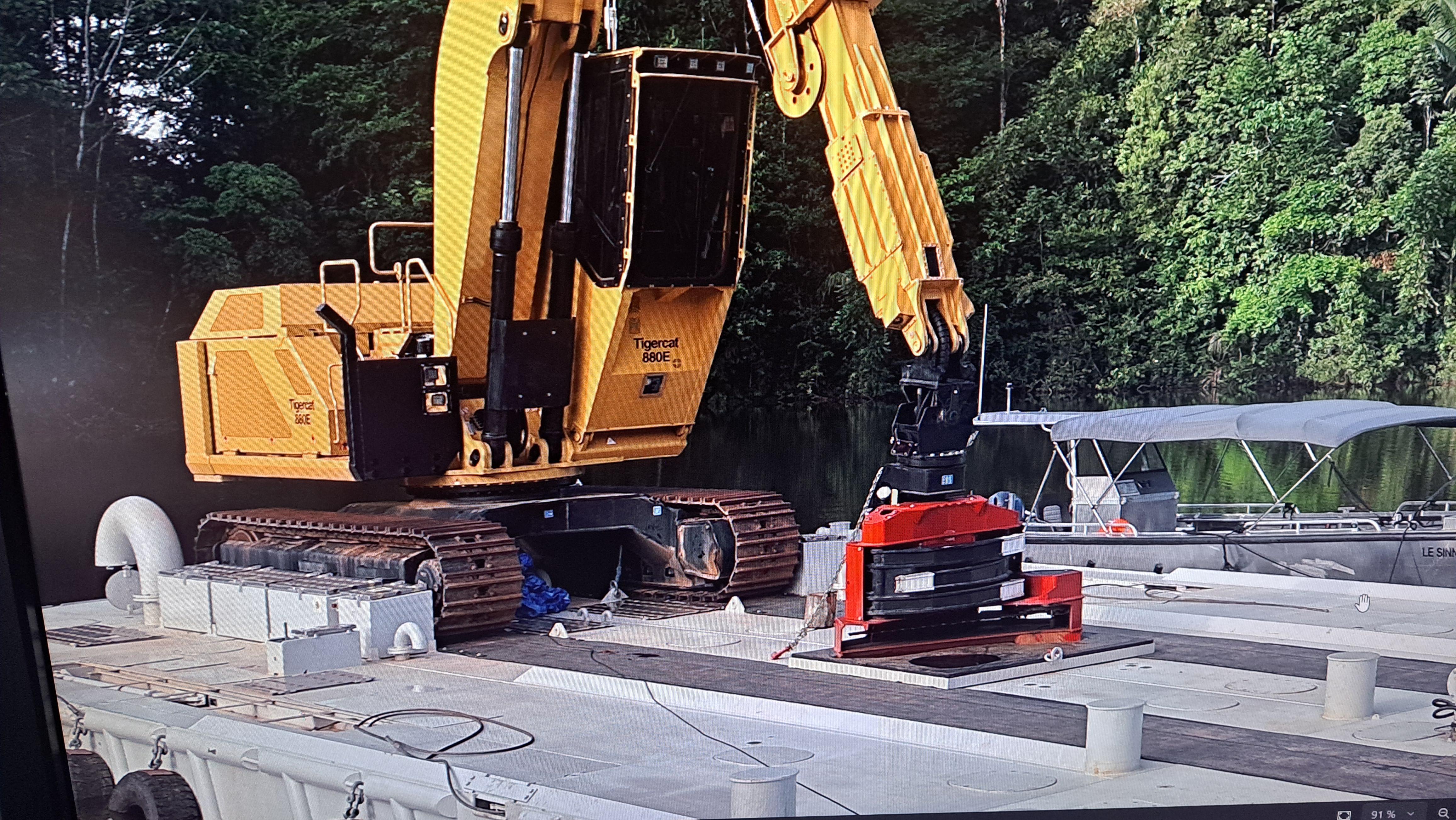

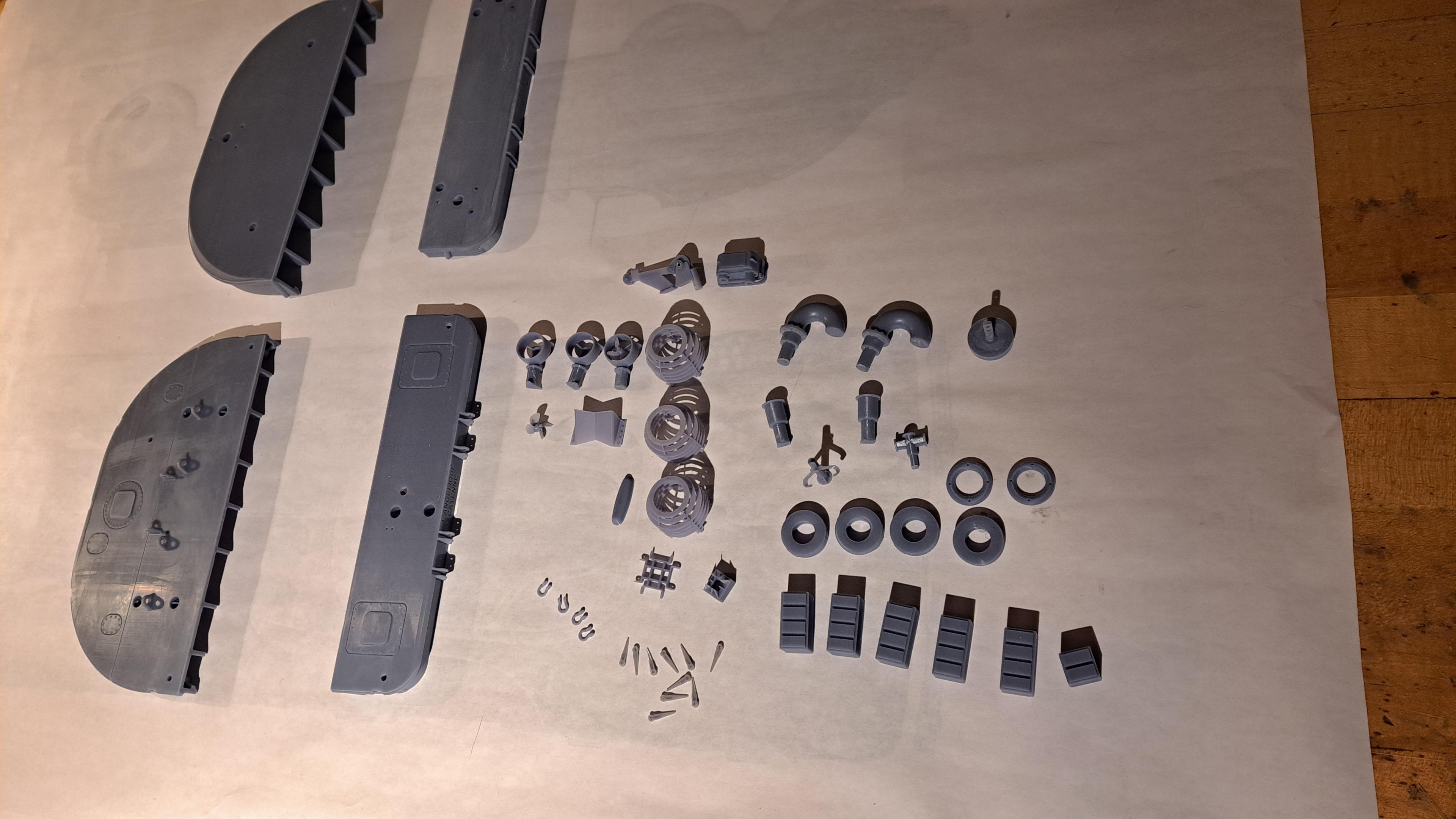

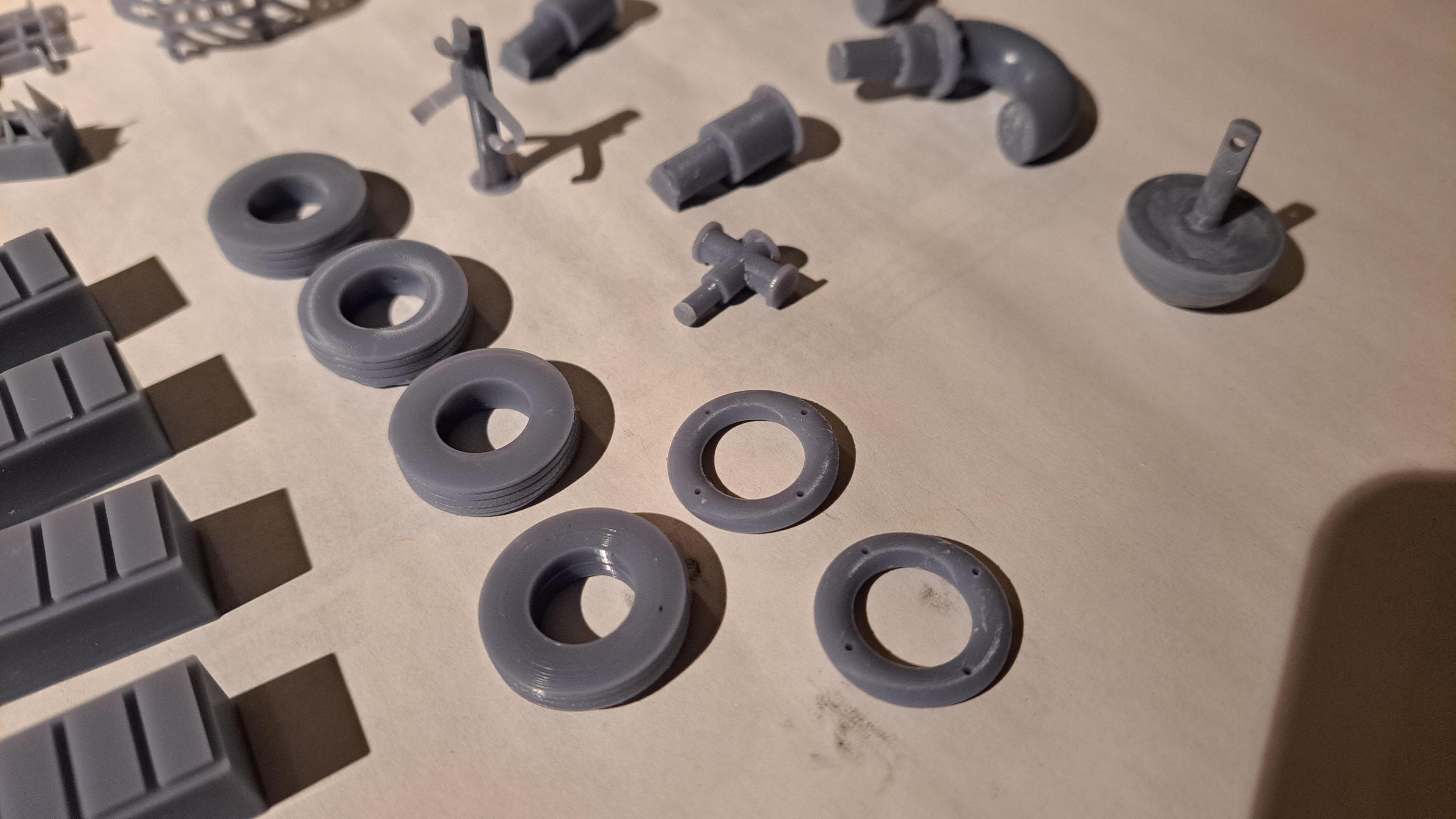

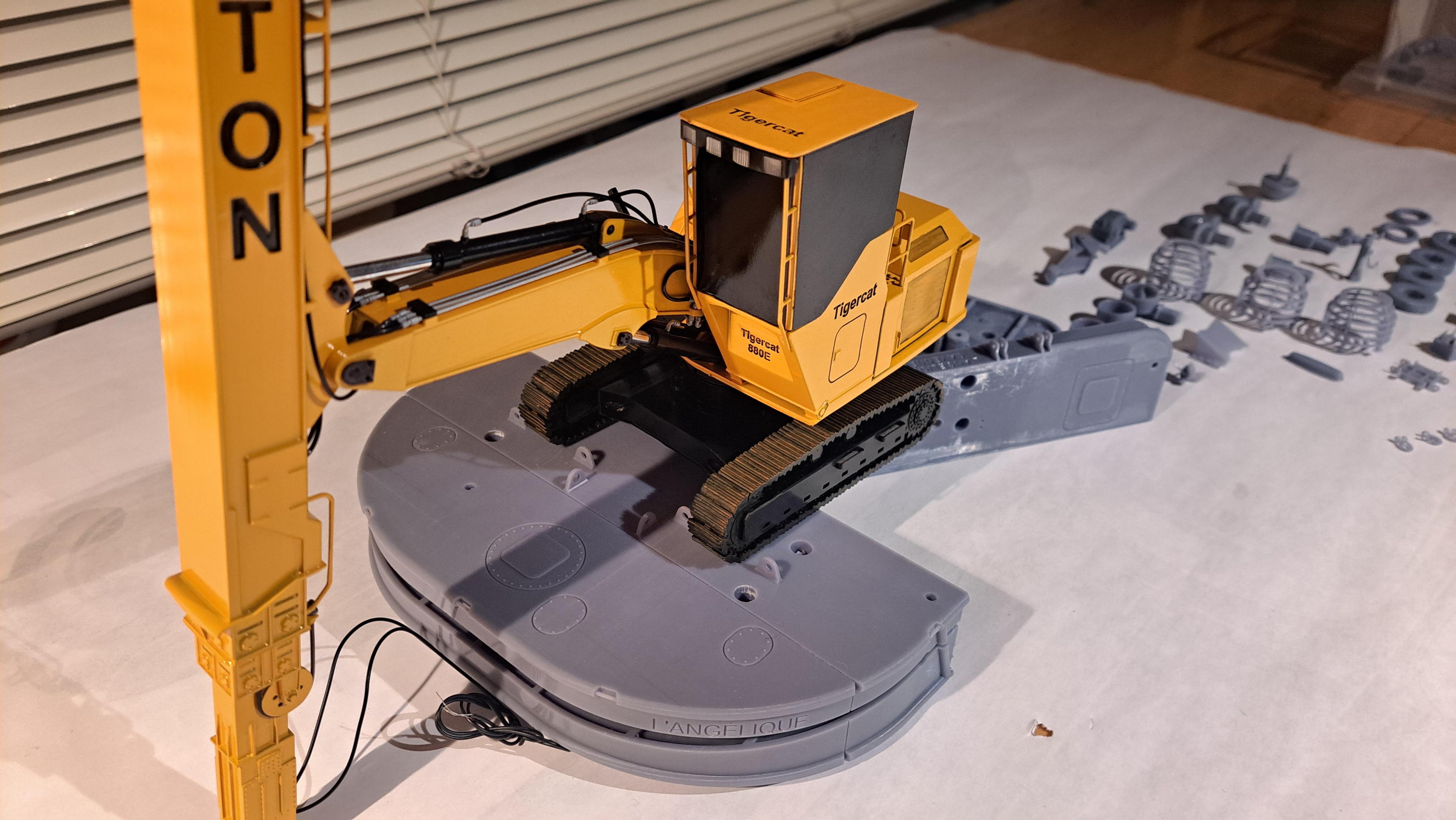

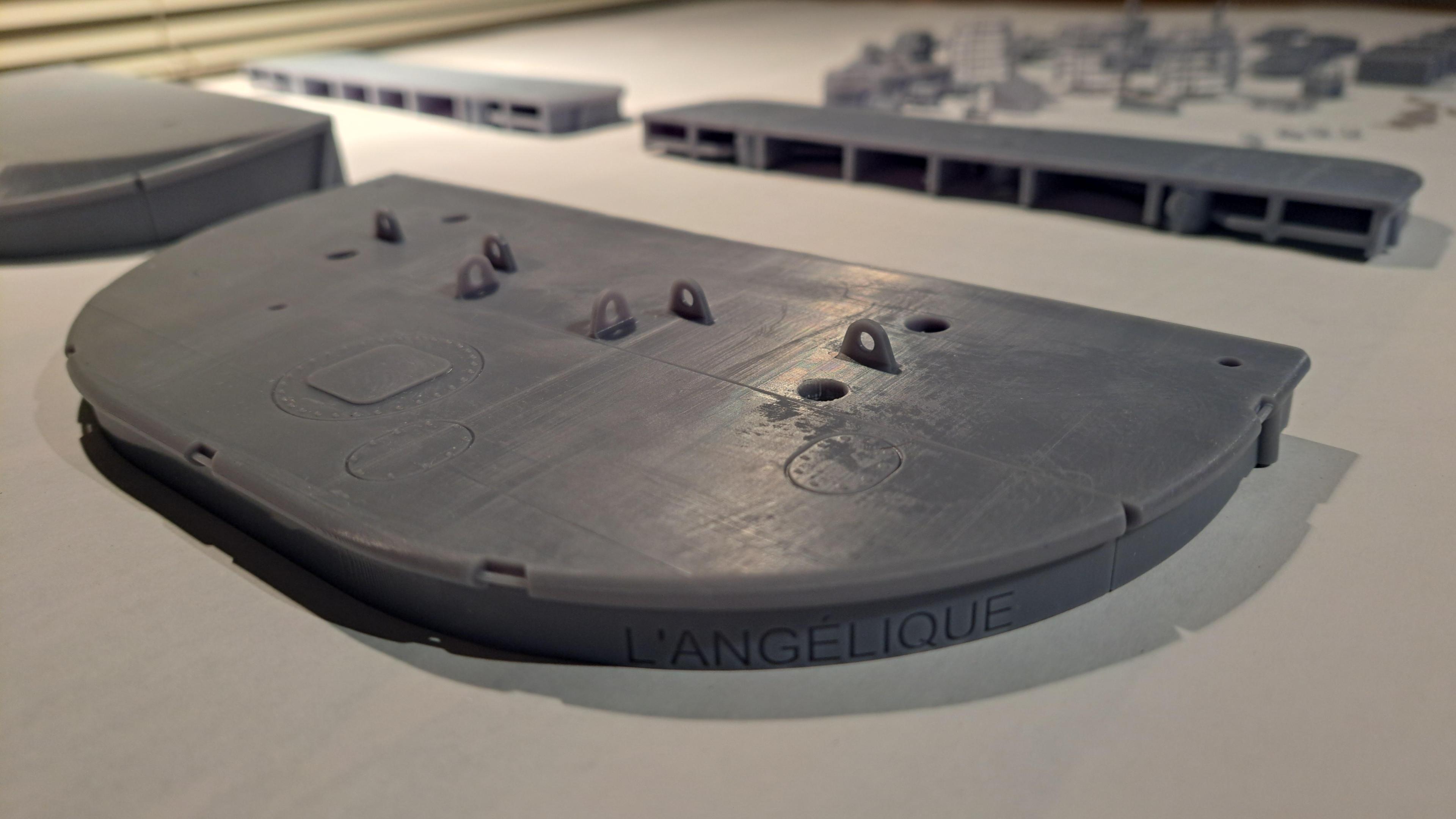

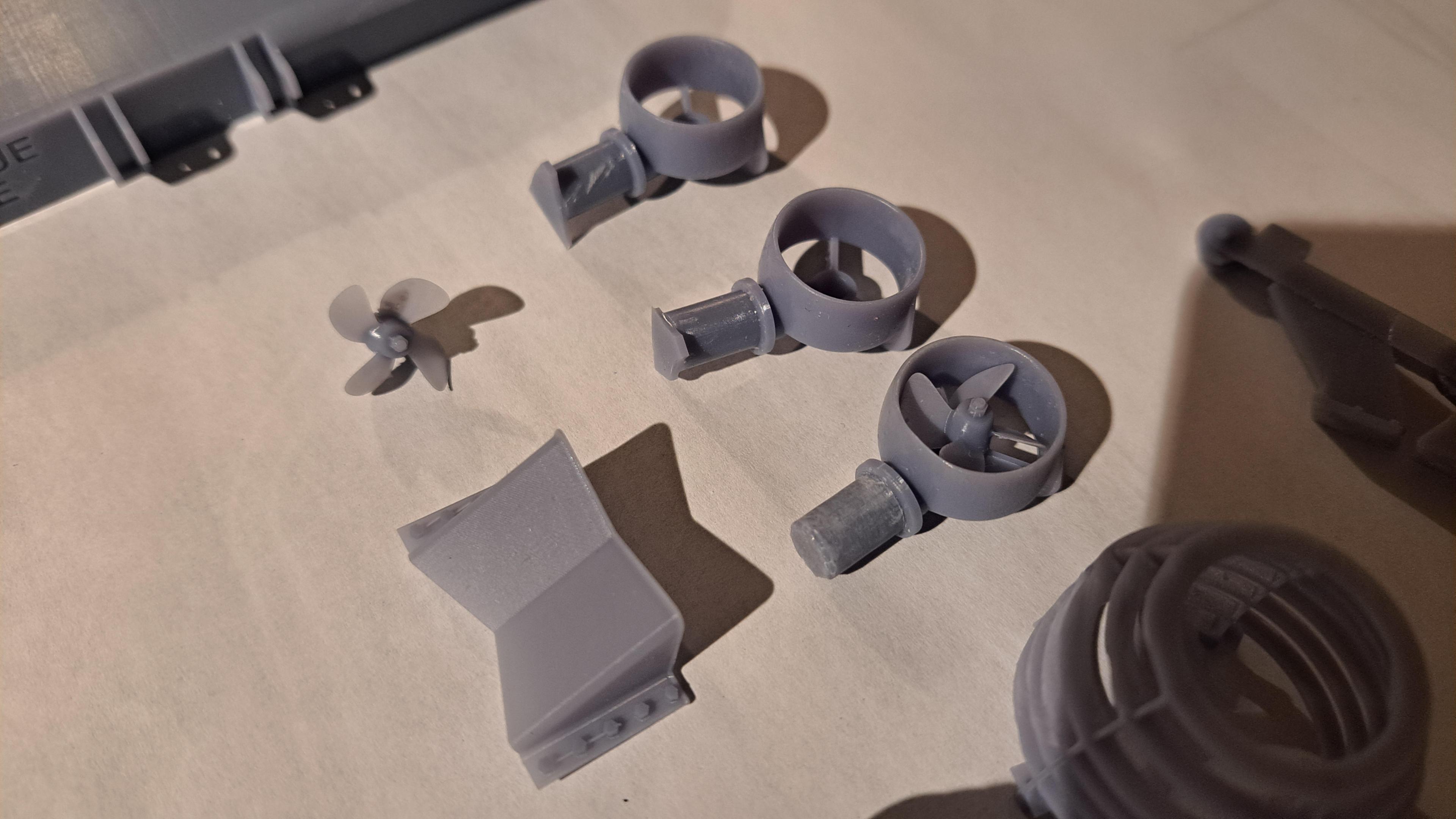

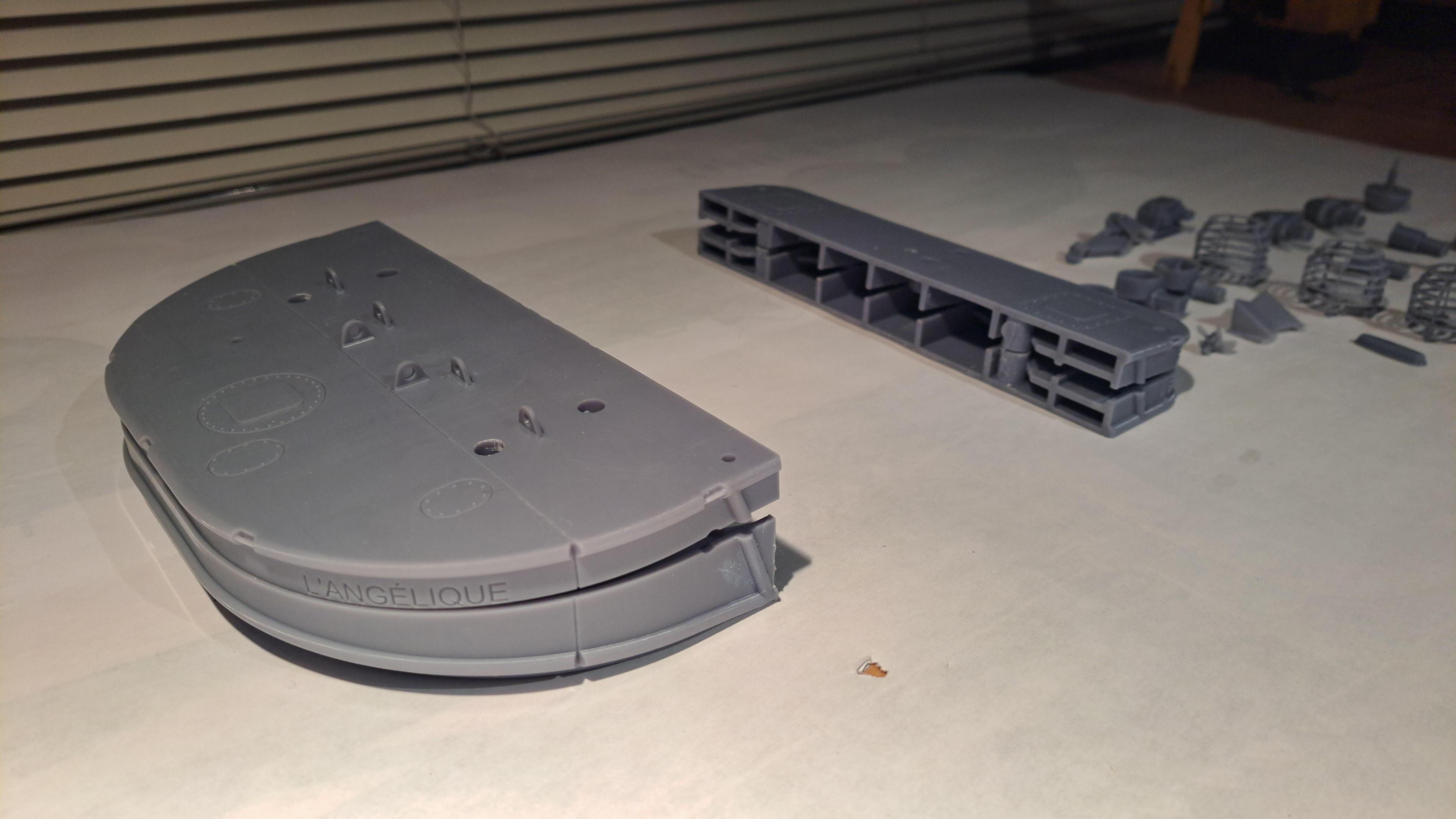

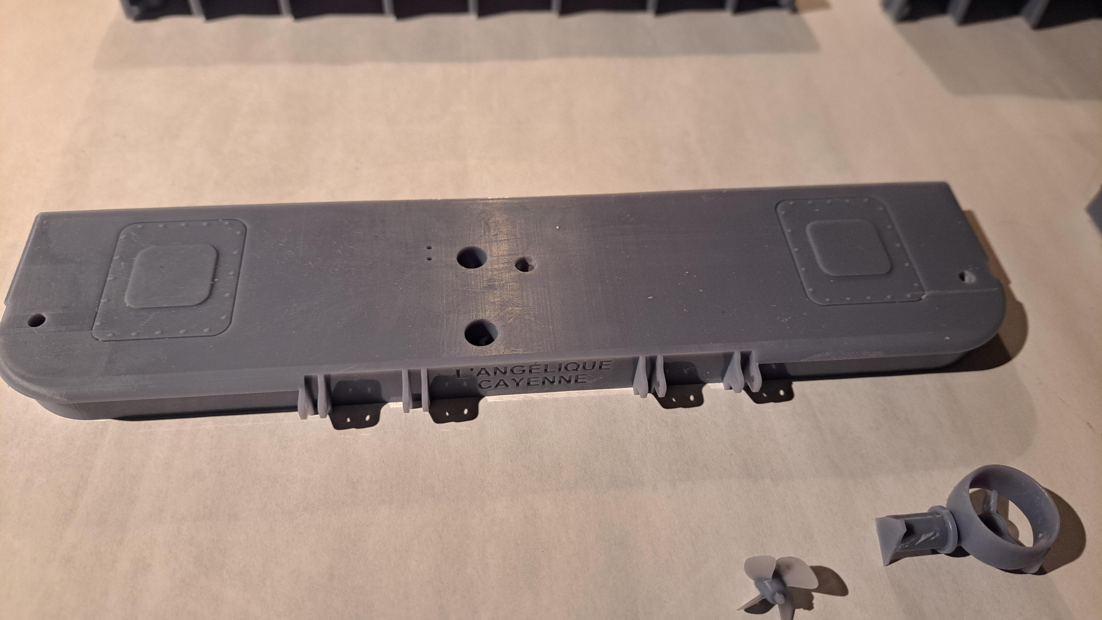

 Now that the 2 Tigercats are done, I started printing 1 of the 2 barges.  It's a fairly complex print. The barge measures 15 3/4 LG x 8 wide so printing in 1 piece is naturally out of the question. The plaform itself is made of 8 parts, 4 top deck and 4 bottom deck. The reason to separate top and bottom is that there will be a 1/8 thick plexiglass sheet between the 2 to simulate the water surface. There is also a ton of add on parts such as cleats, tool boxes, propeller assemblies, communication mast, anchor, a bunch of chain binders, buoys with buoy brackets, tire bumpers...
Here are some pictures of what has been printed so far.

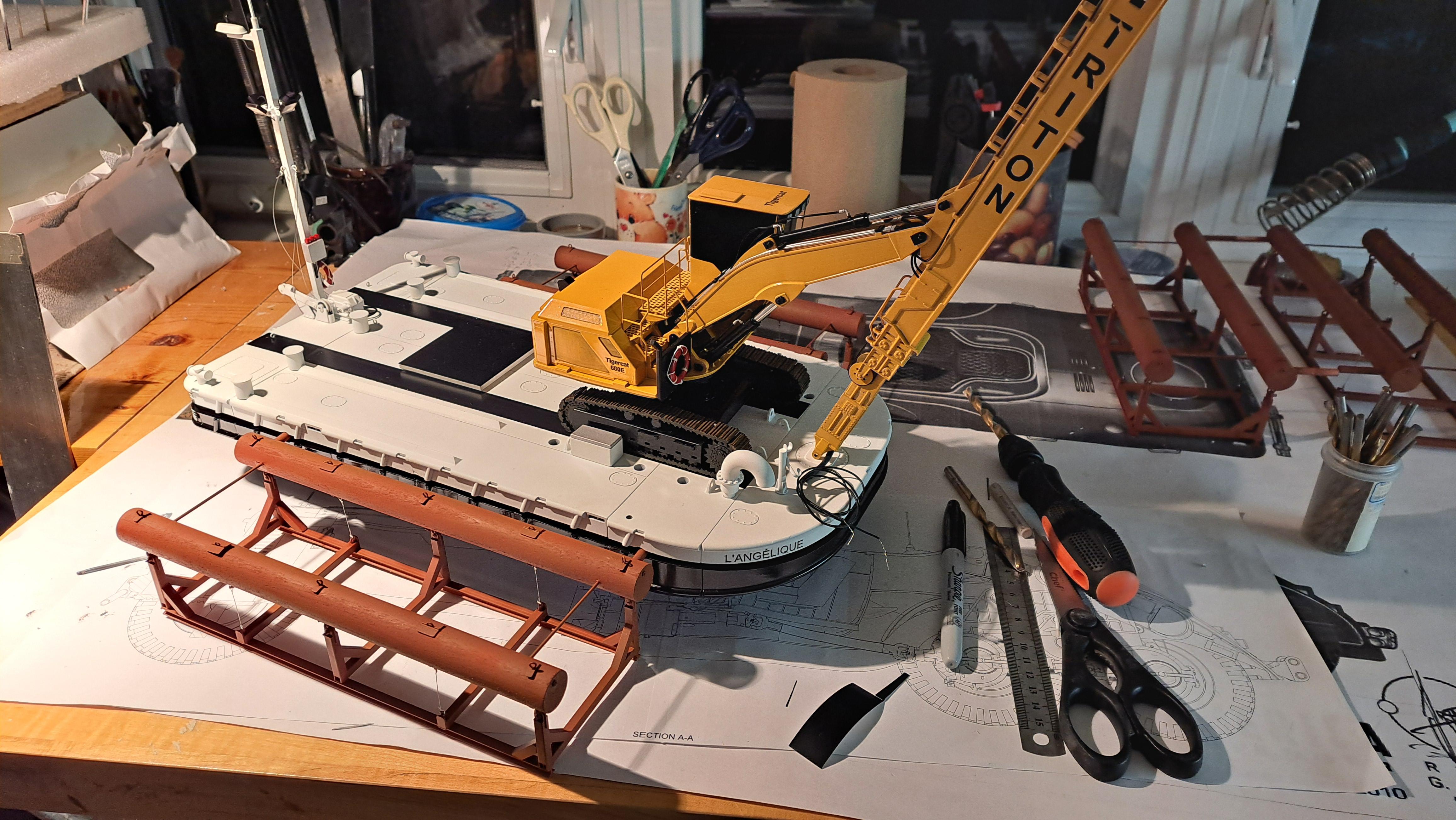

and here's what it will look like

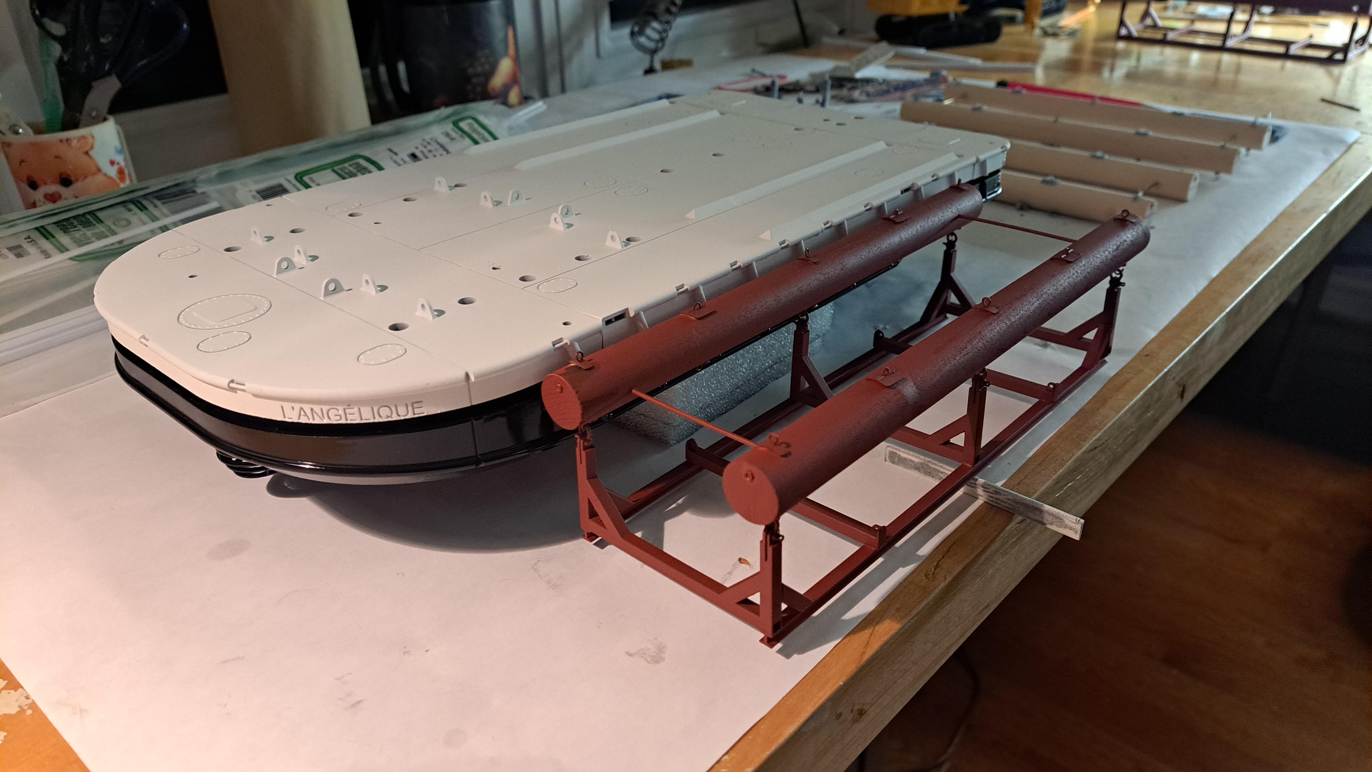

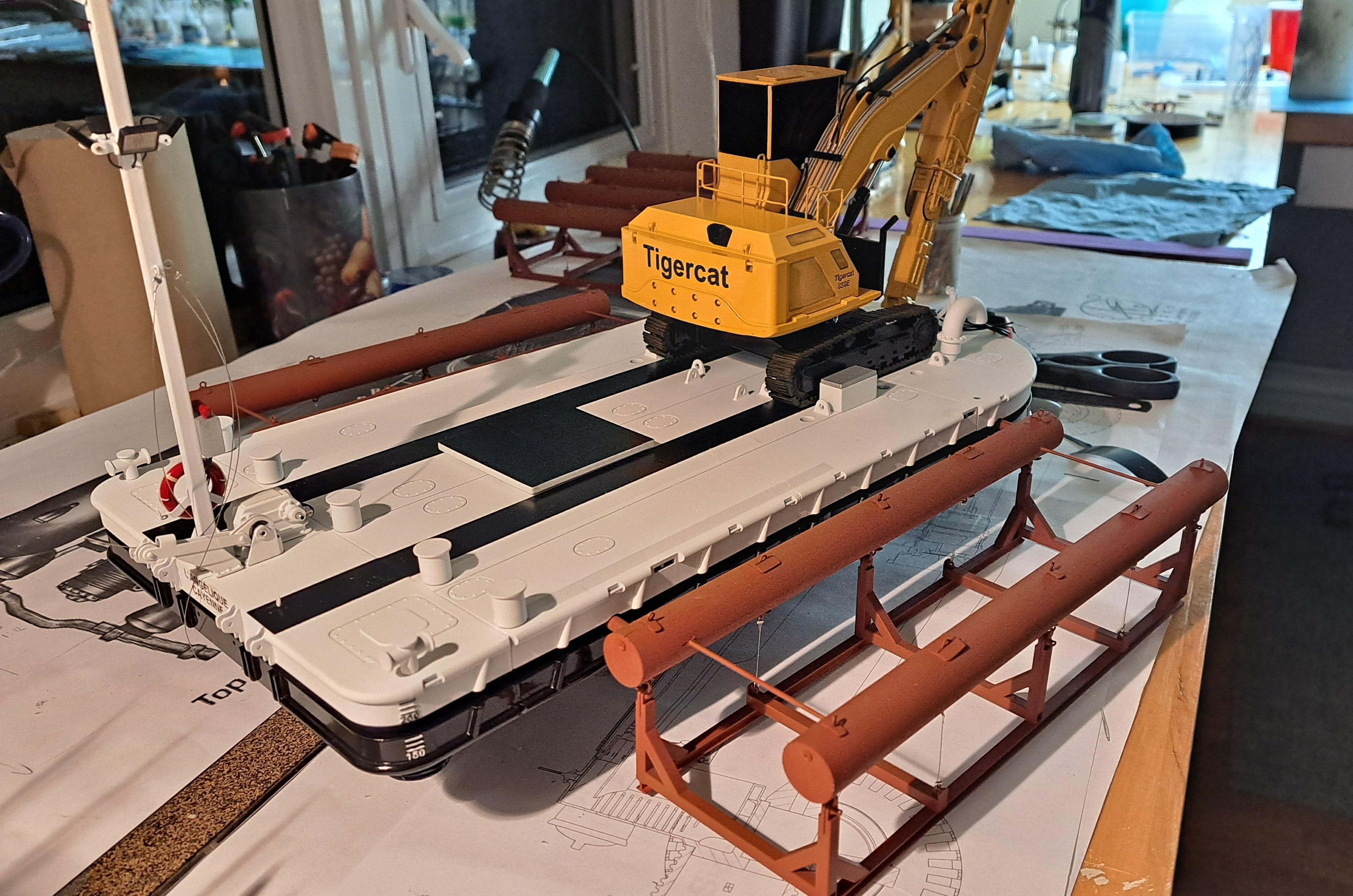

Yep, 2 full models. I have the first barge all painted and ready for detailing and final assembly. I've also made 2 bunks (2 per barge). These are submerged steel structures that receive the trees once they are cut. From what I can see on the pictures I have,  the bunks are just painted with red oxyde primer ( or something that looks like it) and are very rusty. So I  primed mine with a red primer and will try to rust them up a bit.
Here are some pictures of the barge fabrication.
Painted bottom section

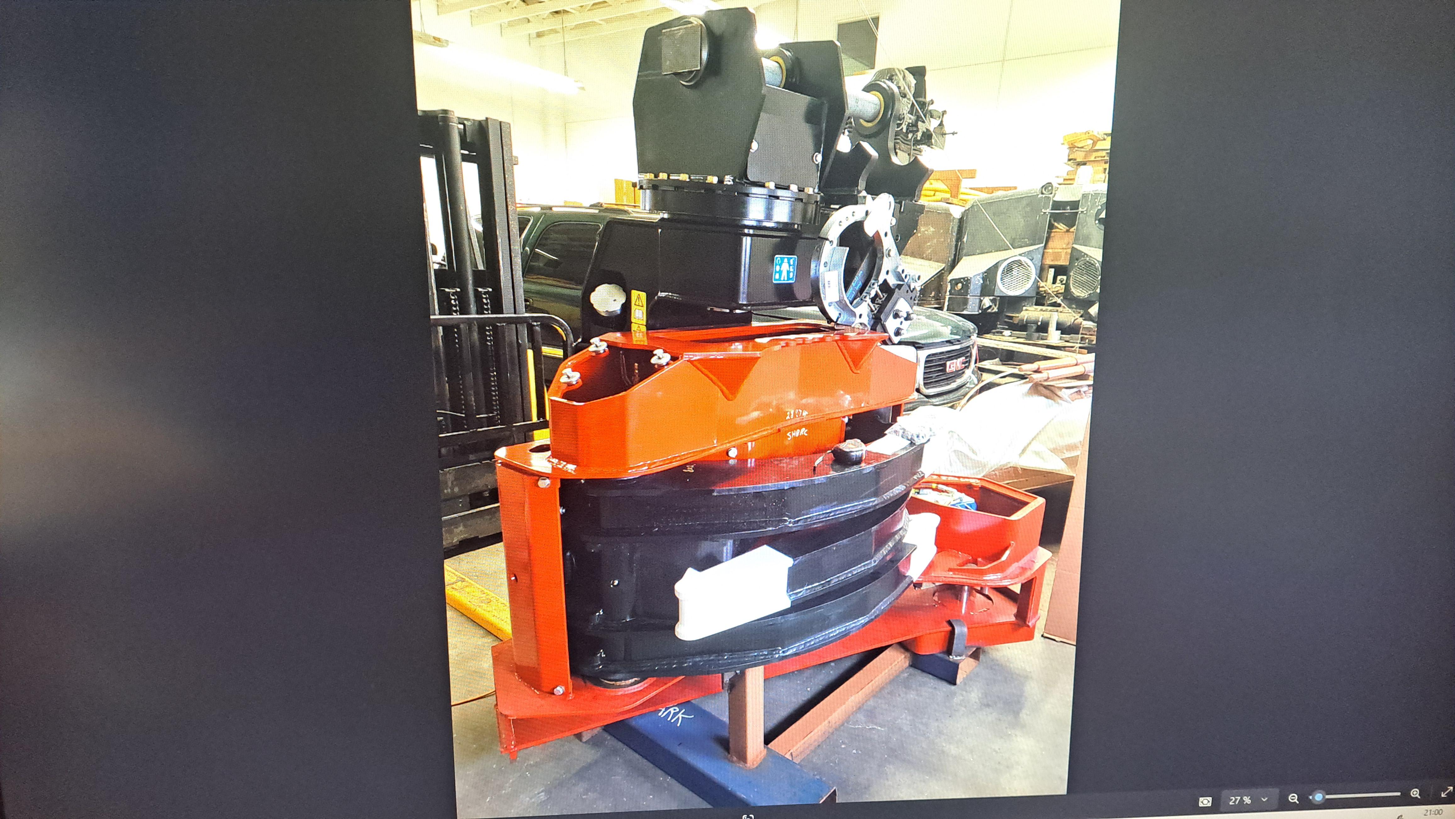

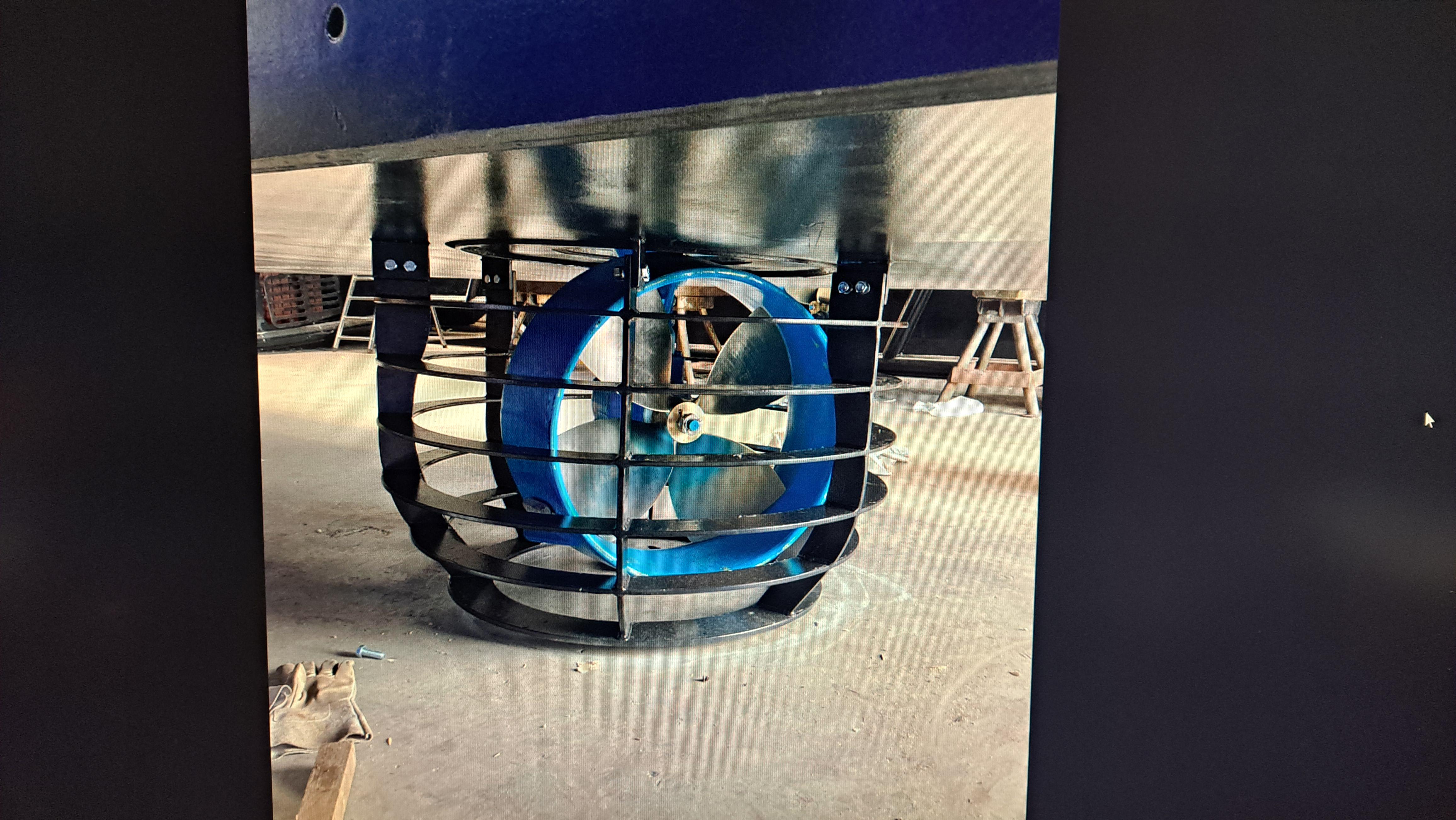

My version of the engine
And the real thing

The bunks fab
first pair primed and ready for rusting
Test fit of bunks and barge
A speaking peek at the end result

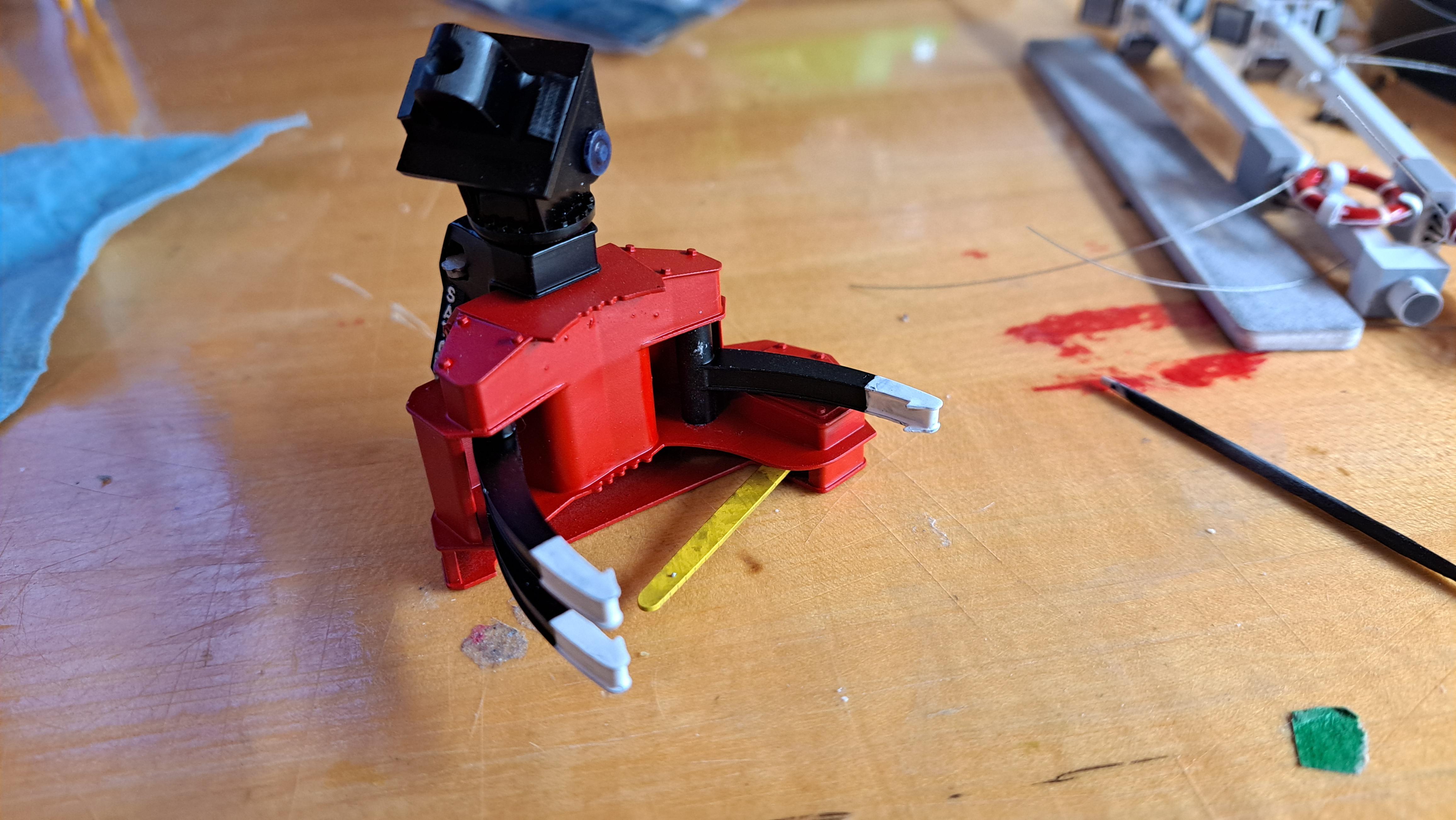

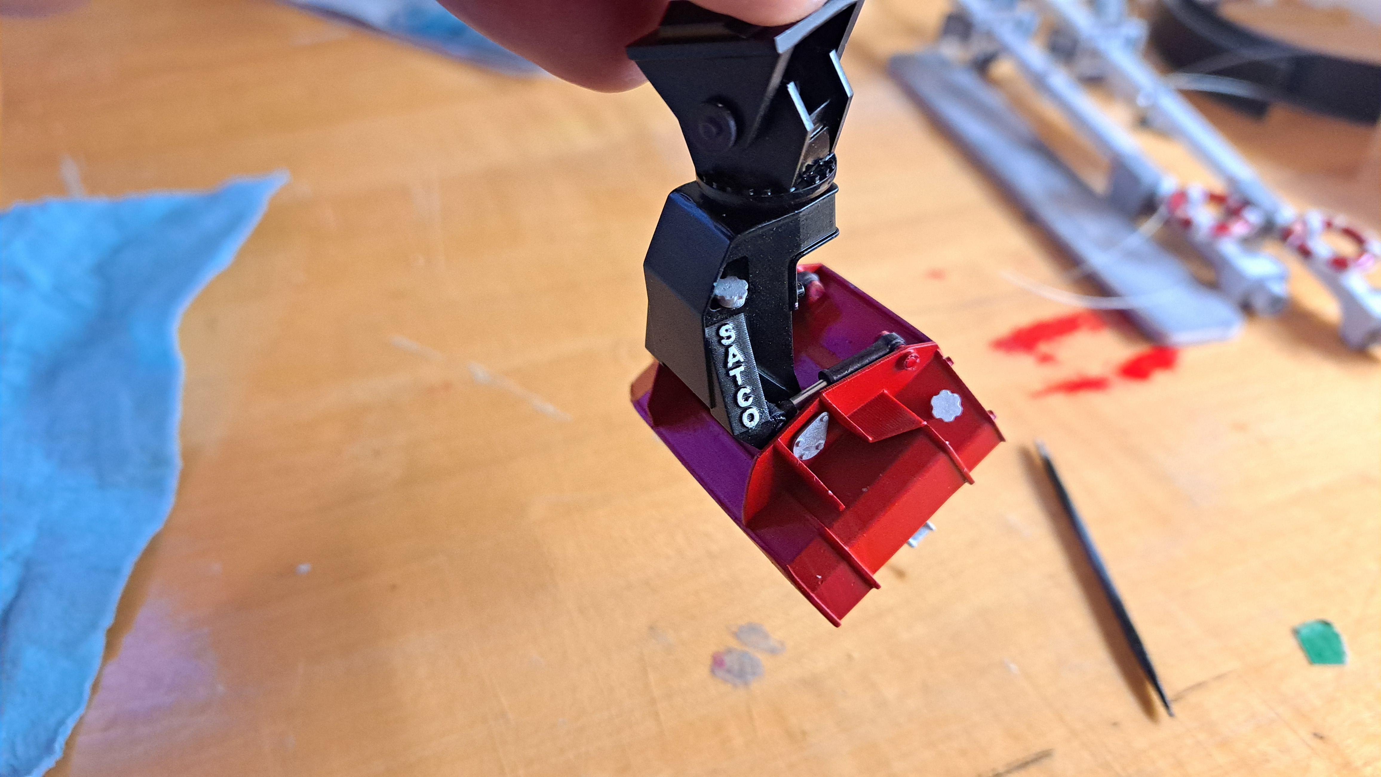

I 3d modeled printed and assembled the harvester head, that's the part that goes underwater and cuts the trees. Again, not much info, a few pictures,  the owners manual and 1 dimension. I think it came out good.
Edited by François

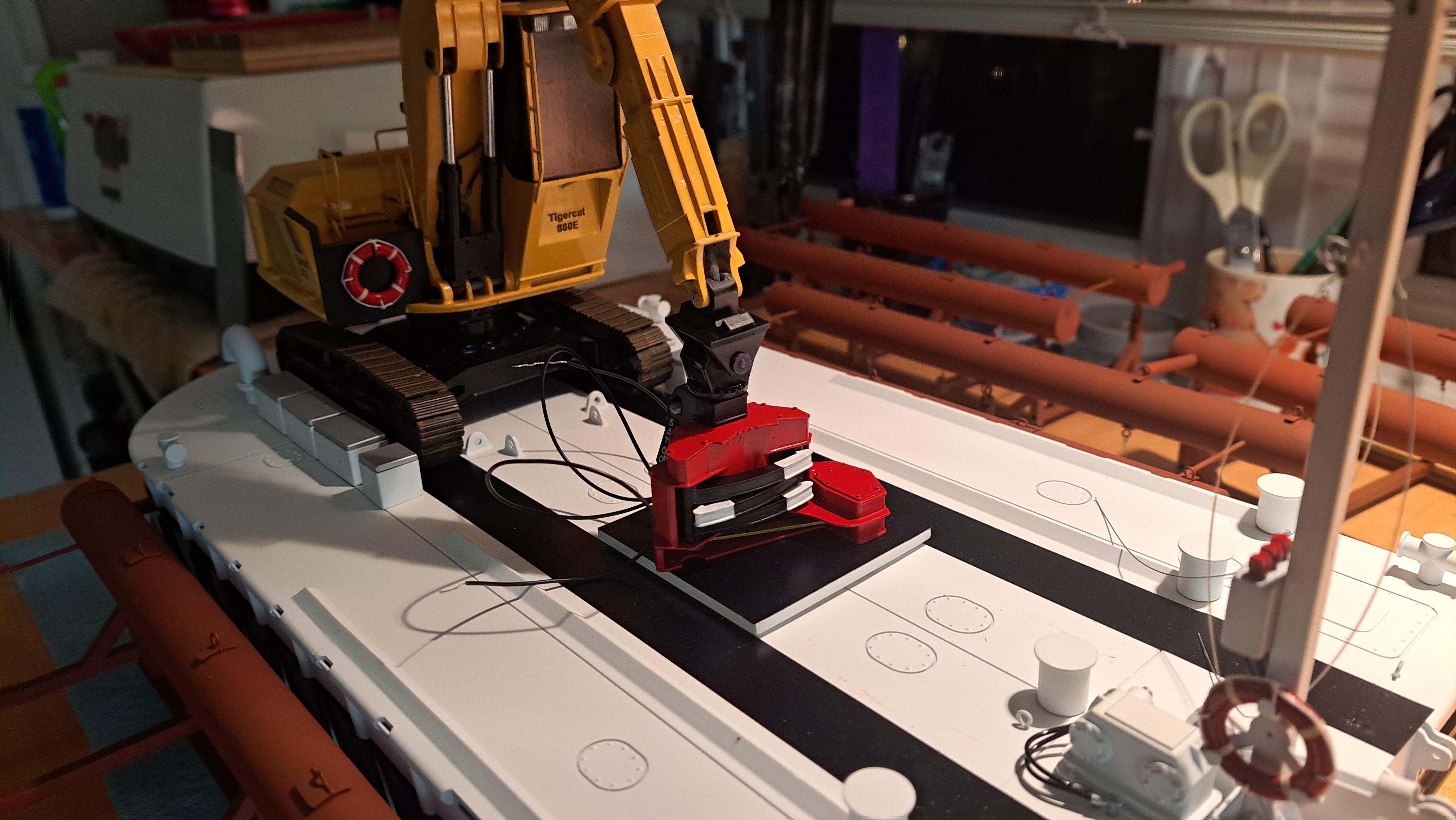

So, my part in this project is done. Tomorrow,  I'll be tranfering it to the diorama guy. Here are some pictures showing a bit how everything came together.
The inner plexiglass with laser cut openings mounted in a temporary frame
Bottom half screwed in place
Anchor deflector installed
Both bunks in place
Top half screwed from underneath thru bottom and plexiglass thus locking the bunks in place
Tigercat glued onto the top surface
Firts chain ratchet binder installed
Both binder and cross braking cable installed at one end (same was installed at other end of Tigercat)

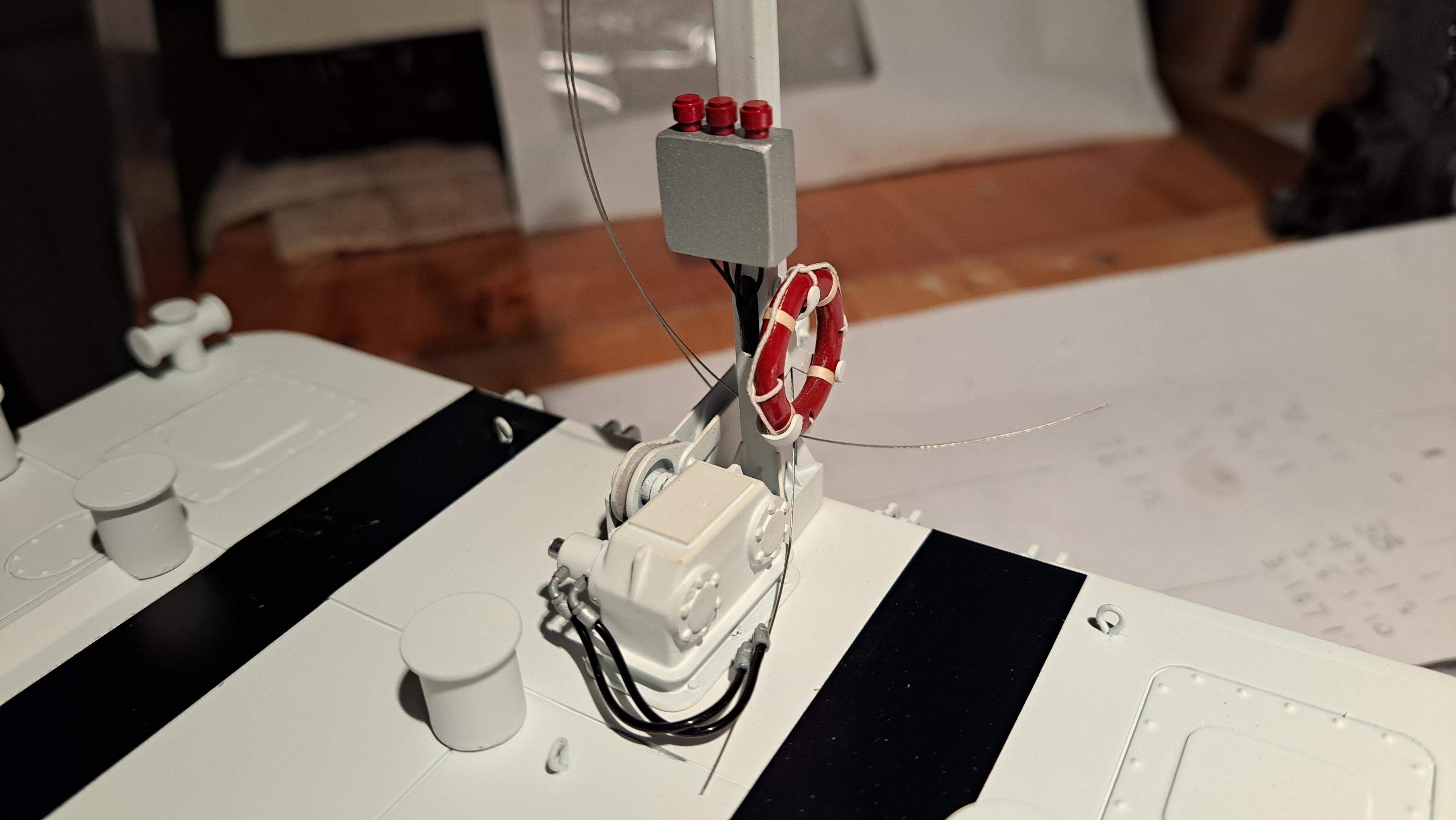

Tool boxes, front vent and front buoy installed
Anchor chain glued in place
Mast glued in place
And 3 retaining cables attached
Triton arm inserted thru plexiglass and glued in place (all pivots were also glued to eliminate any movement and rigidity the assembly)

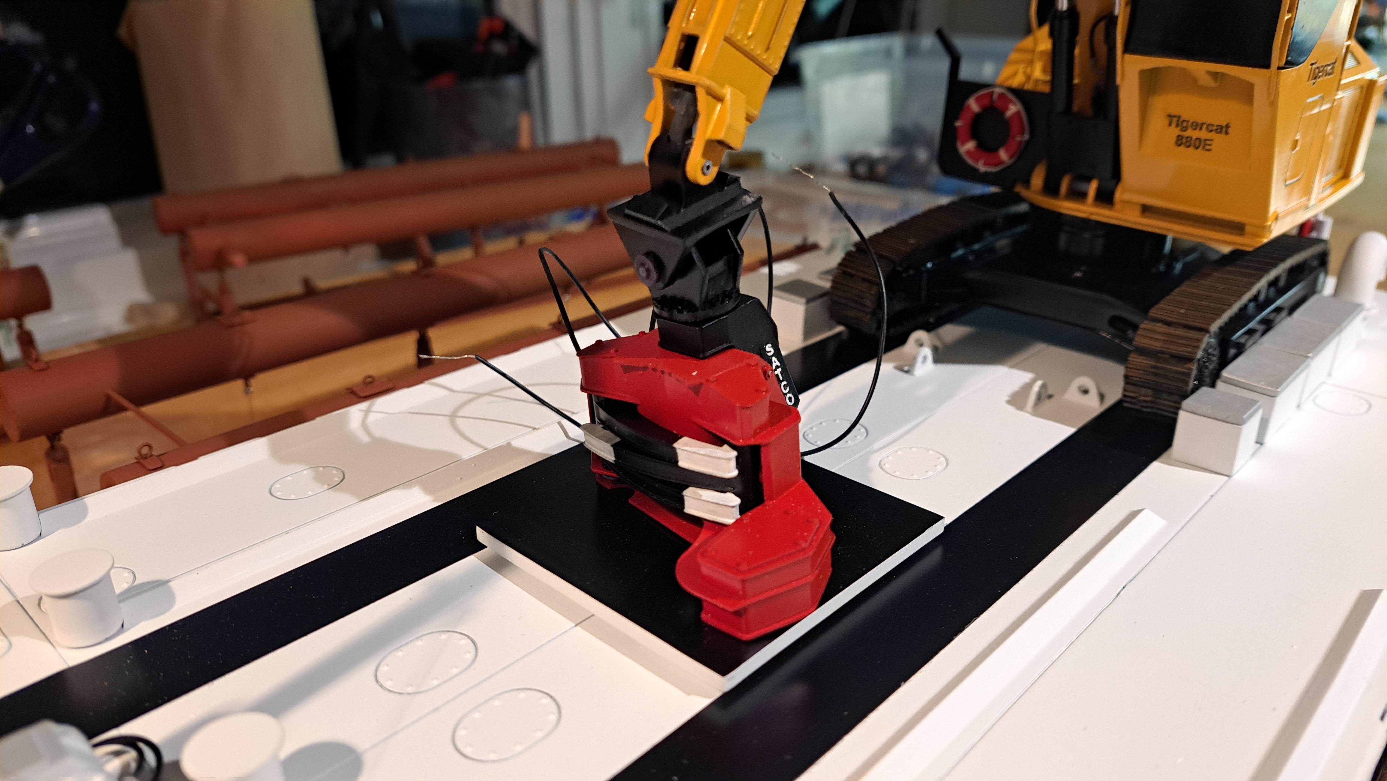

And finally,  the harvesting hand was installed after passing the cab lights wires thru

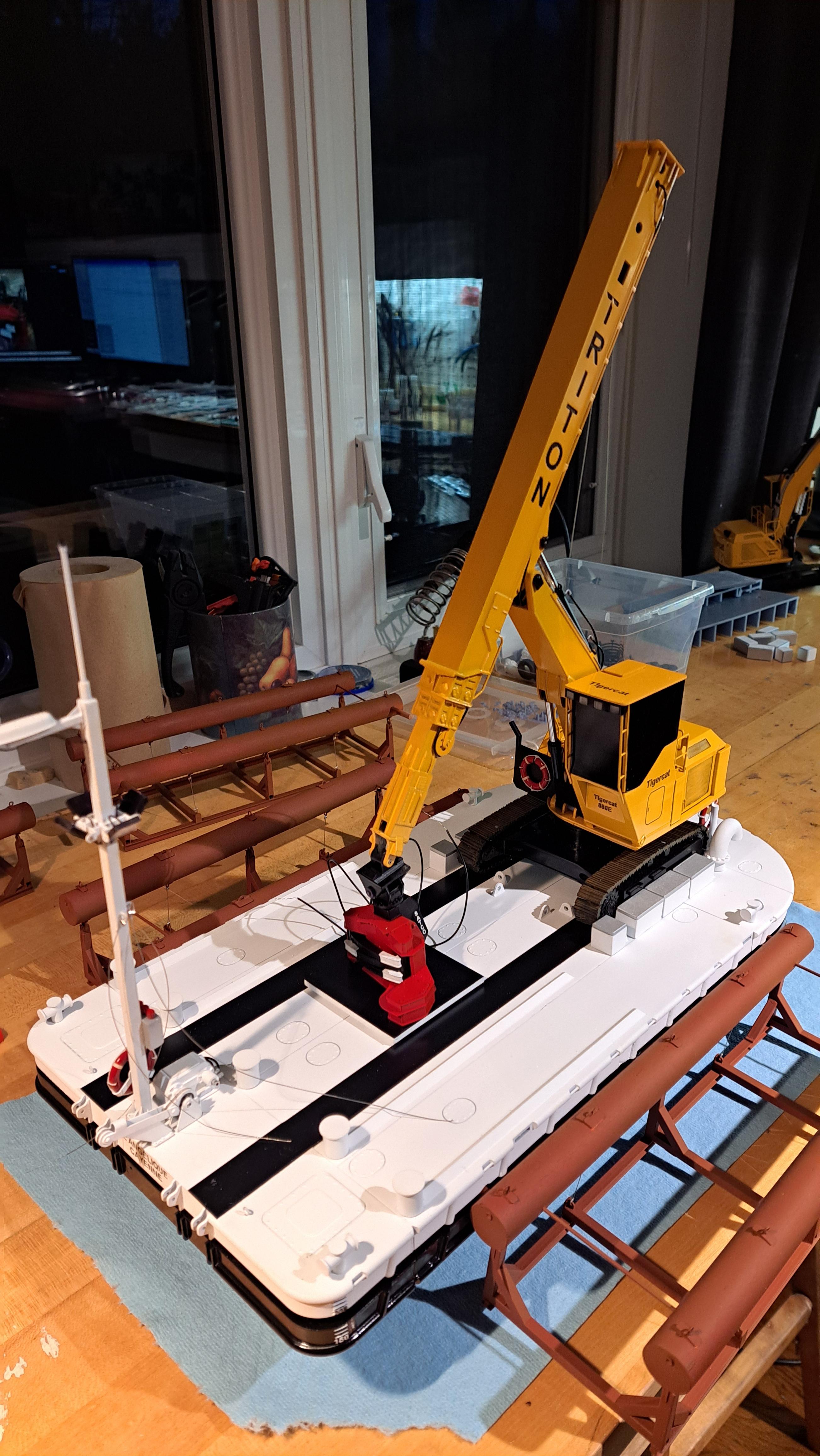

A few shots of the completed models
