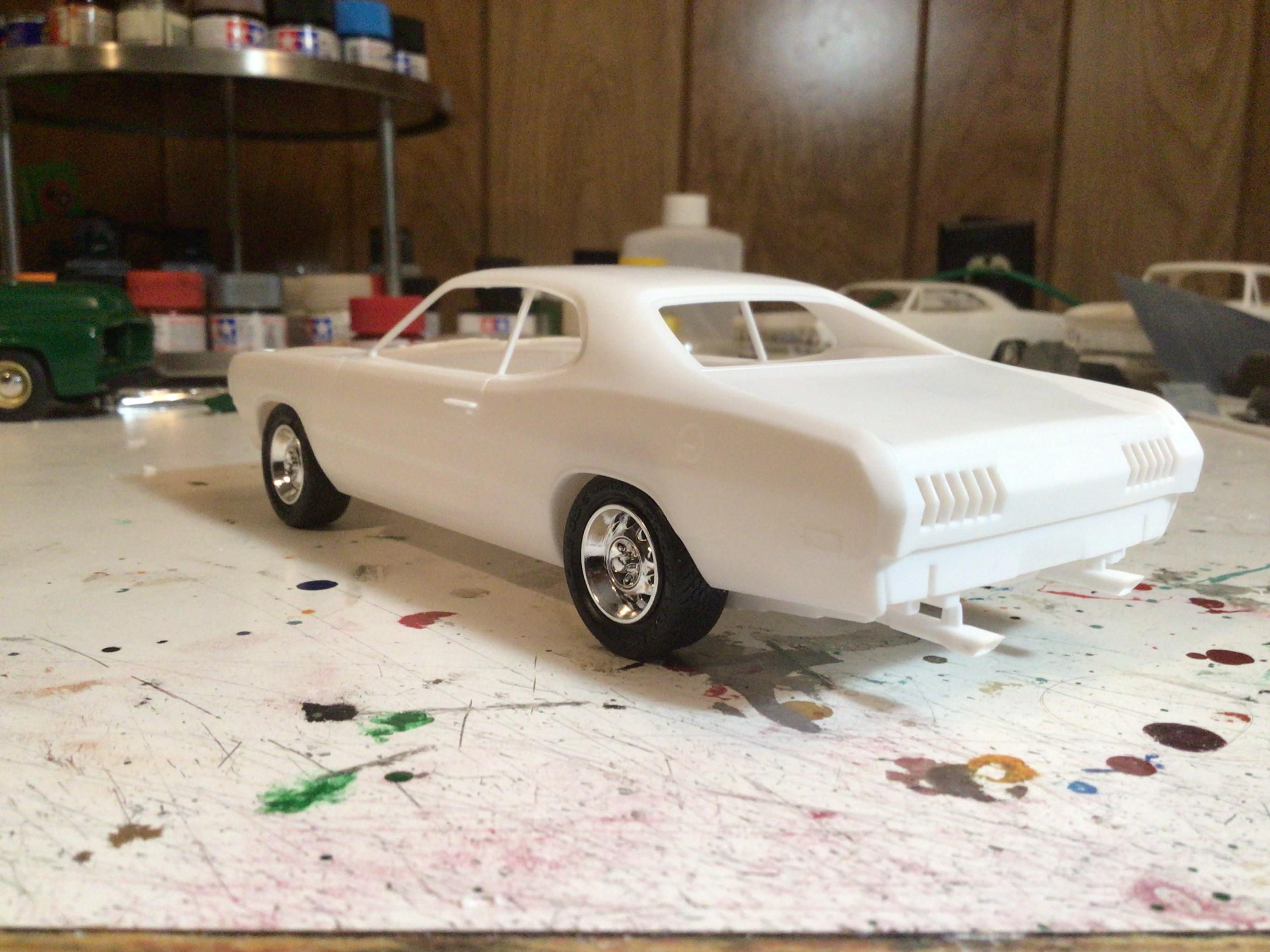

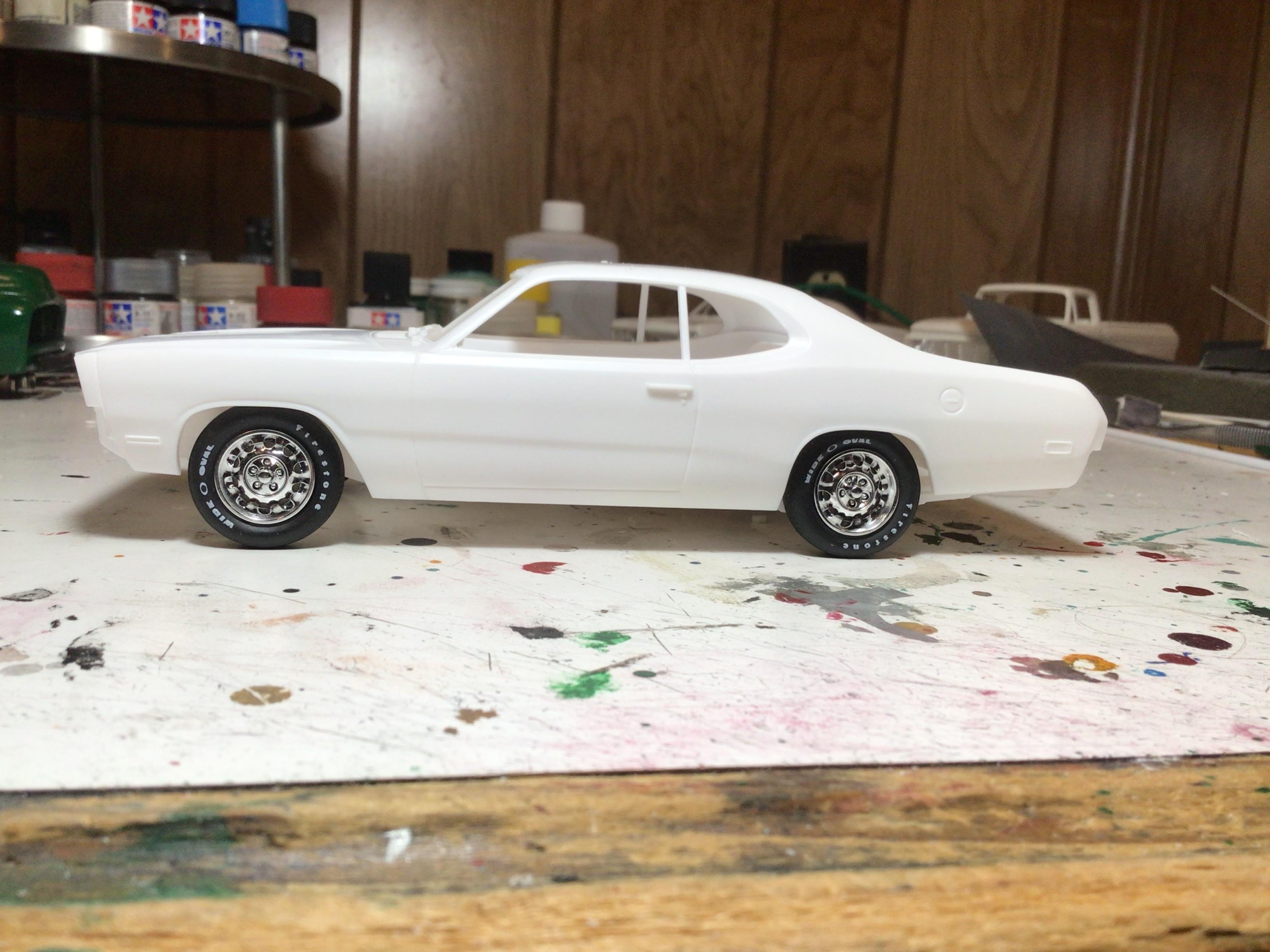

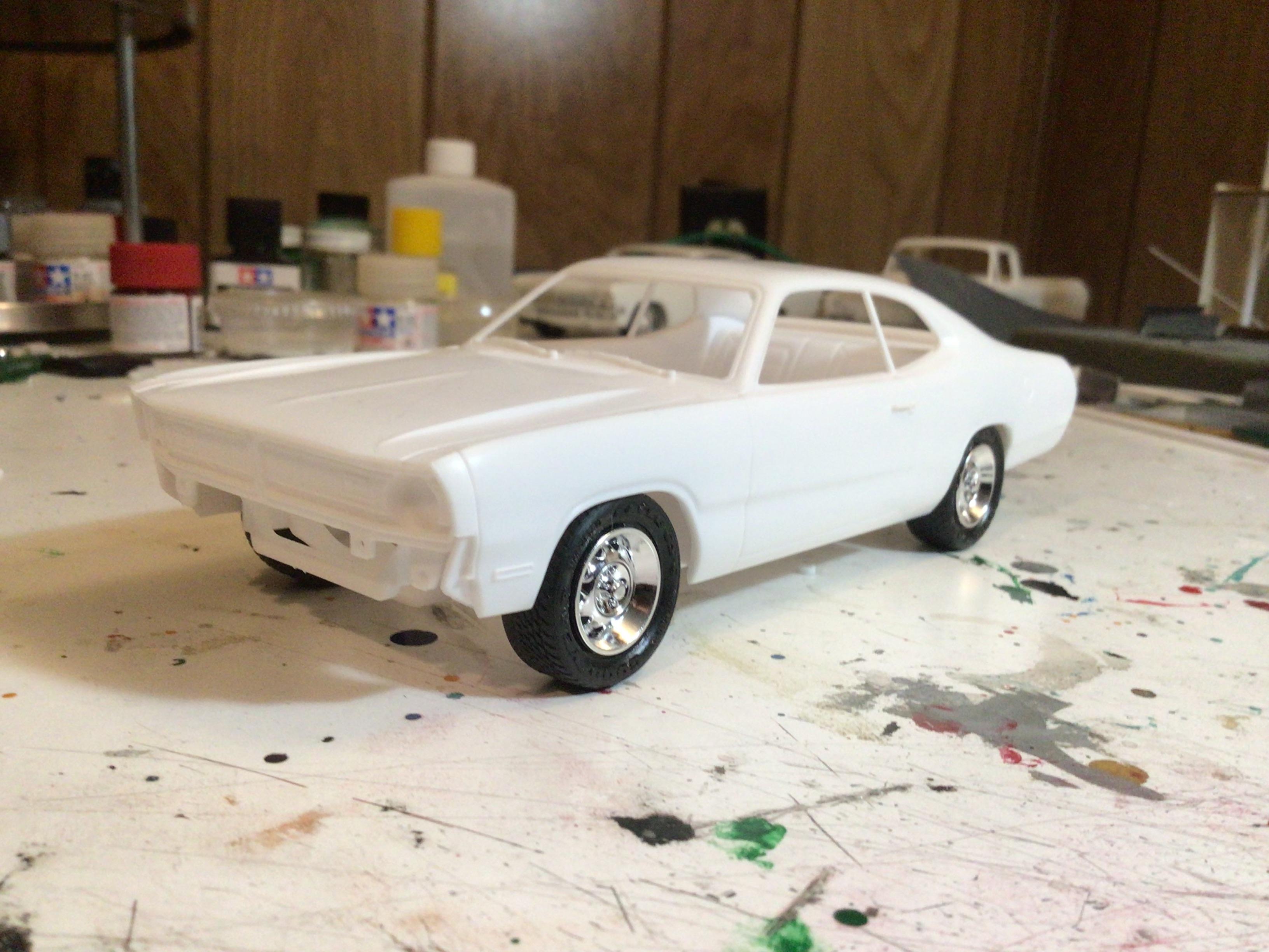

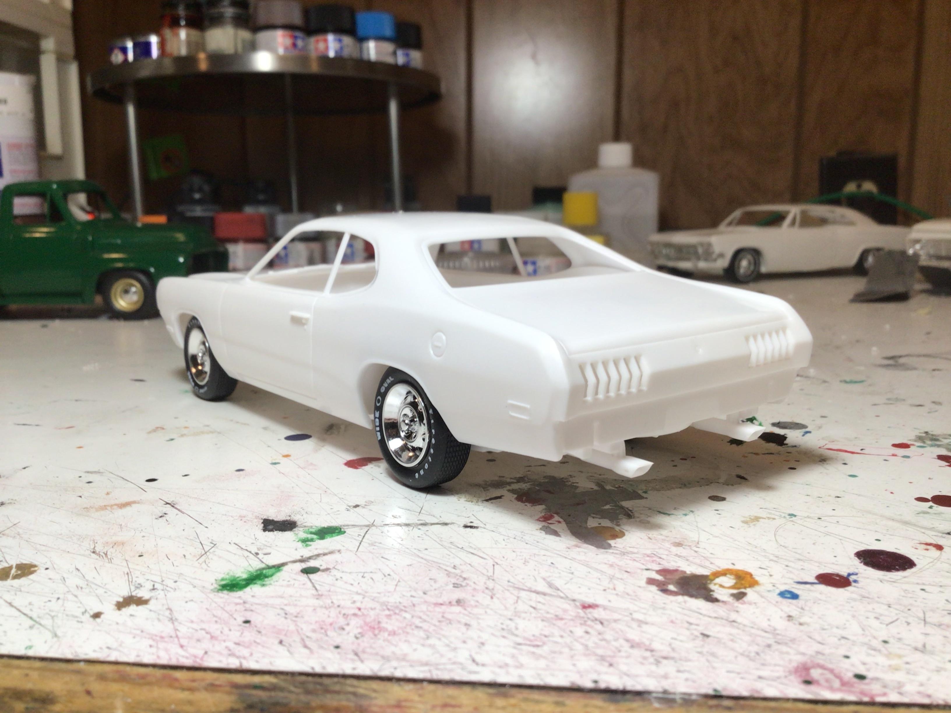

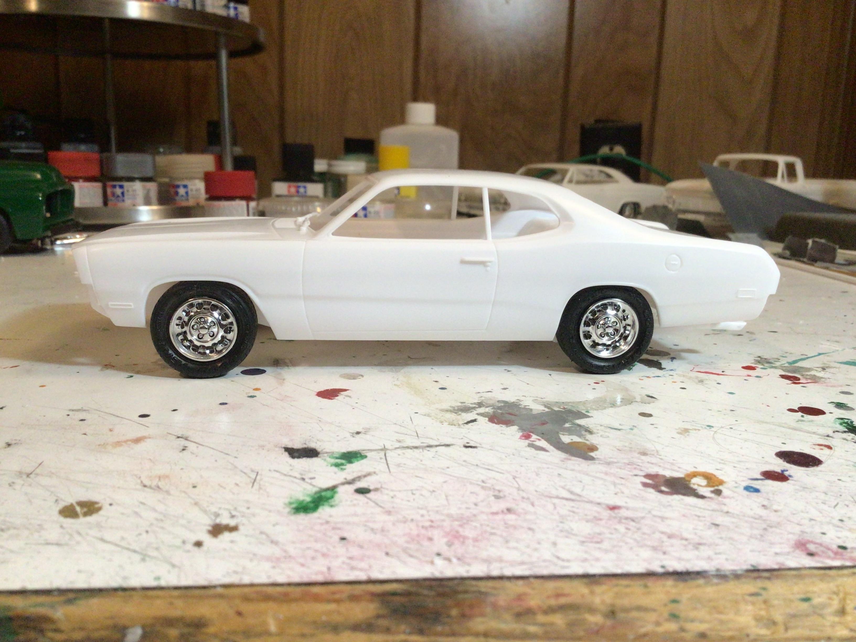

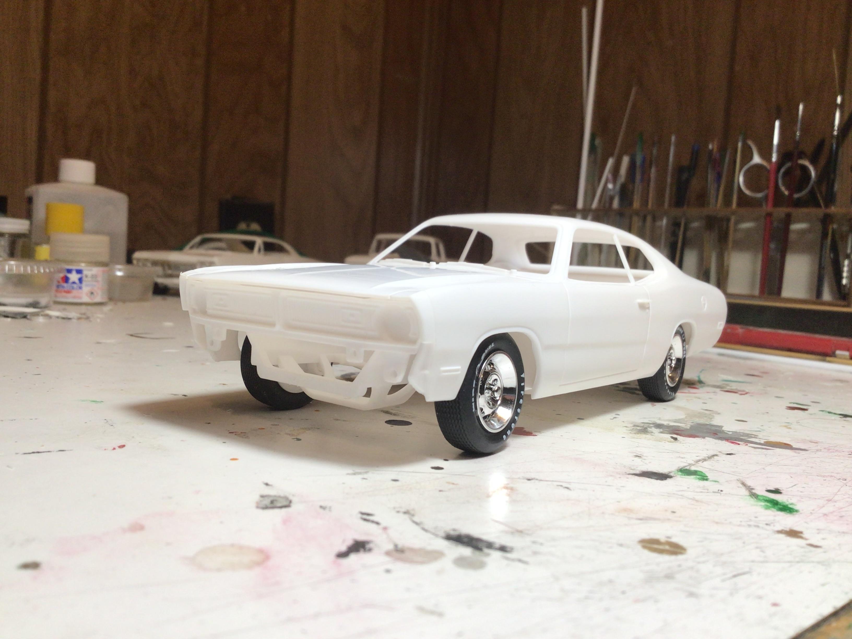

Radretireddad Posted October 17, 2024 Posted October 17, 2024 (edited) For me, the most important elements of a finished kit’s appearance are the ride height, front and rear track, and the proportions of the wheel and tire combination. Ensuring these are correct for my taste are the first things I check out, and if necessary correct before building. Although the MPC ‘71 Demon is mostly great right out of the box, I found the ride height to low, the front and rear tracks to narrow and the wheel diameter to large for the skinny hollow wide ovals included in the kit so here’s what I did to correct them. I corrected the front and rear ride height by gluing two pieces of thin evergreen strip between the chassis and the axle holders at all four corners. Two worked for me but you can add or subtract as many as you like to suite your tastes. I think it still looks a little lower than stock which is perfect for me. I corrected the front and rear track by adding 1/32” long pieces of evergreen tubing behind all 4 wheel inners. Finally I decided the kit wheels, which look more like 15 or even 16 inches in diameter and way deeper than stock, look much more proportionally accurate inserted in a set of wider Goodyear Eagle GSCs in place of the skinny Firestone wide ovals. I posted pics of both for reference. The final look, I think, is more like a tasty corner carving resto-mod which is spot on for me. I’d love to hear what you guys think. Edited October 21, 2024 by Radretireddad 10

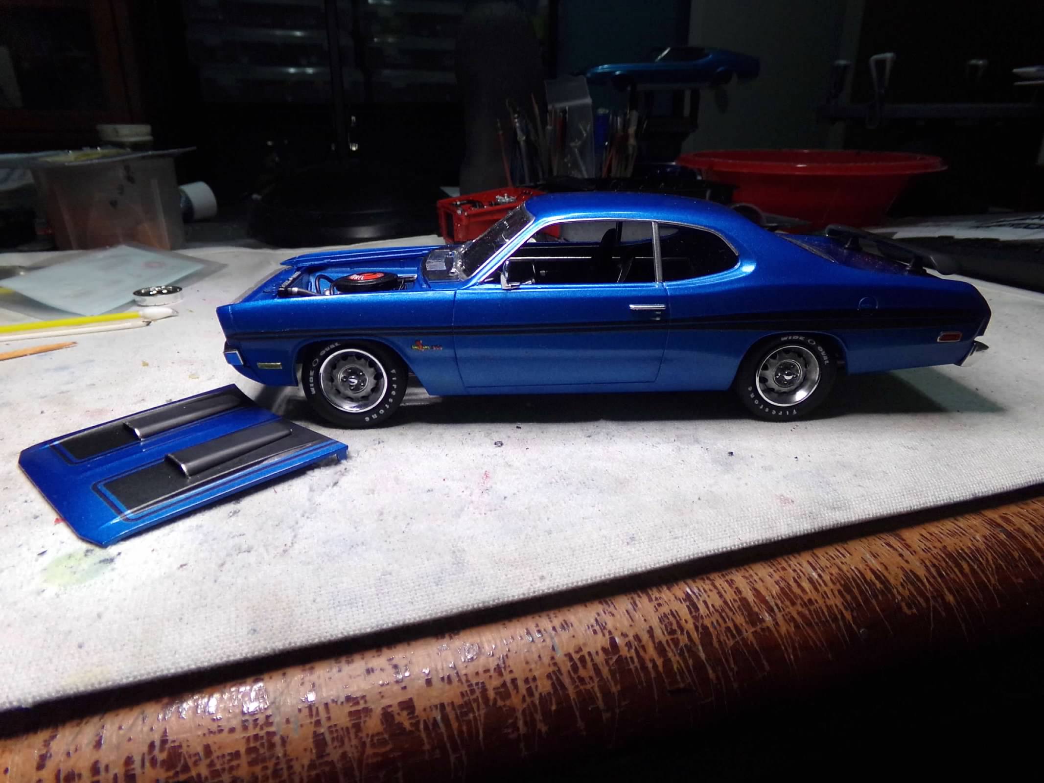

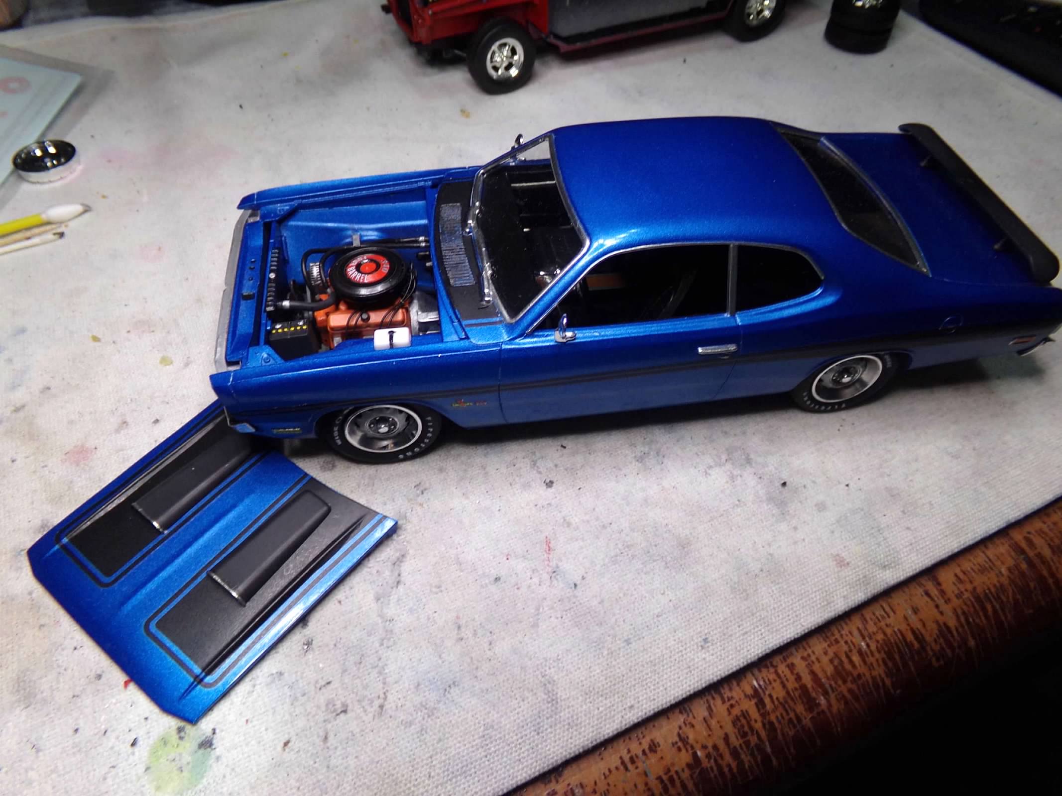

ModelcarJR Posted October 19, 2024 Posted October 19, 2024 I like the changes you've made to the Demon. The "Model Car Magazine" issue 224 also indicates that the engine block and front seats are bit undersized and suggests that they could be substituted from the AMT 340 Duster. I have built this Demon with none of those changes but I did Dullcote the decals on the decal sheet before application and they look nice along with the flat black painted scoops and rear spoiler. Still managed to finish 2nd in a large model car contest. I plan on building it again and will incorporate your changes and the engine and front seat changes and see what happens. I hope you don't mind a couple of photos. 5
Radretireddad Posted October 19, 2024 Author Posted October 19, 2024 4 hours ago, ModelcarJR said: I like the changes you've made to the Demon. The "Model Car Magazine" issue 224 also indicates that the engine block and front seats are bit undersized and suggests that they could be substituted from the AMT 340 Duster. I have built this Demon with none of those changes but I did Dullcote the decals on the decal sheet before application and they look nice along with the flat black painted scoops and rear spoiler. Still managed to finish 2nd in a large model car contest. I plan on building it again and will incorporate your changes and the engine and front seat changes and see what happens. I hope you don't mind a couple of photos. Very nice build. Looks great in blue. I agree on the engine size. I was thinking about going to a 3d printed small block assembly with some aftermarket speed parts added. Thanks for sharing. 1

Ken Car-Fanatic Posted October 20, 2024 Posted October 20, 2024 I agree that wheel/tire size, ride height & stance can easily make or break a car build. Your changes definitely help make it look good. Nice attention to detail & getting it right. 1

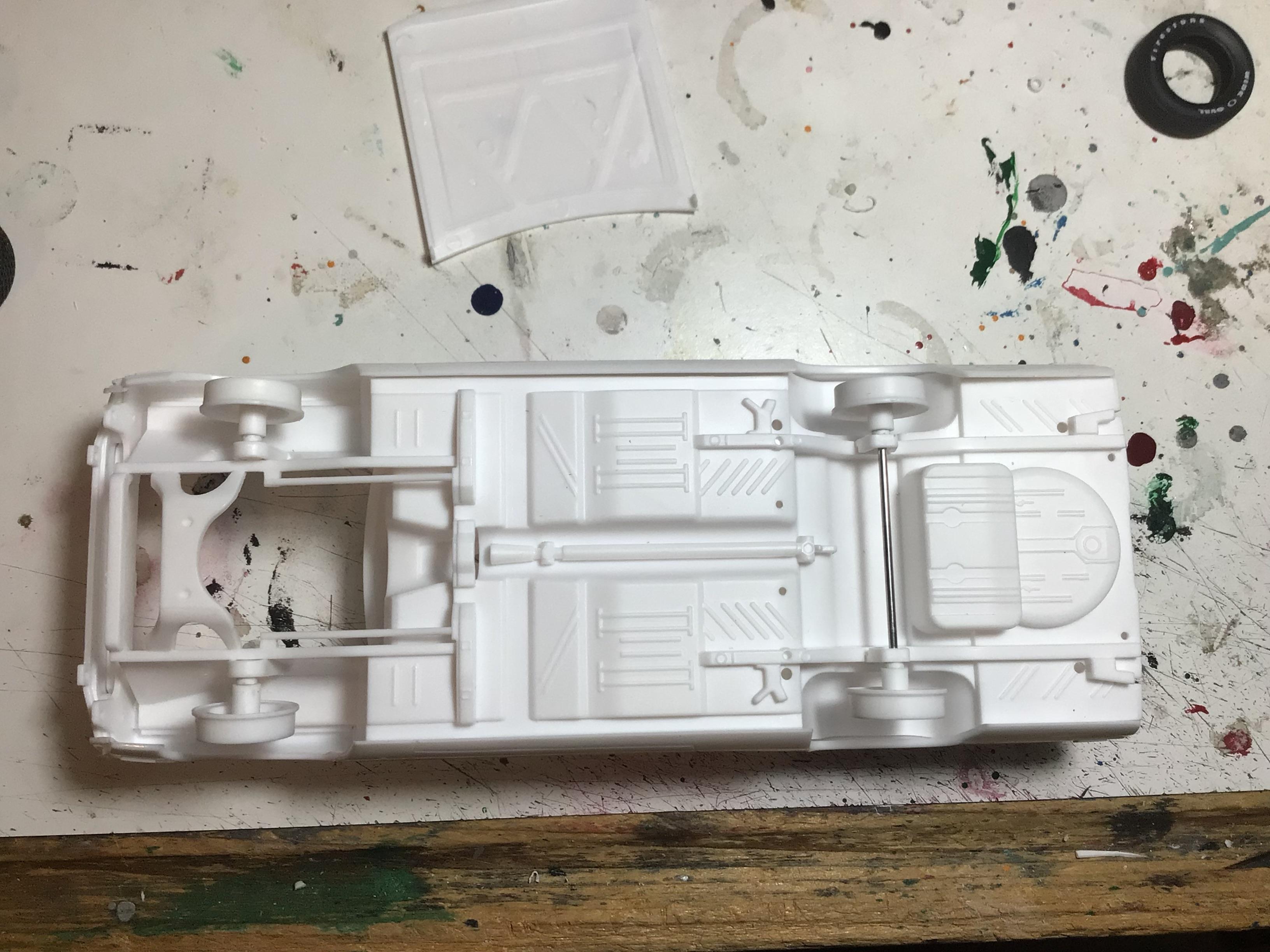

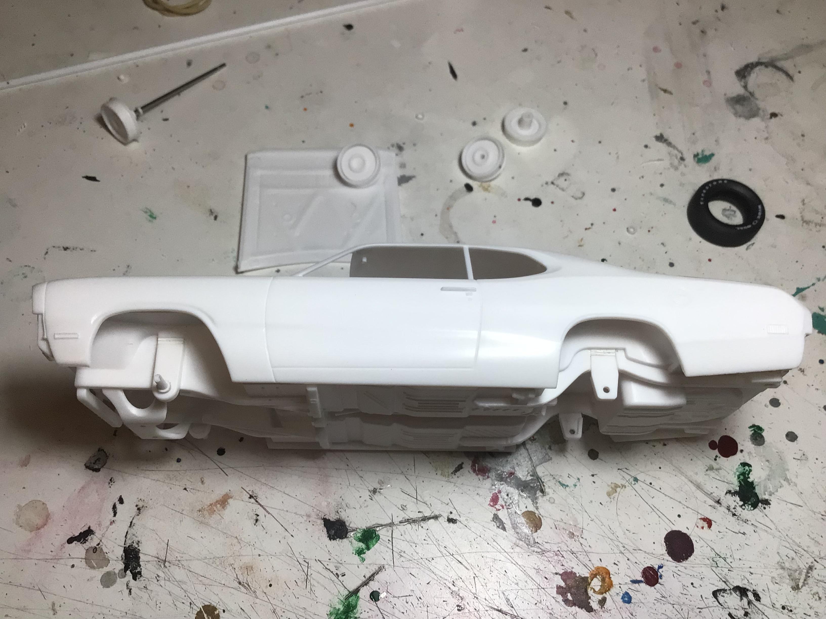

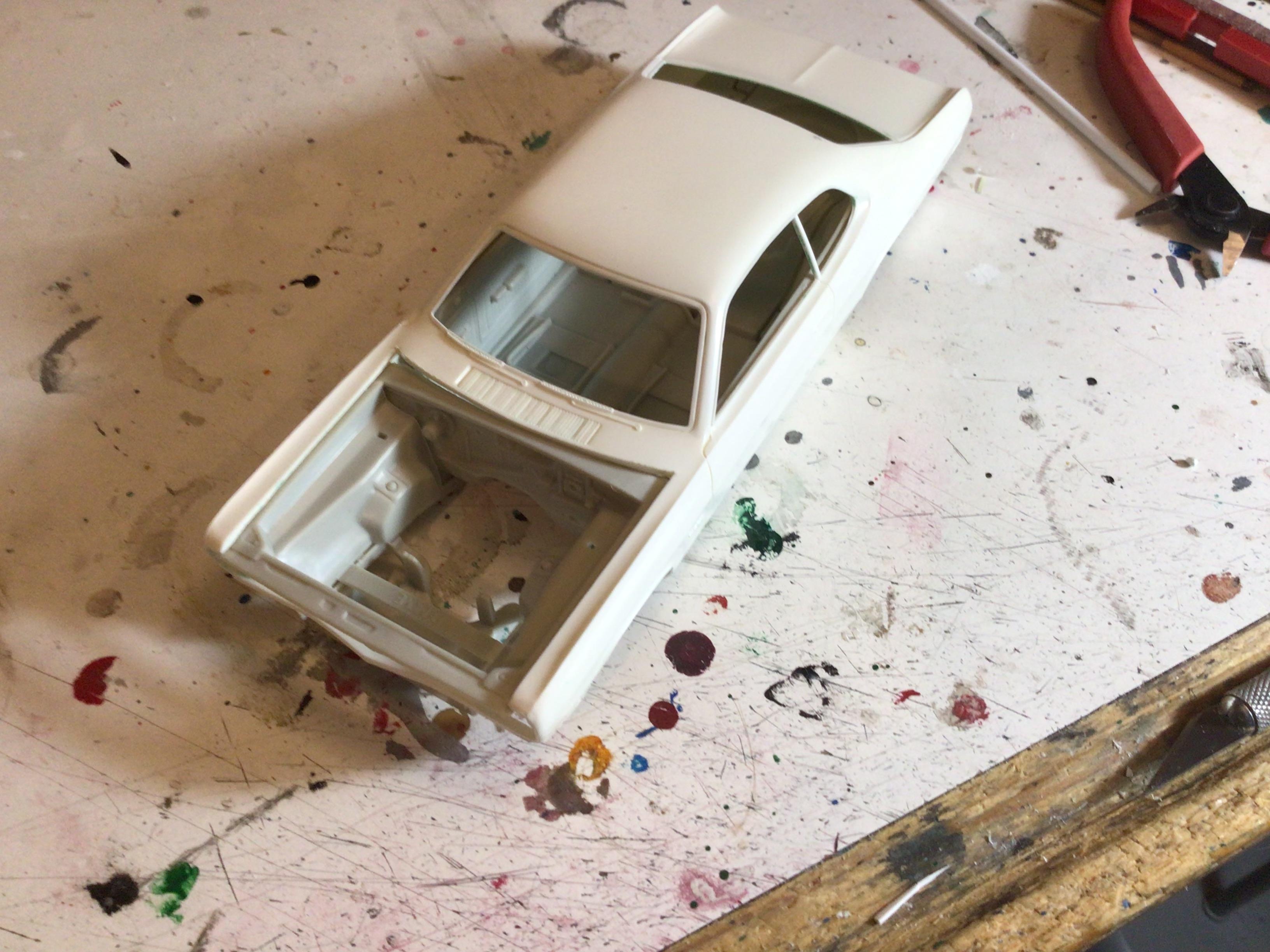

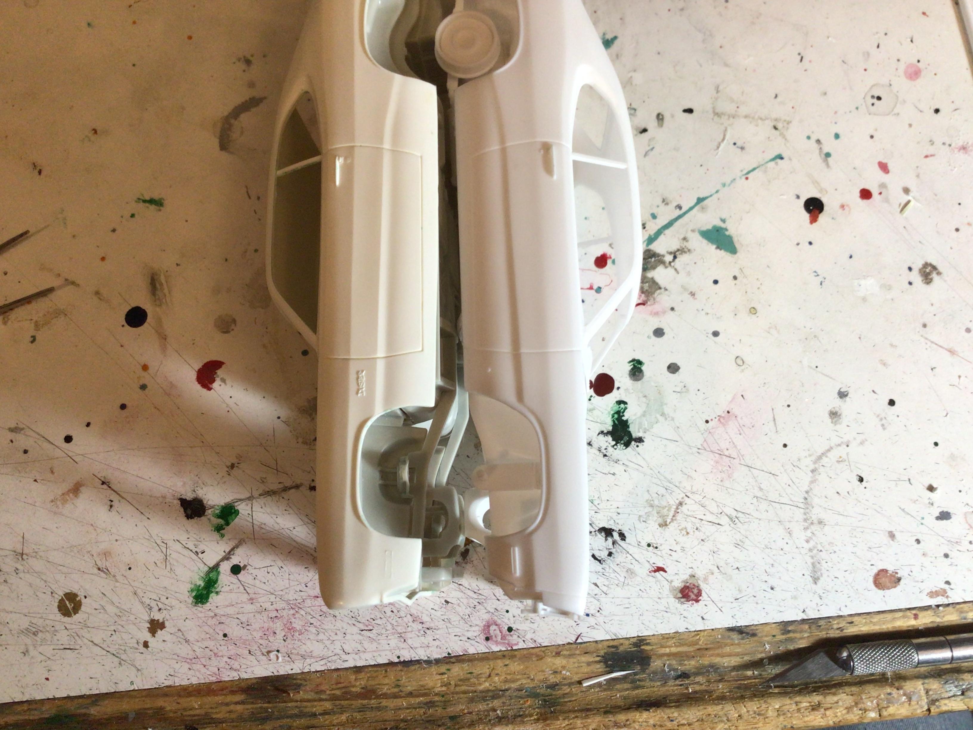

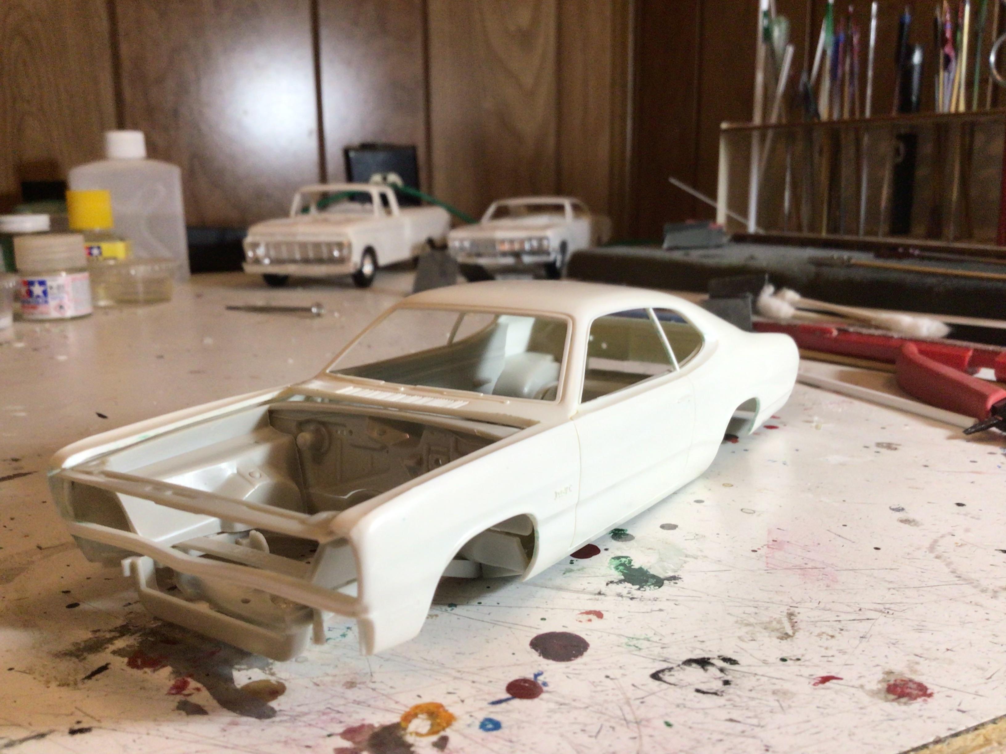

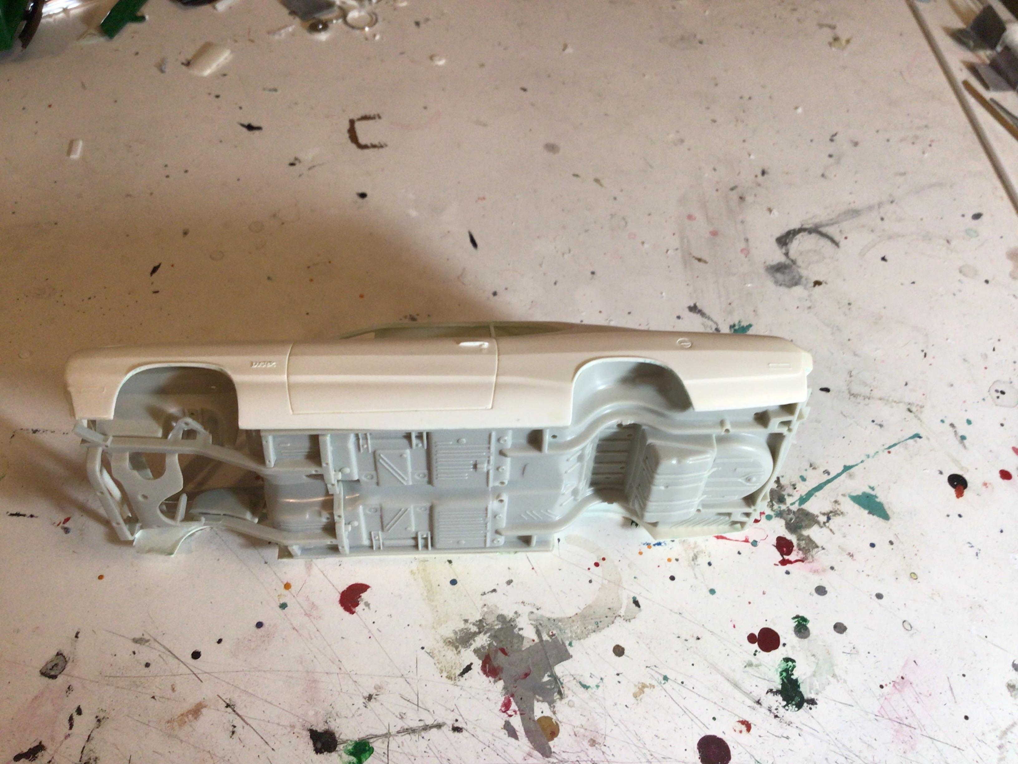

Radretireddad Posted October 21, 2024 Author Posted October 21, 2024 (edited) On 10/19/2024 at 3:13 PM, LennyB said: Nice stance, and I hope you keep the Rally Wheels, always loved those. Considering the comments above this would probably be a good candidate to do a chassis swap with the AMT Duster kit. The wheelbase should be the same but you never know. Has anyone tried that? I have a bash in process using an old ‘74 Duster body I hung on to and it’s a slam dunk. If you carefully cut out the inner fenders, radiator and firewall from the ‘71 Duster kit, they should drop right in to the Demon as they do here. The interior door panels, although not correct for this year Duster also perfectly line up. The only place you’ll need to pay attention to is in the difference between the Duster and Demon front wheel openings. Edited October 21, 2024 by Radretireddad 2

1972coronet Posted October 21, 2024 Posted October 21, 2024 (edited) 16 minutes ago, Radretireddad said: The interior door panels, although not correct for this year Duster also perfectly line up. IMO, the 1971 Duster door cards are 'close-enough' for the 1973 & later models (see image). [ EDIT ] : Yes, the uppers are different ; 1970-1972 are metal (and shaped differently) vs. the moulded plastic of the 1973 & later panels. I, too, have a '74 annual (as well as a '72 and '73) , which I've been planning to do that very bash you've presented. Edited October 21, 2024 by 1972coronet AMENDMENT 1
Radretireddad Posted October 21, 2024 Author Posted October 21, 2024 1 minute ago, 1972coronet said: IMO, the 1971 Duster door cards are 'close-enough' for the 1973 & later models (see image). I, too, have a '74 annual (as well as a '72 and '73) , which I've been planning to do that very bash you've presented. Awesome! In addition to this one, I’m doing one with the MPC ‘69 Barracuda, ‘76 Dart, and one using the LA Dart wheel stander. 1

Moparman18064 Posted October 21, 2024 Posted October 21, 2024 (edited) On 10/19/2024 at 4:13 PM, LennyB said: Nice stance, and I hope you keep the Rally Wheels, always loved those. Considering the comments above this would probably be a good candidate to do a chassis swap with the AMT Duster kit. The wheelbase should be the same but you never know. Has anyone tried that? My 72 Demon build that is almost done is based on it. You do end up cutting a little bit off the rear of chassis for bumper to fit. You also end up making little inner front fender splash shields to cover firewall/ chassis/ body gap. Otherwise, wheelbase turns out perfectly. Edited October 21, 2024 by Moparman18064 1

Mopar - D Posted October 22, 2024 Posted October 22, 2024 Nice changes to the kit chassis. I chose to replace the chassis with the Duster and as noted above there is a little bit of reworking to make it fit. My WIP was back in July.
