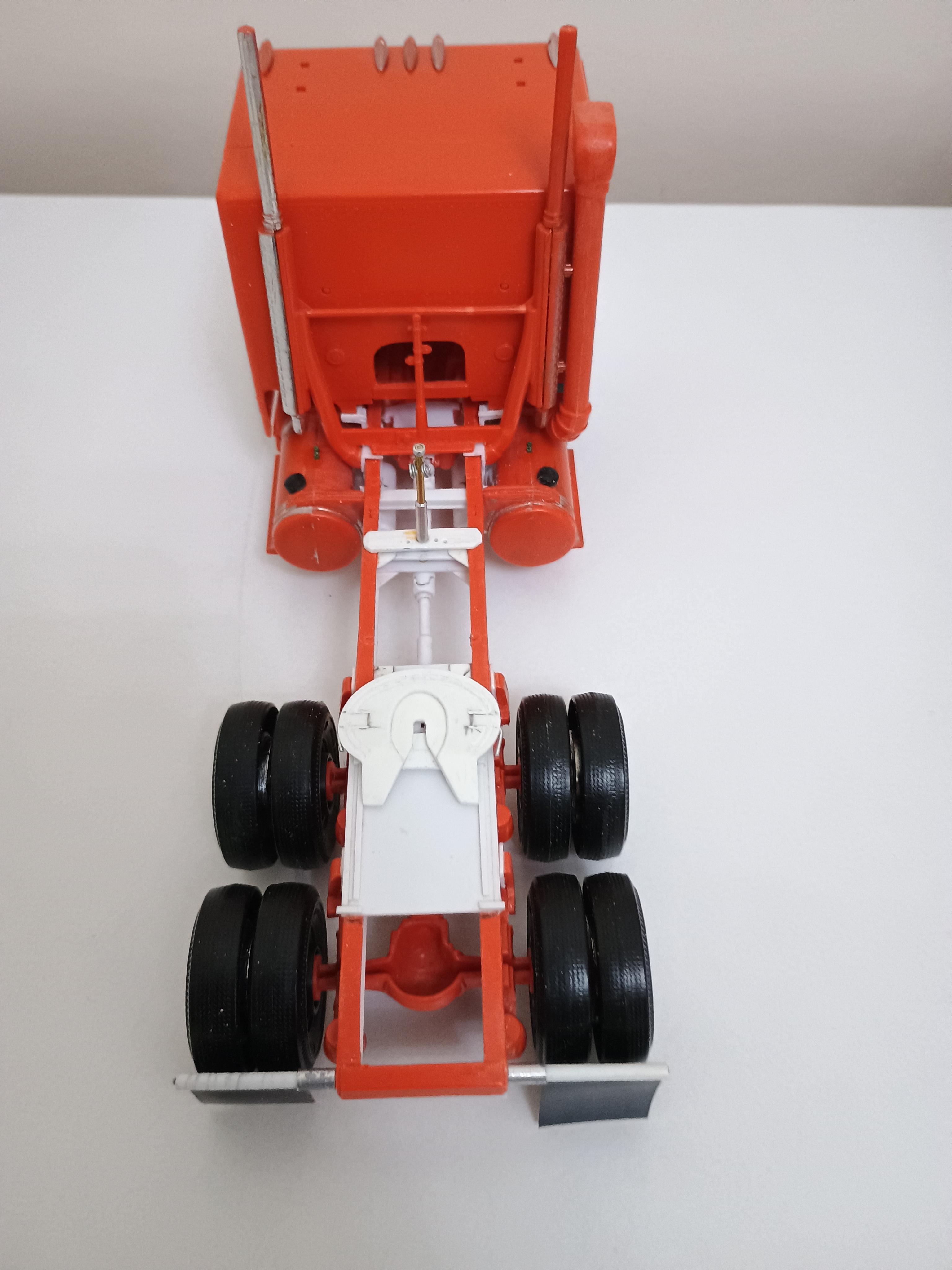

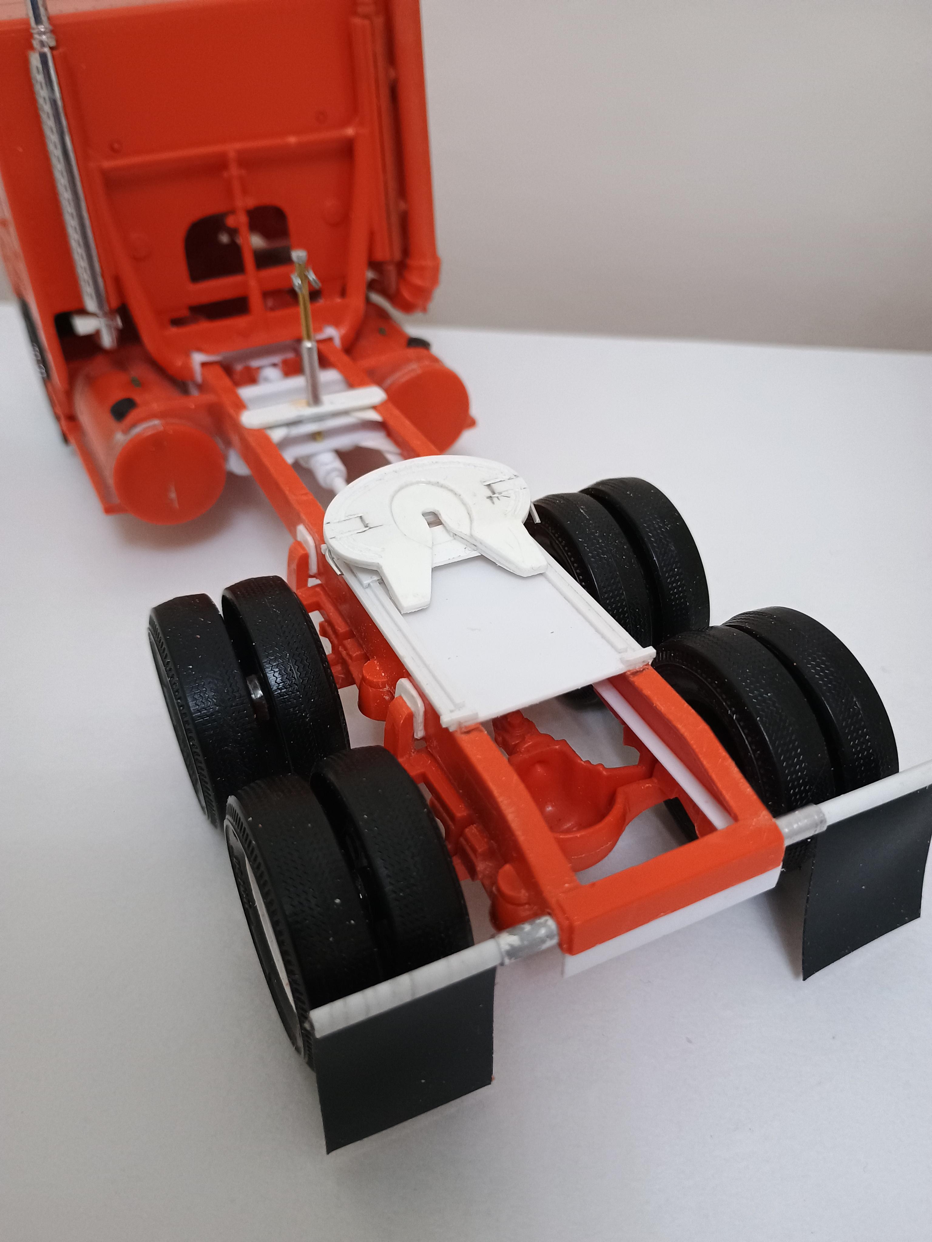

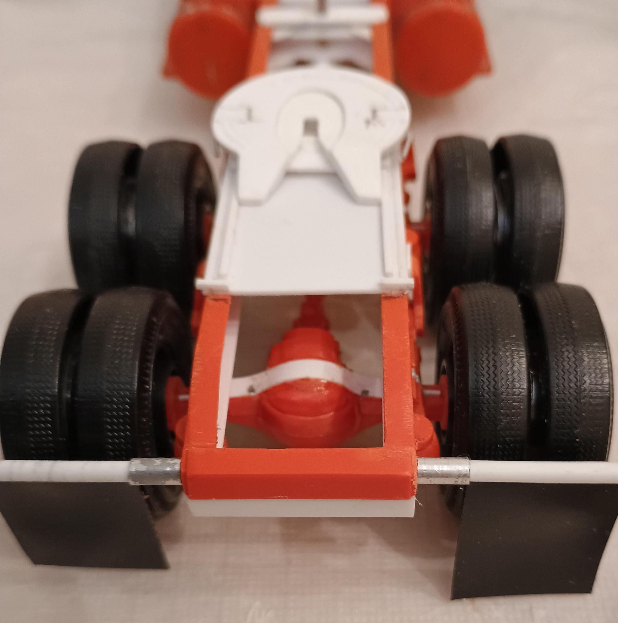

Rockford Posted December 8, 2024 Author Posted December 8, 2024 Snatched some time on the bench this afternoon. Fabbed some air tanks from plastic tube with the ends filled and shaped. Added brackets and located them behind the fuel tanks to keep the clean look of the chassis. Added a 2mm strip to the bottom of the chassis to make it a genuine C section rail. Really couldn't abide the fifth wheel so took a pattern of one of my Hollands and started making a new one. Much better than the kit pieces. 4

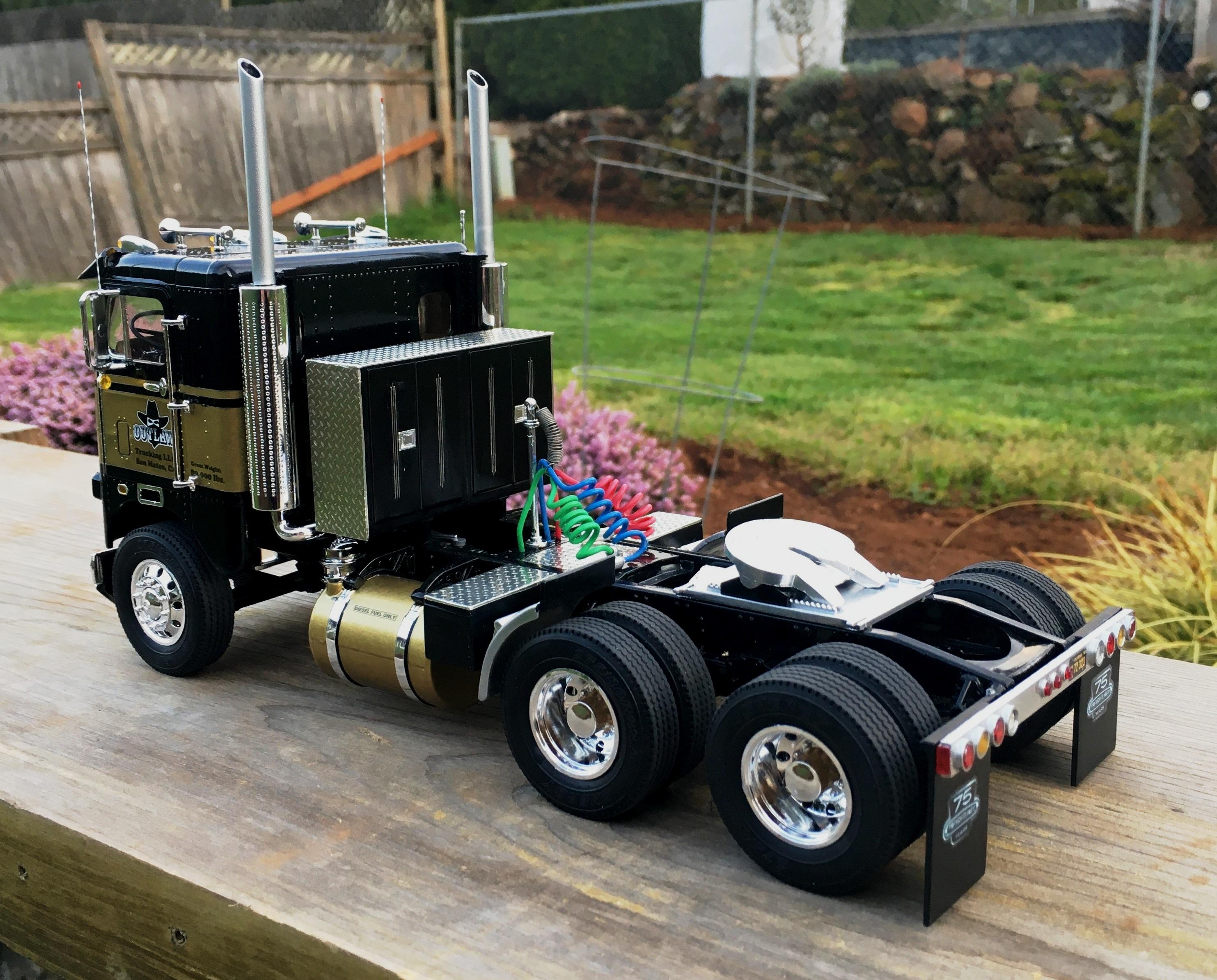

Bills72sj Posted December 9, 2024 Posted December 9, 2024 On 11/14/2024 at 3:04 PM, Rockford said: I have never had a good explanation for why people would run a cabover on such a long frame. This doesn't look like it's been a "drom"because of the position of the pogo stick and fifth wheel. Why so long and not a conventional? I suppose you could say Freightliner didn't make a conventional at the time but these trucks aren't alone. When I built my Freightliner day cab dual drive for an extended flatbed, I took advantage of the longer frame for a chain box/headache rack. 2

Rockford Posted December 9, 2024 Author Posted December 9, 2024 I can't take credit for the Freightliner, that's Bill showing me how he used his chassis space. Wrong scale for me sadly. My Pete looks much better with the Holland type fifth wheel. The shape is so distinctive and stood out to me when I first bought AMT kits because it was so different to the couplings used over here. We had York, Davies Magnet, Fruehauf as I recall but they were all pressed steel and pretty oblong shaped. The American ones were cast iron with that elliptical shape. I'm getting quite adept at knocking these up now, just two layers of card stock, some 1mm square rod and 3mm hollow tube for the gudgeons. I'll add a pull lever later. Elephant in the room... hollow diffs. I know, I have a plan. 5

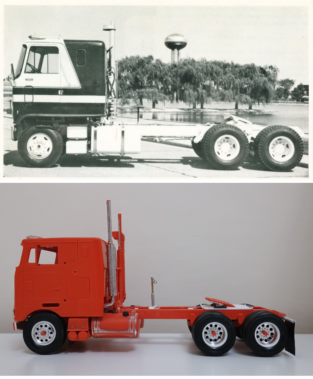

Rockford Posted December 10, 2024 Author Posted December 10, 2024 Saw this in a back issue if Overdrive, December 1969 I think, on the release of the Astro 95, they were quite complementary about it, especially in comparison to the Crackerbox it replaced. It just caught my eye as being the right chassis length. 3
Blue Monday Posted December 10, 2024 Posted December 10, 2024 That looks like a long chassis but it is not too long! Looks like you have found your inspiration for your build! BM. 1
Rockford Posted December 10, 2024 Author Posted December 10, 2024 (edited) You're right, it is just the right amount of 'long'. Love it. Hard to believe that design hit the road in 1969. Great looking truck. Must have had an unconscious image of this truck in my mind's eye when I set the 352 up. Just wish it was an Astro in 1/32 Edited December 10, 2024 by Rockford Added pics 4

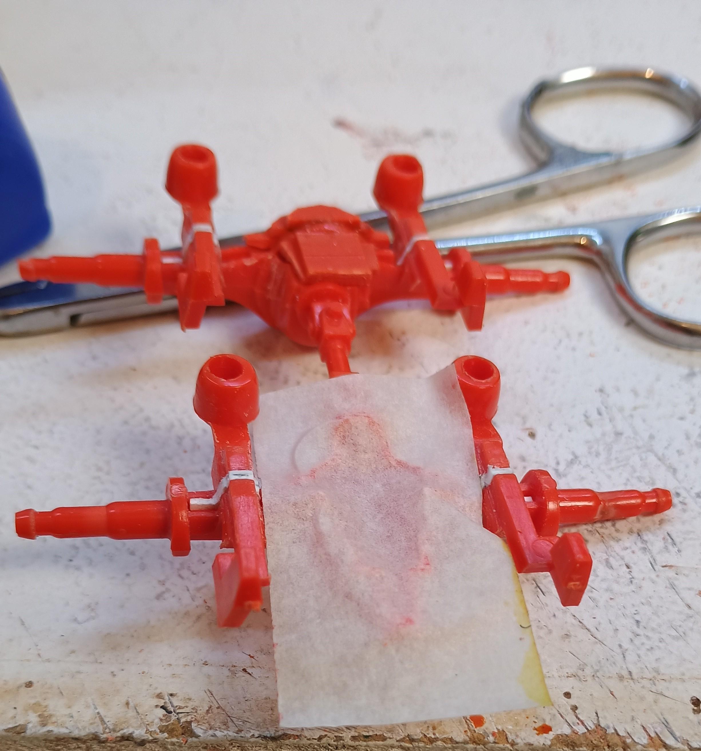

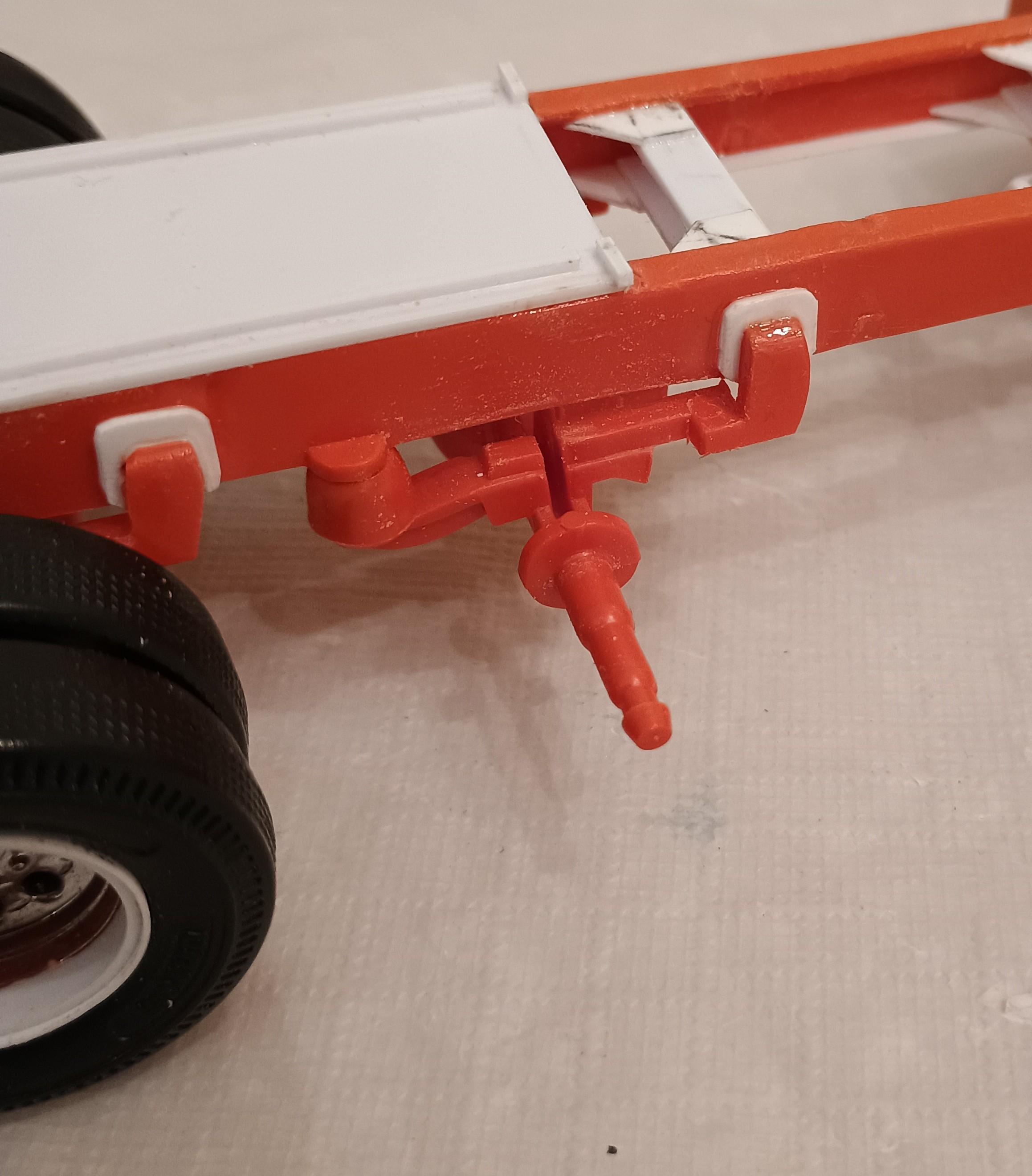

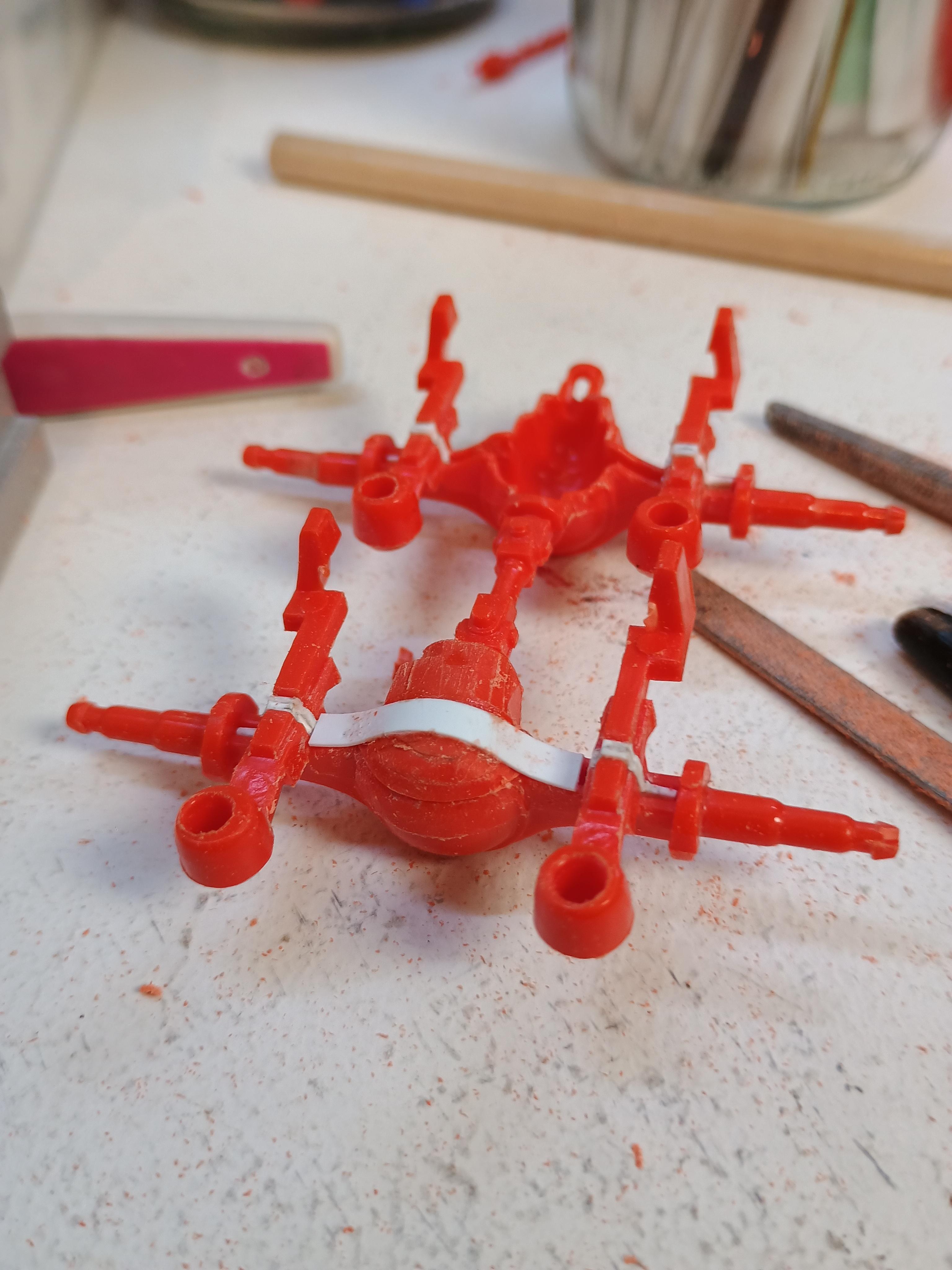

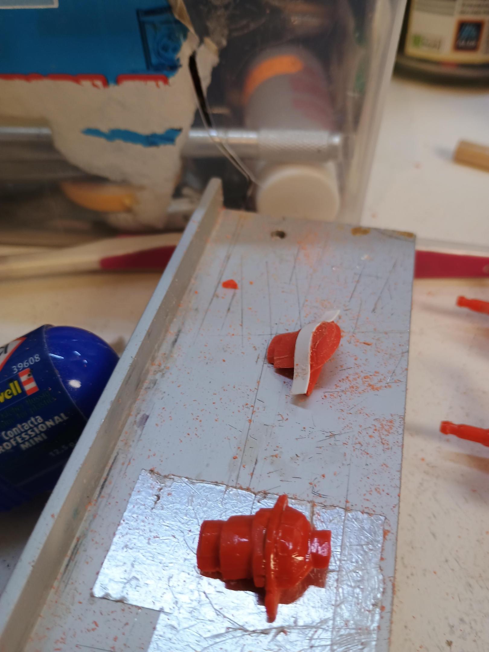

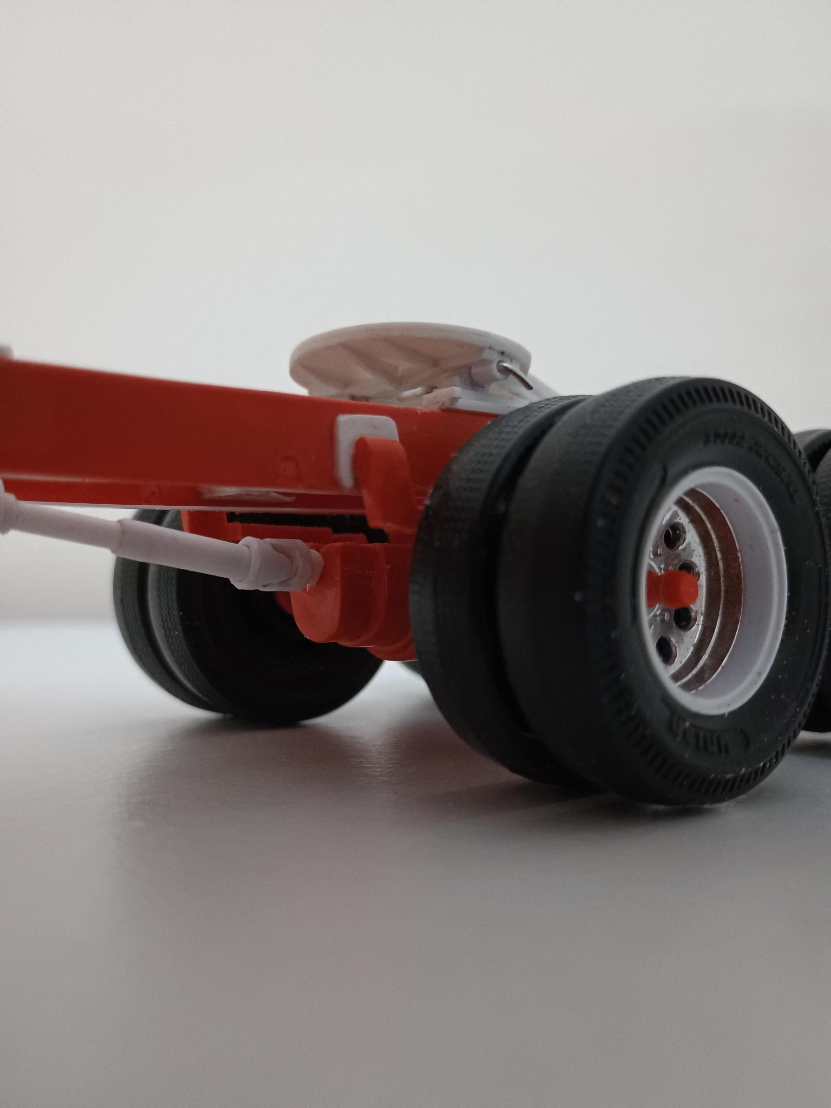

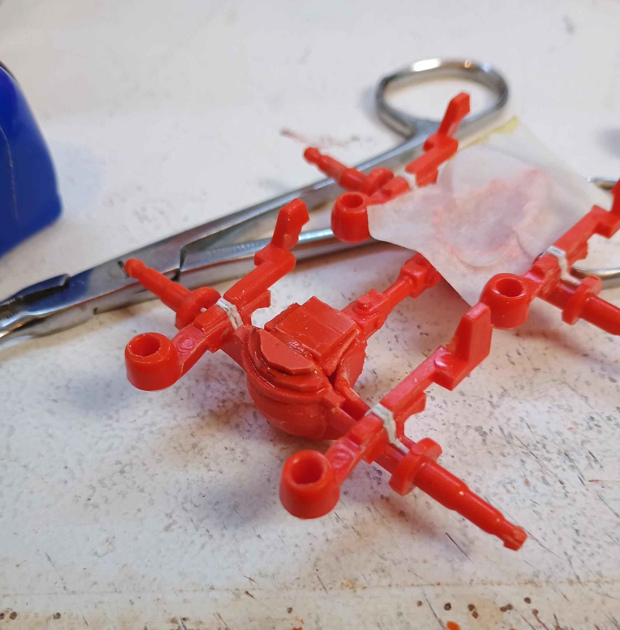

Rockford Posted December 15, 2024 Author Posted December 15, 2024 The rears were glued on and I decided against cutting them off. I retrieved the time warp 352 I bought that had been built and put straight back in the box 40 years ago. I unsnapped the rears from that and built the diffs using the offcuts from the cab when I shortened it. I started by using masking tape to generate a template. Has to be careful not to glue them into the axles by mistake. Once built up I shaped them, added a strip of 2.5mm across the top to replicate the axle tube and coated it all with liquid cement. I also built little fillets to drop into the gap in the trailing arms. Dropped them into place on this truck. They look ok for me. Thanks for your very kind comments lads, I'm really flattered when I look at the work being done by others in this forum. I'm stuck with 1/32 for some reason but remember that it's me being odd that does this, others have a totally different and more sensible approach to these than me. 5

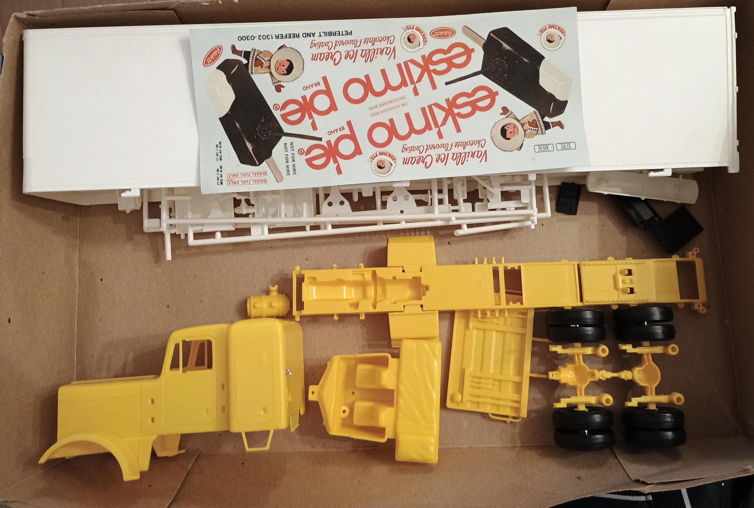

Rockford Posted December 19, 2024 Author Posted December 19, 2024 SQUIRREL!!!! 🐿️ Look what I fell over on eBay! Got it for 12.50 Euros from France. It's as complete as I need, trailer is all there and the essentials of the tractor except someone has done a number on the front bumper, the stacks, headlight units and quarter fenders. They're actually bent and snapped, odd. Nothing that can't be sorted. Someone was asking £99 just for the Pete on its own so I didn't do bad getting both. Just shows you, they're still around. 3
Biggu Posted December 19, 2024 Posted December 19, 2024 Good catch , Steve, although the front end looks like it hit a Moose, at speed ...
