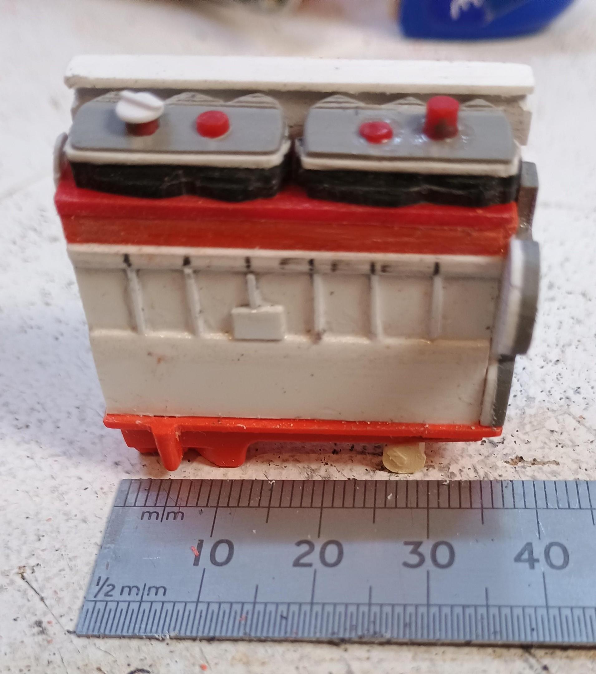

Rockford Posted January 5 Author Posted January 5 (edited) Haven't had the time I usually get this weekend so didn't get very far. Used scraps and sprue to make the rocker covers, breather and oil filler cap. Then took about 4 attempts to shape the rocker boxes underneath them. They are a nightmare of conflicting angles. I found success by gluing the two together and filing the basic profile, then separating them and filing a taper into them at 90°. It's not factree but close enough. The ruler shows the size I'm working with. Next I'll do the top of the intercooler then start dressing the block. Edited January 5 by Rockford Added more waffle. 7
Jürgen M. Posted January 7 Posted January 7 Steve, that engine looks cool! Really nice job and an asset to your build! 👍 1
The Brush Posted January 7 Posted January 7 Hi, Looking good plenty of detail & nice work on the engine. Well worth the effort. 1 1
Old Buckaroo Posted January 7 Posted January 7 I like the engine - it looks great magnified by the pictures which sometimes doesn't work to a persons favor. I'm also partial to items made from bits and whatever, to me "That is Model building"!! 2 1
Pete68 Posted January 7 Posted January 7 Nice looking rendition of a Cat Steve especially when you have little to work from. Great work on the small details too. 1 1

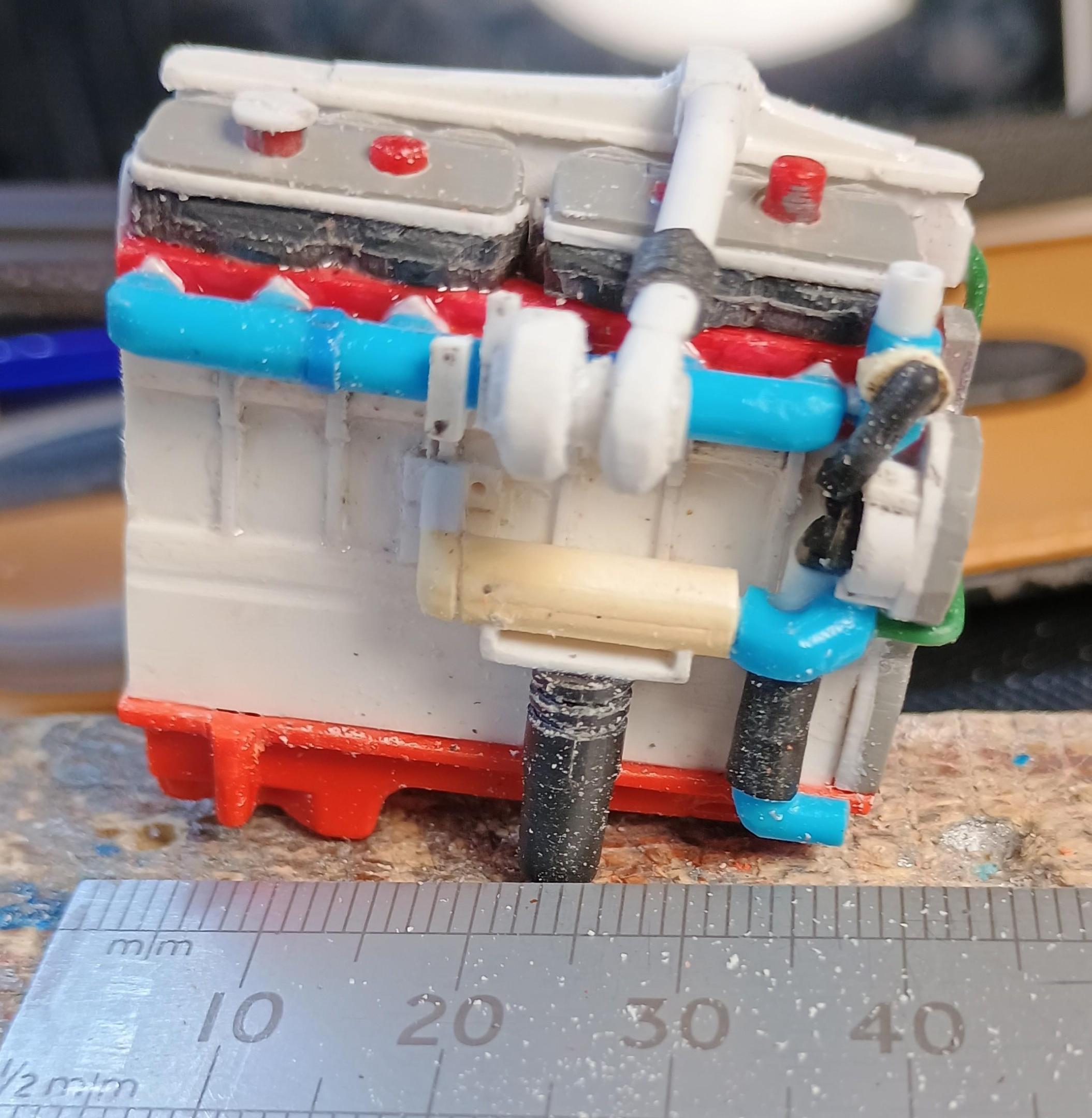

Rockford Posted January 11 Author Posted January 11 Carried on with the engine today. Made a simple log exhaust manifold and added the ports from more of the same. Added flanges cut in 1mm slices from 3.2mm square rod. Also fitted the flange for the turbo. Double wrapped 1mm electrical tape around twice to form the joints in the manifold. Looking at photos of the 3406 manifold there's some brackets cast in so added them too. I might try drilling the unused holes in the brackets should I feel adventurous. Also fabbed a thermostat housing and top hose fitting. Looks ok. Slow going but it's great therapy. The water pump is lying next to the engine. That and the oil cooler will finish this side. 5

Rockford Posted January 12 Author Posted January 12 Got a bit done today, built the waterpump and added the lower radiator hose, also the pipe u to the thermostat. Then the oil cooler and the oil filter and housing. Made an intercooler coolant pipe across the timing cover. Finished the top of the intercooler and fitted a turbo and charge air pipe. It's very hard to get the dimensions right when you're shrinking things to such small sizes, especially when your only real reference is 'for sale' photos. One side done! 4
Old Buckaroo Posted January 12 Posted January 12 Steve I love this engine , I'm such a fan of actual scratch built items. If you begin to question your sanity watch this video, especially around the 13:00 minute timestamp. Enjoy! 3
BK9300 Posted January 12 Posted January 12 Terrific progress on your engine, Steve - all 4 cm worth - amazing work! 1 1
