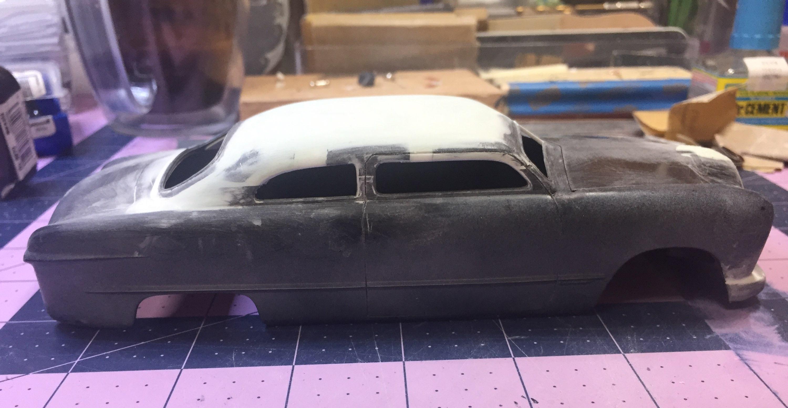

Here's where I'm at so far. The roof was filled in with pieces from a '53 Ford roof, a discard from a previous roof swap, and some scraps. Bondo two part glazing putty followed several times, building up the low spots and getting ready for a quick dusting of primer to see what I need to do next. With Bondo, (and I know there are plenty of you who reject this) you can mix it, slap it on, give it 5 minutes to firm up, shape it with some 220 grit as it is hardening and mix another batch, rinse, repeat and be ready for primer in an hour. Individual results may vary.

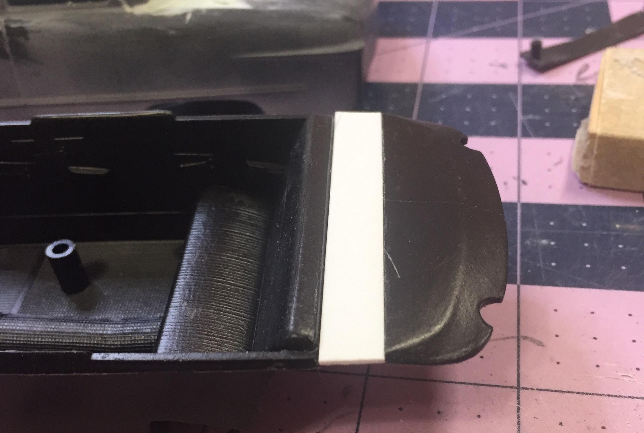

Then the package shelf had to be extended using some Evergreen sheet.

Enjoying watching your plastic surgery here. Your process on the roof is much like the way many 1:1 cars are done. Looking at the windshield opening you now know where the "mail slot" description comes from.

Dave, I may have chopped it a smidgen too much. I thought the .25 inch cut was, give or take, 4" in 1:1 land. Actually, it's close to 6".  But hey, I want it to look like it was done by a punk hot-rodder back around 1960. If it ends up looking decent in black primer, I may leave it that way.

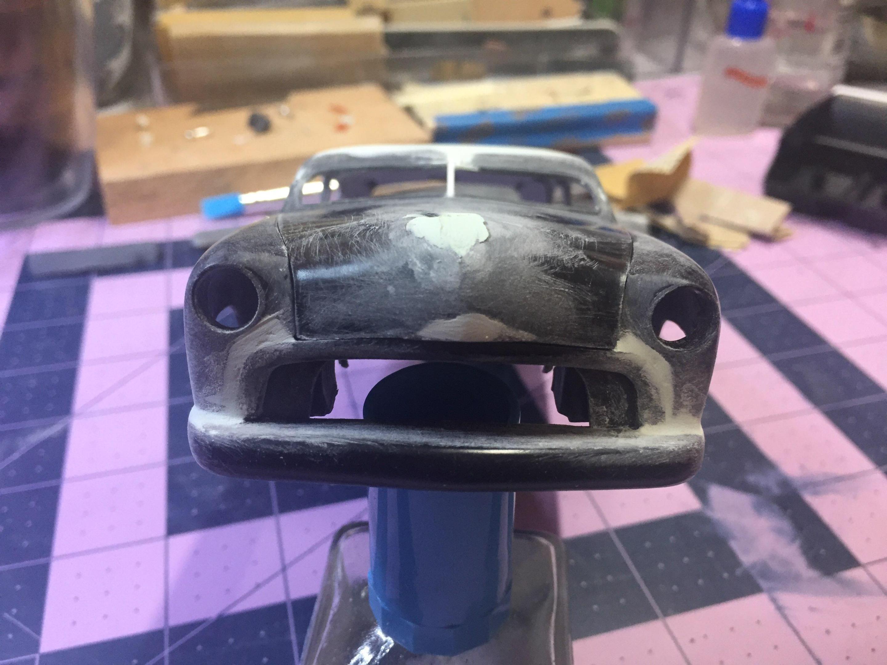

  I added the front facia and the rear panel tonight and cleaned up the window openings some.  The optional kit hood had a twist and wouldn't sit right plus the front right corner featured the mold defect common to both shoebox Ford kits. I played with it but ended up using the stock hood, which I shaved and filled. The grille candidates are the big toothy '53 De Soto grille, the minimalist '55 Plymouth, and the kit's '54 or '55 De Soto grille. There are others but I think a stock Merc unit would be great if I can find one. I need to find wheels and tires that will allow radical lowering (the front inner fenders won't play well with the wide tires in the box.)  IMG_6978.thumb.jpg.8af74f9331613f08aa82fe4ee443f336.jpgIMG_6976.jpg.b845541fffac0a2826cafed64a0ae9d5.jpgIMG_6975.jpg.ea7295a662c2e15b8c01b40926f2b3da.jpgIMG_6979.thumb.jpg.9d86ebc47705322de43d982093a3d93d.jpgIMG_6974.jpg.79613217ad8b7d694c505516b4c146fc.jpg

Remember seeing pictures of these and other cars with tops chopped just this low many years ago, so you're right in line with what they did. There used to be a filler park in the kit for the hood, and that maybe what you did. The grill shell looks like a smooth transition into the fenders. Are you going to use the rear roll panel with the license plate relief in it? For lowering the front end, maybe cut out the inner fenders and use the old pill bottle trick to tub it like you would a rear end. The flat black look would look good on this.

The kit supplied custom grille shell was a poor fit, as is most everything in this kit. The hoods are both slightly warped or the whole body is. I had to add some styrene to the top of the grille shell to get the hood to align better (its still not right).
  The rear panel's plate recess was filled and the plate recess is now in the trunk lid.  Since the tail lights will be stock units, I felt I should do something custom back there.

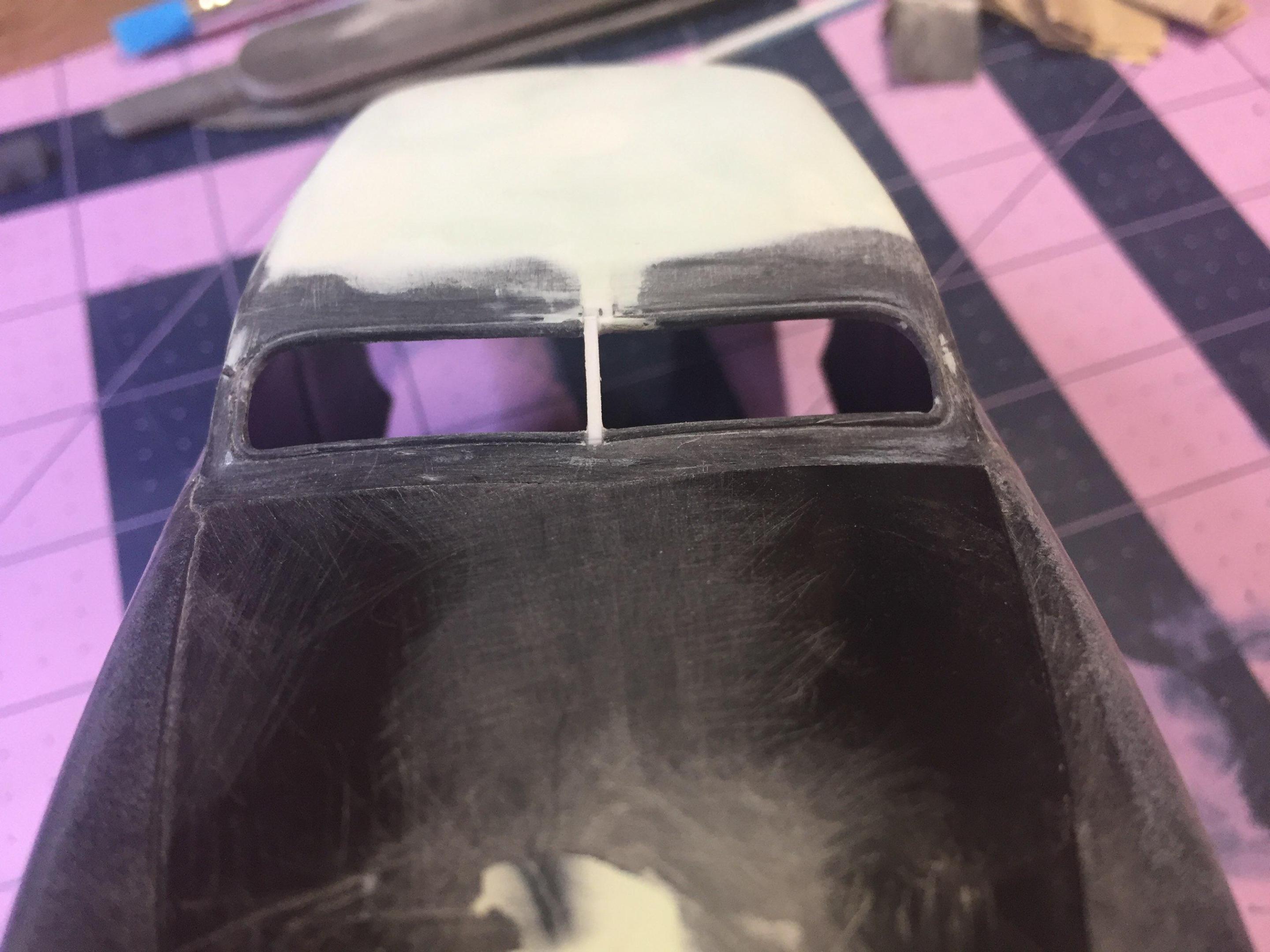

Chopping anything is not easy and wow there was a lot of cutting on this one!!! She is looking good but may I play devils advocate?
The roof is too flat from side to side, you lost some of the windshield shape in the center. I think the rear quarter windows need more taper to them. Now, these are my opinions and opinions only. I have seen things in the past I thought were off but finished nicely.

Yup. That's how it looks to me too. The idea was to make this coupe look like a tudor but I chopped it a bit too much. If I ever get my hands on another one of these, I'll use narrower tape. I think if I did a mild chop, I could maybe lean the pillars out and avoid the longitudinal cuts. Maybe. I thought about adding more material to the roof but there is a thing they did way back called "pancaking."   I could say "well, it's pancaked!"  But y'all are too smart for that ☺️ (although the idea has merit.)  After I get some primer on it I'll see how bad it looks and maybe try some stuff. I dunno. It's an experiment and a sort of proof of concept, moving the backlight to the rear. I much prefer the look of the chopped tudor over the chopped coupe. I wanted more of a Merc look. I appreciate your observations, Andy, they are spot-on.

I can't (or won't) fix the windshield but I am going to add a bit more to the flat spot. With Bondo, all things are possible.

Maybe after adding bondo maybe reshape the windshield opening and use some half round evergreen to replicate the windshield trim?
If you try it again maybe get a donor '49 Merc for the longer roof to start with and incorporate the Ford rear window?
I am glad you did not take offense to my observations.  I'll be watching.

I'm not happy about the prospect of reshaping the windshield and, honestly, I kinda like the look. I do think a bit more crown on the roof might look a little better.  The reason the windshield looks that way is because I didn't quite get the roof back together right which tells me another method needs to be learned or found.  The Merc roof idea is probably worth exploring and if I had a Mercury to sacrifice, we might not be having this conversation. I suspect the Merc roof is a bit wider as well as longer and would not need to be widened at all. I'll let someone else find out about that.
Andy, I'm cool with any and all comments, criticism, questions and advice and I appreciate your ideas. They are good ones.  I'll get some primer on it and re-evaluate the windshield  situation.
