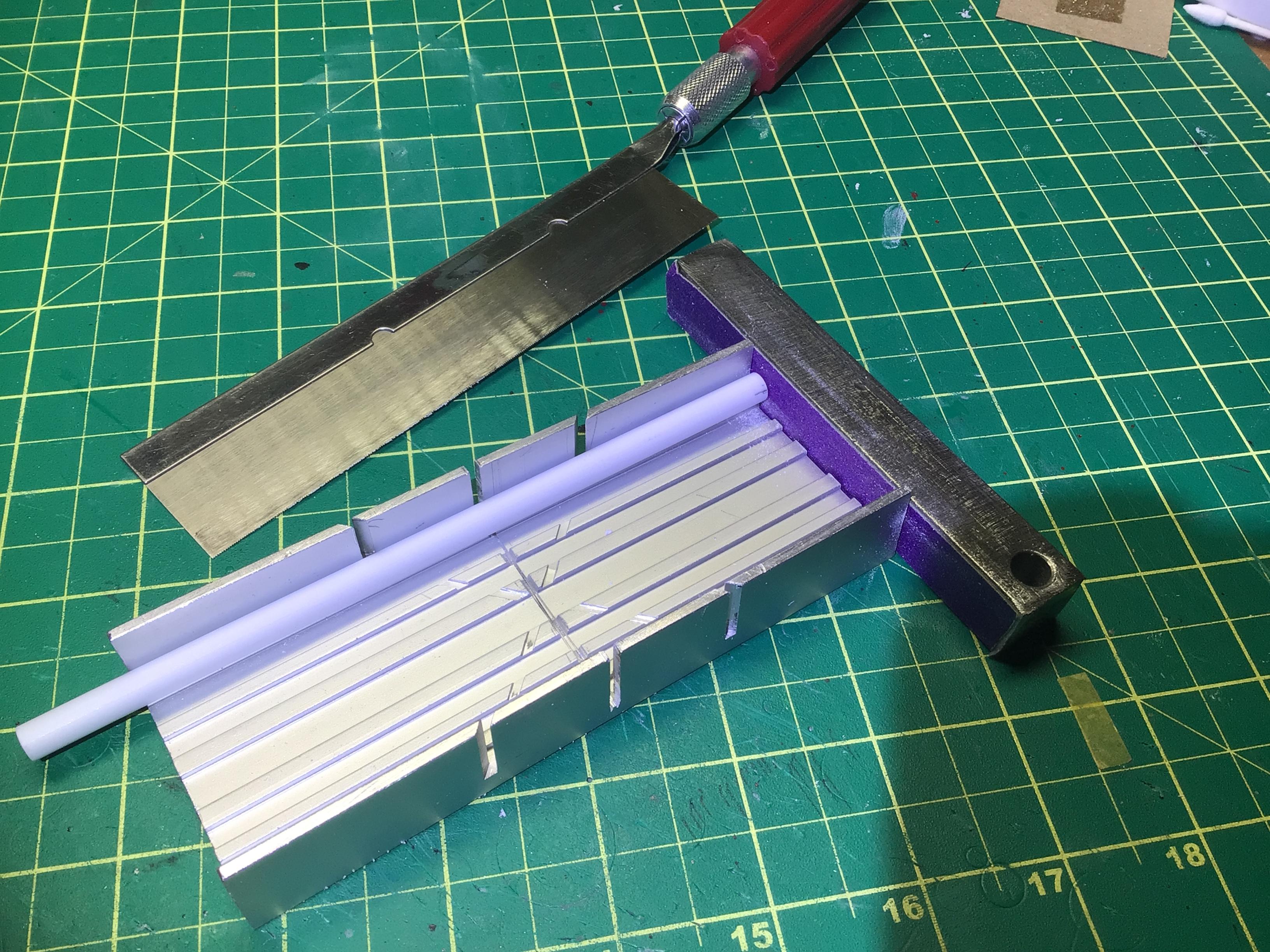

NOBLNG Posted November 14, 2024 Posted November 14, 2024 I have a cheap aluminum mitre box. The slot is a LOT wider than my razor saw, so I have to hold the blade against one side with my finger while cutting in order to get a decent cut. Even then, I use a piece of square bar with sandpaper attached, against the end of the mitre box, to square up any cuts that need to be perfect. 1

R. Thorne Posted November 15, 2024 Posted November 15, 2024 10 hours ago, NOBLNG said: I have a cheap aluminum mitre box. The slot is a LOT wider than my razor saw, so I have to hold the blade against one side with my finger while cutting in order to get a decent cut. Even then, I use a piece of square bar with sandpaper attached, against the end of the mitre box, to square up any cuts that need to be perfect. You might consider one of the thin slot miter boxes. This one comes with a saw. 1

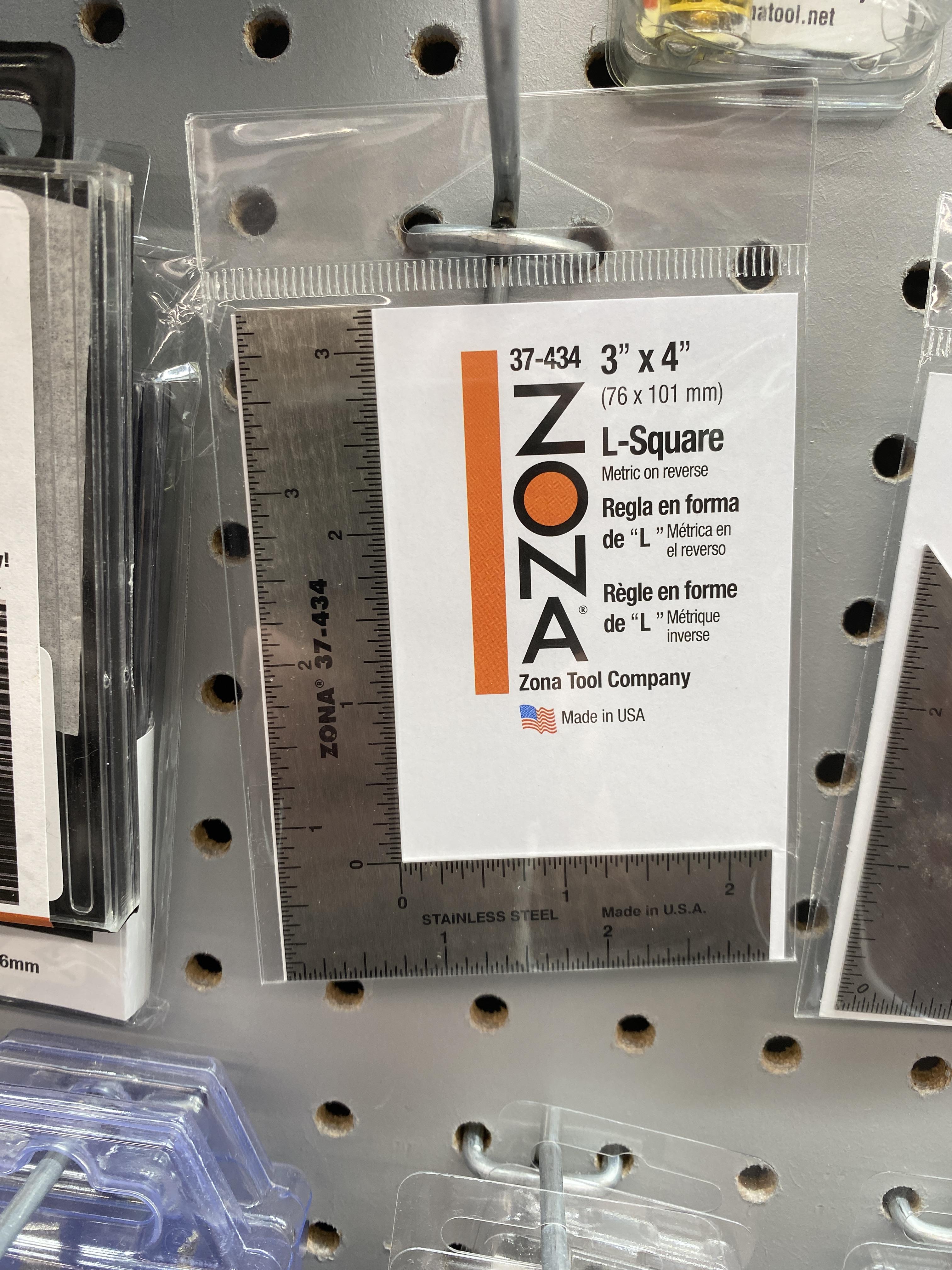

Bugatti Fan Posted November 19, 2024 Posted November 19, 2024 Paul, is that Xacto flat square of hours a current item? it does not appear on the Xacto website.
PHPaul Posted November 20, 2024 Author Posted November 20, 2024 On 11/19/2024 at 3:47 PM, Bugatti Fan said: Paul, is that Xacto flat square of hours a current item? it does not appear on the Xacto website. I've had it quite a long time, possibly since the 1980's when I got into HO model railroading. I'll look around and see what I can find on it.
PHPaul Posted November 20, 2024 Author Posted November 20, 2024 I looked it up under the X-Acto part number 7726 and found a couple of on-line sources for it, including Amazon.
Bugatti Fan Posted November 21, 2024 Posted November 21, 2024 Thanks for coming back on the Ex-Acto square Paul, and for looking out the part number and possible sources for me. The part number will be of great help. I managed to find a couple of flat squares over here on a UK tool supplier's website, but they did not have any measurement scales etched on them like your Ex-Acto square has. I'll be able to do some more proactive searches now with the information you have kindly shared with me. Thanks again for taking the time to look out the information for me. Kind regards Noel
PHPaul Posted November 21, 2024 Author Posted November 21, 2024 You're welcome Noel, glad I could help.
Bainford Posted December 3, 2024 Posted December 3, 2024 On 11/19/2024 at 4:47 PM, Bugatti Fan said: Paul, is that Xacto flat square of hours a current item? it does not appear on the Xacto website. Saw this today at the hobby shop, if it's any help. 1
Bugatti Fan Posted December 3, 2024 Posted December 3, 2024 Thanks for the heads up Trevor. I will have to look and see if the Zona one available from someone in the UK. 1
