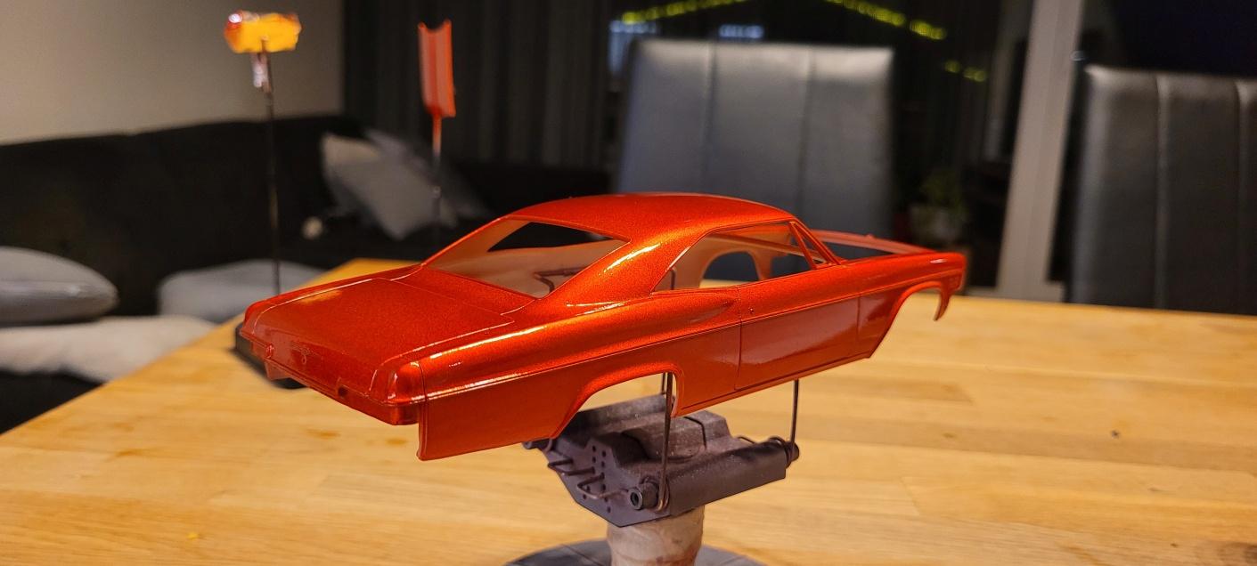

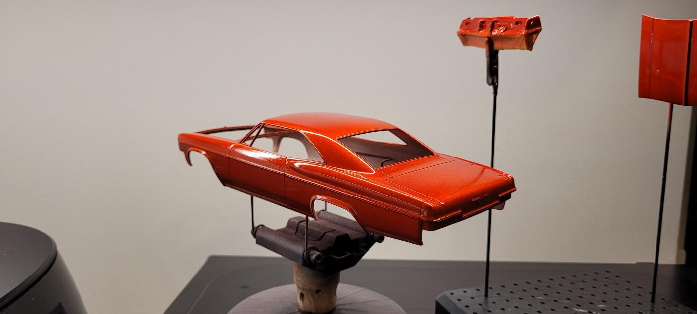

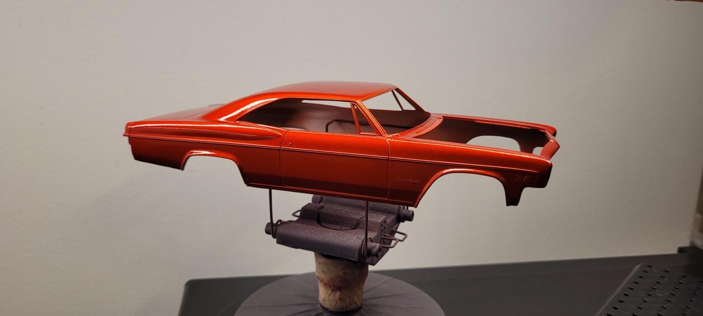

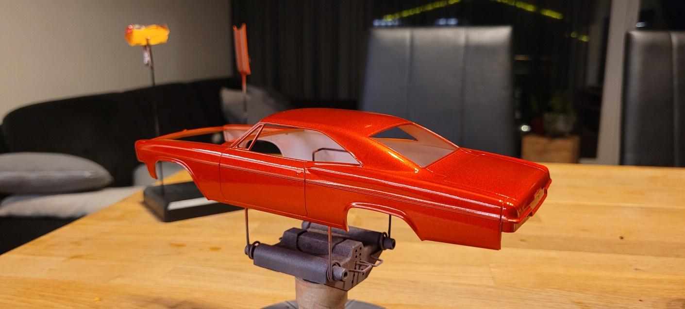

deuces wild Posted November 15, 2024 Posted November 15, 2024 (edited) I saved these 4 pictures from a modeler on here... A BIG thanks for posting these on his build thread...??... I believe he used a metallic silver for a base coat... Edited November 15, 2024 by deuces wild
