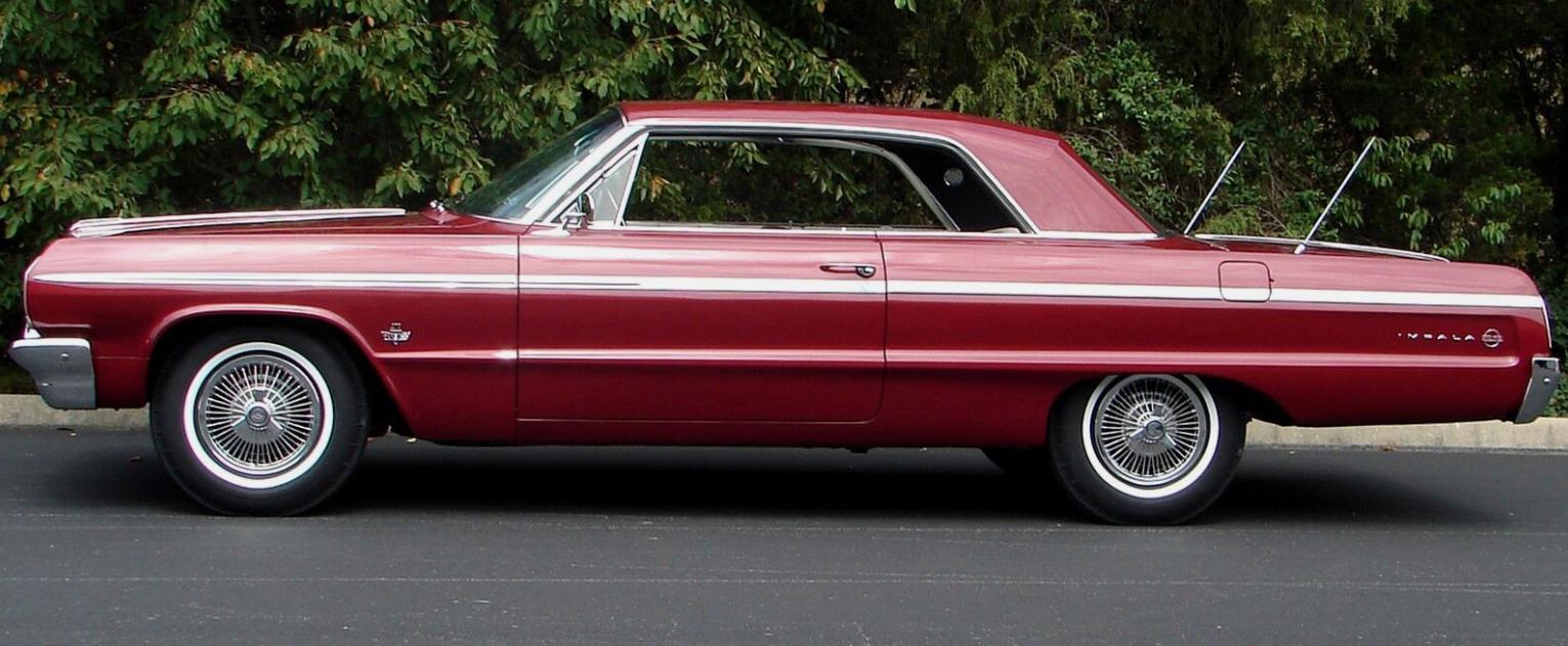

64SS350 Posted November 13, 2024 Posted November 13, 2024 The Revell kit is more detailed, I believe separate frame, opening trunk, etc. It is also an Impala SS, which means chrome and badge removal/change. Also the rooflines are different between an Impala and the Bel-Air, and usually only 4 rear lights/lenses vs 6 on the Impala. These are the major visible differences, not including drivetrain, motor, interior ,and other available options. There are resins out there with I believe two or four door options.

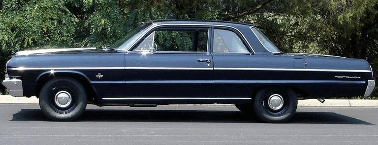

W-409 Posted November 13, 2024 Posted November 13, 2024 (edited) Like mentioned above, Bel Air was not available as a Hardtop, which is the body style that all of the Impala kits represent. The small trim changes etc and tail light removal is quite simple and easy to do on an Impala body, but converting the roofline from a Hardtop to Sedan is a lot of work, so that's where the resin body becomes a good idea. I'm sure there are probably several resin manufacturers that offer a Bel Air bodies in either two or four door version. I'm pretty sure at least Model Car World should have those things available and from what I've understood their quality is usually pretty good. One thing to consider with the resin body, is to find out what kit they used as a master for the casting, meaning, which model kit the resin body fits together with. In the case of a '64 Chevy, I'm thinking the resin body will probably fit either the Revell kit or an AMT kit, but probably not both. In addition to the body, some interior parts will also need to be modified for a lower trim level if you're looking for a factory stock approach, and possible some other small modifications need to be done as well. I've built the Revell Impala years ago, it's a really nice kit! I don't remember having any major fit issues or other problems with that kit. Edited November 13, 2024 by W-409

Rob Hall Posted November 13, 2024 Posted November 13, 2024 MCW used to offer a resin ‘64 Biscayne 2dr sedan, I have one, it’s pretty nice. I don’t know of any currently available.

Rob Hall Posted November 13, 2024 Posted November 13, 2024 7 minutes ago, Casson16 said: Awesome. Do you have any pictures of your build? And, which chassis and interior did you use for it? I’m assuming the Biscayne is closer to the Belair for the roof line? Yeah, same roofline..the Biscayne is just more stripped down. I think it is made to work with the Revell '64 Impala. I never built it, need to find it..it's somewhere in my stash.
