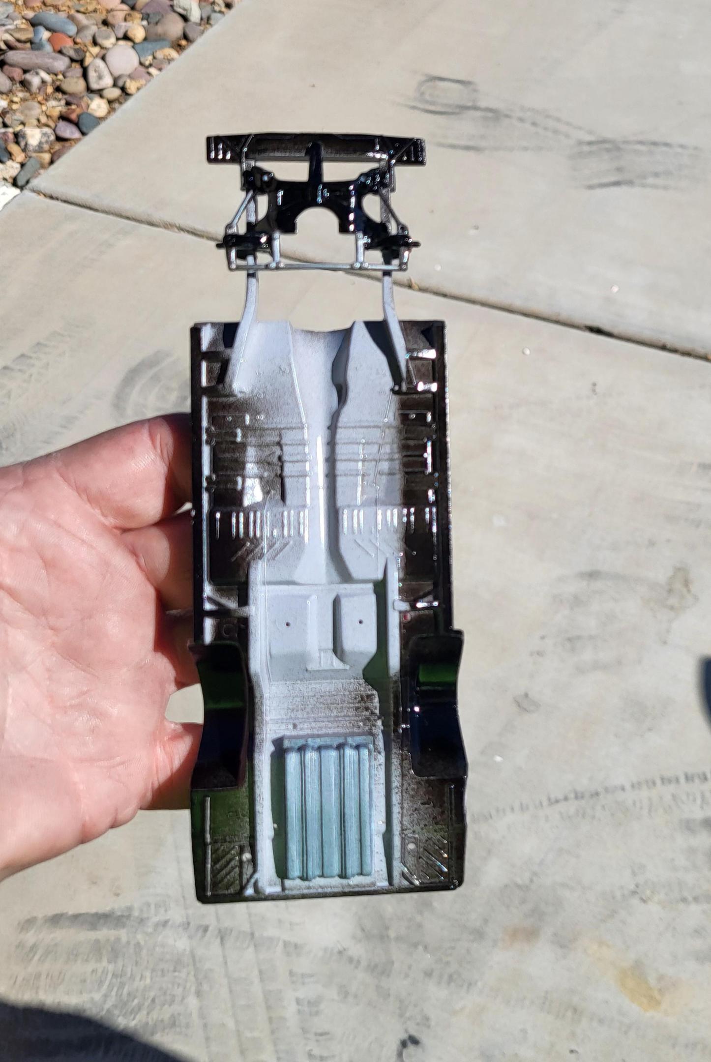

LennyB Posted November 19, 2024 Author Posted November 19, 2024 Thanks guys for all your input, guess I'm just having a run of bad luck. Just went through my collection or spray cans and I see they are all made by Rustoleum. Maybe Rustoleum is the culprit. Thought I had some Krylon but I did throw some away a while back. This is an example of the problems I've had. The interior tub below was sprayed with Flat Black. The inside was sprayed first and that came out fine. Flipped it over when dry and the outside came out shinny. Same can of paint sprayed on the same surface with no more then an hour in between. So the weather couldn't have changed all that much from one side to the other. And I'm spraying inside in a paint booth. This was maybe a week ago. I just now took the same can and sprayed a hood and it came out flat. Another thing I've observed is you always took a can of spray paint when you were done and turned it upside down and sprayed to clear the nozzle. If you turn these over they continue to spray paint. So I find the nozzles clog regularly. I can't wait until the Tamiya order gets here.
