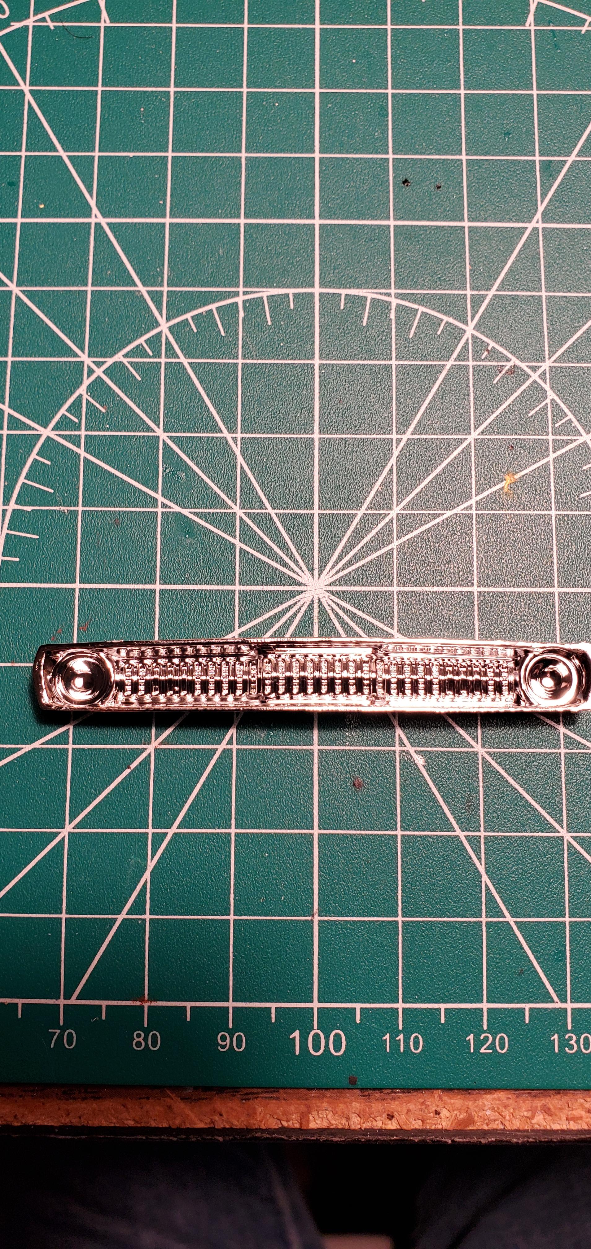

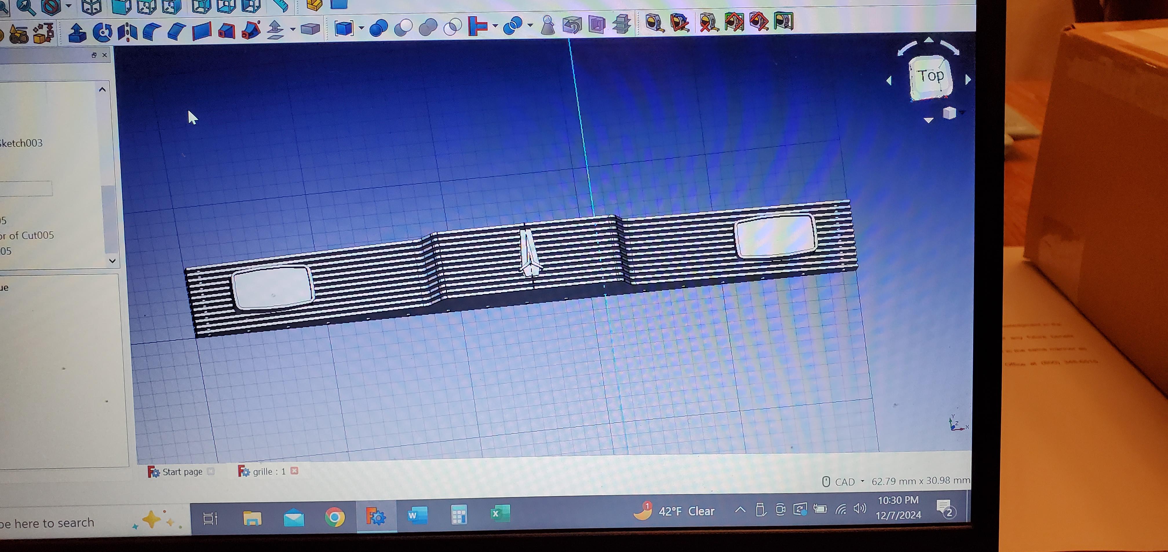

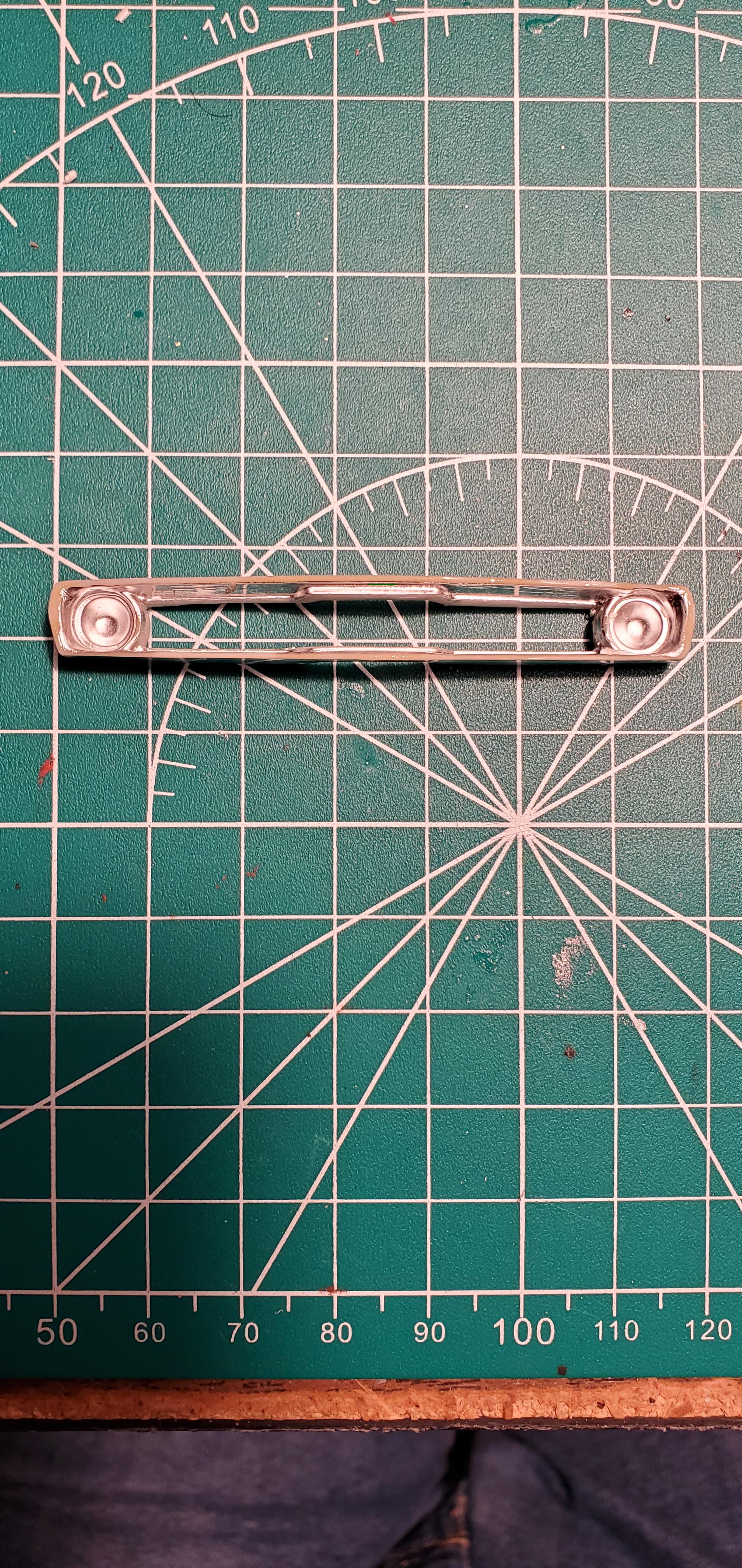

Steamboat Posted December 8, 2024 Author Posted December 8, 2024 One of the first things to address is the grille. The AMT kit uses the "shark tooth" grille, which was only used on the 1971 and 1972 Duster when equipped with the 340. All other 70-72 models had the base grille. Here is the 340 grille that comes in the kit. I carefully removed the center section which will be replaced with a 3d printed grille. Here's the 3d drawing in the final stages of editing. I should have a good print soon. 2

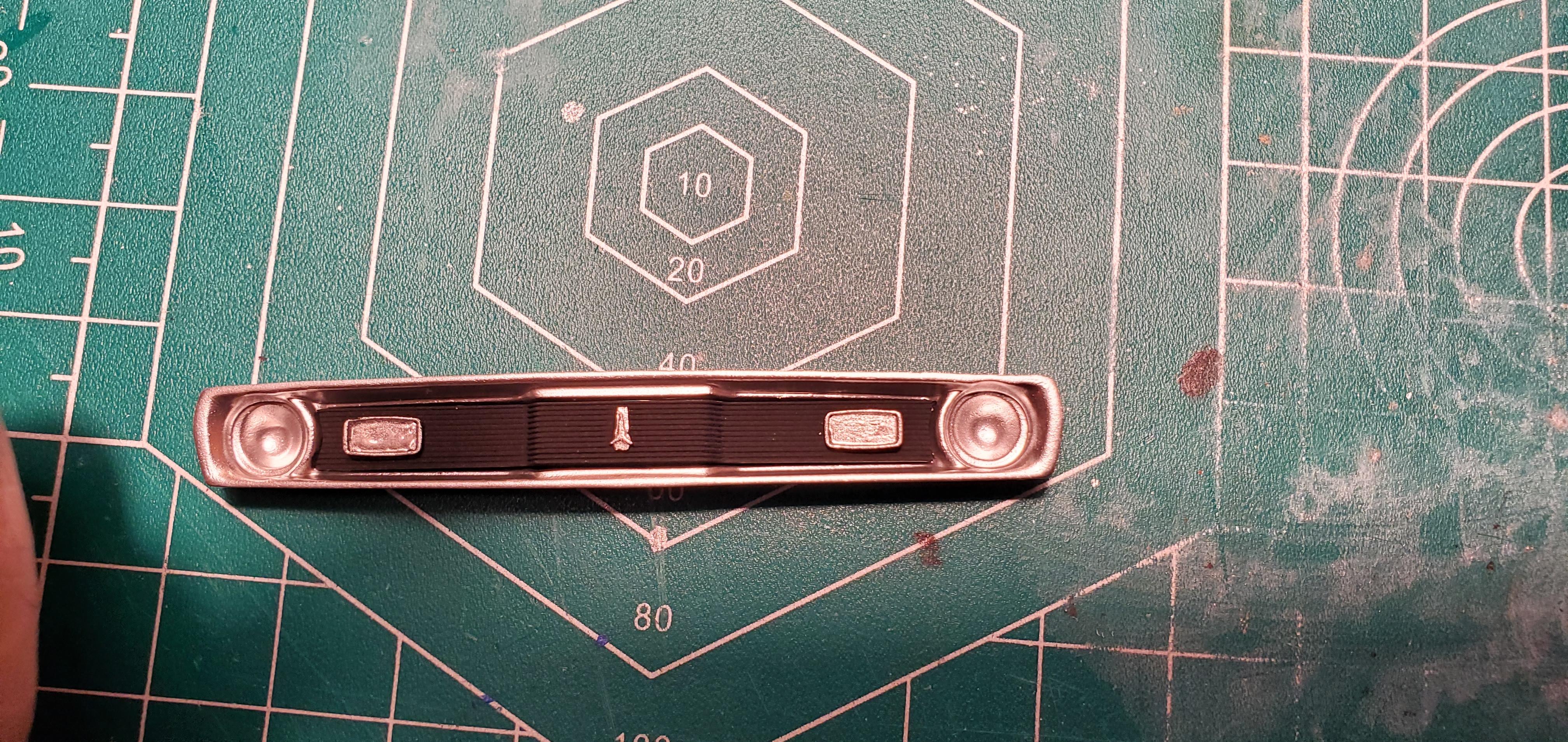

Steamboat Posted December 18, 2024 Author Posted December 18, 2024 Completed grille. I just need to add the headlights. 1

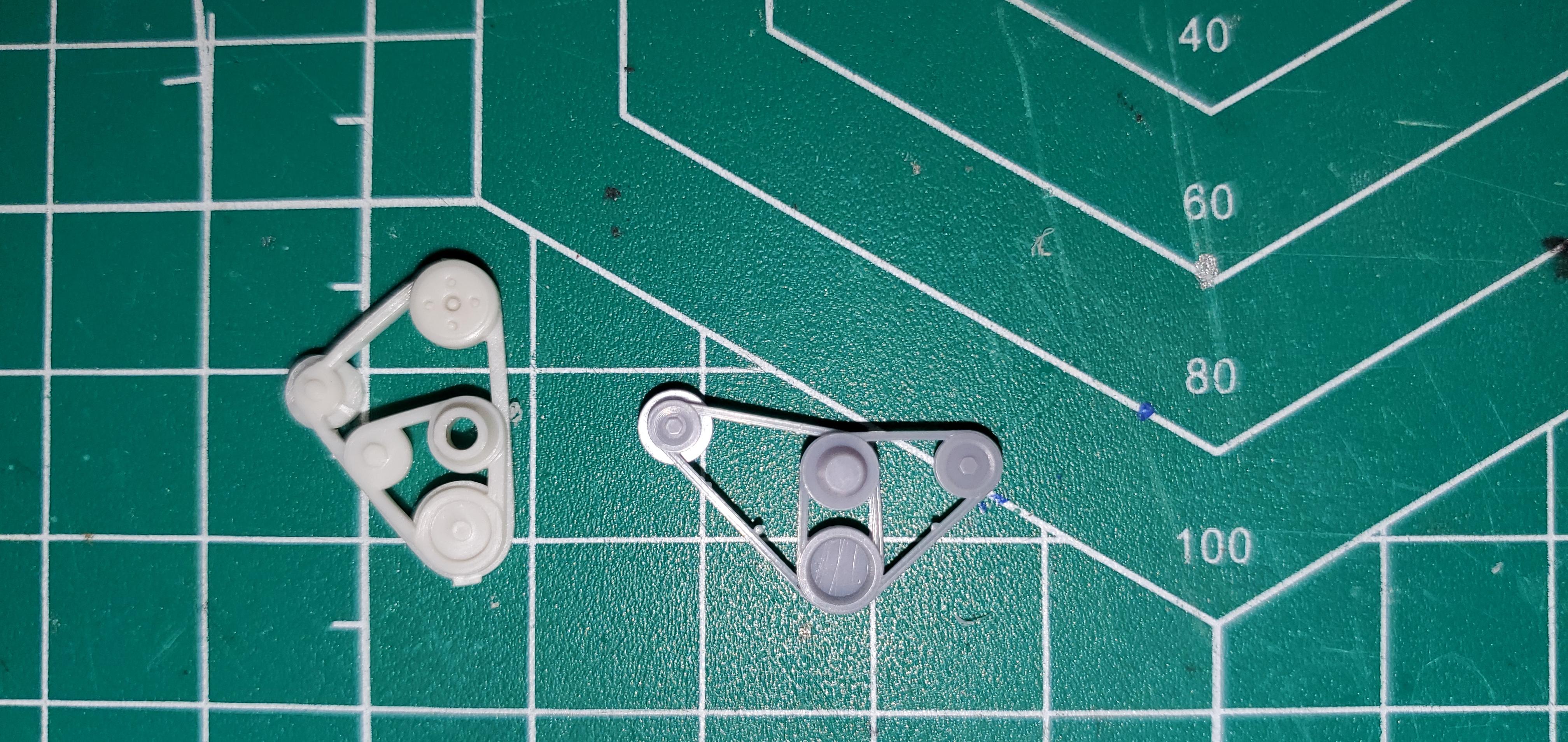

Steamboat Posted December 18, 2024 Author Posted December 18, 2024 I've been working on the belts and pulleys. The 1:1 car is a small block with power steering but no AC. The AMT kit has AC but no power steering. I made up a belt and pulley setup that puts the alternator and power steering pump in semi-correct locations. 3d printing allows you to make very realistic belts, much smaller than can be done with injection molding. Also the 1:1 car has an electric fan, so I eliminated the mounting hole for the fan. The AMT belt set is on the left, my 3d printed set is on the right. 1

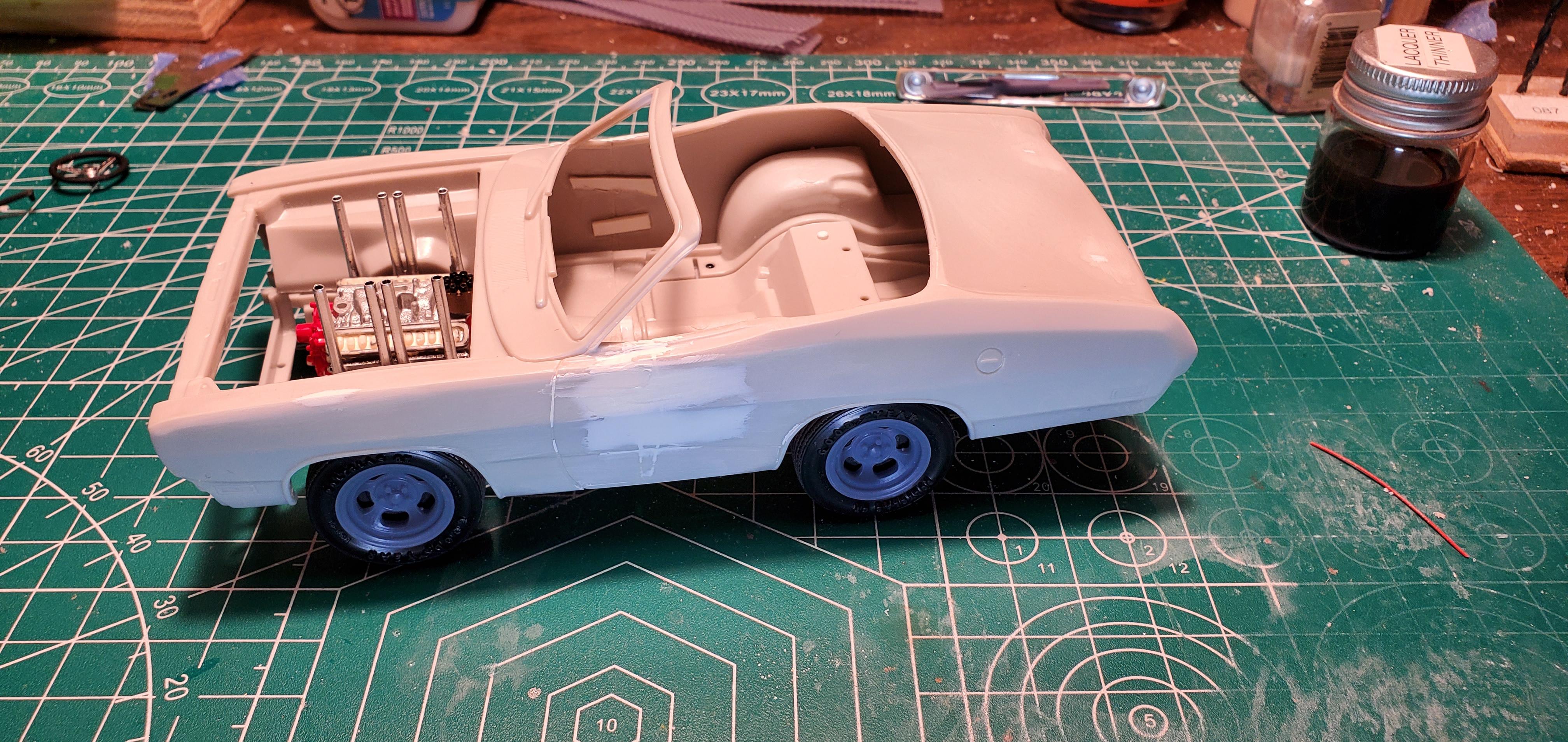

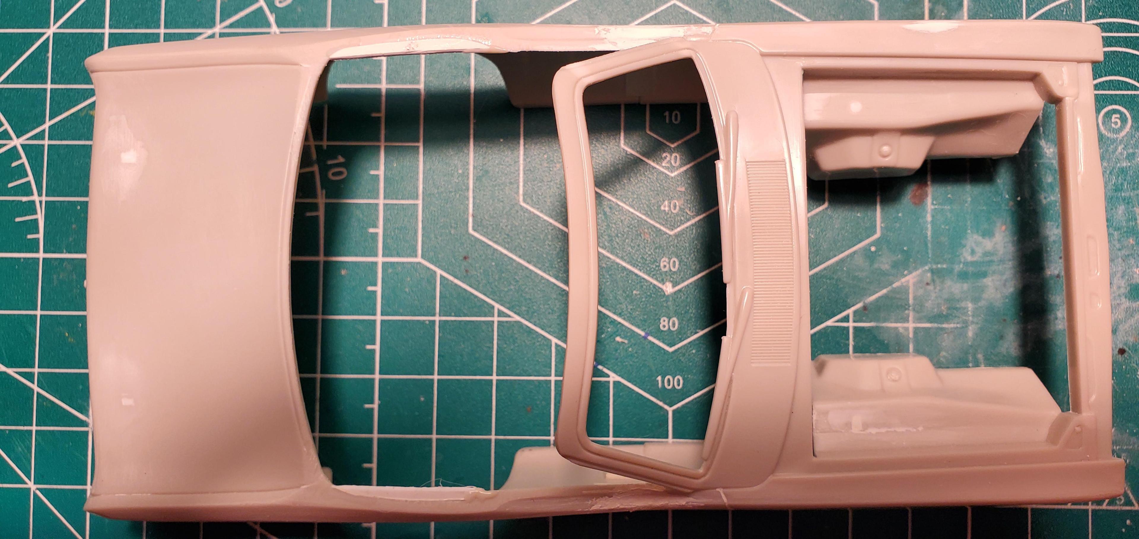

Steamboat Posted December 20, 2024 Author Posted December 20, 2024 The body needed a thin strip of styrene on each side where the c-pillars were cut away. In addition, the holes for attaching the wing and for attaching details on the inner fenders were filled.
