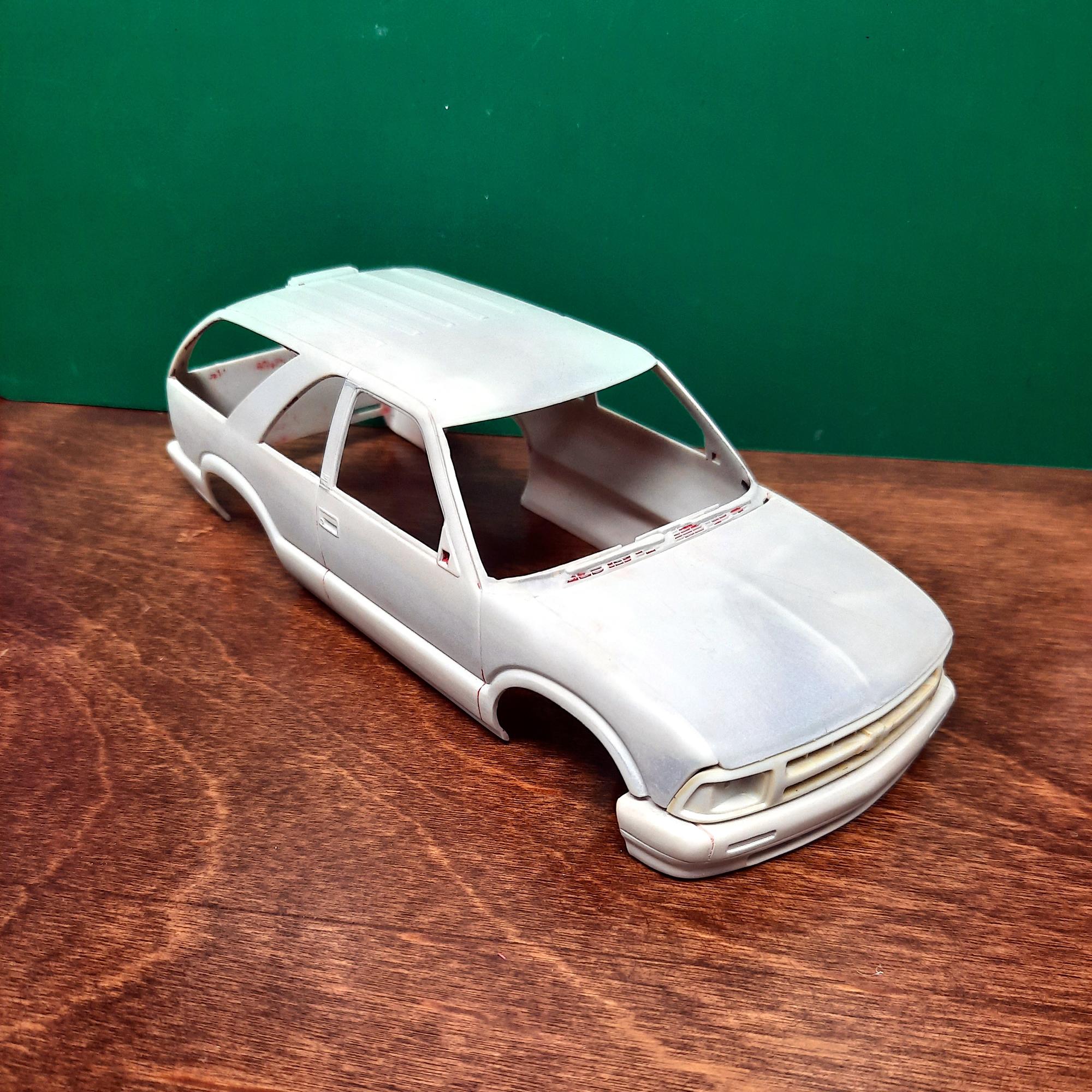

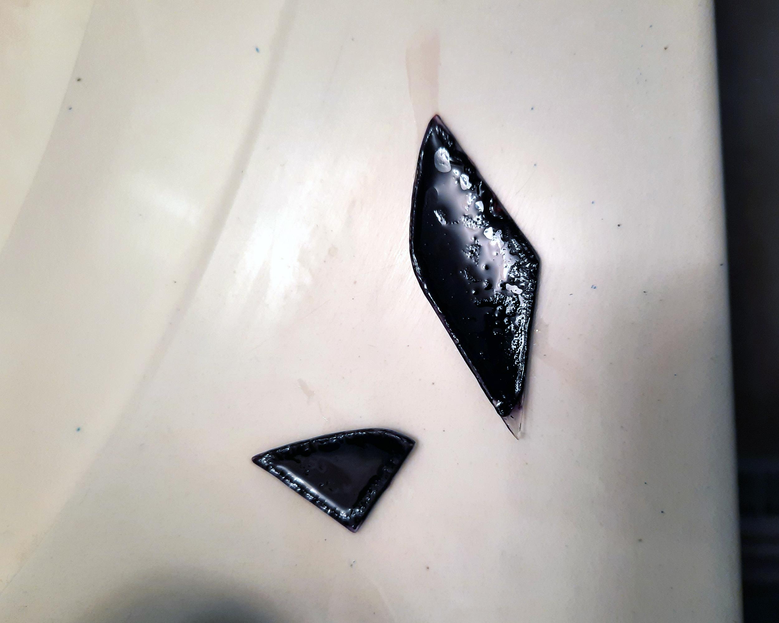

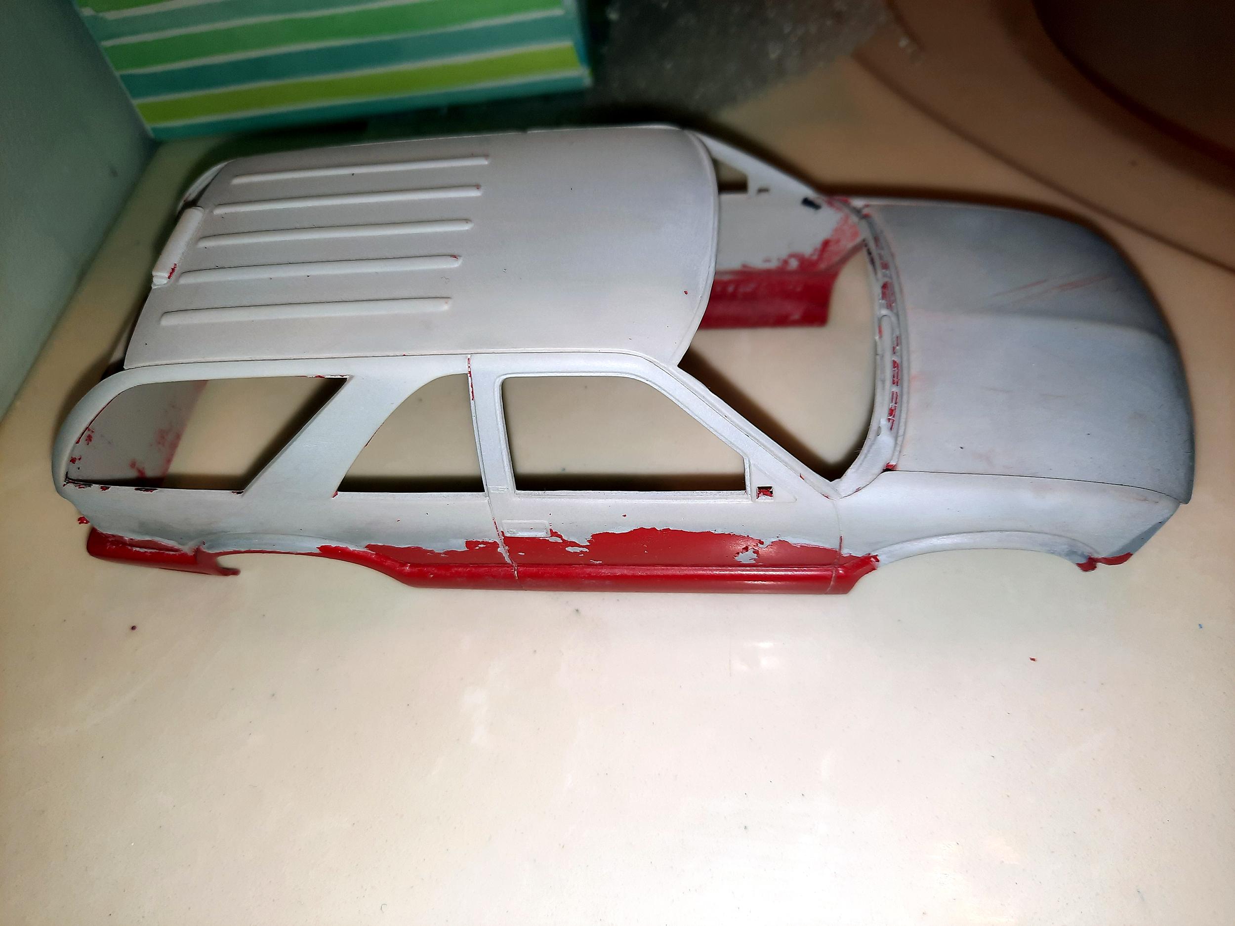

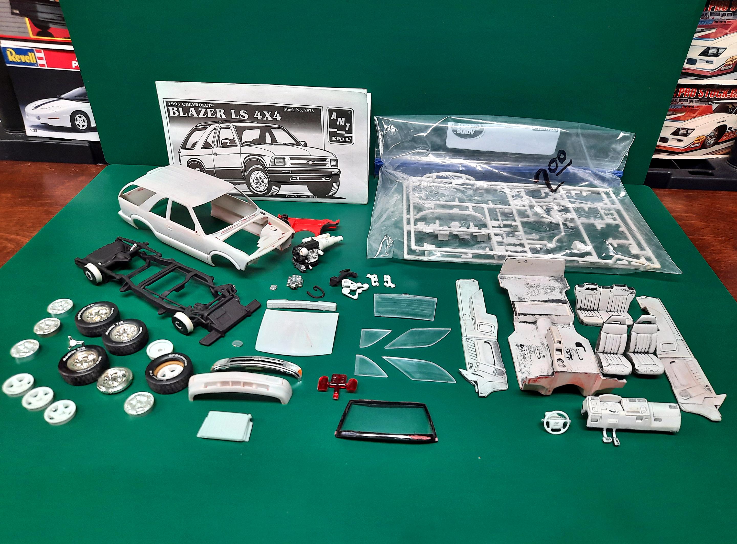

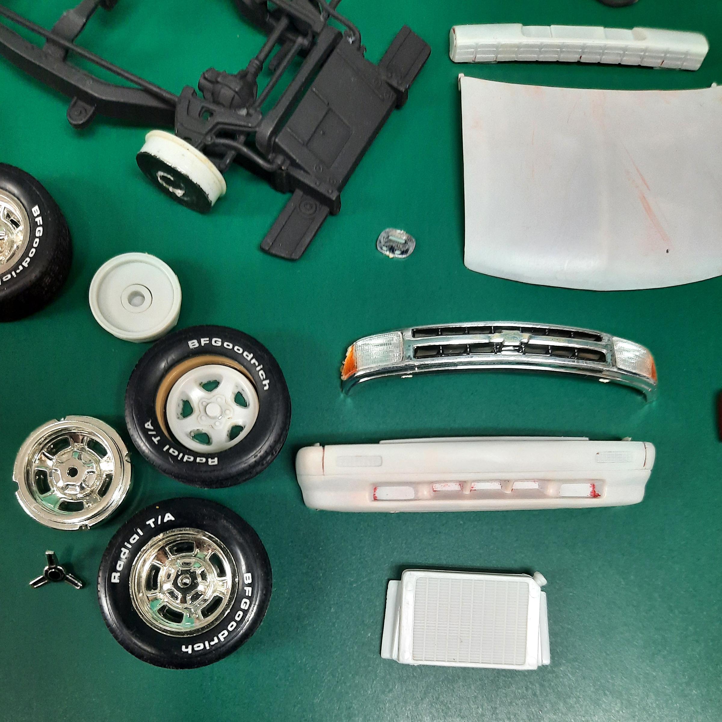

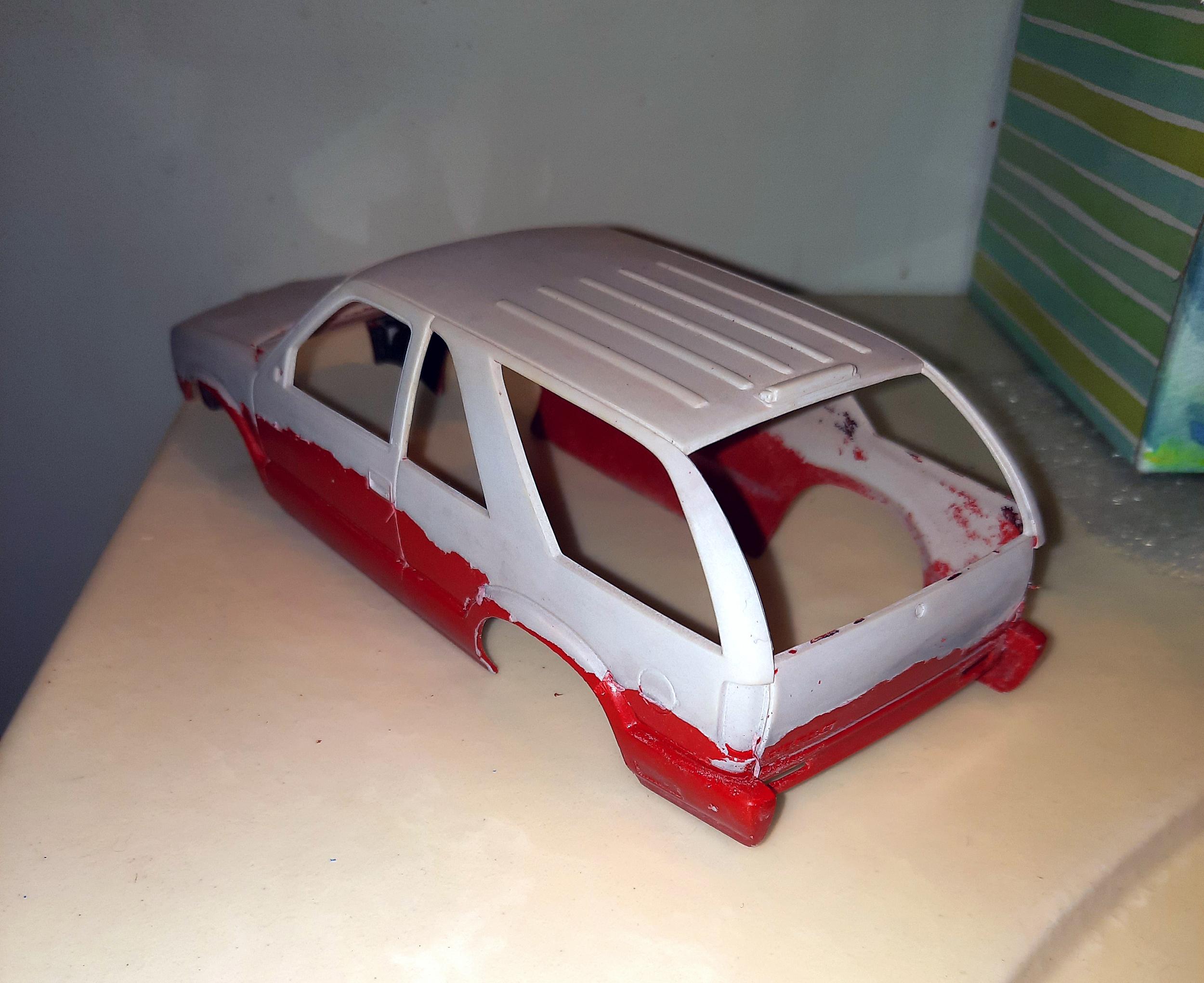

So I got this partially started kit that I bought for $1.00 (they wanted $2, but took $1)  It was painted red with a black interior (including windows painted black on the inside).  I started stripping it down with Scalecoat-2 paint stripper & successfully got everything cleaned off.  It didn't have the stock wheels & tires, but the wheels it had looked pretty good except the big 3-wing knock-offs on them didn't look right on a modern SUV to me, so I came up with an option to make my own center caps.  The body pics are during paint stripping (could only do 1/2 of body at a time).  Also decided to strip paint off grill & wheels to paint them.

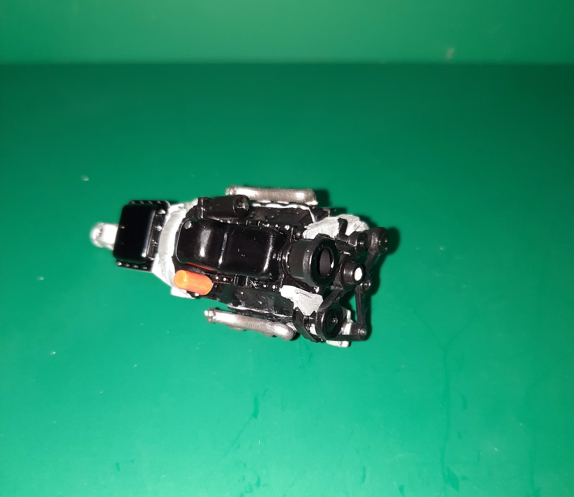

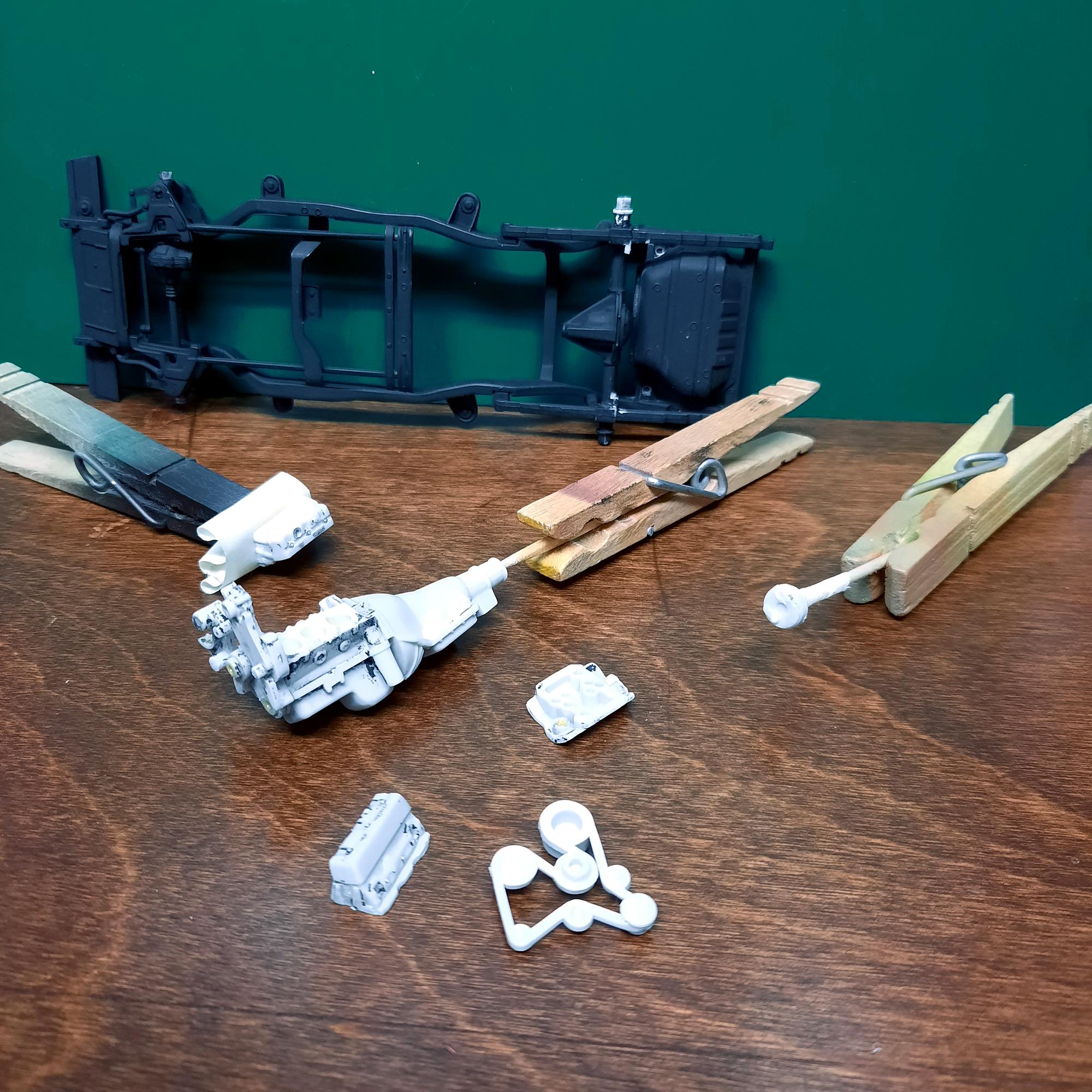

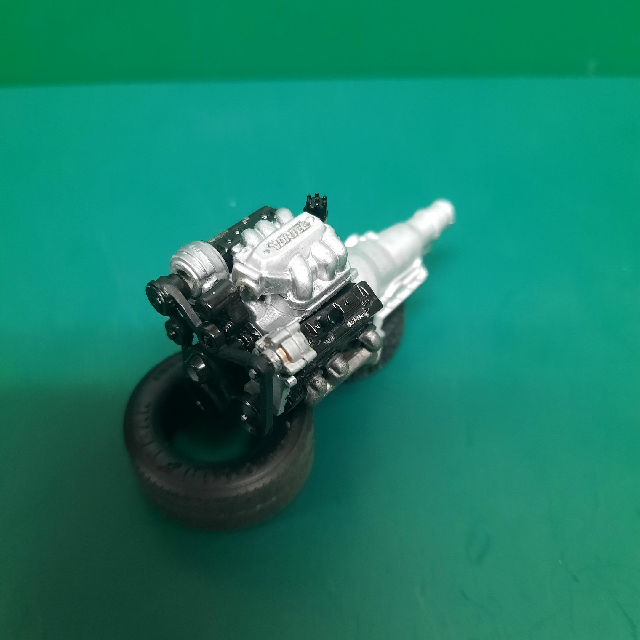

I was thinking this might just be a somewhat quick build, but "quick" has quickly been blown out as a possibility.....  The engine was mostly glued together & painted all black, so I've started with that.  Having to re-learn quite a bit, especially how long it takes to do some of this stuff & how much prep-work can be needed.  But determined to make this work (got some ides & things I'd like to try), so hopefully it's a fun adventure?

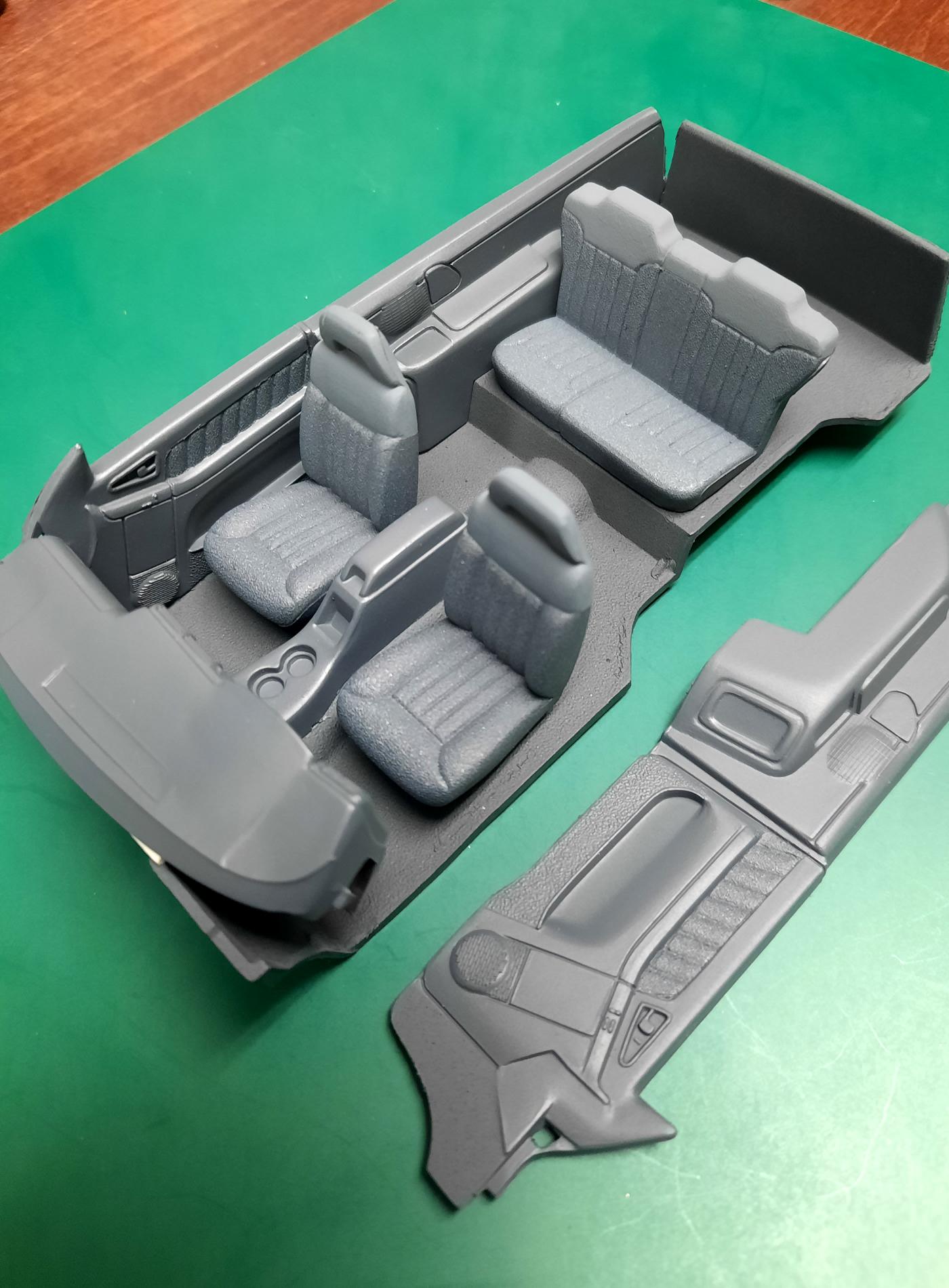

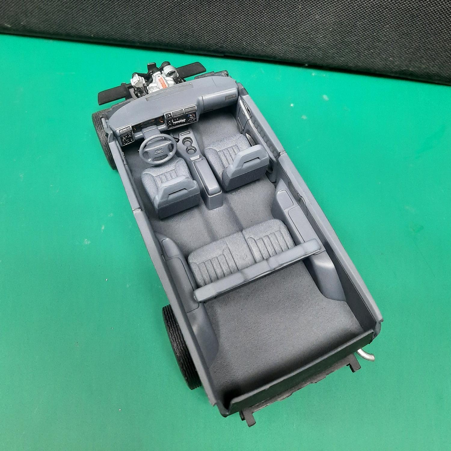

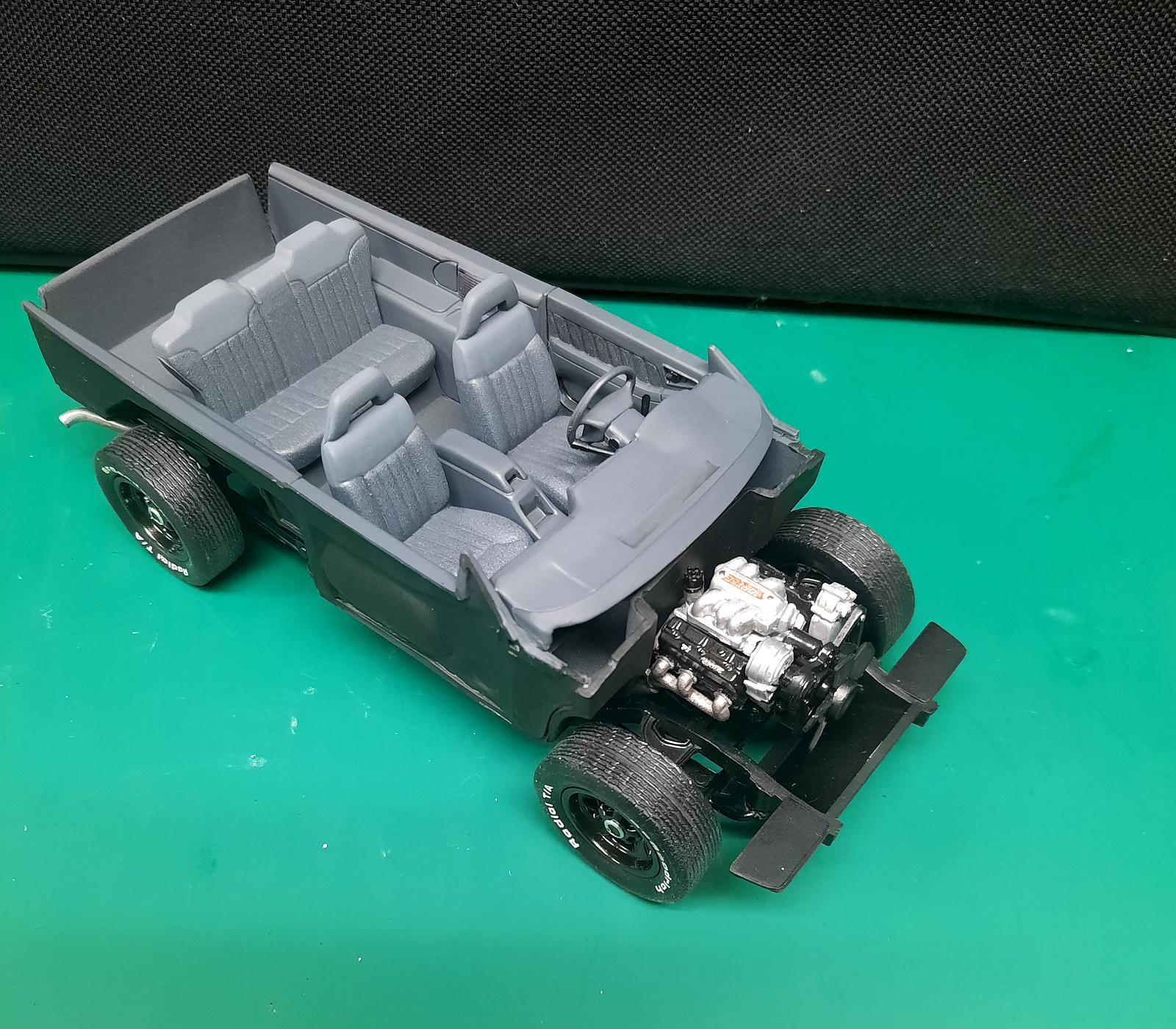

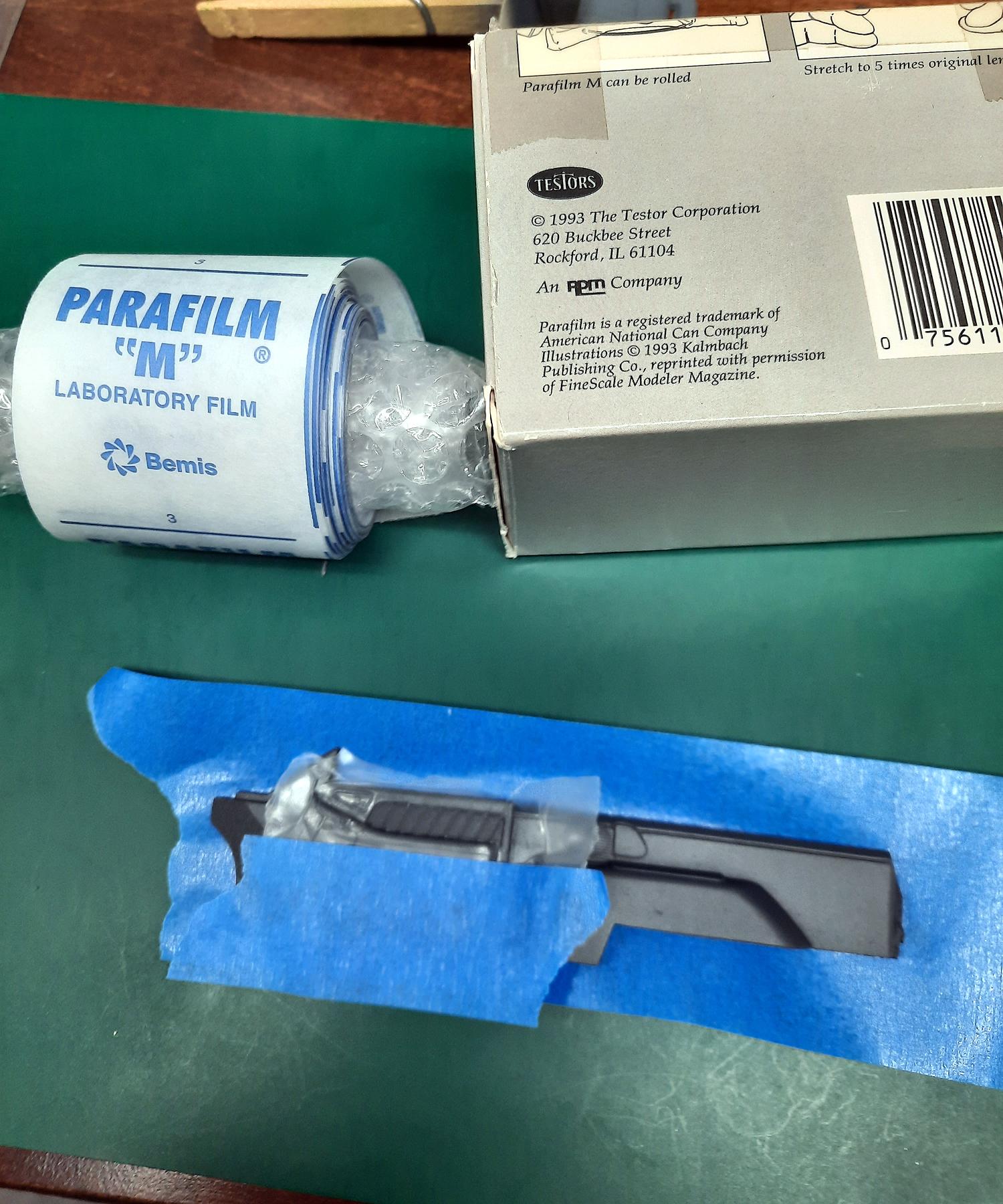

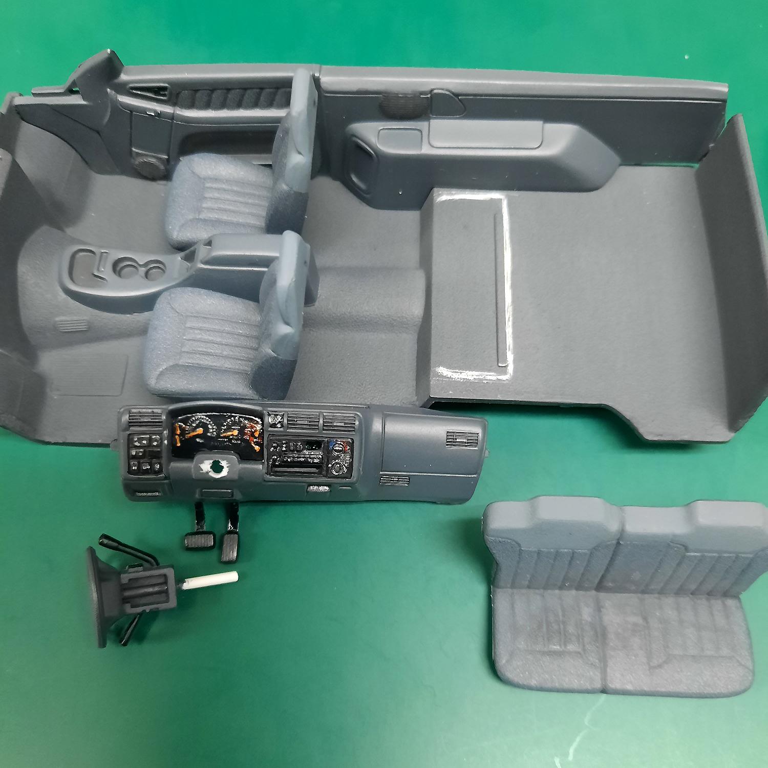

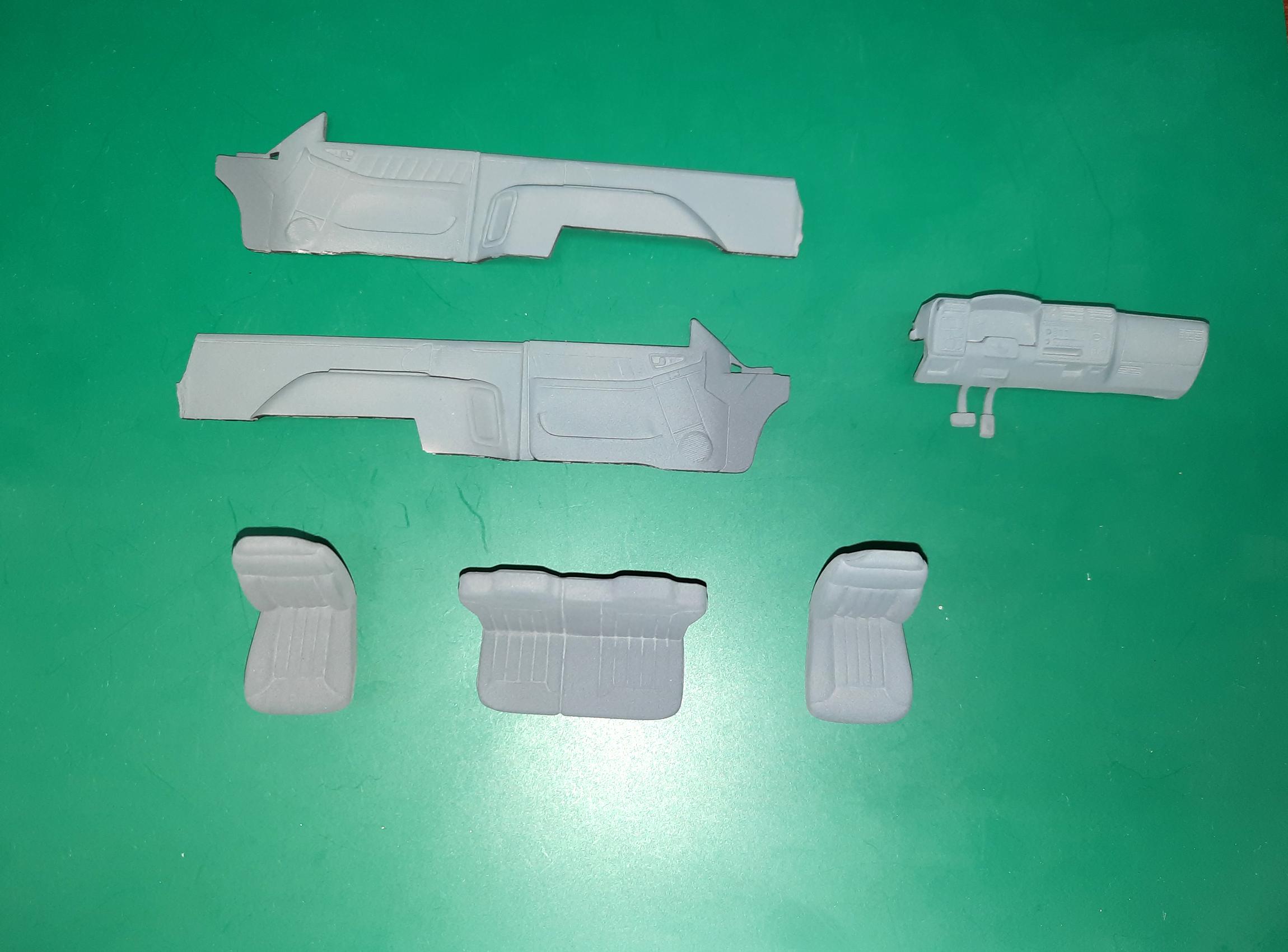

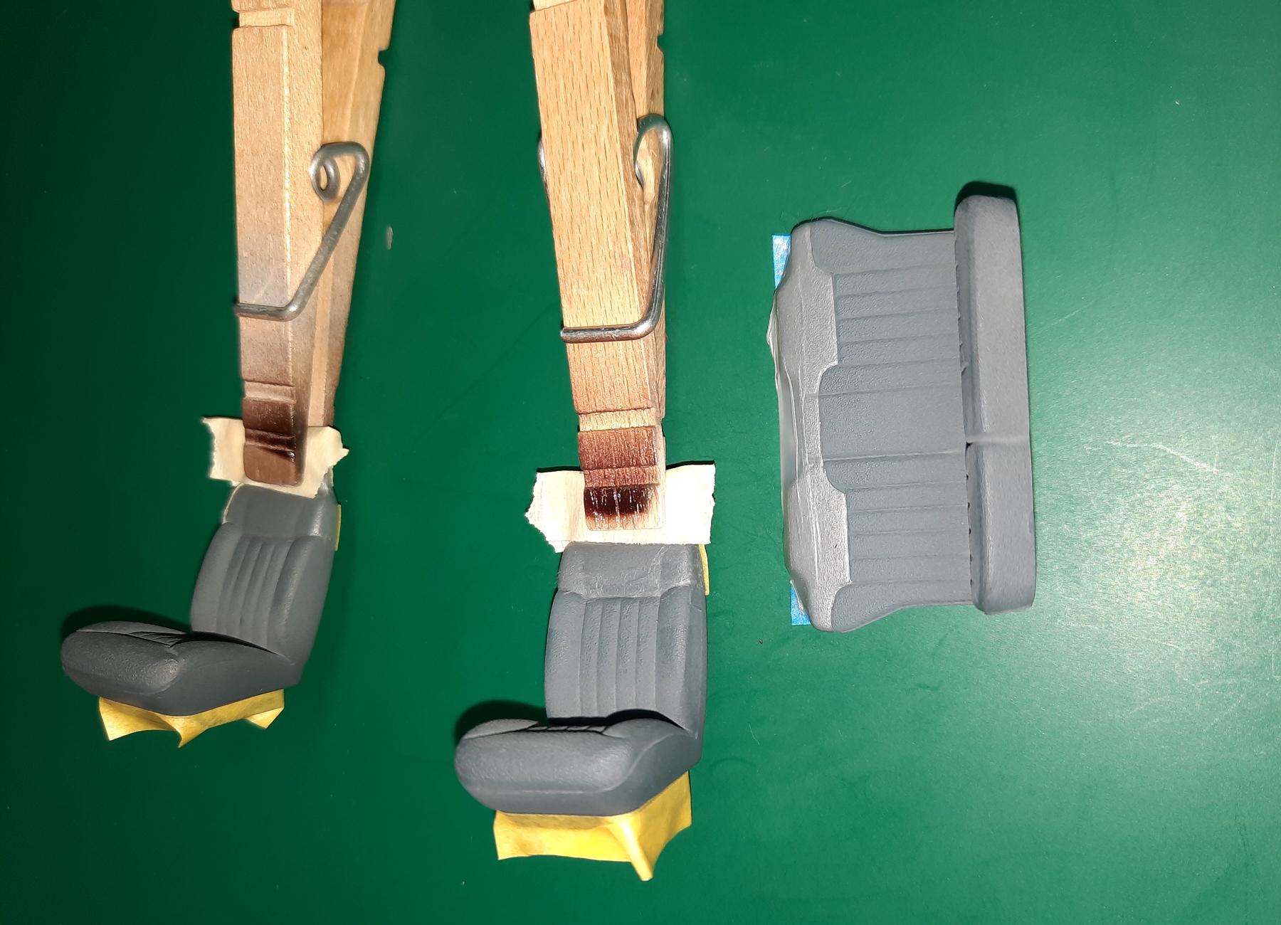

Got the door panels, carpet & seats painted tonight, still remembering how to do things & was trying to figure best way to mask off different sections of seat fabric when I realized I still had some Parafilm for masking (great stuff for complex shapes).  The colors (greys) are all air-brushed Tamiya Acrylics, with the carpet & the seat fabric mixed thicker (almost not thinned) & sprayed at low pressure with the air-brush held further back to create the speckled & textured look.  Mixed some gloss clear into door-panel & dashboard paint to create the vinyl sheen.  Now the detail painting begins.

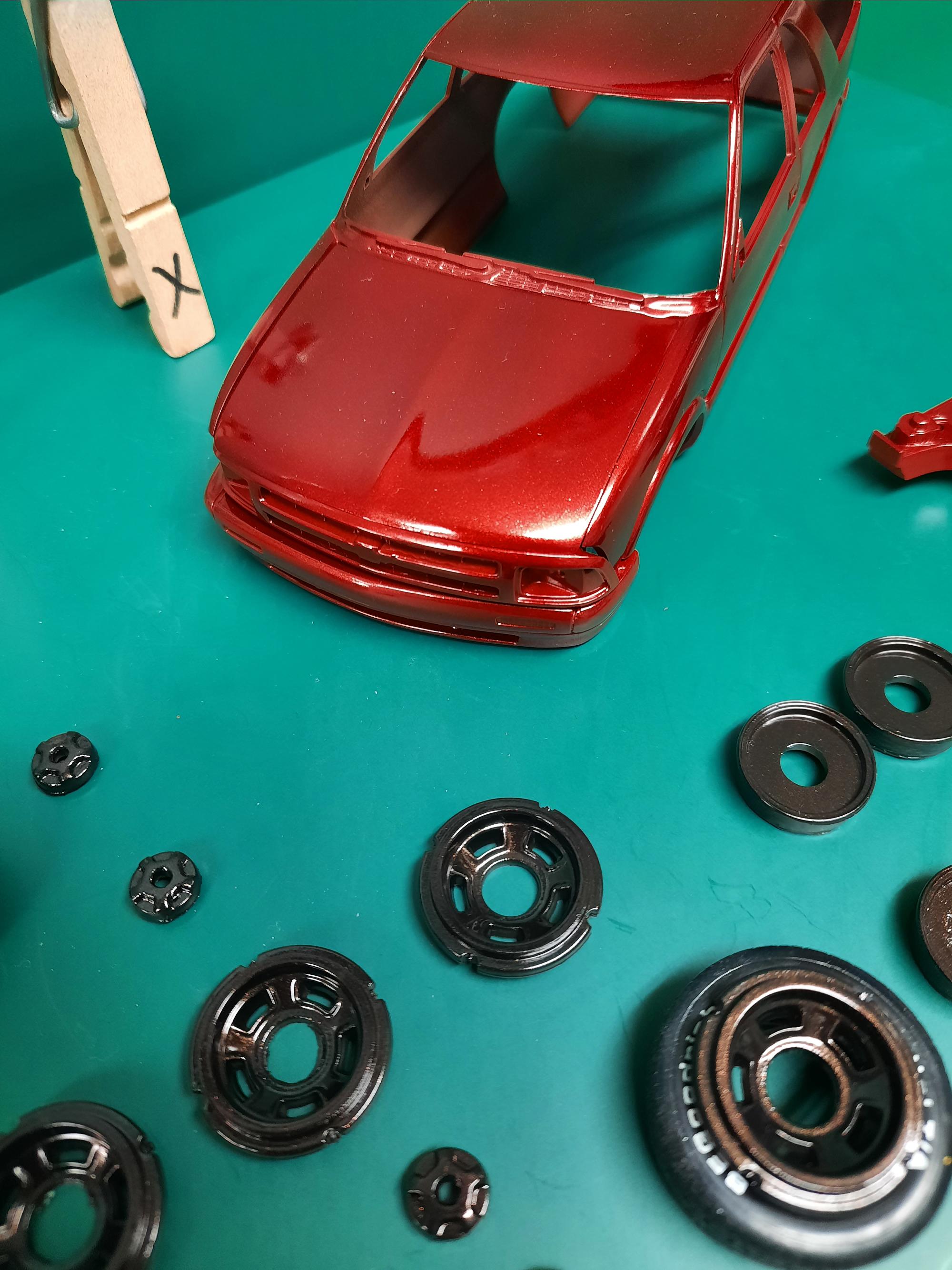

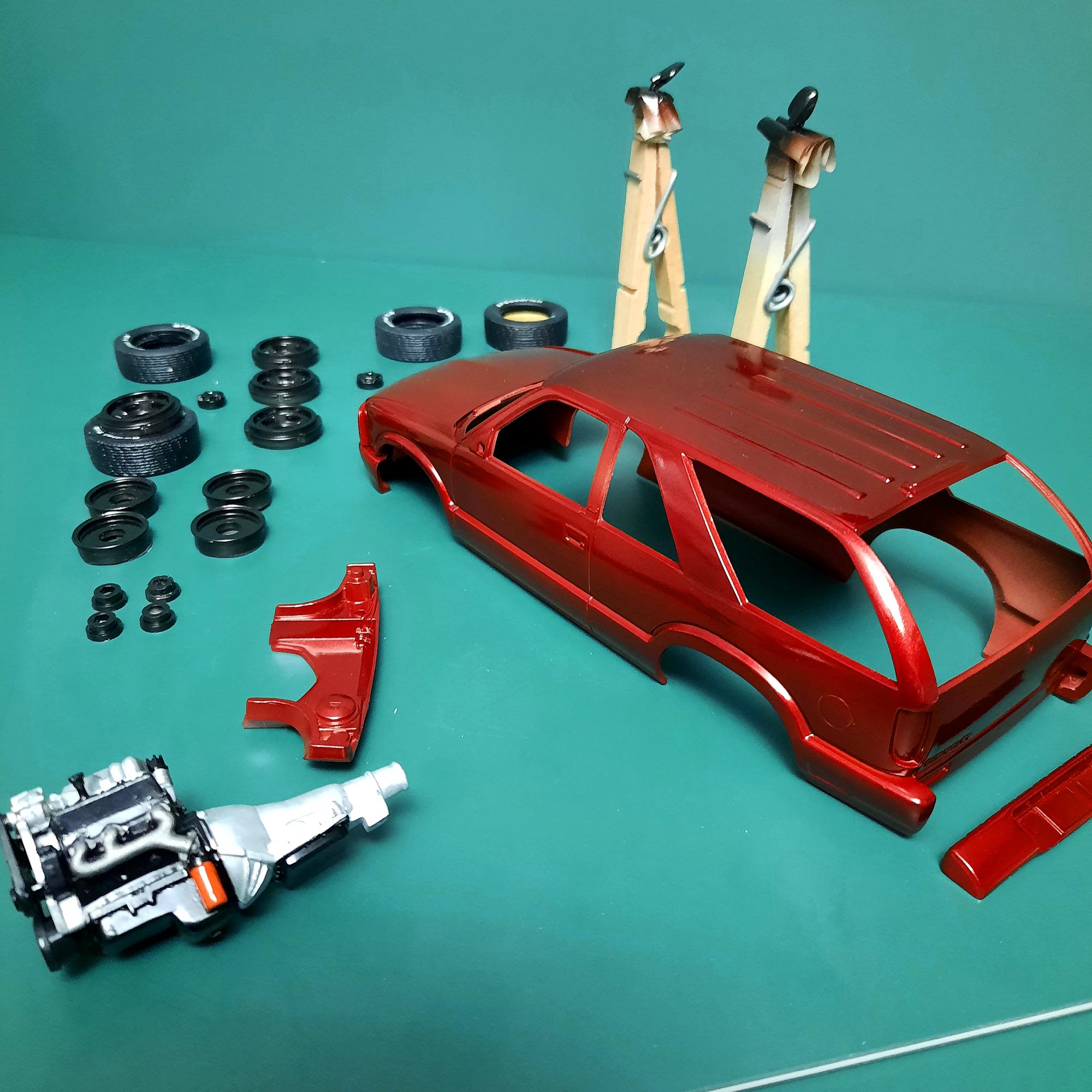

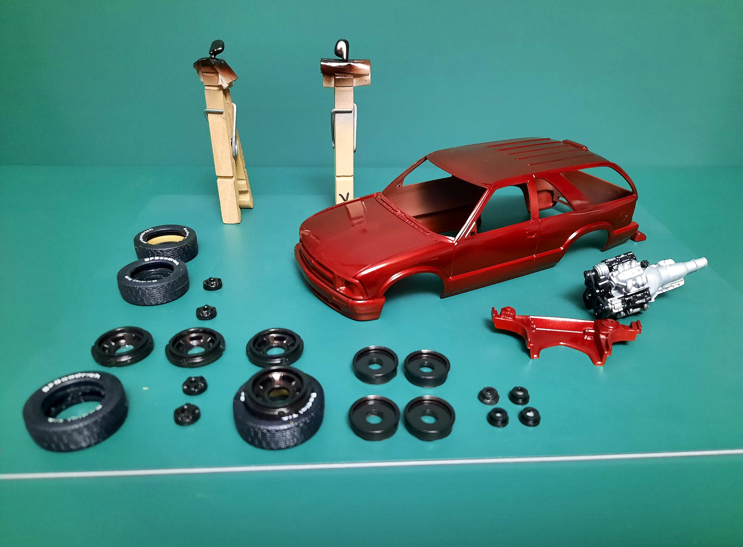

Got the body & wheels painted using the Pearl EX powdered pigments.  Ended up having to use some metallic red Tamiya Lacquer paint along with some clear as a base for the pigment (used Super Russet [metallic-red] & Antique Copper pigments with some Fluorescent Red).  The color came out a bit too bright with a more copper color than I wanted, so I ended-up clear coating with a mixture of Tamaiya's Clear Smoke (dark tint) & Clear Red to get the color I wanted.  Happy with how it came out (the photos look brighter than it is, it has a deeper color in person).  I painted the wheels Black with a clearcoat that had just a little Antique Copper mixed in.  The self-pigmented paint worked well, but did require a good bit more stirring every couple of minutes because the pigment does settle in the spray cup of the airbrush.  It also seemed to take maybe a couple more thin coats of clear than I otherwise might have used, but the new color options are amazing & I will use this technique again if I need to.

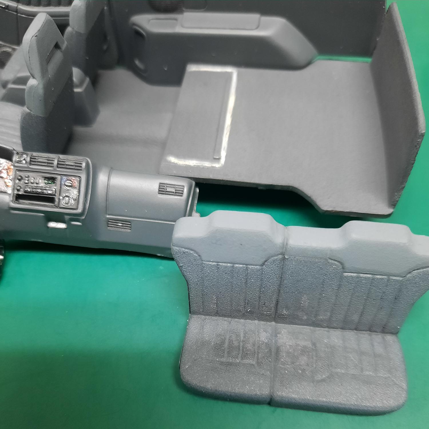

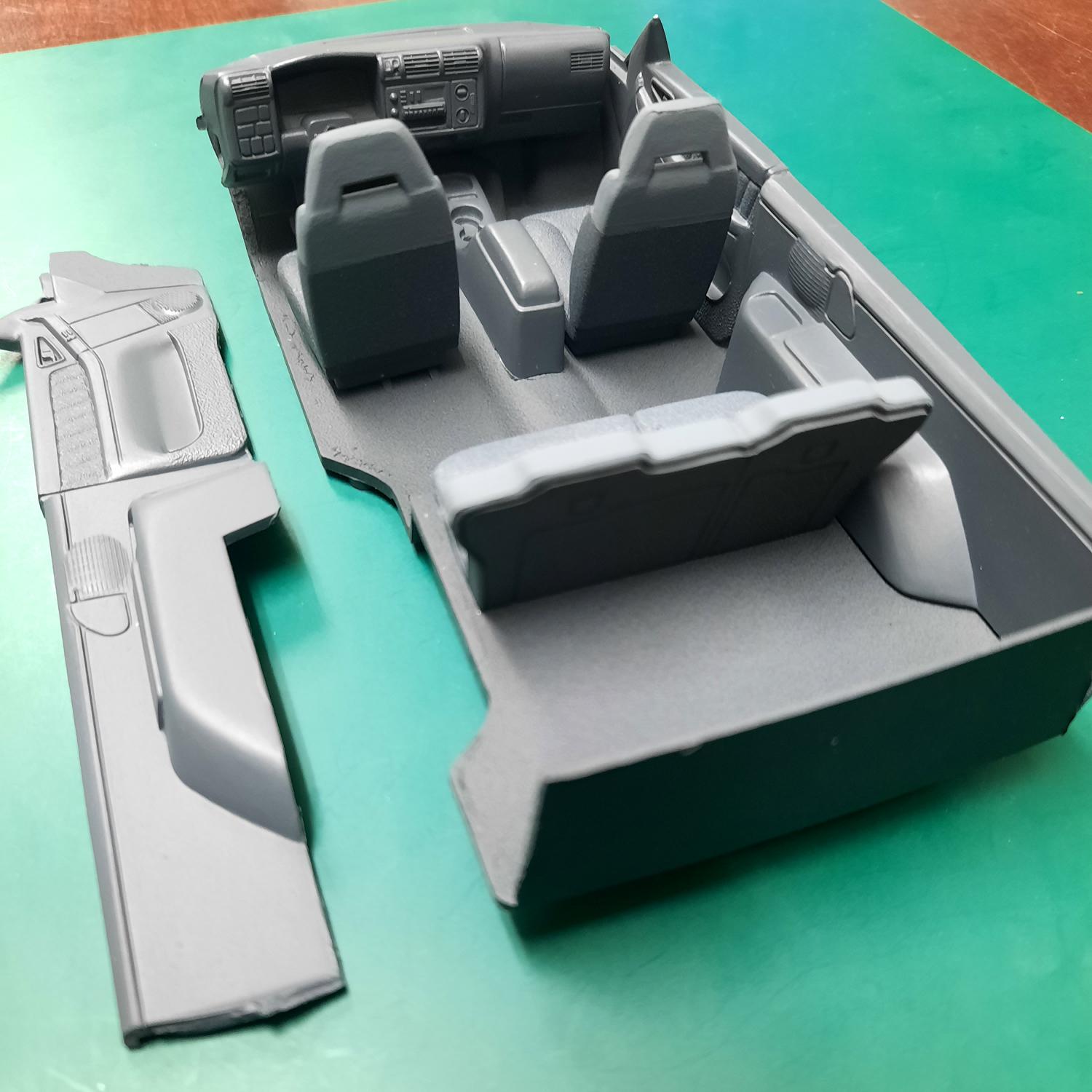

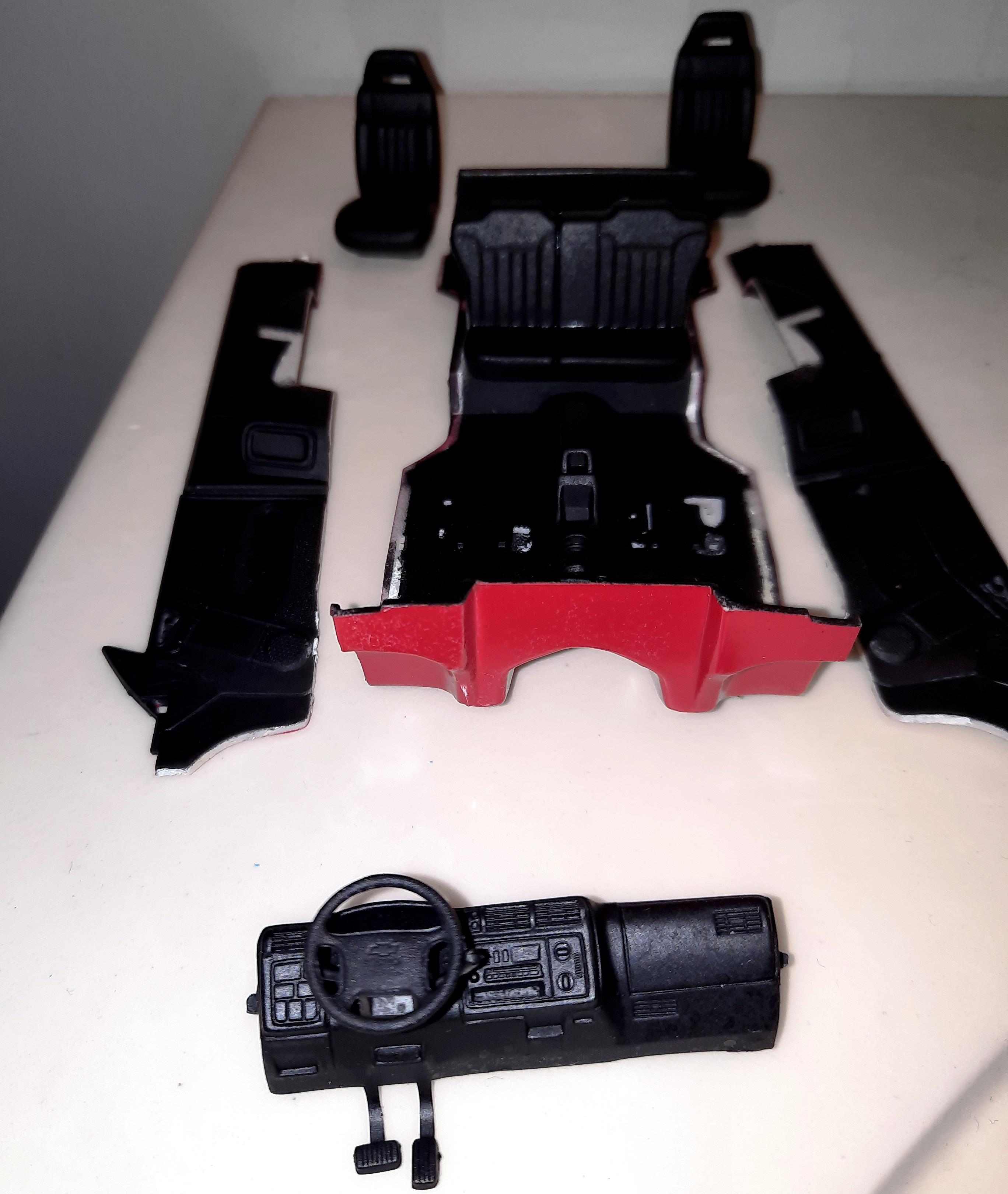

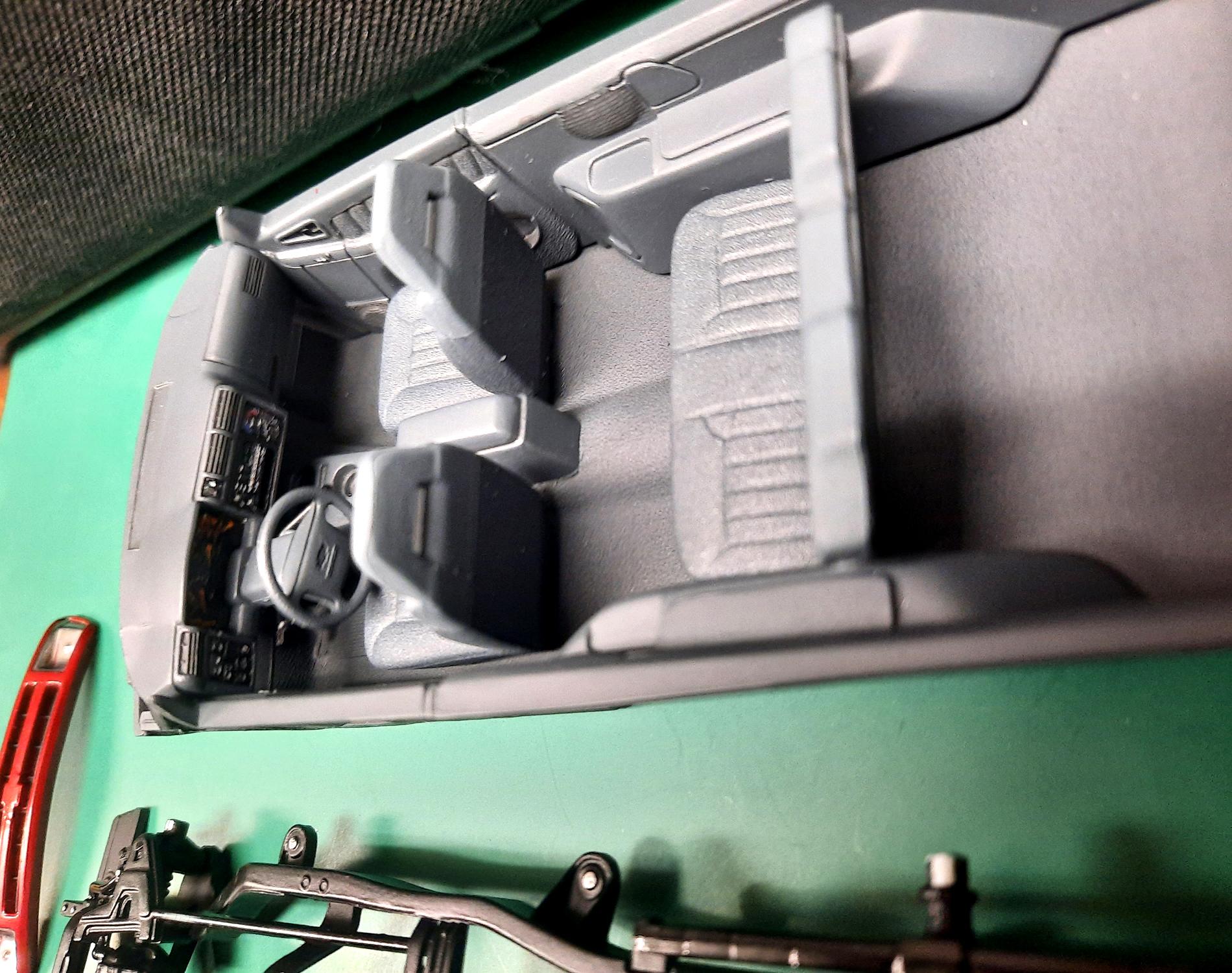

Pretty much completed detail work on interior, except during that, I tried to use Tamiya Panel Liner to accentuate the folding seat seam & found it works great on gloss paints, but not on flat acrylics, it just soaks into, bleeds & stains the paint (Arg!).  So I had to re-mask & touch-up paint on rear bench seat (luckily it was the easiest thing I could have mucked-up & redo).   Also when un-gluing the interior pieces, the steering wheel assembly didn't come off clean, so I just took an Evergreen plastic rod & drill the steering column & dashboard to make a locating pin to help re-glue it.

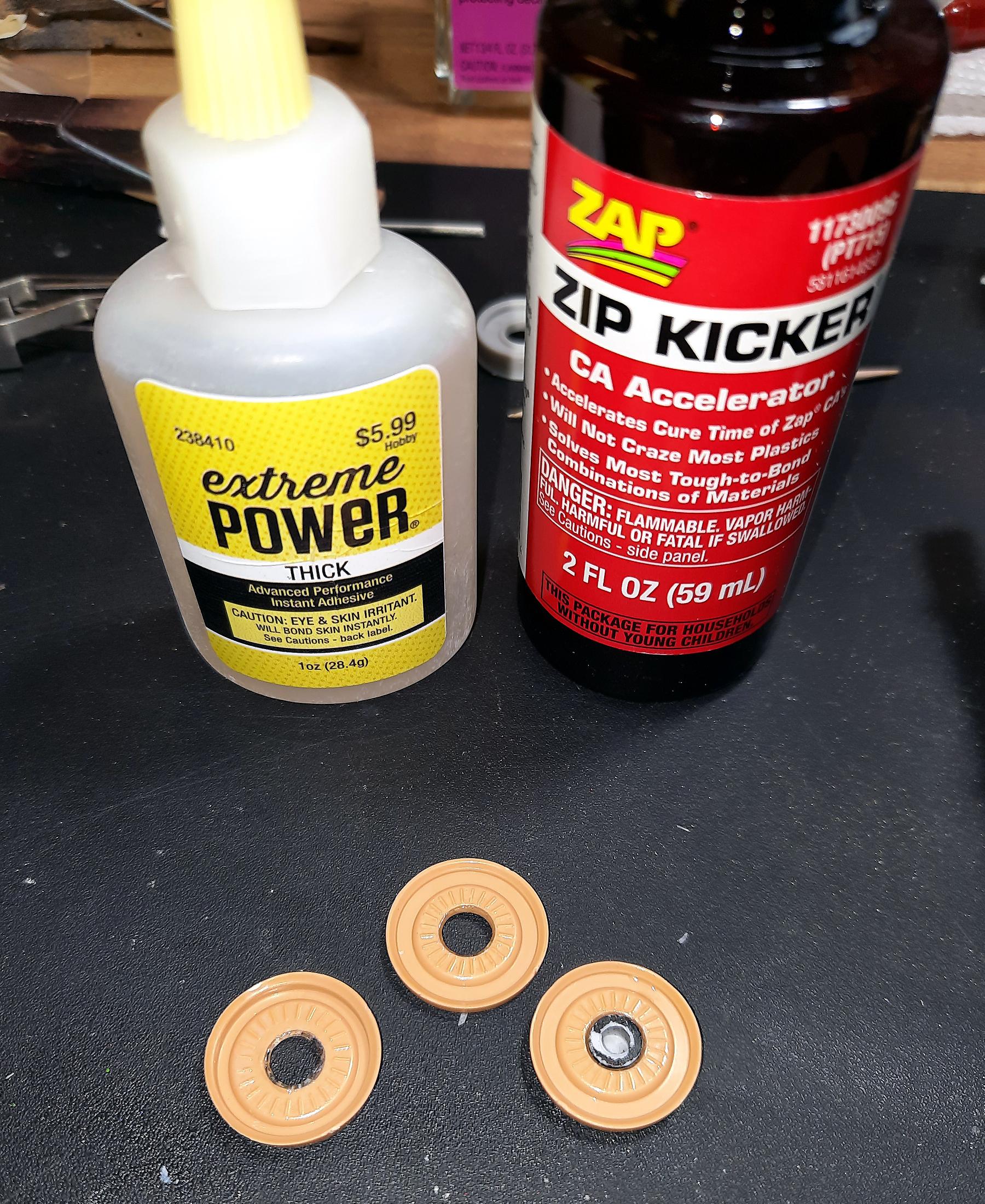

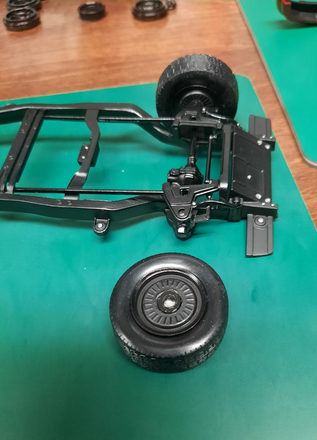

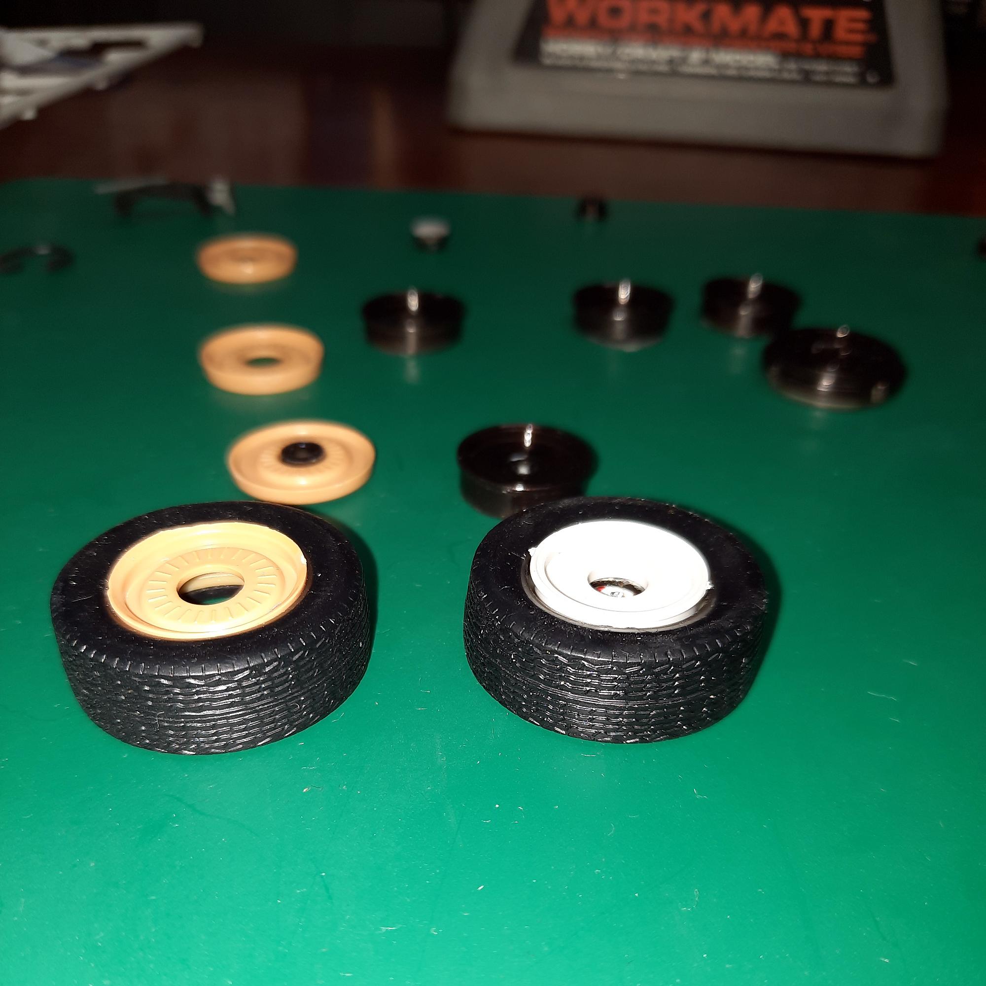

Also found some correct diameter & thickness wheel backers (had to de-chrome them), not sure what they where originally from, but they'll work.  The center post hole was just a little too big & sloppy, so I ended up taking some Thick C/A Glue (super glue) with some Zip-Kicker (C/A accelerator) & used a toothpick to apply glue & a Q-tip soaked of Zip-Kicker to build up 3 coats on post hole, then re-drilled to correct needed size.  So now the wheels fit nice & snug with no slop.  Also got 'em painted.

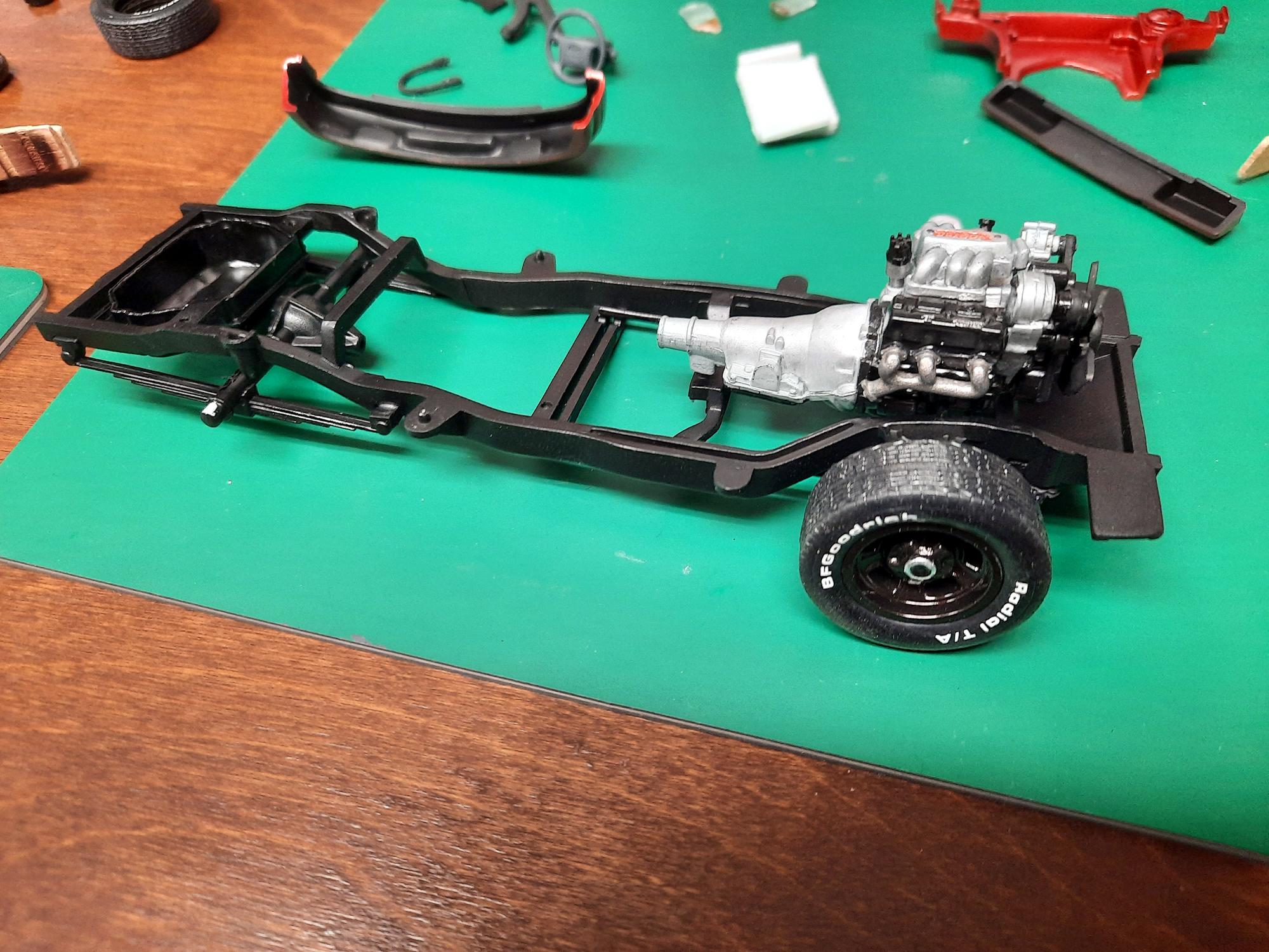

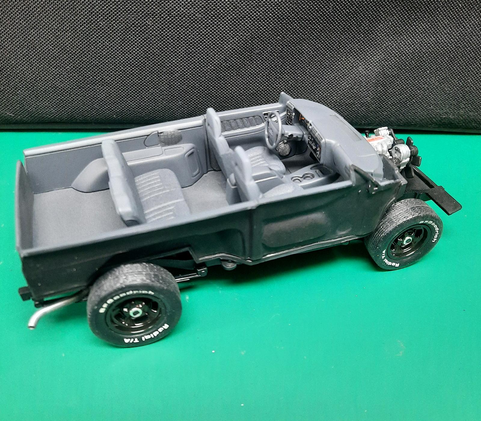

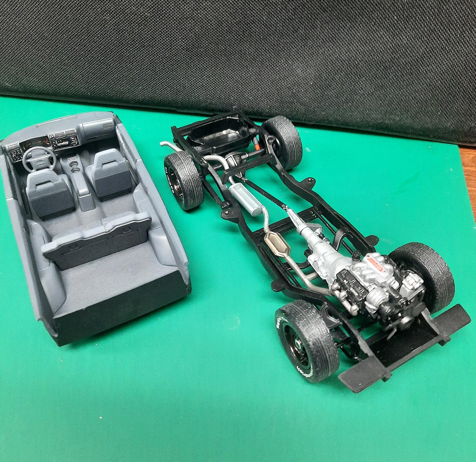

     Sadly, I thought I'd have lots of time to work on this over the holidays, but of course, all kinds of stuff has to go wrong all at once & I just finally got back to this.  So things are much better now.  Continued interior & chassis detailing & assembly.  Working on engine compartment & body now.   Lots of details, parts & test fitting on some of these AMT kits, but I'm fairly happy with the way things are coming out.  Hopefully I can finish this in the near future?
