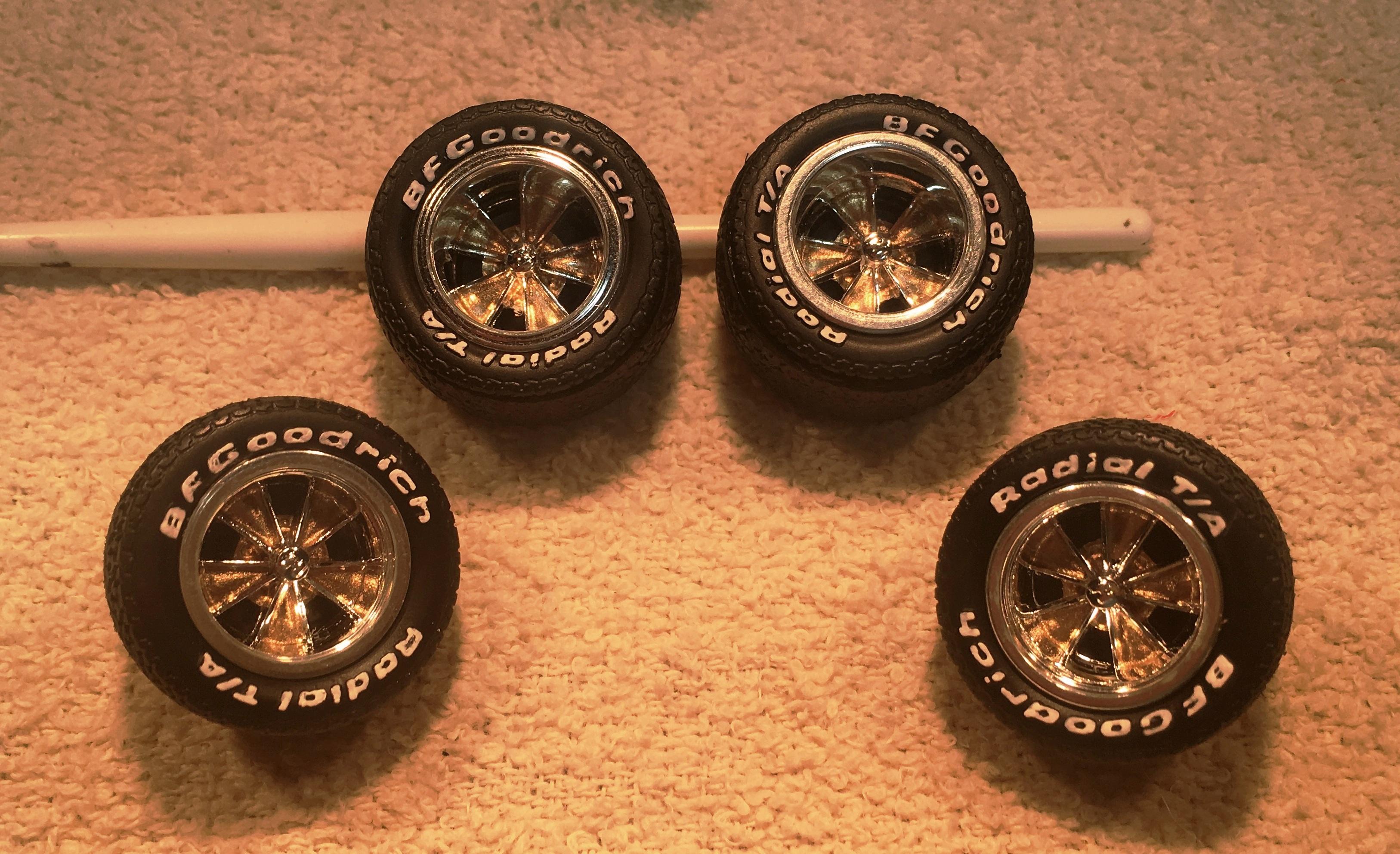

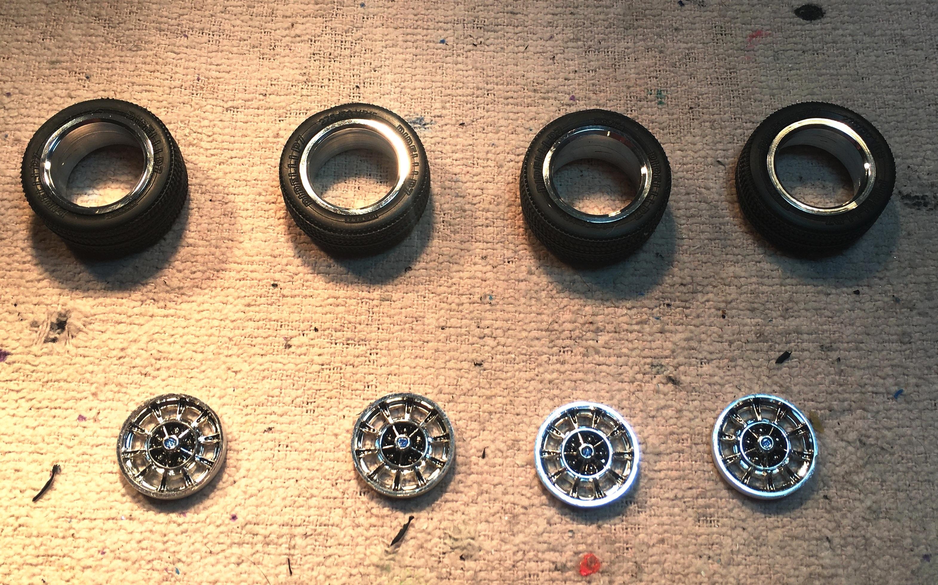

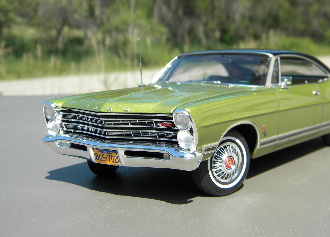

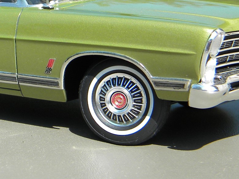

StevenGuthmiller Posted December 14, 2024 Posted December 14, 2024 Doesn't require any special material purchases. Whatever black enamel or acrylic you have on hand will work perfectly fine for detailing wheels, hubcaps, grilles, whatever. You may want to use flat black and thin it accordingly for the job at hand, but I've never felt that I needed to use a panel line accent. Just seemed to me to be more stuff sitting around my shop that I can manage without. Steve 1 1
