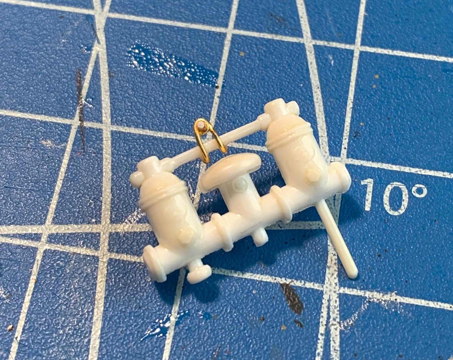

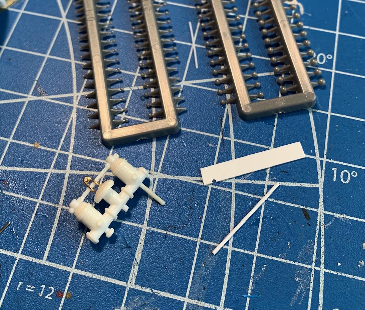

Pierre Rivard Posted December 28, 2024 Author Posted December 28, 2024 One more component on the engine right side done. The coolant pump greaser (sort of...) loosely located above the dynamo. Plumbing and wiring will come in later after paint & assembly. Starting on the left side I fabricated the roots blower clutch linkage and loosely fitted it behind the carbs. On the real car the actuator is linked to the gas pedal. The pedal's very last portion of movement (pedal to metal mode) pulls the linkage to engage the blower clutch. Extra 80HP thank you! 1

Pierre Rivard Posted December 29, 2024 Author Posted December 29, 2024 Thanks for the input fellows. Ken and Cliff are pointing to some sort of oiling system, and I could trace one line to the blower. But for today, throttle linkage... I think 🥺
Pierre Rivard Posted December 29, 2024 Author Posted December 29, 2024 I could not resist. Francis has a dime, and I have a dime! 3
