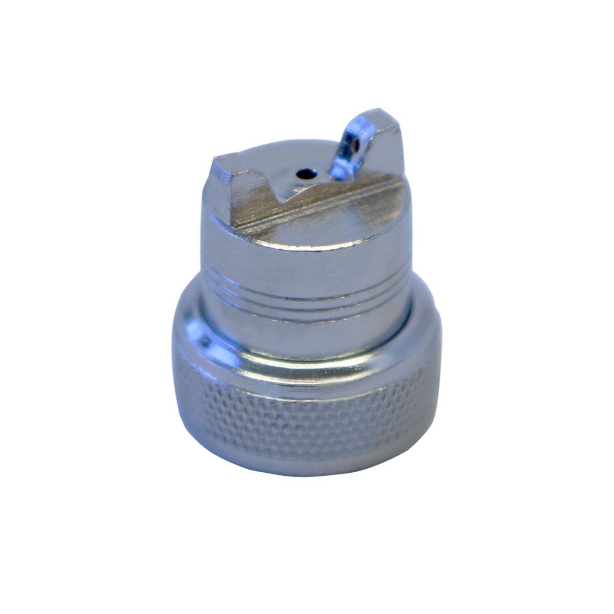

YellowHound Posted December 18, 2024 Posted December 18, 2024 (edited) I will have a couple of new car kits to build in 2025, namely a 1/12 Lancia Stratos and a 1/8th Trans Am. Current airbrush is a Harder&Steenbeck Evolution 2024 CRPlus with a 0.45mm needle. Given the larger scales will call for a lot more paint coverage, and I'm likely to build more at larger scales, should I be looking to get another airbrush to give a higher paint coverage? Actually I'm very attracted by the idea of a fan pattern brush. If so, what should I be looking at? Thanks! Edited December 18, 2024 by YellowHound 1

YellowHound Posted December 24, 2024 Author Posted December 24, 2024 Thank you all for your thoughts. I've ended up buying a new Hyundai compressor and a Procon P290 airbrush with a fan tip. Yesterday I painted a 1/16 chassis with primer and I have to say it was effortless. Great coverage from the brush and the finish is superb. 1
Dave G. Posted December 24, 2024 Posted December 24, 2024 6 hours ago, YellowHound said: Thank you all for your thoughts. I've ended up buying a new Hyundai compressor and a Procon P290 airbrush with a fan tip. Yesterday I painted a 1/16 chassis with primer and I have to say it was effortless. Great coverage from the brush and the finish is superb. You should be set for life with that combo ! And that fan tip should make larger scale body painting much easier. You certainly won't run out of air with that compressor. 1
