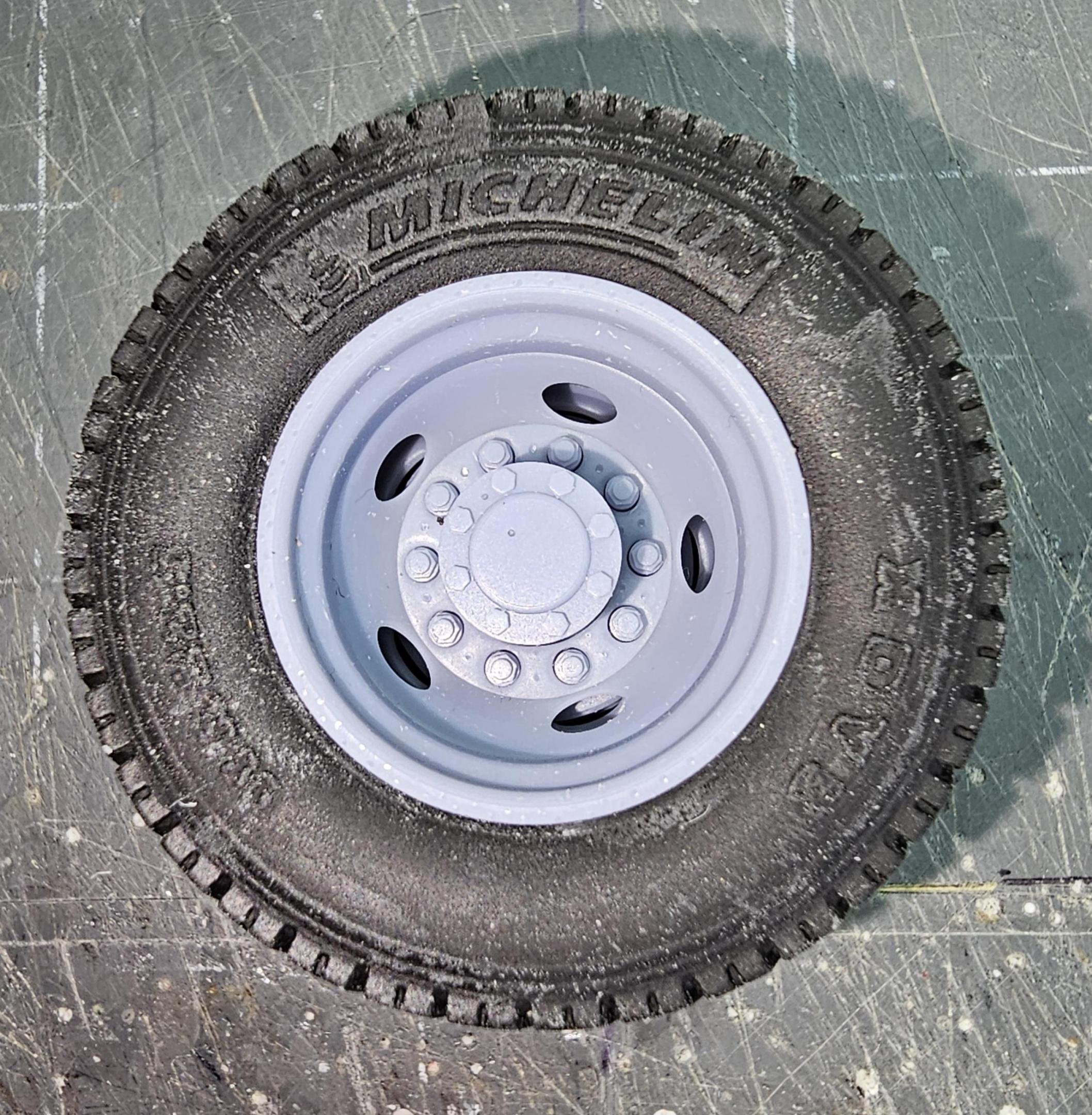

20241220_124813.jpgThese are from Jamie also Michelin XDVS 11.0R 22.5 drive tires.

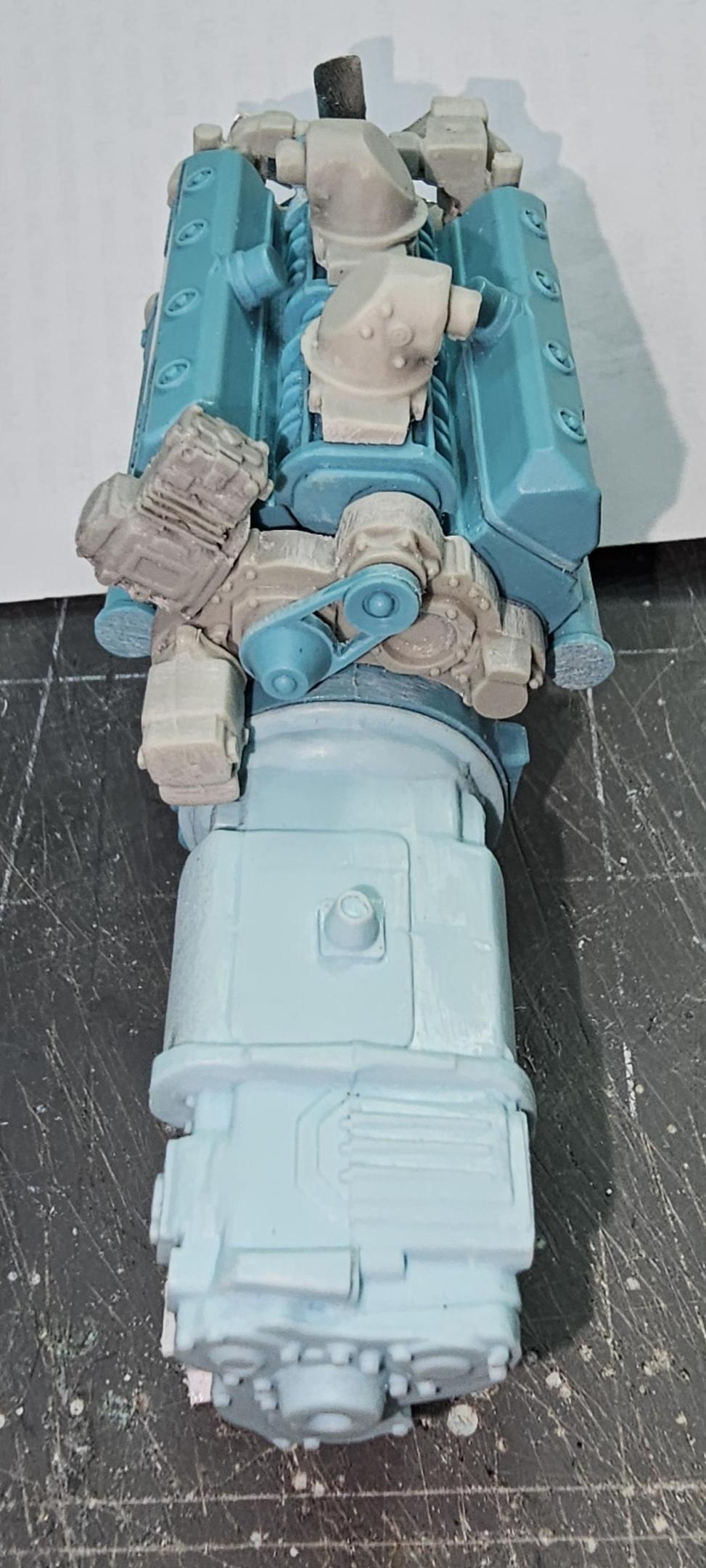

20241220_170751.jpgThis view shows it assembled with a Mack 13/18 spd. Transmission.
20241220_170801.jpgAnother view
20241220_170823.jpgAnother view
20241220_170846.jpgAnother view
20241220_170949.jpgAnother view

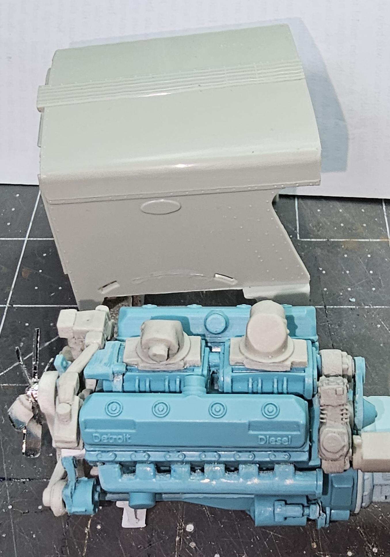

 For me the biggest challenge for this build is going to be stretching the hood to fit over that massive 12V71🤔
Hood fix.jpgI'm not sure if I should use two Revell hoods to make one or scratch build one? I'm stumped so any help from the peanut gallery would be greatly appreciated.

The kit hood is actually short vs the real truck Clyde II by a fair amount. Somewhere there was an article about a modeler correcting it. I recall he scratched the longer portion of the hood. Maybe Scale Auto magazine was where I saw it...I'm sure someone here can say

I found the article from Tim Ahlborn on lengthening a Peterbilt 119" BBC into a 127" BBC hood. I have two Revell Peterbilt 359 hoods, so I think I can pull it off. I just need to print the pictures and follow his instructions. Easy pessy Japanesey. OPPS! I just gave away my age...lol😁

  Well you all wanted to see this. So here we go. "How to lengthen a Revell Peterbilt 359 hood" by me, yeah the old guy.🧓
20241224_133735.jpgOkay, this view shows that the kit hood is actually 61" long. Not 60" like it should be. The tape is for my cut line. I'm removing 3" (scale) this will become clear in a minute.
20241224_134007.jpgThis view shows that the openings for the two air cleaners are about 9" deep into the hood sides. So I'm cutting 10" off the sacrificial hood to add to the good hood that I previously cut 3" off of. So let's see 61" - 3" = 58" + 10" from the other hood = 68" Ta da.
20241224_134403.jpgThis view shows the sacrificial hood to the right and the good hood on the left. As you can see it will be 68" long when I attach them together.
20241224_134412.jpgThis view shows them sitting together, not attached yet. As you can see it's now 68" long. Perfect for a 127" BBC hood.
20241224_135002.jpgThis got out of order. It shows the tape cut line to remove the 10" need for the good hood.
20241224_140145.jpgVoula! It's glued together now. And now I just need to fill in the left over air cleaner openings and sand it down and it will be ready for primmer.
20241224_140152.jpgClose up view of the joint.
20241224_140825.jpgHere it is sitting in place with the cab.
20241224_140831.jpgAnother view of them sitting together. Well I did it! It wasn't really as hard as I thought it was going to be. So now I can move on to finishing the whole truck.
