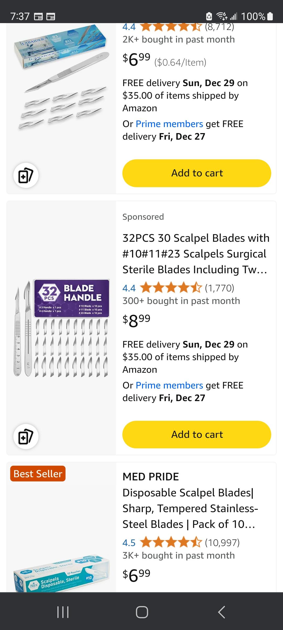

johnyrotten Posted December 25, 2024 Author Posted December 25, 2024 18 minutes ago, slusher said: Where could you even buy a scalpel? Amazon.

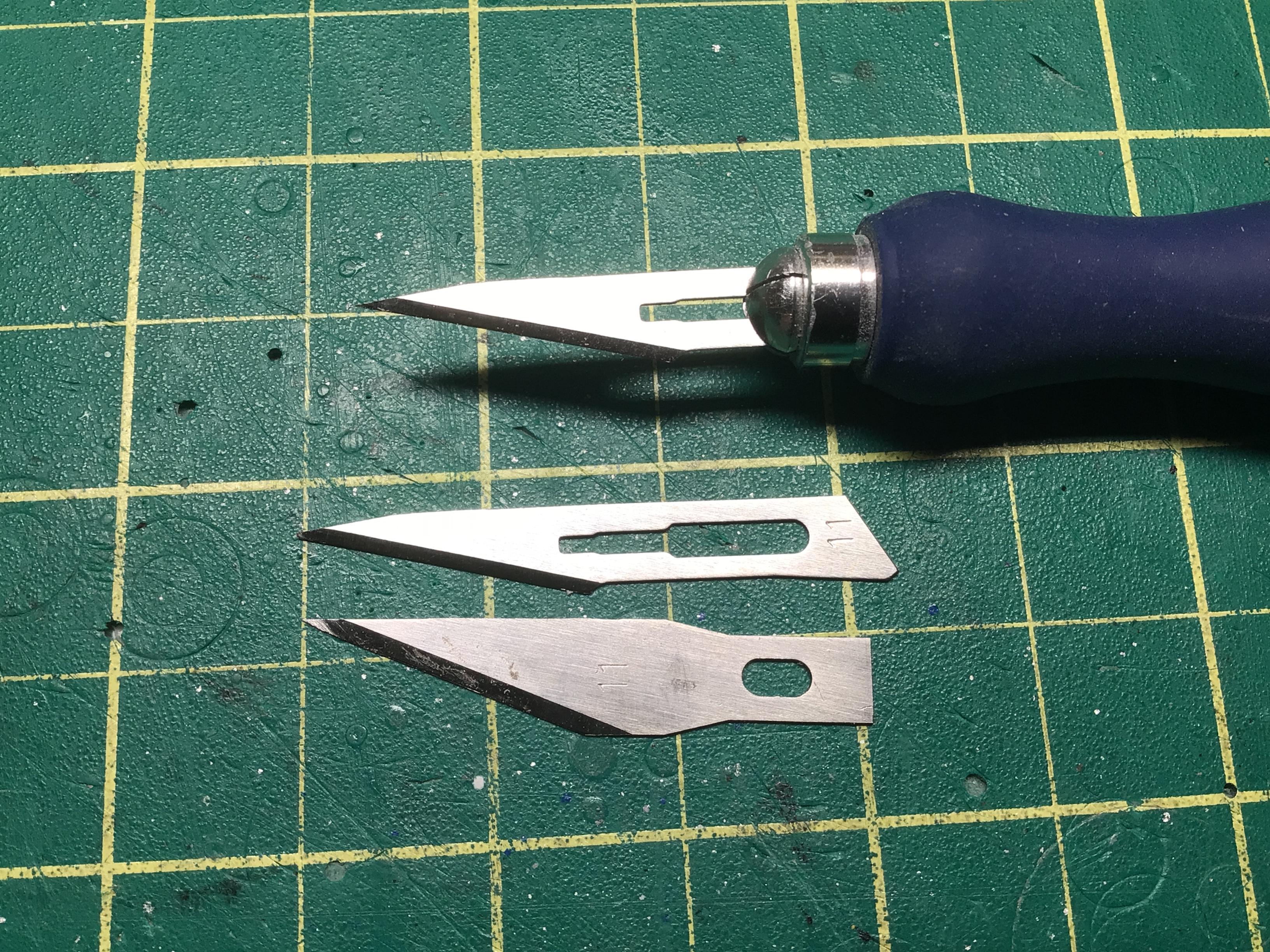

NOBLNG Posted December 25, 2024 Posted December 25, 2024 (edited) I got these on Amazon. They are #11 blades. I went with a round handle since I figure it will work better for doing sharp curves when foiling. I’ve only used it a couple of times but I like it so far and would recommend getting the round handle. They will fit into a standard exacto knife handle, but don’t go in all the way. Edited December 25, 2024 by NOBLNG 1

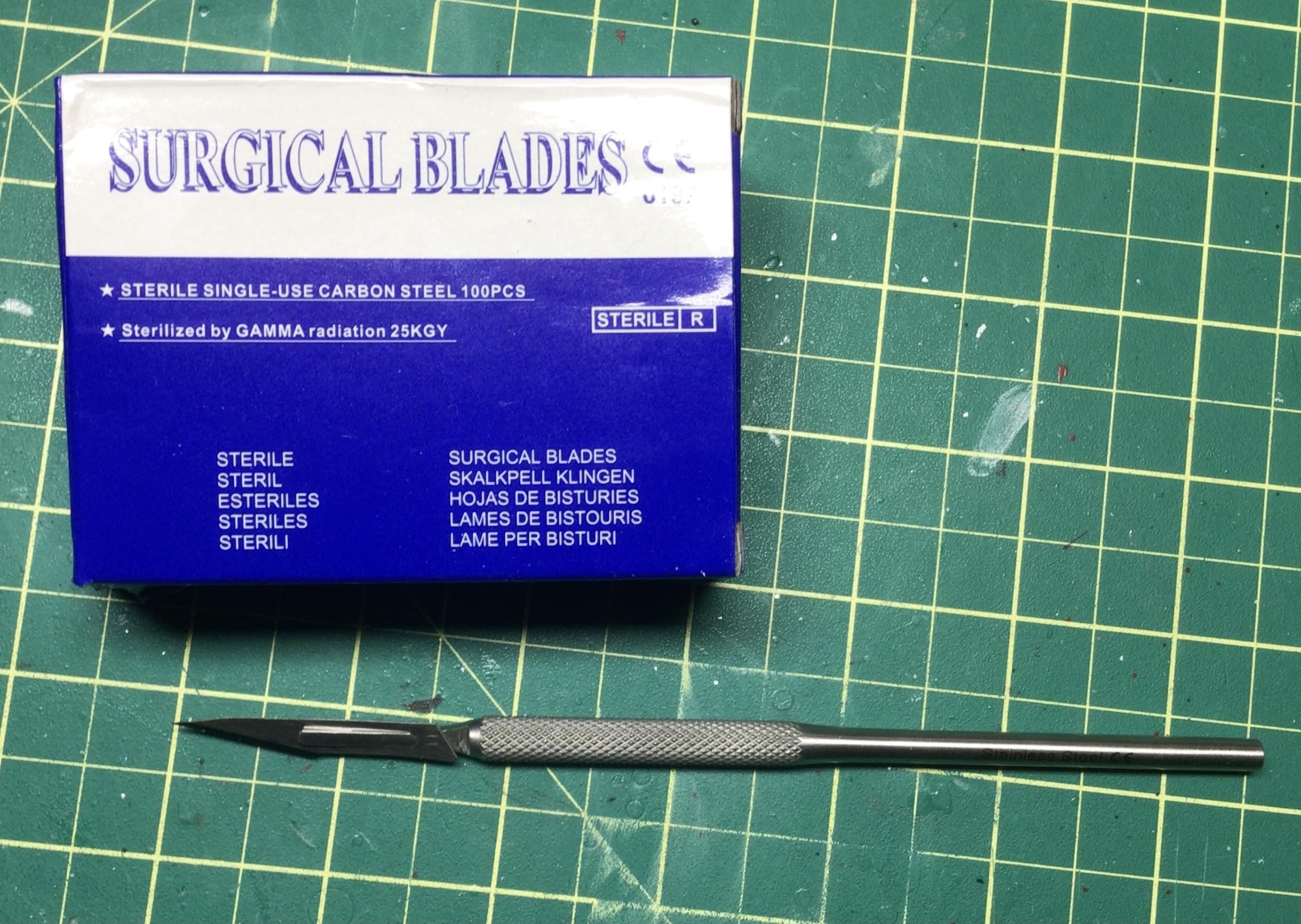

Straightliner59 Posted December 25, 2024 Posted December 25, 2024 6 hours ago, slusher said: Where could you even buy a scalpel? I get them on Ebay. ten or eleven bucks will get a hundred blades and a handle! I've been using them, the last few years. I love them! 1 1
