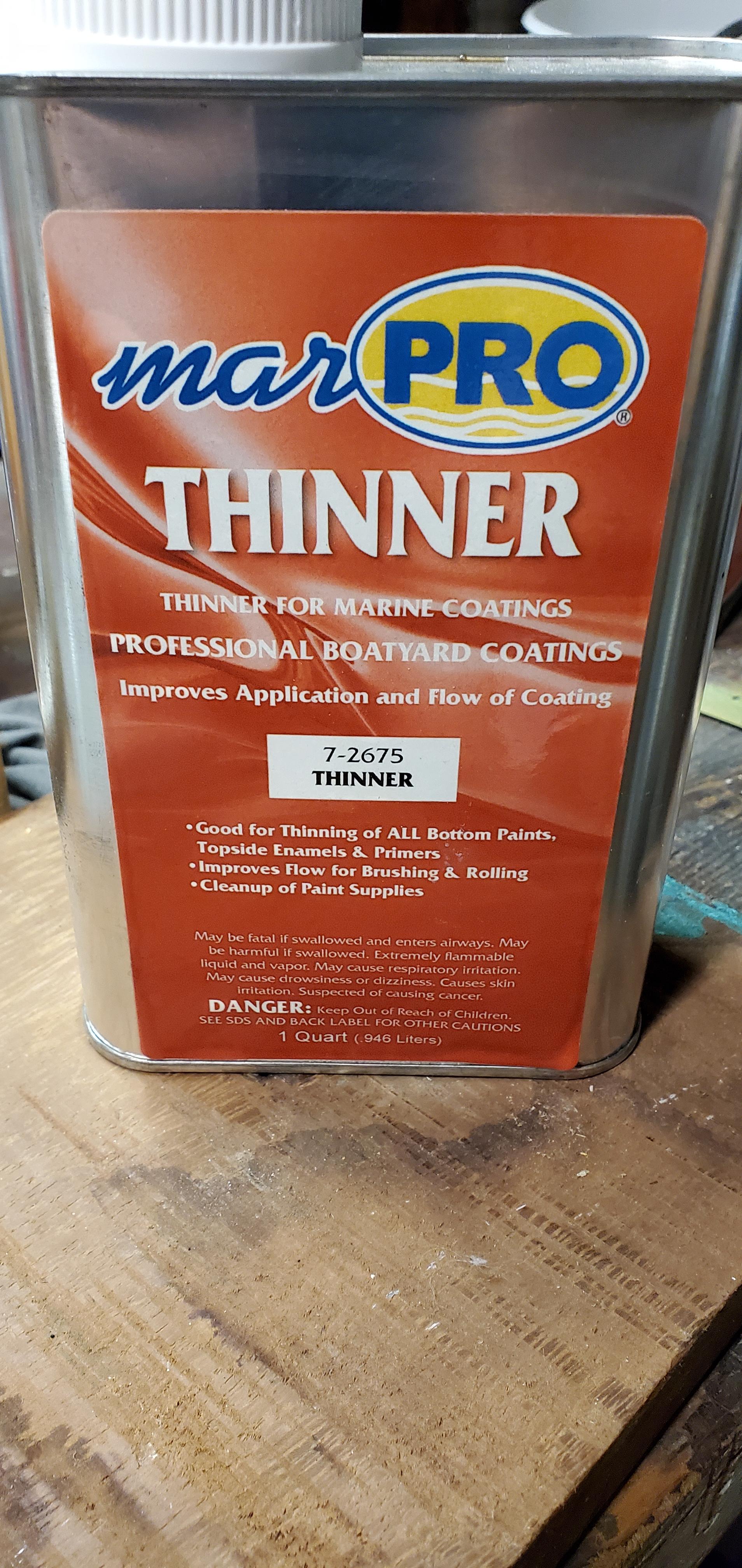

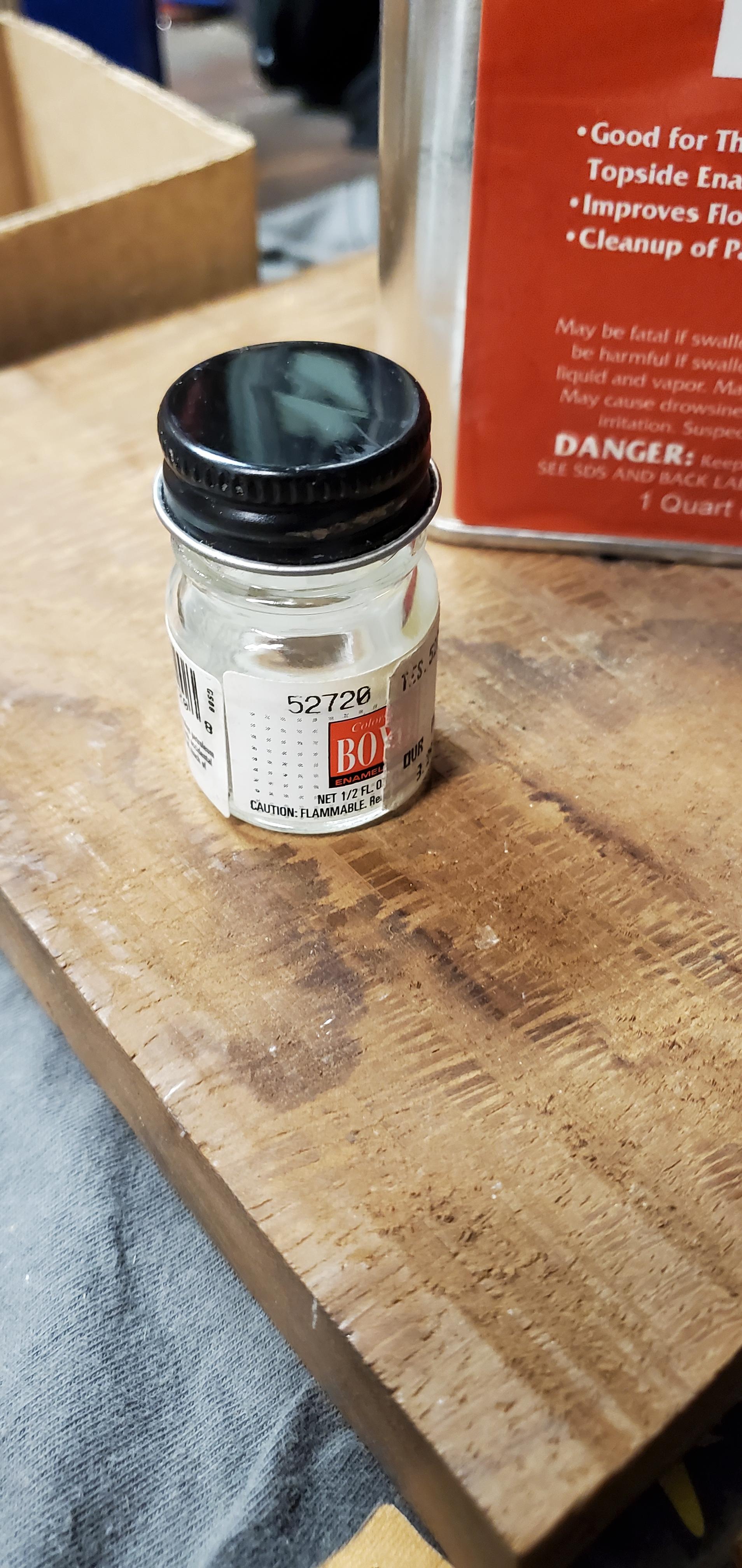

Steamboat Posted December 31, 2024 Author Posted December 31, 2024 2 hours ago, Dave G. said: If you take the little square bottle Testors enamel and empty it out into a mixing cup, there will still be paint residue in the bottle. Then re-fill that with the hardware store lacquer thinner, shake it up and pour into your container of paint you just poured out and stir together. It gives you just a tad short of a true 50/50 blend when all is mixed together. And it works perfectly. There should be no rough dry finish from airbrushing it, assuming shooting it moderately wet and a full wet last coat. With gloss paint, you should see yourself in the glass smooth finish. I shoot it up near 30 psi though, with the Paasche H #3 tip, even sometimes with the #5. You can do the same for lesser jobs using a pipette . Thanks for the tip. That's good advice. I will definitely try it with colors but I'm still a little leery about the cloudiness when I mix lacquer thinner with clear. Here's the clear I'm using. It's actually Boyd's by Testors. I've been playing around with the clear and this thinner that I got at the boat store and never used. It looks promising, but I only brushed it on so far. It's a little "oily" and has a longish cure time but dries with a good sheen.
johnyrotten Posted December 31, 2024 Posted December 31, 2024 I was curious and looked that up. It's a slow drying reducer, according to the one site I looked at. I'm not a painter or chemist, perhaps there's a difference between a reducer and an actual "thinner"? Could explain the cloudiness. I'd like to know myself, I've got 3/4 gallon of reducer in the garage.
peteski Posted January 1 Posted January 1 (edited) Your "thinner for marine coatings" does not mention on the label that it is a "lacquer thinner". Pick up a small can of actual lacquer thinner from a hardware store and test it out. Also different brands of lacquer thinners have different formulations, but generally they all work well with solvent-based enamels like Testors. Edited January 1 by peteski 1

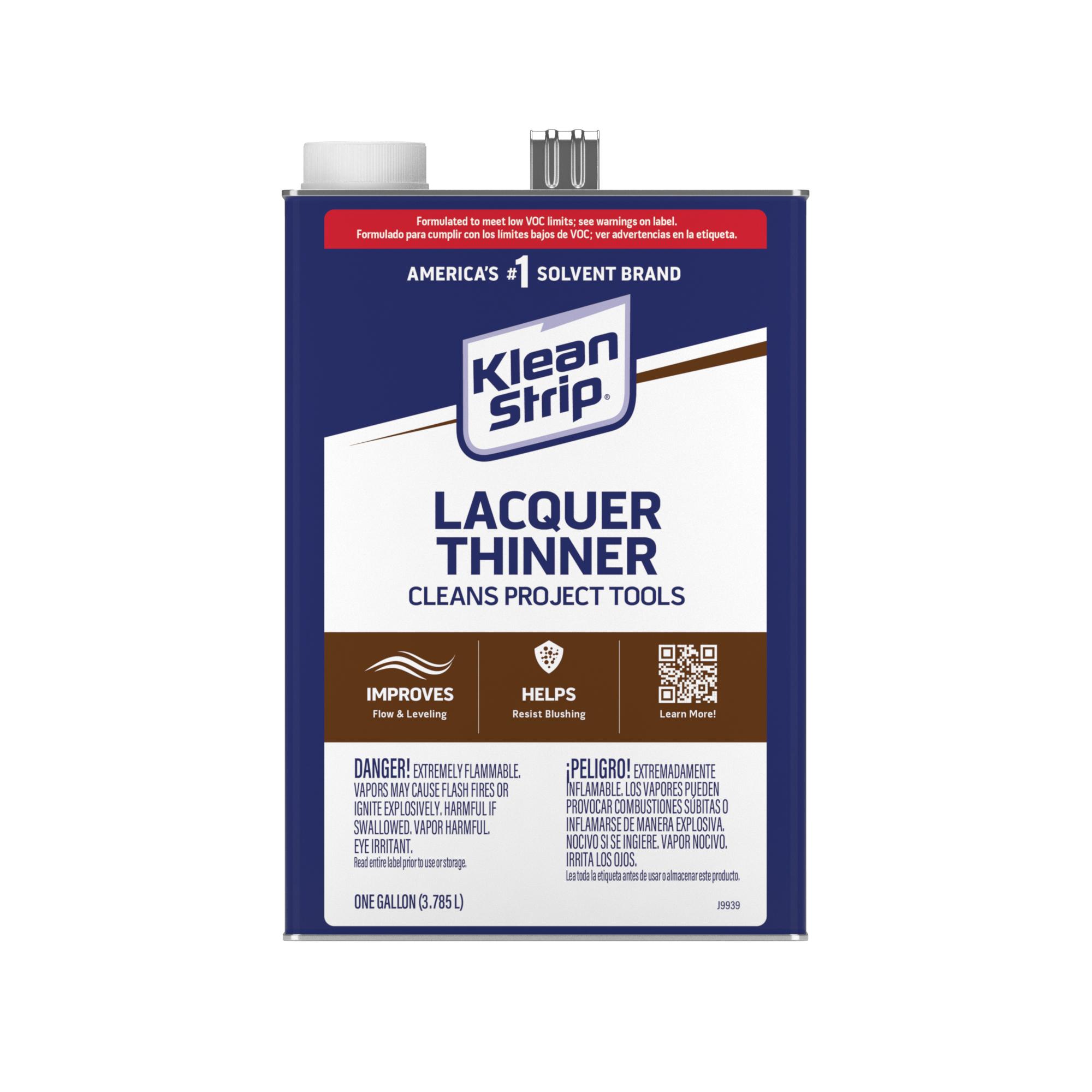

Dave G. Posted January 1 Posted January 1 Really my only concern about hardware store lacquer thinner being used in Testors square bottle paints, was to get the original blend lacquer thinner. Because as I said, around here there are two more blends in the same brand name. One being a fast dry thinner, really just designed for cleaning, the other the green friendly synthetic junk. The original in the brand I use is medium dry rate and works very well at a 50/50 or so ratio in Testors paints. Also to further thin decanted Rustoleum 2x paints for airbrushing.. It last I knew still came in the blue can with orange label area on the front. But the listing for medium dry used to be in the fine print, no longer there. But the fast dry says fast dry right on the front. Blue can, white label area. And if you can still find a can for $5, I envy you. I haven't seen $5 for the stuff in a decade.
Dave G. Posted January 1 Posted January 1 This is the green environmental stuff Then this is the original. If you can see the back label, around the second paragraph is a statement, with in which it says Medium Dry: 1
Dave G. Posted January 1 Posted January 1 21 minutes ago, Dave G. said: This is the fast dry. It California compliant according to the add. In that case, it's probably mostly acetone.
