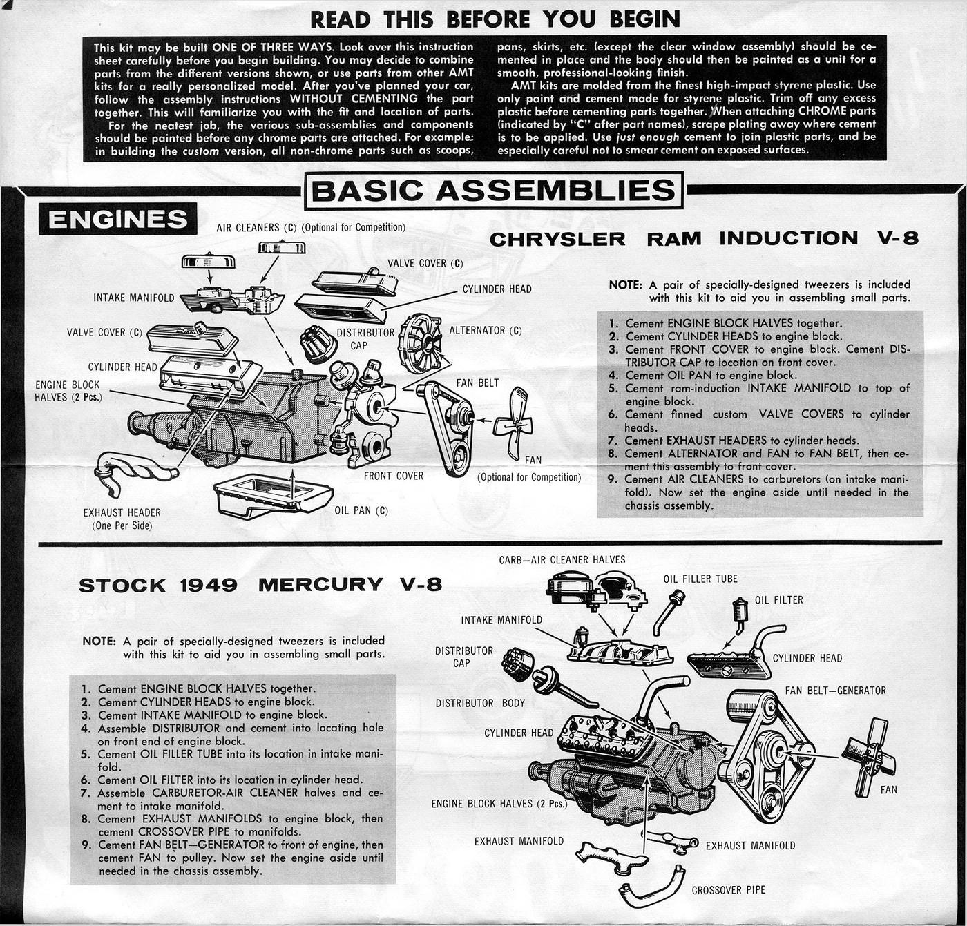

blizzy63 Posted January 5 Posted January 5 (edited) 3 hours ago, bobss396 said: Wasn't the Mopar engine in the AMT '49 Mercury a 413? Yes. A 1962-63 Chrysler Ram Induction/Max Wedge 413/426. Edited January 5 by blizzy63 2
1972coronet Posted January 5 Posted January 5 I totally forgot about that engine ! Though its rocker arm covers aren't stock, they're quite unique and are nicely replicated.

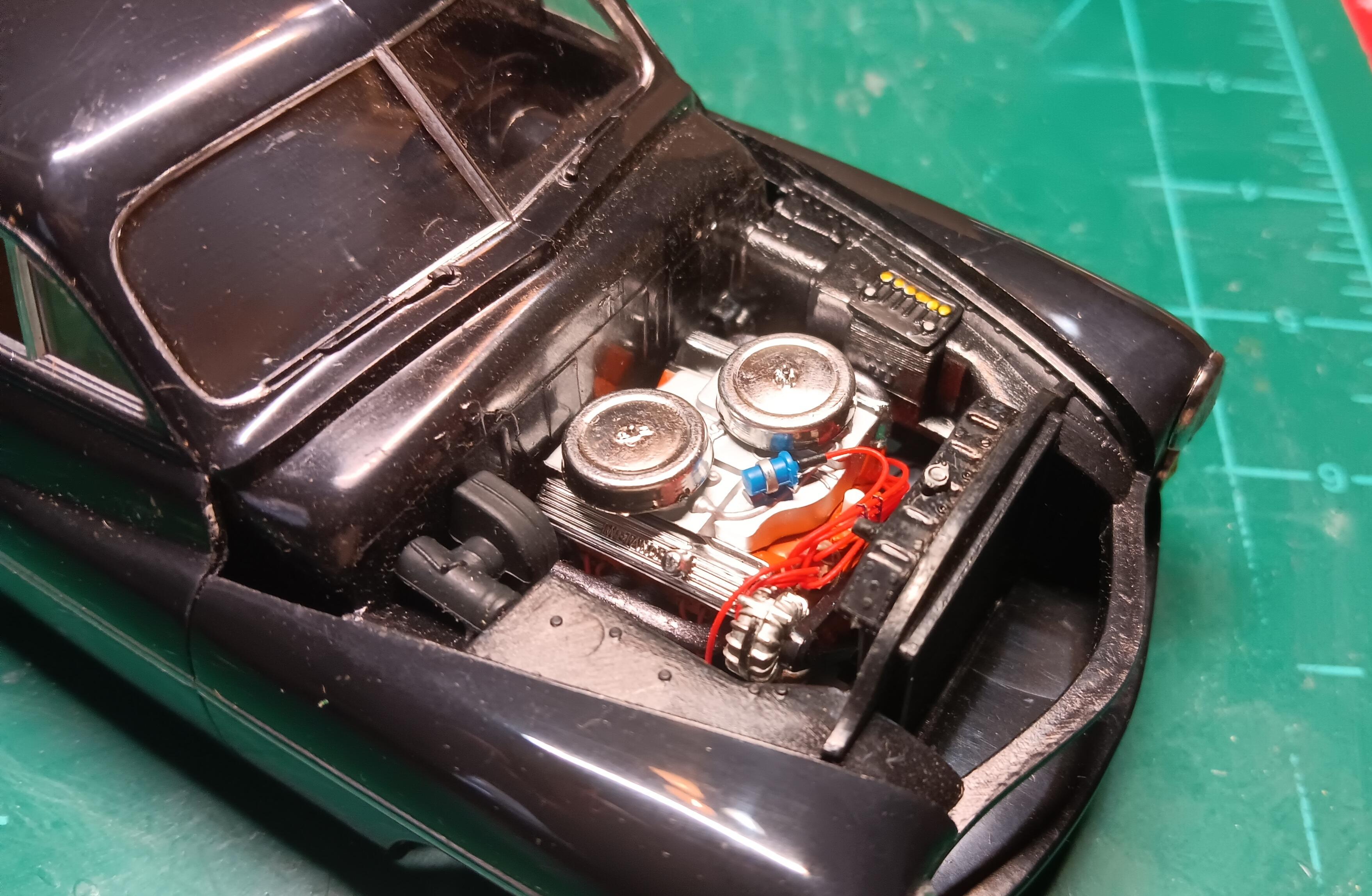

bobss396 Posted January 6 Posted January 6 I'm "restoring" an OG 1949 Mercury now that has the 413 in it. It does build up nicely.

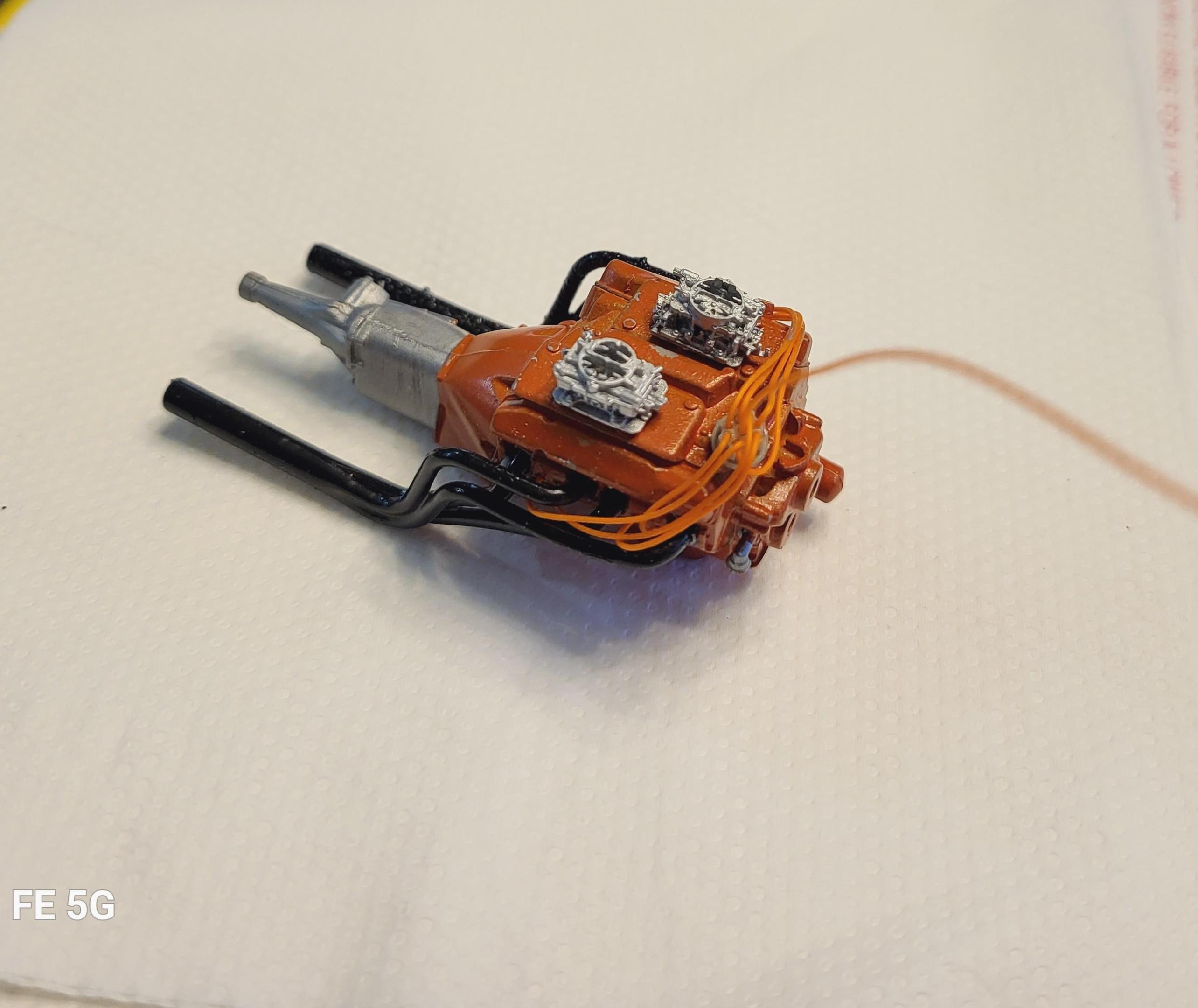

bobss396 Posted January 7 Posted January 7 This is the 413 in my current Mercury rebuild. I have done nothing to the engine, it was already decently build with wires added to it. 1
