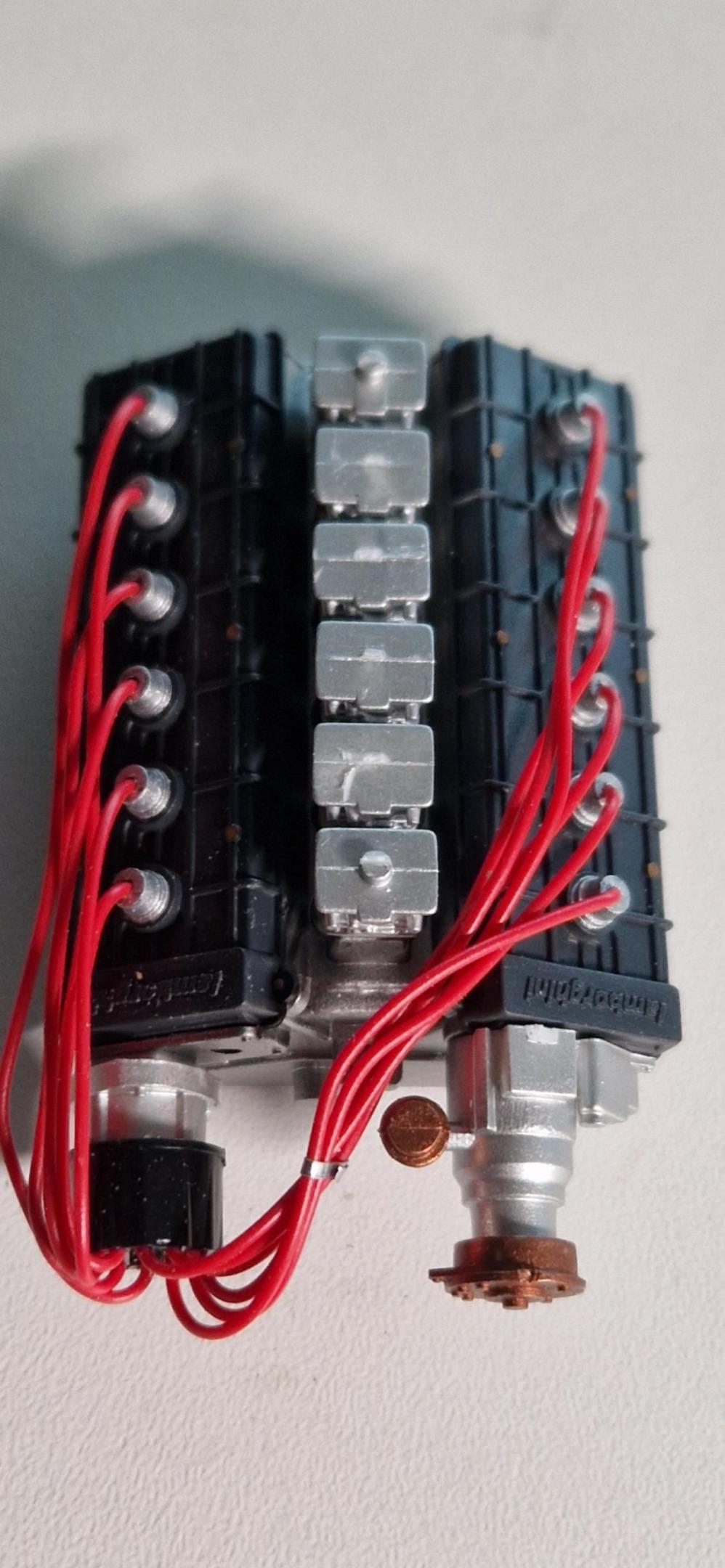

Evening, it goes on here of course.
But unfortunately not a single part of this kit fits. A lot of adjustment work is necessary and really holds up.
Nevertheless, here is a sample for you.
There were already a few cables.
