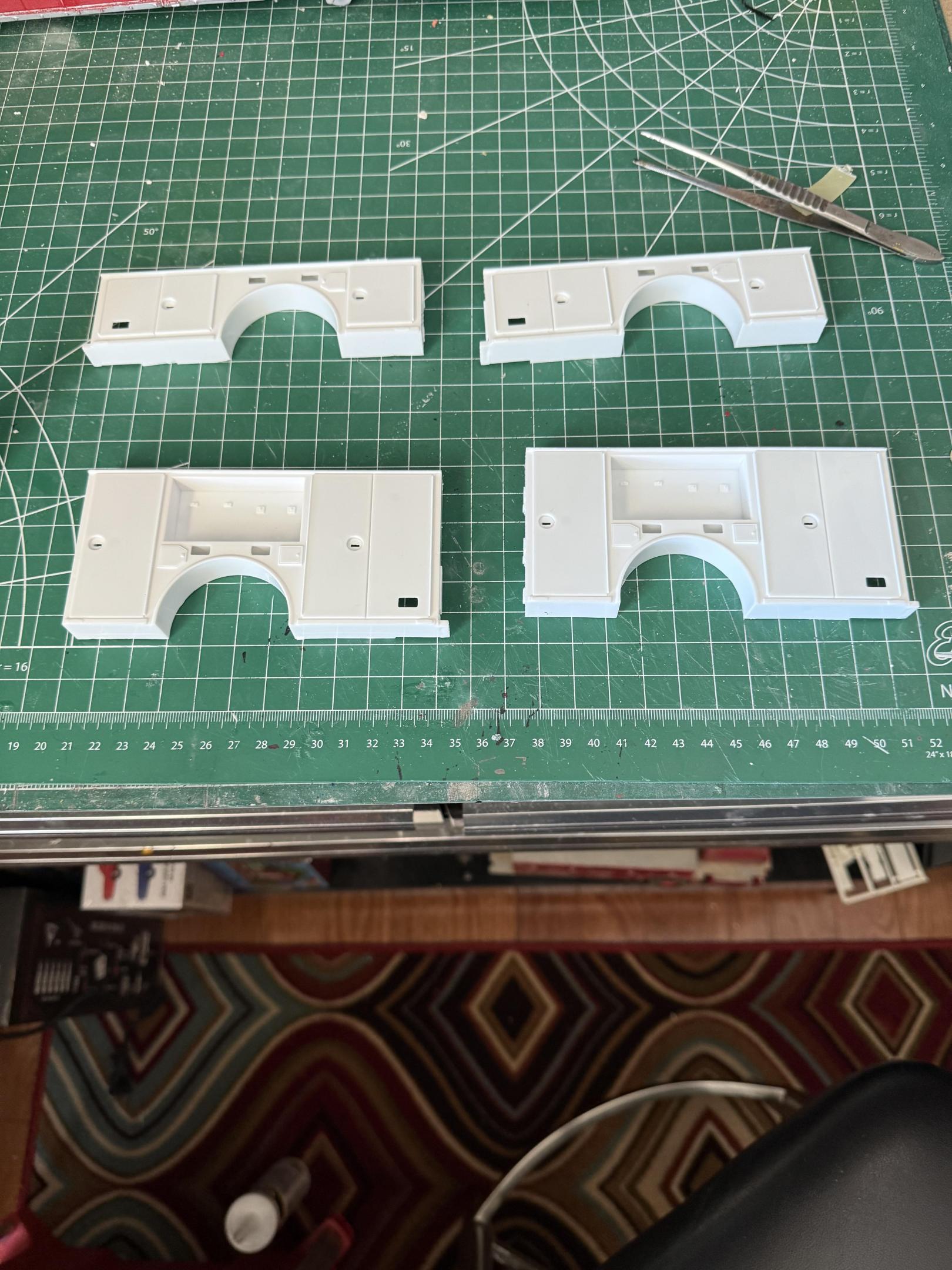

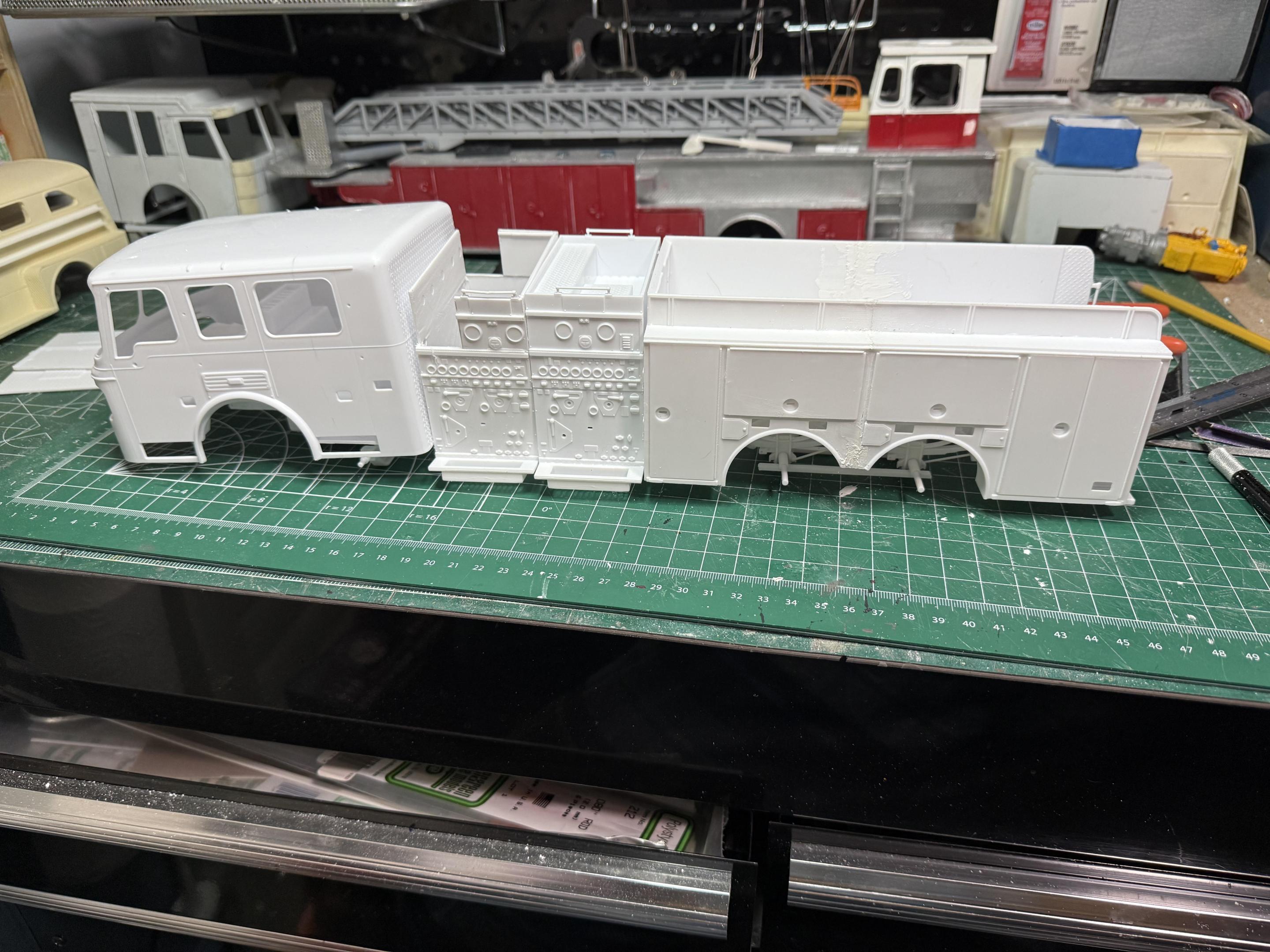

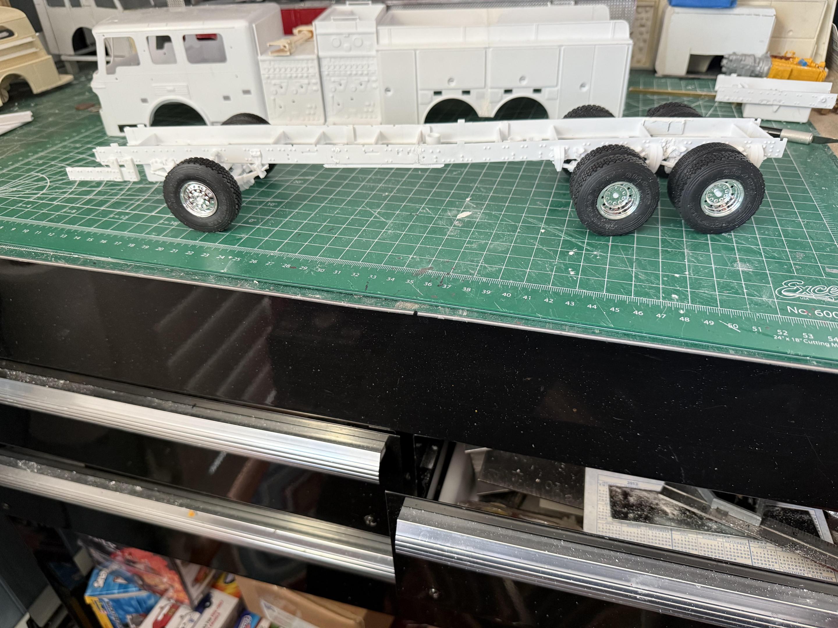

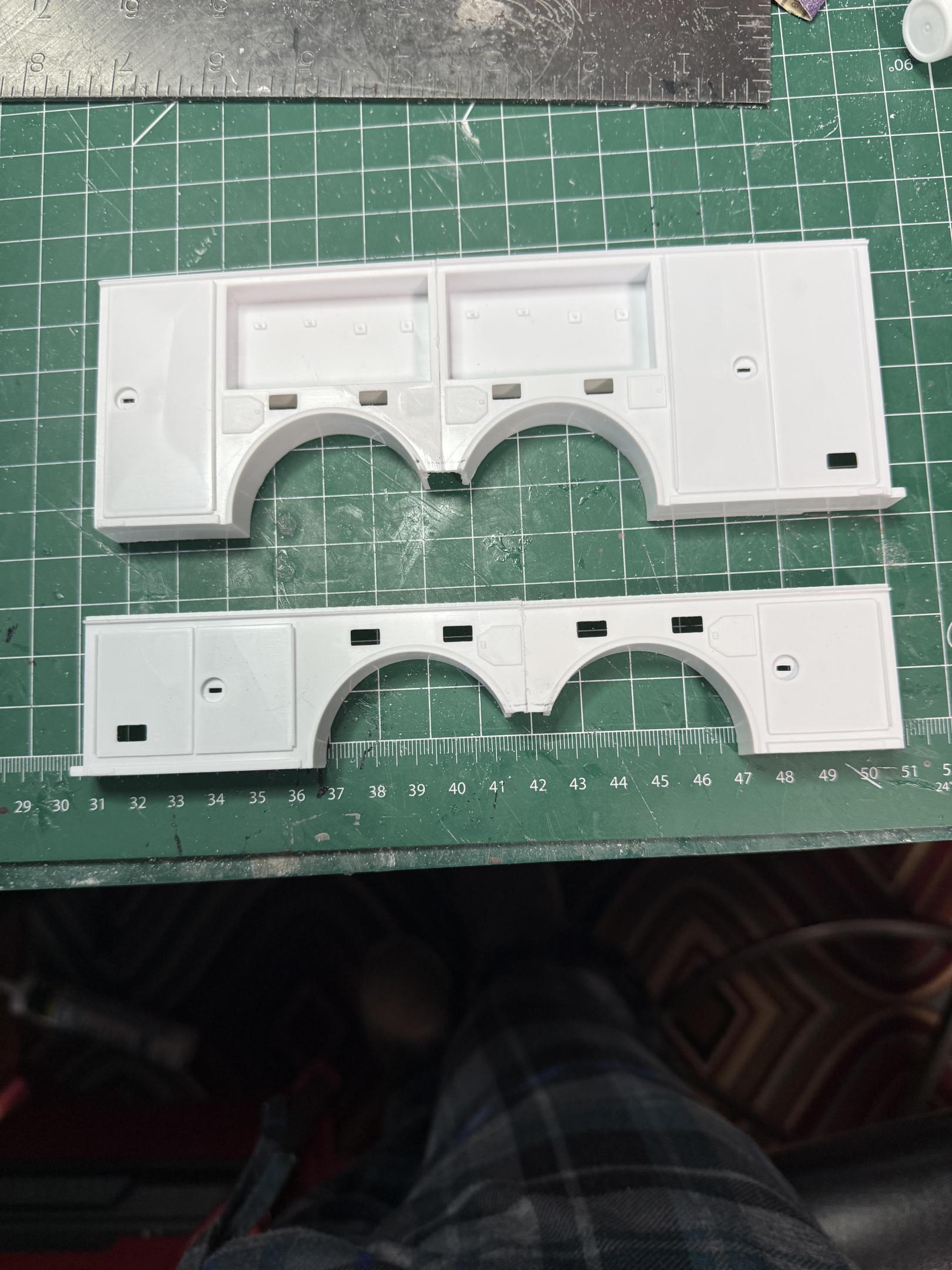

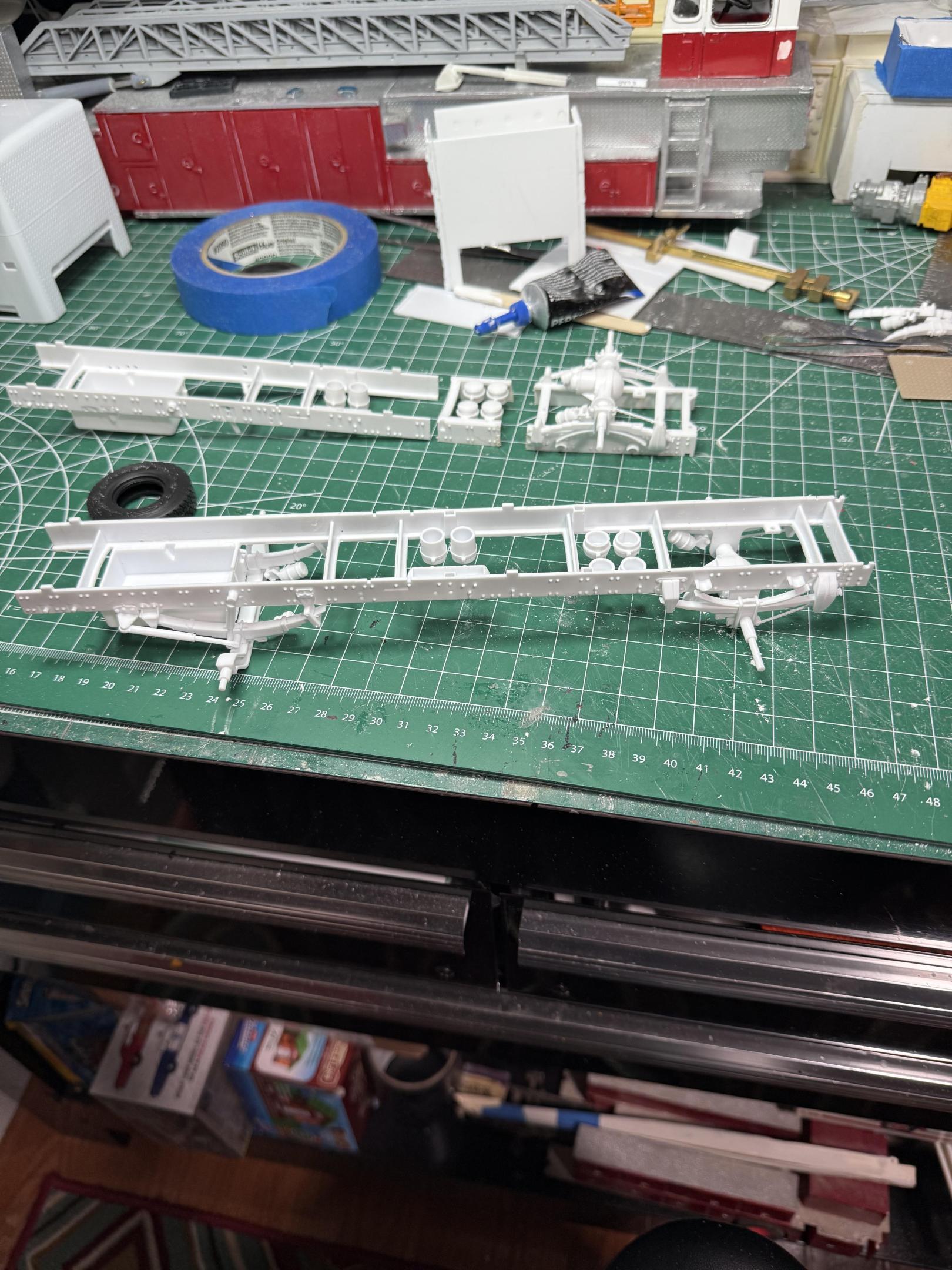

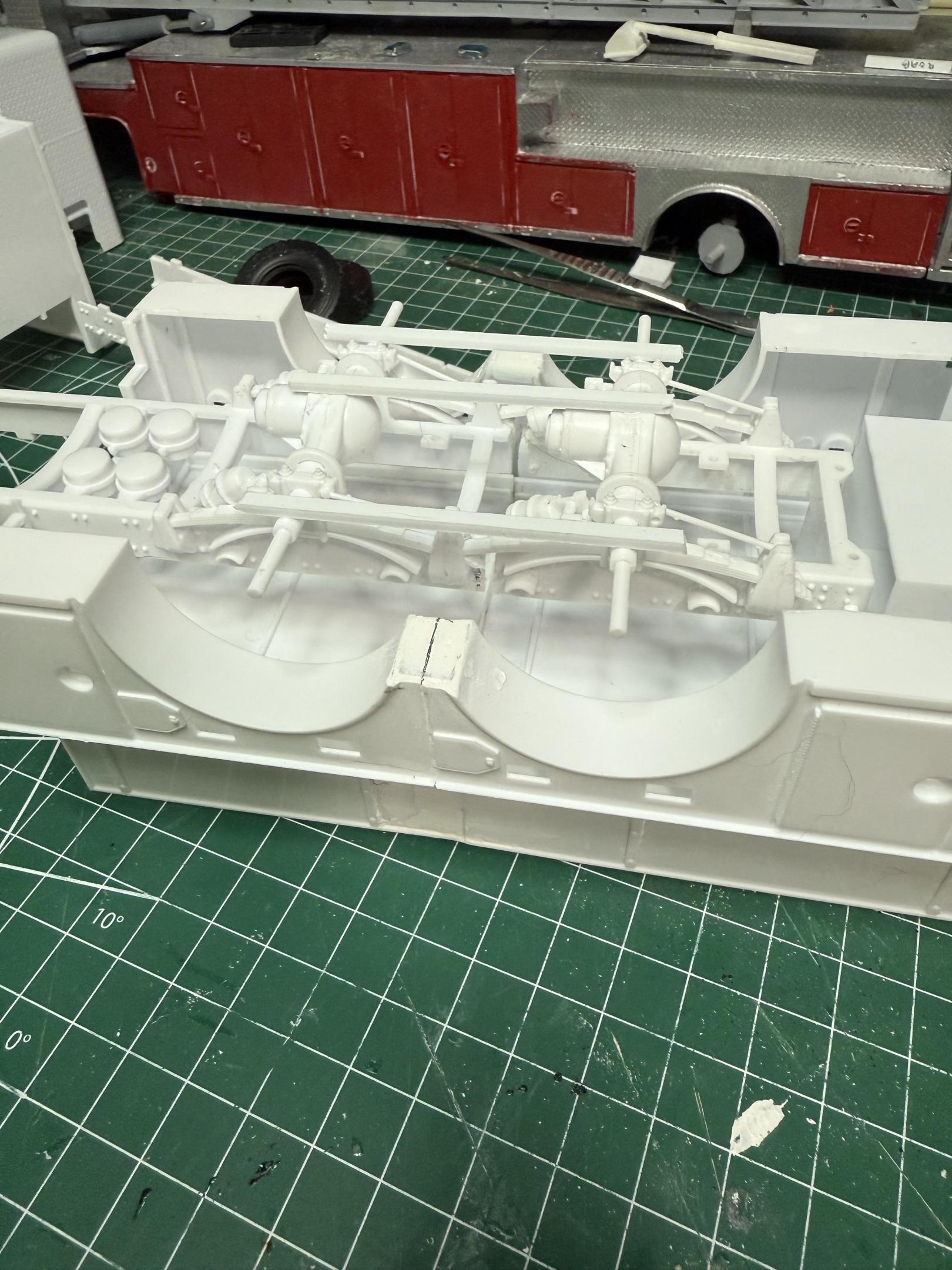

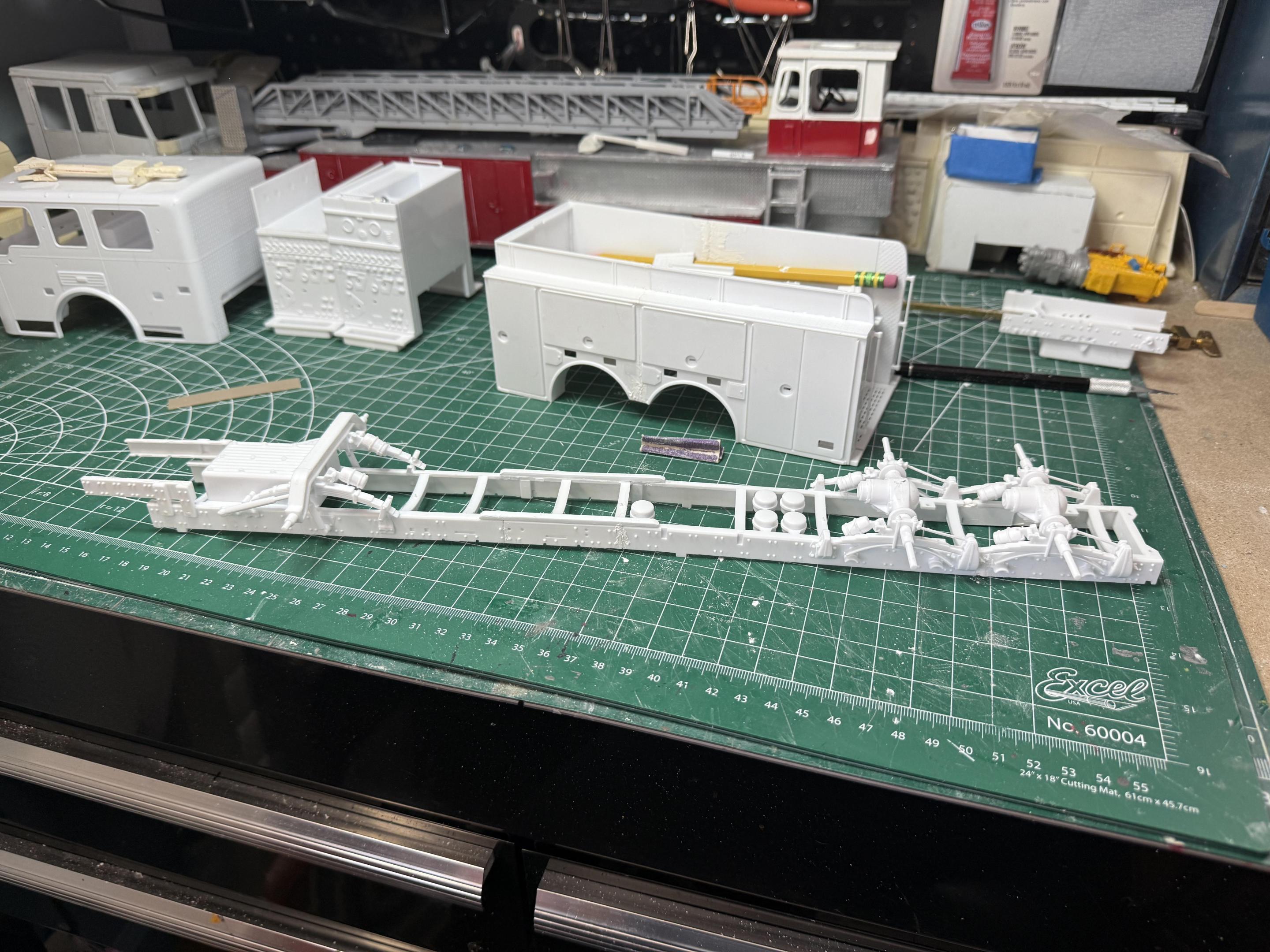

Firebuilder Posted January 10 Posted January 10 I am back at the bench, this will mostly be a kit bash, with a few scratch built parts. I started by combining 2 of the trumpeter ALF eagle kits. The cabinets and hose bed were sectioned and glued together to make a tandem wheel opening. There will be both pump panels used. The chassis has been stretched by cutting and combining the frames from both kits and the tandem rear axles installed. Have a basic idea of what I am going for after seeing a few pictures of industrial rigs. Need to figure out a color combination for this also. These kits only come with a partial transmission and no motor. Not sure what to do about that, or what would even fit the frame and floor pan height. 3

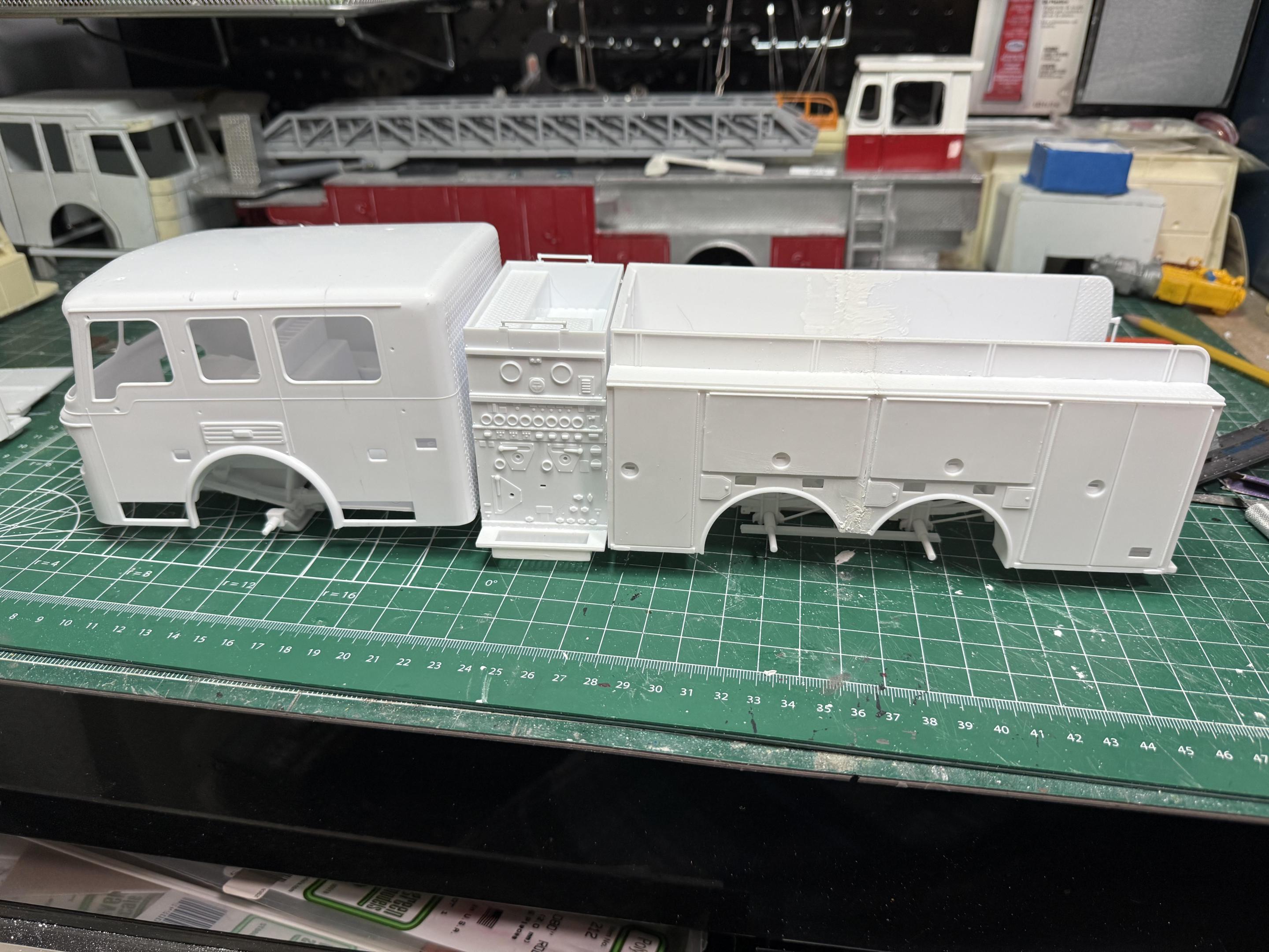

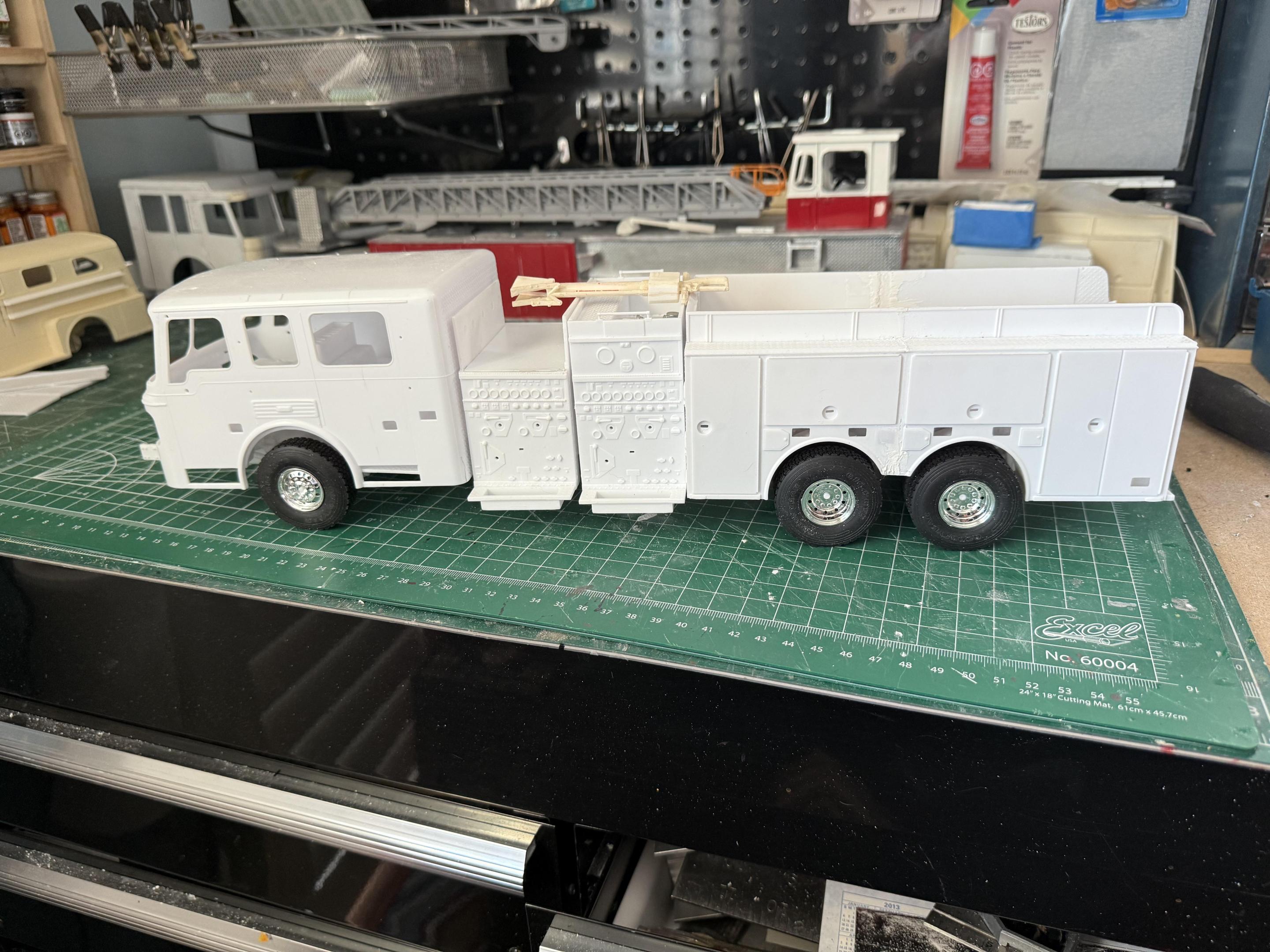

Firebuilder Posted January 11 Author Posted January 11 15 hours ago, gotnitro? said: Awesome looking build ! I'm planning a Quint using the ALF after the rescue truck. I'm definitely watching Jeff, here is a pic without the double pump, my first idea was to make this into a pumper/tanker. All you would have to do is add a place for the out riggers/ stabilizer’s 1

gotnitro? Posted January 11 Posted January 11 That looks so good as a tandem! Entire truck balances visually better

Chariots of Fire Posted January 12 Posted January 12 I was going to ask about the double pump panels. Just MHO but I think the single one looks better and is more prototypical. Nice job putting the two bodies together to form the tandem axle version. Most difficult part of that is hiding the joint between the two pieces! 1

Firebuilder Posted January 13 Author Posted January 13 On 1/11/2025 at 4:52 PM, gotnitro? said: That looks so good as a tandem! Entire truck balances visually better Agreed , it adds a lot to the overall kit, and it opens up a lot of possibilities for other apparatus.

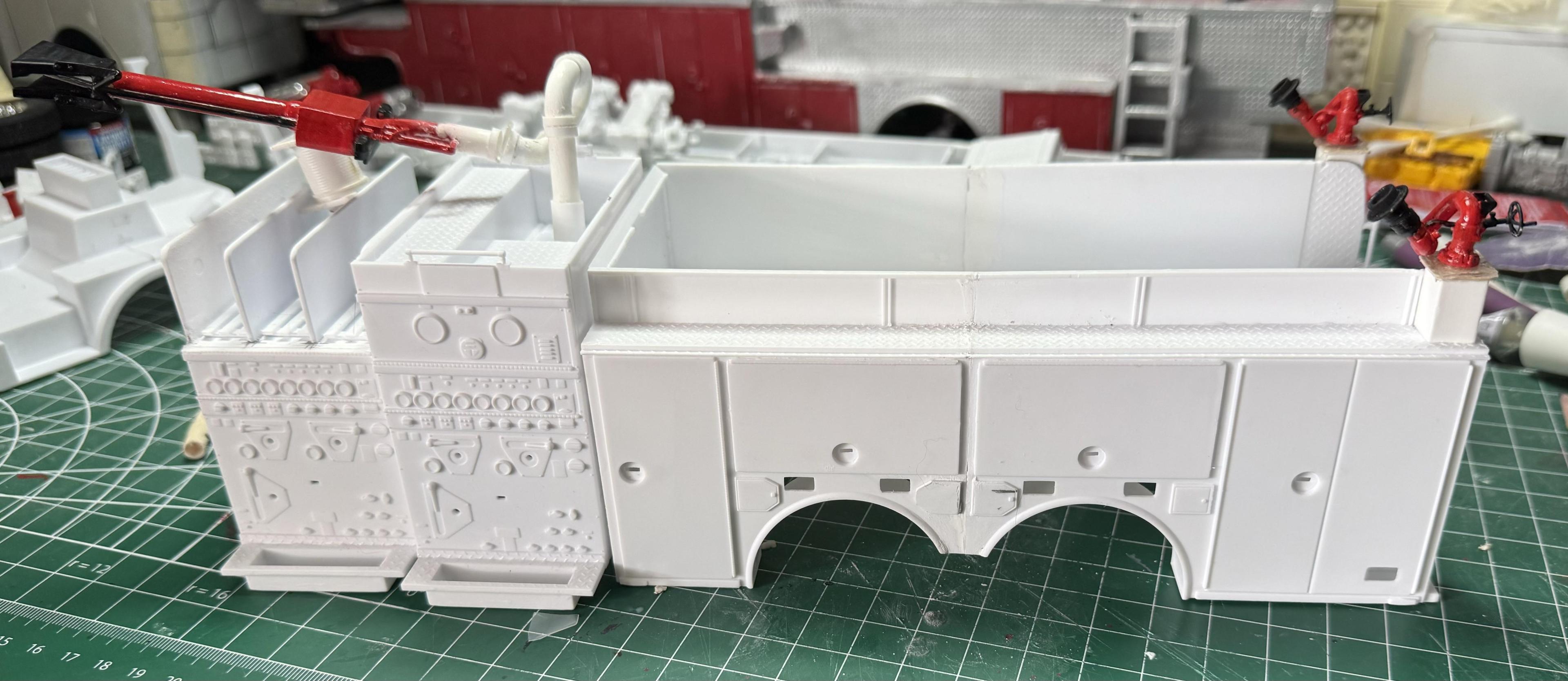

Firebuilder Posted January 13 Author Posted January 13 4 hours ago, Chariots of Fire said: I was going to ask about the double pump panels. Just MHO but I think the single one looks better and is more prototypical. Nice job putting the two bodies together to form the tandem axle version. Most difficult part of that is hiding the joint between the two pieces! Charles, thank you, I was pleased with how the body came out. I cut as carefully as I could and the seams were very close. Once the putty is sanded they should be mostly invisible. The reason for the dual panels is that most of today’s industrial pumpers can pump 5,000 + gpm at draft, and over 10,000+ gpm from a pressurized source. Here are some of the pictures I based the pump panel off of, they are way oversized . A lot are top mounts panels also. I went with the kit pump panels being I don’t think I have the patience, or the skill to make my own pump panel from scratch. Dom

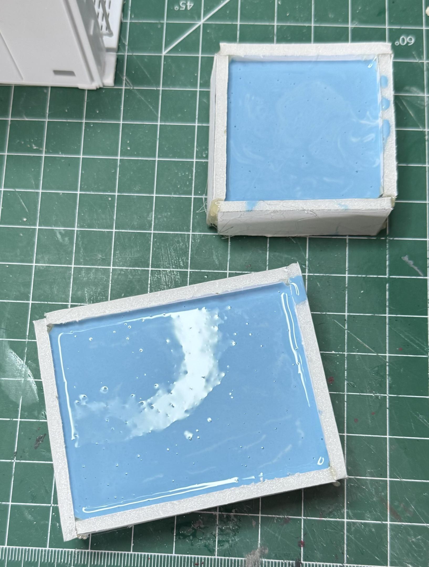

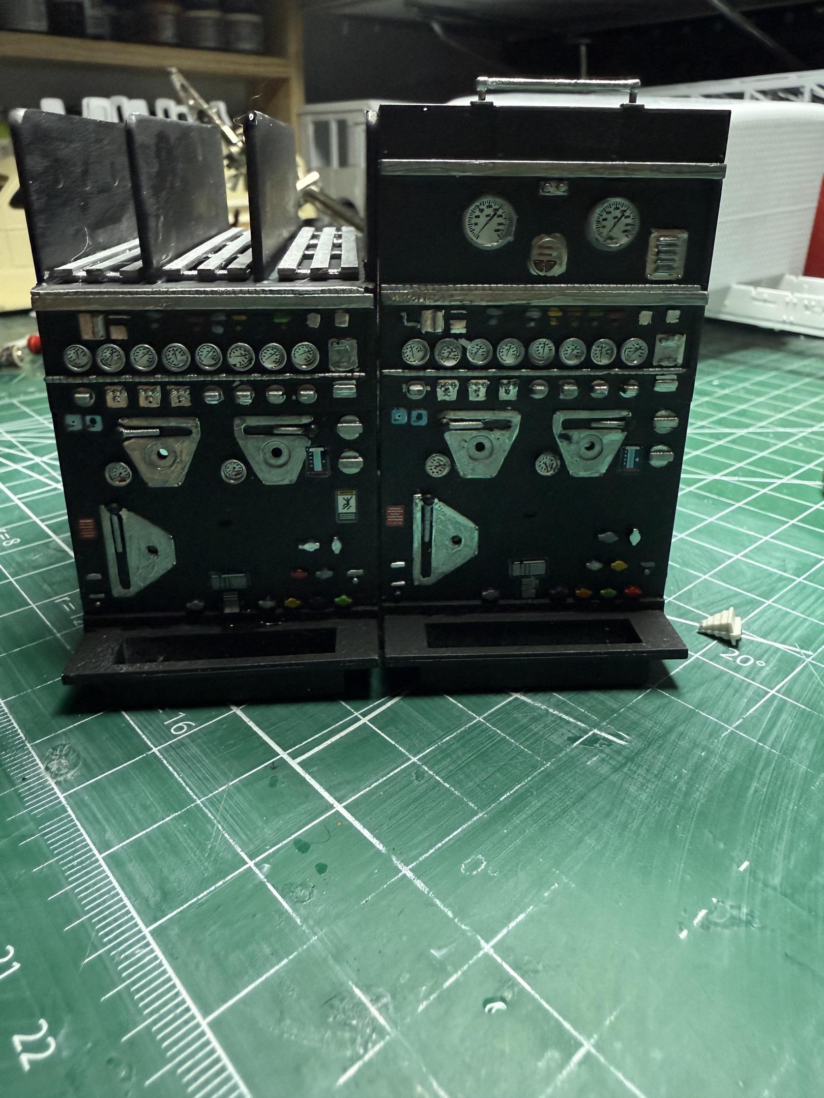

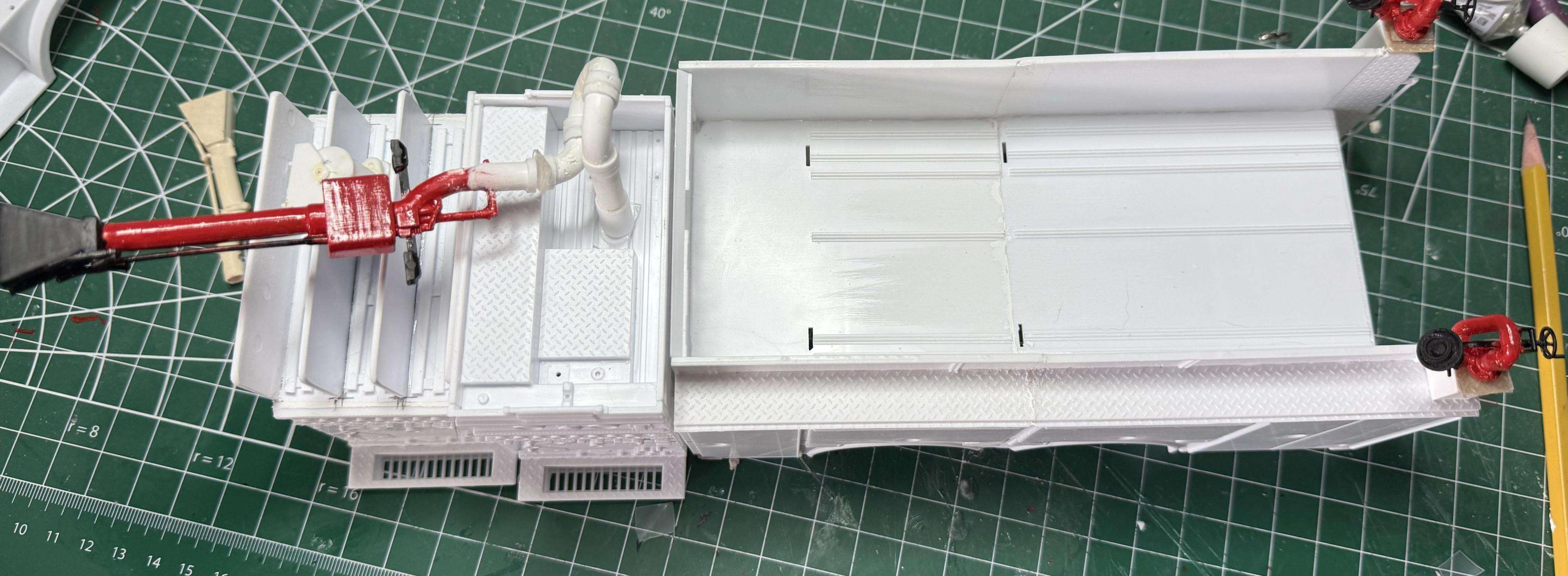

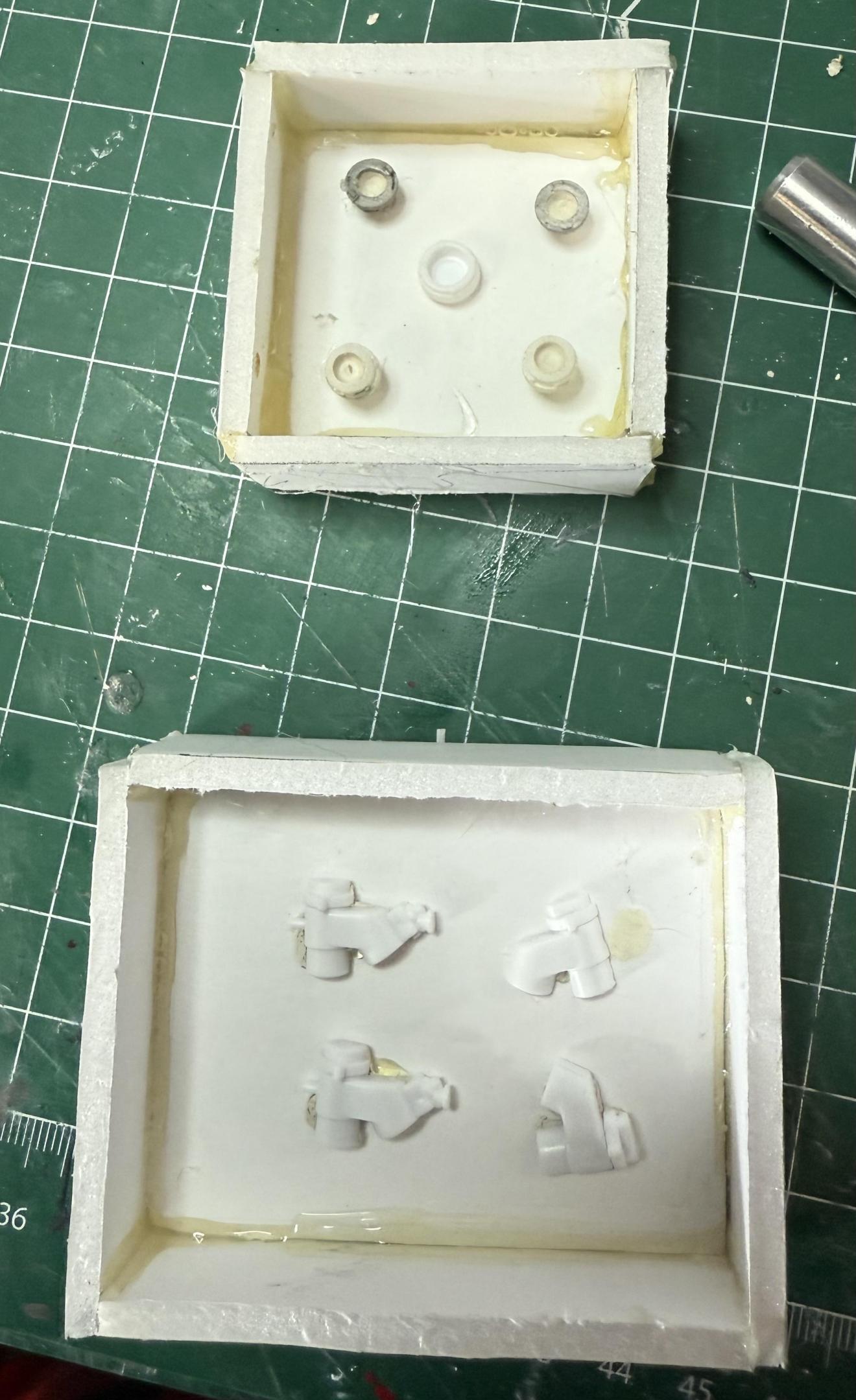

Firebuilder Posted January 13 Author Posted January 13 I did a mock up of the pump panel and deluge, deck guns. I think the one above the pump may to to large. So I may go with a smaller one that I have. I also made the piping for it from Plastruct elbows and some tubing. The pump panel area will have three 2 1/2 inch hand lines. I made a mold to cast some of the parts I will need multiples of. Will see how they come out once cured. Dom 3

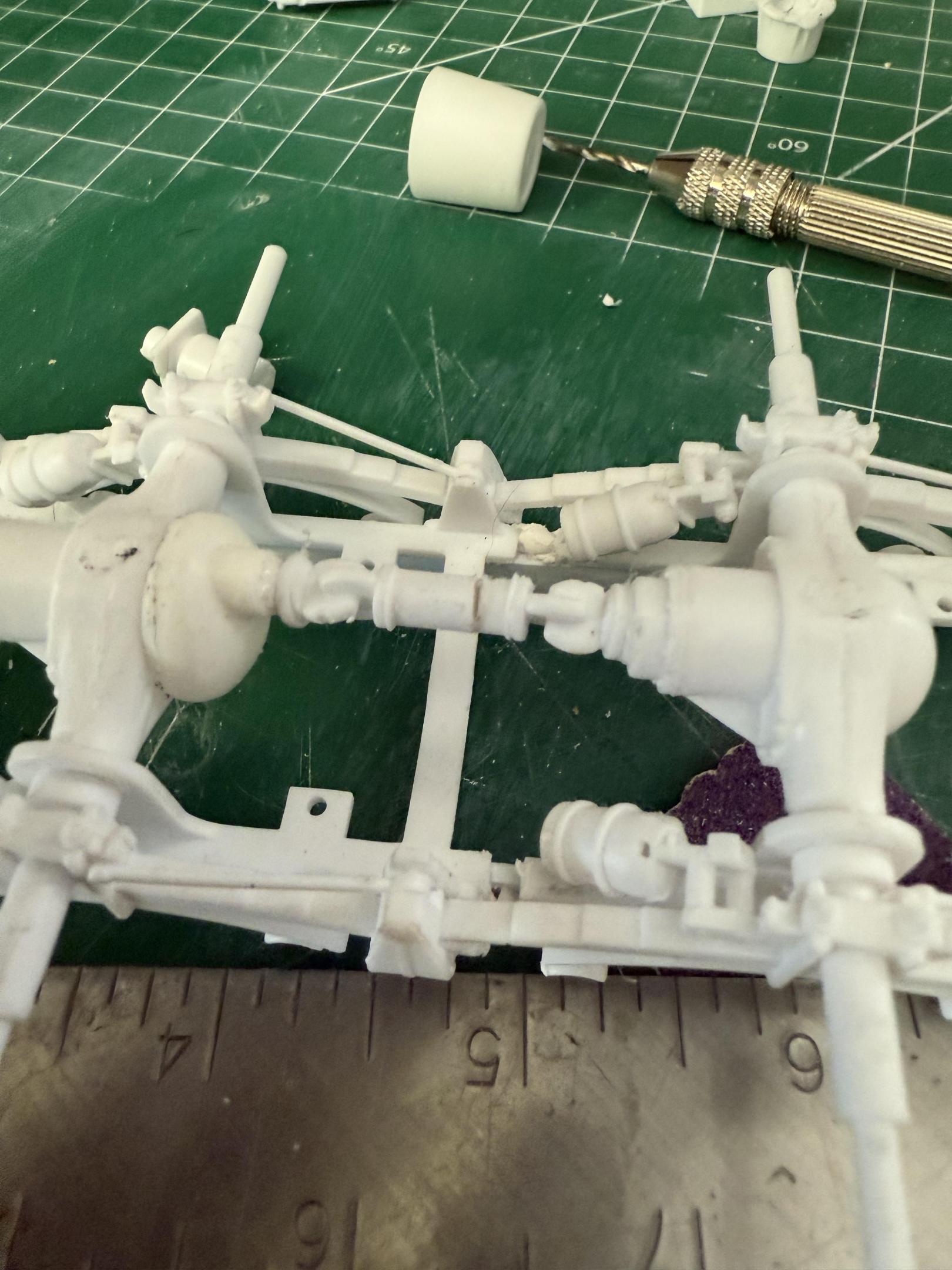

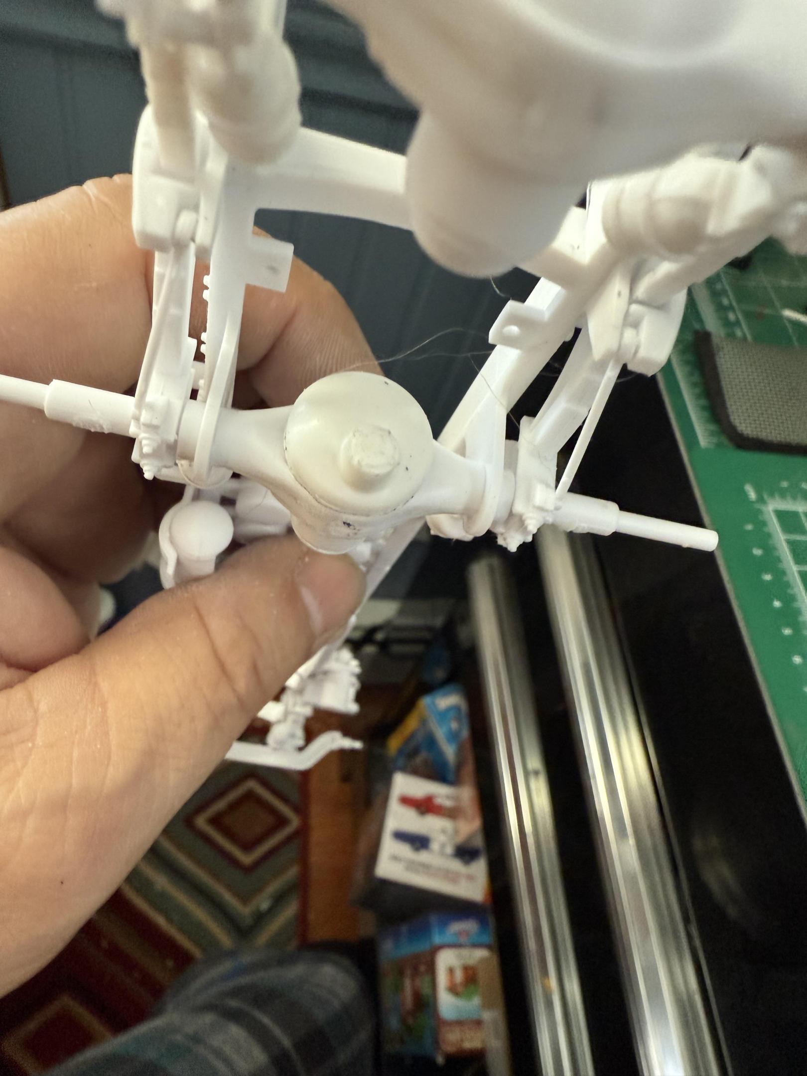

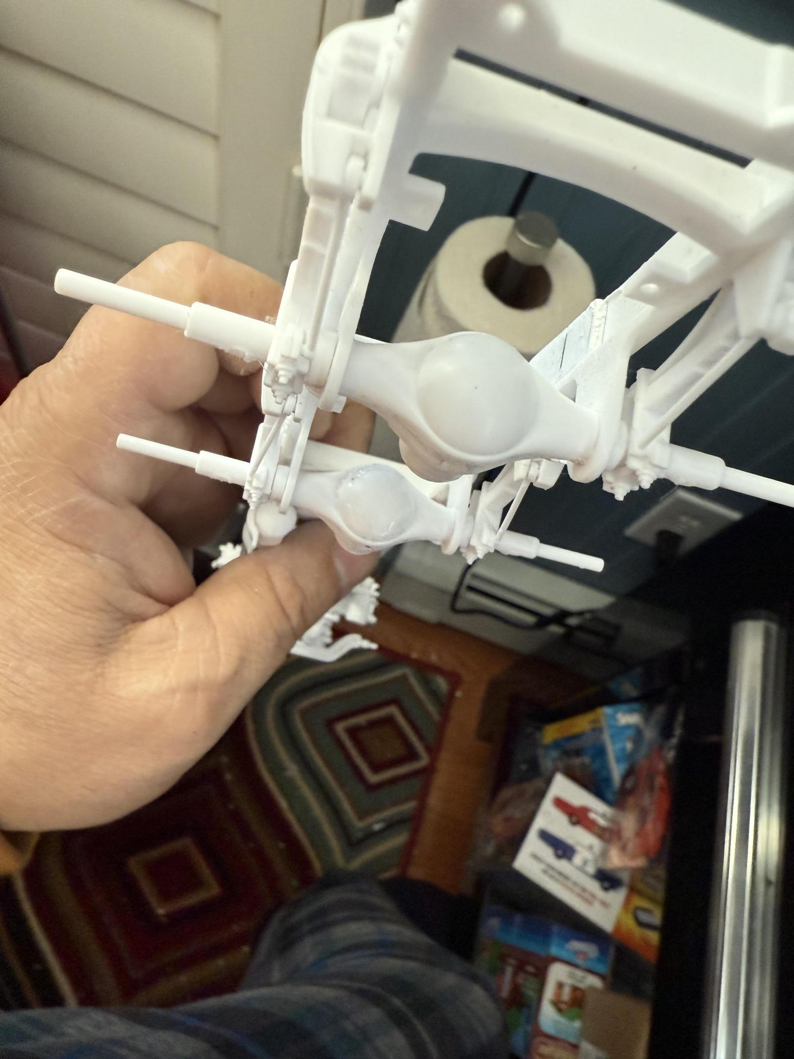

Firebuilder Posted January 19 Author Posted January 19 (edited) Some work has been started on the pump panel. Still need to make the intake and discharge fittings. Also made a mold for the rear axles housing from and old axle half I had in my parts bin. It fit perfectly over the kit axle and allowed me to add the drive shaft for the tandems. Have to do some sanding and clean on the frame. Then on to paint. Edited January 19 by Firebuilder 1
