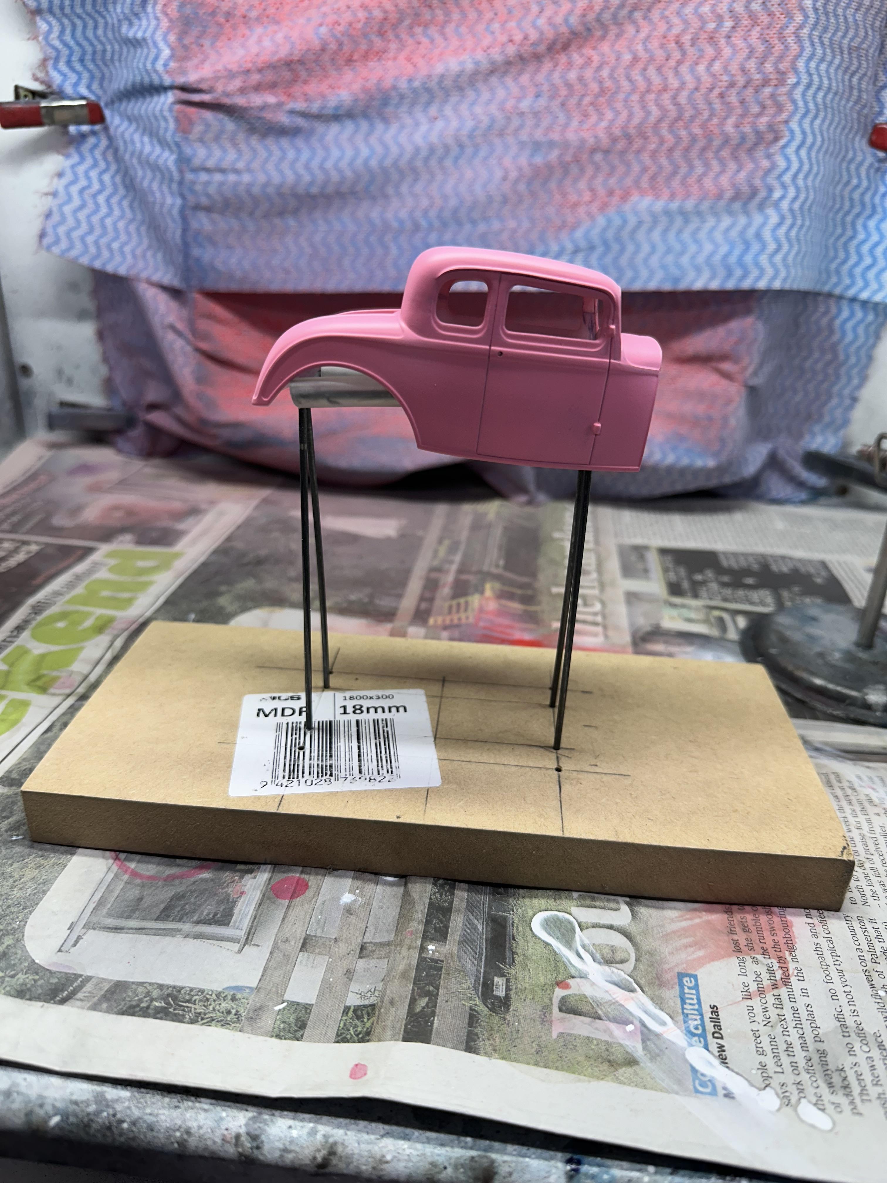

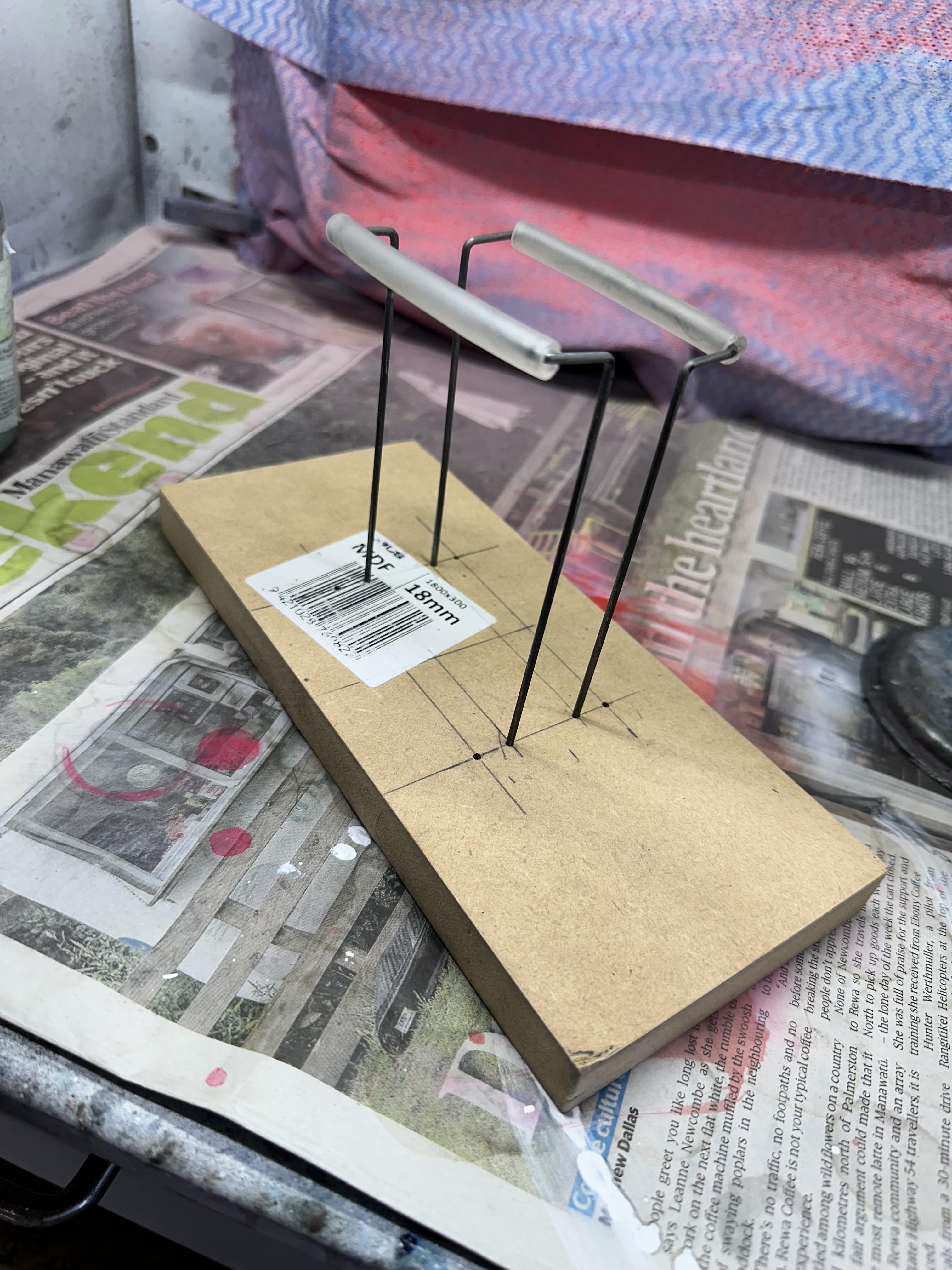

bill-e-boy Posted January 10 Posted January 10 My latest shot at making a body holder Materials - - 2mm piano wire - customwood Base - cut to suit - mine was a piece as found - Silicone tube - found and is about 1/4"od I have used piano wire as this is easy to get from a model shop and has a lot of spring, and it is quite hard. Bend up the piano wire - I used a vise and a soft hammer and cut to length. Unbent legs were 130mm and top is 75mm. Return is about 15mm. The ends have been cleaned up to allow ease of changed holes to suit body. The slicone tube is slid over the tube and is cut at 75mm I set out for drill 2mm holes on a 20 and 40mm wide spacing Body holder as made In use holder with a body fitted - in this case a 1/25th 32 coupe. Note 20mm spacing holes are being used And a very, very old and well used holder ready to be chucked out. Was made from coat hanger wire which is too soft IMO. The point contact did not always hold the body steady when in use 5

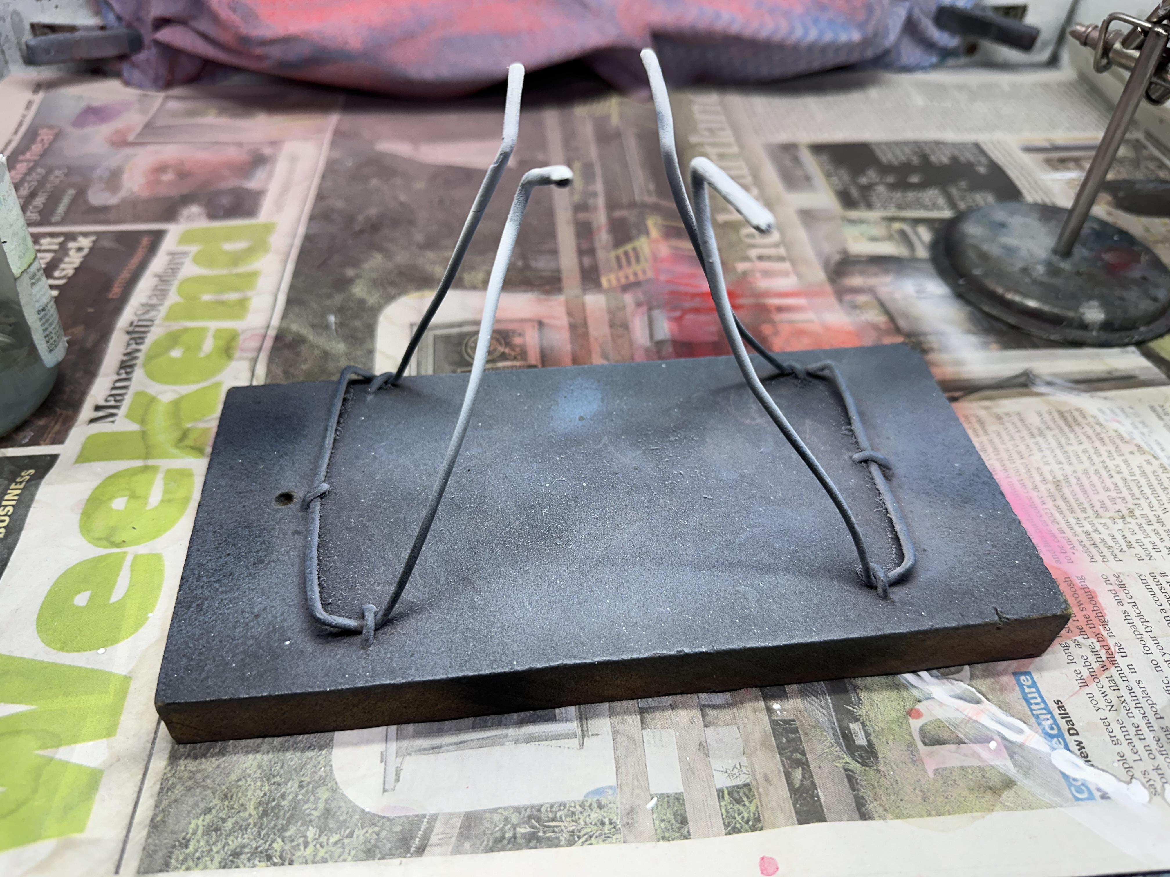

StevenGuthmiller Posted January 11 Posted January 11 Here's mine. Been using the same one for probably 20 years. Time involved to create.....30 seconds. Cost....$0.00. Steve 5

StevenGuthmiller Posted January 11 Posted January 11 37 minutes ago, bill-e-boy said: Steve, I used to use ones like that too, but wire coat hangers are rather rare around our place. Like everything they have turned into plastic BAH! That’s why I’ve been hanging on to this one! 😁 Steve 1

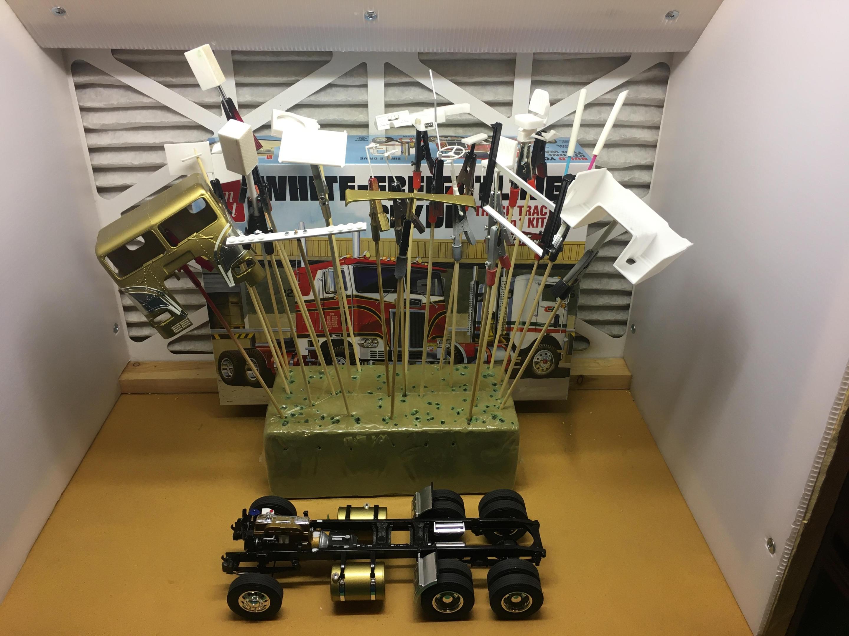

Bills72sj Posted January 12 Posted January 12 I have two of those Tamiya rotating/spring loaded stands. Rarely use them. I take a piece of really thick sprue and sand the end flat. I then CA glue it to the headliner where a dome light would be. I have some alligator clips on a bunch of bamboo skewers. That way I can hold the body and get every surface perfectly coated as I can rotate and tilt it in my hand. Between coats, I just poke it right above the paint booth in the corrugated plastic that I made my booth out of. 1
