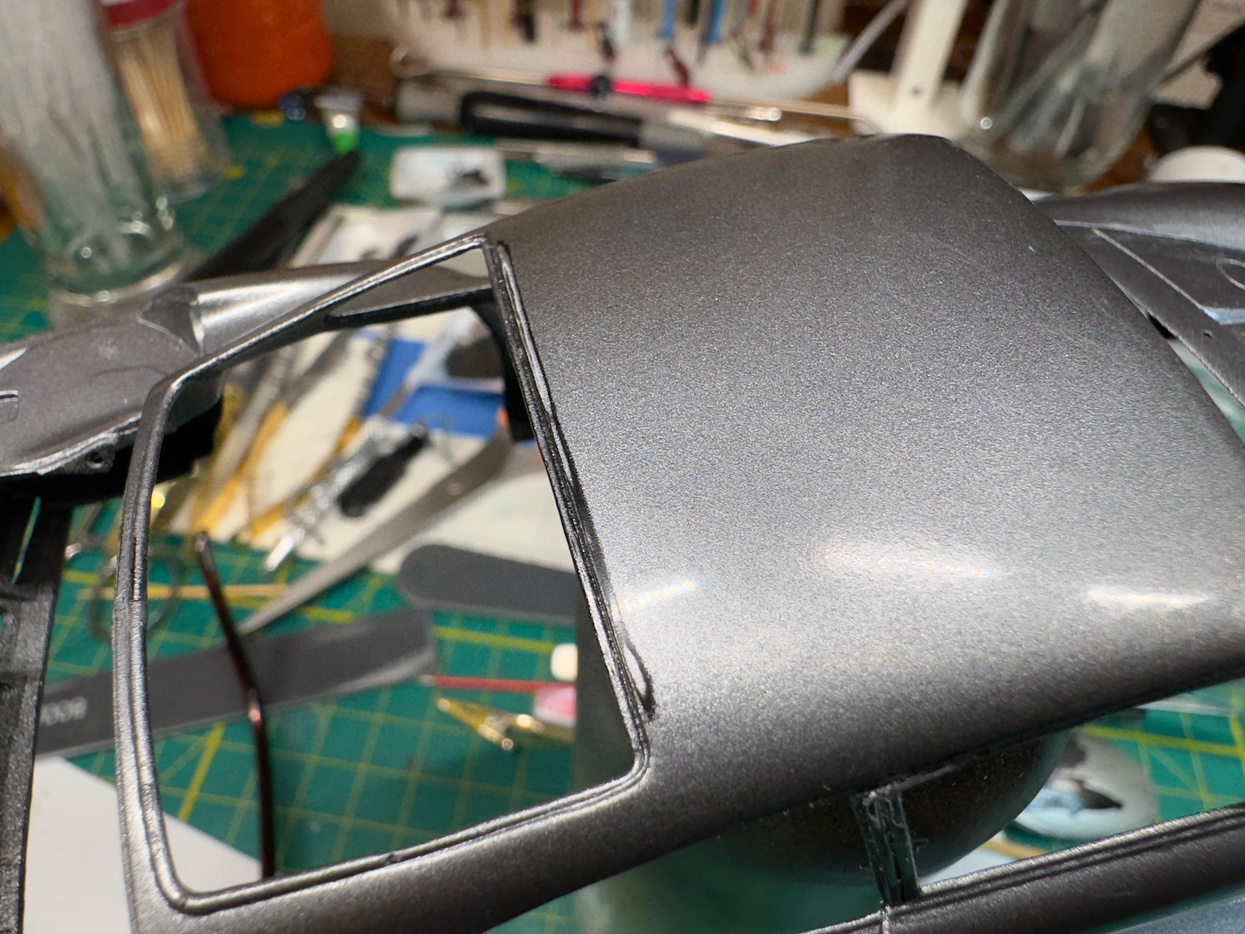

A fly landed and, not something I usually do, I swatted at it. It was on the other side of the 959 shell on my desk. The underside of my forearm came down on the roof of the car and, before I even intended to start on it, I broke the B and C pillars at their tops, and creased the A pillar. You will see in various photos the size of the B pillar grow in girth from more than five repairs. Then, finally, I scraped it down and did it right. Amazingly, the bottom part of it never separated from the door. That was 2 June, for reference.

#1 - Somehow I missed that I hadn't completely erased the parting lines until I'd primed it the second time.
So I had to do this. What you see on the fender is primer on top of silver gray on top of primer. And in the middle of it all is putty because I had wrecked the shape of the fender.
#2 - After putting a coat of the color down, I still hadn't erased the lines. This is the vision thing. It sucks. What really helped me decide to repaint it was that the engine cover looked noticeably different than the bulk of the body. The two remaining cycles of painting were done with the cover on the car so I could know it was getting exactly the same treatment as the rest of the body.

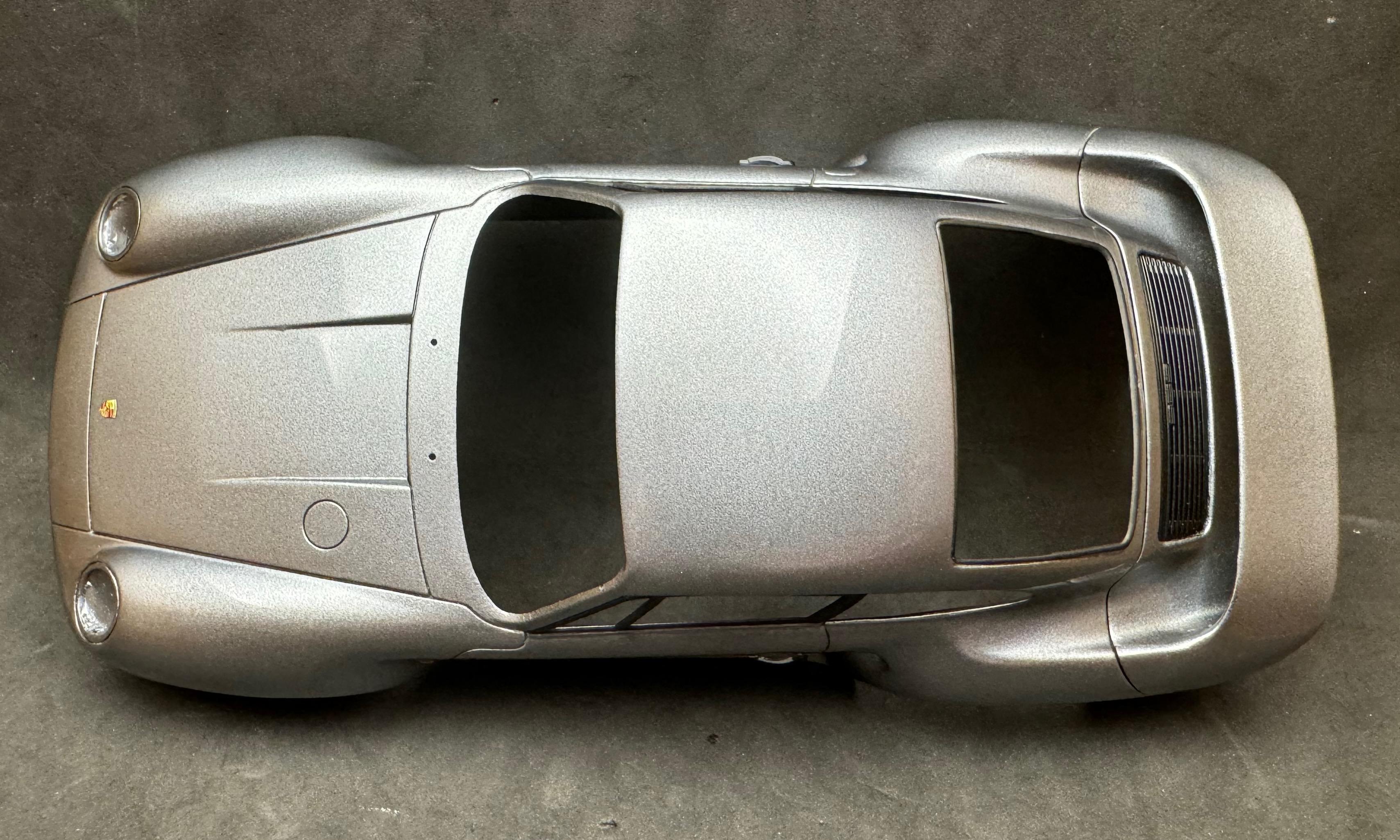

This is the final product, as it is today. The headlamps are a mess.
Three complete paintjobs piled on top of each other. And my only regret, besides the headlamp bezels, is that I stopped at two coats of color. The roof, which has a fourth coat, has a much tighter grain.

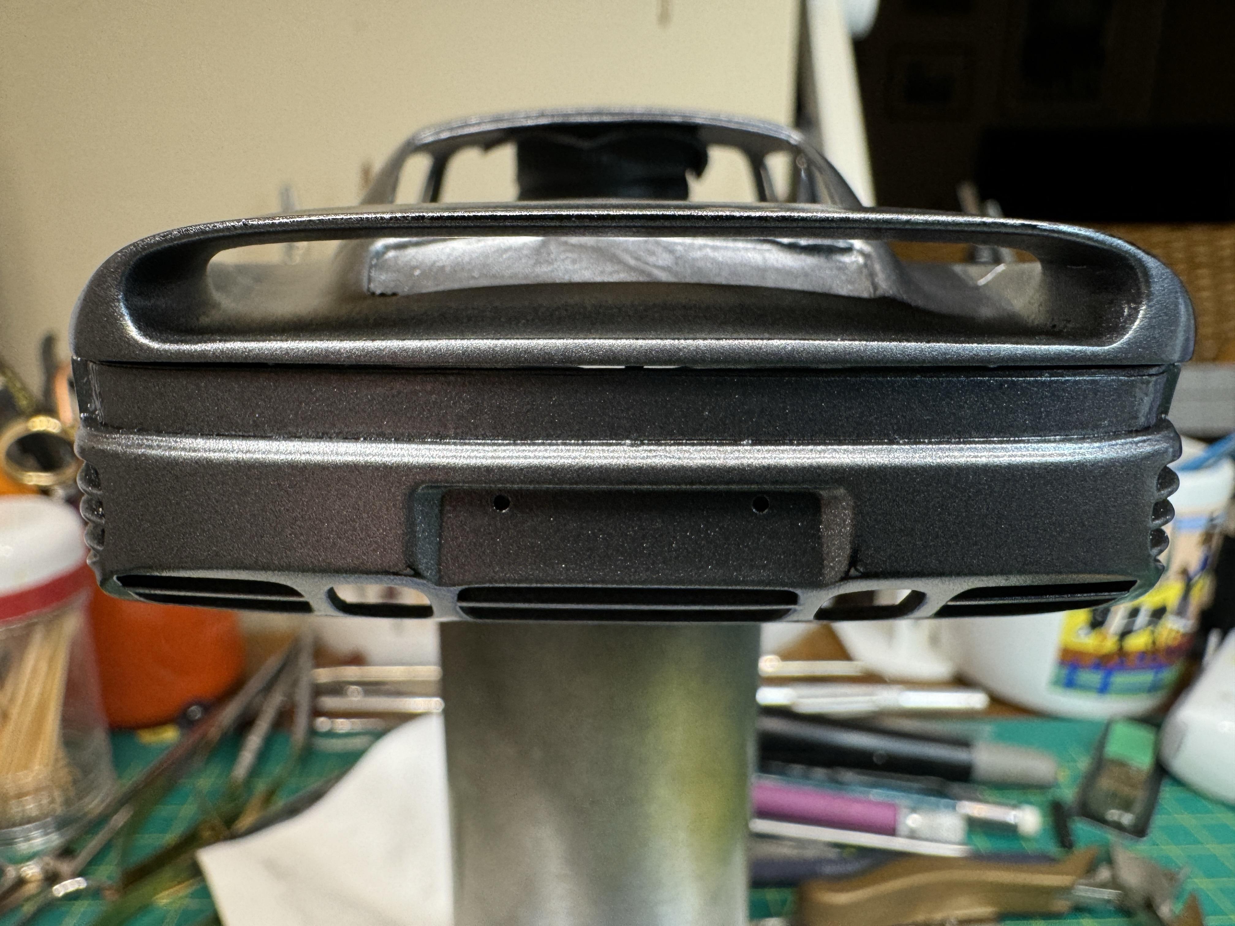

Now for my starving ego: that engine cover got hours and hours of my attention. With each repainting and the changes to gaps that causes, I maintained my goal with that thing: I added the gap, not by just raising the deck, but by sanding what is actually almost a flat line from where it meats the fender skirt up and over the sharp peak. And more important to me than the gap was maintaining the sheet metal (reinforced fibre, I believe) curves that are complex back there, complex and beautiful. At each stage that I took photos of the car, I always included one showed that unbroken flow. If I you didn't give me an opportunity to tell you about it ad nauseum, nobody would have noticed. Still, not many, if any, will get it. Hah!
And the opening under the spoiler. Damn. About 30 sec. of careless sanding in that tunnel resulted in my having changed the shape of the semicircle at either end. Than 30 sec. cost me 10 hrs. or more of body repair work. If anybody knows what the pink polyester putty it is that lots of builders are using, please, please post it here. Thanks.
Now I'm going to show you stuff that only I think warrants this much attention!
It started out innocently enough. Just a bit of light sanding since I was repainting it anyways.
Then started big investment of pride in the outcome. Not to mention the big investment of time in "care and feeding" of the beast.
Subtle use of Tamiya epoxy putty, which I found oddly soothing to maticulassly feather it to blend with the body.
But fixing that 30 sec. of damage to the tunnel, that was not soothing, relaxing, or anything else pleasant.
Many very frustrating hours into it, I figured I just wasn't going to be able effectively sand in those corners. And then a eureka moment that lead to results way better than I was expecting, though leaving lots of room for justified criticism from the highly skilled.
What you saw there took a long time to do. Tens of hours in all tolled, I'm pretty sure, on just the engine cover/spoiler/fender meeting point. Mathias, you almost certainly get it.
