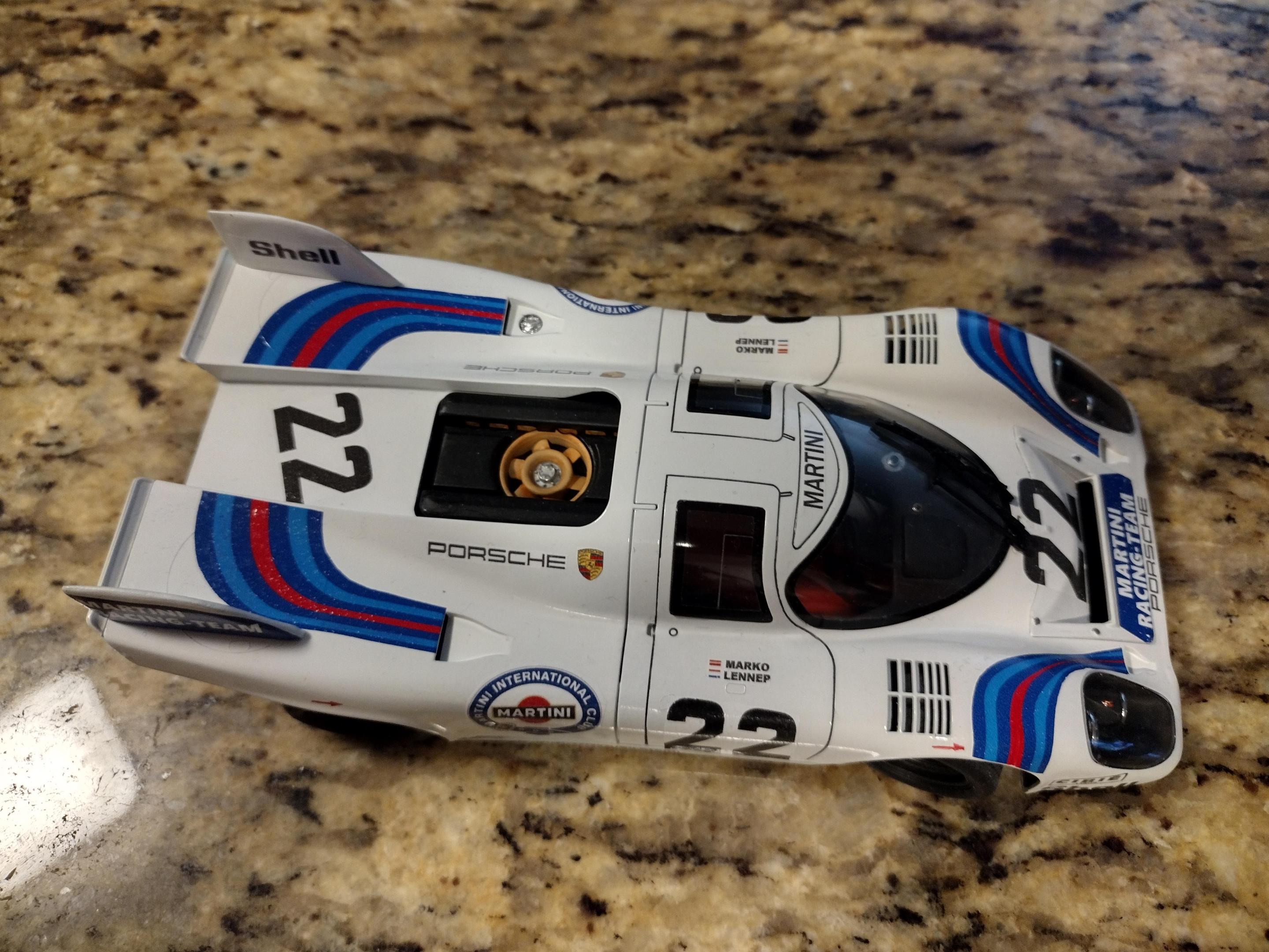

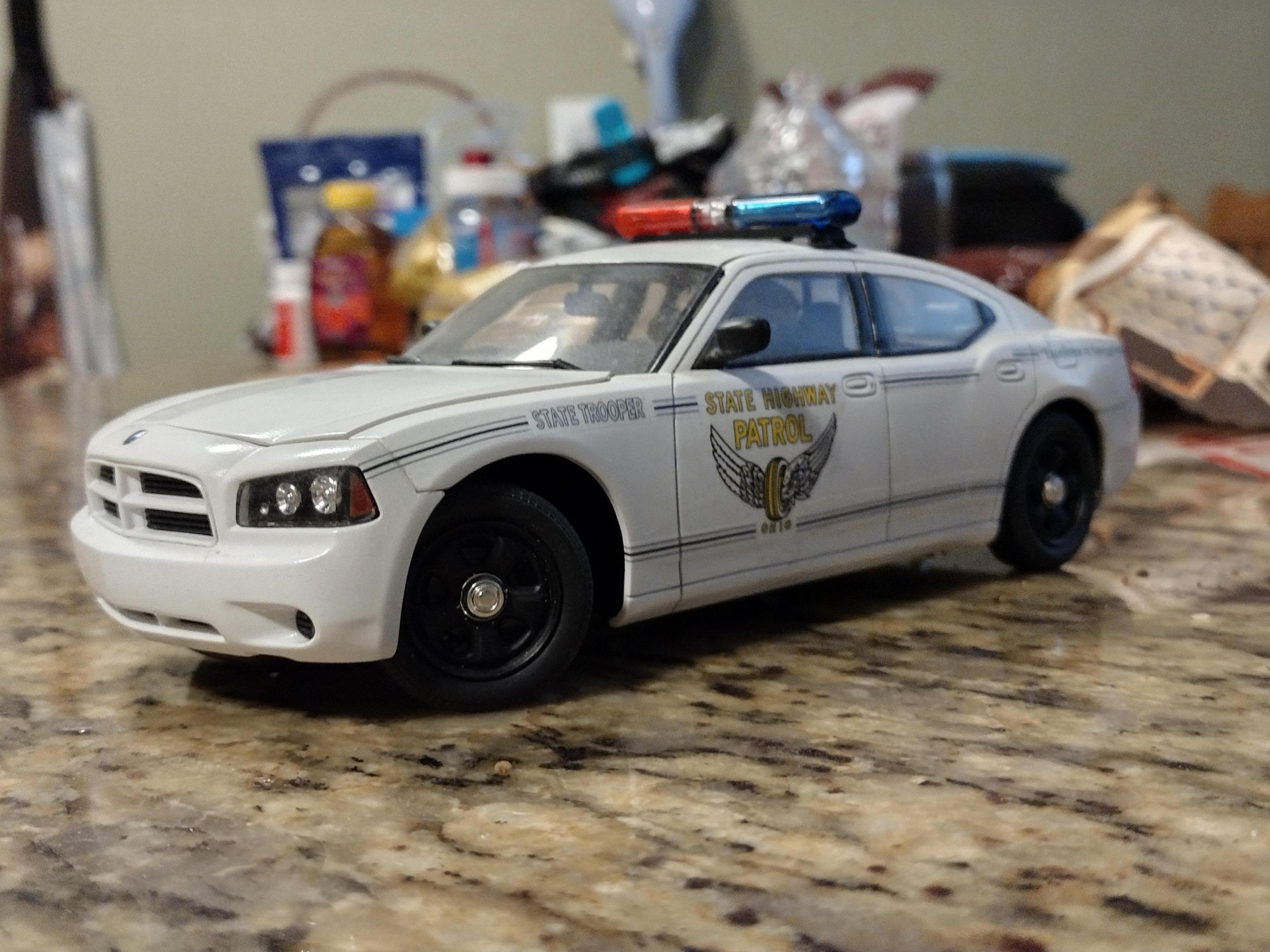

Done home printed decals a few times.  Here's a couple.  I usually spray the decals with clearcoat after printing to hold the ink.  I'm working on a replacement set for the USS Reliant now.

When creating decals, create your artwork and do your test prints on paper. Once you see what you want and you have the size correct, create a master with several to many of the decals you want.  As said above, some will screw up.  Once you print the sheet on decal paper, let it dry overnight.  The next day or later, seal it with Testors Decal Fixative. It's a spray can.  Do one light coat and let it dry. Repeat a few times.  If the decals start to run, and at least one will,  stop and let it dry!
If I was doing any more decals with a white background, I would do a two part decal.  Cut out and apply just the white background. Print your decal on clear, and after doing the sealing process, apply that over the now dry white decal.  Let that all sit a day or more than do any clear coat you wish.
