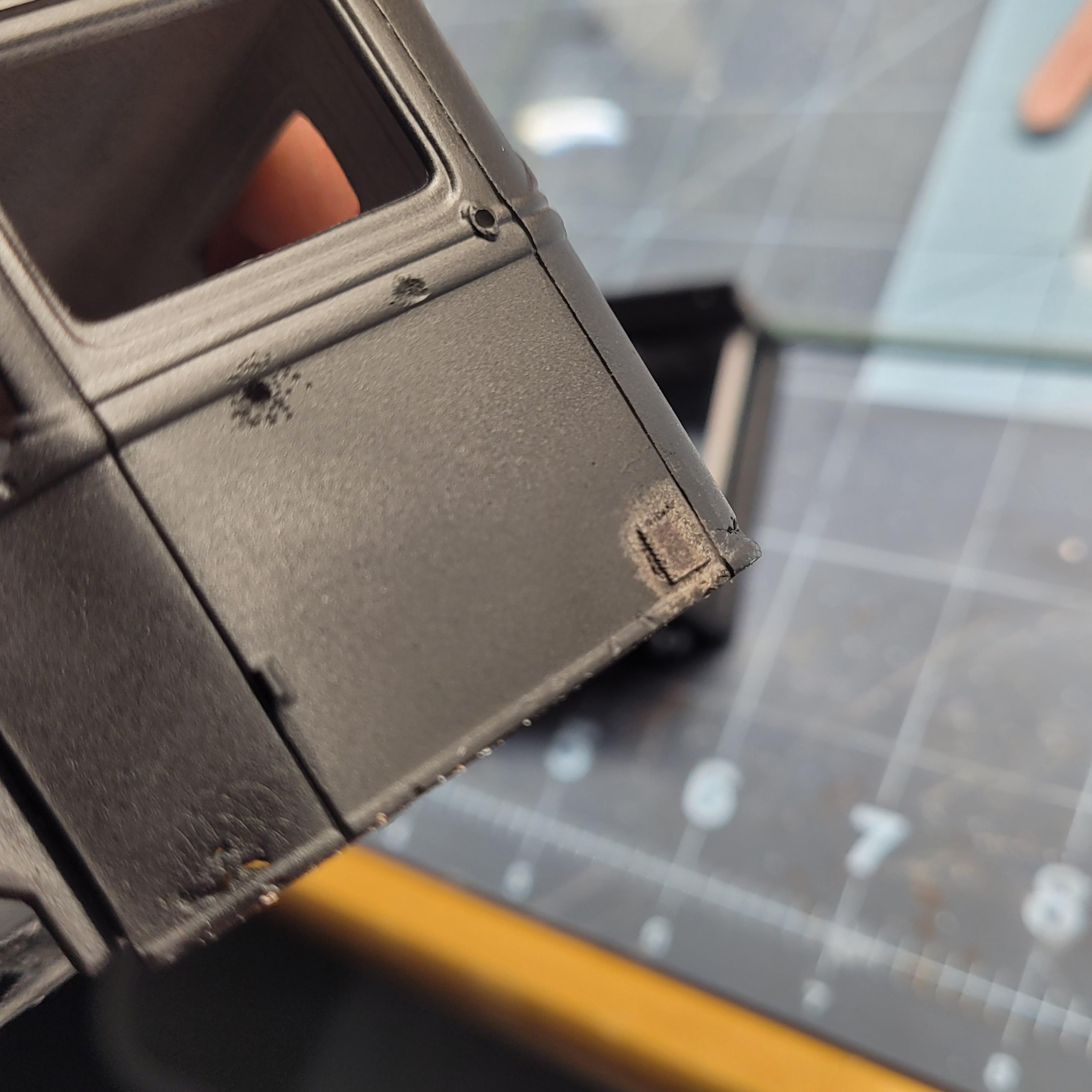

Think I figured out a simple way to pull this off. The welds look like an old farm repair,stick welded,perfect for my build. You'll need an old Xacto blade, bent on tip and dull. This is important.20250126_100649.jpg.52bfa2815824dff5cb3267ceb7136ff4.jpg I lightly ground the area to be patched with a burr. Cut the patch out of styrene,  the thinner the better and use solvent glue to secure it.20250126_100341.jpg.8229deba73d63f060e0e92609d548909.jpg20250126_100335.jpg.b4f5059592725d77720c062da492fa68.jpg After it dries, reapply a swipe of solvent around the edge and use that bent blade to just knick the edge, at a 45 degree angle to the patch. Barely nip it off, it'll be soft enough to form the weld bead, don't try and finesse it, just chop along the edge.20250126_100919.jpg.d34dbe1fb4cbcf1002a6dce8c92a87f0.jpg20250126_101528.jpg.ccb795a794a4931d5395d89a32e073b7.jpg Should look like this. From here it's just a matter of washes, dry brushing ect. 20250126_105958.jpg.7596c0a0d07c66fd279ec343e545debd.jpg20250126_110004.jpg.514dd68ae32005f3504c40a632537afb.jpg20250126_112711.jpg.e229fe2e8200c77d922b5932f3b24411.jpg20250126_112729.jpg.8d6494ccafae4845e1096674472144ec.jpgHere's mine, still have to go back and dry brush a bit of steel to bring out the welds.20250126_132623.jpg.e08674a4c83dfba5d2964a3885c6ada1.jpg20250126_132700.jpg.0dd63461b9dd968388e559232bc2fe89.jpg20250126_132623.jpg.e08674a4c83dfba5d2964a3885c6ada1.jpg20250126_132614.jpg.8c5d2f26d1ecf7432600c2c8cbe02b14.jpg Here's what i tried to mimic with this. arctoolong1jpg.jpg.0f443af120cc8419995ca8dbc2d825c2.jpgstick-electrode-and-welding-basics-1499867646.jpg.b535ae0da1bebfdb0b5f67be19ced083.jpg

I've seen available in styrene,  nothing on hand. This was .010, still a bit heavy,  but I worked with what I've got. Thanks

Nice technique. What if you didn’t even use a patch? Just brush some solvent cement on the area to soften the styrene first.

The whole point is to represent the "technique" chimps have been using since cars and stick-welders existed...slap a way-too-thick patch over a rust hole, secured by bubblegum "welds".

I could see that working, as if the repair was flush. I had thought about using some .020 rod and doing similar,  its easy  for me to get carried away doing this kinda stuff. I did notice the solvent makes the styrene sloppy very fast if you go overboard. Luckily it evaporates just as fast.
Very nice patching.  I tried to do this only once.  Used a very small hole punch at an angle to make the weld lines.  It worked pretty well to keep the round pattern.

Clever idea, I'll remember try that next time I need to do something like this. I was looking for a rough, hastily done look. I think a nice even bead would way more difficult to reproduce at this scale, not to mention color and shade. I'll have to give it a try
