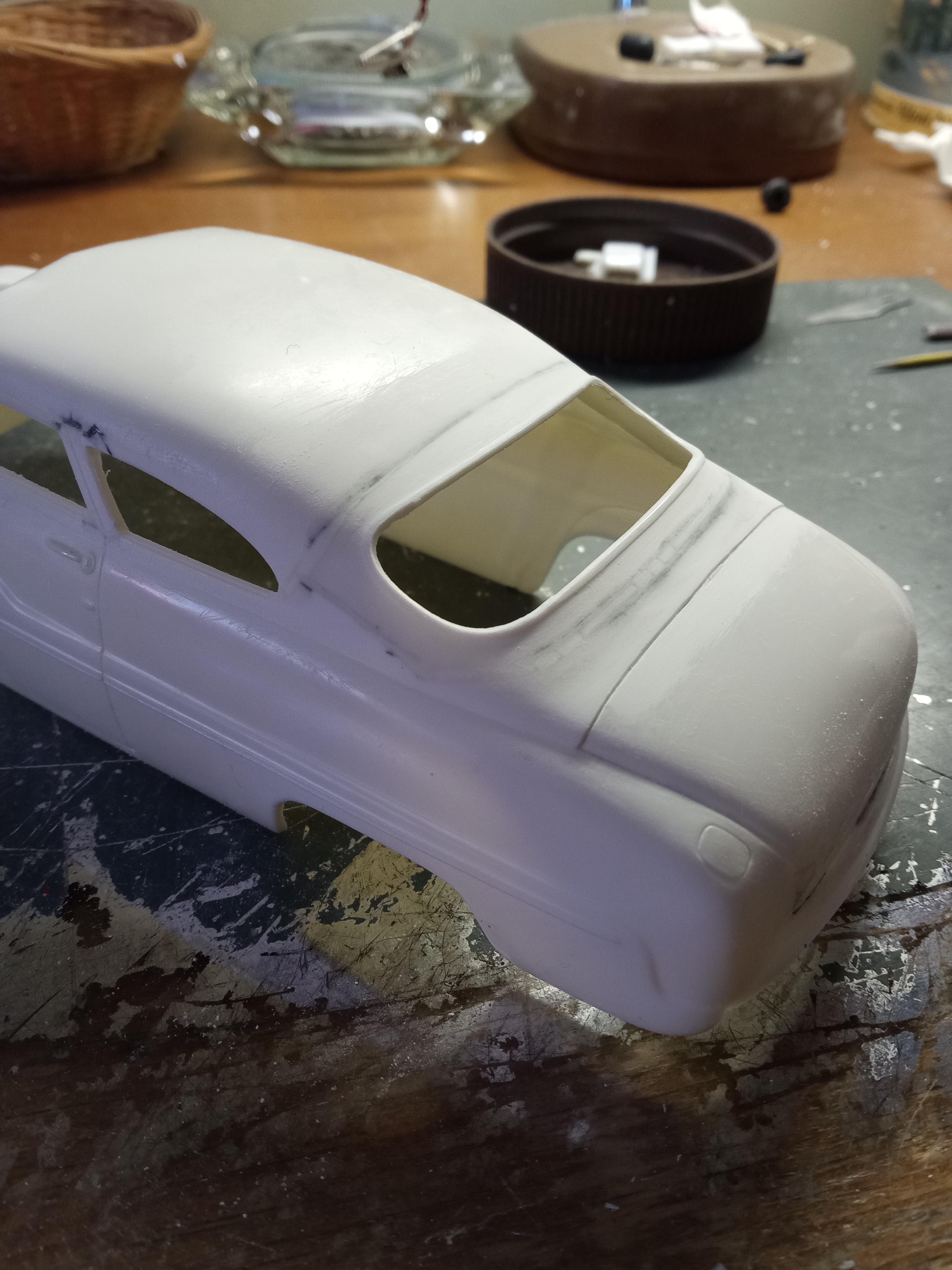

Supernurd Posted February 4 Author Posted February 4 From here the gaps are filled with sprew. Once filed into shape, the whole area was flooded with CA and sanded out. 5
Ace-Garageguy Posted February 4 Posted February 4 Yup, good proportions, the flow of the roofline looks good, and it appears to be symmetrical in most of the shots. Those three areas are where chops go bad, on real cars as well as models. 1

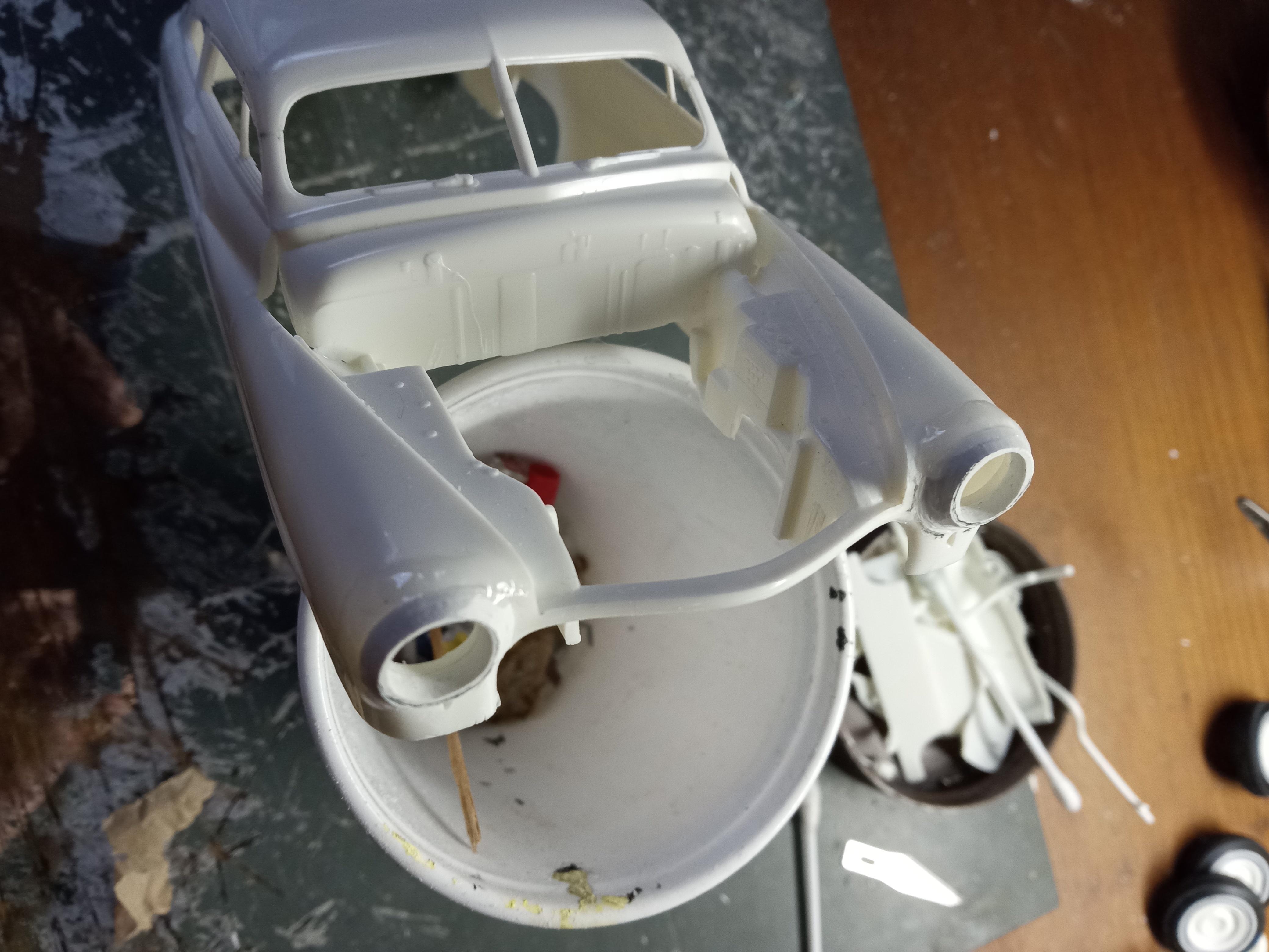

Supernurd Posted February 7 Author Posted February 7 (edited) The vent window pillars have been added back in. Now on to the headlights. Let's weld in some pie plates and get to work. I may go with the chrome bezels, or may go frenched. Yet to be determined. Edited February 7 by Supernurd 2
gman Posted February 7 Posted February 7 1 hour ago, Belugawrx said: 👍Looking great ! Agreed- excellent looking chop. 1
Bullybeef Posted February 7 Posted February 7 Chop looks well thought out and carefully executed. I’ll follow along to see more 1
