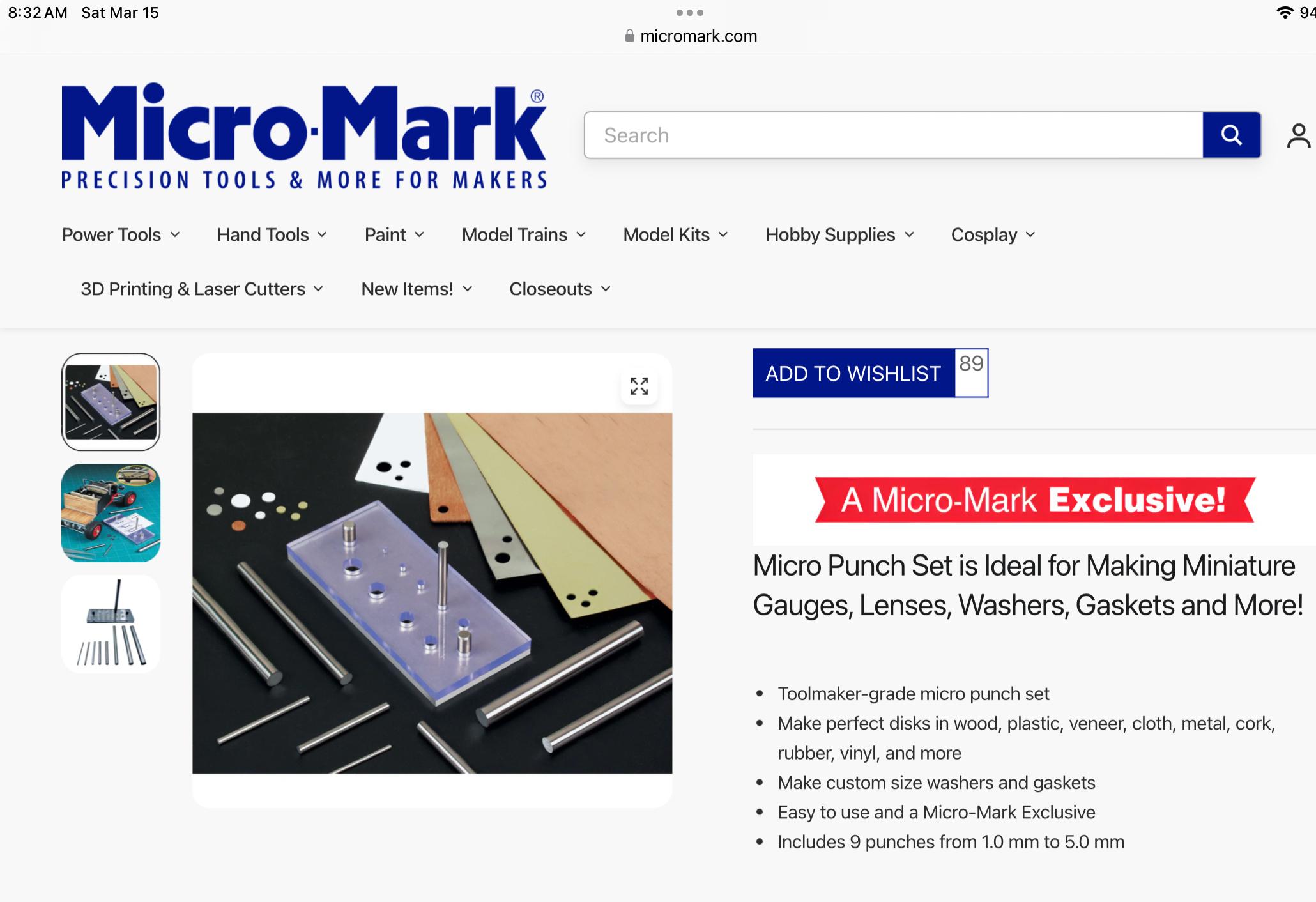

NOBLNG Posted March 15 Posted March 15 (edited) Here are two possibilities. The micromark ones sure aren’t cheap, but the advantage is that you can easily get the guage centered on the punch. The leather punches are cheap but harder to get perfectly aligned over the guage. Edited March 15 by NOBLNG 2
gman Posted March 15 Posted March 15 The toolmaker grade punch set would probably be the best option. If you are a DIY type of person, some aluminum or brass tubing with an appropriate inside diameter could probably be sharpened to make your own punch. It could be used against a soft backing. The main concern is having your punched-out decals get stuck inside the tubing and having to get them out gracefully without damaging them.

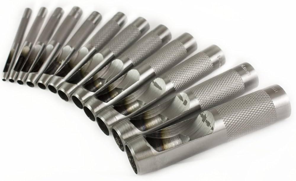

TarheelRick Posted March 16 Posted March 16 A set similar to these can be bought at Harbor Freight for a fairly reasonable price. I've had my set for several years and they work well for me. 2
