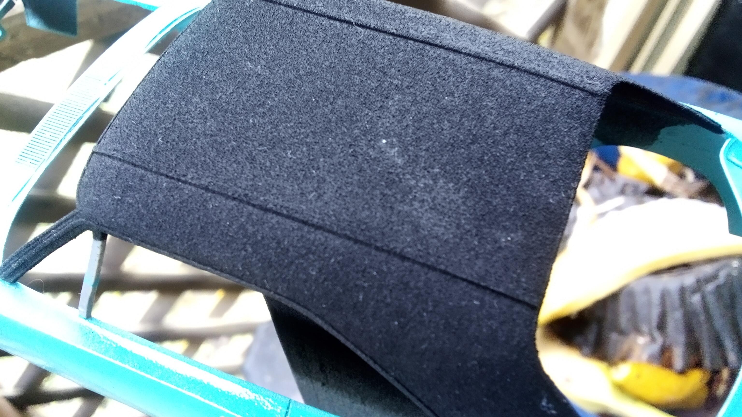

Dave G. Posted March 22 Posted March 22 (edited) On a completely different note but still enamel. A couple of weeks ago I had decanted some Rustoleum 2x semigloss black into one of my mixing jars to store and have on hand. Today I put some of that in my Paasche VL metal side cup and sprayed the loose chassis parts to my 34 Ford pickup build. Along with the interior floor. The difference between airbrushing this stuff and using straight from the can is phenomenal, in terms of over spray, even application. Usually I add a slight bit more thinner to 2x, with this I did not, but the .5 tip handled it. That semigloss is pretty loose to begin with. In the mixing cup after all settles, the layer of pigment on the bottom isn't a whole lot. But it still could have stood an extra bit of lacquer thinner. It was fine for what I was doing though. It sprayed great through the airbrush and cleaned up super easy with hardware store lacquer thinner Anyway, little Testors bottles aren't the only way lol. I had that can of black semigloss left over from a couple of summers ago, when I repainted a metal patio table and chairs. Edited March 22 by Dave G.
