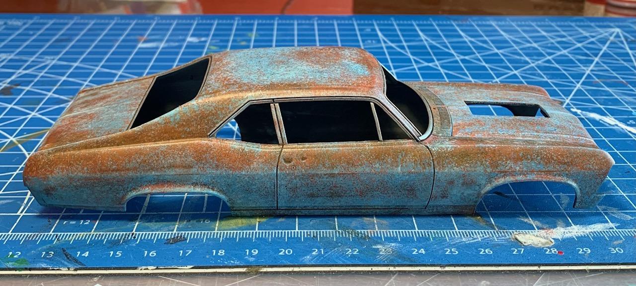

Pierre Rivard Posted April 4 Posted April 4 A Nova salt flat racer? Perhaps it makes no sense but in the spirit of the Bonneville Speed Week, there is category for just about anything. So my crazy idea is to start with a Nova, put a blown Chevy 427 Rat engine, do a rat rod style paint to is and create a.... SALT RAT! Get the concept? I'm dating this to early 2000's, run it in the Altered Classic category (stock pre 1981 body, allowed non stock blown engine, front dam and rear spoilers etc) What I really want to do is the painting experiment, but first the basics of getting the blower location to set the hood opening dimensions, get the basics go chassis ride set up (with my chosen tires) and figure out the air dam and spoiler setup 5 1
Pierre Rivard Posted April 4 Author Posted April 4 I sort of rushed through these steps as pre-requisite items to what I really wanted to do: the rat rod style paint. I forgot to document the steps but to summarize I started with a dark gray primer, then using sponges dabbed acrylic dark rust, light rust, red and orange paints randomly. I then did the same with medium to light blue but focusing on where I wanted residual color. I then gently wet sanded (1500 and 2400 grit) specific areas to blend in and smooth out the various colors. 11

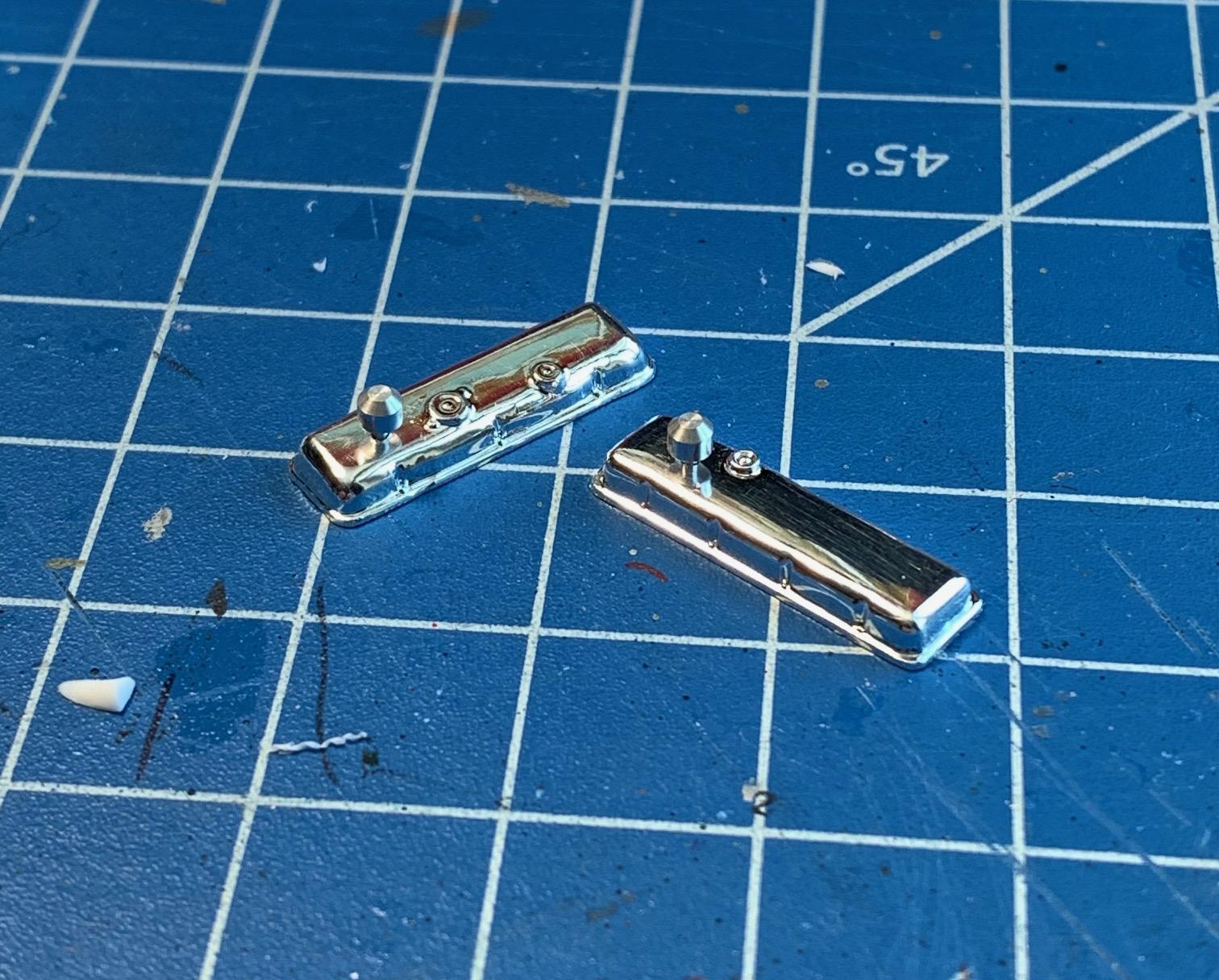

Pierre Rivard Posted April 12 Author Posted April 12 Leaving the excellent chrome covers untouched, other than adding Protect spun oil breathers. That was easy! 1

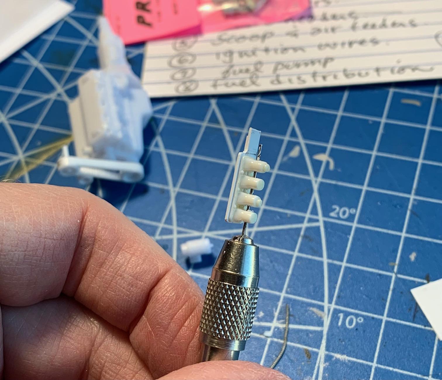

Pierre Rivard Posted April 12 Author Posted April 12 Fuel delivery through a barrel valve made from 2mm square Evergreen. One inlet fuel, 4 outlet fuel & valve actuation through throttle linkage (which also opens butterflies in air inlets. 4
Pierre Rivard Posted April 12 Author Posted April 12 And the back side of it, throttle linkage (where pedal throttle cable will attach to) and spring return. Not the best precision wise but it is all so small I can barely see what I'm doing... 4
