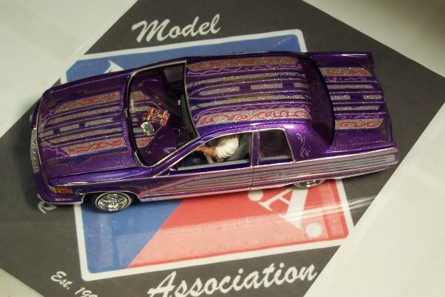

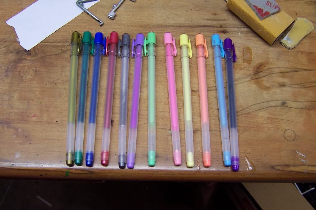

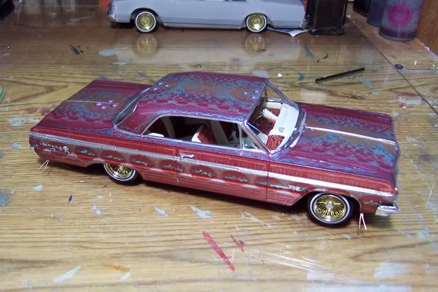

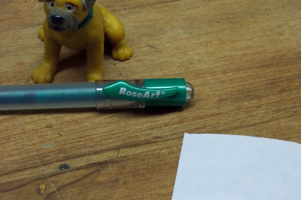

David@MinidreamsInc. Posted May 28, 2009 Posted May 28, 2009 I think i hear them calling me ! I would be 1 of them LOWRIDER guys that use the gel ! I believe i am the first modeler to take on gel pens but i honestly don't know ! I know i was the first on LAYITLOW.com to post a build up using the pens so I will try to answer your question the best i can and in a good spelling cause i'm not so great at that ! LOL ! The gels that i used up until February this year were called ROSE ART and i got them at WAL MART ! They run around $6.00 for a package of 12 With this set i found that the metallic colors silver and gold faded once you cleared them ! Here's a pic of them on a build ! I also use these gel pens that a great friend has given me ! They are called GEL WRITERS and are on eBay for around $30.00 but come in an 84 pack !But the good news is that with this set all the colors work great , the pens roll smooth and they do not move when adding your clear coat ! Here's a pic of them on a build ! NOW THIS TAKES LOTS OF PRACTICE ! YOU HAVE TO BE VERY CAREFUL CAUSE THE INK WILL NOT DRY UNTIL IT IS CLEARED ! IT WILL WIPE RIGHT SO YOU MUST BE AWARE OF WHAT YOU ARE DOING ! I HAVE ALSO FOUND THAT THE BASE COAT HAS TO BE FLAT NON SHINNY FOR THE PENS TO WORK FREE AND EASY . The ball of the pens seem to not want to roll on gloss surfaces ! I use the pens on hot rods, tuners , mini trucks, interior items for detail , heck once you get a set you will use them on everything ! Its even been said that i use them to much LOL ! I tell them its just my trade mark LOL ! Just practice and use your imagination ! And your sure to have a blast and find the way it works best for you !
