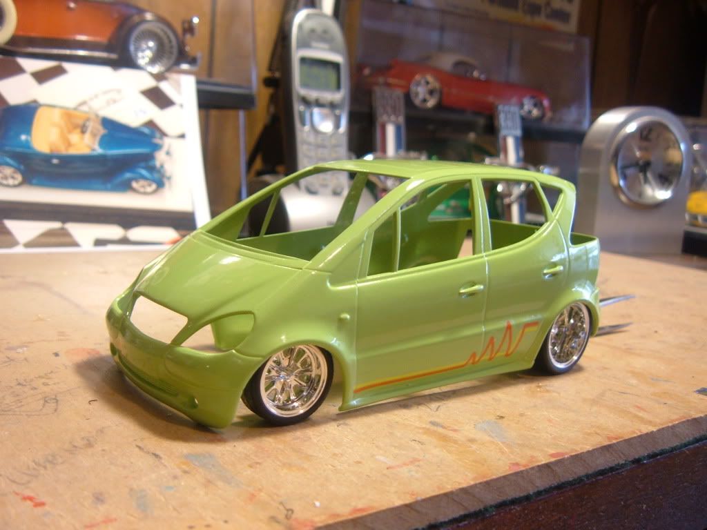

Nick F40 Posted June 10, 2009 Author Posted June 10, 2009 (edited) Thank you, and thanks Bob, that's probably what i'll do. I know about the wet sanding, (I like to do) through the grits and just polishing it but I needed to know how to use the rubbing compound and polish it out. Cruz, I know all you taught me and remember, my dad learned from you I like your method, of course, that's what I did on my Fairlady Z and Focus but i was just wondering with the compound. Randy said that it might take off paint, which it's kind of supposed to but it might take off more. Here's what i'm doing, Audi Quattro, rally. I have Turtle Wax Premium Grade Rubbing Compund and Meguiars Scratch X Edited June 11, 2009 by Nick F40
cruz Posted June 10, 2009 Posted June 10, 2009 Thank you, and thanks Bob, that's probably what i'll do. I know about the wet sanding, (I like to do) through the grits and just polishing it but I needed to know how to use the rubbing compound and polish it out. Cruz, I know all you taught me and remember, my dad learned from you I like your method, of course, that's what I did on my Fairlady Z and Focus but i was just wondering with the compound. Randy said that it might take off paint, which it's kind of supposed to but it might take off more. Here's what i'm doing, Audi Quattro, rally. I have Turtle Wax Premium Grade Rubbing Compund and Meguiars Scratch X Looks good Nick but try taking that picture on the same sunny day but under a deck or something, the gloss will be more noticable when photographing it against the sunny background, something like this..... Hosted on Fotki Right now, the metal flakes are making it a little impossible to see the glossy surface. Try it for me okay!! Please!!! Please!! By the way, I love that Quattro, gots to get my paws on one.... Those body lines are sweet man, you have to get this one done man. Say hi to your pops and tell him that I regret teaching him how to polish, he is kicking my "trasero" every time we compete.

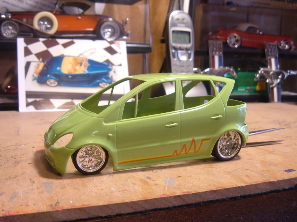

Nick F40 Posted June 11, 2009 Author Posted June 11, 2009 Right now, the metal flakes are making it a little impossible to see the glossy surface. Try it for me okay!! Please!!! Please!! By the way, I love that Quattro, gots to get my paws on one.... Those body lines are sweet man, you have to get this one done man. Say hi to your pops and tell him that I regret teaching him how to polish, he is kicking my "trasero" every time we compete. It's cloudy today so I'll try it. Yeah, this is one of my favorites and yeah me to, especially 1:1. I definetly want to get this one done for next meeting, which you'll get to see it!
Nick F40 Posted June 11, 2009 Author Posted June 11, 2009 here's some better ones Could I just use 4000 and 6000, then rub it out?
