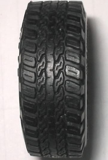

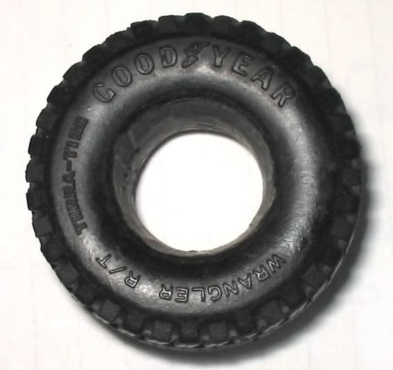

Ron L Posted June 15, 2009 Posted June 15, 2009 Both resin and urethane (flex, reo) tires suck! I wish there was a better method to cast them. Urethanes take forever to cure, and their viscosity does not lend itself to simple gate/vent systems you'd use in a resin mold. Urethanes coagulate a week after purchase and require heating to get them back to liquid state. However they are easy on your molds since they do not heat up. You can also mold them on the small side to allow them to fit on a variety of wheel diameters. Resin tires are fine unless they warp .001" because your mold's corner was sitting on a piece of lint, then the tire doesn't fit on the rim anymore. The exothermic curing process is also very tough on molds especially in the tread area. Here's a car using resin tires. It looks fine in pictures but closer inspection reveals uneven tread and the tire-to-wheel interface is bad due to the tire being out of round. I don't think I'll ever do resin tires again unless it was molded with the wheel.

Ron L Posted July 9, 2009 Posted July 9, 2009 I have been told by my local supplier (The Engineer Guy) that adding 10% of Mold Max 30 to the Smooth Cast resin (all Smooth On products) would yield soft tires. Haven't tried it yet, did get some black pigment. Tires are a PITA, and I'm also thinking of doing tire/wheel combos. 10% Mold Max without the hardener or do you still have to mix the 10% in a 10:1 ratio? Even then you'd end up with a viscosity that's close to the Reo-flex (Smooth on) or Flex- (Alumilite), which would still cause problems with pouring into the mold and the cure times might even be slower. Any pigment also slows down the cure time of the urethane resins. Seems that it would be less of a hassle to just buy the correct materials. They do exist for a reason.

Ron L Posted July 14, 2009 Posted July 14, 2009 OK I tried mixing in some old Moldmax 10 I had with Alumilite resin since my Smooth-on resin has gone sour. Every try mixing honey with water? Well that pretty much explains it. Once I did get it stirred there were still little balls of silicone suspended in the resin. Mixed it up with the other part anyway, added the black tint, and poured it into a tire mold. They do come out flexible, but not flexible enough to stretch onto a larger rim which is what I was shooting for. It'll stretch enough to allow a fudge factor of about 0.003" but forget using the same tire for, say, 15- through 17-inch rims. The little suspended bits of silicone is also a problem in the finish.
