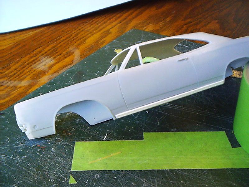

I got started by adding the fenderwell trim and rocker panel molding. This will all be BMF'd after painting.

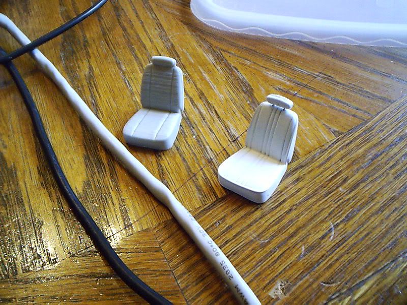

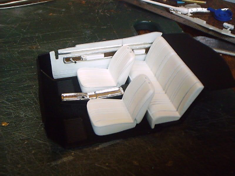

The '69s seats are the right shape, but wrong pattern, so I sanded 'em smooth and started rescribing the correct pattern....(Kit seat on the left, rescribed seat on the right.) The pattern will be repeated on the rear seat.

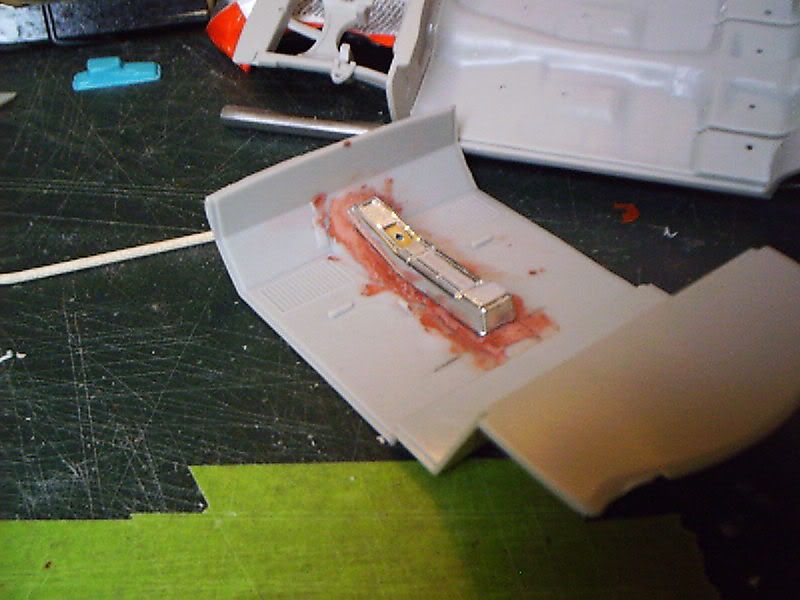

The console from the Revell '67 kit was grafted in place....

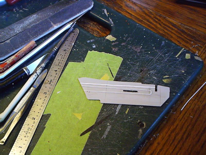

I also started reworking the door panels....

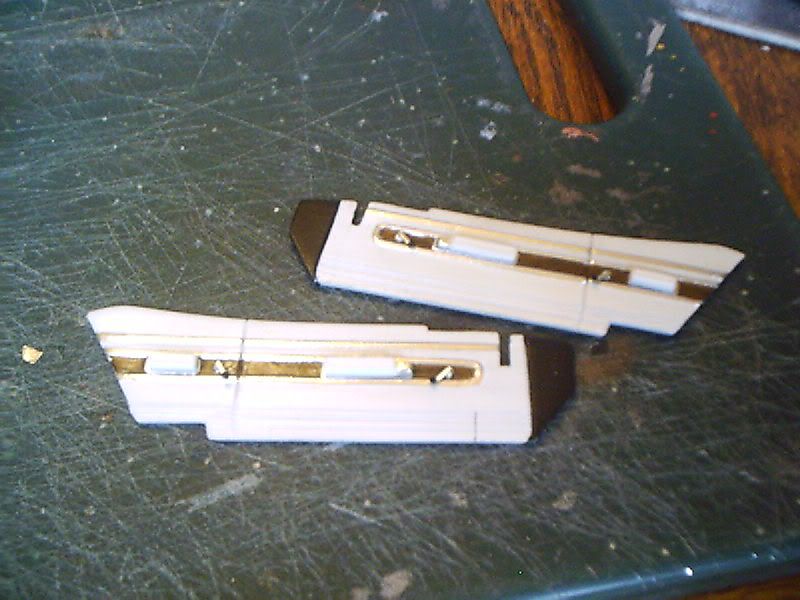

Got the door panels finished. Since I lost the molding in detail with all the sanding and whatnot, I made new window cranks from aluminum and plastic bits.
Also got the seats finished, but don't have the optional headrests attached yet.

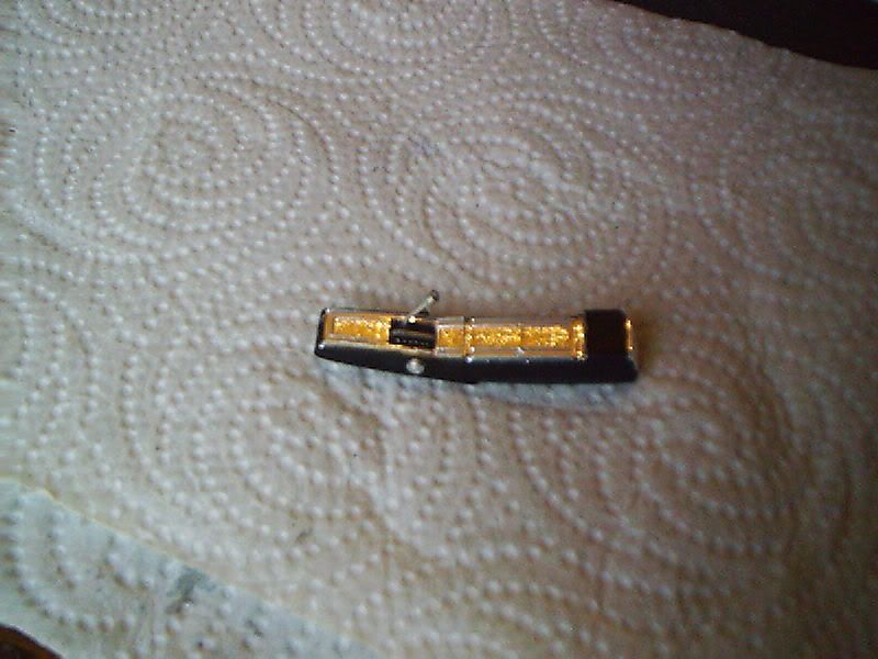

Well, I got the interior finished now. I detailed the console by adding the little lights on the sides, made from aluminum rod with a drop of epoxy for the lenses, and made the proper automatic shifter gate. The shifter knob is aluminum turned in a dremel....

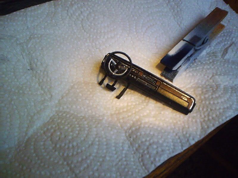

Next, it was the dash. The biggest challenge here was the radio....the kit dash has knobs, the actual car had the trademark Mopar thumbwheels. I drilled out the knobs, filled in the holes with Evergreen rod, and added the thumbwheels using Evergreen half-round. Evergreen strip was also used for the dash trim. I added pedal for an automatic, and used the correct steering wheel from the Revell '67 kit. The glovebox emblem is from a MCG photoetch set. The instruments, radio face, and A/C vents are decals....

Ok, enough of my seatbelt tirade. Here is the finished interior...not perfect, but hopefully close enough......

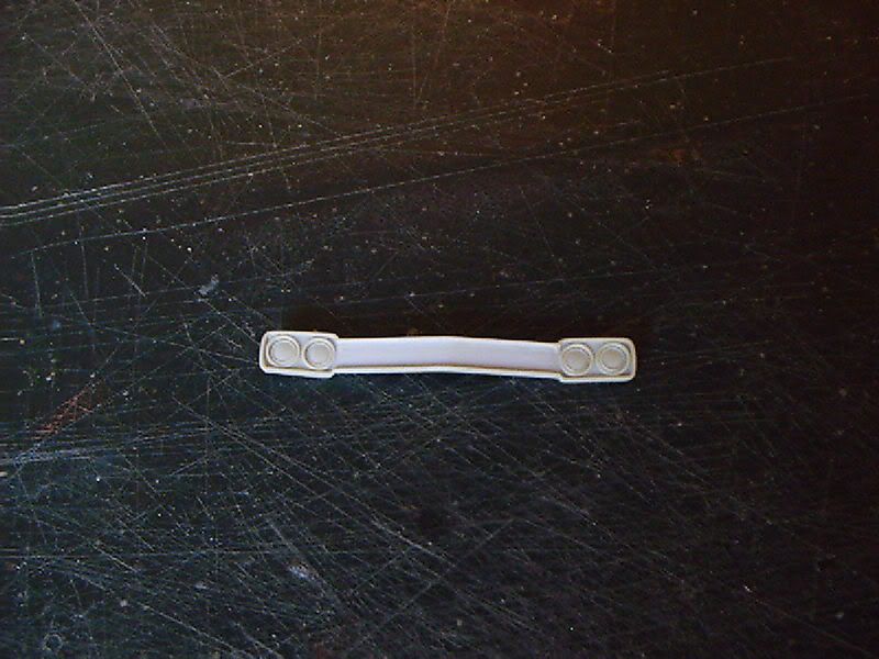

After finishing the interior, I decided to make the unique GTX grille, since that was the next challenge I was unsure of. I figure if I get all the hard stuff done first, the rest will be easy!

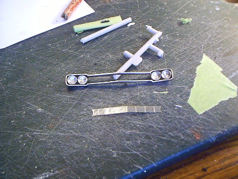

I started by stripping the chrome off the '68 Road Runner grille and sanding the detail off. I also drilled out the molded in headlights....
I then Alcladded (is that a word?) it. At this point, I could've used the decal grille that is supplied with the Keith Marks decals, but I wanted more of a 3-dimensional look. I decided to cut out the center and use a photoetch grille from a MCG '66 Chevelle set, which has almost the same exact pattern as the GTX grille.....
I then installed some clear lenses from the parts box, and used the GTX emblem from the AMT '69 GTX grille....and its finished!

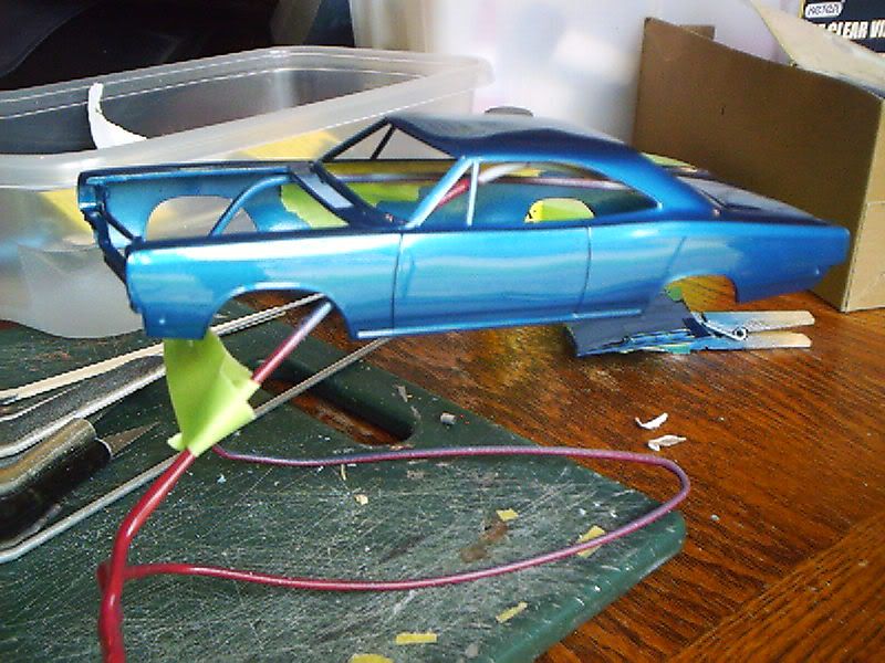

My current work schedule doesn't leave me with much building time, about 3 days every two weeks, but I'm still working on this! I spent this trip home getting some paint layed down....QQ-1 Electric Blue, followed by urethane clear. I also removed the molded in door handles, and will replace them with separate pieces.

I love the Paint Job.
Absolutely Gorgeous
Almost the car of my dreams, I want a 69 tho:D
But I'd take that in 1/2 a heart beat.
That was the exact color of my friend Bobby's '68 GetX. Stupidly he had it repainted Gold, heaven knows why - the blue is sexier. His had a black vinyl roof.

Well, I've seen some fantastic paint jobs, but that knocks it out of the park!! :wub:
Of course, I'm biased to factory stock------and I see one beautiful paint job there!
